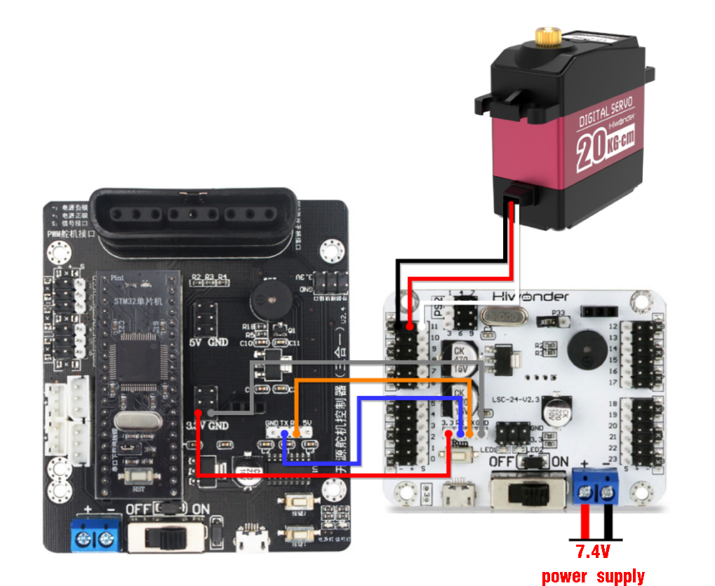

6.1.1 Wiring Instruction
This section employs the STM32 controller based on STC15W4K32S4 and a 24-channel servo controller for development, powered by a 7.4V lithium battery. Connect the serial port on the servo controller to the serial port on the STM32 controller.
  • The servo wiring shown above is for illustrative purposes only. For specific connection interfaces, please refer to the the following text.
  • When using our lithium battery, connect the lithium battery interface wire with red to positive (+) and black to negative (-) to the DC port.
  • If the interface wire is not connected to the lithium battery, do not directly connect it to the battery interface wire to avoid a short circuit between positive and negative poles, which may cause a short circuit.
  • When connecting the serial ports, the RX and TX pins should be reversed. Please refer to the images above.

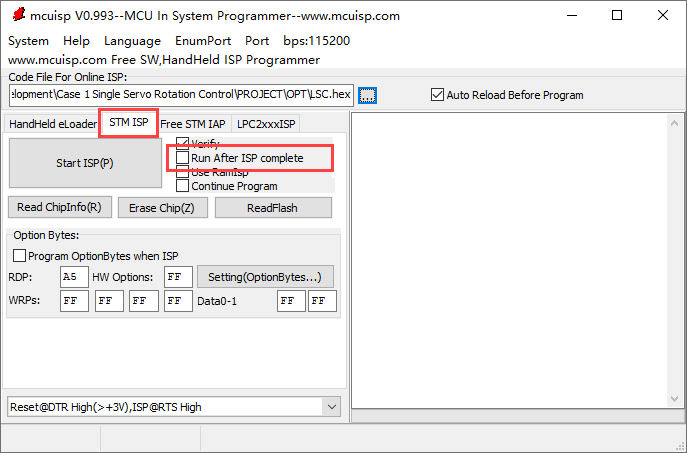

Open the download tool in Appendix > STM32 Software.
Configure it as shown in the figure:

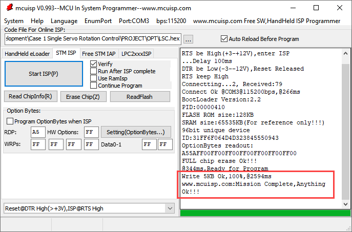

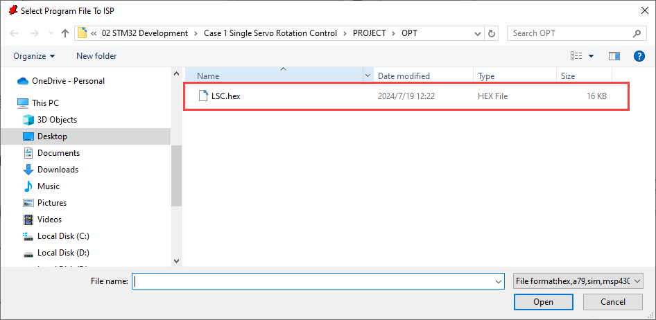

Click . Locate and open the hex file stored in STM32 Development > Case 1 Single Servo Rotation Control > PROJECT > OPT.
After opening the program, click “Start ISP” to download the program to the STM32 microcontroller.
When downloading the program, remove the jumper cap on the STM32 microcontroller and press the reset button. When the prompt “Mission Complete, Anything OK” appears in the lower right corner, it is successfully downloaded. Next, insert the jumper cap back into the STM32 microcontroller.
After the download is completed, switch the 24-channel servo controller on. Press the reset button on the STM32 microcontroller. The servo 1 will start to rotate.

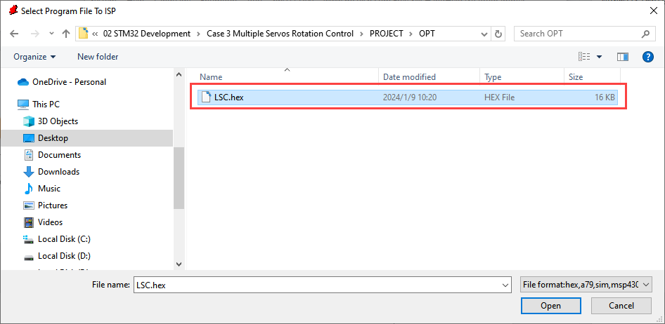

Click . Locate and open the hex file stored in STM32 Development > Case 3 Multiple Servos Rotation Control > PROJECT> OPT.

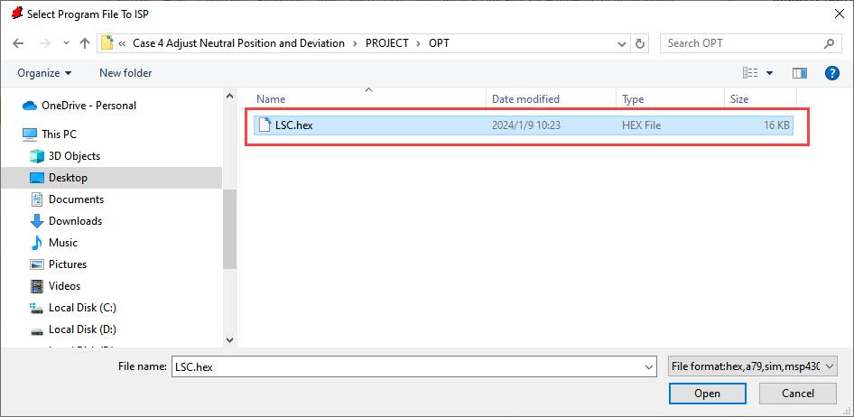

Click . Locate and open the hex file stored in STM32 Development > Case 4 Adjust Neutral Position and Deviation > PROJECT> OPT.
  • Program Outcome
The servo returns to the neutral position. After a short delay, it rotates to the deviation angle and maintains that position.
