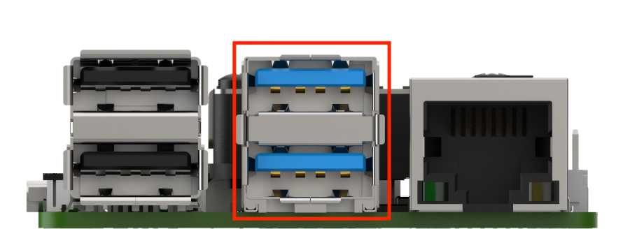

Connect monocular camera to any USB ports on Raspberry Pi board. It is recommended to connect to USB3.0 port (blue) for higher transmission rate, as shown in the picture below:

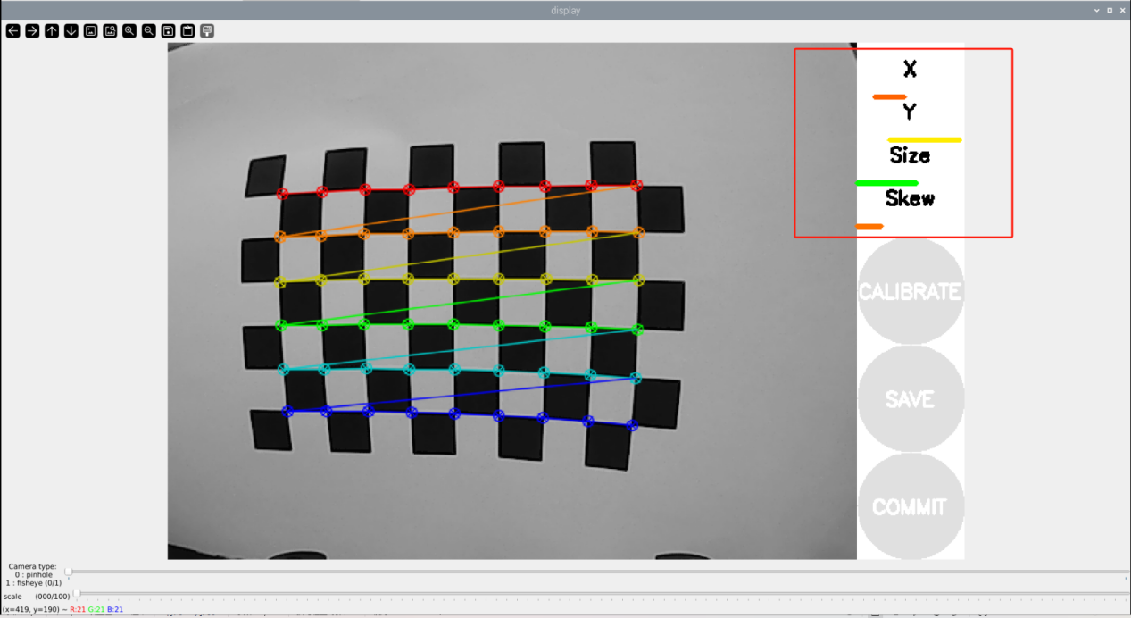

(5) After starting the calibration program, place the chessboard horizontally in front of the camera. Keep the chessboard in a horizontal position and quickly move and tilt the chessboard image in front of the camera. When multiple colored lines appear on the chessboard grid and the progress bar on the right side shows changes, it indicates that the calibration is in progress. During calibrating, you need to repeat this operation several times until the progress bar on the right side turns completely green.
In this case, the parameter “x” represents the left and right movements in the image field of view. We use it to shift the chessboard left or right. The parameter “y” represents the up and down movements in the image field of view. We use it to shift the chessboard up or down. The parameter “size” represents the orientation of the image and the distance from the camera. We use it to adjust the distance of the chessboard, either moving it closer or farther. The parameter “scale” represents the degree of tilting in the image. We use it to randomly tilt the image at different angles when it is in a horizontal position.

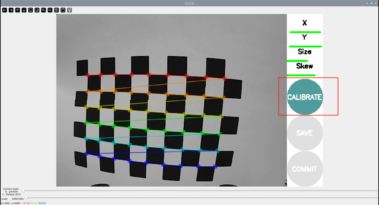

(6) Until the progress bars of the parameters “x”, “y” and “scale” turn green on the right, and the “CALIBRATE” icon is also displayed in green, it indicates that the calibration is complete, as as shown in the following figure

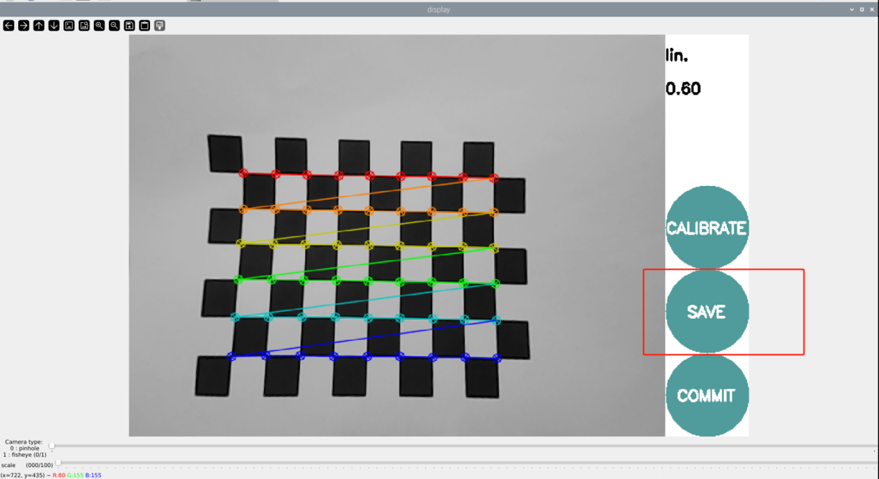

(7) Then click “calibrate” to start computing calibration.
the duration of the calibration process is determined by the numbers of calibration images. The more images required, the longer the process will take.

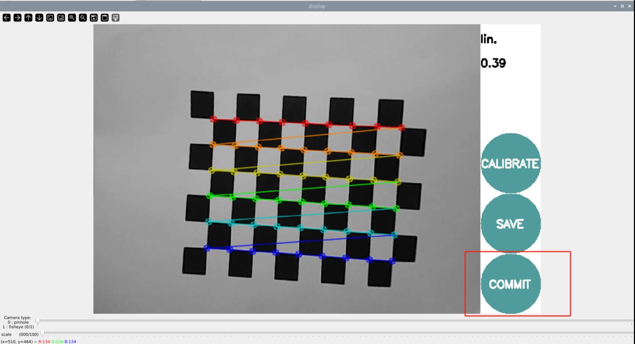

(8) After calibration is complete, try to move the chessboard picture within the display to check if it is straight and click “commit”.
