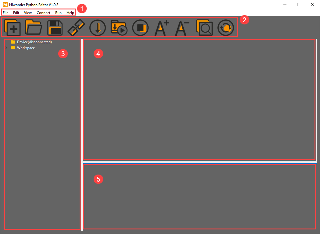

The editor interface is divided into 5 sections as below:
Each area has its corresponding functions, as shown in the table below:
No. Area Name Function Description
1 Menu Bar Contains File, Edit, View, Connect, Run, and Help
2 Toolbar Includes some commonly used shortcut keys that have the same effect as certain keys in the menu bar
3 File List Divided into multiple project files in the device and locally, allowing you to view the contents of project files (folders, source code, etc.)
4 Code Editing Area Allows you to view and write code
5 Terminal Displays message logs and debugging information. When no device is connected, only the message logs can be viewed

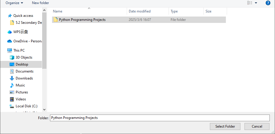

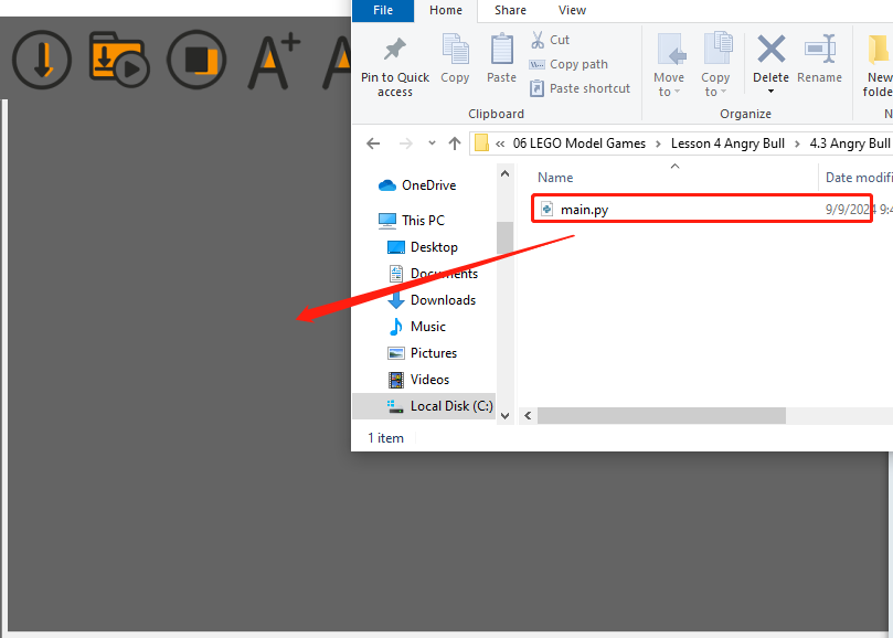

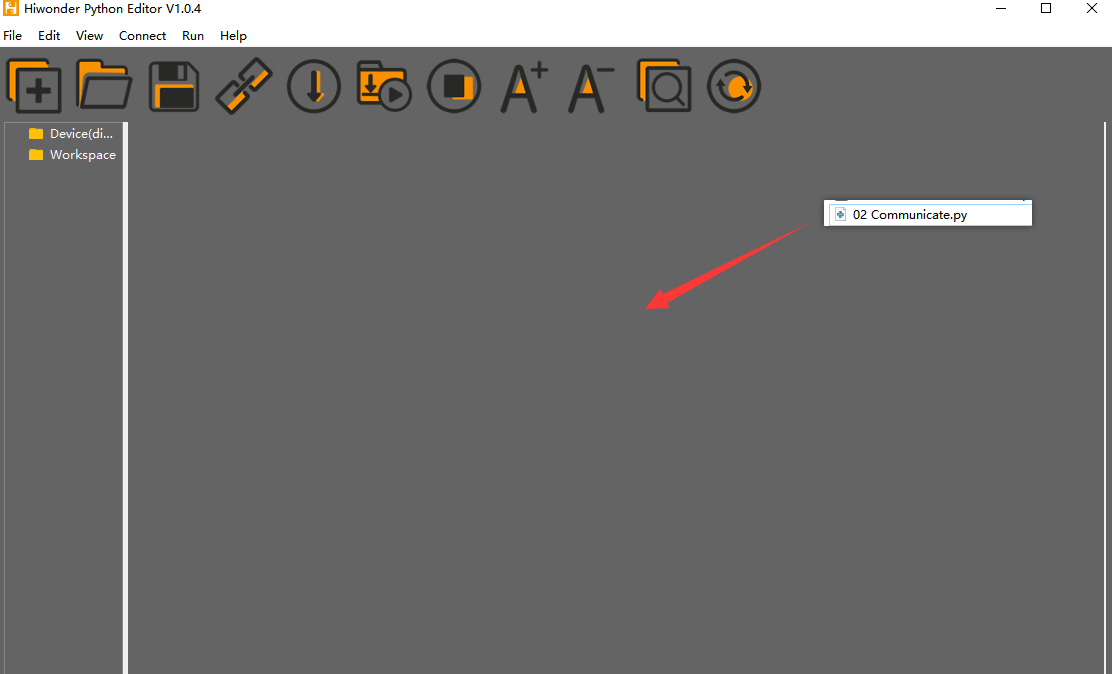

  • Importing Local Projects
(1) When importing a local project for the first time, left-click on ‘Local Projects’ to open the file selection list. (For subsequent imports, right-click on ‘Local Projects’ and select ‘Switch Project Path’).
(2) Select Python Project Programs and click the ‘Select Folder’ button.
(3) The files in the folder will be automatically added to the local projects, and you will be able to see them under ‘Local Projects’.
Importing a local project brings files from your computer into the editor, not downloading them to the ESP32 core board.

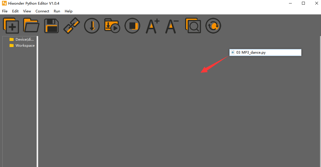

  • Viewing Imported Files/Programs
Here, we can double-click on the program file in the file list to view the detailed code. For example, let’s take march_on_the_spot.py:
Similarly, after downloading the program file to the ESP32 core board, you can double-click it under the ‘Devices’ list to view the program file.

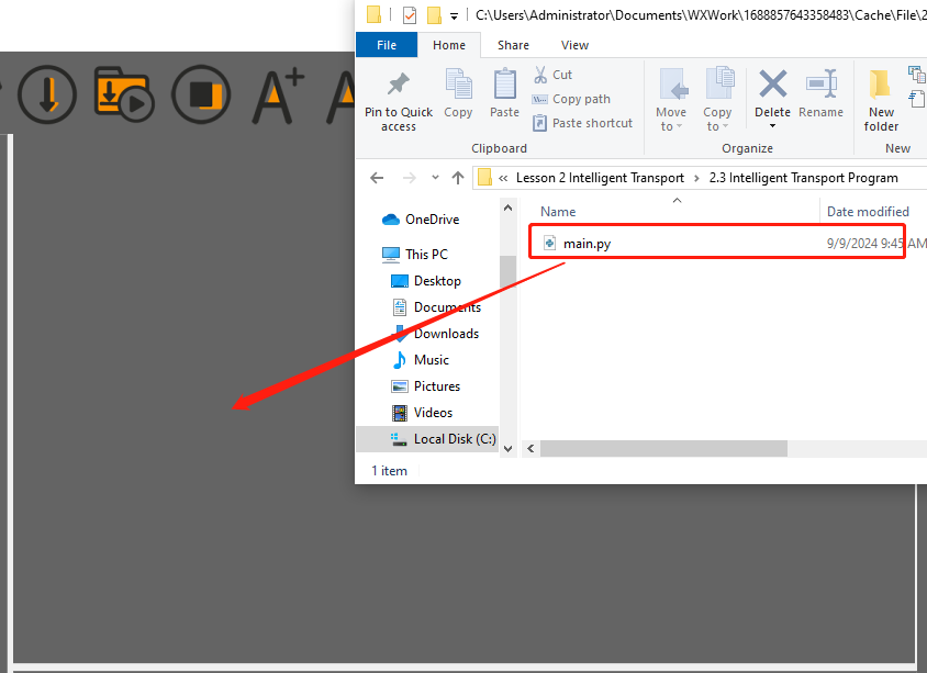

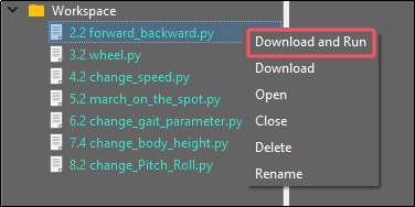

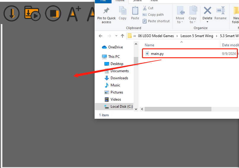

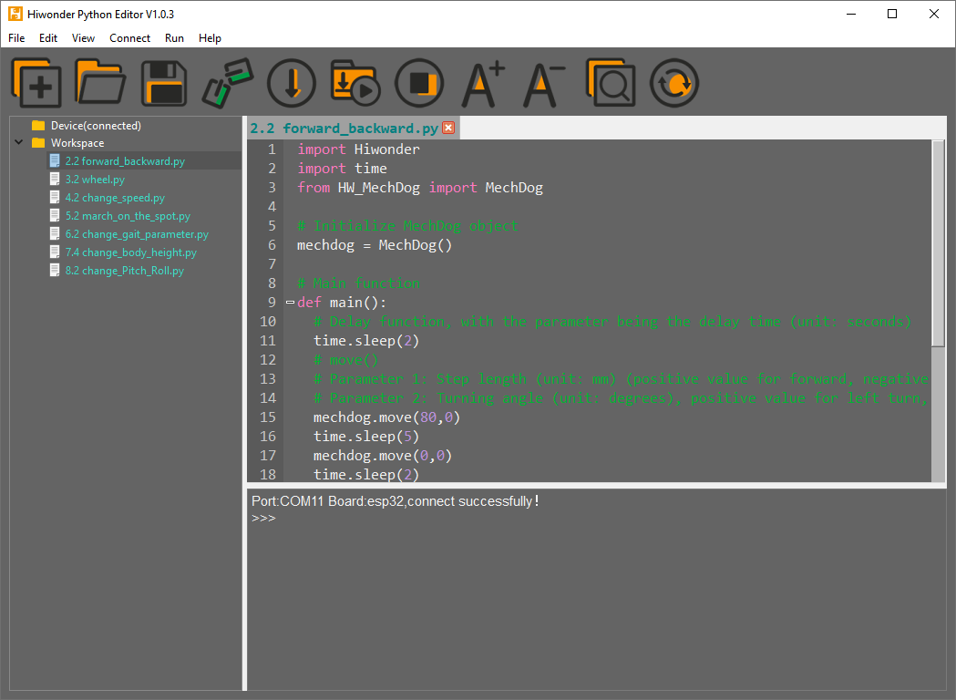

  • Program Download and Execution
Downloading a program is an interactive action between the editor and the device. Using ‘march_on_the_spot.py’ as an example:
(1) After selecting the ‘Hello.py’ file in the ‘Local Projects’ tab, click in the toolbar or right-click the file and choose ‘Download and Run’.
(2) You can view the download progress and completion status in the terminal interface. Since ‘Download and Run’ was selected in the previous step, you can also observe the program’s running effect.
(3) Once the download is complete, the program will appear in the file list under the ‘Devices’ tab.
(4) Finally, delete the original ‘main.py’ file of MechDog and rename the downloaded ‘change_speed.py’ to ‘main.py.’

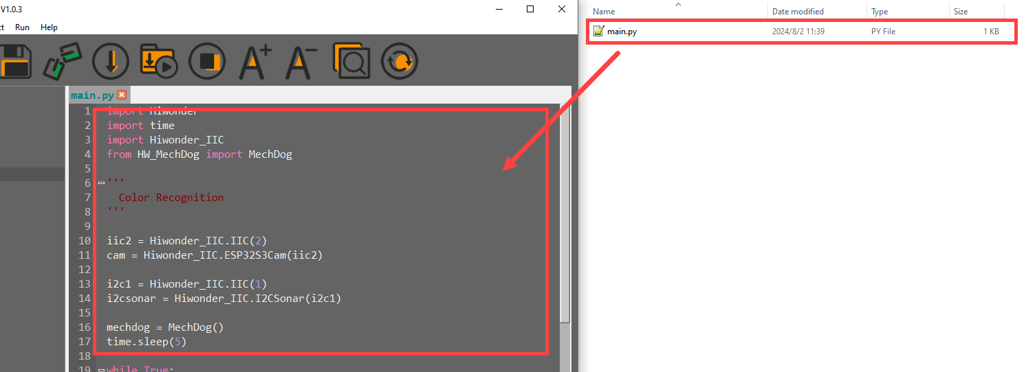

① Besides this download method, you can also rename the file you want to download to ‘main.py’ before proceeding with the download.
② The ‘Download and Run’ function first resets the device (restarts) and then downloads and runs the program, which helps enhance the stability of the program execution.

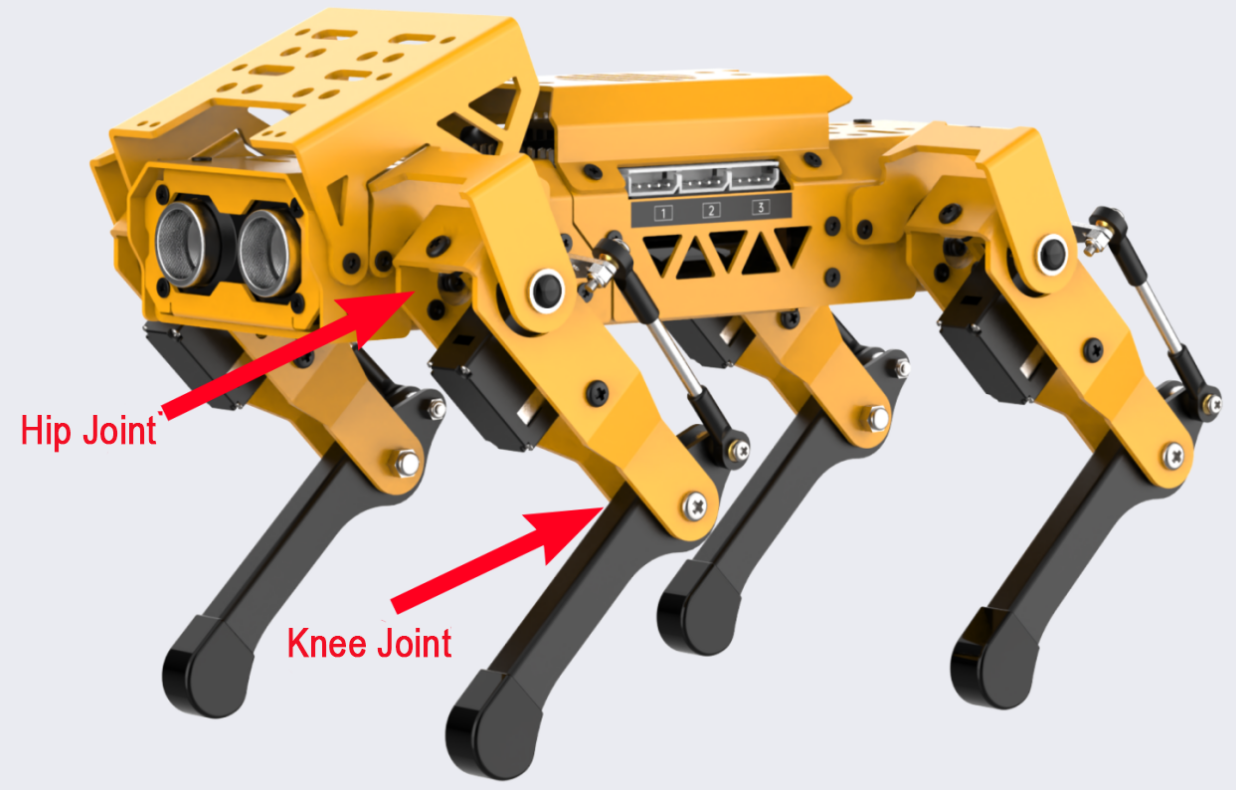

Understanding MechDog’s Leg Composition
The leg consists of the hip joint and knee joint:
Hip Joint: Connects the body of the robot dog to the thigh and rotates within a single plane.
Knee Joint: Connects the thigh to the lower leg and also rotates within a single plane.

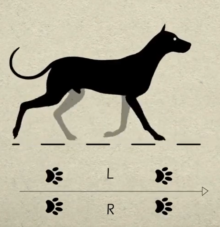

Gait is a periodic summary description of the walking characteristics of animals. Simply put, it describes how animals walk. Common gait characteristics in quadrupeds include trot, walk, amble, pace, etc.
MechDog utilizes the trot gait, so this section analyzes the trot gait.
(2) Explanation of Trot Gait
The trot gait is a medium to low-speed dynamic gait characterized by diagonal pairs of legs moving forward and backward simultaneously lifting and landing. This gait covers a wide range of speeds, combining stability and speed, and is the most commonly used quadrupedal gait.
We will explain using the following model:
Below is an illustration explaining the gait cycle:
① Legs 1 and 4 lift and swing forward, while legs 2 and 3 support the body to ensure MechDog’s center of gravity is at the diagonal intersection.
② All four legs touch the ground simultaneously, with legs 1, 2, 3, and 4 all providing support.
③ Legs 2 and 3 lift and swing forward, while legs 1 and 4 support the body to ensure the dog’s center of gravity is at the diagonal intersection.
④ Finally, legs 2 and 3 also touch the ground, along with legs 1 and 4, completing one walking gait cycle.
⑤ When these 4 sets of actions are completed, MechDog has completed one full cycle of movement.

  • Program Download
forward_backward.py

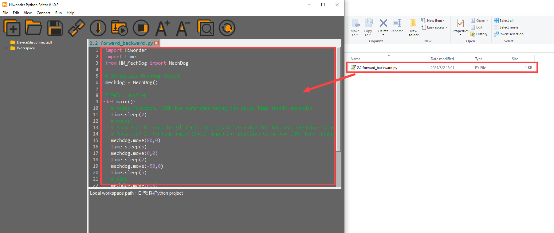

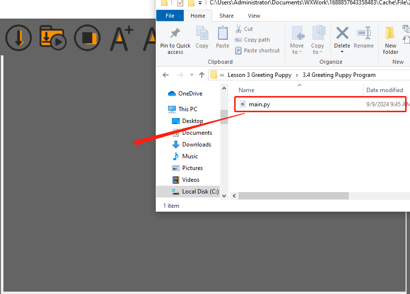

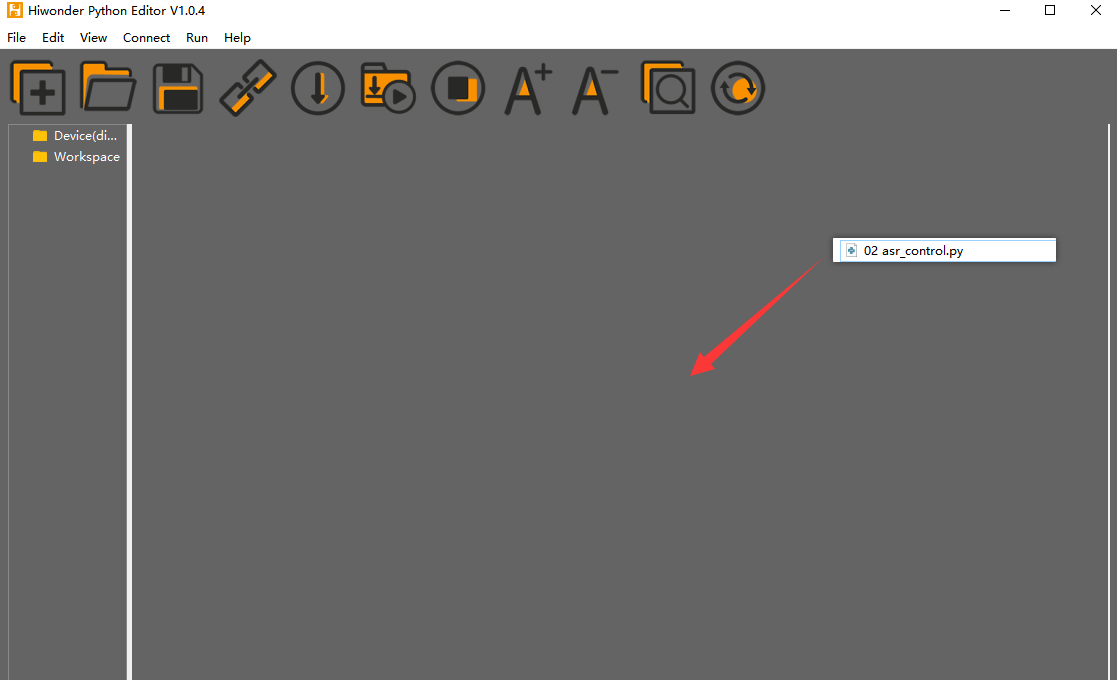

(1) Open the ‘Hiwonder Python Editor’ software
(2) Drag the forward_backward.py file, located in the same directory as this document, into the Hiwonder Python Editor (make sure to drag it into the red box area for it to be effective).
(3) Click the connection button in the menu bar; it will change to a green icon once connected successfully.
(4) After successfully connecting, click the download button in the menu bar to download the program to MechDog. Wait for the information interaction box below to indicate that the download is complete.
(5) Finally, delete the original main.py file of MechDog and rename the downloaded ‘forward_backward.py’ to ‘main.py’.

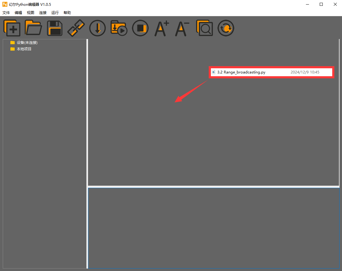

(1) Open the ‘Hiwonder Python Editor’ software .
(2) Drag the wheel.py file, located in the same directory as this document, into the Hiwonder Python Editor (make sure to drag it into the red box area for it to be effective).
(5) Finally, delete the original main.py file of MechDog and rename the downloaded forward_backward.py to main.py.

  • Program Download
change_speed.py
(2) Drag the ‘change_speed.py’ file, located in the same directory as this document, into the Hiwonder Python Editor (make sure to drag it into the red box area for it to be effective).
  • Program Outcome

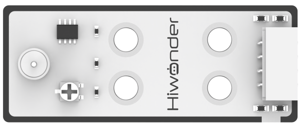

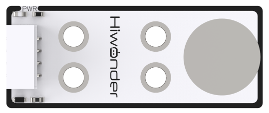

The touch sensor is based on capacitive sensing principles and primarily detects human skin or metal through its gold-plated contact surface.
When no human or metal is touching the metal surface, the signal output is high; when human skin or metal touches the metal surface, the signal output is low.

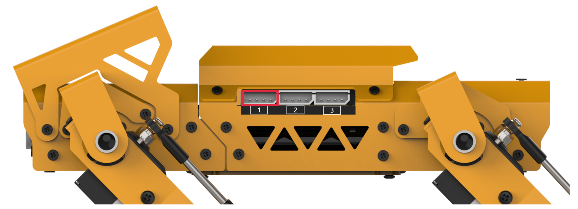

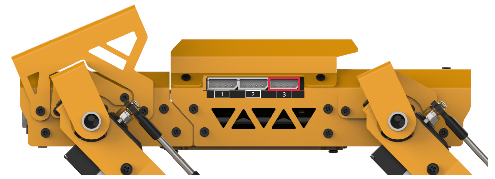

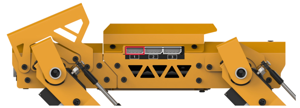

Wiring Information: Connect the touch sensor to interface 3 of MechDog (IO32, IO33).

Touch.py
(2) Drag the ‘Touch.py’ file, located in the same directory as this document, into the Hiwonder Python Editor (make sure to drag it into the red box area for it to be effective).
(5) Finally, delete the original ‘main.py’ file of MechDog and rename the downloaded ‘Touch.py’ to ‘main.py’.

The light sensor is used to detect external light intensity, converting light signals into electrical signals. It is commonly used in interactive projects that create special effects based on light intensity changes, such as automatic street lighting control systems and environmental monitoring systems.
When light hits the photoresistor, the stronger the light, the lower the resistance. Consequently, the VCC voltage through the resistor increases, causing the LED on the light sensor to light up. Conversely, the LED will turn off when the light intensity decreases.
Wiring Information: Connect the light sensor to interface 3 of MechDog (IO32, IO33).

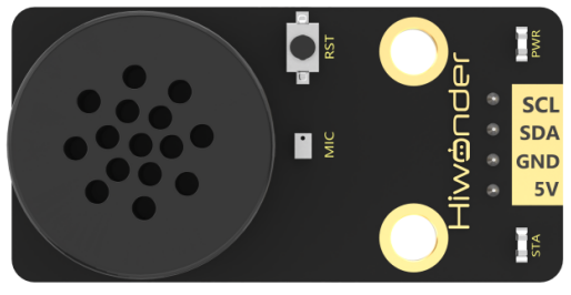

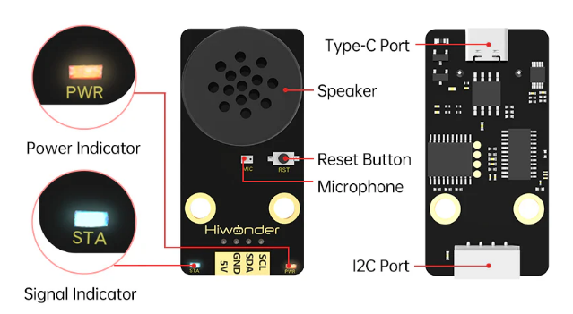

In this section, the MP3 module is used to play music while simultaneously controlling the MechDog to perform a dance routine.
  • Implementation Process

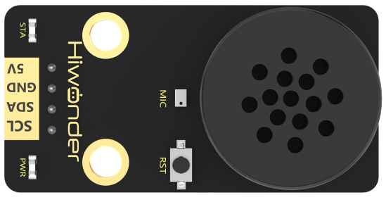

  • Module Description

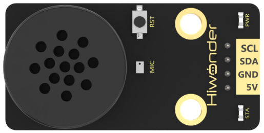

The MP3 module is a user-friendly audio playback component capable of playing music with simple command inputs. It features a 4-pin interface and supports hardware decoding of MP3, WAV, and WMA formats. Additionally, it supports TF memory cards and is compatible with FAT16 and FAT32 file systems.
The module communicates via the I²C protocol and utilizes a digital signal processor (DSP) to manage data transmission and decode audio files. Once decoded, the output is the music we hear during playback.

  • Program Download
MP3_dance.py
(2) Drag the ‘MP3_dance.py’ file, located in the same directory as this document, into the Hiwonder Python Editor (make sure to drag it into the red box area for it to be effective).
(5) Finally, delete the original ‘main.py’ file of MechDog and rename the downloaded ‘MP3_dance.py’ to ‘main.py’.
  • Program Outcome
MechDog will dance in rhythm with the music.

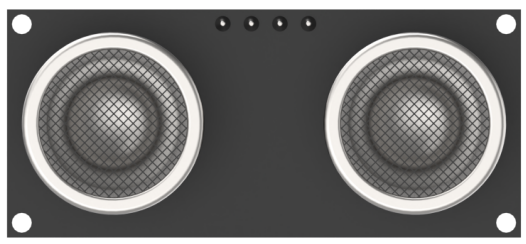

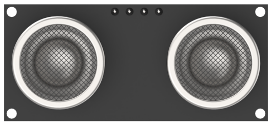

(1) Ultrasonic Module
This module uses an IIC communication interface to read distances measured by the ultrasonic sensor via IIC communication. It features two RGB lights integrated into the ultrasonic probe, allowing for brightness adjustment and multi-color effects through variations and mixing of the red (R), green (G), and blue (B) color channels.
During distance measurement, the module sends out eight 40 kHz square waves and then detects if any signal returns. If a signal returns, it outputs a high level, and the duration of this high level indicates the time it takes for the ultrasonic wave to travel from emission to return.
The ultrasonic module comes with an onboard IIC interface already connected, so no additional wiring is needed by the user.

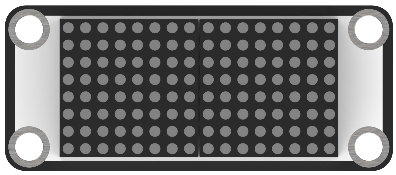

(2) Dot Matrix Module
The LED dot matrix module is an LED display module known for its high brightness, flicker-free display, and easy wiring. It can display numbers, text, patterns, and more.
The module consists of two 8x8 red LED matrices controlled by the TM640B driver chip, which manages the dot matrix display.
Wiring Information: Connect the dot matrix module to interface 3 of MechDog (IO32, IO33).

(4) In the Main Program: Read the distance detected by the glowing ultrasonic module and display it on the dot matrix screen.
# Main function
def main():
  global distance
    distance = i2csonar.getDistance()
    tm.showNum(distance)
(5) Distance Evaluation: If the detected distance is less than 15 cm, set the RGB light of the glowing ultrasonic module to red.
    if (distance<15):
      # Glowy ultrasonic color setting function
      # Parameter 1: Set light, 0 to set both lights, 1 to set light 1, 2 to set light 2;
      # Parameters 2, 3, 4: Correspond to red, green, and blue color values
      i2csonar.setRGB(0,0xff,0x00,0x00) # Set to red
(6) If Distance is Greater Than 40 cm: Set the RGB light of the glowing ultrasonic module to blue.
      if (distance>40):
        i2csonar.setRGB(0,0x00,0x00,0x99) # Set to blue
(7) For Distances Between 15 cm and 40 cm: Set the RGB light of the glowing ultrasonic module to yellow.
        i2csonar.setRGB(0,0xfd,0xd0,0x00) # Set to yellow
    time.sleep(0.1)

4.3.6 Ultrasonic Alarm
  • Project Introduction
In this section, the ultrasonic module detects objects and, based on the distance, controls the RGB light of the ultrasonic module to display different colors. Additionally, the onboard buzzer will sound to provide an alert.
  • Program Logic
  • Module Introduction
(2) Drag the ‘ultrasonic_alarm.py’ file, located in the same directory as this document, into the Hiwonder Python Editor (make sure to drag it into the red box area for it to be effective).
(5) Finally, delete the original ‘main.py’ file of MechDog and rename the downloaded ‘ultrasonic_ranging.py’ to ‘main.py’.

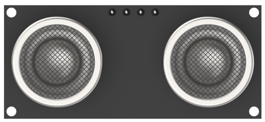

As obstacles move closer to the ultrasonic module, you’ll see the RGB light on the module change color based on the distance. If the distance is ≤ 50 cm, the buzzer will sound an alert.
  • Function Extension
Users can adjust the ultrasonic detection distance to control the buzzer alarm.
(1) Locate the instruction shown in the figure below. The distance variable represents the distance measured by the ultrasonic sensor.
    # Get distance measured by glowing ultrasonic
(2) Drag the ‘homeostasis.py’ file, located in the same directory as this document, into the Hiwonder Python Editor (make sure to drag it into the red box area for it to be effective).

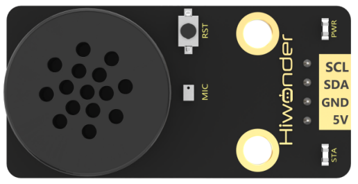

4.4.1 Introduction to Voice Interaction Module
  • Introduction and Working Principle
(1) Introduction
The WonderEcho is an integrated voice interaction module powered by the CI1302 chip, designed for high-accuracy voice recognition and playback. It supports offline neural network (NN) acceleration and hardware-accelerated voice signal processing, utilizing advanced noise reduction and deep learning models for precise recognition.
The CI1302 chip features a Brain Neural Processing Unit (BNPU), enabling real-time, offline NN acceleration and efficient voice signal processing. With a CPU clock speed of up to 220MHz, it supports far-field voice recognition without an internet connection. The module also includes 2MB of built-in FLASH storage, accommodating up to 300 command words.
With its user-friendly design and exceptional voice recognition capabilities, the WonderEcho module is ideal for a wide range of applications, including smart home automation, conversational AI robots, educational robotics, and in-vehicle dispatch systems.
(2) Working Principle
The module operates using a wake word activation system, requiring users to say a predefined wake word to activate voice interaction. Once activated, the module can process and recognize voice commands. The default wake word is “Hello Hiwonder”. If no voice input is detected within 15 seconds, the module will enter sleep mode and must be reactivated for further use.
Upon recognizing a registered voice command, the CI1302 chip transmits the corresponding instruction to the IIC chip and provides audio feedback. The IIC chip stores the received command and transmits it via the IIC slave protocol. A complete list of supported voice commands and response protocols can be found in the Command Word Broadcasting Protocol List in the same directory as this document.
  • Interface Description
(1) Please use a 5V power supply; using a higher voltage may damage the module.
(2) The operating environment should be quiet, as excessive noise may interfere with recognition accuracy.
(3) When speaking the command words, ensure your voice is clear and not too fast. It is recommended to stay within 5 meters of the module.
No. Component Description
1 Speaker Converts analog signals into sound output
2 Microphone Captures sound and converts it into analog signals
3 Reset Button (RST) Resets the module when pressed
4 Signal Indicator (Blue LED) Remains on and blinks once when a keyword is recognized
5 Power Indicator (Red LED) Stays on when the module is powered correctly
6 I2C Interface Functions as an I2C slave for power supply and communication with the host device
7 Type-C Interface Used for power supply and firmware updates for the CI1302 chip
8 CI1302 Chip High-performance voice recognition chip that processes speech and outputs control signals
9 I2C Chip Converts voice recognition commands into I2C protocol instructions
10 Amplifier Chip Converts digital signals into analog signals to drive the speaker
Command Word Broadcasting Protocol List.xlsx

Module Connection: Connect the voice interaction module to I2C Port 1 on the MechDog.

  • Program Download
Range_broadcasting.py
(1) Open the Hiwonder Python Editor.
(2) Import the Script – Drag the Range_broadcasting.py file (located in the same directory as this document) into the red-bordered area of the Hiwonder Python Editor.
(3) Connect to MechDog – Click the Connect button in the menu bar. Once connected, the icon will turn green .
(4) Download the Program – Click the Download button in the menu bar to transfer the program to MechDog. Wait for the confirmation message in the interaction panel indicating the download is complete.
(5) Set the Main Script – Delete MechDog’s existing main.py file, then rename Range_broadcasting.py to main.py.

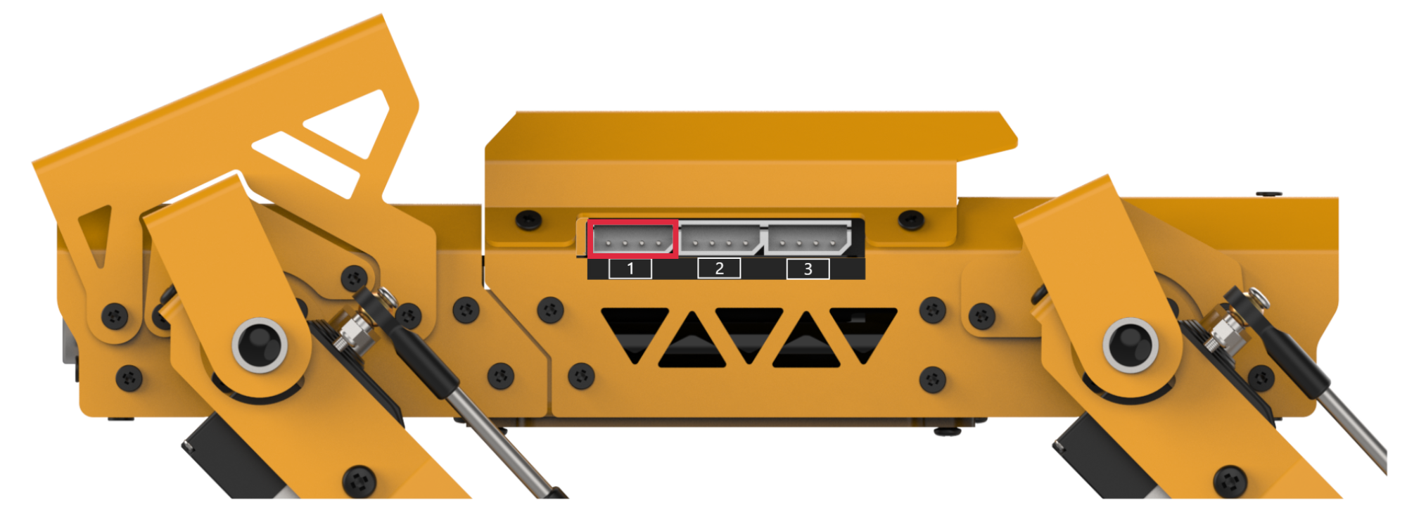

(2) Import the Script – Drag the Communicate.py file (located in the same directory as this document) into the red-bordered area of the Hiwonder Python Editor.
The WonderEcho voice interaction module is based on the CI1302 chip, enabling voice recognition and broadcasting. It supports offline neural network acceleration and hardware-accelerated voice signal processing. Through advanced deep noise reduction and neural network analysis, the module delivers accurate recognition results.
  • Example Program
asr_control.py
(1) Load the necessary libraries: the Hiwonder library, which includes sensor libraries and low-voltage alarm functionalities; the time library, which handles time-related functions; and the HW_MechDog library, which is used to control MechDog’s movements.
2
import Hiwonder
import time
import Hiwonder_IIC
from HW_MechDog import MechDog
(2) Initialize the MechDog control object and set the interface of the voice interaction module to IIC2. Then, configure MechDog’s posture to ensure it is standing on all four legs.
# 初始化MechDog对象(Initialize the MechDog object)
mechdog = MechDog()
# 创建IIC2对象(Create an I2C2 object)
i2c2 = Hiwonder_IIC.IIC(2)
# 创建语音识别模块对象(Create a voice recognition module object)
asr = Hiwonder_IIC.asr_module(i2c2)
# 设置MechDog初始姿态(Set MechDog to its default posture)
mechdog.set_default_pose()

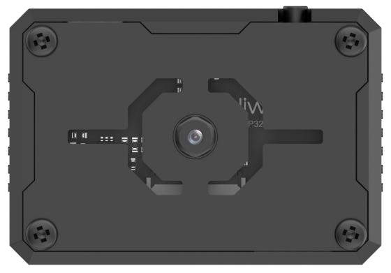

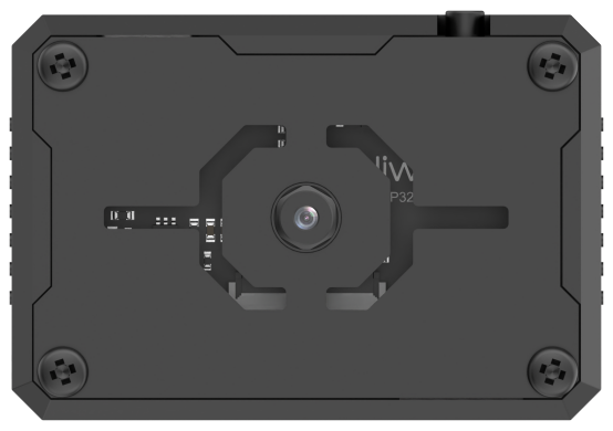

4.5.1 ESP32-S3 Vision Module Introduction & Installation
  • Module Introduction & Working Principle

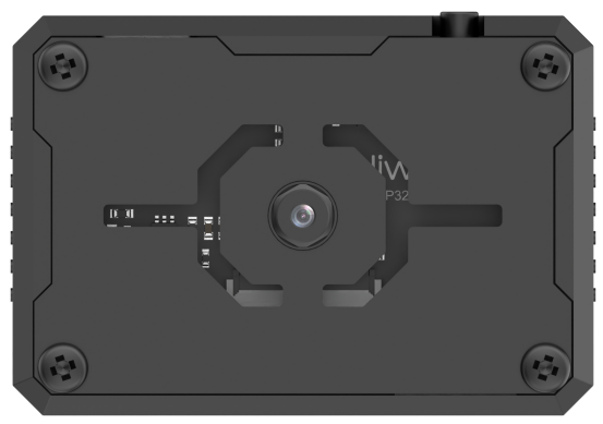

The ESP32-S3 Vision Module is a compact camera module that can function as a standalone system. It captures images using its built-in camera module, processes the image data with the ESP32 microcontroller, and transmits data wirelessly via its Wi-Fi module. Supporting multiple communication protocols and low power consumption, it is widely used in various IoT applications.
  • Port Description
Port Name Interface Description
USB Serial Port Serial communication and firmware programming
Custom Button Customizable button event in the code
IIC Interface Secondary development interface for connecting with the main controller
  • Notice
(1) Please ensure that the module is supplied with a power input of at least 5V 2A; otherwise, there may be a chance of image distortion.
(2) The module comes with default firmware pre-installed, which supports image transmission. To enable visual recognition features, you will need to flash the corresponding firmware.
(1) ESP32-S3 Vision Module
It captures images using its built-in camera, processes the data with the ESP32 microcontroller, and transmits the information wirelessly via the Wi-Fi module. Supporting multiple communication protocols and low power consumption, it is widely used in various IoT applications.

Use a 4-pin cable to connect the vision module to the IIC interface 1 on MechDog.
(2) Ultrasonic Sensor
The module uses an IIC communication interface, allowing it to read distances measured by the ultrasonic sensor via IIC communication. It also integrates two RGB lights in the ultrasonic probe, which can adjust brightness and produce a wide range of colors by varying and combining the red (R), green (G), and blue (B) color channels.
During distance measurement, the module automatically sends out eight 40 kHz square waves and then checks for signal return. If a signal is received, it outputs a high level, and the duration of this high level indicates the time taken for the ultrasonic wave to travel from emission to return.
The ultrasonic module comes with an onboard IIC interface already connected, so no additional wiring is required by the user.

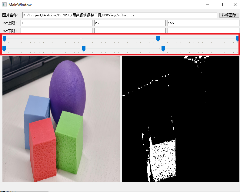

(3) Call the cam.color_recognition() method to return the result of color recognition and print it in the terminal.
  color_list = cam.color_recognition()
  print(color_list)
  if cam.RED in color_list: # red
    i2csonar.setRGB(0 , 250 , 0 , 0)
  time.sleep(0.01)
  if cam.GREEN in color_list: # green
    i2csonar.setRGB(0 , 0 , 250 , 0)
  time.sleep(0.1)
  if cam.BLUE in color_list: # blue
    i2csonar.setRGB(0 , 0 , 0 , 250)
  time.sleep(0.01)

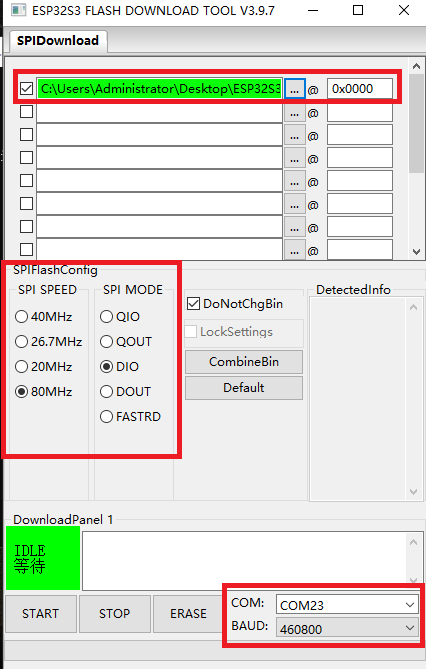

(1) ESP32-S3 Firmware Flashing
ESP32-S3 Color Recognition

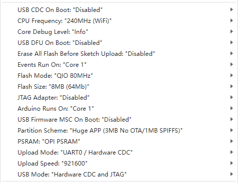

① Connect the ESP32-S3 to your computer using a Type-C data cable.
② Open Firmware & Flashing Tools/ColorDetection.ino located in the same directory.

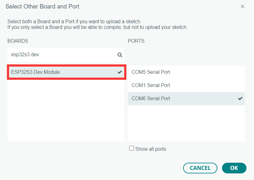

③ Select the “ESP32S3 Dev Module” development board.
④ Click on the “Tools” in the menu bar, and select the corresponding ESP32S3 development board configuration as shown in the figure below (configuration is required for the first use, and no further configuration is needed for subsequent uses).
⑤ Click to upload the code to the ESP32-S3, and wait for the flashing process to complete.

① Open the ‘Hiwonder Python Editor’ software .
② Drag the ‘main.py’ file, located in the same directory as this document, into the Hiwonder Python Editor (make sure to drag it into the red box area for it to be effective).
③ Click the connection button in the menu bar; it will change to a green icon once connected successfully.
④ After successfully connecting, click the download button in the menu bar to download the program to MechDog. Wait for the information interaction box below to indicate that the download is complete.
② Open ESP32-S3 Color Recognition->ColorDetection.ino located in the same directory.

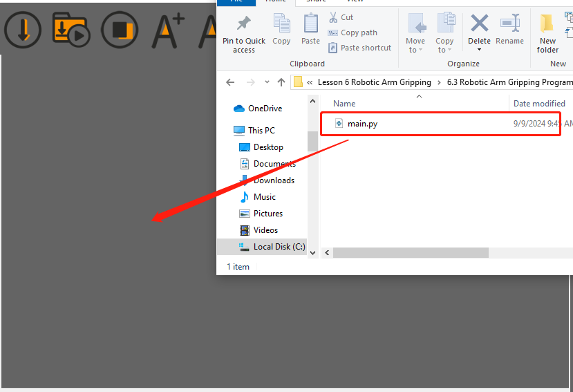

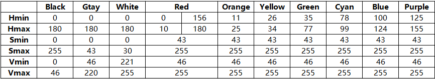

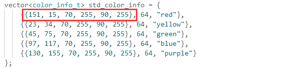

Here, we will explain how to modify the colors recognized by the ESP32-S3. For specific modifications, please refer to the following steps:
(1) First, open the “HSV.exe” file located at Color Threshold Adjustment Tool->HSV->HSV.dist->HSV.exe
(2) Click on “Select Image” to choose the image file you wish to import (the image to be imported must be stored within the img folder).
(3) Drag the sliders to perform HSV threshold segmentation on the image. Adjust to the appropriate HSV threshold range, and you may refer to the color range table below for guidance.
(4) Then save the HSV threshold values. Open the file “color_detection.cpp” in the same directory as this document, and modify the color data to match the saved HSV array. The six elements of the color data, from left to right, are: H lower limit, H upper limit, S lower limit, S upper limit, V lower limit, and V upper limit. Finally, refer to “1. Color Recognition Program Download” to upload the modified program to the ESP32S3-Cam.
(5) After the firmware is uploaded, the ESP camera will be able to recognize objects of other colors.

This section demonstrates how MechDog uses the ESP32-S3 vision module to recognize lines and perform line-following.
MechDog has a large turning radius, so it’s best to make the line turns as wide as possible. In other words, keep the lines as straight as possible.
  • Program Logic
Module Wiring:
② Open ESP32-S3 Vision Line Following->LineTracking.ino located in the same directory.

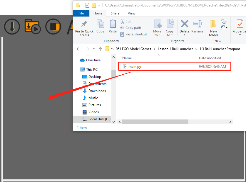

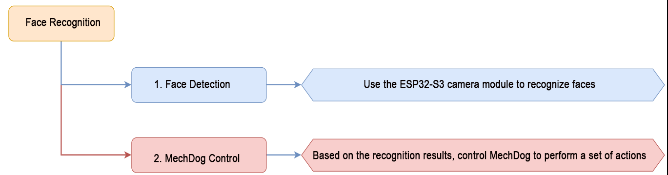

After the ESP32-S3 vision module recognizes a human face, make the robot dog perform a bowing action.
  • Program Logic

Module Wiring:

  • Program Download
(2) Drag the ‘main.py’ file, located in the same directory as this document, into the Hiwonder Python Editor (make sure to drag it into the red box area for it to be effective).

Once MechDog sits down, it utilizes its vision module to detect faces in the area ahead. Upon detecting a face, the servo activates the tail to wag.
  • Program Flowchart
Module Wiring: Use a 4-pin cable to connect the vision module to the I2C interface 1 on MechDog.
① Connect the ESP32-S3 to your computer with a Type-C cable.
② Double-click and open the flash_download_tool_3.9.7.exe file.
③ Configure the settings in the opened interface according to the diagram below.
④ In the flashing interface, first select the firmware by clicking and locate “Face Recognition Firmware & Flashing Tool/face_detection.bin”. Then configure the settings as shown in the diagram below.
⑤ Select the port number (choose according to your actual port number, and avoid selecting COM1 as it may cause flashing to fail).
⑥ Click “ERASE” to erase the existing firmware (this step is crucial), and then click “START” to begin the flashing process.
⑦ Wait for a moment until you see a completion prompt.
⑧ Once the flashing is completed, disconnect the Type-C cable.
(2) Python Program Download

(2) Initialize the MechDog object. Create an I2C1 object and an ultrasonic object for I2C communication with the ultrasonic module. Then, the distance variable used to store the distance is initialized.
# Initialize MechDog object
mechdog = MechDog()
# Create I2C1 object
i2c1 = Hiwonder_IIC.IIC(1)
# Create glowy ultrasonic sensor object
i2csonar = Hiwonder_IIC.I2CSonar(i2c1)

(2) Initialize the MechDog object. Create an I2C1 object and an ultrasonic object for I2C communication with the ultrasonic module. Then, the dot matrix is created to display the distance.
(3) The distance variable used to store the distance is initialized, as well as the position variable used to store the position of the LEGO servo. Set the brightness of the dot matrix module to 4, and the initial posture of MechDog to stand on four legs.

    # Obtain the distance detected by the ultrasonic sensor
(4) Determine the detected distance. If the distance is less than 10cm, set the RGB LEDs of the ultrasonic sensor to red and control the robotic arm to grip the object.
    if (distance<10):
      # Function for setting the color of the ultrasonic sensor
      # Parameter 1: the number of the set light; 0: set 2 lights; 1: set 1 light; 2: set 2 lights
      # Parameters 2 to 4 corresponds the values of red, green, and blue respectively
      i2csonar.setRGB(0,255,0,0) # set to red

  • Program Download
