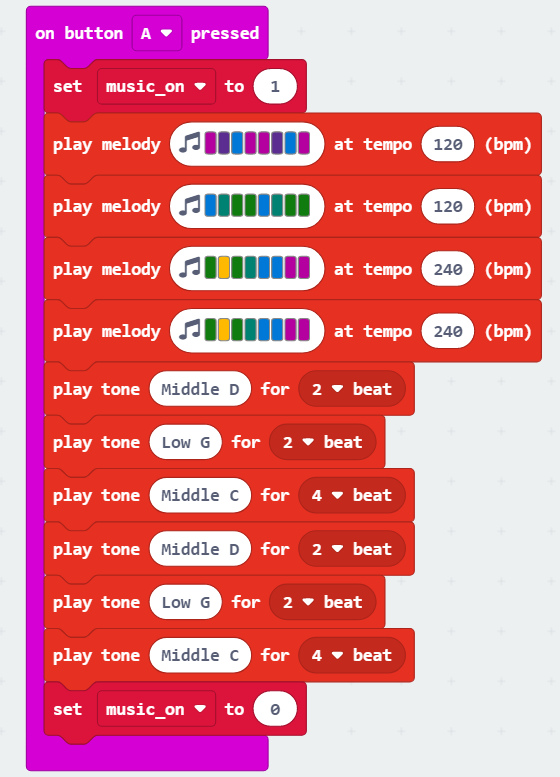

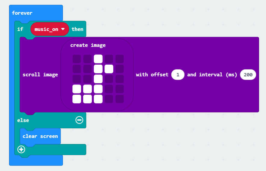

4.4 Play music
4.4.1 Getting Ready
(1) The position where the buzzer is located on the micro:bit.
(2) The positions where the buttons are located on the micro:bit.
4.4.2 Learning Objective
Make the buttons on the micro:bi to enable the music playing through programming.
4.4.3 Project Logic
The micro:bit V2.0 has a built-in buzzer, which can be programmed to output sound.
In this lesson, different melodies can be set and triggered by pressing buttons A and B. This will achieve the effect of playing music.
4.4.4 Program Writing
Coding block combination
4.4.5 Connect Device and Download Program
(1) Connect the micro:bit to the computer’s serial port with the USB cable.
(2) Click “…” button next to “Download” and select “Connect Device”.
(3) Then click “Pair” in the pop-up interface.
(4) Click “Connect”.
(5) After the device is connected successfully, click “Download”. The yellow indicator on the micro:bit near USB port will blink fast. At this time, do not disconnect or move USB cable to avoid failure download.
(6) After the download is completed, the indicator will stop blinking and keep lighting up. The interface will prompt “Download completed”.
There should only be two files in the micro:bit drive from beginning to end, as shown in the figure. The DETAILS.TXT file is used to record some parameters of the micro:bit and generally does not need to be concerned. The MICROBIT.HTM file is the official website page of the micro:bit. Clicking on this file requires the computer to be connected to the Internet.
4.4.6 Project Outcome
After the program is downloaded, pressing button A will play the melody of the song “Two Tigers”, while pressing button B will play the melody of the song “Twinkle Twinkle Little Star”.

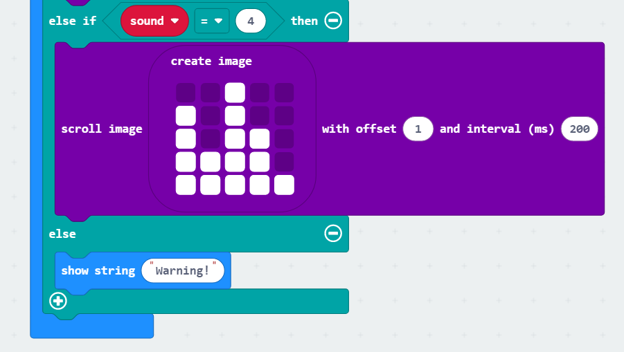

4.5 Noise Detector
4.5.1 Getting Ready
(1) The position of the speaker on the micro:bit.
(2) The position of the microphone on the micro:bit.
4.5.2 Learning Objective
(1) Learn about the microphone on the micro:bit and the relevant coding blocks.
(2) Implement sound detection and feedback through programming.
4.5.3 Project Logic
On the micro:bit V2.0, a microphone has been added to provide sound input. When the microphone is activated, a red LED on the board will light up.
The environmental information, such as the ambient sound level, light intensity, and magnetic field strength, received by the micro:bit cannot be directly perceived or judged. However, specific values can be obtained through serial port printing.
For easier operation, let’s redirect the serial port to the USB port in this lesson. Then, you can create a variable to represent the sound intensity and map the sound value range to the intensity value to display different images. When the sound level meets the set level, a sound alarm will be triggered.
4.5.4 Program Writing
Coding block learning
| Coding block | Class | Function |
Indicate that the serial input and output use USB connection. |
Write the value and the newline character to the serial port. | |
Omit the last several digits of the original value. |
4.5.5 Connect Device and Download Program
4.5.6 Project Outcome
After the program is downloaded, you can speak to the microphone on the micro:bit. The LED dot matrix will display different high and low matrices to reflect the sound intensity, based on the detected sound level.

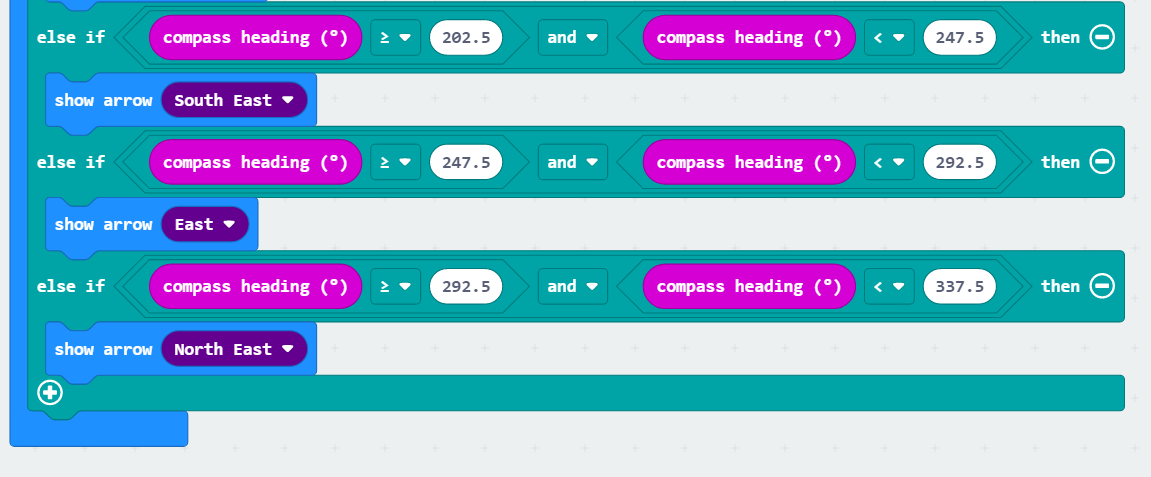

4.7 Compass
4.7.1 Getting Ready
The position of the electronic compass on the micro:bit.
4.7.2 Learning Objective
① Learn about the electronic compass on the micro:bit.
② Program micro:bit to detect direction and print the arrow.
4.7.3 Project Logic
There is an electronic compass on the micro:bit. It can measure the magnetic field strength in multiple directions, which can be realized through programming.
4.7.4 Program Writing
Indicate the use of USB connection for serial input and output. |
Write the value and line feed to the serial port. | |
4.7.5 Connect Device and Download Program
4.7.6 Project Outcome
After the program is downloaded, the prompt “TILT TO FILL SCREEN” will be displayed by scrolling on the micro:bit. Then, you need to calibrate it. Hold the micro:bit and move it in different directions until all the LEDs of the dot matrix are lit up.
After calibration, hold the micro:bit to move it again, and the dot matrix will display the corresponding directional arrow.
