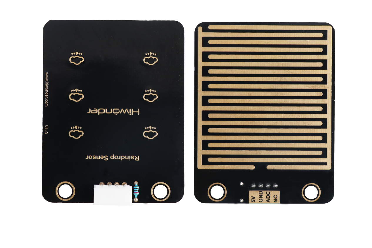

Hiwonder raindrop sensor is used for monitoring the amount of rainfall and can covert the monitored result into analogue signal and output . When in use, 5V GND terminal will input 5V voltage and ADC terminal will output voltage from 0 to 5 V. The greater the amount of rainfall, the greater the output voltage of ADC terminal.
It is also used to monitor weather condition. The surface of sensor is processed with immersion gold technology, which can improve the ability to prevent corrosion in the soil and prolong its life.

1.2.2 Port Instruction
| Pin | Pin Instruction |
| 5V | Power Supply |
| GND | GND |
| ADC | ADC terminal outputs the detected amount of rainfall from 0~1023. The greater the amount of rainfall, the greater the value of ADC. |
| NC | Empty |

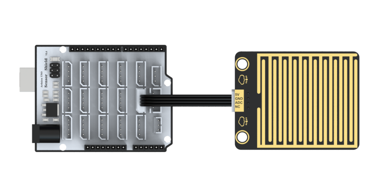

1.3.2 Wiring diagram
Take connecting 4PIN wire to A2 and A3 port on Arduino expansion board as example.
Please note that if not using Arduino expansion board, you need to connect sensor to Arduino demo board through Dupont line as following picture.

Step 2: Connect Arduino expansion board to the controller. Then, connect raindrop sensor to corresponding port on expansion board with 4PIN wire as the picture shown above.

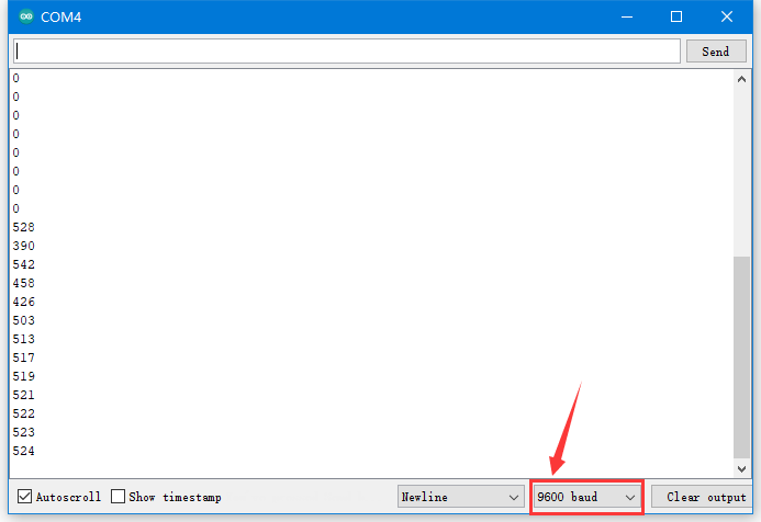

Step 5: After the code is uploaded successfully, please open the serial monitor to set the baud rate as 9600.
1.3.4 Project Outcome
When the sensor detects no raindrop, the serial monitor will display 0. When we sprinkle water on sensing area to simulate rain, the data displayed on the monitor will increase as picture shown below.
