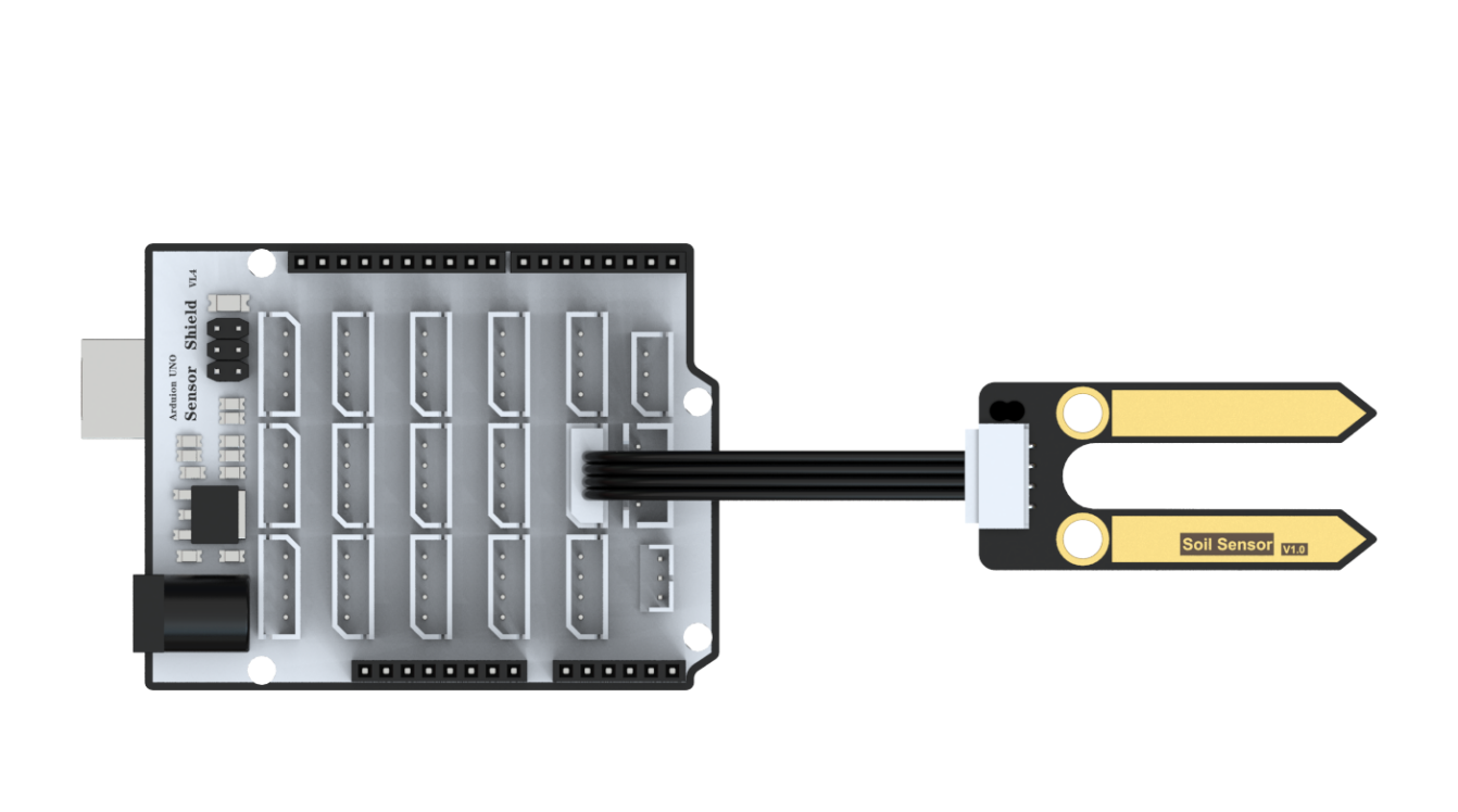

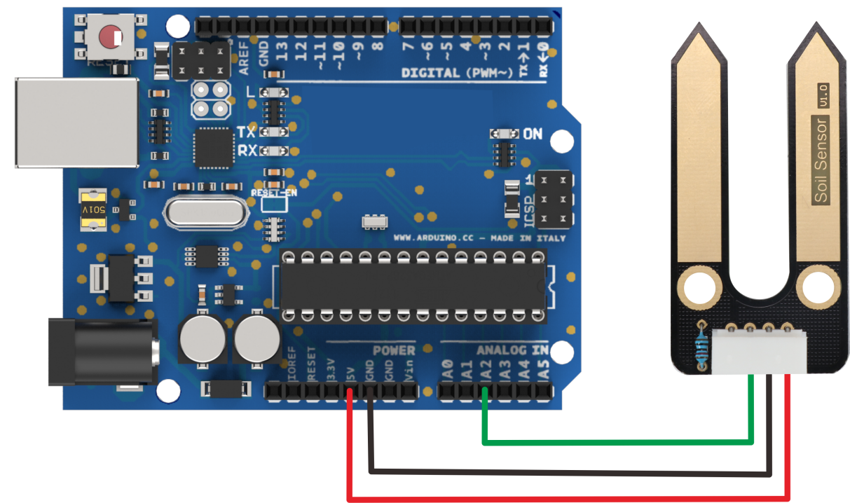

1.3.2 Wiring diagram
Take connecting 4PIN wire to A2 and A3 port on Arduino expansion board as example.
Please note that if not using Arduino expansion board, you need to connect sensor to Arduino demo board through Dupont line as following.

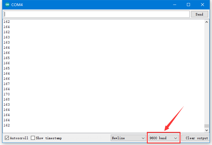

Step 5: After the code is uploaded successfully, please open the serial monitor to set the baud rate as 9600.
1.3.4 Project Outcome
When insert soil sensor into flowerpot, the monitor will display simulated value of current soil moisture as picture shown below.
