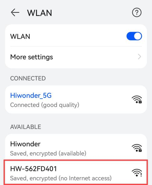

After TurboPi boots up successfully, it enters AP direct connection mode, and generates a WiFi starting with “HW”.

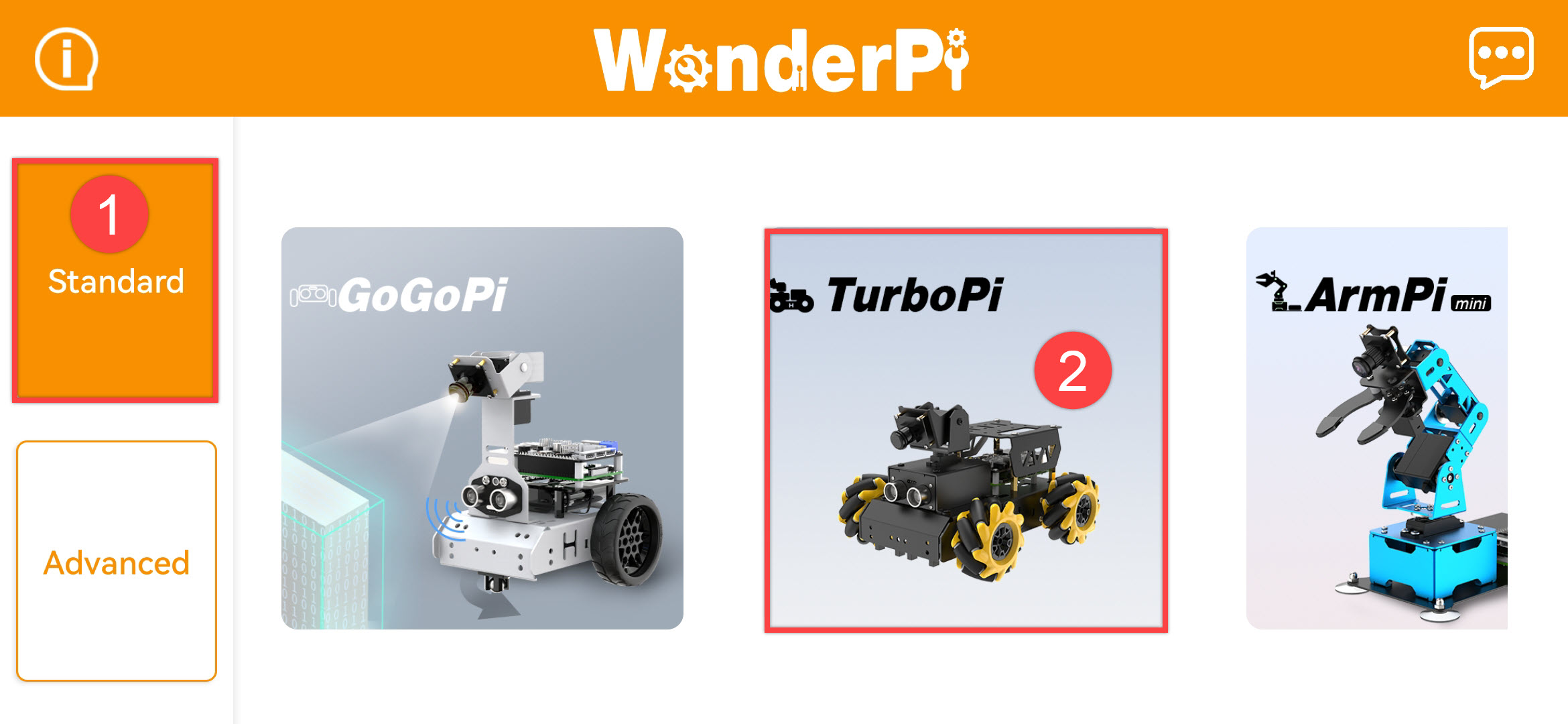

(1) Open “WonderPi”. Select “Standard ->TurboPi” in sequence.

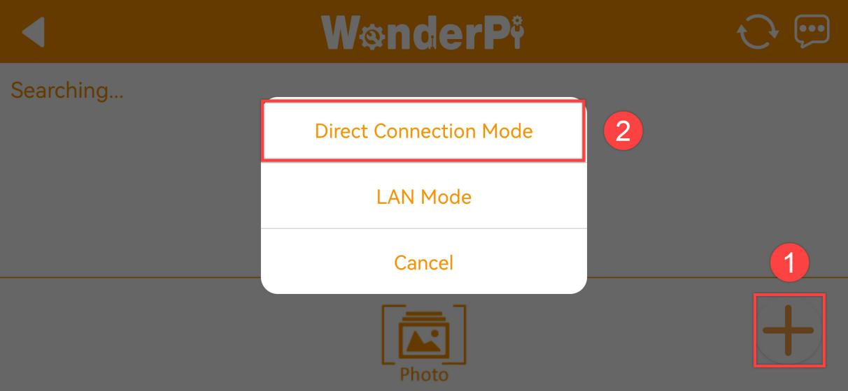

(2) Tap “+” in bottom right corner, and then select Direct Connection Mode.

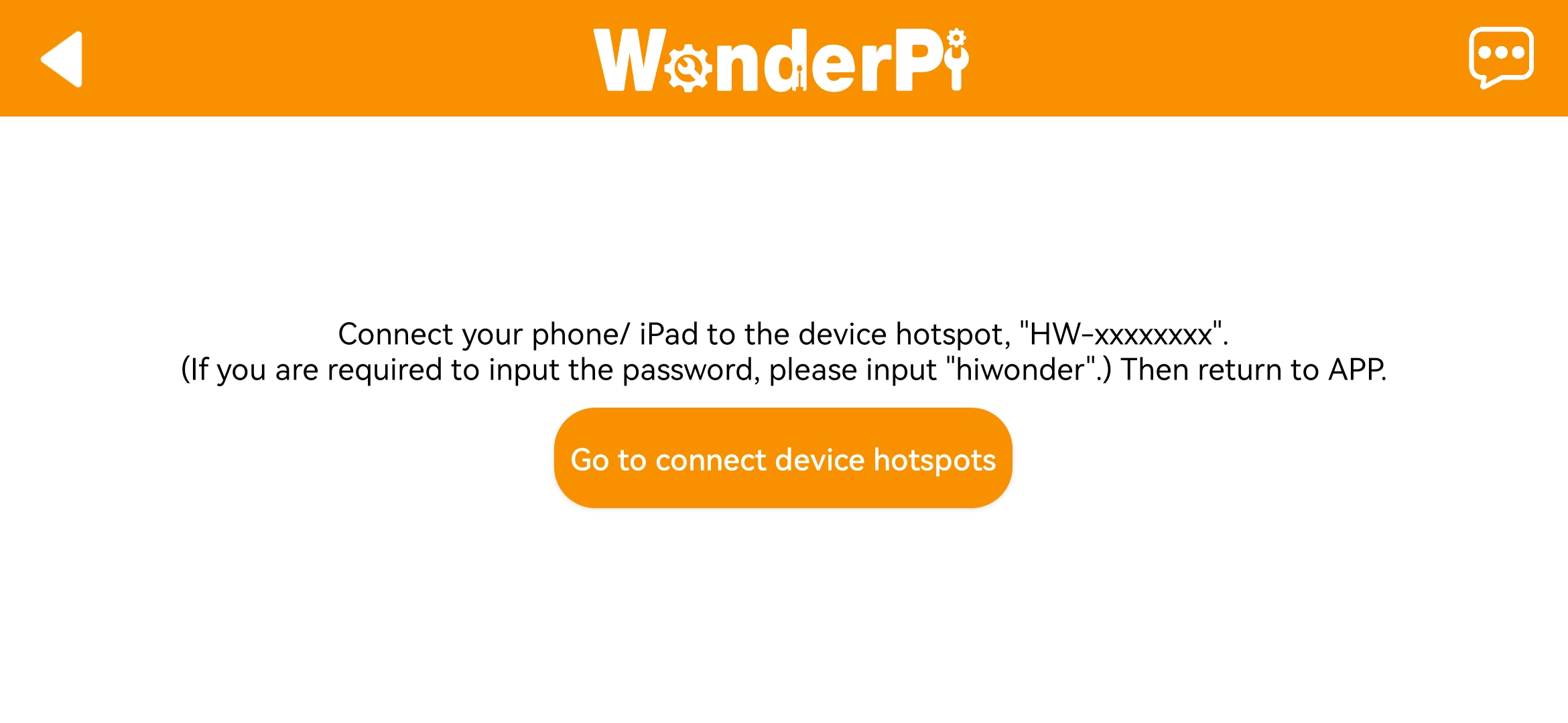

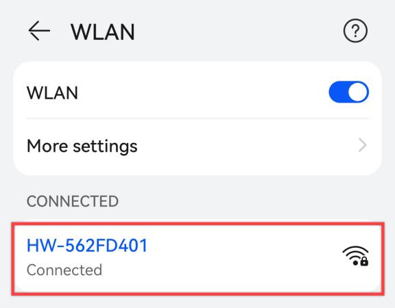

(3) Tap “Go to connect device hotspot”. Join WiFi starting with “HW”. The password is “hiwonder”.
(4) Return back to APP after connection.

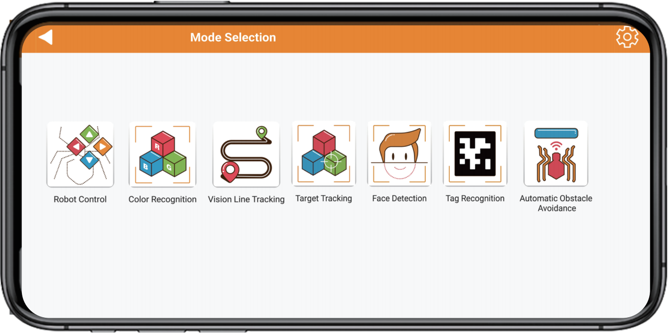

(6) Tap robot icon to enter mode selection interface.
For detailed introduction to robot games, please refer to the file in “2.2 APP Control”.

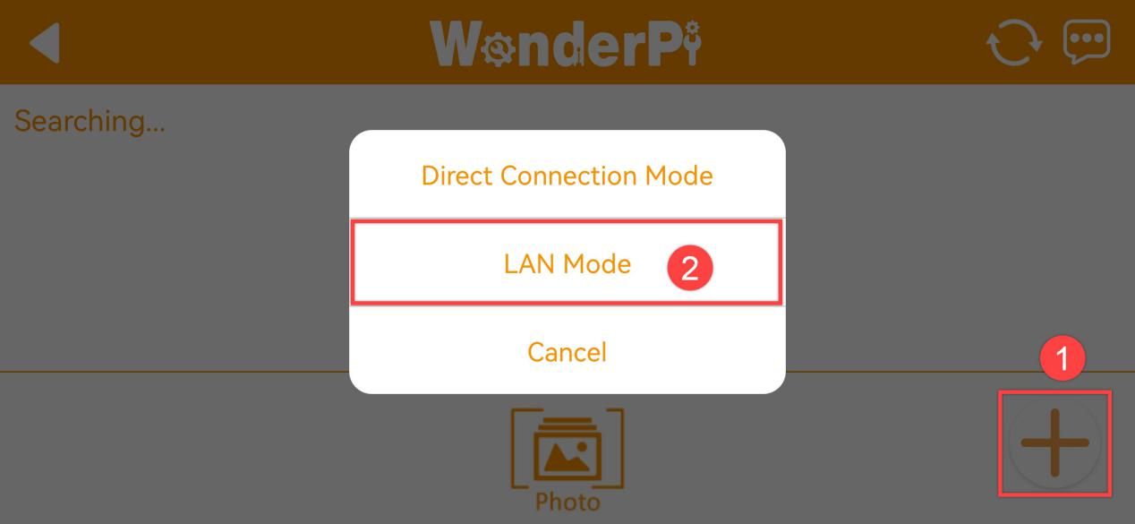

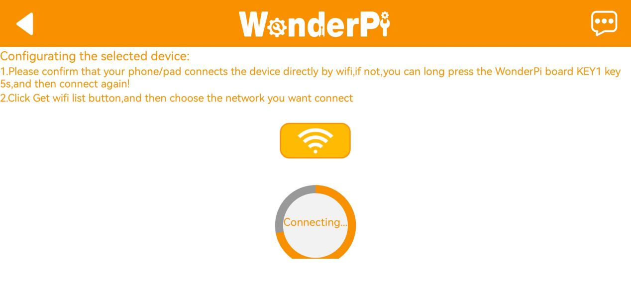

2.2.3 LAN Connection Mode

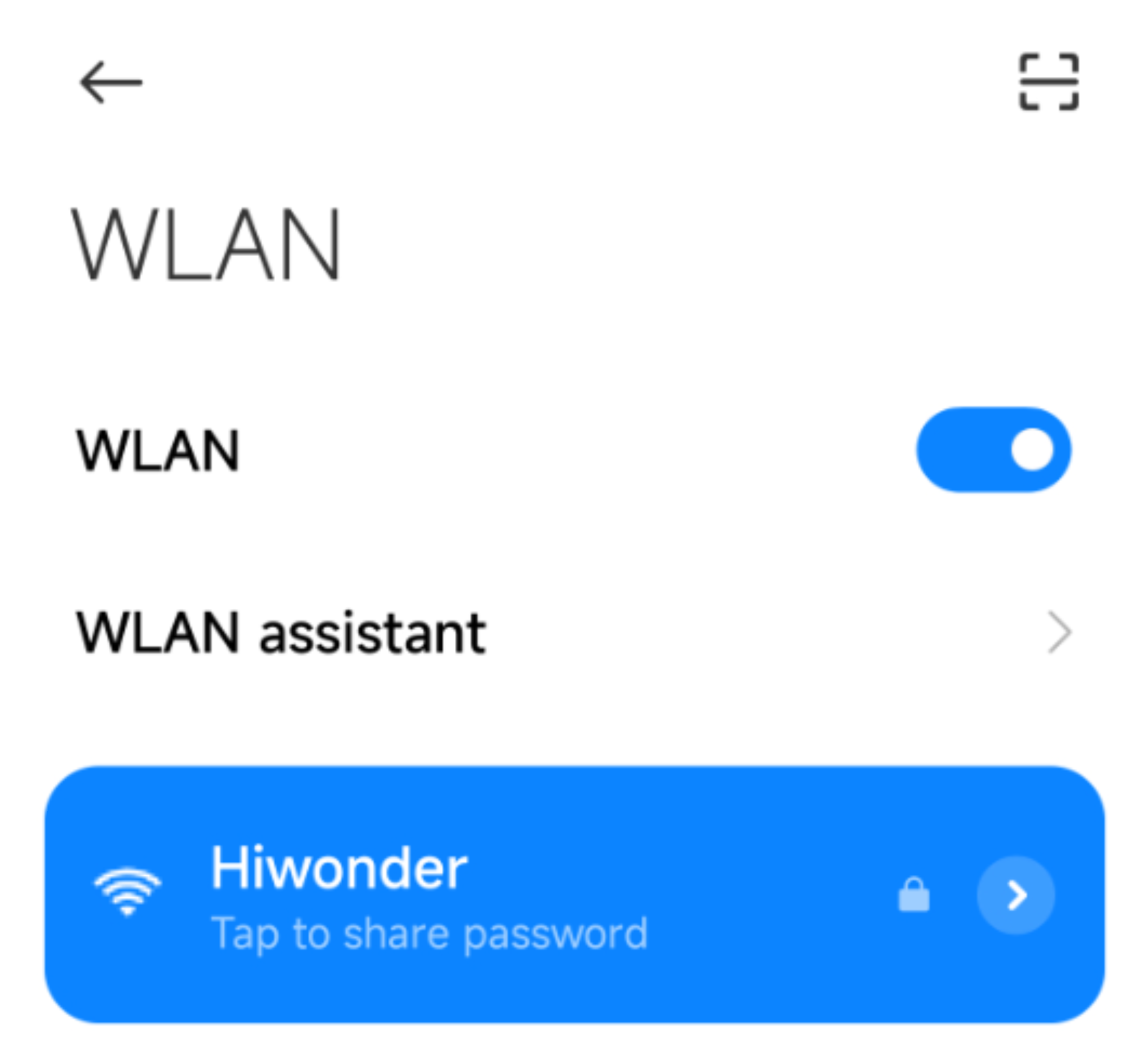

(1) Disconnect the WiFi generated by TurboPi. Connect your phone to a WiFi. Take “Hiwonder” as example.
(2) After connection, open “WonderPi”. Select “Standard ->TurboPi” in sequence.
(3) Tap “+” in bottom right corner, and then select LAN Mode.

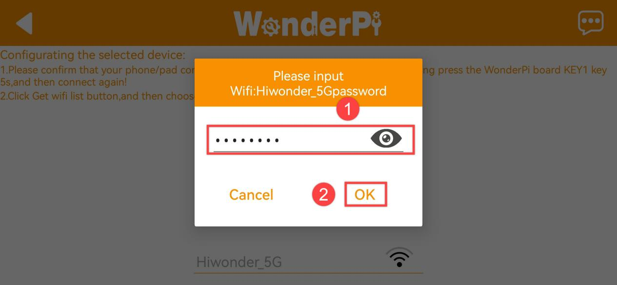

(4) Input the password of the WiFi your phone joins. Ensure the password you input is correct, otherwise APP fails to connect to robot. Tap “OK”.
(5) Tap “Go to connect device hotspot”.
(6) Join the WiFi starting with “HW”. The password is “hiwonder”. After connection, return back to APP.
(7) APP automatically configures network.

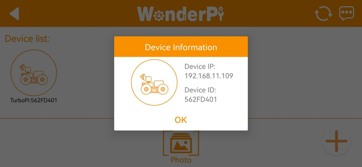

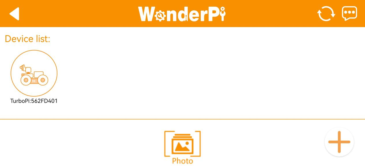

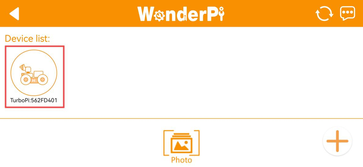

(8) After a while, robot icon below occurs, and LED on expansion board keeps on.
(9) Long press robot icon to check TurboPi’s IP and ID.
(10) Tap robot icon to enter mode selection interface.
For detailed introduction to robot games, please refer to the file in”2.2 APP Control”.

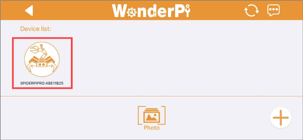

Follow the tutorial in 2.1 APP Installation and Connection to install the app and connect to the SpiderPi Pro.
2.2.2 Start Games

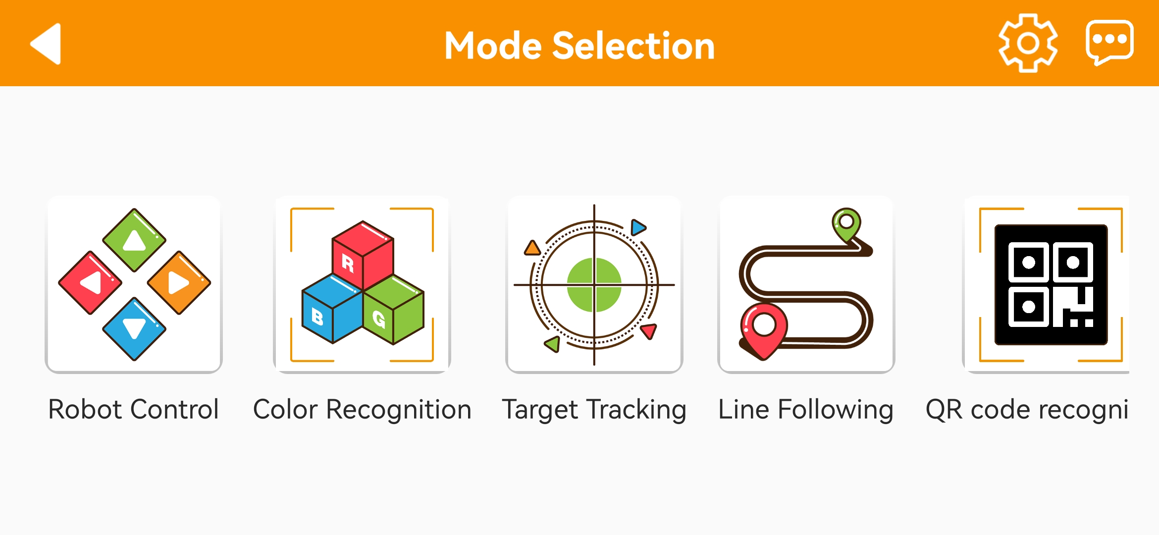

After connecting, click SpiderPi Pro icon to enter the mode selection interface.
loading
In the mode selection interface, click the icon corresponding to the game to enter the game interface.
loading

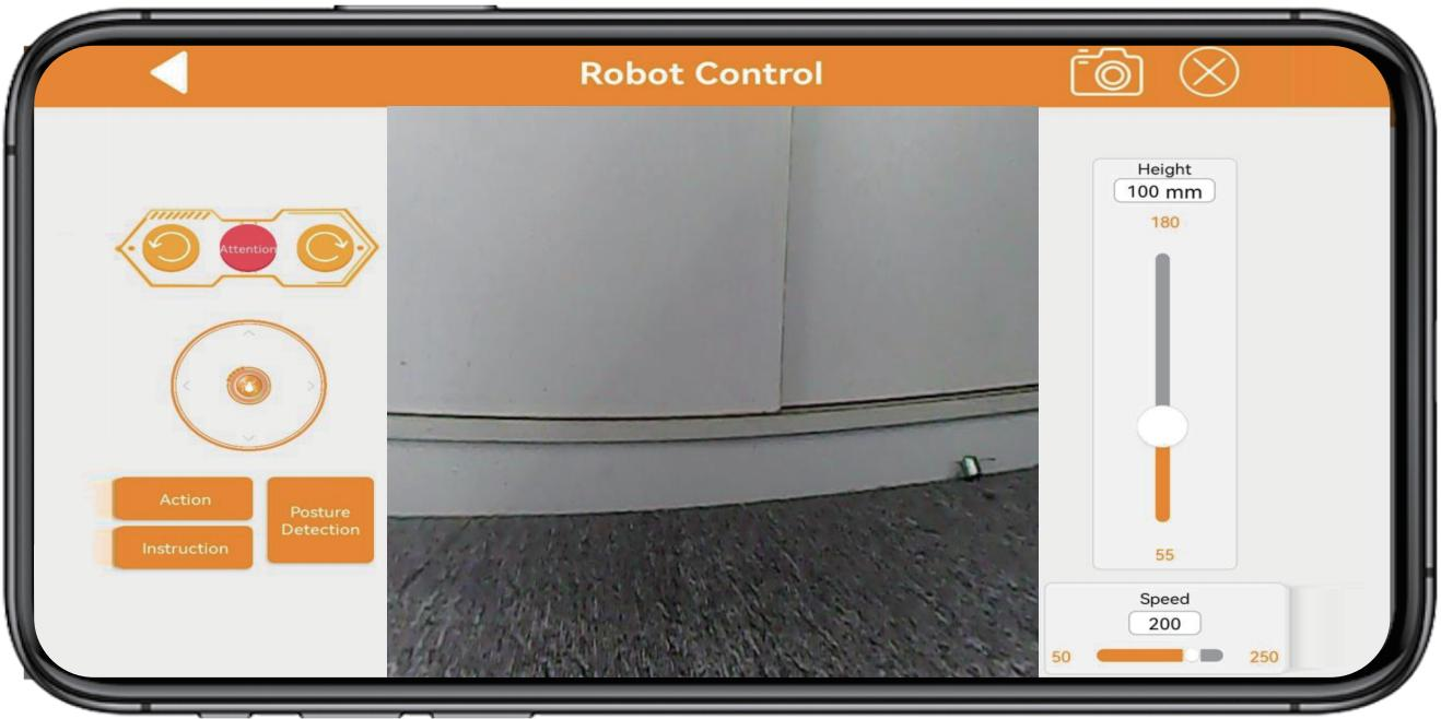

  • Robot Control
This game allows you to control the movement and the action group execution of the robot in real time. The interface consists of four parts, and the descriptions and function icons of each part are shown below:
loading
The interface of Robot Control can be divided into three parts. The left side of the interface can control the movement of the SpiderPi Pro by dragging the slider. Other function icons can refer to the following table:
Icon Corresponding Function
Drag to control SpiderPi Pro's movement.
Clicking on the icons from left to right can control the robot to perform left slide, stand at attention, and right slide, respectively.
Make SpiderPi Pro perform provided built-in actions.
Provide a guide for the remote control of the SpiderPi.
Adjust SpiderPi's movement speed.
Click the icon at the top to bring up the interface for controlling the robotic arm. The movement of the robotic arm can be controlled by adjusting the angle of its 5 servos using the buttons.
loading
If you want to back to the games option interface, you can click the blank area, then the title bar will appear. Next, click at the left side.

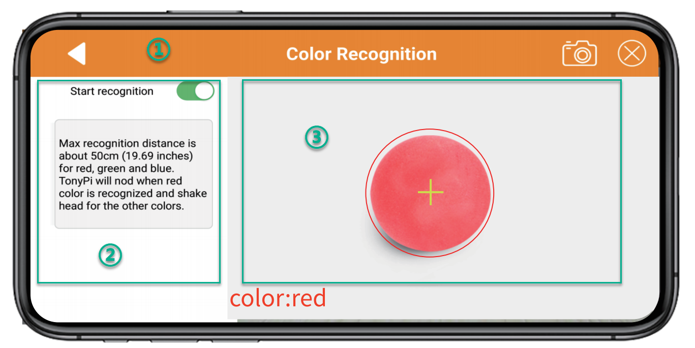

  • Color Recognition
This game can recognize red, green, and blue. SpiderPi Pro will nod when it detects red and shake its head when it detects blue or green.
  • Please start this game under a well-lit environment, but try to keep it from direct light.
  • When recognizing, please do not have the same or similar colored object within the detected range to avoid interference.
  • If the recognition effect is not good enough, please refer to “2.2.3 Adjust Color Threshold”.
(1) Click “Color Recognition” to enter this game. Its interface consists three parts:
loading
① The status bar is located at the top of the interface.
② The left side of the interface is the area for enabling, disabling the game and adjusting the color threshold.
③ The right side of the interface is the area for displaying the live camera feed.
(2) Click the “Start” allows you to place red, blue, and green objects one by one in front of the camera.
Recognized Color Outcome
Red The buzzer emits a "beep" sound, and the camera nods its head.
Green The buzzer emits a "beep" sound, and the camera shakes its head.
Blue The buzzer emits a "beep" sound, and the camera shakes its head.
(3) If want to back to mode selection interface, you can arbitrarily click the blank area in interface, then click .

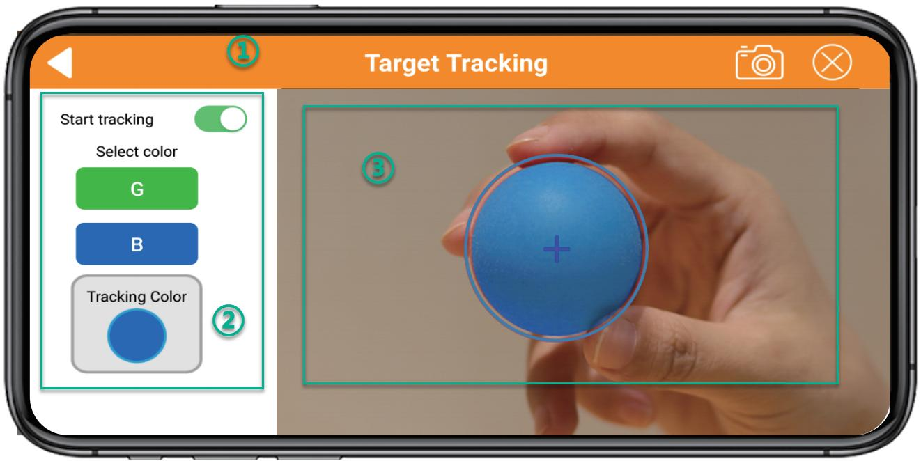

  • Target Tracking
(1) Click “Target Tracking” to enter the game interface. Once activated, this game enables the pan-tilt of SpiderPi Pro to move along with the movement of the target color.
loading
② The tracking switch area is located on the left side of the interface
③ The live camera feed area is located on the right side of the interface.
(2) If want to back to mode selection interface, you can arbitrarily click the blank area in interface, then click .

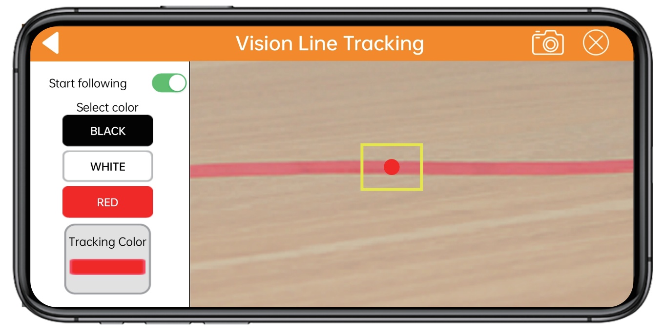

  • Line Following
(1) Click “Line Following” to enter this game. After activating it, the SpiderPi Pro will move forward along a black, white or red line.
loading
② The line tracking switch area is located on the left side of the interface
③ The camera live feed area is located on the right side of the interface.

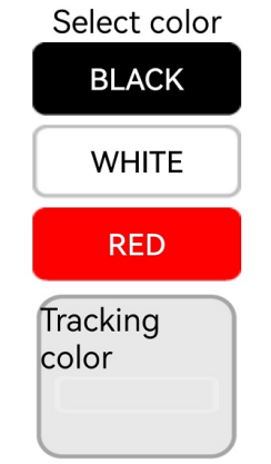

(2) Click “Start following” to enter this game and select color. Then SpiderPi will follow the targeted line.
Icon Button Function Instruction
Start or stop this game.
Select the targeted color.
Display the selected tracking color.

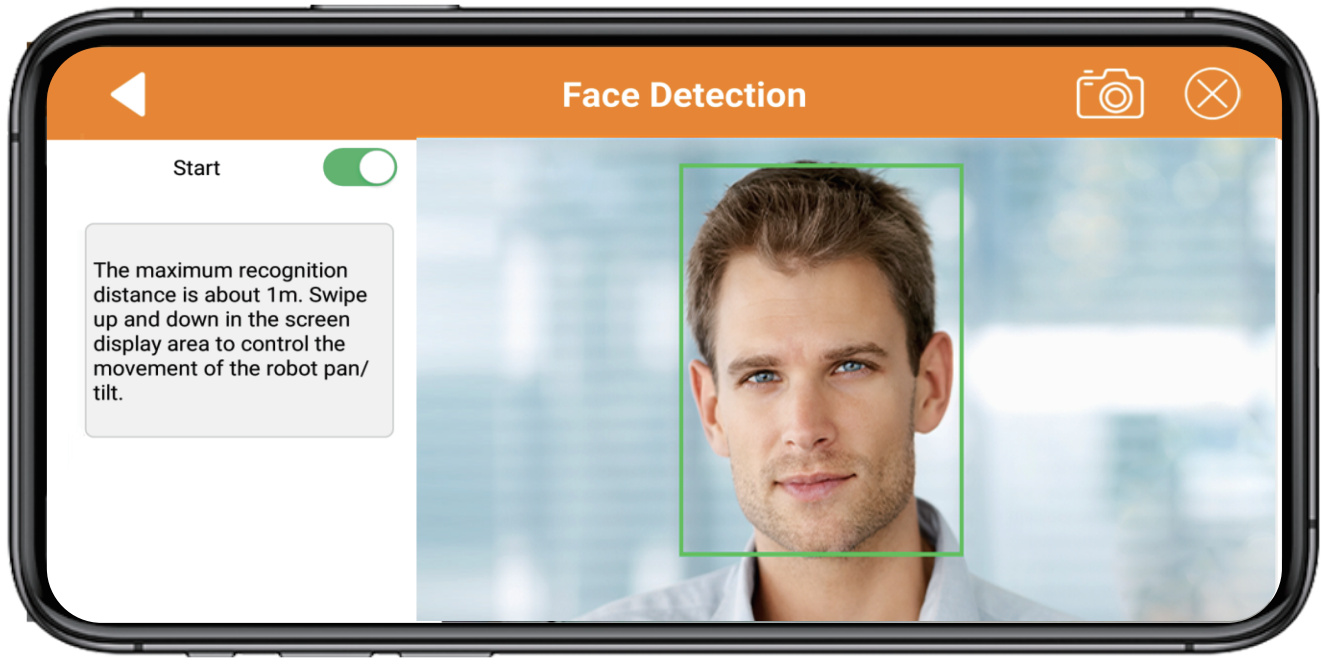

  • Face Detection
  • Please start this game in a well-lit environment, but keep robot from the direct light.
  • When recognizing, one human face only is allowed to appear within the detected range. Otherwise, it will affect the game result.
  • The max recognition distance is about 1 meter.
(1) Click Face Recognition to enter this game.
loading
(2) After clicking Start, the pan-tilt of the SpiderPi Pro will move left and right. When the face is detected, it will make a “Hello” action.
(3) If want to back to the mode selection interface, click the blank area of interface and then clickin the left side.

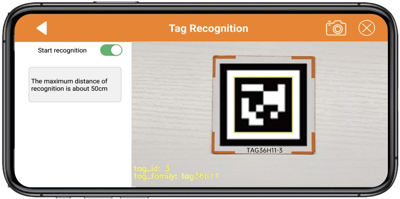

  • Tag Recognition
(1) Click “Tag Recognition” in mode selection interface to enter this game. This allows SpiderPi Pro’s camera to recognize different QR code tags and execute corresponding actions.
  • When recognizing QR codes, the distance should not be too close or too far. The best distance between the QR code image and the camera is 35cm.
loading
(2) Click “Start”. Then SpiderPi will identify tags within the detected range and carry out different actions according to the recognized ID.
ID Corresponding Action
1 Wave "Hello".
2 Walk in place.
3 Twist the body.
(3) If want to back to the mode selection interface, click the blank area of interface and then click in the left side.

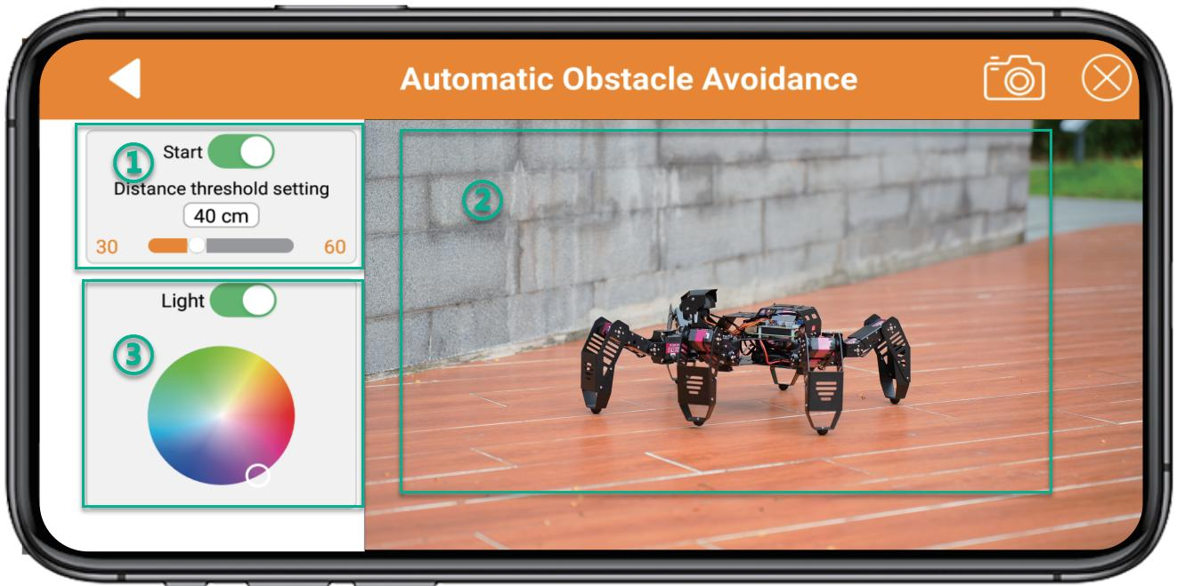

(1) Click Obstacle Avoidance to enter the game interface. After this game is activated, the SpiderPi Pro can use ultrasonic to detect obstacles ahead to avoid them.
Do not detect object at close range for a long time.
loading
① The left side of the interface includes the obstacle avoidance game switch and the obstacle threshold setting area.
② The middle of the interface is the camera transmission image area.
③ The right side of the interface includes the setting area for the RGB light and motor speed.
(2) Click “Start avoidance”. SpiderPi Pro will move forwards and it will turn left when detecting obstacle ahead. Then continue moving forward until there is no obstacle.

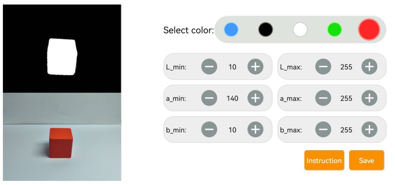

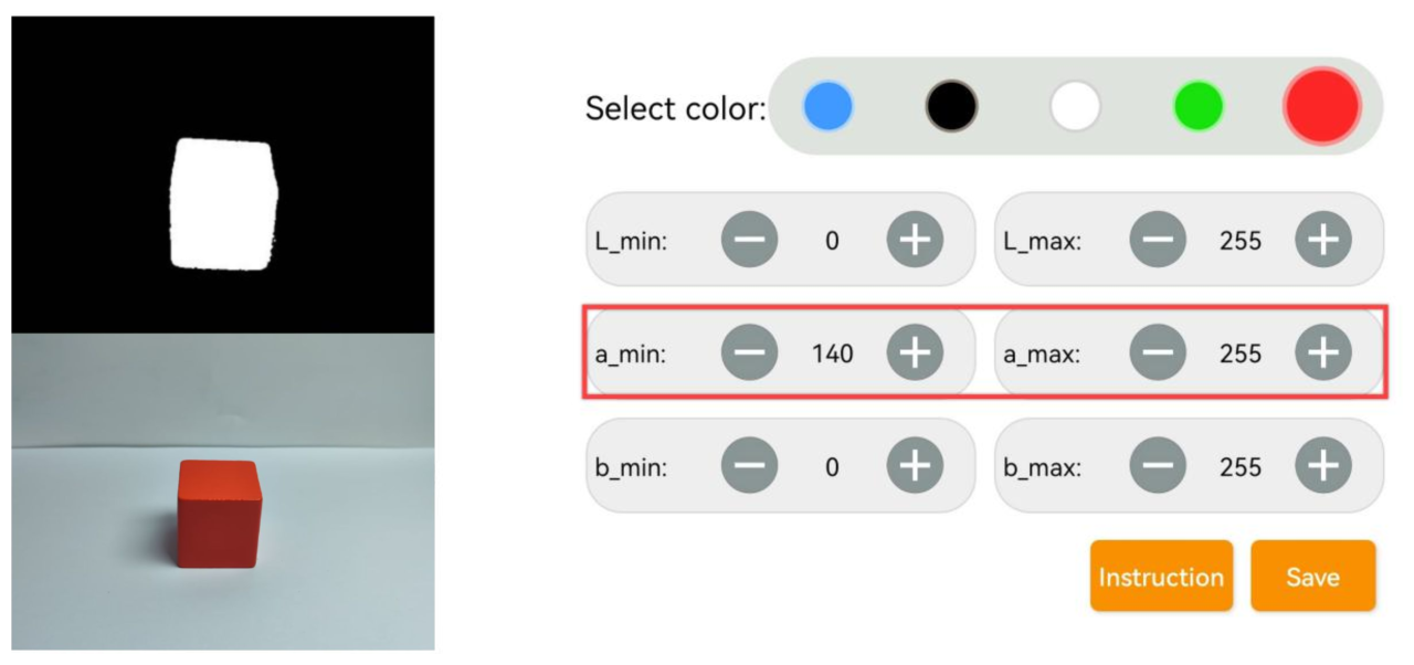

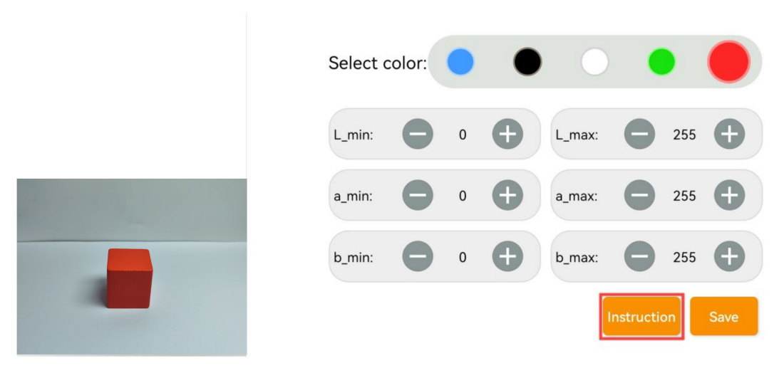

2.3.3 Adjust Color Threshold

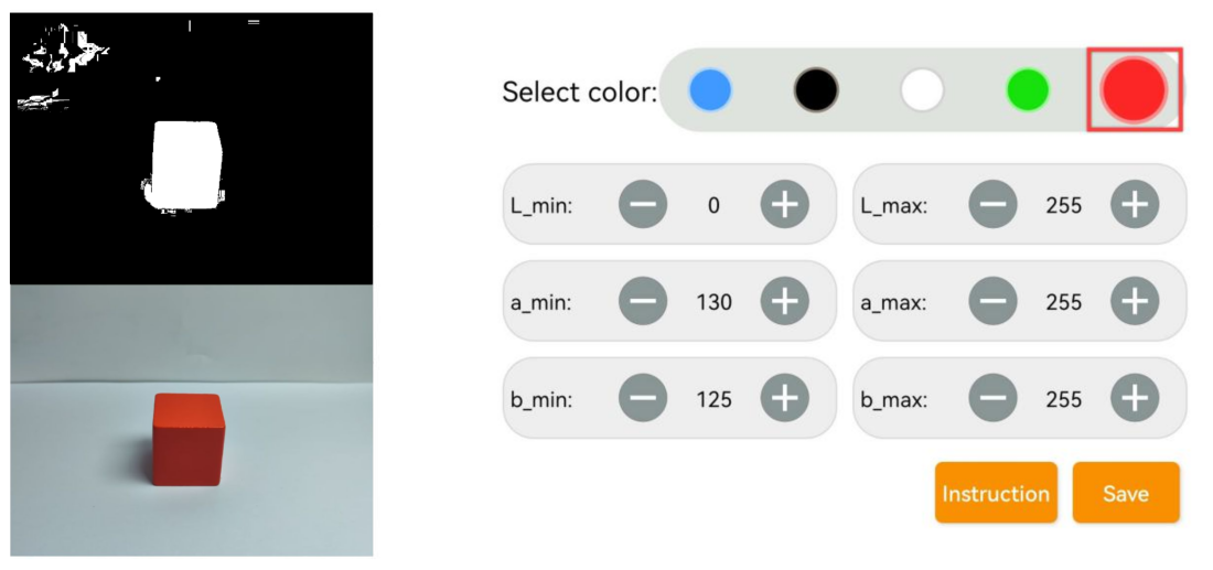

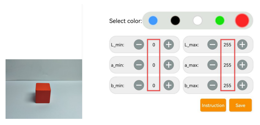

(1) Select color to be adjusted. Take red as example.
(2) Put red object within camera recognition zone. Set L_min, a_min and b_min to 0, and L_max, a_max and b_max to 255.

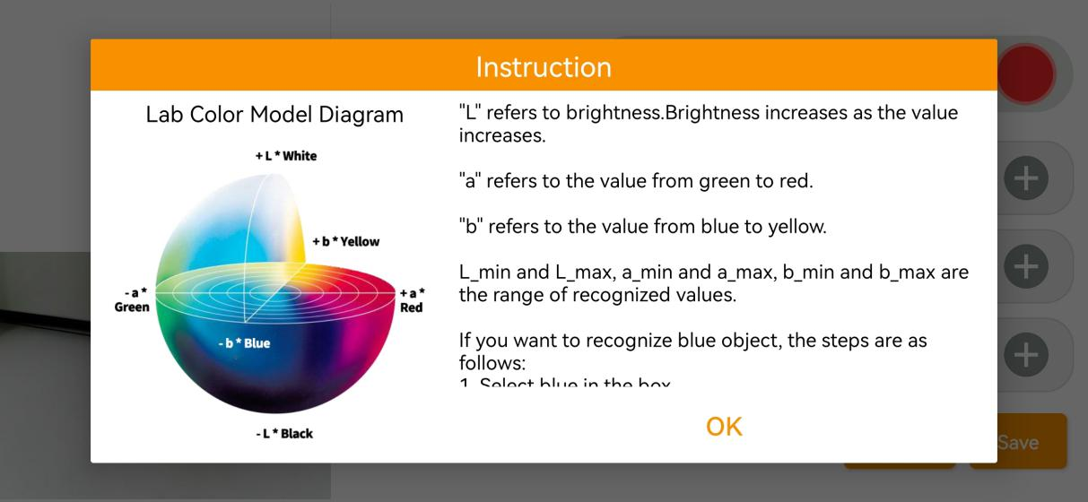

(3) Tap “Instruction” icon to check how to adjust color threshold.
if you need to close Instruction window, select “OK”.
(4) Red approaches “+a” zone, so you need to adjust A component.
(5) Keep “a_max” value the same, and then increase “a_min” value till red object turns white and other area is black.
(6) Adjust “L” and “B” values. If it belongs to light red, increase L_min. Otherwise, decrease L_max. If it belongs to warm tone, increase B_min. Otherwise, decrease B_max.
(7) Remember to save the value after adjustment.
