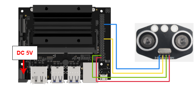

4.1.1 Wiring Instruction
This section uses DuPont wires to connect ultrasonic sensor. For wiring instructions, refer to the figure below:
Note: Before powering on, ensure that no metal objects are touching the controller. Otherwise, the exposed pins at the bottom of the board may cause a short circuit and damage the controller.

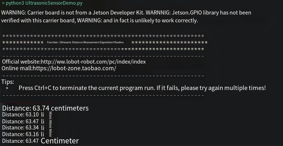

  1. Run the program by entering:
python3 UltrasonicSensorDemo.py
4.2.2 Project Outcome
Place obstacles at different distances in front of the ultrasonic sensor. The terminal will display the distances detected by the ultrasonic sensor.
