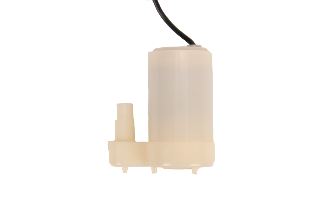

Hiwonder water pump module needs to be put into water when in use and can work after supplied by DC 2.5V-6V power. In our daily life, we can use the water pump coordinating with soil sensor to make an intelligent watering system.
1.2 Specification Instruction
1.2.1 Specification
| Working Voltage | DC 2.5V-6V |
| Working Current | 0.18A(DC 4.5V) |
| Power | 0.91W(DC 4.5V) |
| Hydraulic head | 0.55m(DC 4.5V) |
| Flow Rate | 100L/H(DC 4.5V) |

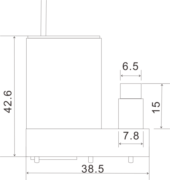

1.2.2 Dimension Drawings
Unit: mm

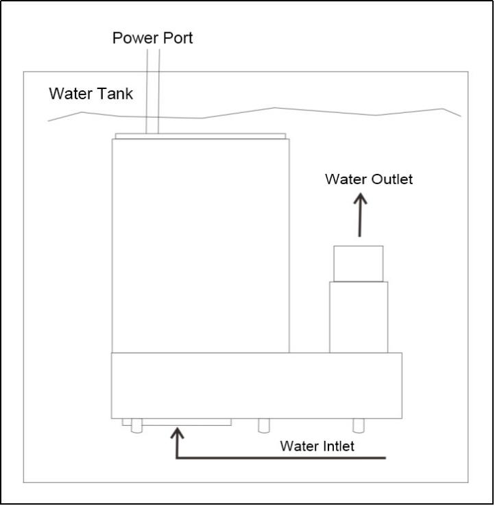

1.3 Operation Method

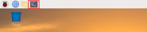

Step 3: Click
or press “Ctrl+Alt+T” to enter the LX terminal.

Q1:How should i distinguish positive and negative poles of water pump when in use ?
A: When supply water pump power, connect positive pole to one of ports freely and negative pole to the other port. Then,water pump can work.
