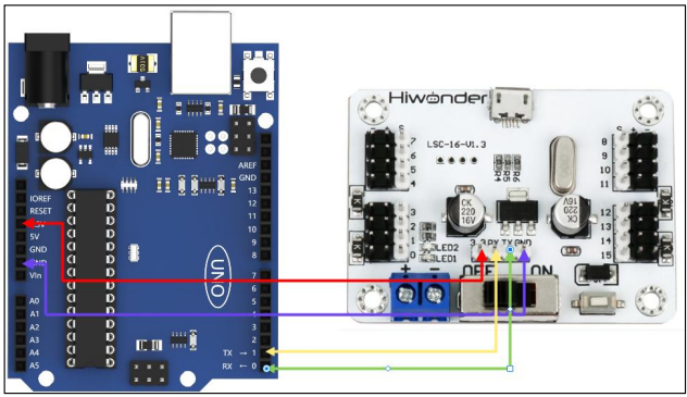

3.1.1 Wiring Instruction

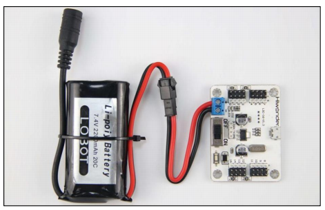

This section employs Arduino UNO and 16-channel servo controller for development, powered by a 7.4V 2200mAh lithium battery. Connect the serial port on the 16-channel servo controller to the serial port on the Arduino UNO.
(1) Connect the battery cable to the power interface on the servo controller, and connect the lithium battery.
Connect the red wire to “+”, and the black wire to “-”. The positive and negative poles must be matched correctly.
(2) Use female-to-female DuPont wires to connect the Arduino UNO to the controller.
Connect the TX and RX interfaces in reverse, GND to GND, and 3.3V to 3.3V.
(3) Connect the servo to the interface 1 on the controller.
  • When using our lithium battery, connect the lithium battery interface wire with
red to positive (+) and black to negative (-) to the DC port.
  • If the interface wire is not connected to the lithium battery, do not
directly connect it to the battery interface wire to avoid a short circuit between positive
and negative poles, which may cause a short circuit.
  • When connecting the serial ports, make sure to connect RX and TX correctly. Please refer to the images above.
  • Before powering on, ensure that no metal objects come into contact with the controller. Otherwise, it may cause a short circuit and damage the controller due to its bottom pins.

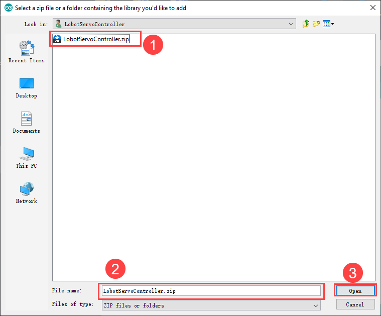

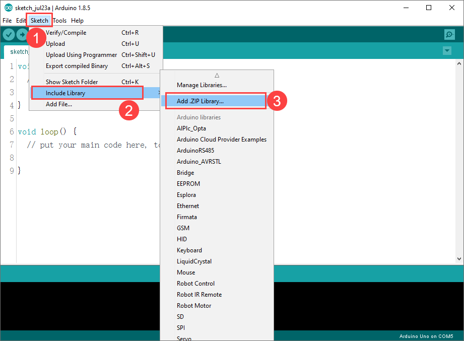

  • Add Library File
(1) Open Arduino IDE. Click “Sketch -> Include Library -> Add .ZIP Library” in the menu bar.
(2) Locate and open the library file in Library File (import before the first use).

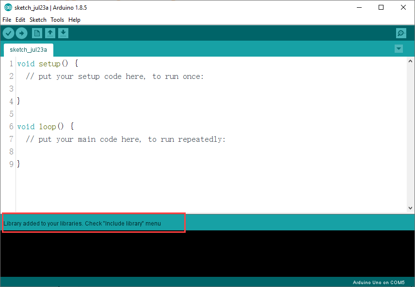

(3) Return to the IDE. When the prompt shown in the following image appears, the library file is successfully added.

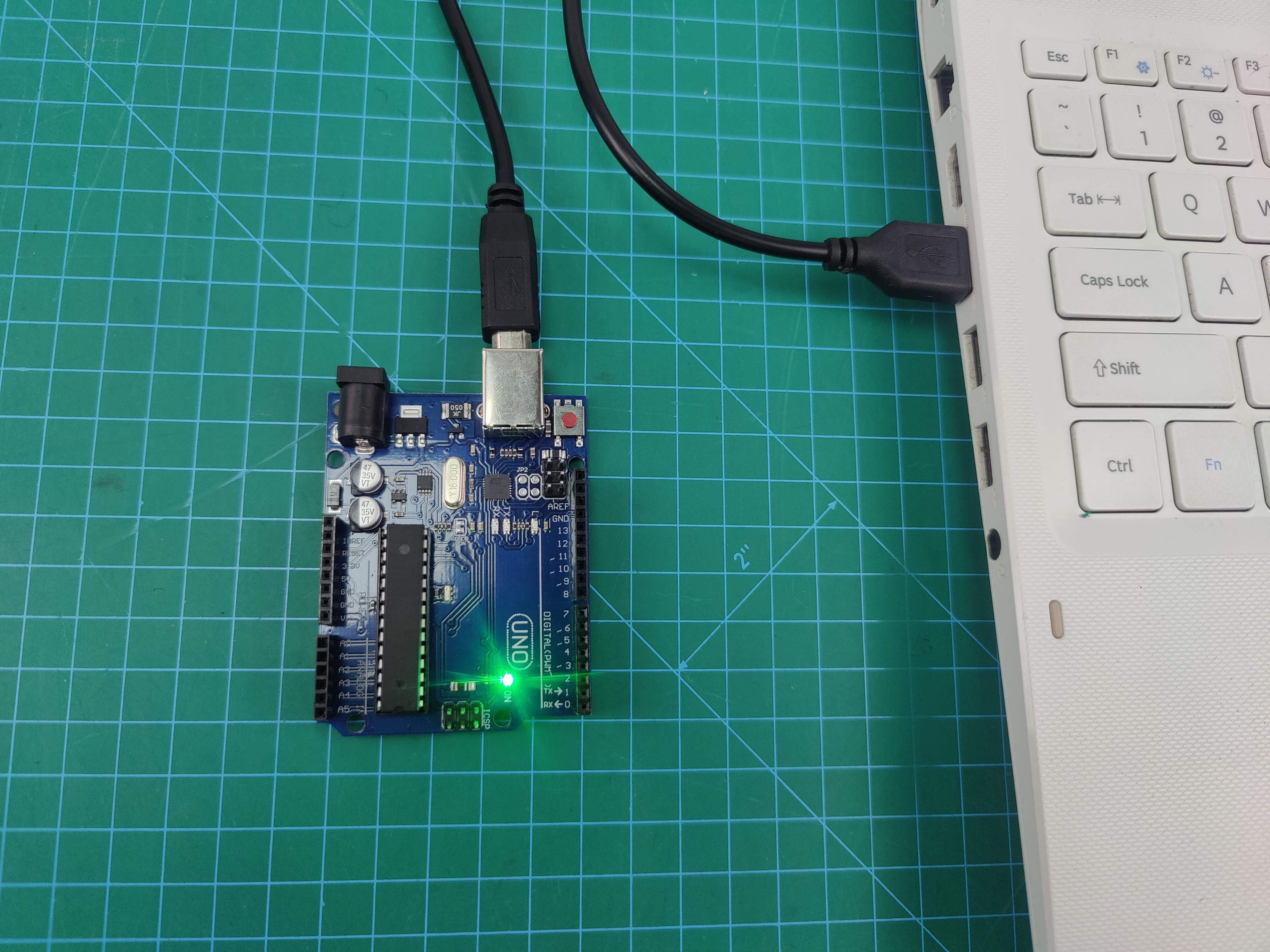

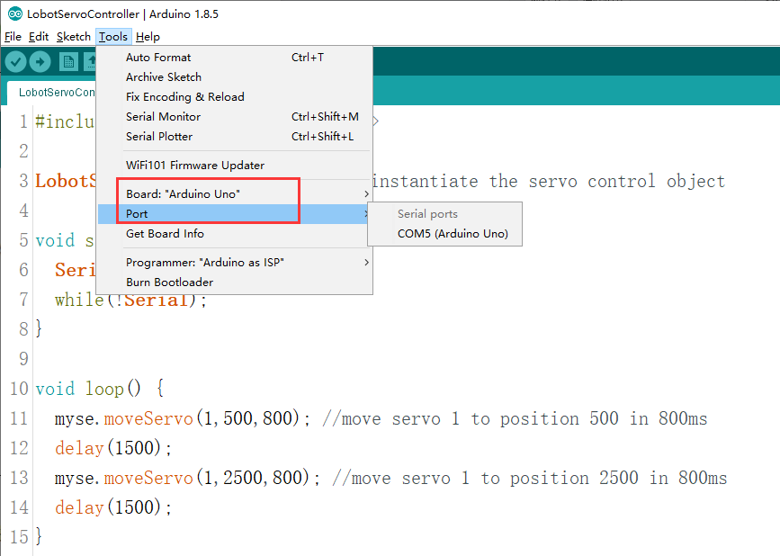

(3) Connect Arduino UNO to your computer with a USB cable. Select the board type as “Arduino UNO” and the corresponding port.
The port may not be unique. Arduino IDE will add the Arduino model after the corresponding port number.
When downloading the program, the serial ports of the Arduino UNO and the servo controller should be disconnected. Otherwise, the program will fail to be downloaded.
(4) After Arduino UNO is connected, click to download the program. After the download is complete, follow Wiring Instruction to connect the servo controller to the Arduino UNO. Then, switch the servo controller on. The servo 1 will start to rotate.
