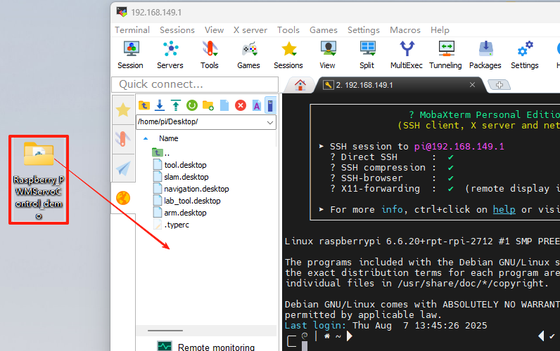

Drag the program and library file SDK into the Raspberry Pi system image via MobaXterm. The software package is located under Appendix -> Remote Desktop Connection Tool (for Raspberry Pi and Jetson). For detailed instructions on how to use MobaXterm, refer to the corresponding document. In this example, the files are placed on the desktop.
Make sure the library files are placed in the same directory as the program.
