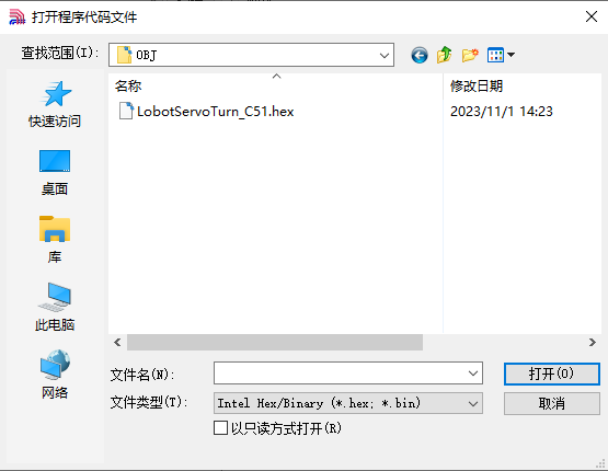

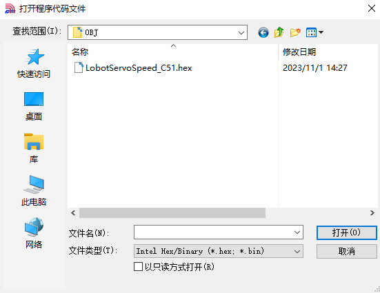

(3) Click “Open Code File” and find the hex file in “C51 Program/Case 2 Control PWM Servo Speed/LobotServoSpeed_C51/OBJ”.
(4) After opening the program file, click “Download/Program” to upload the code to the 51 microcontroller. Note: Before uploading, remove the jumper cap from the 51 microcontroller. Once the STC-ISP tool in the lower-right corner shows that it is detecting the target device, reinsert the jumper cap. The upload process will begin automatically.

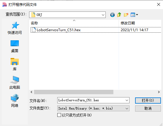

(3) Click “Open Code File” and find the hex file in C51 Development/Source Code/Case 3 Control Multiple Servos/OBJ/LobotServosTurn_C51.

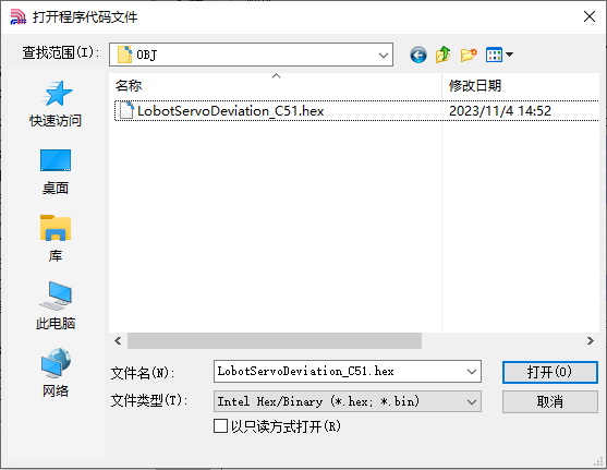

(3) Click “Open Code File” and find the hex file in C51 Program/Case 4 Central Position & Deviation Adjustment/LobotServosDeviation_C51/OBJ.
