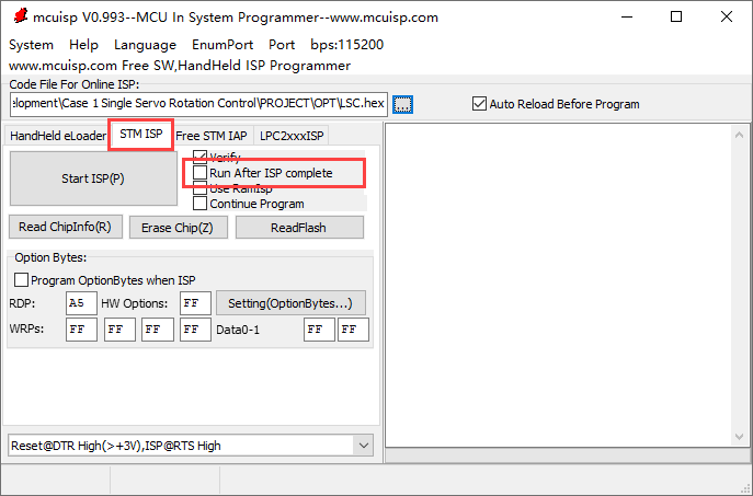

(1) Open the download tool in Appendix>STM32 Software.
(2) Configure it as shown in the figure:

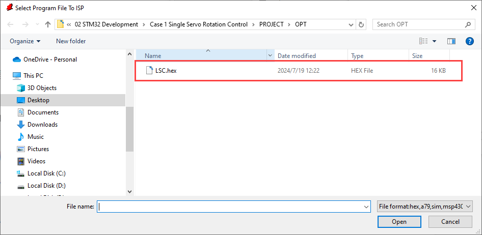

(3) Click . Locate and open the hex file stored in STM32 Development/Case 1 Single Servo Rotation Control/PROJECT/OPT.

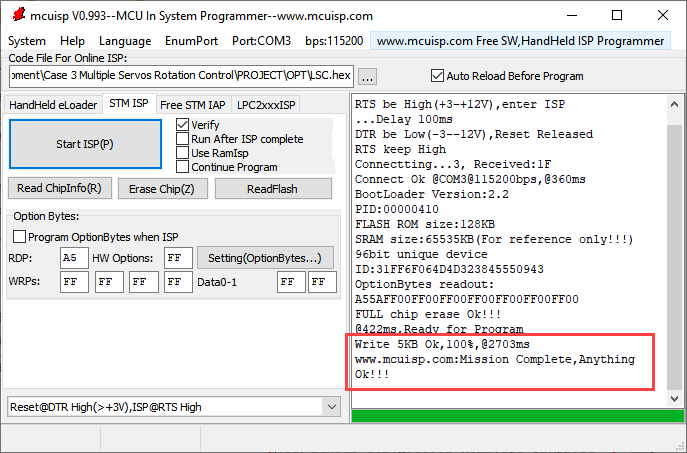

(4) After opening the program, click “Start ISP” to download the program to the STM32 microcontroller.
When downloading the program, remove the jumper cap on the STM32 microcontroller and press the reset button. When the prompt “Mission Complete, Anything OK” appears in the lower right corner, it is successfully downloaded. Next, insert the jumper cap back into the STM32 microcontroller.
After the download is completed, switch the servo controller on. Press the reset button on the STM32 microcontroller. The servo 1 will start to rotate.

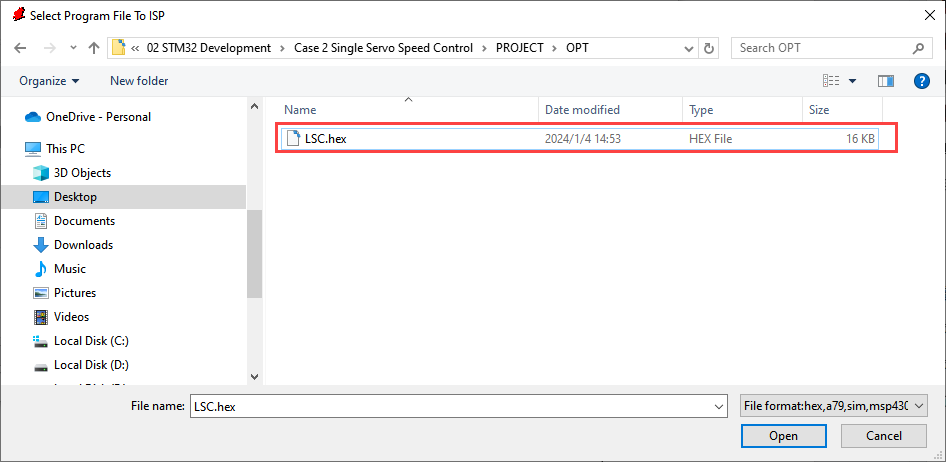

(3) Click . Locate and open the hex file stored in STM32 Development/Case 2 Single Servo Speed Control/PROJECT/OPT.

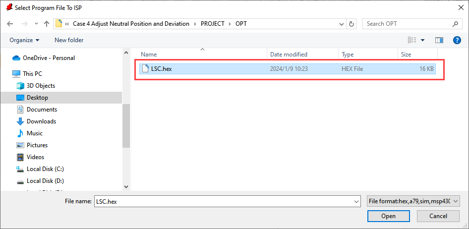

(3) Click . Locate and open the hex file stored in STM32 Development/Case 4 Adjust Neutral Position and Deviation/PROJECT/OPT.

(5) After the download is completed, switch the servo controller on. Press the reset button on the STM32 microcontroller. The servo 1 will start to rotate.
  • Program Outcome
The servo returns to the neutral position. After a short delay, it rotates to the deviation angle and maintains that position.
