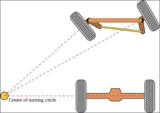

The Ackermann steering chassis represents a standard configuration extensively employed in the new energy market and is a popular choice within the realm of autonomous driving. Specifically developed by Hiwonder, for educational scenarios, this Ackermann car chassis aligns with the standard structure of modern car chassis. In this design, the rear wheels consistently maintain a parallel orientation, while the inner wheels articulate at an angle during turns. Ackermann steering is characterized by the inner wheel turning at a greater angle than the outer wheel, and the disparity in turning angles is termed Ackermann steering.

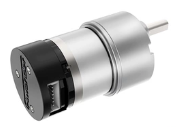

(1) Equipped with a high-performance DC reduction motor featuring its own high-precision encoder.
(2) The motor operates at a rated voltage of 12V, delivering strong horsepower and excellent performance.

The front wheel transmission system of the Ackerman chassis consists of a steering gear, connecting rod, and wheel. The steering gear is linked to the connecting rod, and the connecting rod is connected to the wheel. By rotating the steering gear, the rotation amplitude of the connecting rod is controlled, consequently managing the steering of the front wheel.
During turns, the two front wheels maintain a parallel alignment, meaning they rotate at the same angle. The control of the rear wheels involves motors and wheels. The robot’s forward, backward, and speed movements are regulated by the motor’s rotation.
The Ackerman car is equipped with a 520 Hall-coded DC reduction motor—a high-torque, high-load motor with a 12V DC power supply and a reduction ratio of 1:30. This motor design enhances the performance and efficiency of the Ackerman chassis.

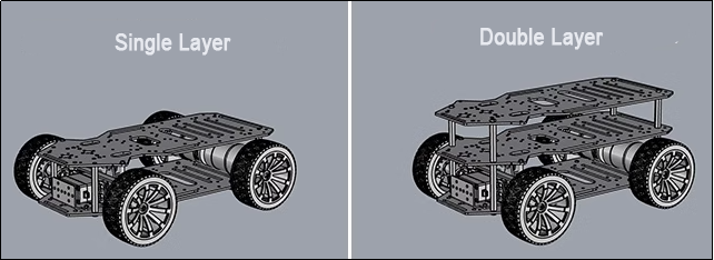

1.2 Double-layer board installation tutorial
1.2.1 Double-layer board installation tutorial
Greetings, everyone! In today’s video, I’ll guide you through the step-by-step assembly process of the double-layer Ackermann chassis. Let’s dive in! Begin by removing the four screws. Here’s a helpful tip: hold the column with your hand to keep the bottom screw secure. Next, attach the single-pass copper column to these designated holes. Moving on, affix the second layer onto the columns and secure them together using screws. And there you have it – assembly is complete! For details on wiring and controller installation, please check out the next video.
