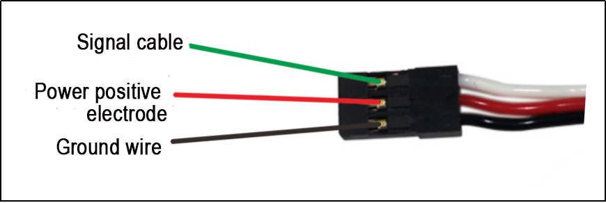

4.3.3 Steering Servo
The steering servo in this chassis utilizes the LD-1501MG PWM servo model.
The LD-1501MG operates on a PWM servo mechanism. To control it, a PWM signal with a 20ms period is sent to the signal end. The servo angle is adjusted by manipulating the pulse width within the range of 500 to 2500μs. This corresponds to an angle range of 0 to 180°, and the recommended operating voltage is between 6V and 8.4V.
PIN Description
White Signal wire
Red Positive power electrode
Black Ground wire

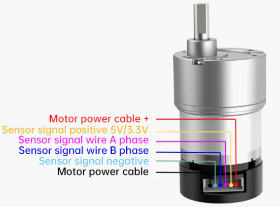

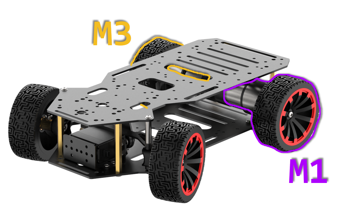

4.3.4 Encoder Geared Motor
The motor model employed in this chassis is JGB37-520R30-12. Here’s the breakdown: “J” signifies a DC motor, “GB” denotes an eccentric output shaft, “37” indicates the diameter of the reduction box, “520” represents the motor model, “R30” stands for the reduction ratio of 1:30, and “12” signifies the rated voltage of 12V. Please refer to the interface description illustrated in the figure below:

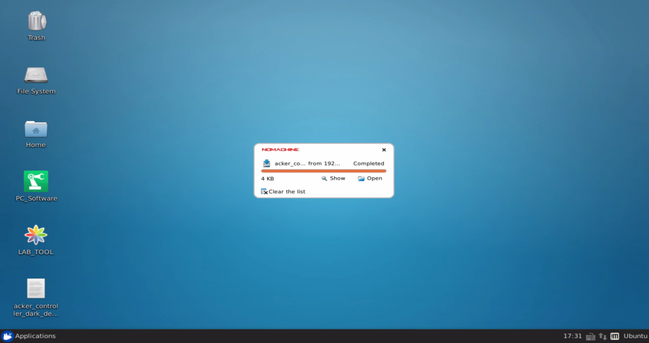

First, you must establish a remote connection to the robot, and subsequently, transfer the program files to the designated directory within the system.

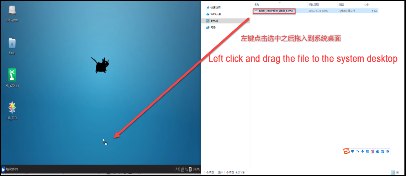

  • Open NoMachine software, and connect the software to the device.
  • Drag the demo file under the “3 Program” folder to the system image desktop, as shown in the figure below.

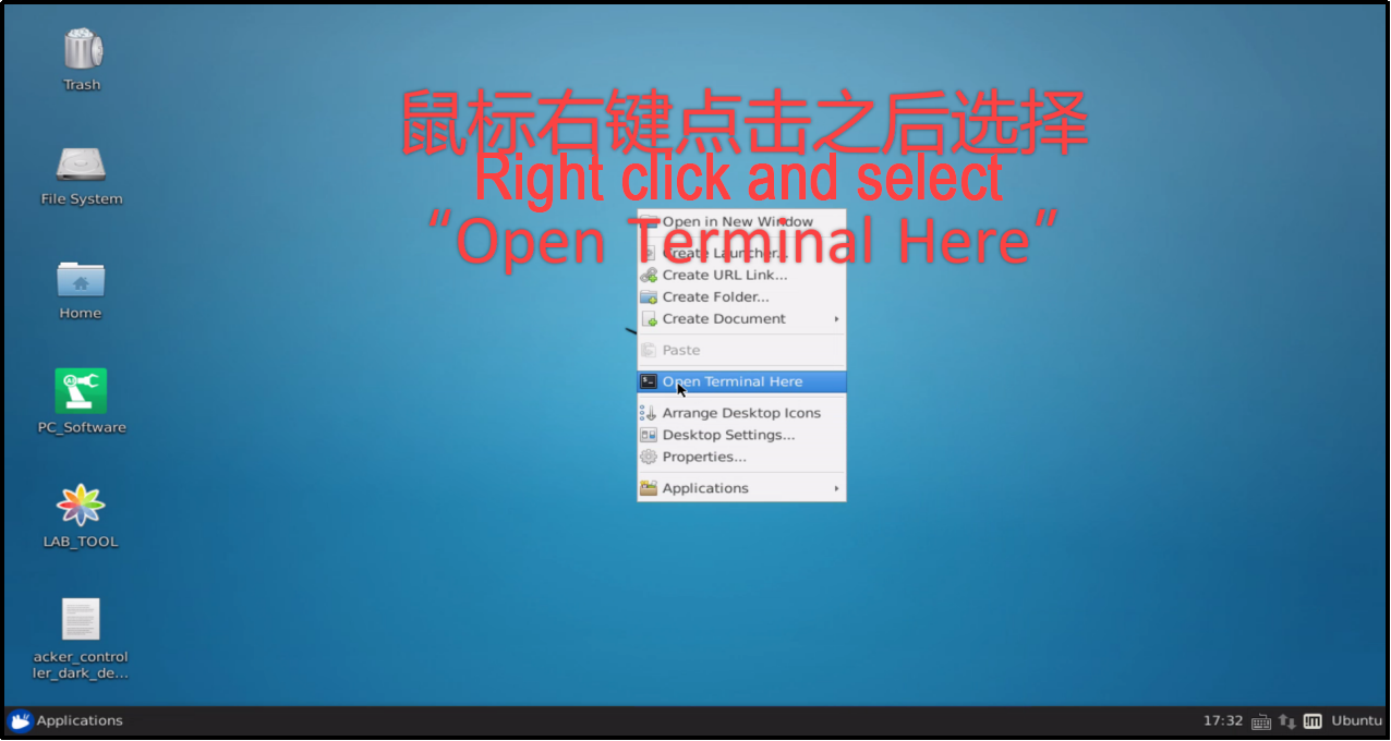

  • To access the terminal interface using NoMachine, follow these steps: Right-click on the desktop, and choose “Open Terminal Here”

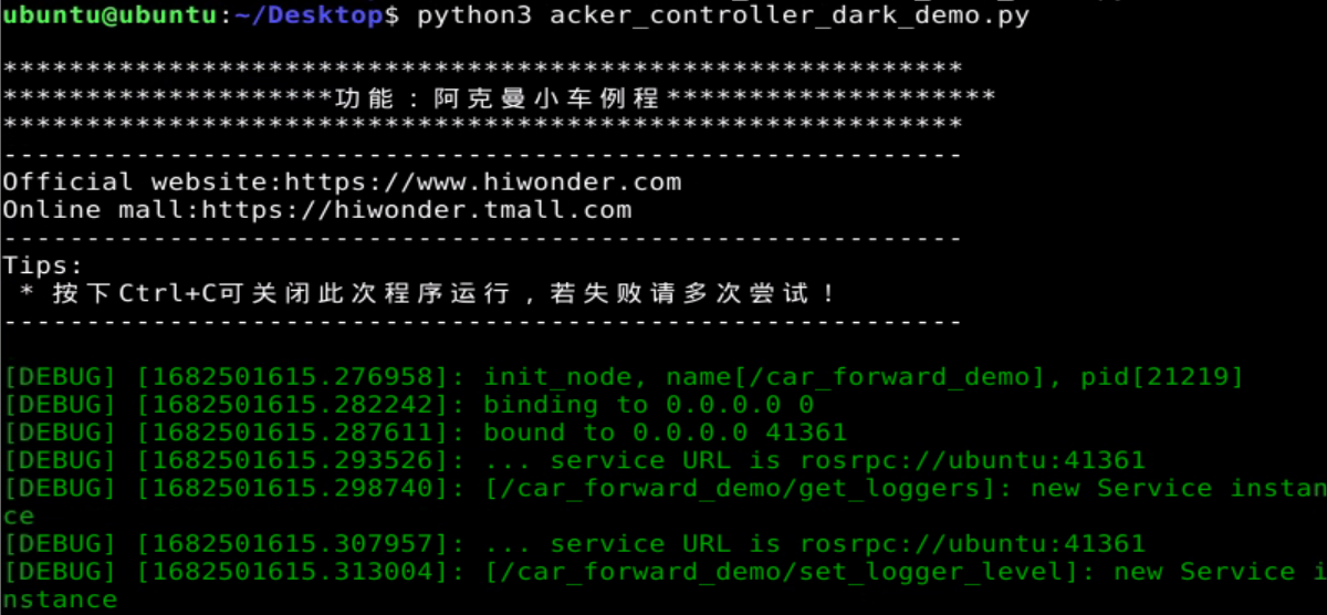

  • Enter the following command sudo chmod +x acker_controller_dark_demo.py to grant executable permissions to the program.
  • Type the command python3 acker_controller_dark_demo.py to launch the car’s control program.
  • After the program is loaded, the car will execute corresponding movements as defined in the program.
  • **To exit the program, simply press ** ‘Ctrl+C’ in the terminal to close it.

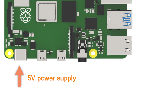

4.6.1 Power Supply Considerations
Considering the rated operating voltage of the Raspberry Pi 4B motherboard is 5V, it’s essential to note that the four-channel encoded IIC interface (5V, GND, SCL, SDA) solution from the motor drive module cannot be directly used for power supply. This is because the 5V of this interface only supports voltage input and cannot be used for output. However, using other interfaces of the motor driver module to power the Raspberry Pi GPIO is not recommended. It is advised to adopt a dual power supply solution, providing a separate external power supply to the motor drive module. For instance, using an 11.1V lithium battery (fully charged at 12V) to power the motor drive module, and supplying Raspberry Pi 4B with an additional 5V3A power supply for independent power.
Here, we clarify that powering the Raspberry Pi through the GPIO port is not recommended due to the following reasons:
  • The Raspberry Pi lacks an additional protection circuit for the GPIO port. If power is supplied solely through the GPIO, unstable voltage may lead to current reactions that could potentially damage the built-in CPU, posing a risk to the device.
  • Simultaneously, inadequate external current through the GPIO port may result in improper functioning of the Raspberry Pi 4B, while excessively high current can lead to damage to the built-in components. Therefore, it is advisable to power the Raspberry Pi 4B through the Type-C port, using a stable power source such as a power bank with specified current and voltage (5V, 2.5A or 5V, 3A) to ensure the normal operation of the Raspberry Pi 4B motherboard.
Using a separate power supply for the Raspberry Pi not only ensures its normal operation but also preserves the 5V and GND pins of the Raspberry Pi, facilitating future expansions of the Raspberry Pi.
