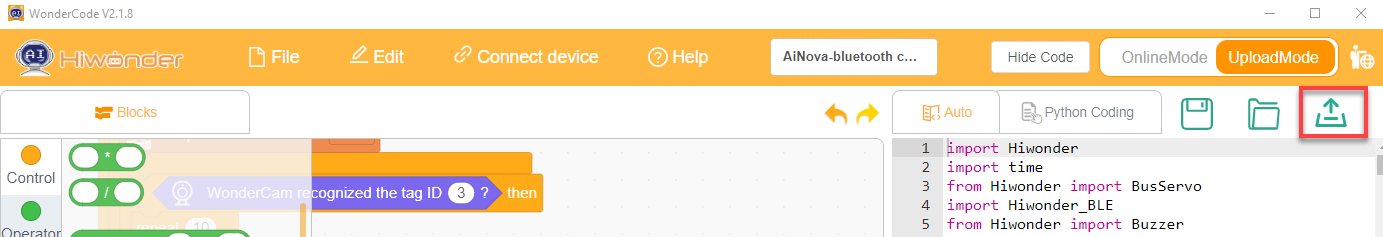

2.2.3 Program Download
(1) Import the AiNova Bluetooth Control.sb3 program , or simply drag it onto the main interface of the programming software.
(2) After importing the program, click the “Upload” icon in the upper right corner of the interface.
(3) Wait for the download to complete; then you will see an “Successful” message.
