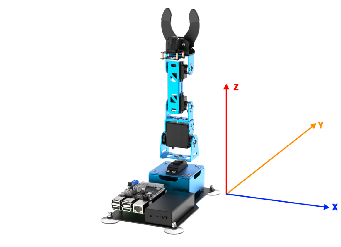

A coordinate system must be established to describe the motion of an object. ArmPi mini uses x, y and z coordinate system and take the center of the base as origin (0,0,0), as the figure shown below:
loading
When controlling robotic arm, z-axis value must be greater than 0.
After the coordinate system is established, robot arm can be controlled to reach any position in the workspace by specifying the coordinate of the end effector position and using inverse kinematics to calculate the joint angle. The X, Y and Z axes can be controlled at individually or together.
Coordinate axis Control direction
x Control the end effector to move left or right. Moving to the right is the positive direction of x axis.
y Control the end effector to move forward or backward. Moving forward is the positive direction of y axis.
z Control the end effector to move up and down. Moving up is the positive direction of z axis.
For example, when robot arm moves to the right, x-axis value increases; when robot arm moves forward, y-axis value increase; when robot arm moves up, z-axis value increases.

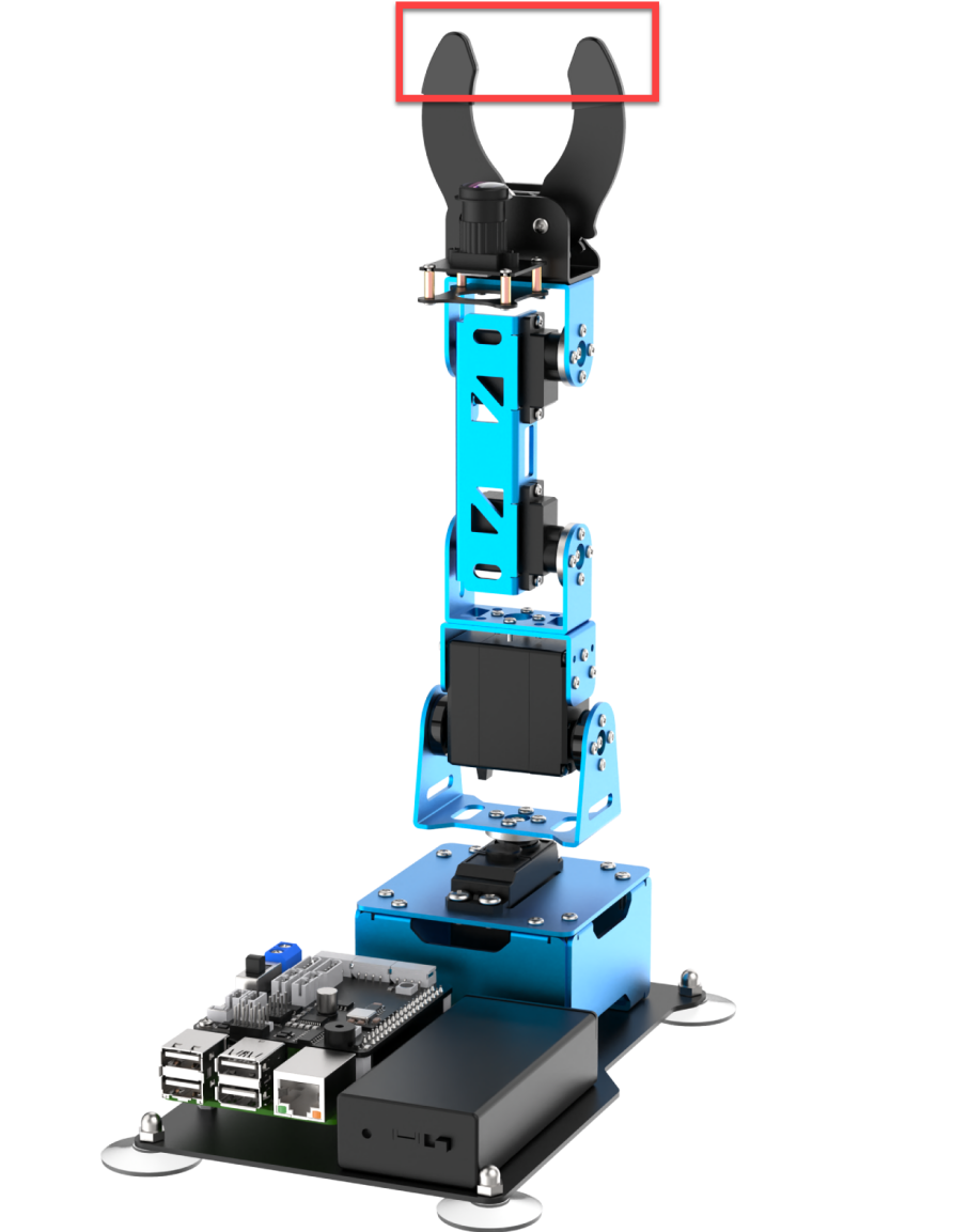

The function AK.setPitchRangeMoving() in inverse kinematics library is used to control robot arm to move. Take AK.setPitchRangeMoving((0, 6, 18), 0,-90, 90, 1500) for example.
The first parameter(0, 6, 18) is the end-effector coordinate. The three parameters represent the coordinate of x, y and z axes.

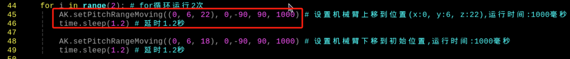

(4) Find the following code:
(5) Press “i” key on the keyboard to enter the editing mode.
(6) Change “(0, 6, 22)” to “(4, 6 , 18)”, as the figure shown below:
(7) After modification, press “Esc” and enter “:wq”, and then press “Enter” to save and close the file.
:wq
(8) Enter command and press “Enter” to start game and check the game effect after modification.
python3 arm_move_IK_demo.py

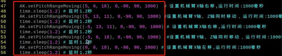

    # 设置机械臂初始位置(x:0, y:6, z:18),运行时间:1500毫秒(set the initial position of the robotic arm to (x:0, y:6, z:18) and the runtime to 1500ms)
    time.sleep(1.5) # 延时1.5秒(delay for 1.5s)
    AK.setPitchRangeMoving((5, 6, 18), 0,-90, 90, 1000)  # 设置机械臂X轴右移,运行时间:1000毫秒(set the robotic arm to move to the right along the X-axis with a runtime of 1000ms)
    time.sleep(1.2) # 延时1.2秒(delay for 1.2s)
    AK.setPitchRangeMoving((5, 13, 11), 0,-90, 90, 1000) #设置机械臂Y轴、Z轴同时移动,运行时间:1000毫秒(Set the robotic arm to move simultaneously along the Y and Z axes with a runtime of 1000ms.)
    AK.setPitchRangeMoving((-5, 13, 11), 0,-90, 90, 1000) # 设置机械臂X轴右移,运行时间:1000毫秒(set the robotic arm to move to the right along the X-axis with a runtime of 1000ms)
    AK.setPitchRangeMoving((-5, 6, 18), 0,-90, 90, 1000)  #设置机械臂Y轴、Z轴同时移动,运行时间:1000毫秒(Set the robotic arm to move simultaneously along the Y and Z axes with a runtime of 1000ms.)
    AK.setPitchRangeMoving((0, 6, 18), 0,-90, 90, 1000) # 设置机械臂X轴左移,运行时间:1000毫秒(set the robotic arm to move to the left along the X-axis with a runtime of 1000ms)

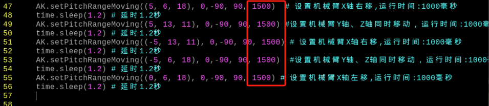

(6) Change “1000” to “1500”, as the figure shown below:
:wq
python3 arm_move_IK_triaxial.py
