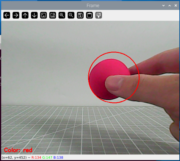

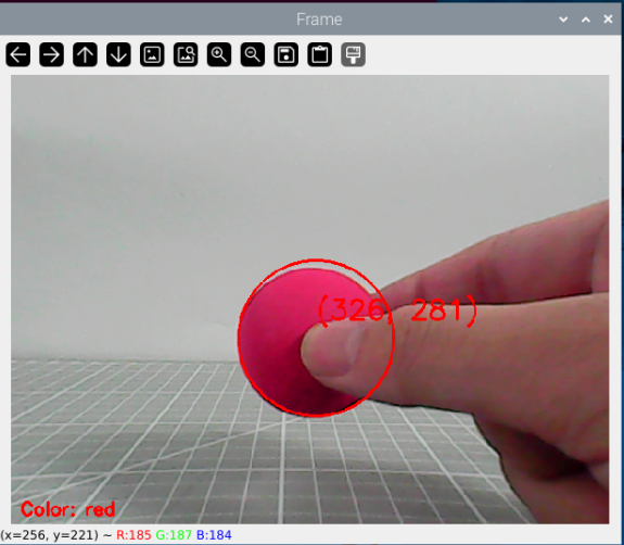

4.1.3 Program Outcome

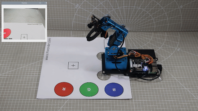

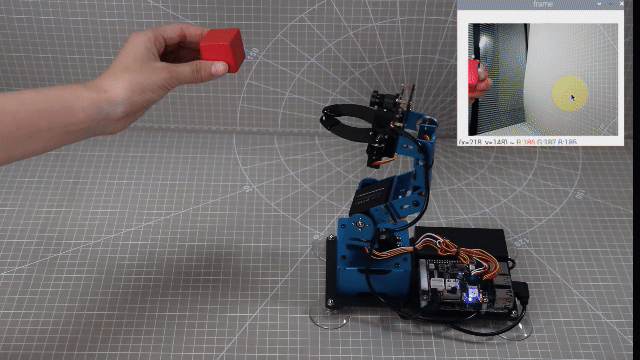

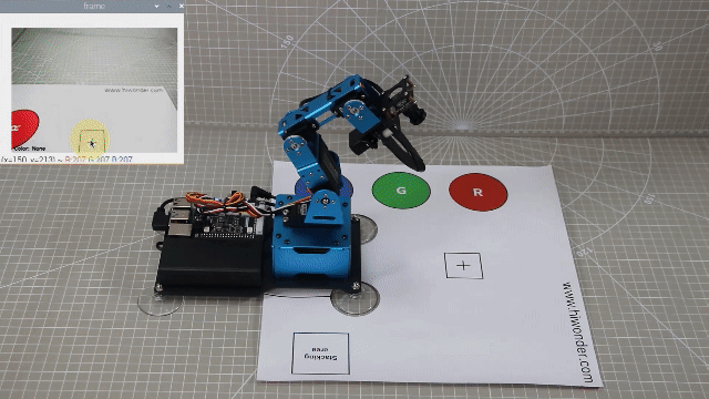

After starting the game, the camera will be used to detect colors. When a red ball is recognized, the buzzer will emit a beep sound, and the ball will be circled in the transmitted image, with “Color: red” printed.
  • During the recognition process, ensure the environment is well-lit to avoid inaccurate recognition due to poor lighting conditions.
  • Ensure that no objects with similar or matching colors to the target are present in the background within the camera’s visual range, as this may cause misrecognition.

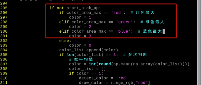

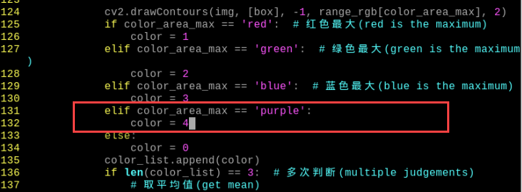

            if color_area_max == 'red':  # 红色最大(red is the maximum)
                color = 1
            elif color_area_max == 'green':  # 绿色最大(green is the maximum)
                color = 2
            elif color_area_max == 'blue':  # 蓝色最大(blue is the maximum)
                color = 3
                color = 0
            color_list.append(color)

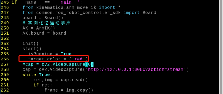

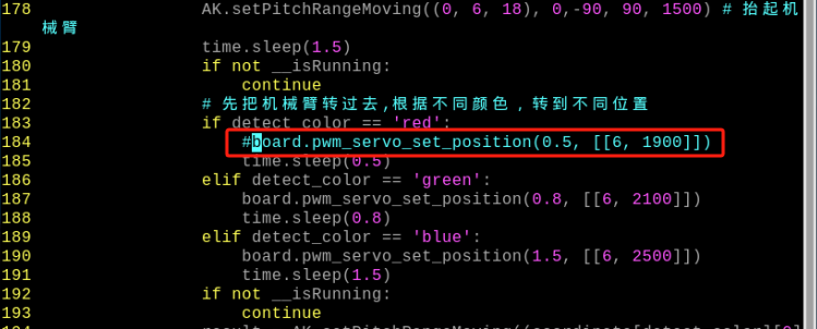

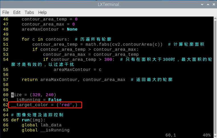

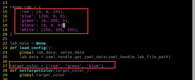

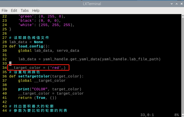

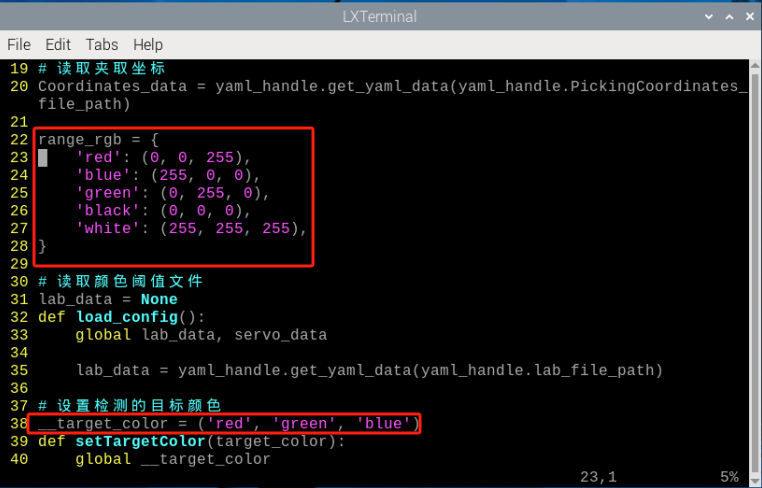

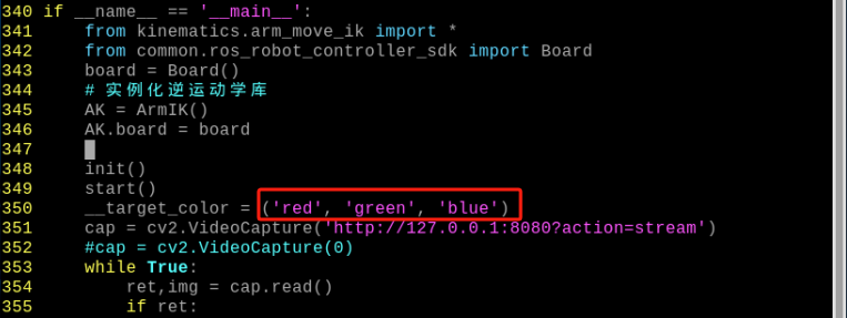

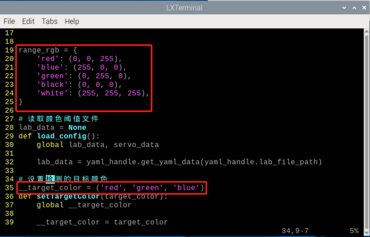

  • Changing the Default Recognized Color
The color recognition program is pre-configured to recognize three colors: red, green, and blue. By default, the program identifies red, triggering the buzzer to emit a beep and drawing a circle around the red ball in the transmitted image, displaying “Color: red”.

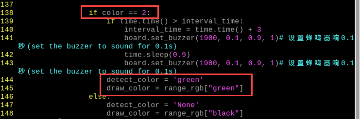

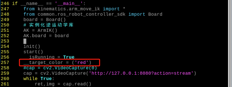

To change the recognized color to green, follow these steps:
(1) Enter the following command and press Enter to navigate to the source code directory:
cd ArmPi_mini/functions/

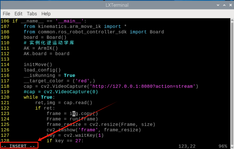

(2) Then, enter the following command and press Enter to open the program file:
sudo vim color_recognition.py

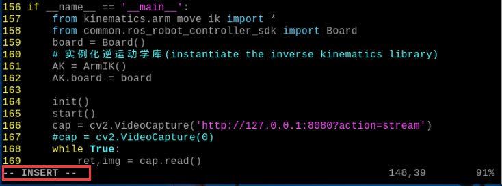

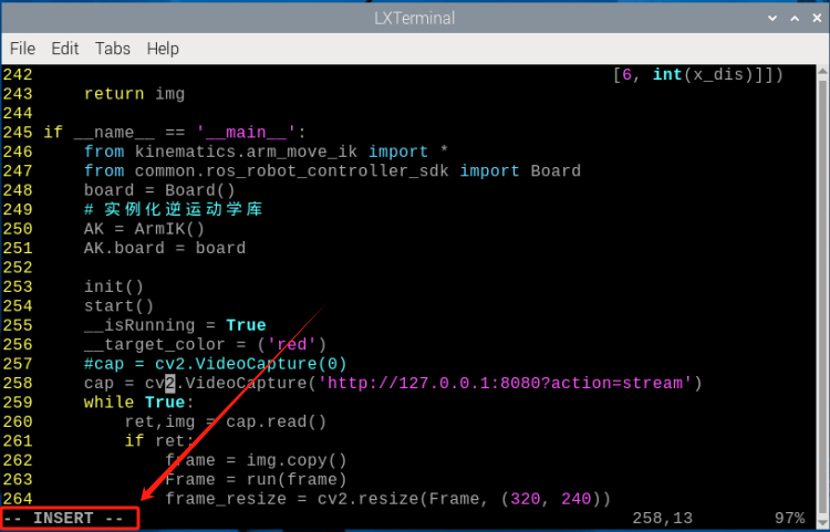

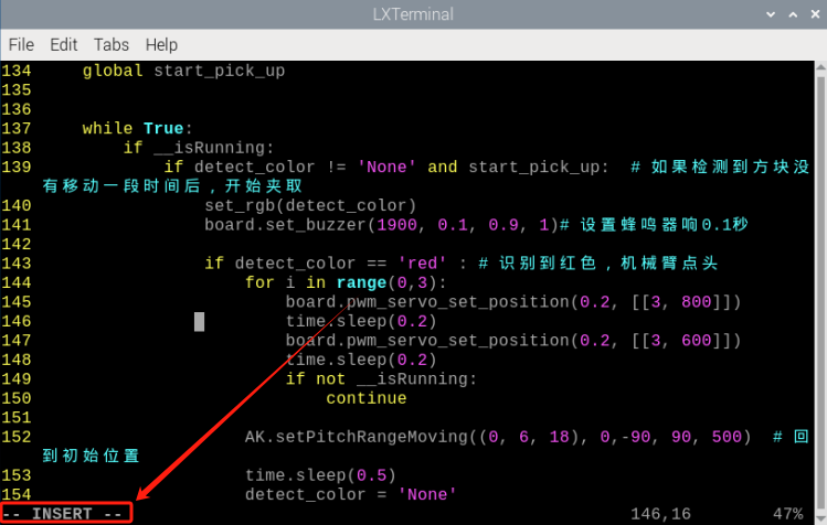

(3) Press the “i” key on the keyboard to enter edit mode.

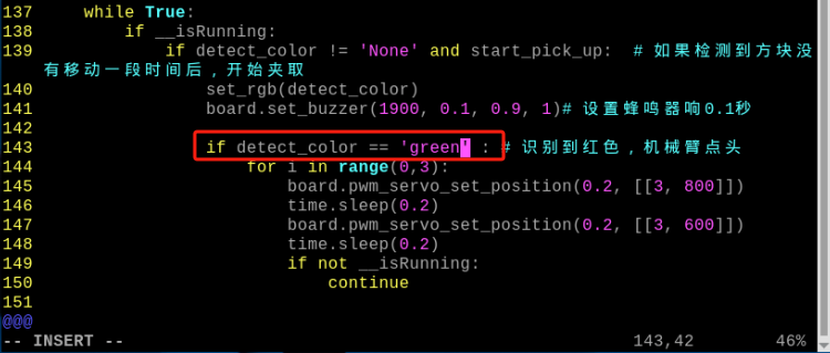

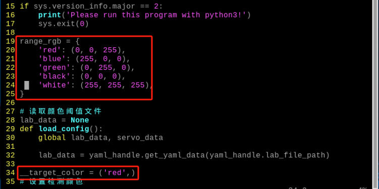

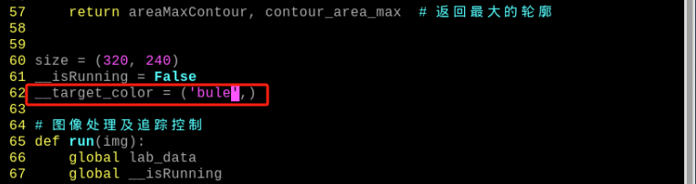

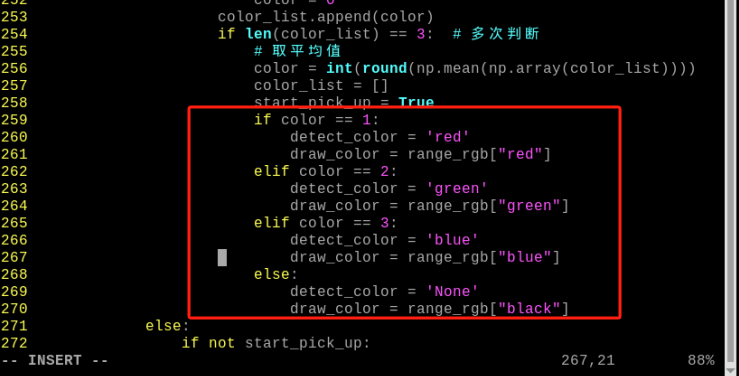

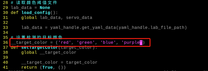

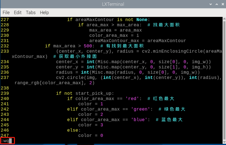

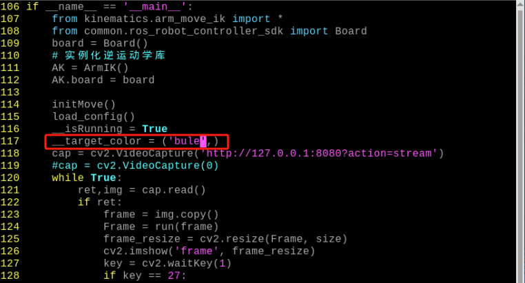

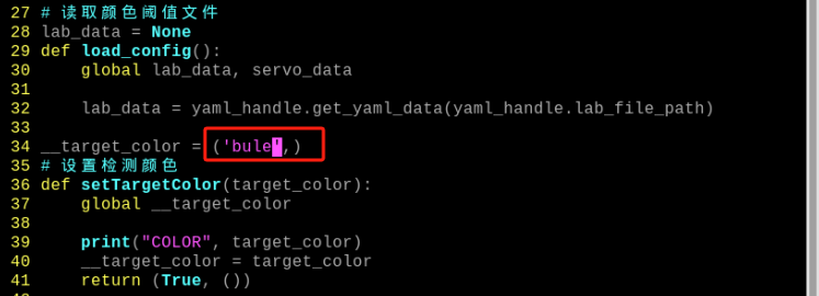

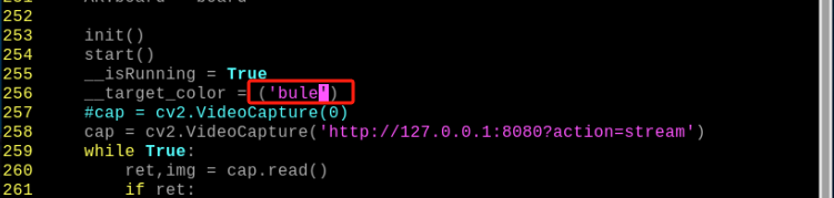

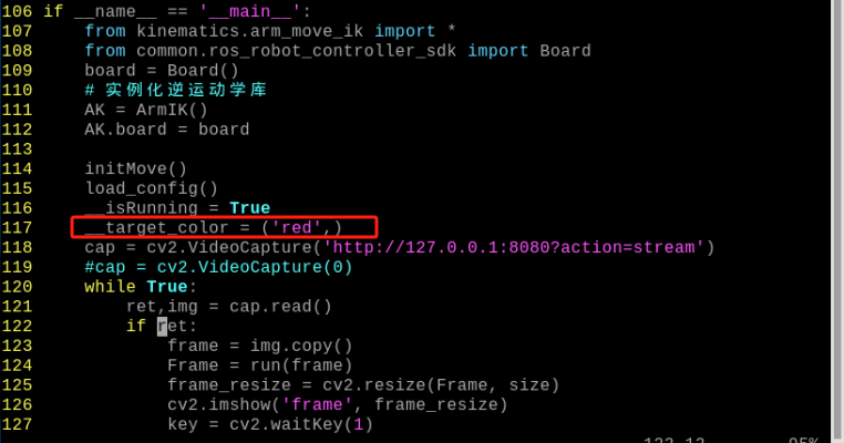

(4) Replace “red” (highlighted in red in the image) with “green”, as shown in the image below:

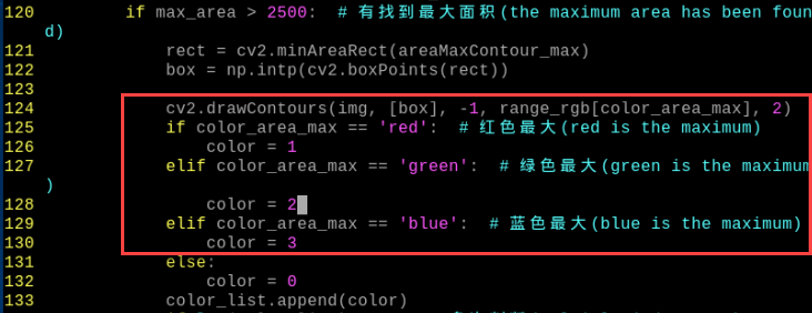

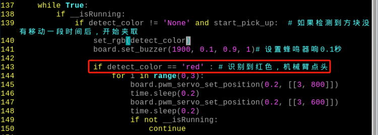

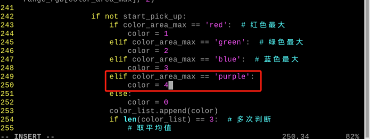

(5) Modify the color parameters as shown in the following figure:
(6) To save your changes, press the “Esc” key, then type “:wq” (note the colon before “wq”) and press Enter to save and exit.

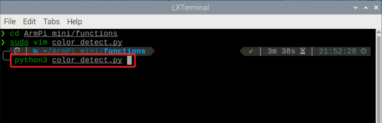

(7) Enter the following command and press Enter to start the color recognition functionality:
python3 color_recognition.py

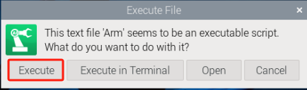

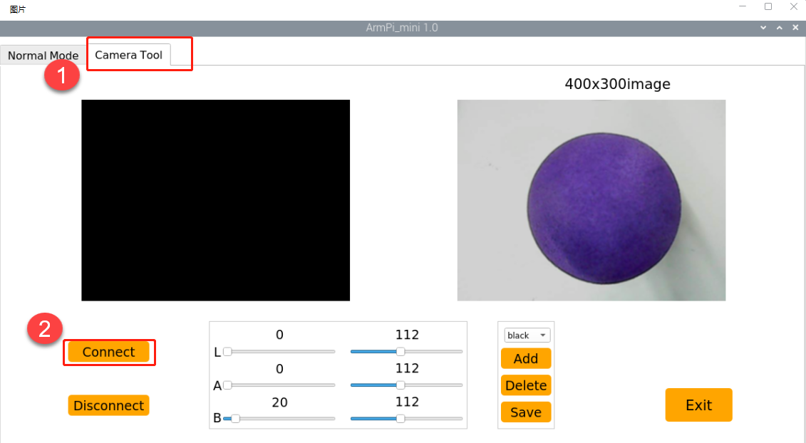

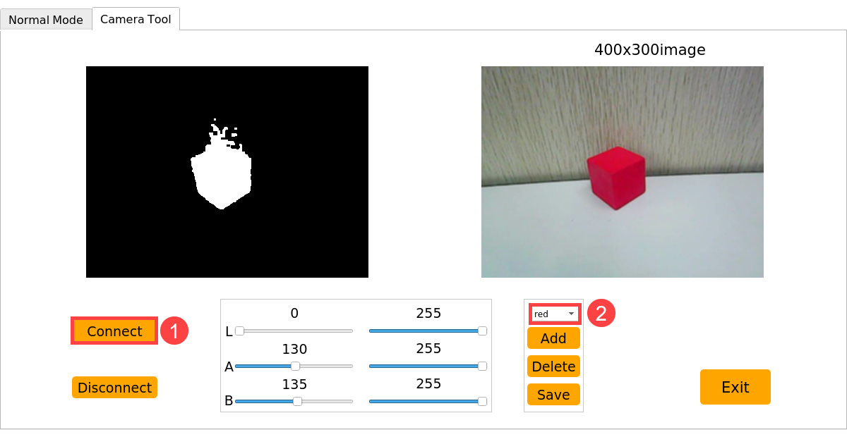

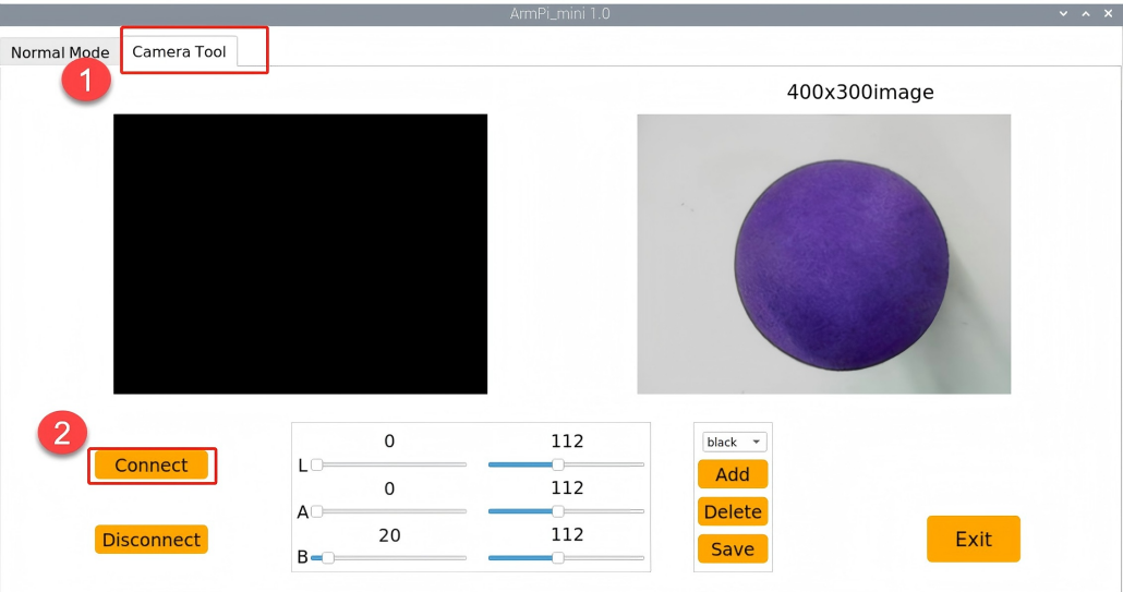

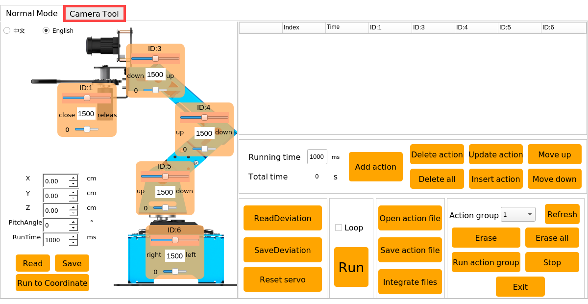

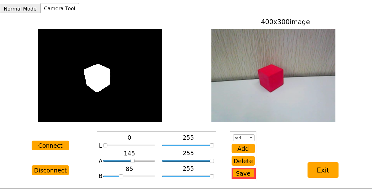

(1) Double click loading and select “Execute” in the pop-up window.
loading

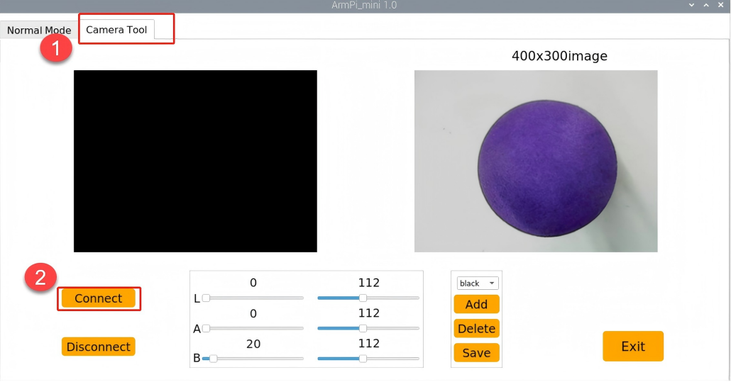

(2) Then select “Camera Tool” and “Connect” in sequence.
loading

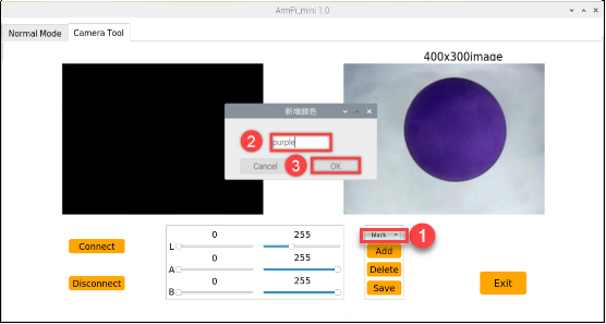

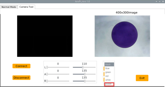

(3) Click “Add” and name the new color. Take “purple” as example. Then click “OK”.
loading

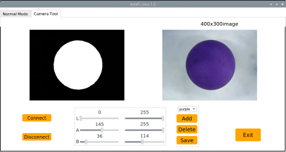

(4) Select “purple” in the drop-down list of the color selection.
loading

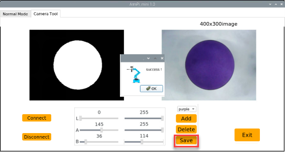

(5) Point camera at the purple object, and drag L, A and B slider to adjust value until the recognized color turns white and other area colors turns block in the left side.
loading
(6) Finally, click “Save”.
loading

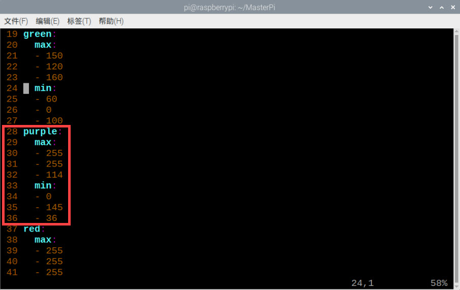

(7) Check whether the modified value is written into program. Enter command and press “Enter” to access to the program directory.
cd ArmPi_mini/yaml/
(8) Enter command and press “Enter” to open program file.
sudo vim lab_config.yaml

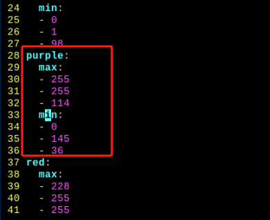

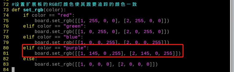

(9) After opening the color threshold program, you can check the threshold parameter of purple.
loading

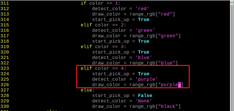

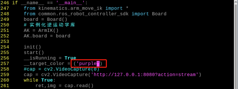

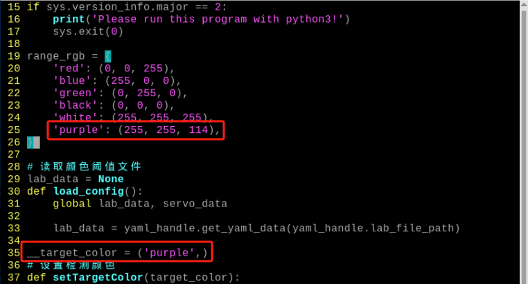

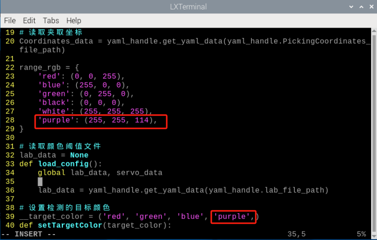

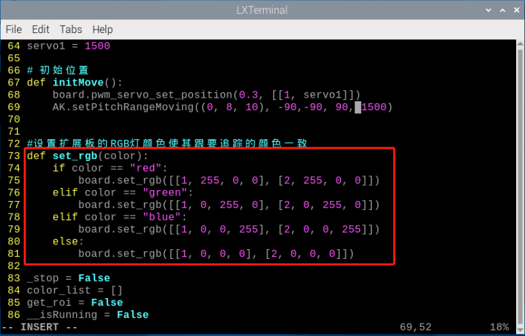

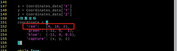

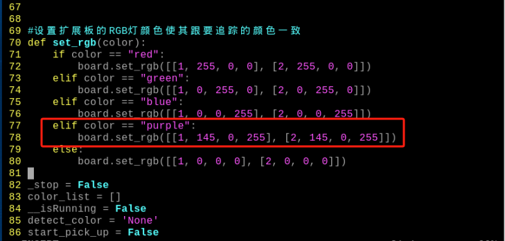

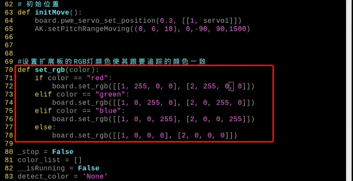

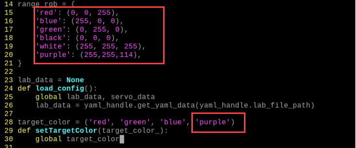

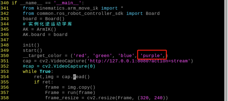

(10) Find the following code.

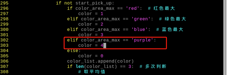

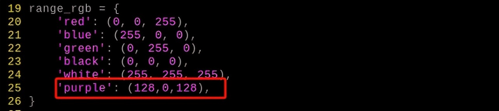

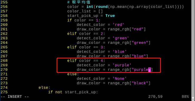

(11) Enter 'purple': (255, 255, 114) and 'purple'. The (255, 255, 114) is the RGB value of the purple. The sequence of RGB needs to be swapped to BGR. Therefore, the value of purple does not change. Please use RGB color reader to check it.

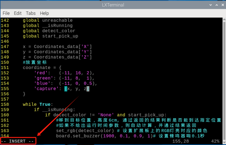

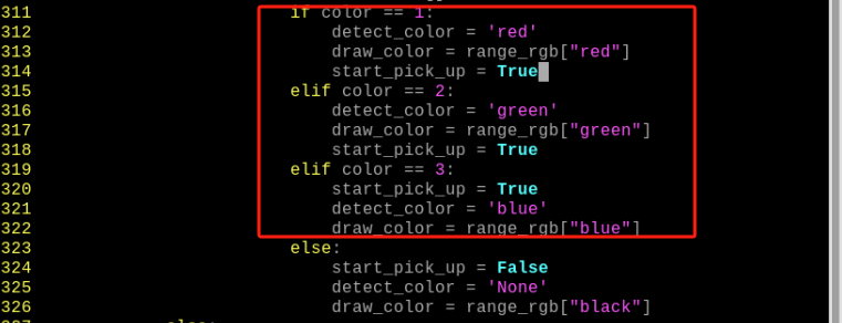

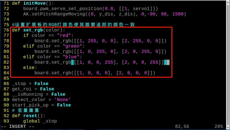

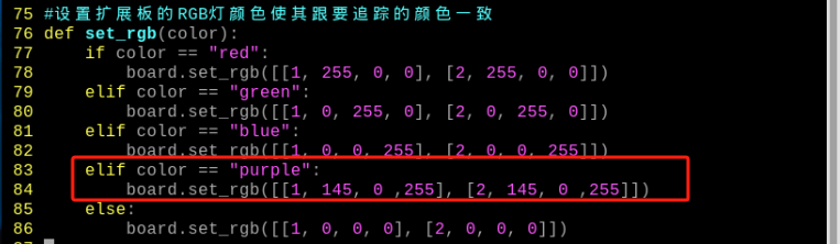

(12) Find the following code.
(13) Enter the content of the following red frame to set the RGB light on the expansion board to purple, as the figure shown below.
(14) Save the modified content. Press “Esc” and enter “:wq”, and then press “Enter” to save and close the file.

(2) Enter the command to navigate to the directory where the demo program is located.
(3) Enter the command of running the program , and press “Enter” to start the game.
python3 color_detect.py
(4) To close the program, press “Ctrl+C” in the LX terminal interface. If the program cannot be closed successfully, repeat this operation until it exits.
4.2.3 Project Outcome
Firstly, start game. After recognition, robot arm will give corresponding feedback according to the recognized color. The effect is shown in the following list.
Object color Buzzer RGB light Action Printed content
Red Make a "Di" sound Red Nod red
Green Make a "Di" sound Green Shake head green
Blue Make a "Di" sound Blue Shake head blue

The source code of program is located in:/home/pi/ArmPi_mini/functions/color_detect.py
  • Import Function Library
 2
#!/usr/bin/python3
# coding=utf8
import sys
import cv2
import time
import math
import threading
import numpy as np
import common.misc as Misc
import common.yaml_handle as yaml_handle
276
277
278
279
280
281
282
if __name__ == '__main__':
    from kinematics.arm_move_ik import *
    from common.ros_robot_controller_sdk import Board
    board = Board()
    # 实例化逆运动学库(instantiate the inverse kinematics library)
    AK = ArmIK()
    AK.board = board
Import the libraries related to OpenCV, time, math, threads and inverse kinematics. If want to call a function in library, you can use library name+function name (parameter, parameter). For example,
    board = Board()
    AK = ArmIK()
    AK.board = board
    init()
    start()

                    frame_mask = cv2.inRange(frame_lab,
                                                 (lab_data[i]['min'][0],
                                                  lab_data[i]['min'][1],
                                                  lab_data[i]['min'][2]),
                                                 (lab_data[i]['max'][0],
                                                  lab_data[i]['max'][1],
                                                  lab_data[i]['max'][2]))  #对原图像和掩模进行位运算(perform bitwise operation on the original image and the mask)
The first parameter frame_lab is the input image.
The second parameter (lab_data[i]['min'][0],lab_data[i]['min'][1],lab_data[i]['min'][2]) is the lower limit of color threshold.
The third parameter (lab_data[i]['max'][0],lab_data[i]['max'][1],lab_data[i]['max'][2]) is the upper limit of color threshold.

Find the largest contour in obtained contours. To avoid interference, set a minimum value and the target contour is effective when the area is greater than the set value.
227
228
229
230
231
                        if area_max > max_area:  # 找最大面积(find the maximum area)
                            max_area = area_max
                            color_area_max = i

(8) Determine Maximum Color
Use judgement statement to get the maximum color in a image.
239
240
241
242
243
244
245
246
247
248
249
250
251
252
253
254
255
256
257
258
259
260
261
262
263
264
265
266
267
268
269

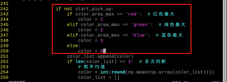

                if not start_pick_up:
                        color = 1
                        color = 2
                        color = 3
                        color = 0
                    if len(color_list) == 3:  # 多次判断(multiple judgements)
                        # 取平均值(get mean)
                        color = int(round(np.mean(np.array(color_list))))
                        color_list = []
                        start_pick_up = True
                        if color == 1:
                            detect_color = 'red'
                            draw_color = range_rgb["red"]
                        elif color == 2:
                            detect_color = 'green'
                            draw_color = range_rgb["green"]
                        elif color == 3:
                            detect_color = 'blue'
                            draw_color = range_rgb["blue"]
                            detect_color = 'None'
                            draw_color = range_rgb["black"]
                    draw_color = (0, 0, 0)
                    detect_color = "None"
  • Execute Feedback
The robot arm movement function move() is executed as a child thread. When color is recognized, the move() function is executed. It mainly determine the image processing result, and then execute the feedback including RGB light, buzzer, a single servo and multiple servos control.
129
130
131
132
133
134
135
136
137
138
139
140
141
142
143
144
145
146
147
148
149
150
151
152
153
154
155
156
157
158
159
160
161
162
163
164
165
166
167
168
169
170
171
172
173
174
175
176
177
178
179
# 机械臂移动函数(function for the robotic arm's movement)
def move():
    global _stop
    global __isRunning
    global detect_color
    global start_pick_up
        if __isRunning:
            if detect_color != 'None' and start_pick_up:  # 如果检测到方块没有移动一段时间后,开始夹取(if the block is detected no moving for a period, the robotic arm starts to grip)
                set_rgb(detect_color)
                board.set_buzzer(1900, 0.1, 0.9, 1)# 设置蜂鸣器响0.1秒(set the buzzer to sound for 0.1s)
                if detect_color == 'red' : # 识别到红色,机械臂点头(if red is detected, the robotic arm nods its head)
                    for i in range(0,3):
                        board.pwm_servo_set_position(0.2, [[3, 800]])
                        time.sleep(0.2)
                        board.pwm_servo_set_position(0.2, [[3, 600]])
                        time.sleep(0.2)
                        if not __isRunning:
                            continue
                    AK.setPitchRangeMoving((0, 6, 18), 0,-90, 90, 500)  # 回到初始位置(return to initial position)
                    time.sleep(0.5)
                    start_pick_up = False
                else: # 否则识别到其他颜色,绿色和蓝色,机械臂摇头(if green and blue are detected, it shakes its head)
                        board.pwm_servo_set_position(0.4, [[6, 1300]])
                        time.sleep(0.3)
                        board.pwm_servo_set_position(0.4, [[6, 1700]])
                        time.sleep(0.3)
                        if not __isRunning:
                            continue
                    time.sleep(0.5)
                time.sleep(0.01)
            if _stop:
                _stop = False
                initMove()  # 回到初始位置(return to initial position)
                time.sleep(1.5)
            time.sleep(0.01)
(1) The RGB color is consistent with the recognized color.
70
71
72
73
74
75
76
77
#设置扩展板的RGB灯颜色使其跟要追踪的颜色一致(set the color of the RGB light on the expansion board to match the color to be tracked)
def set_rgb(color):
    if color == "red":
        board.set_rgb([[1, 255, 0, 0], [2, 255, 0, 0]])
    elif color == "green":
        board.set_rgb([[1, 0, 255, 0], [2, 0, 255, 0]])
    elif color == "blue":
        board.set_rgb([[1, 0, 0, 255], [2, 0, 0, 255]])
        board.set_rgb([[1, 0, 0, 0], [2, 0, 0, 0]])
(2) Drive Buzzer
141
The code board.set_buzzer(1900, 0.1, 0.9, 1) calls a function calledset_buzzer(), which sets the buzzer to sound for 0.1 seconds. This is used to control the sound effect and duration of the buzzer.

4.2.5 Function Extension
  • Change default recognition color
There are three built-in recognition colors in program including red, green and blue. When recognizing red, the robot arm will nod.
Here take changing the default recognition color to green for example. The specific operation steps are as follow.
(1) Enter command and press “Enter” to enter the source code directory.
(2) Then enter command and and press “Enter” to open the program file.
sudo vim color_detect.py
(3) Find the following code:
After entering the line number of the code, press “Shift+G” to go to the corresponding position. (The line number of the code shown in the figure is for reference only, please refer to the actual situation.)
(4) Press “i” to enter the editing mode.
(5) Change “red” to “green” in detect_color == 'red', as the figure shown below.
(6) Then save the modified content. Press “Esc” and enter “:wq”, and press “Enter” to save and close the program file.
:wq
(7) Enter command again, and press “Enter” to start game.
  • Add new recognition color
In addition to the built-in color, you can add new recognition color. For example, add yellow as a new recognition color. The specific operation steps are as follow.
(1) Double click and select “Execute” in the pop-up window.
(2) Then select Camera Tool and Connect in sequence.
loading
(3) Click Add and name the new color. Take purple as example. Then click OK.
loading
loading
loading
loading
cd ArmPi_mini/yaml/
loading
(10) Refer to the steps 1-2 in “4.2.5 Function Extension -> Change default recognition color” to open the program file, and press “i” to enter the editing mode.
(12) Enter 'purple': (128, 0, 128) and 'purple'. The (128, 0, 128) is the RGB value of the purple. The sequence of RGB needs to be swapped to BGR. Therefore, the value of purple does not change. Please use RGB color reader to check it.
(13) Find the following code.
(14) Enter the content of the following red frame to set the RGB light on the expansion board to purple, as the figure shown below.
(15) Find the following code.
(16) Enter the content of the following red frame, as the figure shown below.
(17) Find the following code.
(18) Enter the content of the following red frame, as the figure shown below.
(19) Save the modified content. Press “Esc” and enter “:wq”, and then press “Enter” to save and close the file.
:wq
(20) Then refer to the steps in “4.2.2 Start and Close the Game” to start game. Position a purple object in camera frame, and then robot arm will shake its head. If want to control the robot to nod when recognizing purple, you can refer “4.2.5 Function Extension -> Change Default Recognition Color” to change the default color to purple.
(21) If you want to add other recognition colors, please refer to the operation steps above.
4.3 Position Detection
4.3.1 Program Description
The logic of color sorting is to locate block and print the location coordinate in terminal. This process includes color recognition and target position detection.
The first part is color recognition. Perform Gaussian filter first to reduce noises of image. Convert the object color through Lab color space. You can refer to the content in folder “OpenCV Basic Lesson/3. Color Space Learning” to learn about Lab color space
Recognize the color of the object in circle through color threshold. Then perform masking on image. Mask is to hide the whole or part of the processing image with the designated image, figure or object.
Next, process the image of the object with opening and closing operations. Find and circle the maximum contour, and then recognize the object in circle by the color threshold. The opening operation erodes an image and then dilates the eroded image. Opening is useful for removing small objects and thin lines from an image while preserving the shape and size of larger objects in the image. It can remove small particles of noise and break the adhesion between objects.
The closing operation dilates an image and then erodes the dilated image. Closing is useful for filling small holes in an image while preserving the shape and size of large holes and objects in the image.
The second part is to detect the object position. According to the minimum enclosing circle of object, obtain its origin coordinate, e,i., the position of rge target color.
4.3.2 Start and Close the Game
The input command should be case sensitive, and “Tab” can be used to complement keywords.

  • Main Function Analysis
The python program __name__ == '__main__:' is the main function of program. Firstly, the function “init()” is called to initialize. The initialization in this program includes: return the robot arm to the initial position and read the color threshold file. Generally there are also configurations for ports, peripherals, timing interrupts, etc., which are all done in the process of initialization.
106
107
108
109
110
111
112
113
114
    board = Board()
    AK = ArmIK()
    AK.board = board
    initMove()

The default tracking color is red. Here the default color will be changed to blue for example.
(1) If you want to change the tracking color, enter command and press “Enter” to enter the source code directory.
(2) Then enter command and press “Enter” to open the program file.
sudo vim position_detection.py
After entering the line number of the code, press “Shift+G” to go to the corresponding position. The line number of the code shown in the figure is for reference only, please refer to the actual situation.
(4) Press “i”. When the word “Insert” appears, it means the program has entered the editing mode.
(5) Change “red” to “blue” in __target_color = ('red',), as the figure shown below.
Then save the modified content. Press “Esc” and enter “:wq” (Do not miss the “:” before “wq”.), and press “Enter” to save and close the program file.
(6) Then save the modified content. Press “Esc” and enter “:wq” (Do not miss the “:” before “wq”.), and press “Enter” to save and close the program file.
:wq

4.4.3 Project Outcome
The default tracking color is red in program. After starting game, ArmPi mini will move with the red block.

  • Adjust Color Threshold
If the effect of color recognition is not good enough, you need to adjust the color threshold. Take adjusting red for example and other colors are set based on the same method. The operation steps are as follow:
(1) Double click icon and select “Execute” in the pop-up window.
(2) After entering the interface, click “Camera Tool”.
(3) Then click Connect , and then select red in the lower right corner.
loading
(4) If the returned image does not appear in interface, it means the camera fails to connect. At this time, check the camera whether is connected. The right side of the interface is the real-time returned image and the left side is the color to be recognized. Aim camera at the red block, and then drag the sliders until the red at the left side turns white and other colors turn black. Finally, click “Save”.
loading
  • Modify Tracking Color
(1) If want to change the tracking color, enter command “cd MasterPi/functions/” and press “Enter” to enter the source code directory.
(2) Then enter command “sudo vim color_tracking.py” and press “Enter” to open the program file.
(5) Change “red” to “blue” in “__target_color = (‘red’,)”, as the figure shown below.
The color after modification must be one of the colors in color selection bar. If want to change to other colors, please refer to “4.4.5 Function Extension -> Add Recognition Color” to add new recognition color.
(6) After modifying, press “Esc”. Then input “:wq” and press “Enter” to save and close the file.
:wq
  • Add Recognition Color
In addition to the built-in color, you can add new recognition color. For example, add purple as a new recognition color. The specific operation steps are as follow.
(1) Double click and select Execute in the pop-up window.
loading
(3) Click “Add” and name the new color as “purple”. Then click “OK”.
loading
(4) Select “purple” in the drop-down list of the color selection bar.
loading
loading
loading
(7) Check whether the modified value is written into program. Enter command “cd ArmPi_mini/yaml/” and press “Enter” to access to the program directory.
cd ArmPi_mini/yaml/
(8) Enter command “sudo vim lab_config.yaml” and press “Enter” to open program file.
(9) After opening the color threshold program file, you can check the threshold parameter of purple.
loading
(10) Refer to the steps 1-2 in “4.4.5 Function Extension -> Modify Tracking Color” to open the program file, and press “i” to enter the editing mode.
(11) Find the following code.
(12) Enter ‘purple’: (255, 255, 114), and change “red” to “purple”, as the figure shown below:
The parameter (255, 255, 114) is the maximum value of purple threshold parameter checked in step 9.

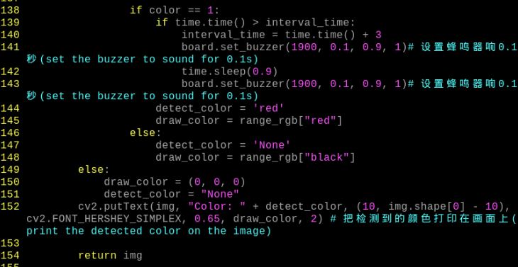

(14) Add the content in red frame, as the figure shown below.
(16) Change “red” to “purple”, as the figure shown below:
(17) Save the modified content. Press “Esc” and enter “:wq”, and then press “Enter” to save and close the file.
:wq

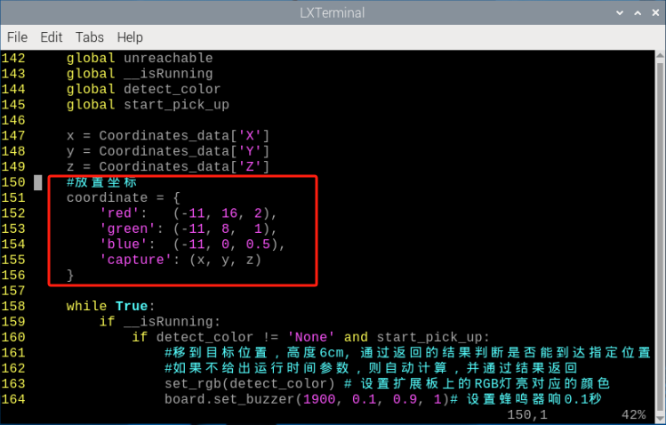

(18) Then refer to the steps in “4.4.2 Start and Close the Game” to start game. Position a purple object in camera frame, and then robot arm will track and move with the target. If you want to add other recognition colors, you can refer “4.4.3 Add Recognition Color” to add new recognition color.

Before starting color sorting, please make sure that ArmPi mini has been completely configured according to the content in “1.Getting ready -> 1.8 Deviation Adjustment” to adjust deviation and calibrate position and place map, otherwise it may influence the game effect.
4.5.1 Project Description
The logic of color sorting is to recognize and distinguish color, and then control robot arm to sort the colored blocks. This realization process includes color recognition and color sorting.
The first part is color recognition. Perform Gaussian filter first to reduce noises of image. Convert the object color through Lab color space. (You can refer to the content in folder “OpenCV Basic Lesson/7.Color Space Learning” to learn about Lab color space)
Recognize the color of the object in circle through color threshold. Then perform masking on image. (Mask is to hide the whole or part of the processing image with the designated image, figure or object.)
The second part is color sorting. Firstly, robot arm uses the AK.setPitchRangeMoving() fucntion to calculate the servo angle at the target position. Next, control the gripper. Then pick the target color based on the recognized the recognized color and move them to the corresponding area one by one. Regarding the inverse kinematics, please refer to “3. Basic Motion Lesson -> 3.1 What is Inverse Kinematics”.
4.5.2 Start and Close the Game
The input command should be case sensitive.
(2) Click in the upper left corner (as the figure shown below), or press “Ctrl+Alt+T” to open LX terminal.
(3) Enter command and press “Enter” to access to the directory of game program.
(4) Enter command and press “Enter” to start game.
python3 color_sorting.py
4.5.3 Project Outcome
Place red, green and blue blocks on a flat and smooth surface. When the block is recognized, ArmPi mini will beep. Then position the recognized block in front of the gripper, and robot arm will grip the block and move it to the corresponding position in the left side.
4.5.4 Program Analysis

The python program __name__ ==  '__main__:' is the main function of program. Firstly, the function init() is called to initialize. The initialization in this program includes: return the robot arm to the initial position, read the color threshold file. Generally there are also configurations for ports, peripherals, timing interrupts, etc., which are all done in the process of initialization.
332
333
334
335
336
337
338
339
340
341
    board = Board()
    AK = ArmIK()
    AK.board = board
    init()
    start()

            if max_area > 500:  # 有找到最大面积(the maximum area has been found)
                (center_x, center_y), radius = cv2.minEnclosingCircle(areaMaxContour_max)  # 获取最小外接圆(get the minimum circumscribed circle)
                center_x = int(Misc.map(center_x, 0, size[0], 0, img_w))
                center_y = int(Misc.map(center_y, 0, size[1], 0, img_h))
                radius = int(Misc.map(radius, 0, size[0], 0, img_w))
                cv2.circle(img, (int(center_x), int(center_y)), int(radius), range_rgb[color_area_max], 2)
                        color = 1
                        color = 2
                        color = 3
                        color = 1
                        color = 2
                        color = 3
                        color = 0
                        # 取平均值(get mean)
                        color_list = []
                        if color == 1:
                        elif color == 2:
                        elif color == 3:
  • Execute Feedback
138
139
140
141
142

(1) RGB Light On
71
72
73
74
75
76
77
78
79
80
def set_rgb(color):
    if color == "red":
(2) Drive Buzzer
164
The code board.set_buzzer(1900, 0.1, 0.9, 1) calls a function called set_buzzer(), which sets the buzzer to sound for 0.1 seconds. This is used to control the sound effect and duration of the buzzer.

4.5.5 Function Extension
The effect of color sorting in program defaults to recognize red, green and three blocks, and then pick and transport it to the corresponding position in the left side. If want to change the block placement position, you need to learn about the coordinate of robot arm. The coordinate of robot arm is shown below (take robot arm as the first person view):
loading
The corresponding relationship between placement position and coordinate parameter:
Coordinate Parameter Block Position
x increases The block moves to the right along x axis.
x decreases The block moves to the left along x axis.
y increases The block moves forward along y axis.
y decreases The block moves backward along y axis.
z increases The block moves up along y axis.
z decreases The block moves down along y axis.
The parameter z must be greater than 0.
Here the program will be changed to place the block in front of robot arm. The method is applicable to change other color. The specific operation steps are as follow:
sudo vim color_sorting.py
(5) In 'red': (-11,16,2), -11 is the x-axis parameter, 16 is the y-axis parameter, and 2 is the z-axis parameter. Here change -12 to 0 and keep the y-axis and z-axis parameters unchanged to make the block place in front of the robot, as the figure shown below:
(6) Then find and comment the following code. (Add “#” in front of the code.)
(7) Then save the modified content. Press “Esc” and enter “:wq”, and press “Enter” to save and close the program file.
:wq
(8) Enter command again, and press “Enter” to start game.
    board = Board()
    AK = ArmIK()
    AK.board = board
    init()
                        color = 1
                        color = 2
                        color = 3
                        color = 3
                        color = 0
def move():
    global _stop
    global get_roi
    global number
    global __isRunning
    global detect_color
    x = Coordinates_data['X']
    y = Coordinates_data['Y']
    z = Coordinates_data['Z']
    coordinate = {
        'capture': (x, y, z),       # 夹取坐标(gripping coordinate)
        'place': (12, 0, 0.5), # 放置坐标(placing coordinate)
        if __isRunning:
                set_rgb(detect_color) # 设置扩展板上的RGB灯亮对应的颜色(set the RGB light on the expansion board to light corresponding color)
                board.pwm_servo_set_position(0.5, [[1, 2000]])# 张开爪子(open gripper)
                time.sleep(0.6)
                if not __isRunning: # 检测是否停止玩法(detect if the game is stopped)
                    continue
                AK.setPitchRangeMoving((coordinate['capture']), -90,-90, 90, 1000) # 机械臂运行到夹取位置(robotic arm runs to the gripping position)
                time.sleep(1) # 延时1秒(delay for 1s)
                if not __isRunning:
                    continue
                board.pwm_servo_set_position(0.5, [[1, 1450]])# 闭合爪子(close the gripper)
                time.sleep(0.6)
                if not __isRunning:
                    continue
                AK.setPitchRangeMoving((0, 6, 18), 0,-90, 90, 1500) # 抬起机械臂(uplift the robotic arm)
                time.sleep(1.5)
                if not __isRunning:
                    continue
                board.pwm_servo_set_position(0.5, [[6, 1500]])# 先把机械臂转过去(rotate the robotic arm to the position first)
                time.sleep(1.5)
                if not __isRunning:
                    continue
                if not __isRunning:
                    continue
                AK.setPitchRangeMoving((coordinate['place'][0], coordinate['place'][1],12), -90,-90, 90, 800) # 机械臂运行到夹取位置上方(run the robotic arm to the top of the gripping position)
                time.sleep(0.8)
                if not __isRunning:
                    continue
(1) RGB Light On
71
72
73
74
75
76
77
78
79
80
def set_rgb(color):
    if color == "red":
loading
loading
loading
(5) Point camera at the purple object, and drag L, A and B slider to adjust value until the recognized color turns white and other area colors turns black in the left side.
loading
loading
cd ArmPi_mini/yaml/
(10) Enter command and press “Enter” to enter the source code directory.
(11) Then enter command and press “Enter” to open the program file.
sudo vim color_palletizing.py
(12) Find the following code:
(13) Input 'purple':(255, 255, 114) and 'purple', as the figure shown below:
The parameter (255, 255, 144) is the maximum value of purple threshold parameter.
(14) Find the following code.
(15) Enter the content of the following red frame, as the figure shown below.
(16) Find the following code.
(17) Enter the content of the following red frame, as the figure shown below.
(19) Find the following code.
(20) Enter the content of the following red frame, as the figure shown below.
