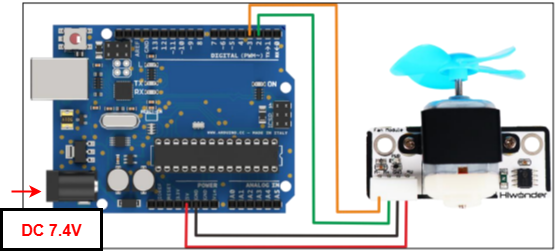

2.1.1 Wiring Instruction
This section illustrates connecting a 4-pin cable to the A2 and A3 ports on the Arduino expansion board. Refer to the diagram below.
If you do not have an Arduino expansion board, use a Dupont wire to directly connect to the Arduino development board, just as below:
  • If the battery is not connected to the cables, do not connect the cable ends directly together. Doing so may cause a short circuit and damage the system.
  • Before powering on, ensure that no metal objects are touching the controller. Otherwise, the exposed pins at the bottom of the board may cause a short circuit and damage the controller.
