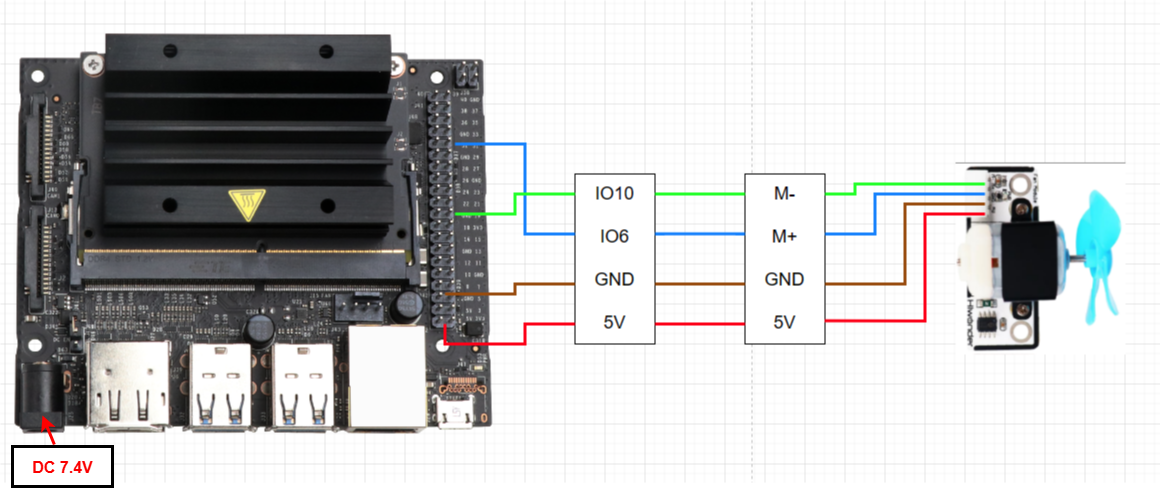

4.1.1 Wiring Instruction
This section uses DuPont wires to connect fan modules. For wiring instructions, refer to the figure below:
Connection diagram
Item Pin Motor Connection Type Item Pin
Jetson Nano IO10 Dupont wire Fan Module M-
Jetson Nano IO6 Dupont wire Fan Module M+
Jetson Nano GND Dupont wire Fan Module GND
Jetson Nano 5V Dupont wire Fan Module 5V
Before powering on, ensure that no metal objects are touching the controller. Otherwise, the exposed pins at the bottom of the board may cause a short circuit and damage the controller.
