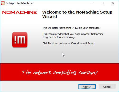

2. NoMachine installation
NoMachine is a graphical software for remote controlling. After connecting the computer to the Wi-Fi created by Jetson Nano, we can directly control the Jetson Nano on our computer. Next, I will show you how to install this software in several steps.
  1. Double click the “nomachine_8.4.2.exe” file in this folder, then click “Next

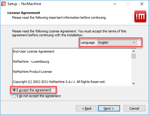

  1. Tick “I accept the agreement” and set the language as English.
  1. Select the folder to install the software, then click “Next”.

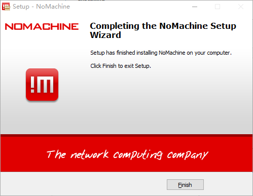

  1. Wait to finish. Later on, the finishing prompt will pop up, then click “Finish”.
  1. After the installation is completed, click “Yes” to restart the computer in the pop-up window. Please don’t skip this step!

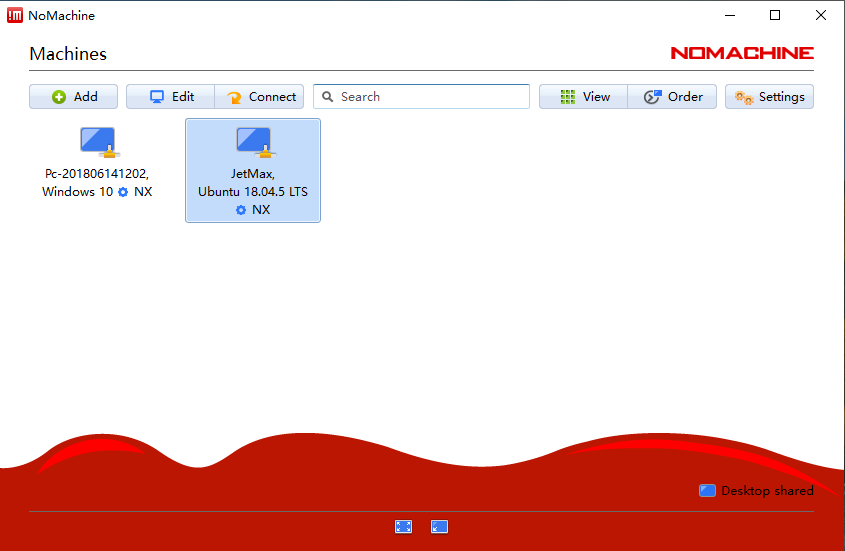

  • Device connection
  1. Switch on JetMax. As the JetMax boots up successfully, it will create a Wi-Fi starting with HW. And you can search this Wi-Fi on your computer.
  1. Having connected, back to the NoMachine interface and double click the JetMax icon. Or you can enter “192.168.149.1” in the search box to login.

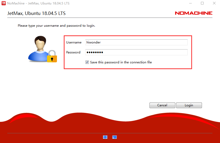

  1. The prompt will pop up to ask you to enter the Username and Password. The username is “hiwonder” and password is “hiwonder”. After entering, tick “Save this password” and click “Login”. Later, keep clicking “OK” in the subsequent pop-up windows, then the Jetson Nano desktop will show up.

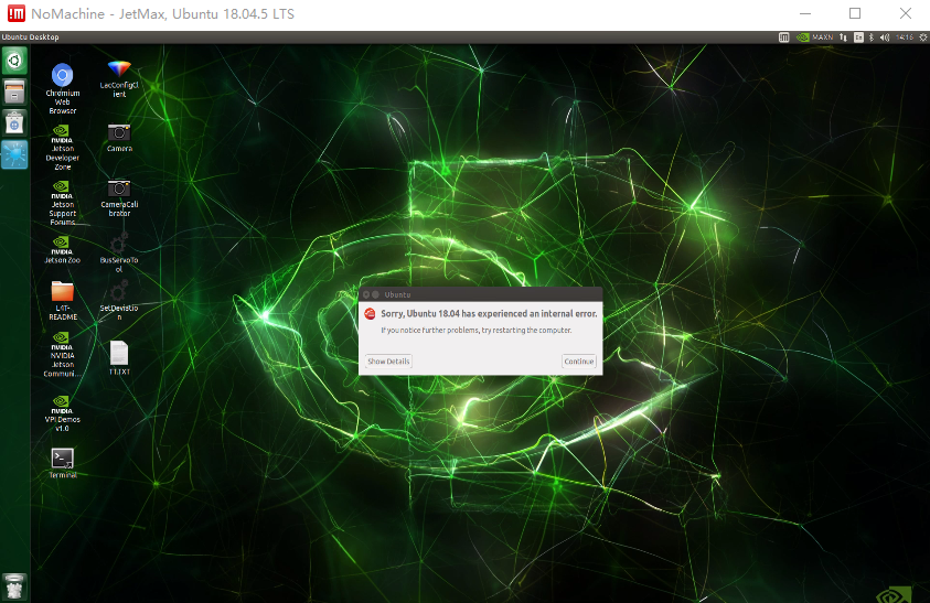

  1. If the warning dialog box occurs, just click “Cancel”. This is normal phenomenon. If black screen occurs, you can try to reboot up the Jetson Nano.

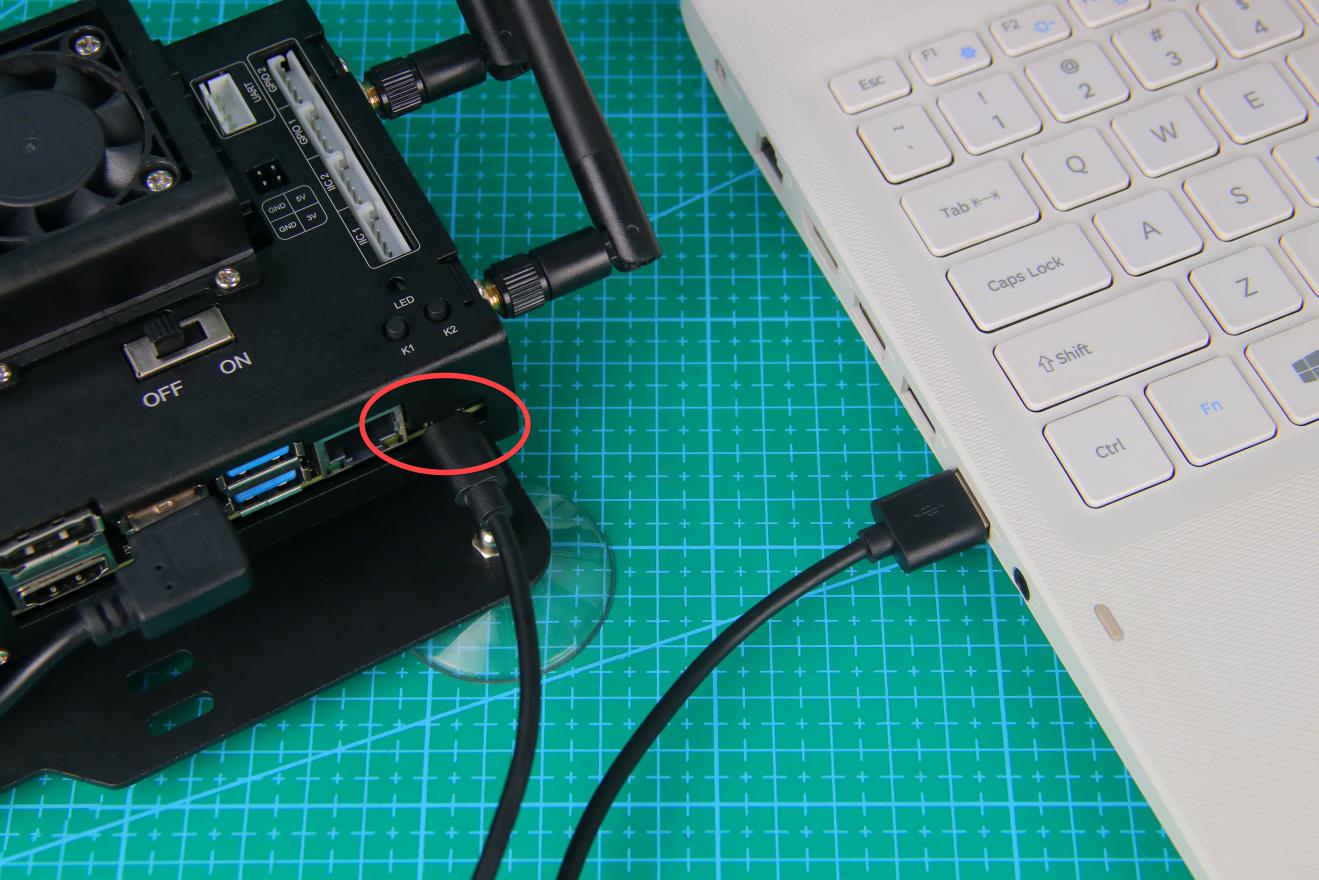

  1. Connect the controller to the computer with the Android cable.

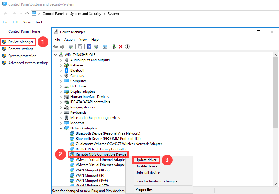

  1. Next, install the NDIS driver. Right click “Computer” and select “Attribute”. Then click “Device Manager” to find the NDIS driver and select “Update driver”.
  1. After the update is complete, follow step 3.1.1 Remote Tool Installation and Connection->Device Connection to log in to the system.

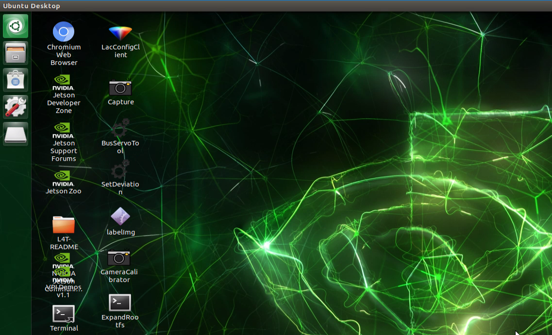

  • Desktop layout
The remote Jetson Nano system desktop is as follow.
These 6 icons need to be focused on.
Icon Function
Color value adjustment tool
Collect data
Set servo angle
Set servo deviation
Calibrate the camera
Command line terminal for entering the command

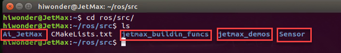

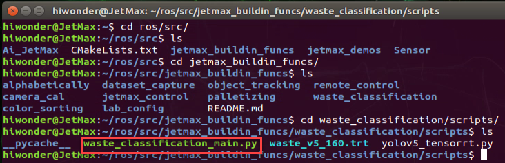

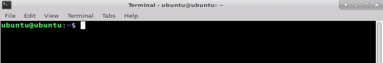

  1. Click to open terminal.
  1. Enter command “cd ros/src/” to enter the src folder.
cd ros/src/

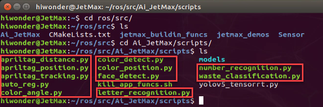

  1. Enter “ls” command and press “Enter” to list all the files. And we mainly focus on these three directories.
Name Function
Ai_JetMax Program for robotic arm individual controlling
jetmax_buildin_funcs Robotic arm APP controlling program
jetmax_demos Program for robotic arm individual controlling
Sensor Control program of Jetson Nano expansion board and external sensor/ module
  1. Next, enter the directory of games and program source codes. In Ai_JetMax directory, enter “cd Ai_JetMax/scripts/” command. Then enter “ls” command to list all the folders and files in this directory. The files in red frame are game files.

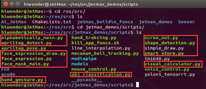

  1. In jetmax_demos directory, enter command “cd jetmax_demos/scripts/”. Then enter “ls” command to list all the folders and files in this directory. The files in red frame are game files.
The games for each game file are listed below.
Game file
Games name
apriltag_detect.py
AprilTag recognition
ApriTag recognition
visual_calculator.py
numerical calculation
numerical calculation experiment
shape_detection.py
shape recognition
face_expression.py
emotion recognition
hand_gesture.py
gesture recognition
smart_store.py
smart warehousing
face_expression_draw.py
emotion recognition and drawing
screw_nut.py
screw sorting
obj_classification.py
goods sorting
alphabetically_main.py
word spelling
face_mask_main.py
face mask recognition
simple_draw.py
Stick figure drawing
robotic arm draw stick figure
robotic arm draw expression
robotic arm write number

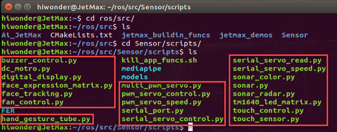

  1. In sensor directory, enter “cd Sensor/scripts/” command first. Then enter “ls” command to list all the files and folders in this directory. The files in the red frame are game files.
The game for each file is listed below.
File name Game
serial_servo_control.py Control rotation of serial bus servo
serial_servo_speed.py Adjust speed of serial bus servo
serial_servo_read.py Read state of serial bus servo
pwm_servo_control.py Control single PWM servo
pwm_servo_speed.py Control speed of servo
multi_pwm_servo.py Control multiple PWM servos
buzzer_control.py Control buzzer
dc_motor.py Control DC motor
serial_port.py Control serial port
fan_control.py Fan module experiment
sonar.py Control ultrasonic sensor
touch_sensor.py Touch sensor detection
m1640_led_matrix.py Dot matrix module display
digital_display.py Digital tube module display
face_tracking.py Fan tracking and control
sonar_radar.py Ultrasonic scan display
sonar_color.py Ultrasonic and AI recognition, control and picking
face_expression_matrix.py Emotion recognition and dot matrix display
hand_gesture_tube.py Gesture recognition and digital tube display
touch_control.py Touch control

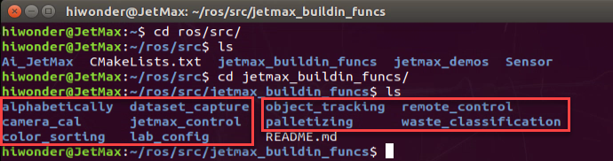

  1. In “jetmax_buildin_funcs” directory, enter “cd jetmax_buildin_funcs/” command, then enter “ls” command to check the folder storing different AI game files.
Enter the corresponding folder, then enter the scripts folder to find the corresponding game file. For example, enter waste_classification folder to find the game file of waste sorting.

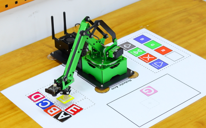

3.2 Waste Sorting
3.2.1 Program logic
The process of waste sorting is divided into two parts.
Step 1: recognize and sort
Firstly, subscribe to the real-time image data released by the camera node. Then covert this data to Numpy form. After that, input the image to yolov5 network for server operations, including scale, transpose, array expand, etc. After serial operations, the processing result will be obtained.
The obtained coordinate of the waste card will be converted to the original image coordinate. After the coordinate is converted and the waste name is recognized, the waste card will be classified according to the set rules and the category name of the waste will be gained. Next the waste will be framed, then its name and recognition credibility will be displayed.
Step 2: suck and place
Firstly, the waste card with highest recognition credibility will be the first to be sorted, then it will be framed with white box. When confirming the next waste card to be sorted, there is no need to compare the recognition credibility between these cards repeatedly. The waste card which is nearest to the first sorted target, is the next to be sorted. In order to ensure the result credibility, the target will be recognized repeatedly.
When the target is confirmed, the process of sorting and transferring will start. The pixel coordinate of the target card will be converted into the world coordinate. Then calculate the distance between the card position and sorting area to control the speed.
Calculate the angle of the robotic arm relative to the central axis and control the corresponding angle of the suction cup rotation. At last, control the robotic arm to pick the waste card, then suck and transfer it to the sorting area.
The source code of the program is located in /Home/ros/src/jetmax_buildin_funcs/waste_classification/ scripts/waste_classification_main.p
def camera_to_world(cam_mtx, r, t, img_points):
    inv_k = np.asmatrix(cam_mtx).I
    r_mat = np.zeros((3, 3), dtype=np.float64)
    cv2.Rodrigues(r, r_mat)
    # invR * T
    inv_r = np.asmatrix(r_mat).I  # 3*3
    transPlaneToCam = np.dot(inv_r, np.asmatrix(t))  # 3*3 dot 3*1 = 3*1
    world_pt = []
    coords = np.zeros((3, 1), dtype=np.float64)
    for img_pt in img_points:
        coords[0][0] = img_pt[0][0]
        coords[1][0] = img_pt[0][1]
        coords[2][0] = 1.0
        worldPtCam = np.dot(inv_k, coords)  # 3*3 dot 3*1 = 3*1
        # [x,y,1] * invR
        worldPtPlane = np.dot(inv_r, worldPtCam)  # 3*3 dot 3*1 = 3*1
        # zc
        scale = transPlaneToCam[2][0] / worldPtPlane[2][0]
        # zc * [x,y,1] * invR
        scale_worldPtPlane = np.multiply(scale, worldPtPlane)
        # [X,Y,Z]=zc*[x,y,1]*invR - invR*T
        worldPtPlaneReproject = np.asmatrix(scale_worldPtPlane) - np.asmatrix(transPlaneToCam)  # 3*1 dot 1*3 = 3*3
        pt = np.zeros((3, 1), dtype=np.float64)
        pt[0][0] = worldPtPlaneReproject[0][0]
        pt[1][0] = worldPtPlaneReproject[1][0]
        pt[2][0] = 0
        world_pt.append(pt.T.tolist())
    return world_pt
3.2.2 Preparation
  1. Please place the robotic arm on the map, then switch on it and calibrate its position. You can calibrate the robotic arm via the mobile APP. For the detailed instruction, you can refer to the 2. Quick User Experience. Then place the waste cards to the recognition area. Ensure the cards are not too close to each other and don’t place them to edge of the recognition area.
  2. Install and open the No Machine remote tool. For detailed instruction, you can refer to “3. AI Vision Games->3.1 Set Development Environment->3.1.1 Remote Tool Installation and Connection”.
3.2.3 Operation steps
The entered command should be case-sensitive. And the keywords can be complemented by the Tab key.
  • Enter the game
  1. Turn on JetMax, then connect to the system desktop through No Machine.
  2. Click .

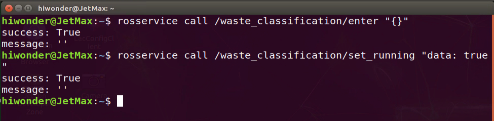

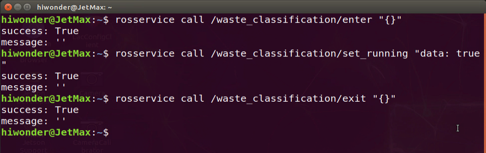

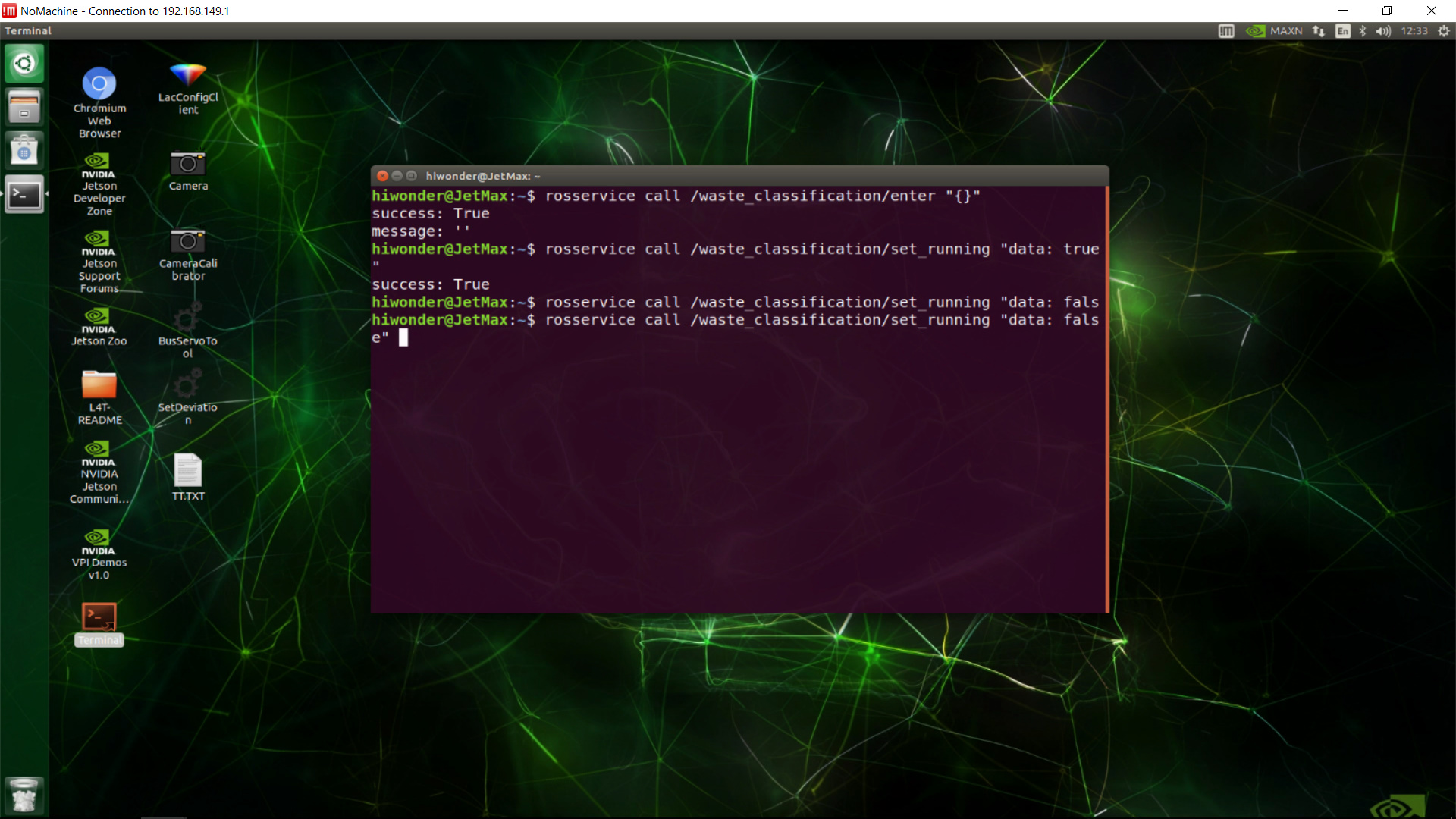

  3. Enter the game. Then enter command “rosservice call /waste_classification/enter “{}”” and press Enter.

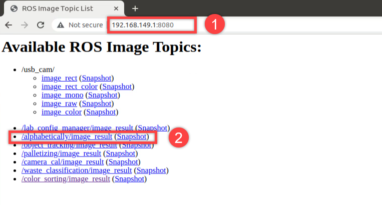

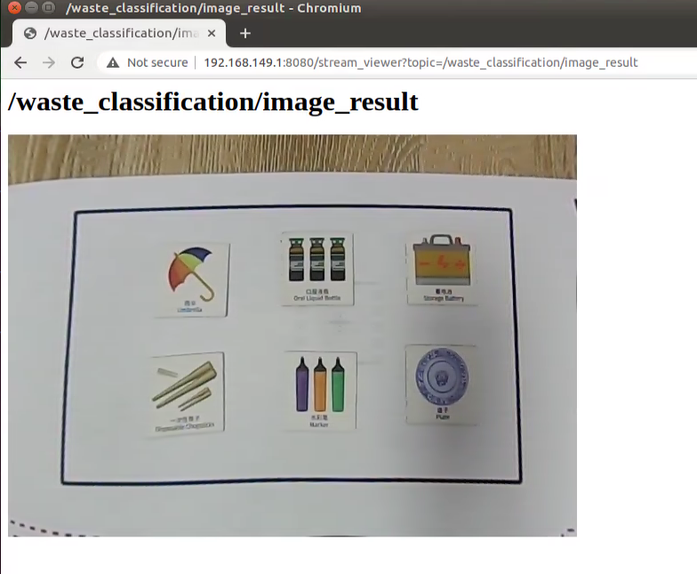

  • Turn on camera

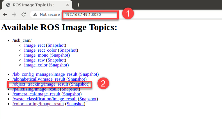

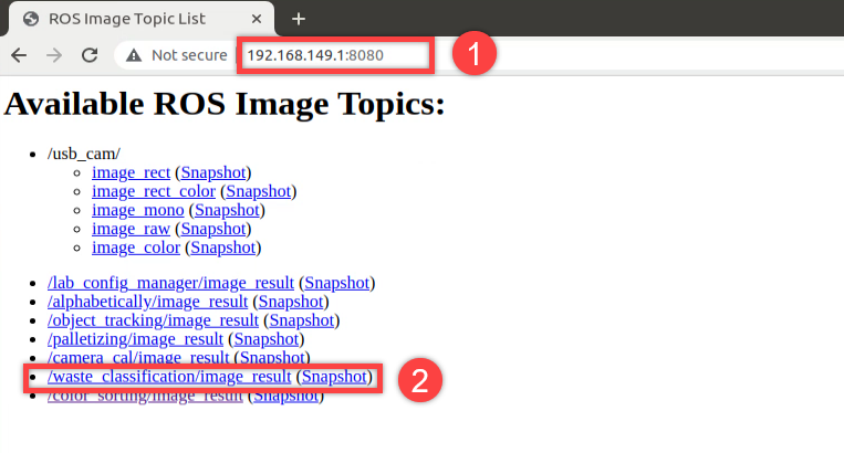

Turn on camera. Double click , then enter the address, 192.168.149.1:8080/ and press Enter. Next, select “/waste_classification/image_result(Snapshot)”.
  • Start the game
Start the game. Enter command “rosservice call /waste_classification/set_running “data: true”” and press Enter.

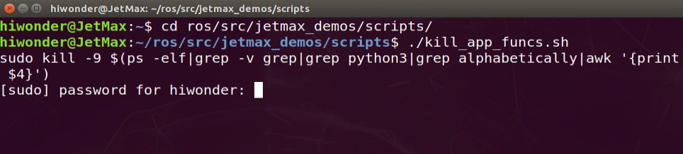

  • Stop and exit the game
  1. If you want to stop the game, you can enter command “rosservice call /waste_classification/ set_running “data: true”” and press Enter.
  1. If you want to exit the game, you can enter command “rosservice call /waste_classification/exit”{}”” and press Enter.
3.2.4 Function Realization
After the game starts, place the waste card to the recognition area. When the camera recognizes the waste card, the robotic arm will suck and transfer them to the corresponding area according to the card category.
Waste category Card
Hazardous_waste Storage Battery、Marker、Oral Liquid Bottle
Recyclable_waste Plastic Bottle, Umbrella, Toothbrush
Food_waste Banana Peel, Ketchup, Broken Bones
Residual_waste Cigarette End, Plate, Disposable Chopsticks

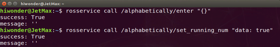

3.3.1 Program logic
The implementation process is divided into 2 parts.
Step 1: recognize
Firstly, we set the variable of state.running_mode to control the game mode. When the variable is set as 1, the program of alphabet sequencing will be executed.
Next, subscribe to real-time image data released by camera node and convert it into Numpy form. Then input the image to yolov5 network to scale, transpose and array expand so as to acquire the processed result.
Then, convert the recognized alphabet card coordinates into the origin image coordinates, frame the alphabet cards and display the alphabet.
Step: sequence and place the cards
Firstly, call min() function of python and make the alphabet card with smallest frame the first target to be sequenced. And the next target is the alphabet card which is the closest to the first target. To ensure the reliability, it is necessary to recognize the target for several times.
After the target is confirmed, the robotic arm will start sequencing and transferring. And convert the pixel coordinate of the target card into world coordinate for calculation between the current position of the cards and placing area so as to control the speed.
Lastly, calculate the angle of the robotic arm relative to the central axis and control the corresponding angle of the suction cup rotation. Control the robotic arm to suck and sequence the alphabet card in the placing area.
The source code of the program locates in /Home/ros/src/jetmax_buildin_funcs/alphabetically/
scripts/alphabetically_main.py

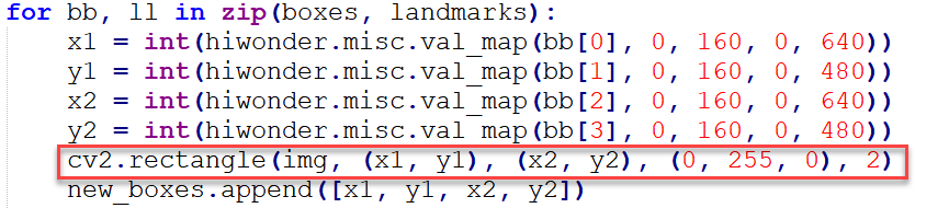

IMAGE_SIZE = 640, 480 # 输入图片尺寸
CHARACTERS_ENGINE_PATH = os.path.join(sys.path[0], 'characters_v5_160.trt') # 字母模型路径
CHARACTER_LABELS = tuple([i for i in 'ABCDEFGHIJKLMNOPQRSTUVWXYZ']) # 字母分类名称
CHARACTER_NUM = 26
NUMBERS_ENGINE_PATH = os.path.join(sys.path[0], 'numbers_v5_160.trt') # 数字模型路径
NUMBERS_LABELS = tuple([i for i in '0123456789+-*/=']) # 数字分类数值的名称
NUMBERS_NUM = 15 # 分类总个数
TRT_INPUT_SIZE = 160 # trt输入尺寸
# 随机颜色, 用于结果框出
COLORS = tuple([tuple([random.randint(10, 255) for j in range(3)]) for i in range(CHARACTER_NUM + NUMBERS_NUM)])

  • Enter the game
  1. Turn on JetMax and connect to the system desktop through NoMachine.
  2. Double click to open command line terminal.
  3. Enter command “rosservice call /alphabetically/enter “{}”” and press Enter to enter the game.
  • Turn on camera

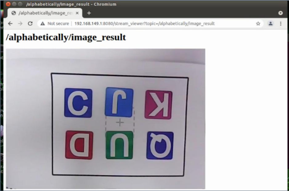

Double click . Then enter the address “192.168.149.1:8080/” in the address bar and press Enter. Next, select “/alphabetically/image_result(Snapshot)” to turn on camera.
  • Start the game.
  1. Enter command “rosservice call /alphabetically/set_running_char “data: true”” and press Enter to turn on the recognition check function to check whether the alphabet is recognized.
  1. Enter command “rosservice call /alphabetically/set_running_char “data: true”” again and press Enter to start sucking.
  1. We can enter this command “rosservice call /alphabetically/set_running_char “data: true”” continuously to turn on recognition check and sucking function.
Special note: in step 3, when you turn on the recognition check and sucking function, the robotic arm will continue to sequence the alphabet that follows. Only when we enter the command to stop the recognition check and the suction function, and then turn on the suction function, the robotic arm will start a new round of alphabet sequencing.

The source code of the program is located in /Home/ros/src/jetmax_buildin_funcs/color_sorting/
scripts/color_sorting_main.py

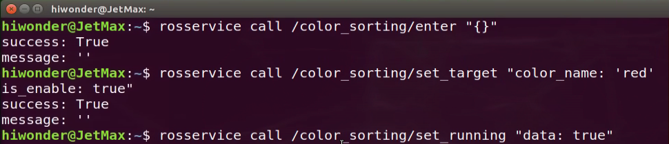

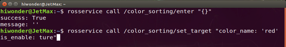

  3. Enter the game. Enter command “rosservice call /color_sorting/enter “{}”” and press Enter.
rosservice call /color_sorting/enter "{}"

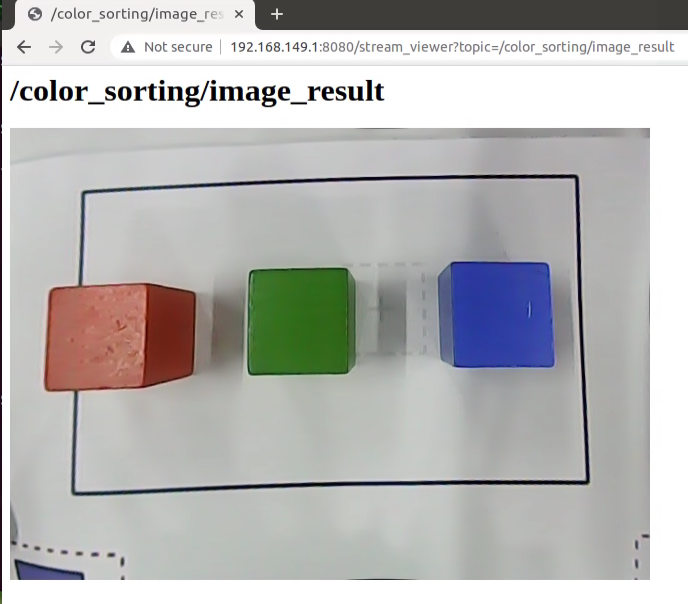

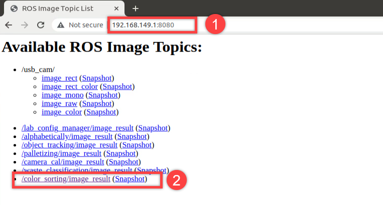

  • Turn on camera
Double click , then enter the address, 192.168.149.1:8080/ and press Enter. Next, select “color_sorting/image_result(Snapshot)”to turn on the camera.
  • Start the game
  1. Enter the command “rosservice call /color_sorting/set_target “color_name: ‘red’: is_enable: true”” and press Enter to set the target color. Here we set the target color as red.
  1. Enter command “rosservice call /color_sorting/set_running “data: true”” and press Enter to start the game.

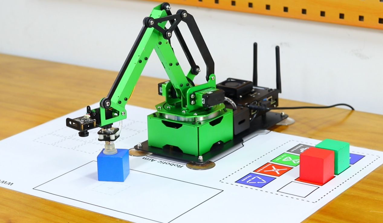

3.4.4 Function Realization
After the game starts, place the colored blocks to the recognition area. Then the robotic arm will pick the blocks in target color and place them to the corresponding sorting area.

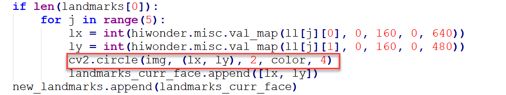

After the block is found, frame it and draw 5 dots on it to mark its position. The specific program is as follow.
	cv2.circle(img, (int(n_p1[0]), int(n_p1[1])), 2, (255, 255, 0), 10)
	cv2.circle(img, (int(n_p2[0]), int(n_p2[1])), 2, (255, 255, 0), 10)
	cv2.circle(img, (int(c_x), int(c_y)), 2, (0, 0, 0), 10)
cv2.circle(img, (int(ap[0]), int(ap[1])), 2, (0, 255, 255), 10)
cv2.drawContours(img, [box], -1, hiwonder.COLORS[color_name.upper()], 2)
cv2.circle(img, (int(center_x), int(center_y)), 1, hiwonder.COLORS[color_name.upper()], 5)
  1. use cv2.drawContours function to draw the contour of the block.
The first parameter img represents the specific block image of the drawn contour.
The second parameter [box] represents the contour itself.
The third parameters -1 represents the index of the contour.
The fourth parameter hiwonder.COLORS\[color_name.upper()\] represents the color of the drawn contour.
The fifth parameter 2 represents the width of the contour.
  1. Use cv2.circle function to draw 5 circles. Take cv2.circle(img, (int(n_p1[0]), int(n_p1[1])), 2, (255, 255, 0), 10) for example.
The first parameter img represents the specific block image of the drawn dots.
The second parameter (int(n_p1[0]), int(n_p1[1])) represents the center coordinate of the drawn circle.
The third parameter 2 represents the radius of the drawn circle.
The fourth parameter (255, 255, 0) represents the color of the drawn circle. The parameter consists of 3 values ranging from 0 to 255. This parameter represents that the font color is mixed with red , green and blue. The first value 255 represents red value. The second value 255 represents the green value and the third value 0 represents the blue value.
The fifth parameter 10 represents the width of the drawn circle. The lager the value, the wider the width.

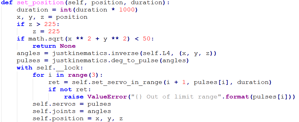

Control the robotic arm to move through setting the coordinate of the robotic arm. Then suck the block and adjust the block position.
        hiwonder.pwm_servo1.set_position(90 + angle, 0.1)
        jetmax.set_position((nn_new_x, new_y, 120), t)
        rospy.sleep(t)
        jetmax.set_position((new_x, new_y, 120), 0.3)
        rospy.sleep(0.4)
        sucker.set_state(True)  # 启动气泵,吸气
        jetmax.set_position((new_x, new_y, 85 - 5), 1)
        rospy.sleep(1.05)
        cur_x, cur_y, cur_z = jetmax.position
        jetmax.set_position((cur_x, cur_y, 180), 0.8)
        rospy.sleep(0.8)
        hiwonder.pwm_servo1.set_position(90, 0.1)
When controlling the robotic arm to rotate, call set_position program to convert the coordinate value of the robotic arm into the value of servo controlling. The program is as follow.

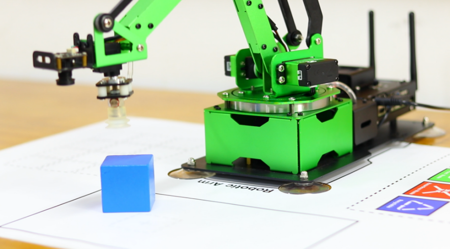

According to the color of the block, acquire the coordinate where the block is placed, and control the robotic arm to move to the corresponding position.
Sort red, green and blue block. According to different color name, we will obtain different color coordinate (x,y,z). Then convert the coordinate value of the robotic arm into the value of servo controlling. The program is as follow.
         (x,y, z), angle = state.target_positions[color_name]
        t = math.sqrt(((cur_x - x) ** 2 + (cur_y - y) ** 2)) / 180.0
        hiwonder.pwm_servo1.set_position(90 + angle, 0.5)
        jetmax.set_position((x, y, 180), t)
        rospy.sleep(t)
        jetmax.set_position((x, y, 180), 0.3)
        rospy.sleep(0.4)
        jetmax.set_position((x, y, z), 1)
        rospy.sleep(1)
4. Release the block, and lift the robotic arm
After controlling the robotic arm to the (x, y, z) coordinates, release the color block, and then control the robotic arm to move to the (x, y, 140) position. The procedure is as follows.
        #Put down the Block
        sucker.release(3)  # Turn off the air pupm
        jetmax.set_position((x, y, 140), 0.8)
        rospy.sleep(0.8)
The second parameter daemon=True indicates that it is marked as a daemon thread. If only daemon threads remains, the entire program will exit.
  1. After sorting the color blocks, use cv2.line function to draw 2 straight lines and draw a cross to mark the position of the color blocks, as shown in the following figure.
    cv2.line(img, (int(img_w / 2 - 10), int(img_h / 2)), (int(img_w / 2 + 10), int(img_h / 2)), (0, 255, 255), 2)
    cv2.line(img, (int(img_w / 2), int(img_h / 2 - 10)), (int(img_w / 2), int(img_h / 2 + 10)), (0, 255, 255), 2)
Take cv2.line(img, (int(img_w / 2), int(img_h / 2 - 10)), (int(img_w / 2), int(img_h / 2 + 10)), (0, 255, 255), 2) for example.
The first parameter img represents the specific block image of the drawn straight line.
The second parameter (int(img_w / 2), int(img_h / 2 - 10)) represents the starting coordinate of the straight line.
The third parameter (int(img_w / 2), int(img_h / 2 + 10)) represents the end coordinate of the straight line.
The fourth parameter (0, 255, 255) represents the color of the straight line. The parameter consists of 3 values ranging from 0 to 255. This parameter represents that the line color is mixed with red , green and blue. The first value 0 represents red value. The second value 255 represents the green value and the third value 255 represents the blue value.
The fifth parameter 2 represents the width of the line.

  • Enter the game

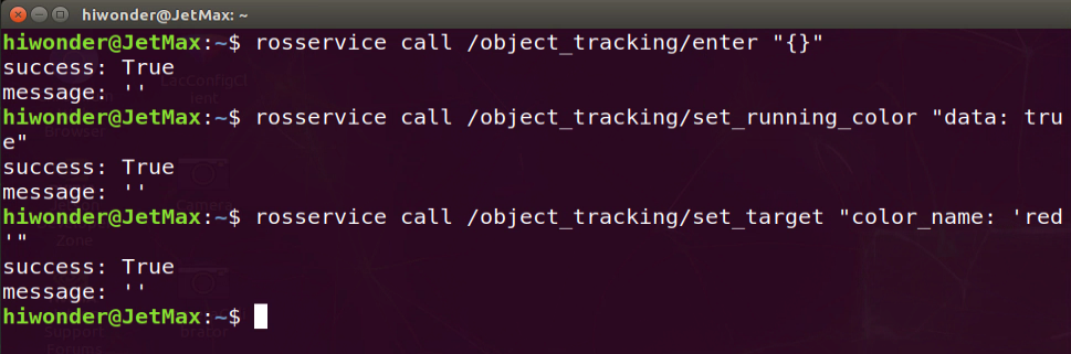

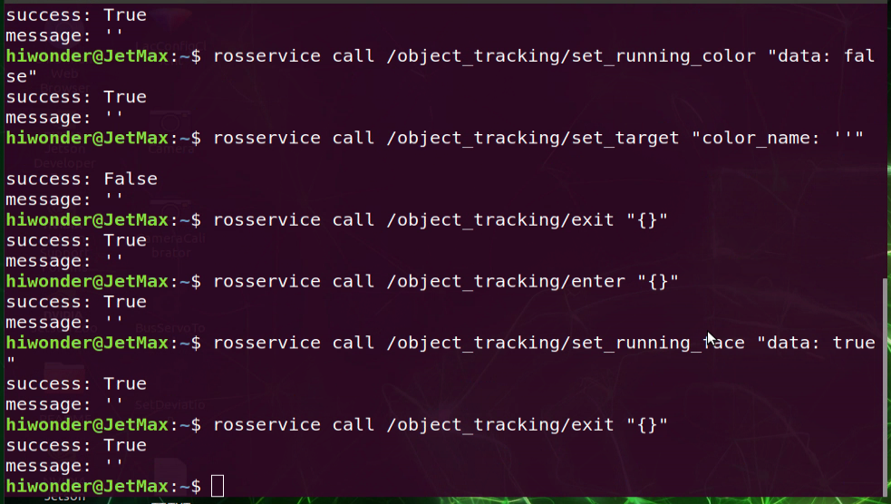

  3. Enter command “rosservice call /object_tracking/enter “{}”” and press Enter to enter the game.
  • Turn on Camera
Double click and enter the address “192.168.149.1:8080/”, then press Enter. After that, select “ /object_tracking/image_result(Snapshot)” to turn on the camera.
  • Start the game
  1. Enter command “rosservice call /object_tracking/set_target “color_name: ‘blue’” “ to set the color to be tracked and press Enter. Take tracking blue for example.
  1. Enter command “rosservice call /object_tracking/set_running_color “data: true” “ and press Enter to start color tracking.
  1. If you want to stop the game, you can enter command “rosservice call /object_tracking/set_running_color “data: false” “ and press Enter.
  1. If you want to exit the game, you can enter command “ rosservice call /object_tracking/exit “{}” “ and press Enter.

  3. Enter command “cd ros/src/jetmax_demos/scripts” and press Enter to enter the directory storing the game program.
  1. To avoid the memory being occupied and affect the game, you need to enter command “./kill_app_funcs.sh” to close other games.
  1. Then enter the password to grant the permission to execute the previous command. The password is “hiwonder”.
  1. Lastly, enter command “rosrun jetmax_demos visual_calculator.py” and press Enter to start the game.

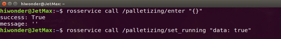

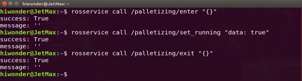

3.7.3 Operation Steps
The entered command should be case sensitive. And the keywords can be complemented by Tab key.
  • Enter the game
  3. Enter command “rosservice call /palletizing/enter “{}” “ and press Enter to enter the game.

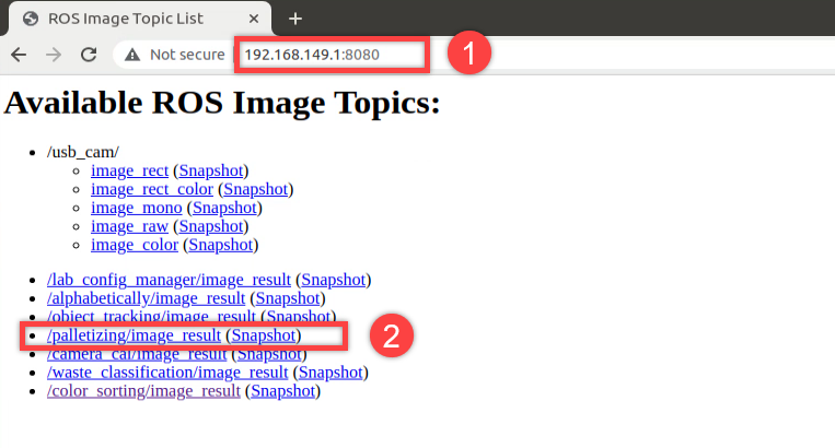

  • Turn on the camera
Double click and input the address “192.168.149.1:8080/”, then press Enter. After that, select “/palletizing/image_result(Snapshot)” to turn on the camera.
  • Start the game
Enter commend “rosservice call /palletizing/set_running “data: true” “ and press Enter to start the game.
  1. If you wan to stop the game, you can enter command “rosservice call /palletizing/set_running “data: false” “ and press Enter.
  1. If you want to exit the game, you can enter command “rosservice call /palletizing/exit “{}” “ and press Enter.

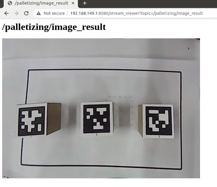

3.7.4 Function realization
After the game starts, place the tag block to the recognition area of the map. Having recognized the tag block, the robotic arm will suck and stack them one by one in the stacking area.

3.8.3 Operation steps
  • Enter the game
  1. Connect to the system desktop through NoMachine.
  3. Enter command “rosservice call /object_tracking/enter “{}” “ and press Enter to enter the game.
Double click and input the address “192.168.149.1:8080/”, then press Enter. After that, select “/object_tracking/image_result(Snapshot)” to turn on the camera.
  • Start the game
  1. Enter command “rosservice call /object_tracking/set_running_face “data: true” “ and press Enter to start the game.
  1. If you want to stop the game, you can enter command “rosservice call /object_tracking/set_running_face “data: false” “ and press Enter.
  1. If you want to exit the game, you can enter command “rosservice call /object_tracking/exit “{}” “ and press Enter.

  1. Use cv2.rectangle() function to draw rectangle frame to frame human face. The specific program is as follow.
The first parameter img represents the specific human face image of the drawn frame.
The second parameter (x1, y1) represents the starting coordinate of the rectangle.
The third parameter (x2, y2) represents the ending coordinate of the rectangle.
The fourth parameter (0, 255, 0) represents the color of rectangle border to be drawn. The parameter consists of 3 values ranging from 0 to 255. This parameter represents that the color is mixed with red , green and blue. The first value 0 represents red value. The second value 255 represents the green value and the third value 0 represents the blue value.
The fifth parameter 2 represents the width of the rectangle border.
  1. Use cv2.circle() function to draw 5 mark points.
The first parameter img represents the specific human face image of the drawn mark points.
The second parameter (lx, ly) represents the center coordinate of the drawn circle.
The fourth parameter color represents the color of the drawn circle. Set parameter in img_ret, boxes, landmarks = show_faces(img_ret, boxes, landmarks, (0, 255, 0)) as (0, 255, 0).
The fifth parameter 2 represents the width of the circle line. The larger the value, the wider the width.

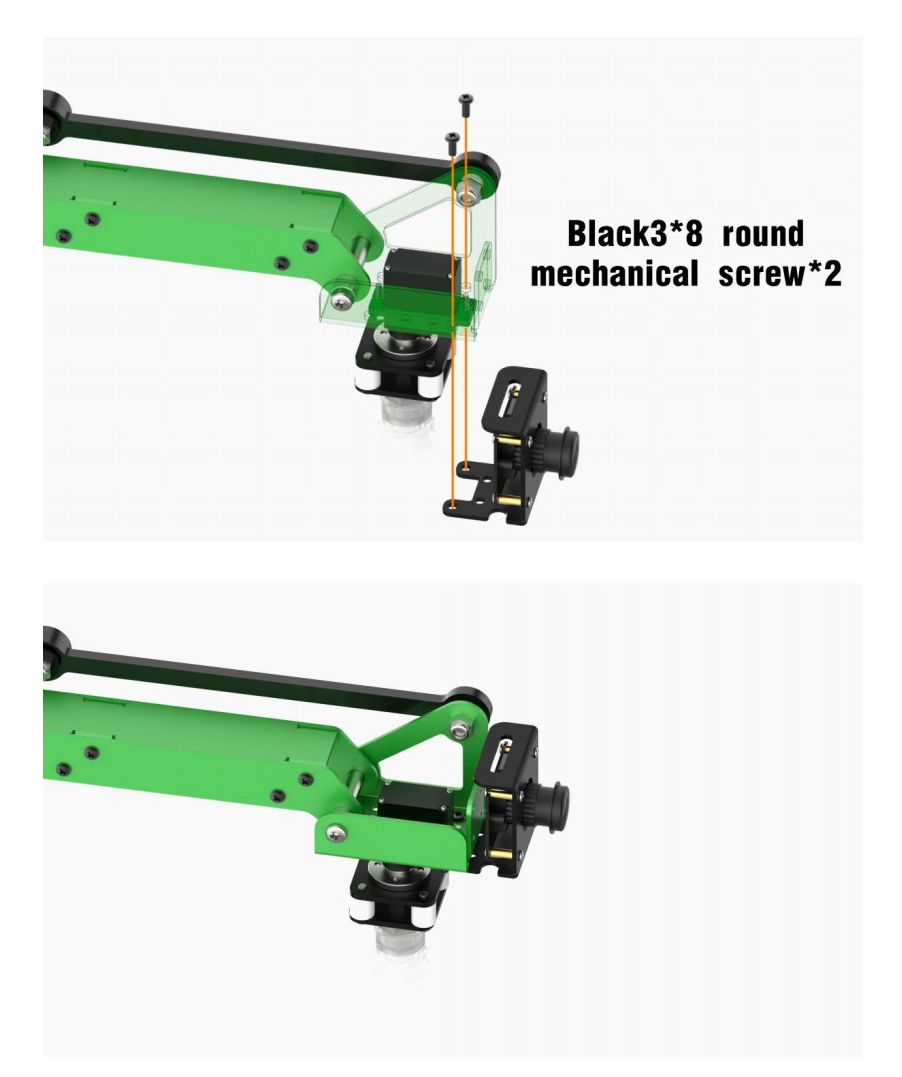

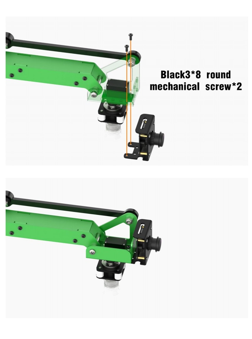

3.8.6 Camera Horizontal Installation

  1. In order to avoid memory being occupied and affecting the start of emotion recognition game, you need to enter command “./kill_app_funcs.sh” to quit other games.
  1. At this time, enter password to grant the permission to execute the previous command. And the password is “hiwonder”. Pay attention to that the input interface will not show up when you enter the password.

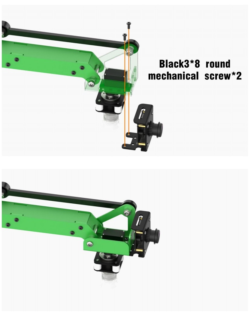

3.9.5 Camera Horizontal Installation
3.10 Gesture Recognition
3.10.1 Preparation
When playing this game, please install the camera of the robotic arm horizontally. For installation details, you can refer to “3.10.5 Camera Horizontal Installation” in this folder.
