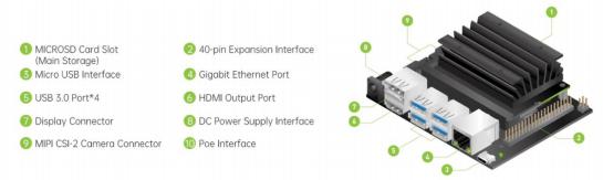

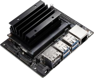

  • Hardware Components
The following figure shows the hardware component of Jetson Nano B01.
① MicroSD card slot for main storage
② 40-pin expansion header
③ Micro-USB port for 5V power input, or for Device Mode
④ Gigabit Ethernet port
⑤ USB 3.0 ports ( ×4)
⑥ HDMI output port
⑦ Display Port connector
⑧ DC Barrel Jack for 5V power input
⑨ MIPI CSI-2 camera connectors

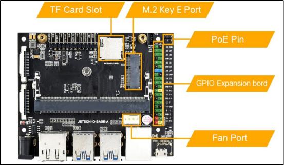

M.2 Key E port
Connect with wireless network card.
PoE pin
Connect with PoE module.
GPIO port
For extension
Fan port
Connect with cooling fan

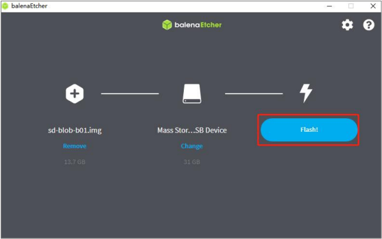

  • Write Image

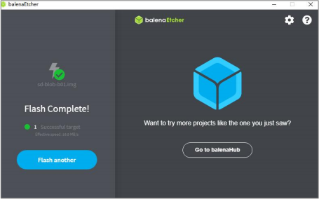

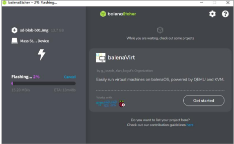

  1. After the image file is decompressed, prepare a card reader and SD card.

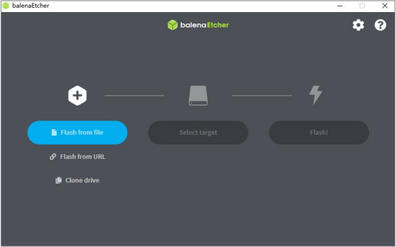

Insert SD card into card reader, and connect it to computer. Then open “balenaEtcher”.
  1. Click “Flash from file” to import the image file.
  1. Click “Select target” to select SD card.
SD card will be formatted automatically when the image is written. Please make a copy of the import data before re-writing the image.
  1. Check the SD card to be written, and click “Select” .
  2. Click “Flash” to start writing image.
  1. If the formatting prompt appears after the image is written, please click “Cancel”.
  1. When the word “Flash Complete” is prompted, the image is written successfully.

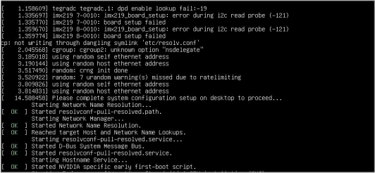

1.1.3 First Start Jetson Nano
When first boot up Jetson Nano board, the system needs to be configured.

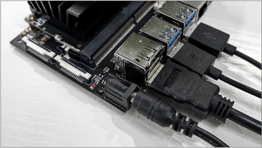

  • Power on Jetson Nano

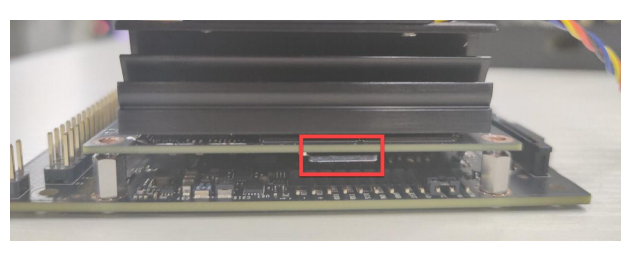

  1. Insert SD card (the system image is written) into Jetson Nano board. The SD card slot is shown in the picture below:
(Regarding system image writing, please refer to the material in “1.1.2 TF Card Writing Image” .)
  1. Please pay attention to the direction of SD card. The side with card slot must face upwards and push it into Jetson Nano board gently.
  1. Connect monitor, mouse and keyboard to Jetson Nano board. Use HDMI cable to connect monitor to HDMI port of Jetson Nano board. Mouse and keyboard are connected to USB port, and 5V 4A power adapter to DC power port. Lastly, boot up Jetson Nano board after the network is connected.

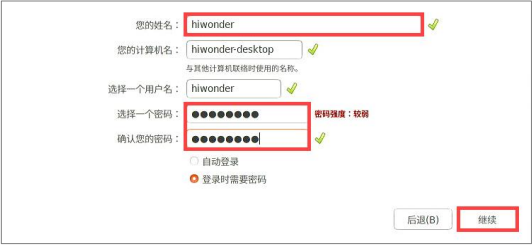

  • System Configuration

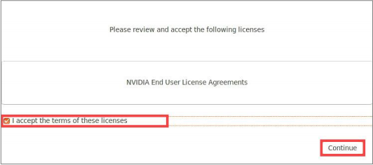

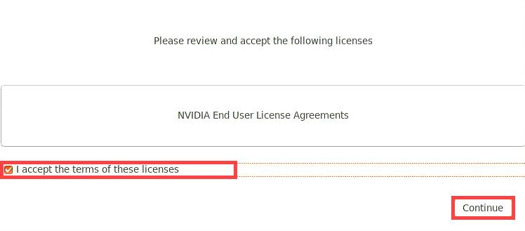

The system needs to be configured when first start Jetson Nano. The operation steps are as follow:
  1. Accept the agreement license and click “Continue” .

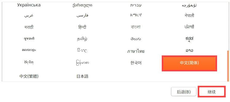

  1. Set system language and click “Continue” .

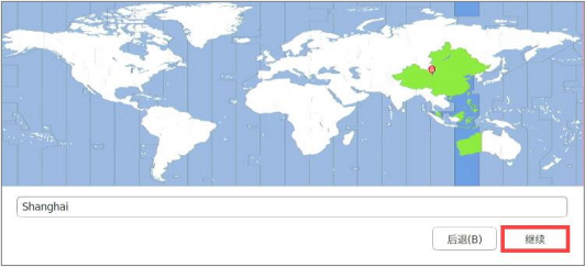

  1. Set your location and click “Continue” .

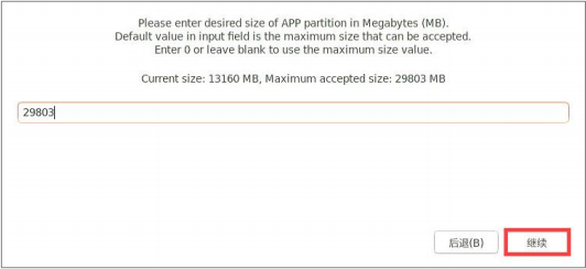

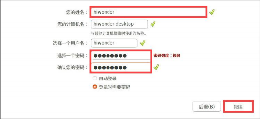

  1. Set user name and password, and click “Continue” .

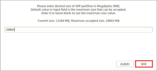

  1. Keep the default size setting of APP partition, and click “Continue” .

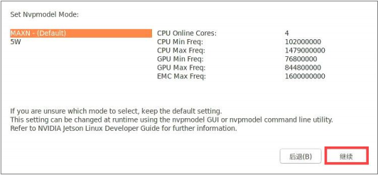

  1. Keep the default mode setting and click “Continue” .
  1. After system configuration is complete, Jetson Nano board will restart automatically.

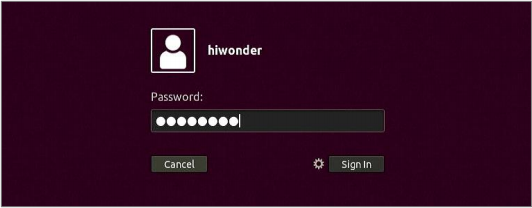

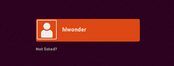

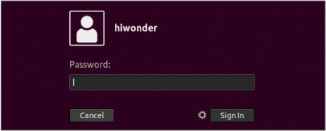

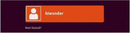

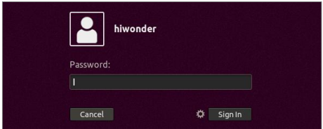

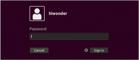

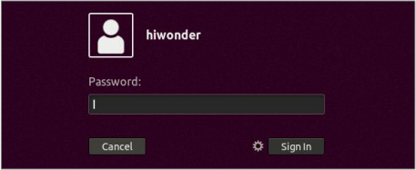

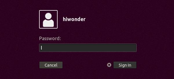

  1. Enter the password set in step 4, and click “Sign In” to enter the system desktop.

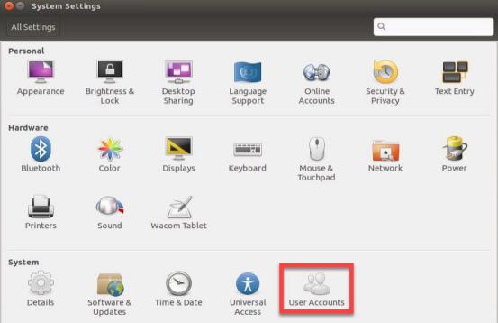

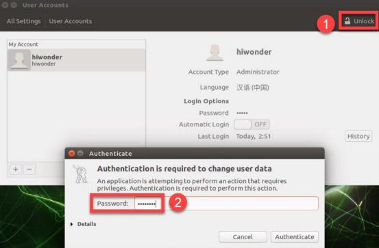

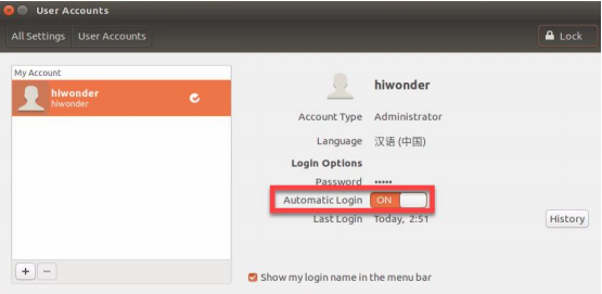

  1. Click on and select “System Settings…” to enter the setting interface.
  1. Select “User Accounts” .
  1. Click on and input password. Then press Enter.
  1. Switch “Automatic Login” to “ON” . Then exit settings.

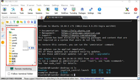

  1. After the first use of Jetson board, it can be directly controlled via remote tool. For the remote control, please refer to the material in “ 1.1.7 Remote Desktop Configuration and Usage”.

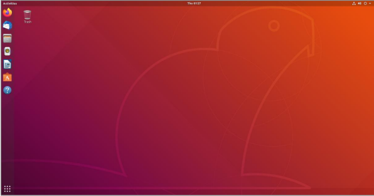

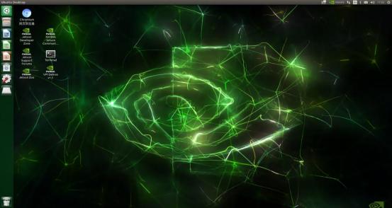

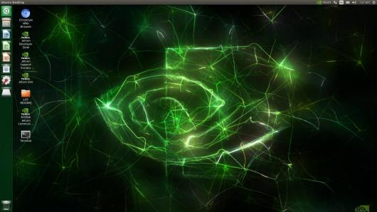

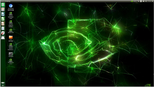

  • Introduction to System Desktop
The following picture shows the Jetson Nano system desktop:

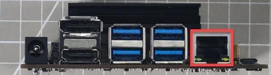

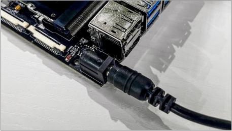

  1. Connect network cable to RJ45 interface, as the picture shown below:
  1. If the interface flashes yellow light, as the picture shown below, which means network is connected successfully.

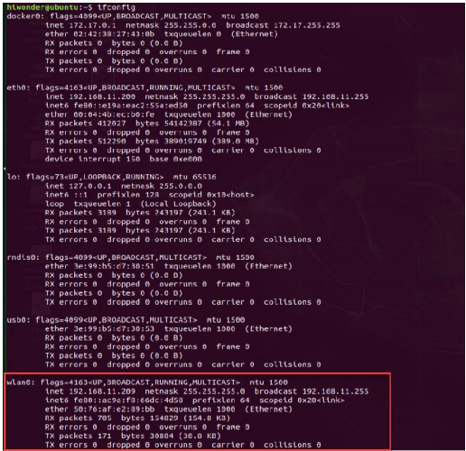

2. Detect Connection Status
  1. Start Jetson Nano and connect it with screen.
For remote desktop installation and configuration, please refer to the material in “ 1.1.7 Remote Desktop Configuration and Usage”.
  1. Double click to on system desktop to open the command line terminal.

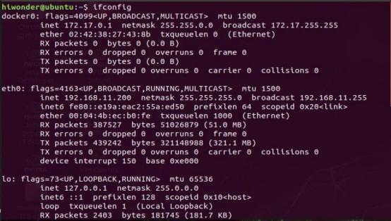

  2. Enter command “ifconfig” and press Enter to view the network connection status, If the IP of eth0 is 192.168.11.200 (this IP address is an example), network is connected successfully.
The IP of eth0 will change with the router connected. The router needs to enable dhcp server function. Under normal circumstance, no need to manually enable dhcp service.

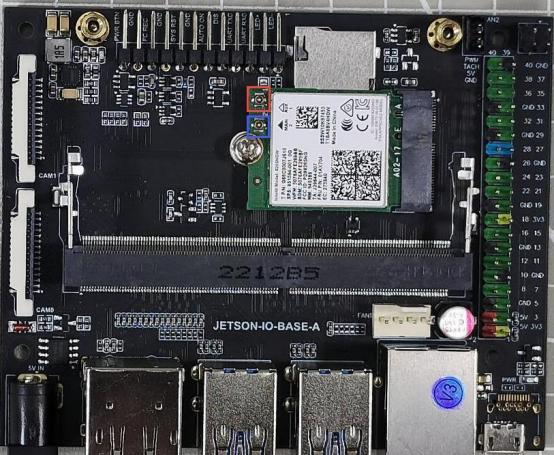

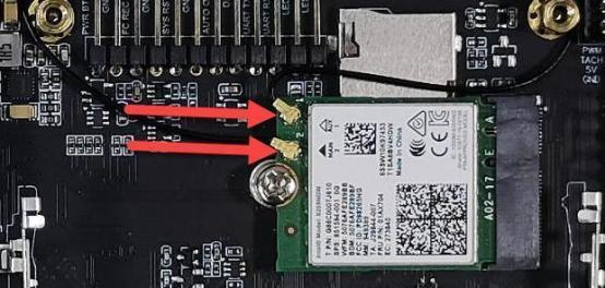

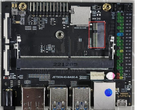

1. Install Wireless Network Card
M2 wireless network card is applied in here. If you do not purchase Jetson Nano WIFI advanced kit, you can skip following part.
  1. Prepara Jetson Nano board, screwdriver, network card and antenna.
  2. As the picture shown below, remove these two screws.

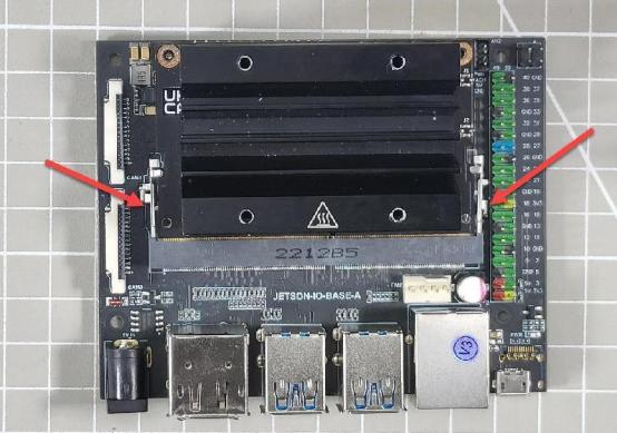

  1. Open the two clips where the below red arrows point to.

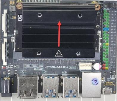

  1. Pull up the core board towards the red arrow.

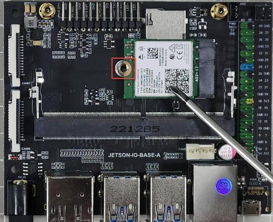

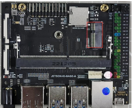

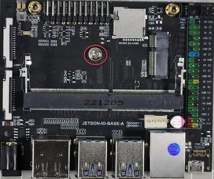

  1. Remove the screw for fixing network card, as the picture show below:
  1. Insert network card to the position framed in following picture.
  1. Tighten the screw for fixing network card, as the picture shown below:

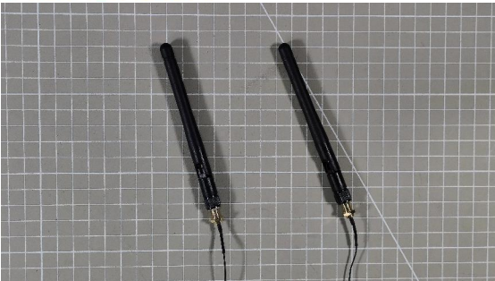

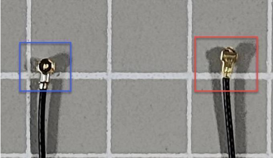

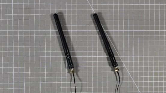

  1. There are two boxes in following picture. The red one is hole 1, and the blue one is hole 2 for connecting with antenna.
  1. The antenna has two sides, as the picture shown below. The blue box shows the reverse side and the red box is the front side. You need to connect the reverse side in the corresponding position.
  1. After installing antennas, the wire connected to hole 1 needs to be placed in the left side, and the wire to hole 2 needs to be placed in the right side.
  1. Then insert the core board to the position shown in the picture below:
  1. Tighten the screws for fixing core board.
  1. Fix the antenna to the cable connected to the network card.

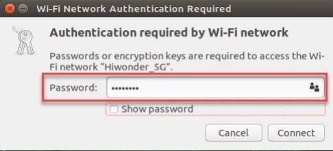

  2. Click on and select “More networks” to select the WIFI to be connected.
  3. Enter WIFI password and click “Connect” .

3. Detect Connection Status
Enter command “ifconfig” and press Enter to view the network connection status. If the IP of wlan0 “ 192.168.11.209” appears, network is connected successfully.
The IP of wlan0 will change with the router connected. The router needs to enable dhcp server function. Under normal circumstance, no need to manually enable dhcp service.

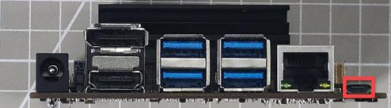

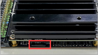

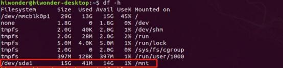

  • Connect Jetson Nano with USB Cable
If LAN is not connected to a public network, Jetson Nano will still not be able to access external resources.
In addition, before connecting with USB cable, please first connect Jetson Nono to the power supply and waif for booting up.

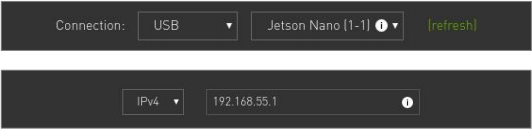

1. Wiring
  1. Turn on Jetson Nano. Connect USB cable to the position shown in following picture and connect the other end to computer.

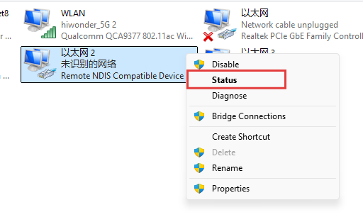

2. View Device

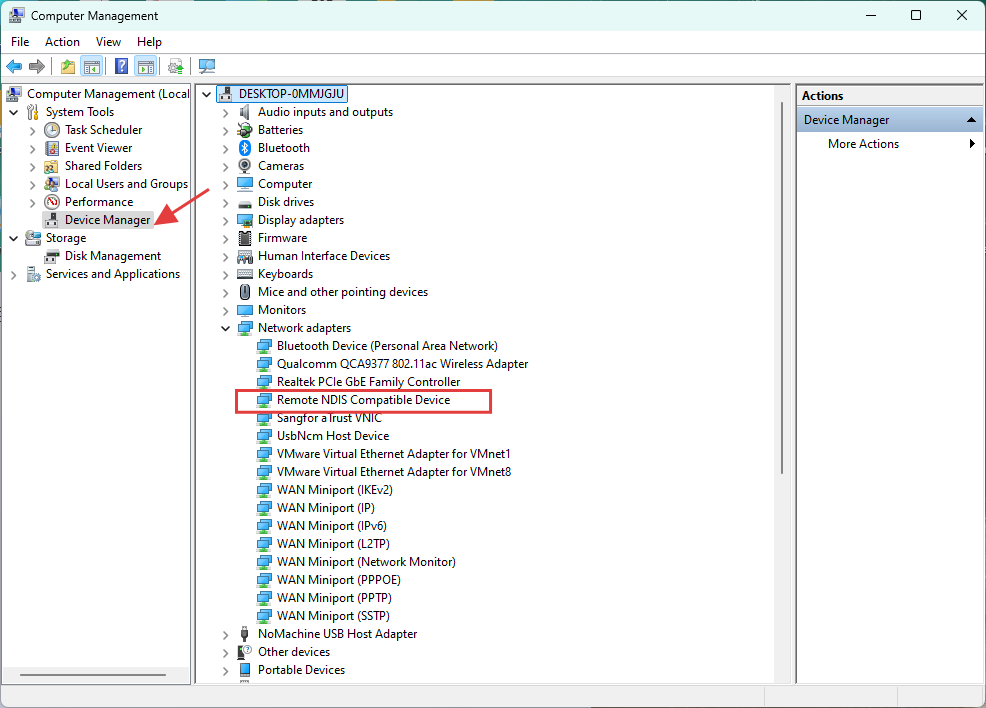

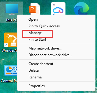

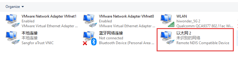

  1. Boot up Jetson Nano board, right click on “This computer” to select “Mange” .
  1. Click “Device manger”. If you find “Remote NDIS Compatible Device”, which means device is connected.

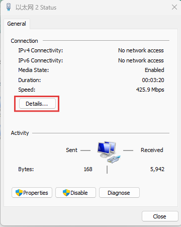

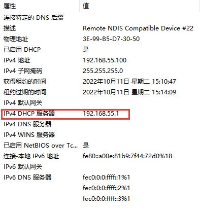

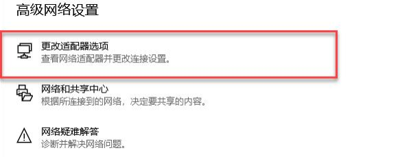

3. View Device IP
  1. Right click network connection area and select “Open ‘Network and Internet’ settings” .
  1. Click “Change adapter” to view adaptor.
  1. The one in following red box is the required adapter.
  1. Right click “Status”.
  1. Click “Detailed Information” .
  1. If the information shown in below red box appears, it means Jetson Nano can be accessed through “ 192.168.55.1”.

1. IP Search
Reminder: if you use USB cable to connect Jetson Nano, the fixed IP is “192.168.55.1”, you can skio this part.
  1. After connecting the Jetson Nano board to the router via wireless or wired either way, the device IP can be queried through the router or MobaXterm tool.
  2. If you use MobaXterm, please open tool first and follow the operation steps shown in the picture below.
  1. IP address range is the possible address range of Jetson nano, generally fill in the first three input boxes with the same value as the computer IP, the last two are fixed to 1-\254. then click “Start scan” to search for all active IPs in the network.
  1. As shown above, at the SSH column, the devices circled in green support SSH remote connection, from which you can find out your Jetson Nano device and can choose to record the IP.

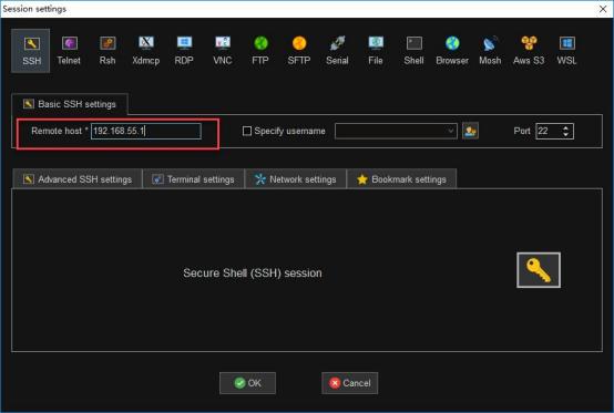

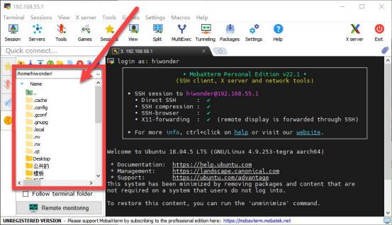

2. Create Session and Connection
  1. In MobaXterm, click “Session” at the upper right corner to create a session to record the IP of Jetson Nano “ 192.168.11.161”, and click “OK” .
If you connect Jetson Nano with USB cable, you need to enter “ 192.168.55.1”.

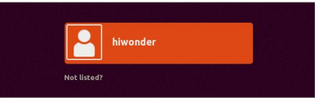

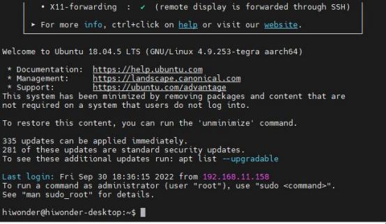

  1. Enter user name and password. (The default setting is “hiwonder” as user name and “hiwonder” as password. You can modify it as needed.) Then press Enter. Please note that the password is the same as that in Linux.
User name must be entered under lowercase mode when logging in, even if the set user name contains uppercase.
After the password is input correctly, you will access to system successfully, as the figure shown below:

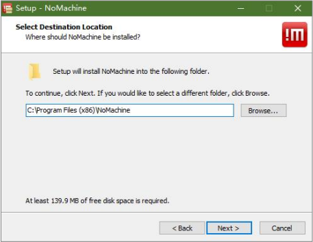

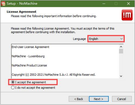

  • Install Nomachine on Computer
  1. Nomachine Tool. (remote desktop connection tool which can find it under the same directory with document.)

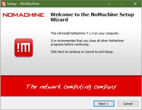

  1. Double click “nomachine_7.1.3_1.exe” to open Nomachine installation package.
  2. Click “Next”.
  1. Select installation language as “English”. Check “I accept the agreement” and click “Next” .
  1. Keep the default installation path and click “Next” .
  1. After the following prompt appears, click “Finish” .

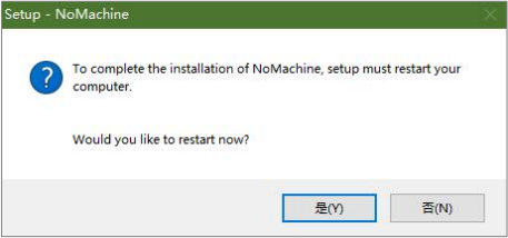

  1. Click “Yes” to restart your computer. (Do not skip this step!)

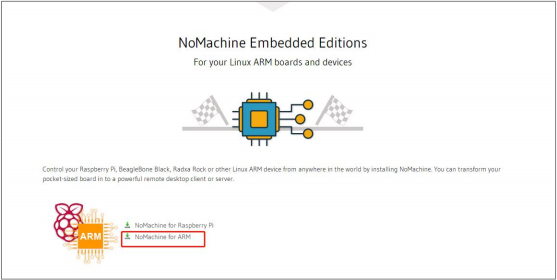

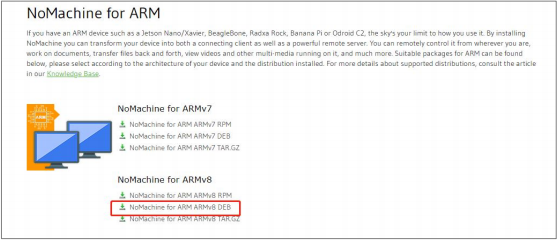

  1. Start Jetson Nano. Open browser and open the website “https://www.nomachine.com/download” to enter Nomachine download page. (If you use network card or network cable, you can directly enter the web page. If you use USB cable to connect Jetson Nano and computer, please refer to the following operation steps.)
  2. Find “NoMachine for ARM” in page and click it to enter ARN version download page.
  1. Then click “NoMachine for ARM ARMv8 DEB” to enter the download
page.
  1. Click “Download” .

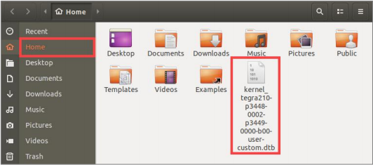

  1. Drag this file in download directory to “Home” directory.
  1. Find file “nomachine_8.1.2_1_arm64.deb” in the same path of this document.
  1. Connect Jetson Nano on MobaXterm. Drag the file”nomachine_8.1.2_1_arm64.deb” to the position shown in the following red box.

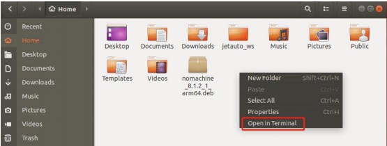

  1. On Jetson Nano desktop, you can find “nomachine_8.1.2_1_arm64.deb” under Home directory.
  1. In “Home” directory, right click a blank space and select “Open in Terminal” .
  1. Enter command “sudo dpkg -i nomachine_8.1.2_1_arm64.deb” . In command, “nomachine_8.1.2_1_arm64.deb” is the default file name. If it is modified when download, the file name in command must be modified according to the actual situation.
  1. Enter the password and press Enter. Here take the default password “hiwonder” as example.

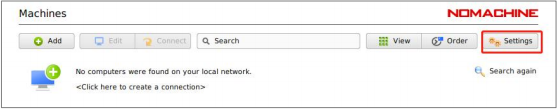

  • Computer Connection and Usage

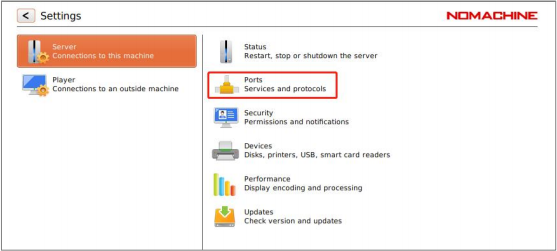

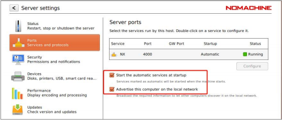

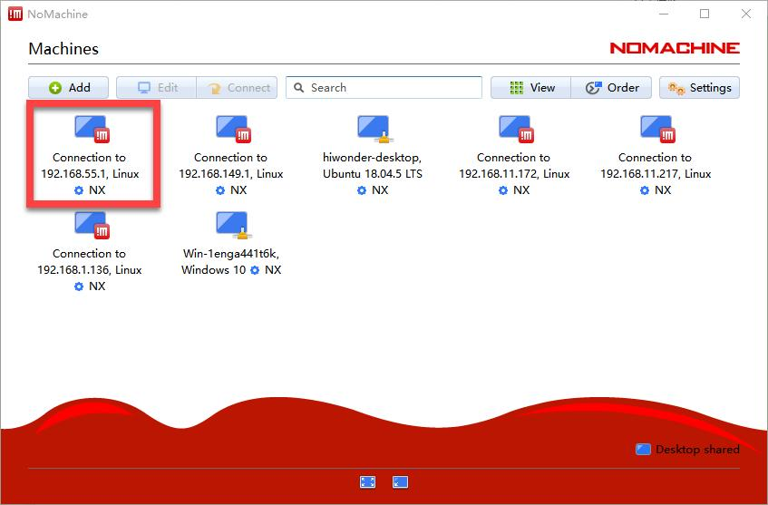

  1. After installation is complete, open Nomachine and click “Settings” to enter the setting page.
  1. Click “Ports” to enter the port setting page.
  1. Confirm the following two options are ticked. Then complete configuration.

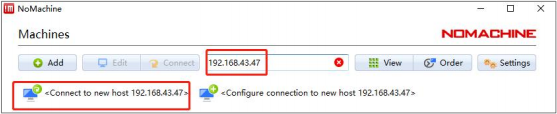

  1. Open Nomachine on computer and enter IP address “ 192.168.43.47” in
search box and click “Connect to new host 192.168.43.47” .

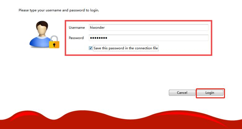

  1. Enter username and password and click “Login” . Then you can find the Jetson Nano desktop.

If Jetson Nano does not enable auto-login, black screen will occur when using Nomachine.
Use a monitor to connect Jetson Nano board, For auto-login setting, please refer to Step 9-13 in “ 1.1.3 First Start Jetson Nano/ System Configuration”.

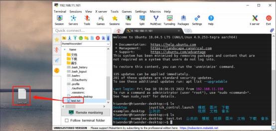

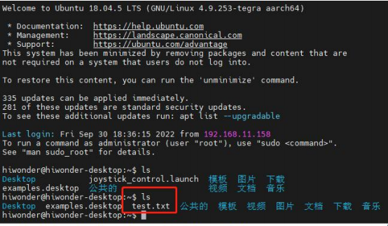

1. From Computer to Jetson Nano
  1. After SSH is connected, select the files to be transferred, drag the files to MobaXterm file zone with your mouse.
  1. The file will automatically be transferred to Jetson Nano system desktop.Enter command “ls” to view all files.
2. From Jetson Nano to Computer
After SSH is connected, find the file to be transferred on MobaXterm file zone, and drag file to computer desktop.

  1. Start Jetson Nano and connect to a USB port of Jetson Nano board,
  2. Double click onto open a command line terminal.
  3. Enter command”sudo mkfs.ext4 /dev/sda1” and press Enter to format U disk.
  1. If the following prompt appear, enter “y” and press Enter to confirm operation.
  1. The below prompt means U disk is formatted successfully.

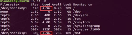

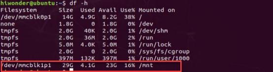

  1. Then enter command “sudo mount /dev/sda1 /mnt” to mount U disk to “/mnt” directory which can be modify to other existed directory.

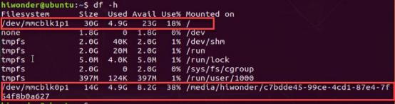

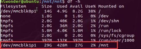

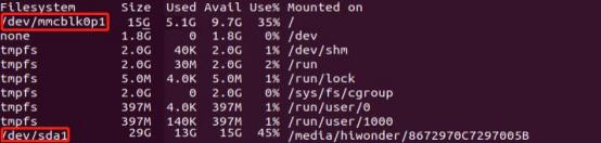

  1. Lastly, enter command “df -h” to view whether the mounting is completed.
df -h
  1. If the following prompt appears, the mounting is completed successfully.

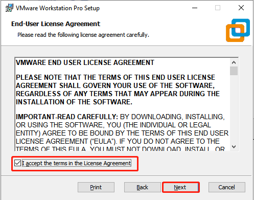

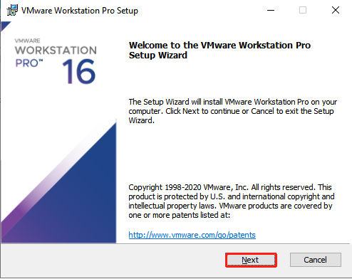

  1. Extract “Vmware 16.0 Pro.zip” to any directory, and then install the program “VMware-workstation-full-16.0.0-16894299.exe”.
  2. Click “Next”.
  1. Check “I accept the terms in the License Agreement” and click “Next”.

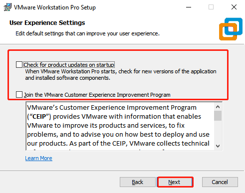

  1. It is recommended to cancel the below two options and click “Next”.

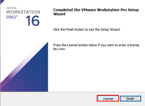

  1. After the installation is completed, click “License”.
  1. Open the file “VMware 16 Activation Key. txt” in the directory where the “Wmware 16.0 Pro.zip” software is extracted.
  2. Copy any activation key. Go back to the installation page of the virtual machine, and paste it into the text box. Then click “Enter”.

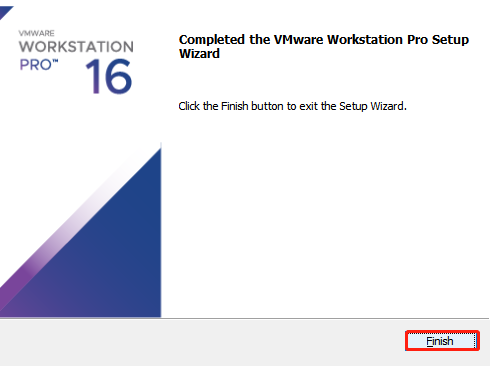

  1. Click “Finish”.

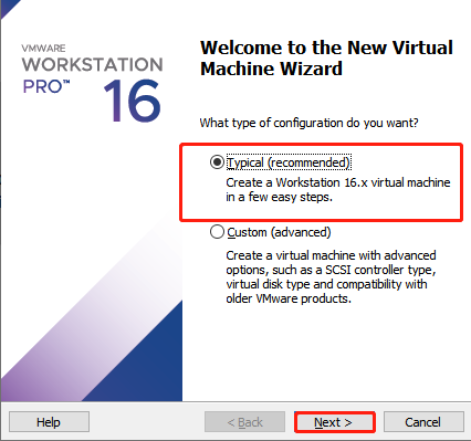

  • Create a Virtual Machine
We will use Ubuntu 18.04 system in here and the system image file is located in “Appendix”.
The operation steps for creating a virtual machine is as follow:
  1. Click on to open the virtual machine.
  2. Click “Create a New Virtual Machine”.
  1. Keep the default settings and click “Next”.

  1. After the virtual machine is installed, click the orange box in system interface.
  1. Enter your password and click “Sign In” to enter the system desktop.

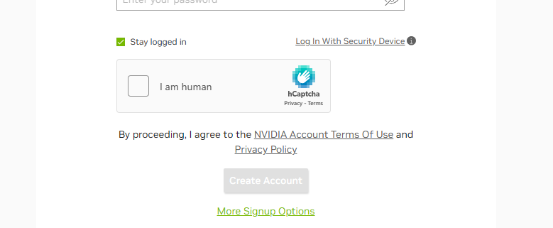

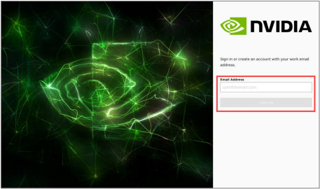

  1. Enter NVIDIA DEVELOPER website http://developer.nvidia.com/. Click on “Join” button.
  1. Enter your email account for signing up an NVIDIA account.
  1. Enter the required information to create your account.
  1. Complete the following verification and create your account.

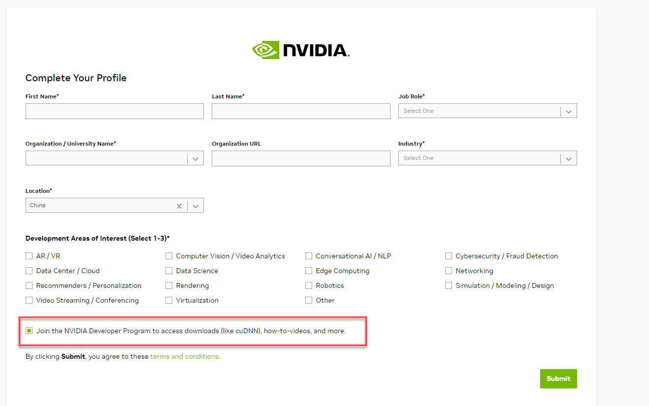

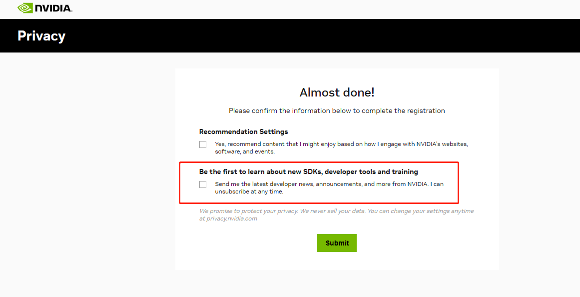

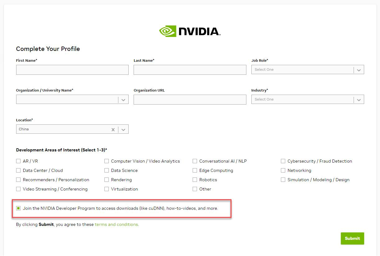

  1. Go back to log in and check the second option (do not skip this step).
  1. Complete your profile and check “Join the NAVIDIA Developer Program to access downloads (like cuDNN)… “, then click on “Submit”.

  1. Double click on to open virtual machine. Click on “Start the virtual machine”.
  1. Click on the below orange box.
  1. Enter the password, and then click on “Sign In” button to enter the system desktop.

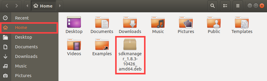

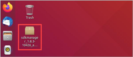

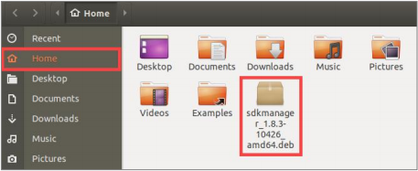

  1. Drag the SDK Manager Installation file on your computer desktop to the virtual machine desktop.
  1. Click onto open the file manger, and move SDK Manager Installation file to the home directory.
  1. Click on on the task bar and click on or press “Ctrl+Alt+T” to open the terminal.
The entered command should be case sensitive and “Tab” key can be used to complement the key works.
  1. Enter command “sudo apt install ./sdkmanager_1.8.3-10426_amd64.deb” and press Enter to install SDK Manager tool.

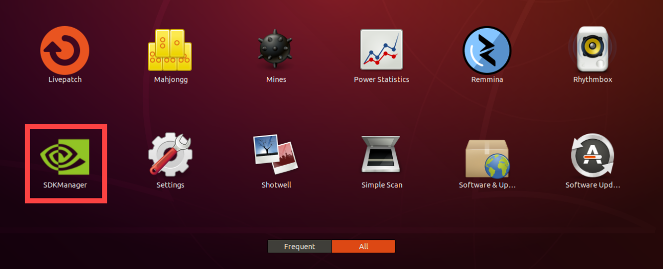

  1. After installation is completed, click on. Then you can find SDKManger software.

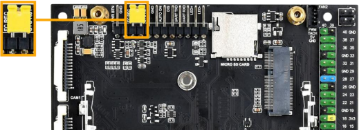

  1. Remove the jumper cap.
  1. Using a removed jumper cap, short the ‘FC REC’ and ‘GND’ pins on the Jetson Nano B01 development board to put the board into Force Recovery mode.
Must short circuit the pins first, and then boot up the development board.

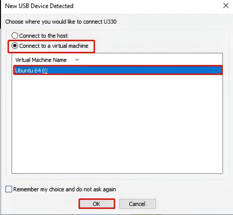

  1. Connect one end of USB cable to Jetson Nano B01 development board, and the other end to your computer.

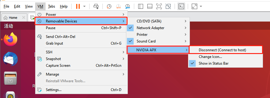

  1. If the following prompt window occurs, please select “Connect to virtual machine” and click on “OK”.
  1. If the device detection window does not appear, pleas click “VM -> Removable Devices -> NVIDIA APX -> Disconnect (Connect to host)”.

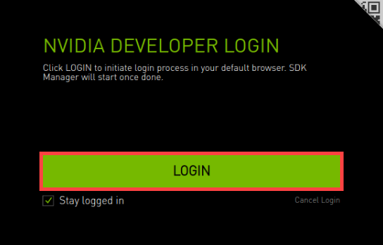

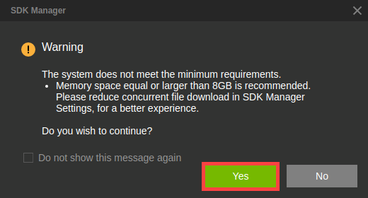

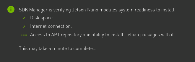

  1. Click on and click on to run SDK Manager tool. If the below warning window shows up, click on “Yes”.

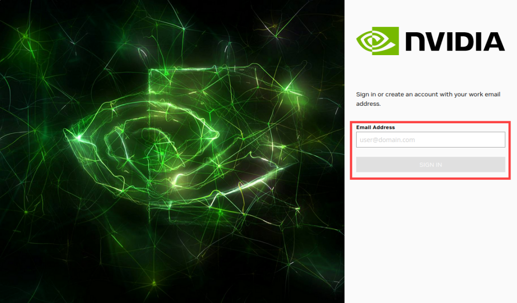

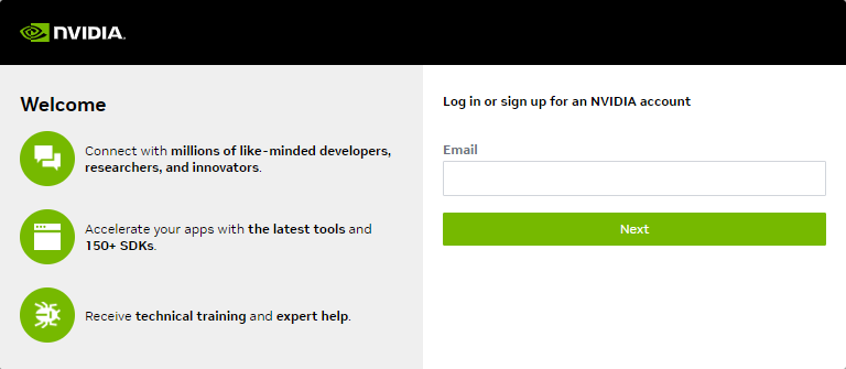

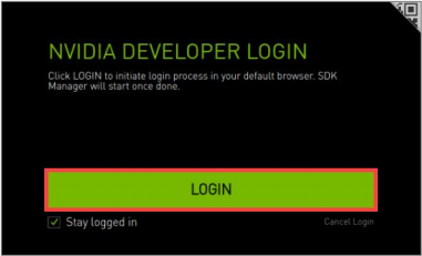

  1. Click on “LOGIN” button.
  1. Log in to the account.

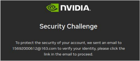

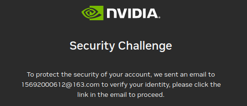

  1. Security verification is required while log in. You need to click the link send by NAVIDIA in the email to verify your identity.

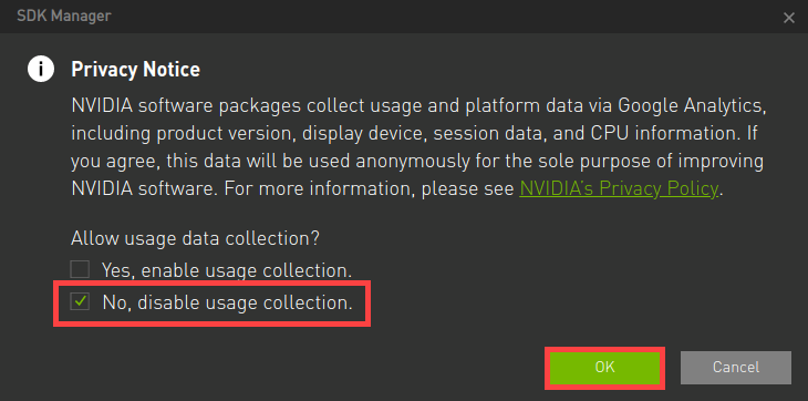

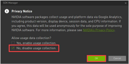

  1. If the below prompt window pops up, please check “No, disable usage collection” and click “OK”.

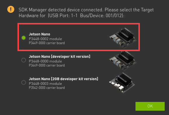

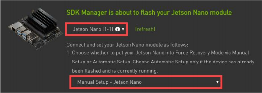

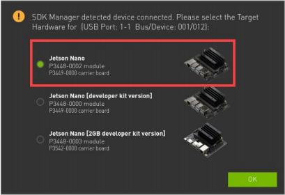

  1. If you’re required to select the board model, please select “Jetson Nano” and click on “OK”.

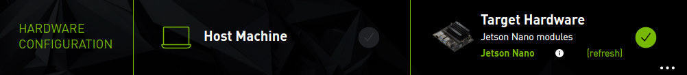

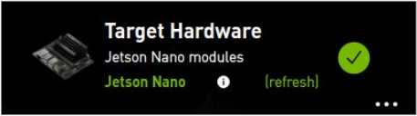

  1. In “STEP 01” page, cancel “Host Machine” and confirm if the development model “Target Hardware” is correct.
If Jetson Nano board is not detected, please try to reconnect the the USB cable between the development board and your computer.

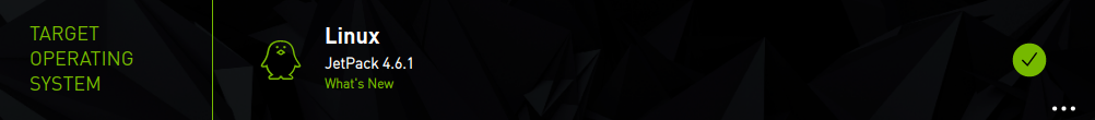

  1. TARGET OPERATING SYSTEM” is the system version to be installed. “JetPack 4.6.1” is selected in this lesson. You can select other versions as requirement.

  1. Keep the default installation path and check “I accept terms and conditions of the license agreements”. If you need to change the installation path, you can click “change”.
  1. After settings are completed, click “CONTINUE TO STEP 03”.

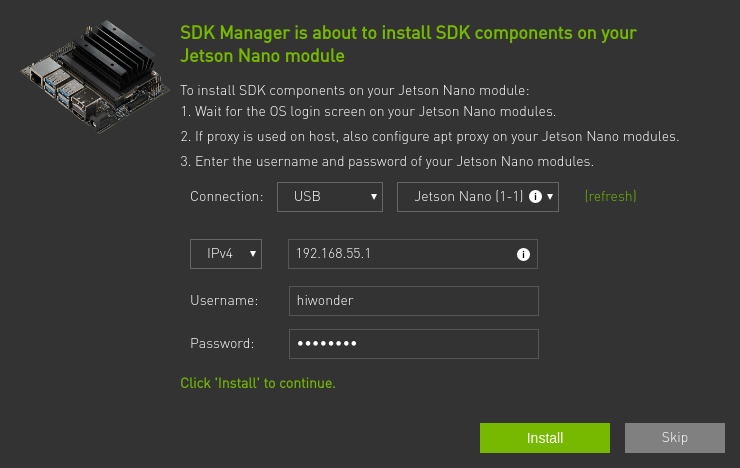

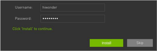

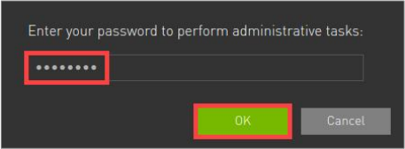

  2. Enter the system account and password, then click “OK”.
  1. If the below pop-up appears, click on “Create”.
  1. Fill in the system password and click on “OK”.
  1. If the installed system is JetPack 4.6.1 or higher, the Proconfig window will occurs in the process of the installation. The development board keeps the default settings and the installation mode is set as “Manual Setup – Jetson Nano”.
  1. Select “Pre-Config” in the drop-down menu of the OEM Configuration and set the system account and password. Both are set as “hiwonder” as example. Then click “Flash”.
if the installation option only select “Jetson OS”, please jump to step 29.

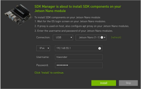

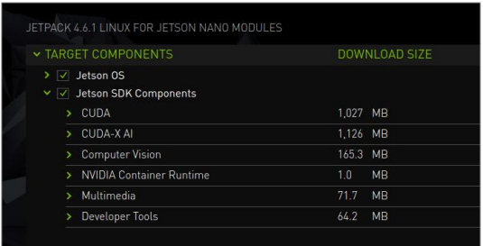

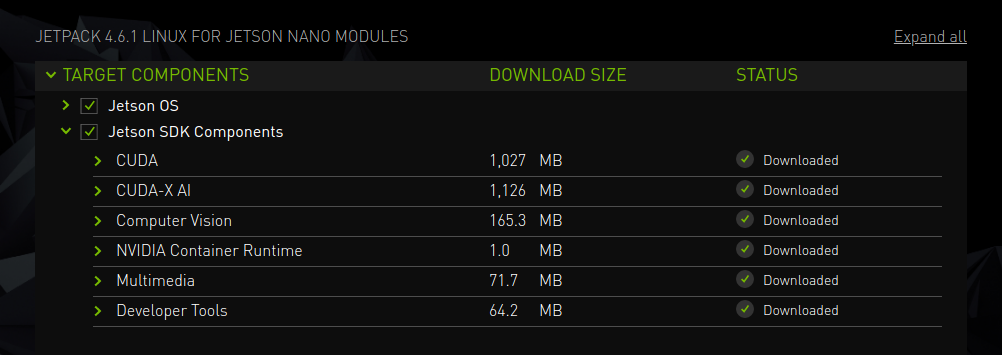

  1. If the installation option “Jetson SDK Components” is selected, the relevant configuration window will appear.
  1. The “Connection” option and IP keep the same settings.

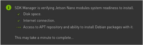

  1. Enter username and password, then click “Install”.

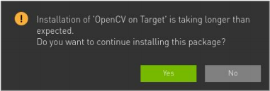

  1. If the relevant detection and installation window occurs, the detection needs to take some time. After the detection is completed, click “OK”.
  1. If the below window pops up, click on “Yes”.
  1. After the system installation is finished, click on “Finish”.
  1. Remove the jumper cap and USB cable, and then connect screen, jumper cap, mouse and keyboard to the Jetson Nano board. Power up the Jetson Nano board and enter the system. (The jumper cap must be installed properly, otherwise, the Jetson Nano will fail to boot up.)

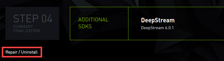

  • Reinstall System
The original system must be uninstalled before reinstalling the system. Please refer to the following operation steps:
  1. Please refer to the steps 1-12 in “1.1.11 Burn System Image -> Install SDK System and Burn JetPack”.

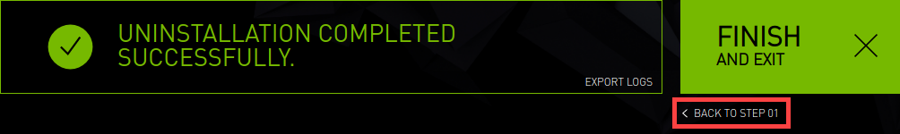

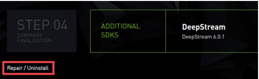

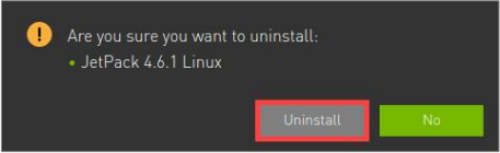

  2. Click “Repair/Uninstall”.
  1. Click “Uninstall”.
  1. Enter your password. Then click “Uninstall” to start uninstalling the system.
  1. Click “BACK TO STEP01”.
  1. Refer to the steps 13-30 in “1.1.11 Burn System Image -> Install SDK System and Burn JetPack” to reinstall the system.

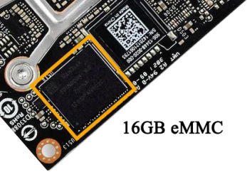

Jetson Nano ALT board comes with a 16GB eMMC that is a embedded Multi Media Card. User can directly write image into eMMC, no a external TF card needed as system boot driver.
Besides, without the pin switch of DC power port, Jetson Nano ALT board can prevent power is not supplied since the jumper cap is not inserted on DC port.

  • Hardware Structure
The hardware structure of Jetson Nano EMMC version is as follow:
Port/PIN
Function
2-channel MPI CSI interface port
Connect camera
Display port
Connect monitor
HDMI port
DC power interface
5V power input
4-channel USB 3.2 Gen1 port
Used to connect peripherals and the
maximum transmission speed is up to 5Gb ps.
10/100/Base-T self-adaptive. PoE power supply is supported when connecting with PoE module.
" 10/100/1000Base-T" means Ethernet over twisted pair carrying 10Mb/s, 100Mb/s or 1000Mb/s baseband signals.
Micro USB interface
5V power input or USB data transfer.
TF card slot
Insert TF card as capacity expansion
M.2 Key E port
PoE pin
GPIO port
For extension
Fan port

  1. Connect monitor, mouse and keyboard to Jetson Nano ALT board. Use
1. Task bar
Icon
Name
Function
Search your
computer
Search application and file in system
Files
File manger
LibreOffice Writer
Create word file
LibreOffice Calc
Create spreadsheet
LibreOffice
Impress
Create presentation file
Software
App store
System Settings
common system settings
L4T-README
Open the folder where the instruction file is stored
Trash
Store the deleted files.
2. Menu bar
Icon
Function
Related device settings
Network settings
Input method
System notification
Speaker volume
System time
System control menu
3. Desktop Application
Icon
Name
Instruction
Chromium browser
A browser is developed by Google
NVIDIA Jetson Developer Zone
Access NVIDA Jetson developer zone.
NVIDIA Jetson Support Forums
Access NVIDIA Jetson technical support forum.
NVIDIA Jetson Zoo
Access a web page for installation
instruction. This web page provides the instruction regarding how to install open source add-on packs and frameworks on Jetson Nano.
L4T-README
Access the specified folder. This folder stores instructions.
NVIDIA Jetson
Community
Projects
Access NVIDIA Jetson project forum
Terminal
Enter command in terminal to control system

  • Wired Connection
1. Wiring
It is recommend to use network cable for Jetson Nano development to ensure a stable network environment.

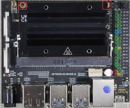

  1. Enter WIFI password and click “Connect” .
  1. The following prompt will remind you WIFI is connected.
Enter command “ifconfig” and press Enter to view the network connection status. If the IP of wlan0 “192.168.11.209” appears, network is connected successfully.

2. View Device
  1. Click “Device manger”. If you find “Remote NDIS Compatible Device #22”, which means device is connected.
3. View Device IP

  • Connection
1. IP Search

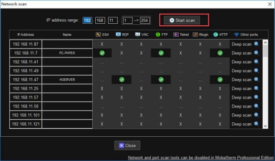

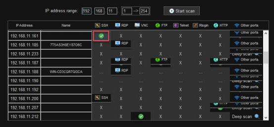

  1. IP address range is the possible address range of Jetson nano, generally fill in the first three input boxes with the same value as the computer IP, the last two are fixed to 1-> 254. then click “Start scan” to search for all active IPs in the network.
  1. After the password is input correctly, you will access to system successfully, as the figure shown below:
  1. Nomachine Tool. (remote desktop connection tool which can find under the same directory with this document.)
  2. Click “Next” .
  1. Select installation language as “English” . Check “I accept the agreement” and click “Next” .

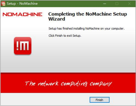

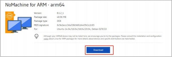

  1. Find “NoMachine for ARM” in page and click it to enter ARN version download page.
  1. Then click “NoMachine for ARM ARMv8 DEB” to enter the download page.

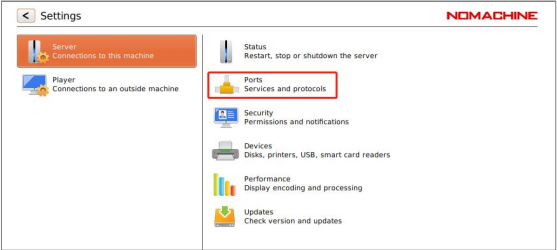

  1. Open Nomachine on computer and enter IP address “192.168.43.47” in search box and click “Connect to new host 192.168.43.47” .

1.2.7 SSH File Transfer
Before this lesson, please refer to the document “1.2.5 SSH Remote Connection”.

Realize file transfer between computer and Jetson Nano board through SSH.
  • Tranfer File via SSH
After SSH connection, find the file to be transferred on MobaXterm file zone, and drag file to computer desktop.

  2. Click “Create a New Virtual Machine” .
  1. Keep the default setting and click “Next” .

  1. After virtual machine is installed, click the orange box on system interface.
  1. Enter password and click “Sign In” .

2. Sign up NVIDIA DEVELOPER Account
Since the account of NVIDIA DEVELOPER website will be used in SDK Manager Tool, please following the steps below to sign up an account in advance.
If you already have an account on NVIDIA DEVELOPER website, you can jump directly to “1.2.11 Write eMMC System -> Install SDK Manger”.
  1. Enter NAVID DEVELOPER website “https://developer.nvidia.com/” and click “Join” button on the upper right corner.
  1. Enter your email that used to sign up account and click “Next” .
  1. Fill in your account information.
  1. Check “I am Human” to verify, and then click “Create account” .
  1. After signing up, return to the login. Select the second option (never skip this step!).
  1. After filling in the corresponding information, click “Submit” and check the option in following red box.

  1. Drag SDK Mange installation file from your computer desktop to the system desktop of virtual machine.
  1. Click on on taskbar to open file manger. Move the installation file of SDK Manager tool to home directory.

  1. Double click to open virtual machine. Click “Power on virtual machine”.
  1. After powering on, connect Jetson Nano ALT board to you computer through USB cable.
  1. If the following window appear, select “Connect to virtual machine” and select the virtual machine used. Then click “OK” to connect Jetson Nano to virtual machine.
  1. If the above window does not appear, you can click “Virtual machine/Mobile device/NVIDIA APX/Connect” on menu bar to connect Jetson Nano to virtual machine.

  1. Click “LOGIN” .
  1. Log in NVIDIA DEVELOPER website.
  1. Verification is required for account login. Click the link sent by NVDIA in the email to proceed.
  1. If the following window pops up, please check “No, disable usage collection” and click “OK” .
  1. Select “Jetson Nano” and click “OK” .
  1. On “STEP 01” interface, uncheck “Host Machine” and confirm whether the selected target hardware is correct.
If the development board does not be detected, please attempt to reconnect the USB cable between Jetson Nano board and computer.

  1. In the drop-down menu of “OEM Configuration”, select “Pre-Config” and set the username and password. Then click “Flash” .
If only “Jetson OS” is checked in installation options, please jump to step 29, which will cause some functions disabled.
  1. If check “Jetson SDK Components” , the relevant configuration window will appear.
  1. “Connection” and IP keep the default settings.
  1. Enter username and password and click “Install” .
