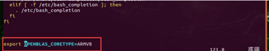

  1. Jump to the end of the file and press “i” . Enter command “export OPENBLAS_CORETYPE=ARMV8”, press “Esc”, enter “ :wq” and press Enter to save and exit the file.

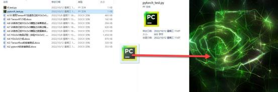

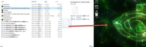

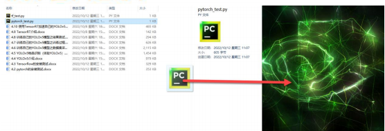

  1. Drag file “pytorch_test.py” under the same directory with this document to NoMachine desktop.
  1. Double click onto open command line terminal.
  2. Enter command “cd Desktop/” and press Enter to switch desktop.
cd Desktop/
  1. Enter command “python3 pytorch_test.py” and press Enter to run text code.

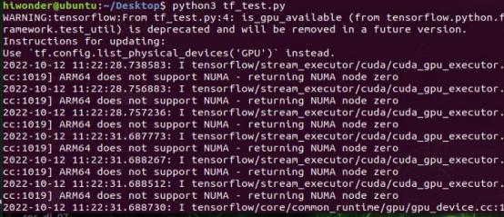

  1. Drag “tf_test.py” under the same directory with this document to NoMachine desktop.
  2. Enter command “cd Desktop/” and press Enter to swap desktop.
cd Desktop/
  1. Enter command “python3 tf_test.py” and press Enter to run the test code.
python3 tf_test.py

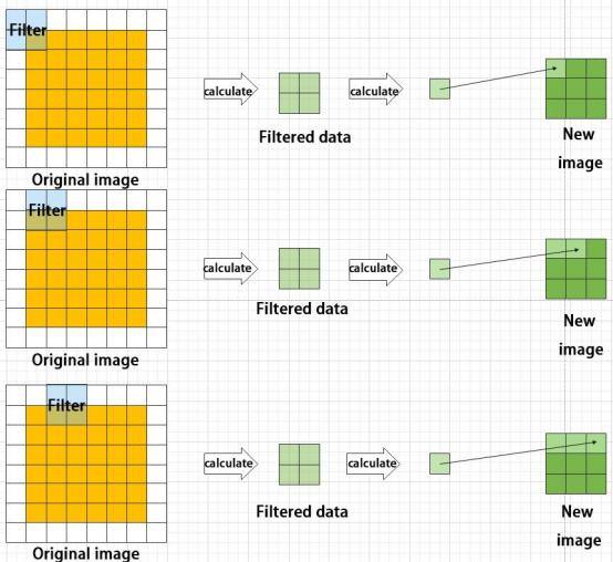

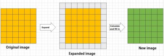

1. Convolution layer: extract features of the image

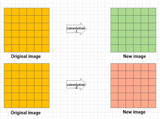

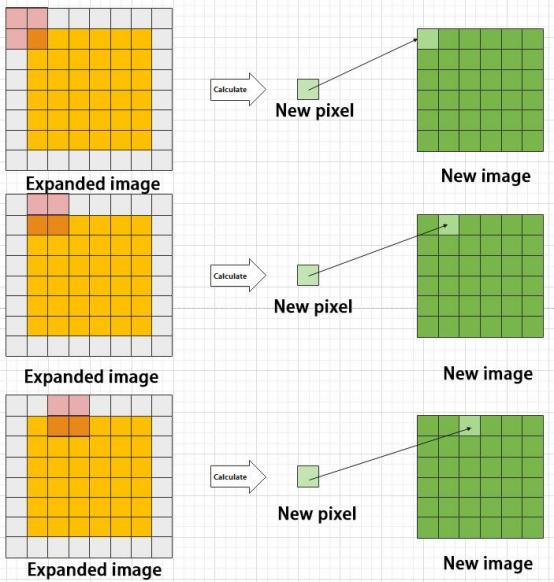

Convolution refers to the effect of a phenomenon, action or process that occurs repeatedly over time, impacting the current state of things. Convolution can be divided into two components: “volume” and “accumulation”. “Volume” involves data flipping, while “accumulation” refers to the accumulation of the influence of past data on current data. Flipping the data helps to establish the relationships between data points, providing a reference for calculating the influence of past data on the current data.
During convolution, the periphery of the image may remain unchanged or be expanded as needed, and the convolution result is then placed back into the corresponding position in the image. For instance, if an image has a resolution of 6 ×6, it may be first expanded to a 7 ×7 image, and then substituted into the convolution kernel for calculation. The resulting data is then refilled into a blank image with a resolution of 6 ×6.

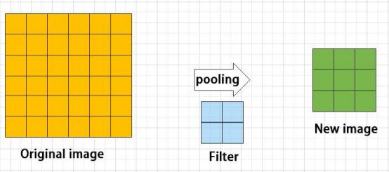

2. Pooling layer: enlarge the features of image
The pooling layer is an essential part of a convolutional neural network and is commonly used for downsampling image features. It is typically used in combination with the convolutional layer. The purpose of the pooling layer is to reduce the spatial dimension of the feature map and extract the most important features.
Let’s take maximum pooling as an example to explain how it works. Before understanding the maximum pooling, we need to understand the filter. Similar to the convolution kernel, the filter requires us to manually set the area. During the calculation, the filter is slid across the image, and the pixels in the area are compared. The maximum value of the pixels in the area is selected and becomes the output for that region. This process results in a reduced feature map size, which helps in reducing computational complexity and prevents overfitting.
In summary, the pooling layer plays a crucial role in feature extraction and downsampling. It helps to extract the most important features from an image and reduce the computational complexity of the neural network. Different types of pooling techniques can be used depending on the application requirements.

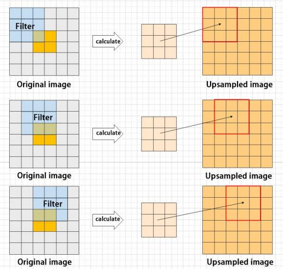

3. Upsampling layer: restore the size of an image
For example, let’s consider an image with a resolution of 6 ×6 pixels. Before upsampling, use 3X3 filter to calculate the original image so as to get the new image.

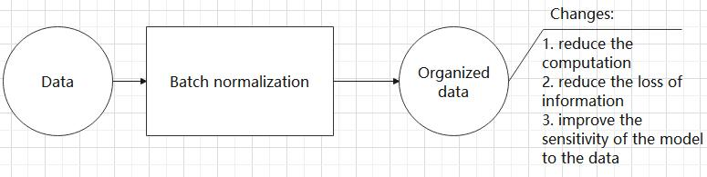

4. Batch normalization layer: organize data
Batch normalization works by standardizing the data within each mini-batch, which reduces the loss of information during the calculation process. By retaining more features in each calculation, batch normalization can improve the sensitivity of the model to the data.

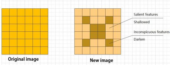

6. ADD layer: add tensor
In a typical neural network, the features can be divided into two categories: salient features and inconspicuous features.
The ADD layer works by adding the tensors of salient features, which can help to amplify their importance and improve the overall performance of the model.

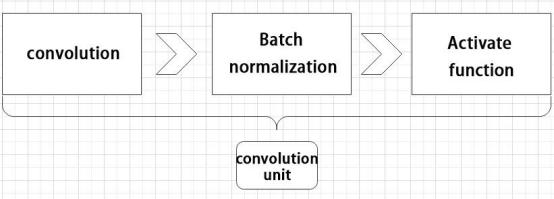

1. Convolutional unit:

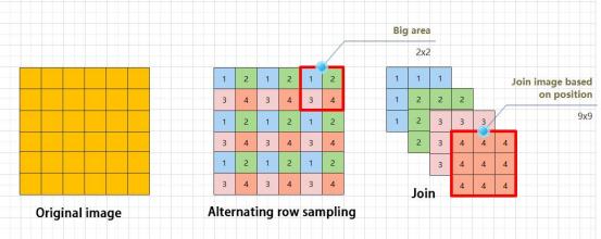

The Focus module for interleaved sampling and concatenation first divides the input image into multiple large regions and then concatenates the small images at the same position within each region to break down the input image into several smaller images. Finally, the images are preliminarily sampled using convolutional units.
As shown in the figure below, taking an image with a resolution of 6 ×6 as an example, if we set a large region as 2 ×2, then the image can be divided into 9 large regions, each containing 4 small images.
By concatenating the small images at position 1 in each large region, a 3 ×3 image can be obtained. The small images at other positions are similarly concatenated, and the original 6 ×6 image will be broken down into four 3 ×3 images.

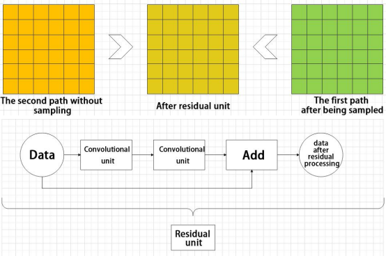

3. Residual unit
The function of the residual unit is to enable the model to learn small changes in the image. Its structure is relatively simple and is achieved by combining data from two paths.

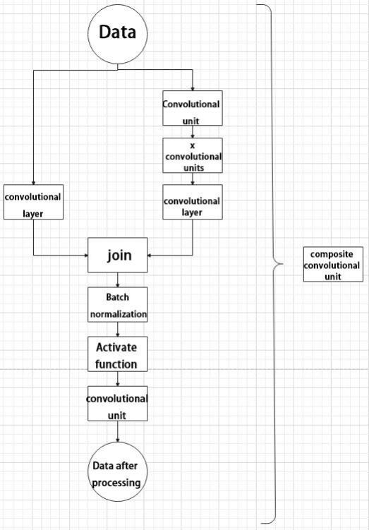

4. Composite Convolution Unit
The first path only has one convolutional layer for sampling, while the second path has 2x+1 convolutional units and one convolutional layer for sampling. After sampling and splicing, the data is organized through batch normalization and then activated by an activation function. Finally, a convolutional layer is used for sampling.’

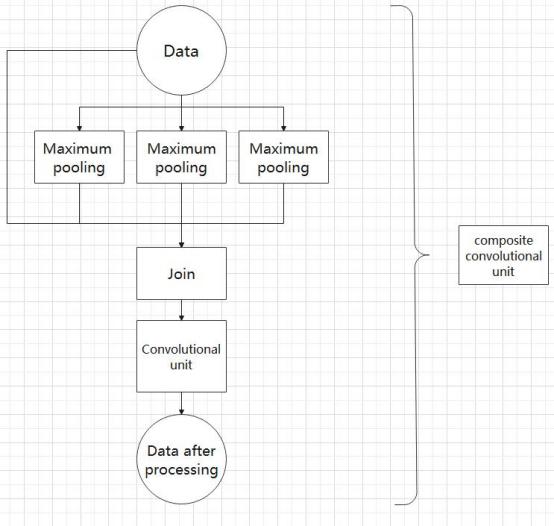

6. Composite Pooling Unit
The output data of the convolutional unit is fed into three max pooling layers and an additional copy is kept without processing. Then, the data from the four paths are concatenated and input into a convolutional unit. Using the composite pooling unit to process the data can significantly enhance the features of the original data.’

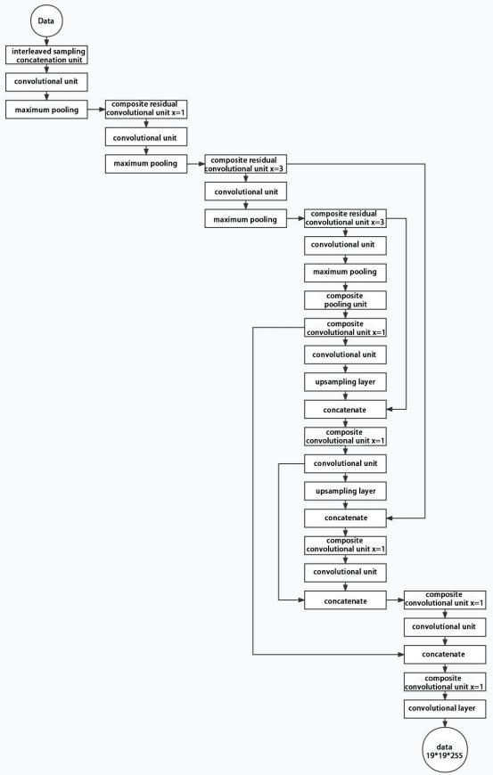

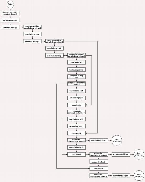

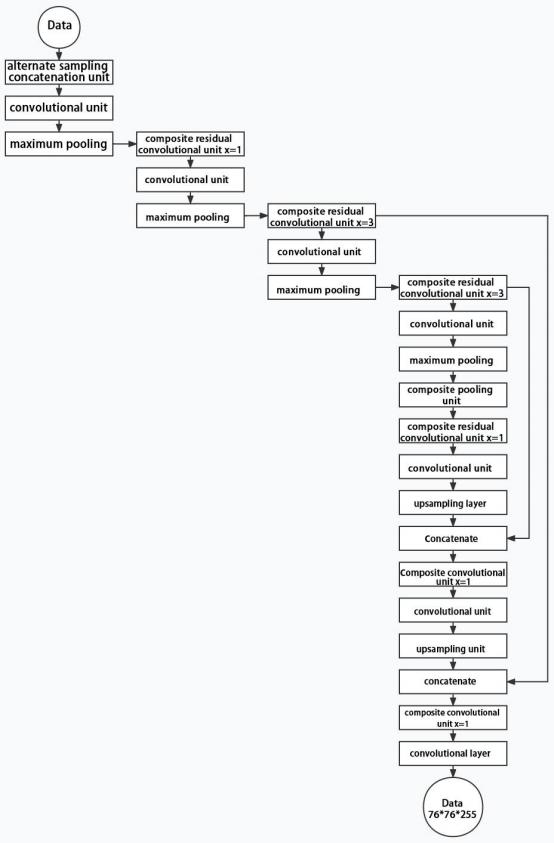

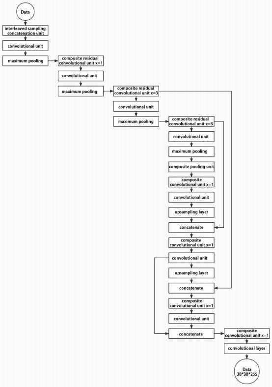

  • Structure
Composed of three parts, YOLOv5 can output three sizes of data. Data of each size is processed in different way. The below picture is the output structure of YOLOv5.

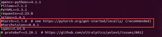

  1. Enter command “vi requirements.txt” and press Enter to open Yolo5 folder.
vi requirements.txt
Modify the file according to the following image.

  1. Drag “torchvision-0.11.0a0+fa347eb-cp36-cp36m-linux_aarch64” under the same directory with this document to NoMachine desktop.
  1. Enter command “cd Desktop/” to switch desktop.
cd Desktop/
  1. Enter command “pip install torchvision-0.11.0a0+fa347eb-cp36-cp36m-linux_aarch64.whl” and press Enter to install torchvision.

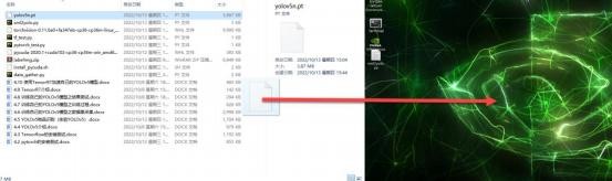

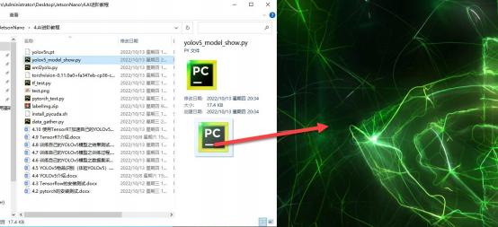

  1. Drag “yolov5n.pt” under the same directory with this document to NoMachine desktop.
  1. Double click on to open the command line terminal.

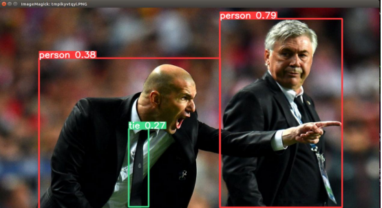

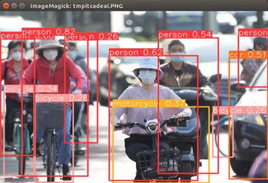

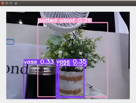

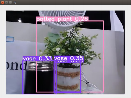

  1. Enter command “python3 detect.py –weights yolov5n.pt –source 0” and press Enter to start target detection.
python3 detect.py --weights yolov5n.pt --source 0
This step is for USB camera. If you don’t have it, please directly move to next step. After finishing this step and displaying image from camera, it means the model has been enabled, no need to proceed to following steps.
Waiting for a period of time. The camera returned image will display. Finally, select command line terminal and press “Ctrl+C” to close the display.

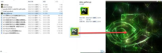

  3. Zoom in NoMachine desktop. Drag “data_gather.py” under the same directory with this document to NoMachine desktop.

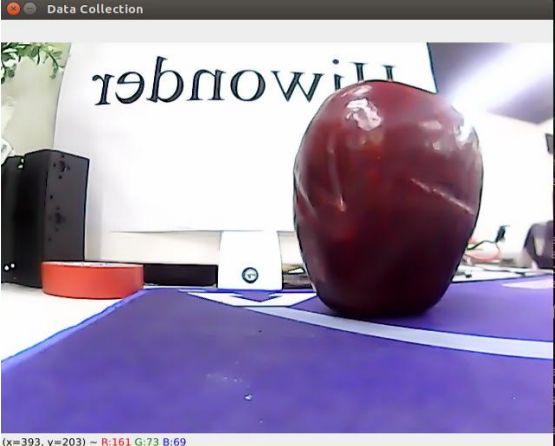

  1. Enter command “python3 data_gather.py” and press Enter to start collect data.
The returned camera image appears, as the figure shown blow.
  • Press “S” to save the returned camera image. Long press “S” for continuous save.
  • Press “Q” to exit program.
  • To improve the model reliability, please shot object to be recognized from different distances, rotation angles and tilt angles.
After starting data collection, “My_data” folder is created on the desktop, which contains three folders: Annotations, imageSets, and JPEGImages, where JPEGImages is used to store images, Annotations is used to store annotations, and imageSets is used to store paths to images.

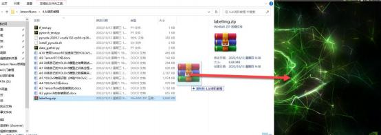

  1. Zoom in NoMachine desktop, and drag “labelImg.zip” under the same directory with this document to NoMachine desktop.

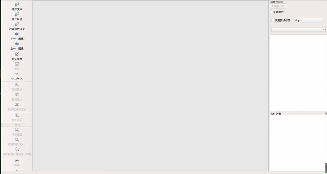

  1. Enter command “python3 labelImg.py” and press Enter to open annotation software.
python3 labelImg.py
Button Shortcut Key Function
Ctrl+U Select the directory where the picture is saved
Ctrl+R Select the directory where the calibration data is saved
W Create annotation box
Ctrl+S Save annotation
A Swap to the previous image
D Swap to the next image

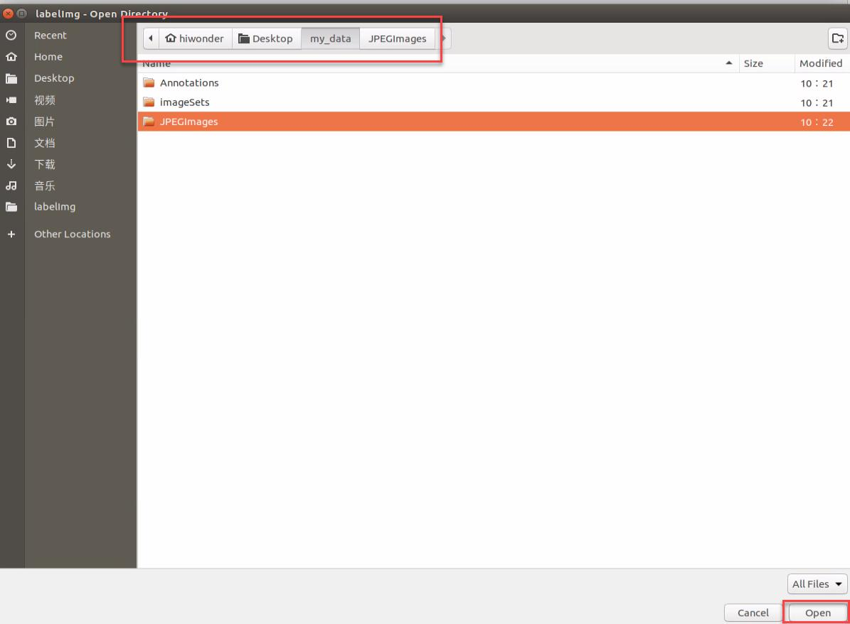

  1. Press “Ctrl+U” and select the directory
/home/hiwonder/Desktop/my_data/JPEGImages/” where the image is saved. Then click “Open” .

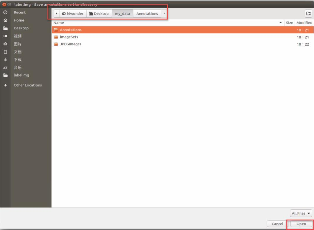

  1. Press “Ctrl+R” and select directory “/home/hiwonder/my_data/Annotations/” where calibration data is saved . Then click “Open”.

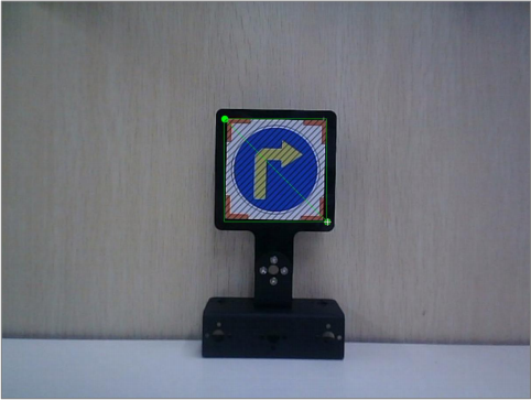

  1. Press “W” key on keyboard to create annotation box.
Move your mouse cursor to the appropriate position. Long press the left mouse to drag the marker box to completely cover the recognition object. Then release mouse button to complete the selection of the recognition object.
  1. Name the category of the recognition objects in the pop-up window. Here it is “right” . Then click on “OK” or press “Enter” to save this category.
label name can be modified by yourself.
  1. Use “Ctrl+S” to save the annotation data of the current image.
  2. Complete the annotation operations to other images according to steps 4-6.

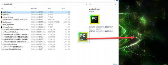

  2. Zoom in NoMachine window and drag “xml2yolo.py” under the same directory with this document to NoMachine desktop.
  2. Enter command “cp ./Desktop/xml2yolo.py ./Desktop/my_data/” and press Enter.

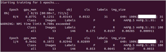

  1. Enter command “python3 train.py –img 640 –batch 8 –epochs 5 –data /home/hiwonder/Desktop/my_data/data.yaml –weights ./my_yolov5.pt” and press Enter to train model.
python3 train.py --img 640 --batch 8 --epochs 5 --data /home/hiwonder/Desktop/my_data/data.yaml --weights ./my_yolov5.pt
In command, --img is the image size. --batch is the number of single inputs for image. --epochs is the numbers of training. --datais the path to data set. --weights is the name and path of weights. The model will finally be stored in yolov5 folder named my_yolov5.pt. The above parameters can be modified. If want to increase the model reliability, you can increase the training times but it needs to take longer time.
The used data require to be collected from “4.6 Data Set Acquisition”.
  1. When the following option appears, enter “3” and press Enter.
If the following content appear, it is training.

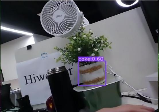

  1. Enter command “python3 detect.py –weights my_yolov5n.pt –source 0” to start target detection.
Without camera, you can directly skip this step. After complete this step and see the live camera feed, it means the model is enabled.
python3 detect.py --weights my_yolov5n.pt --source 0
  1. Wait for a while, the boxes on live camera feed occur, which means model has been enabled.
class_name is the category name of target recognition content. box is the start coordinate (upper left corner) and end coordinate (lower right corner) of the identification box. score is the confidence of detection and recognition.
Finally, select the command bar and press “Ctrl+C” to close it.

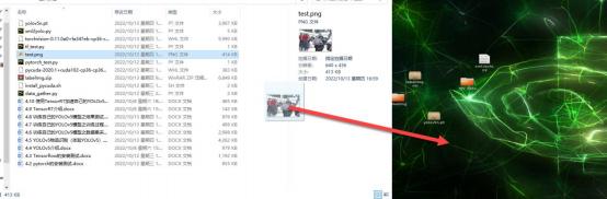

  1. Drag the picture for target detection to the desktop of NoMachine. Take the picture “test.png” as example.
