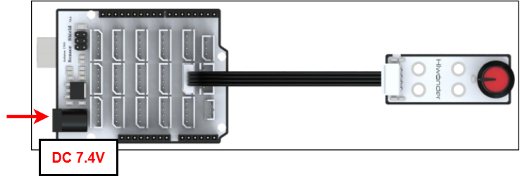

This section illustrates connecting a 4-pin cable to the A2 and A3 ports on the Arduino expansion board. Refer to the diagram below.

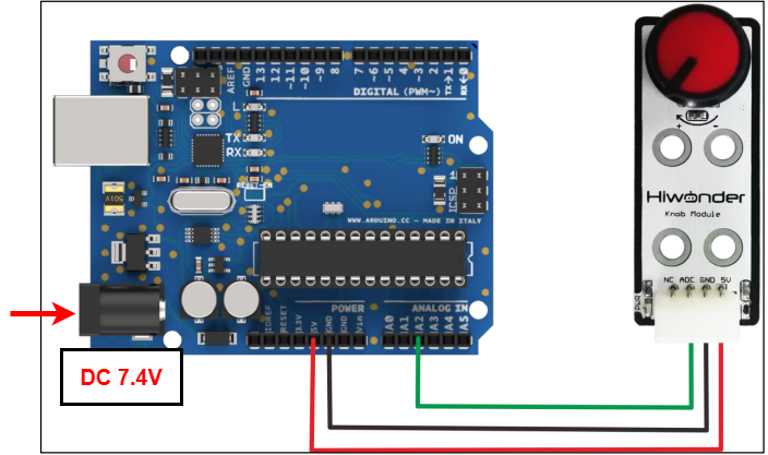

If you do not have an Arduino expansion board, use a Dupont wire to directly connect to the Arduino development board, just as below:
  • Before powering on, ensure that no metal objects are touching the controller. Otherwise, the exposed pins at the bottom of the board may cause a short circuit and damage the controller.

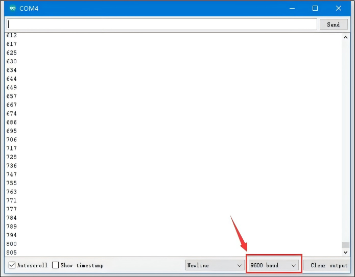

  1. After the code is uploaded, click to open the serial monitor, set the baud rate to 9600 to observe the output.
2.2.2 Project Outcome
Rotate the potentiometer on the sensor to observe the data changes on the monitor displays. Rotate the knob clockwise to increase the displayed value; rotate it counterclockwise to decrease the value.
