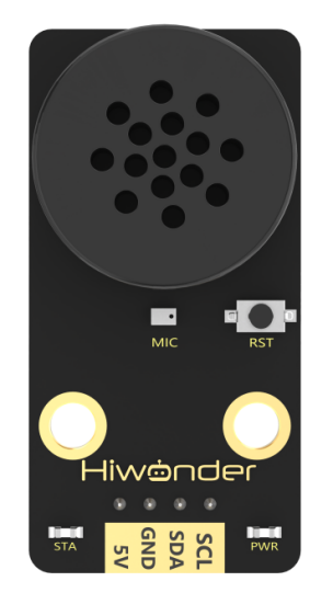

  • Voice Interaction Module Introduction
(1) Module Introduction
The integrated voice interaction module (WonderEcho) is based on the CI1302 chip, designed for voice recognition and playback. It supports offline neural network (NN) acceleration and hardware-accelerated voice signal processing. Through deep noise reduction and neural network models, it analyzes audio to produce recognition results.
The CI1302 chip features a Brain Neural Processing Unit (BNPU), enabling offline NN acceleration and voice signal hardware acceleration. With a CPU clock speed of up to 220 MHz, it supports offline far-field voice recognition. It also includes 2MB of built-in flash memory, capable of storing up to 300 command phrases.
This module is easy to operate and offers excellent voice recognition performance, making it widely applicable in areas such as smart home systems, conversational robots, educational robots, and in-vehicle dispatch terminals.
(2) How It Works
This module uses a wake-word mode for activation. Users need to say the wake word to activate the voice interaction module before recognition can begin. By default, the module recognizes English. The English wake word is “Hello Hiwonder.” To switch to Chinese recognition, you need to flash the Chinese recognition firmware. After switching, the Chinese wake word is “小幻小幻” (Xiao Huan Xiao Huan). If no voice input is detected within 15 seconds, the module enters sleep mode and requires reactivation by the wake word.
When the CI1302 chip detects a matching voice command, it sends the corresponding instruction to the IIC chip and provides voice feedback. The IIC chip stores the received voice command and sends it out via the IIC slave protocol. For detailed voice command lists, please refer to the “Command and Playback Protocol List” located in the same directory as this document.

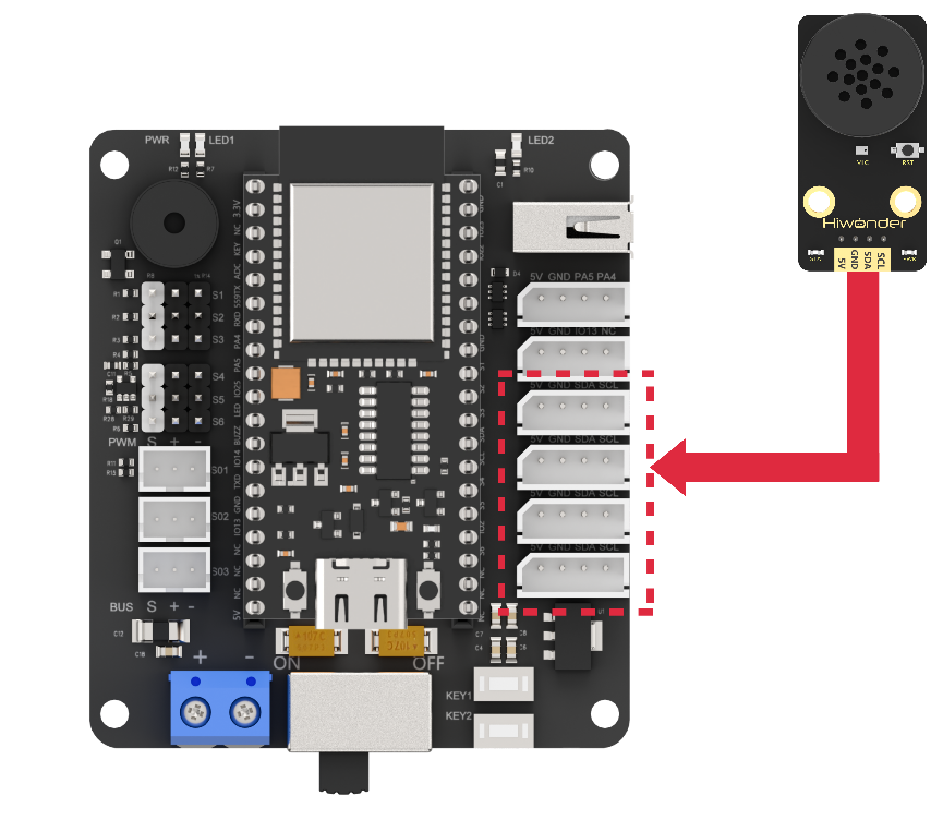

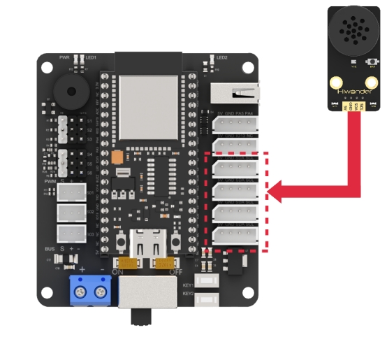

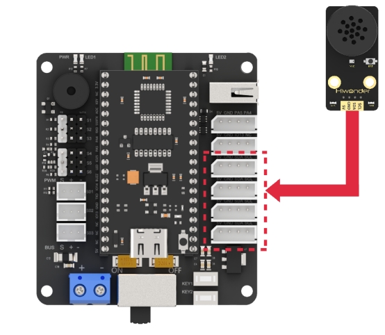

  • Module Wiring
Module Wiring: As shown in the figure below, before running the program in this lesson, please connect the module to any IIC interface within the red box on the servo control board.

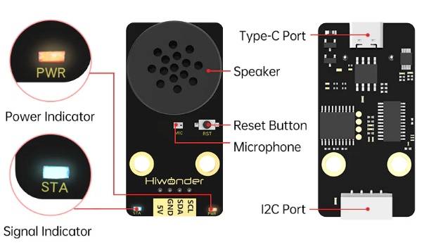

  • Hardware Interface Description
NO. Name Feature Description
1 Speaker Converts analog signals into sound
2 Microphone Converts sound into analog signals
3 RST button Reset Button
4 Signal Indicator LED (Blue) Steady on; flashes once when a voice command is recognized
5 Power Indicator LED (Red) Steady on when power supply is normal
6 IIC Ports Acts as an IIC slave for power supply and communication with host device
7 Type-C port Used for power supply and firmware updates for the CI1302 chip
8 CI1302 chip High-performance voice recognition chip that processes voice commands and outputs signals
9 IIC chip Converts commands from the voice recognition chip into IIC protocol commands
10 Amplifier Chip Converts digital signals to analog signals to drive the speaker

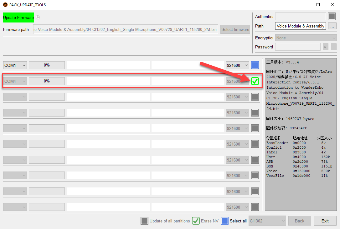

  • Flashing the Firmware

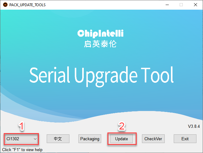

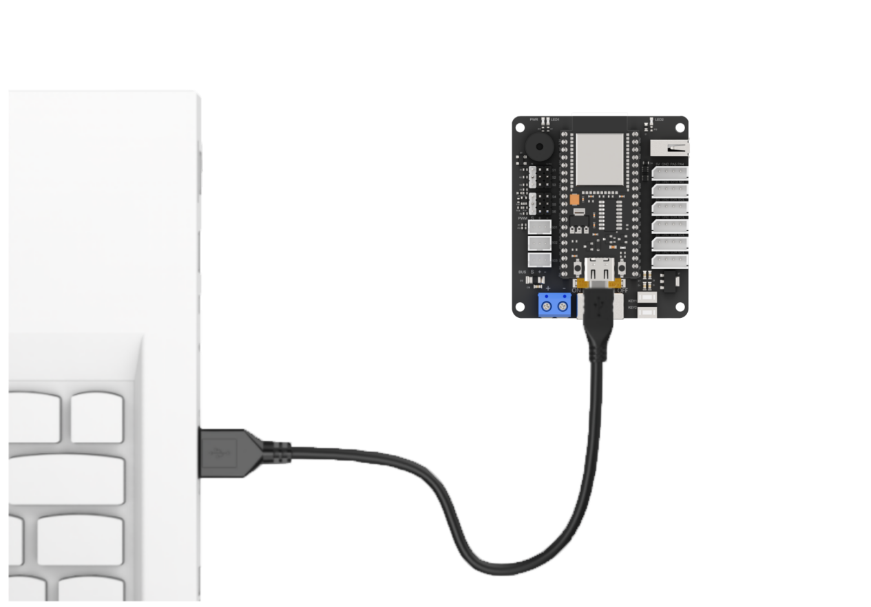

(1) First, connect the voice interaction module to your computer using a Type-C data cable.
(2) Open the PACK_UPDATE_TOOL.exe located in the Appendix->Firmware Update Tool folder in the same directory as this document. Select the “CI1302” chip, then click “Firmware Upgrade.”
(3) Click “Select Firmware” and locate the file named “CI1302_Chinese_single microphone_V00729_UART1_115200_2M.bin” in the same directory as this document. Select the appropriate COM port from the list.
(4) Identify the correct COM port and select it.
(5) Press the RST button on the WonderEcho to initiate the flashing process. Wait for the process to complete successfully.

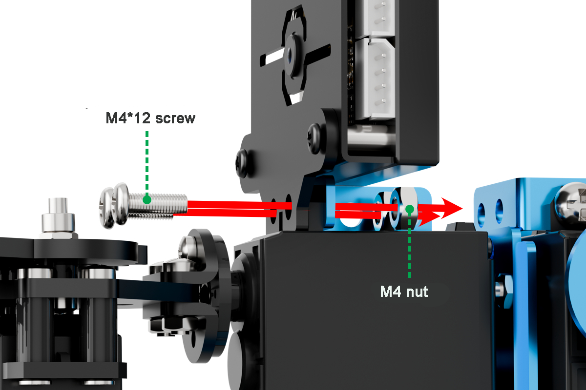

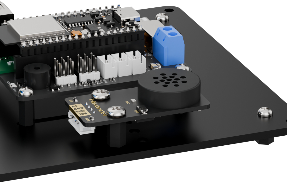

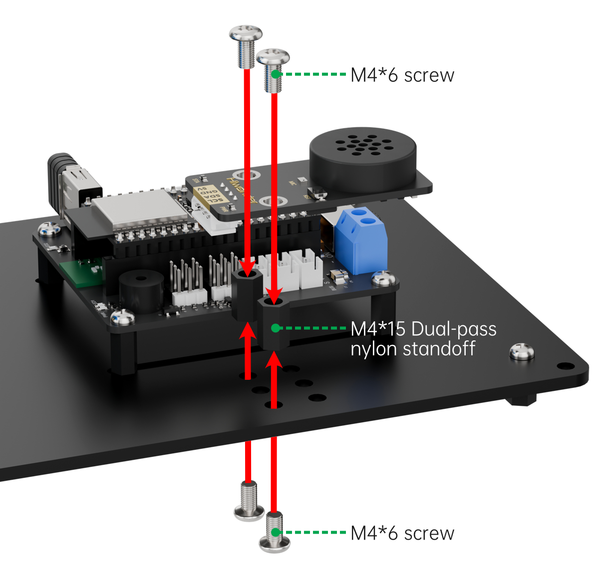

8.1.3 Module Assembly
Command and Broadcast Word Protocol List (English).xlsx
CI1302_English_Single Microphone_V00729_UART1_115200_2M.bin

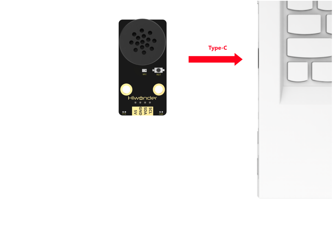

8.2.2 Device Connection
Connect the voice interaction module to your computer using a Type-C cable, or power it using a 4-pin cable.

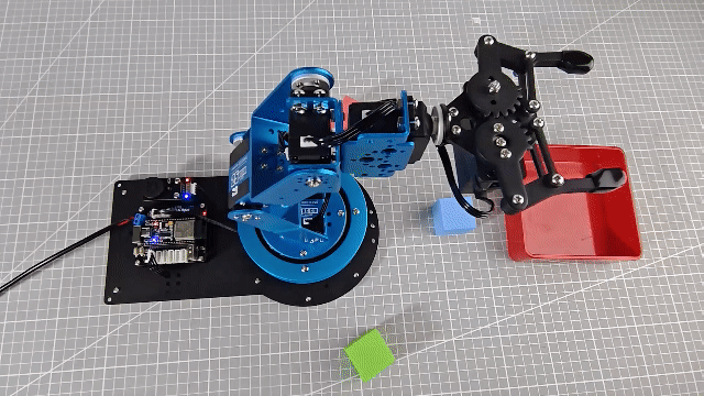

8.3.1 Project Description

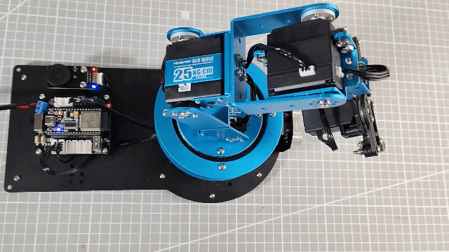

In this lesson, the system recognizes user commands and picks up different colored blocks accordingly.
8.3.2 Program Procedure

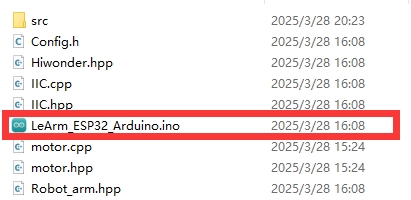

(2) Locate the corresponding example project folder within the Arduino workspace located in the same directory as this document.
(3) Open the project, then select the appropriate development board model as shown in the figure below.

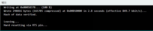

(4) First, click “Compile”, then click “Upload”. Once the upload completes successfully, if the output window at the bottom of the software displays the screen shown below, the program has been downloaded successfully.
8.3.5 How It Works

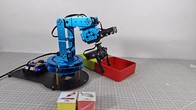

After powering on the device, say the wake-up phrase “HELLO-HI-WONDER” to activate the voice interaction module. The module will respond with “I’m here.” You can then speak other commands to start the sorting activity.
The program recognizes the commands “SORT-RED,” “SORT-GREEN,” and “SORT-BLUE,” and controls the robotic arm using inverse kinematics to pick and sort the corresponding colored blocks.
If no new command is received for an extended period, the module will respond with “I’m going to take a break” and enter sleep mode. To continue, you’ll need to wake it up again.

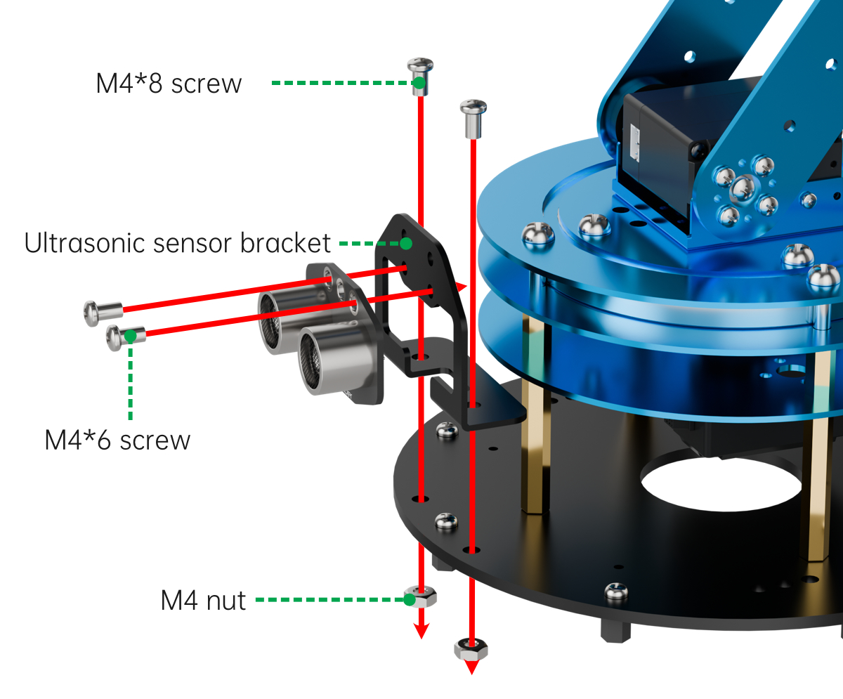

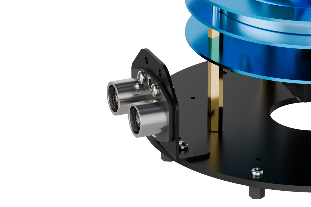

8.4.1 Assembly
8.4.2 Project Description
This lesson controls the RGB light color based on the obstacle distance and broadcasts corresponding voice commands.

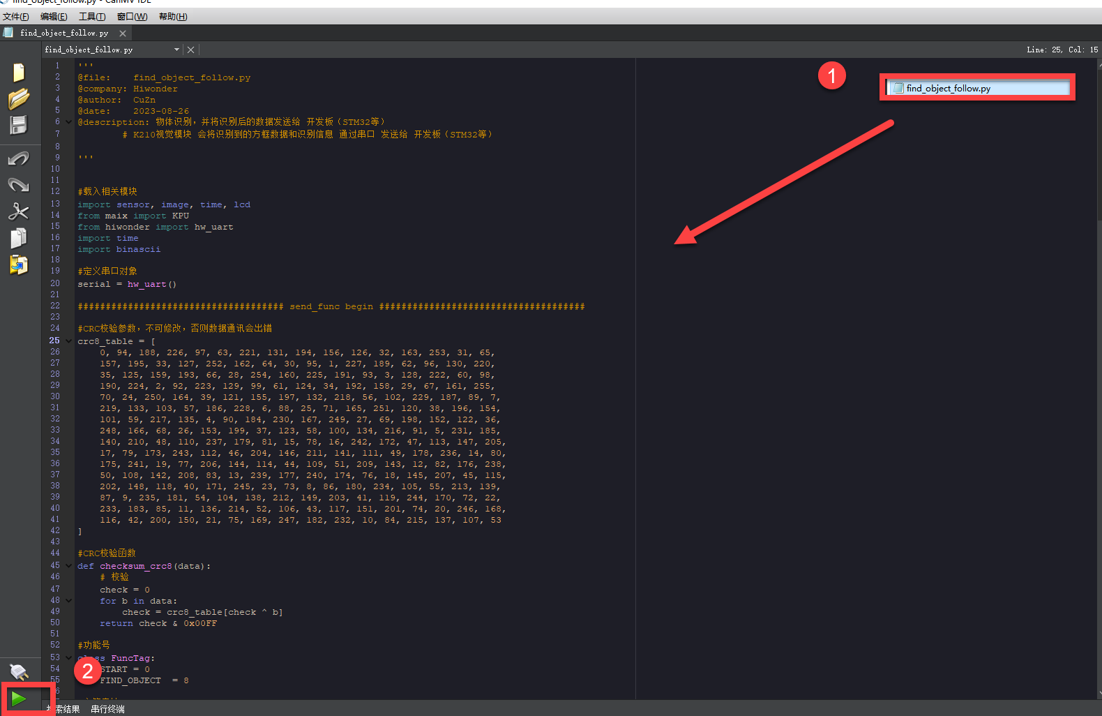

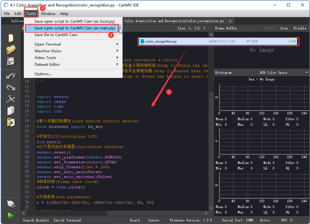

(2) Program Import & Running

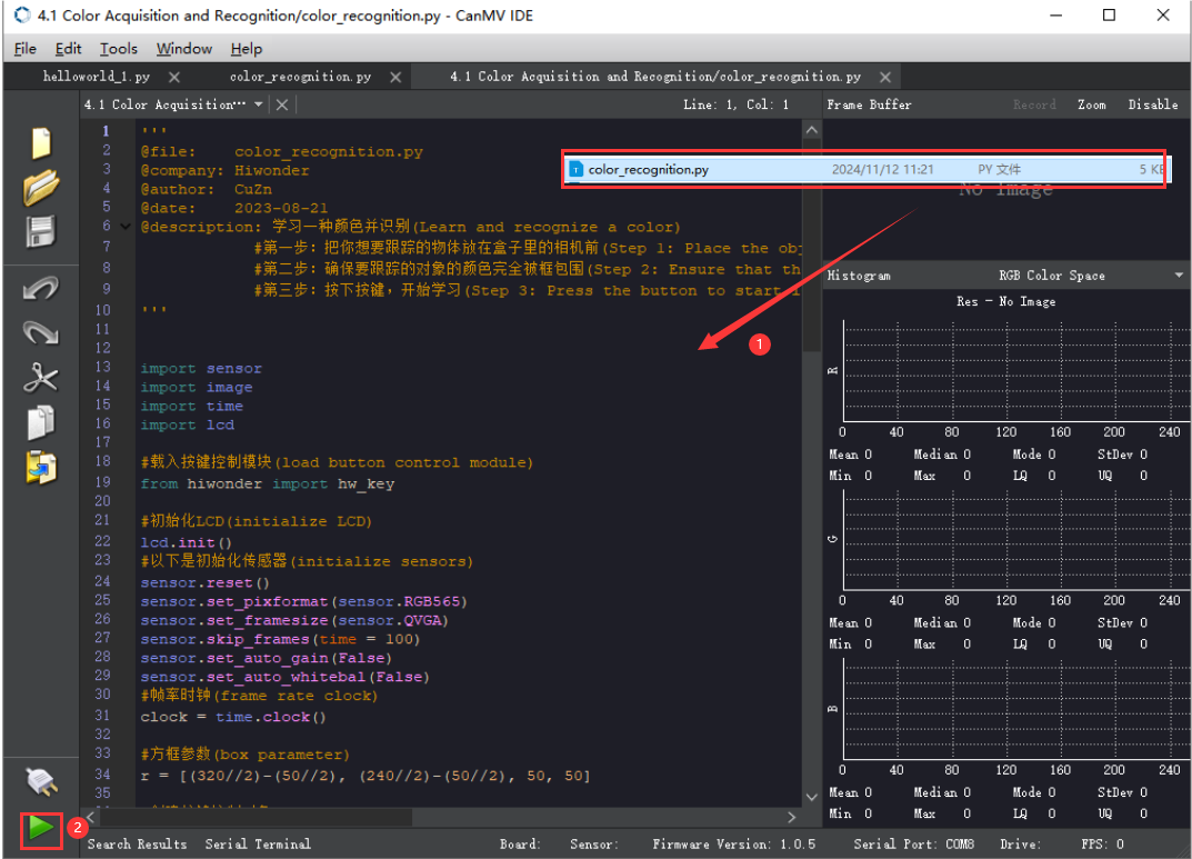

① Double-click the icon to open the CanMV IDE development software.
② Click in the bottom left corner.
③ Select the corresponding serial port number. Check “Advanced Settings”, and select “Mode-3”.
④ Click “OK” and wait for the connection to be completed.
⑤ After the connection is successful, the CanMV IDE displays the icon in the bottom left corner.
⑥ If the connection takes more than 10 seconds, it indicates a connection failure. Click “Cancel”, and a pop-up window shown below appears. Click “OK” and re-check the connection.
Tips for connection failure:
  • Incorrect COM port selected: Disconnect other USB devices from your PC to reduce interference, then repeat the above steps and ensure the correct COM port is selected.
  • Cable is not a data cable: Some Type-C cables are for charging only and do not support data transmission. Please use a Type-C cable with data transfer capability (a Type-C data cable is included with our product).
  • Other firmware has been flashed to the K210 module: Reflash the factory firmware and then reconnect.
There are two modes for running programs on the K210 vision module: Online Mode and Offline Mode.
Online Mode: In this mode, after connecting the module, drag the program file from this lesson’s folder into the CanMV IDE code editor. Then click the Run button in the lower left corner to execute the program online, as shown below.
Programs run using this method will be lost once the device is disconnected or powered off—they are not saved to the vision module.
Offline Operation
Offline Mode: After connecting, drag the program file from this lesson’s folder into the CanMV IDE code editor.
  • Click the “Tools” menu in the toolbar, and select “Save current script as (main.py) to CanMV Cam” as shown below.
  • Then click “Yes” to confirm.
  • A prompt will appear indicating that the script has been written successfully—click “OK”. This saves the MicroPython script to the K210 vision module.
In this mode, the K210 can run the script automatically when powered on, even without a PC connection—enabling true offline operation.

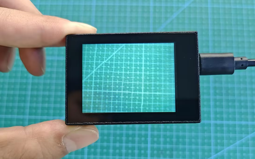

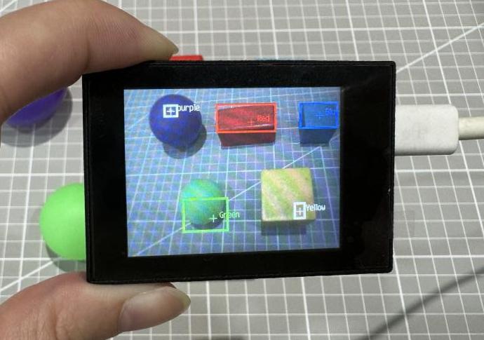

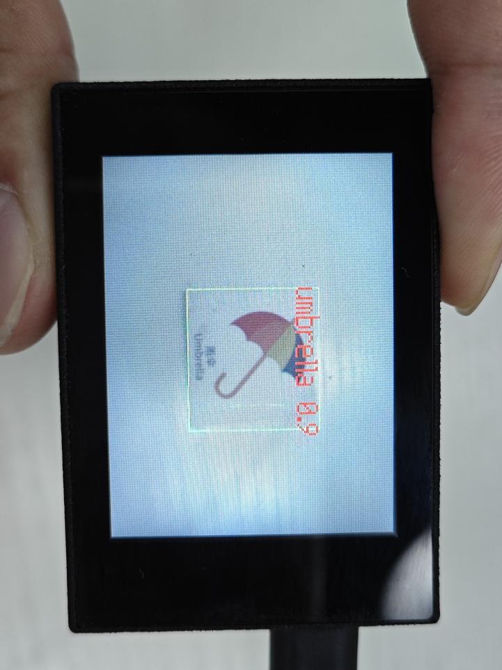

  • Running Effect
Place the garbage card within the recognizable range. The K210 vision module will highlight and label the detected garbage card area, displaying it on the LCD screen.

This lesson enables garbage sorting via voice command, allowing the robotic arm to automatically recognize and sort waste.

(1) Introduction to WonderEcho Voice Module

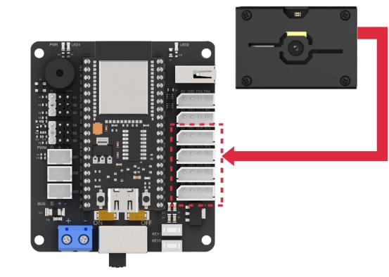

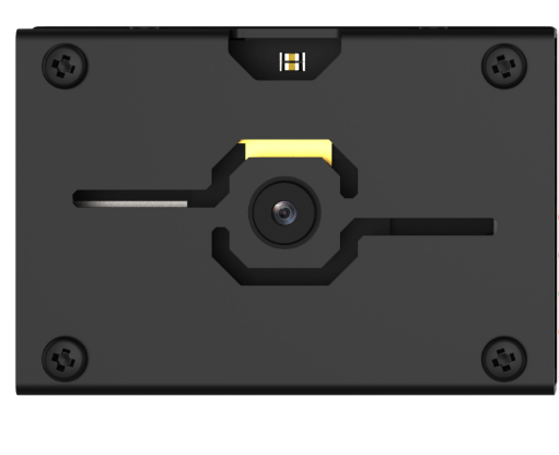

(2) WonderMV Vision Module
The WonderMV module features a high-performance built-in K210 chip, enabling users to implement AI vision functions such as color recognition and face detection through programming. Equipped with an IIC interface, this module allows easy data communication with various main control devices, providing an efficient solution for intelligent vision applications.

(1) Connect the core board to the computer using the USB cable.

After powering on the device, say the wake-up phrase “HELLO-HI-WONDER” to activate the voice interaction module. The module will respond with “I’m here.” You can then speak additional commands to start the activity.
Once the robotic arm is powered on, users can say “START-WASTE-SORTING” or “STOP-WASTE-SORTING” to enable or disable the waste sorting function. When the function is enabled, the robotic arm will recognize the type of waste, announce the category, and then pick it up and place it in the corresponding area.
If no new command is given for a period of time, the module will respond with “I’m going to take a break” and enter sleep mode. To resume the activity, the system must be reawakened.

  • The grab-and-place logic for the four types of garbage is highly similar. Here, we take recyclable waste as an example:
  • First, call the speak method of the voice interaction module to play the speech entry with type 0xFF (broadcast message) and ID 1, which corresponds to the phrase “Recyclable Waste.”
Broadcast Phrase ID
Recyclable Waste 1(0x01)
Food waste 2(0x02)
Hazardous waste 3(0x03)
Other waste 4(0x04)
  • Call the coordinate_set method of the robotic arm object to control the arm using inverse kinematics. The movement takes 1200 ms and brings the arm to the coordinates corresponding to “descend toward the object to be picked.” At this point, the claw moves down above the target object.
  • Then, call the claw_set method to control Servo 1 of the robotic claw to rotate to 30°, causing the claw to close and grip the object.
  • Next, call the coordinate_set method again to move the robotic arm to the “lift-up transition pose after gripping”. This movement takes 1000 ms, during which the gripped object is lifted.
  • Then, call the coordinate_set method to move the robotic arm to the coordinates corresponding to “descend toward the recyclable waste drop-off area.” This movement also takes 1000 ms. At this stage, the robotic arm rotates to face the direction of the drop-off area and descends, positioning the gripped object directly above the drop-off zone.

  • Getting Ready
(1) Device Connection
Connect the vision module to a computer with a Type-C data cable.
(2) Download and Run Program
① Double-click to open the software.
  • The selected serial port number is wrong. Please unplug other serial ports connected to your PC. Try the above steps again to select the correct serial port number.
  • The cable used for the connection is not a data cable. Use a Type-C data cable that supports data transmission. A Type-C data cable is included in the package before delivery.
  • Other K210 firmware is flashed. Reflash the factory firmware, and then proceed with the connection.
There are two ways to run K210 programs: online and offline.
Online operation:
After connecting successfully, drag the program under the same folder as this lesson to the code editor area of CanMV IDE. Click the at the bottom left corner to run the program online.
Programs run in this way will be lost when the connection is disconnected or the device is shut down. They will not be saved on the K210 vision module.
Offline operation:
① After connecting, drag the program under the same directory to the CanMV IDE code editing area. Click “Tools” on the toolbar. Select “Save open script to CanMV Cam (as main.py)”.
② Click “Yes”.
③ Once the writing is successful, a window shown below will appear. Click “OK”. This saves the MicroPython file into the K210 Vision Module.
By downloading in this way, after powering on the K210 Vision Module without connecting, it will run the MicroPython file, enabling offline operation.

  • Program Outcome
The factory program comes preloaded with threshold values for red, green, blue, yellow, and purple. Once the program is running, simply place objects in these colors within the detection range of the K210 vision module. The module will automatically recognize them and draw bounding boxes around the detected colored objects, as shown in the image below.

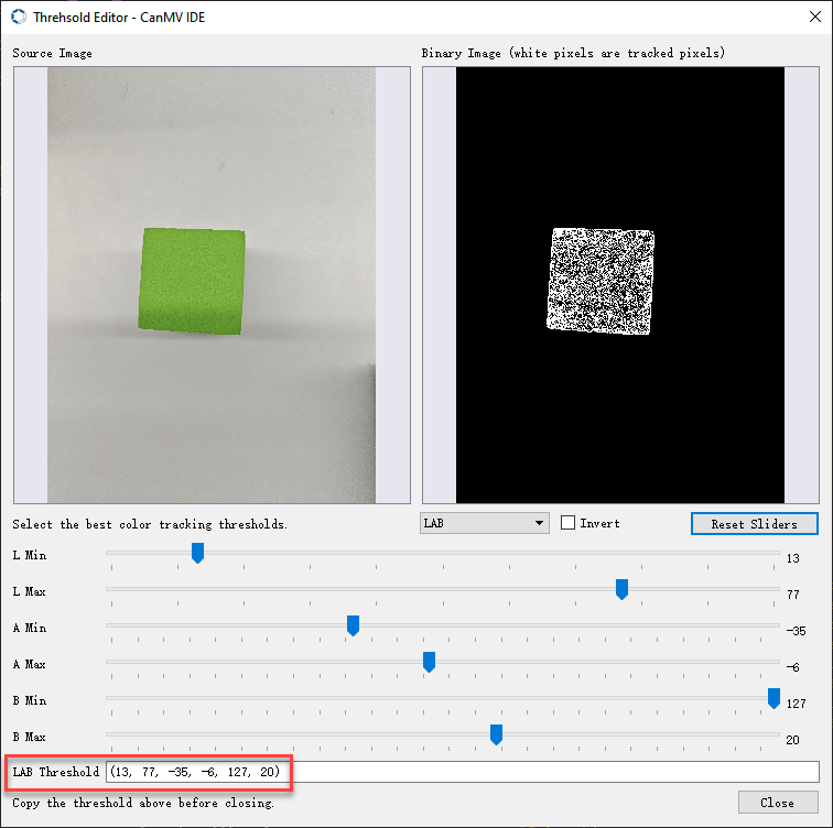

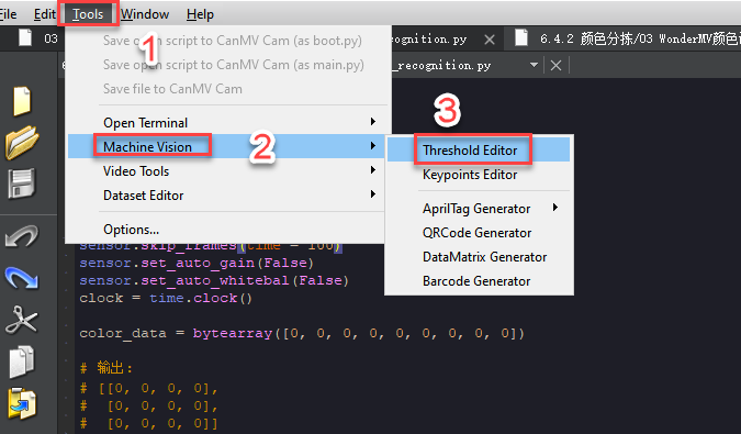

(2) How to Obtain LAB Thresholds for New Colors
You can use the tools provided in the CanMV IDE to obtain LAB threshold values for additional colors.
① Double-click to open CanMV IDE, then go to Appendix → Machine Vision → Threshold Editor to launch the Threshold Editor tool.
② Click on Image File.
③ Select an image that contains the color you want to add (preferably with a clean background and minimal color interference).
④ Adjust the sliders until the target color region turns completely white while all other regions turn black. Then, record the resulting LAB threshold values.

  • Project Description
In this lesson, the user gives a voice command specifying the color to be sorted (from three available colors). The robotic arm then locates the corresponding color block and picks it up to hand it to the user.

  • Module Introduction
  • How It Works
Once the robotic arm is powered on, users can issue commands such as “Sort red,” “Sort green,” or “Sort blue.” The robotic arm will continuously scan the three designated areas for colored blocks. When it detects a matching color, it will pick up the block and hand it to the user.
If no new command is received for an extended period, the module will respond with “I’m going to take a break” and enter sleep mode. To continue the activity, the system must be reawakened.
