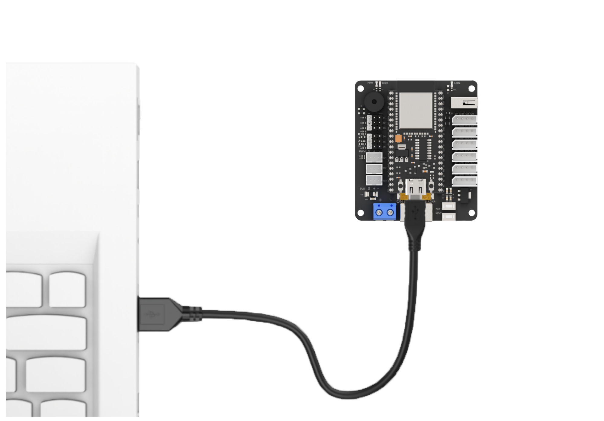

9.1.2 Hardware Connection
Before downloading the program, please ensure that the serial port driver is properly installed.
Connect the computer’s USB port to the USB-to-serial port on the mainboard using a USB download cable.
