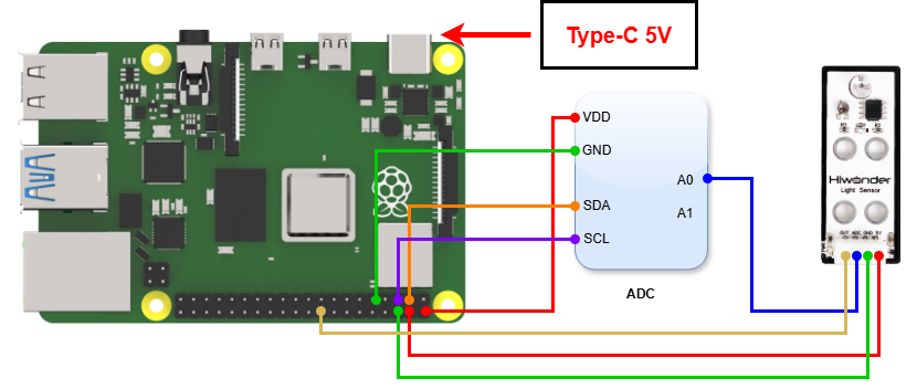

3.1.1 Wiring Instructions
This section illustrates connecting the ADC module to the light sensor using jumper wires. Refer to the diagram below for wiring:
  • When using Hiwonder’s lithium battery, ensure that the battery connector is wired correctly: red to “+” and black to “–” on the DC interface.
  • If the connector is not attached to a lithium battery, do not connect it directly to the battery leads to avoid short circuits caused by reversed polarity.
  • Before powering on, make sure no metal objects come into contact with the controller. Otherwise, exposed pins on the underside of the board may cause a short circuit and permanently damage the board.

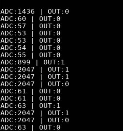

3.2.2 Program Outcome
Use the light sensor to measure ambient light intensity. When the photodiode is covered, the sensor reading exceeds 900, above the threshold; LED1 turns off, and the terminal displays 1. When uncovered, the reading drops below the threshold, LED1 turns on, and the terminal displays 0.
