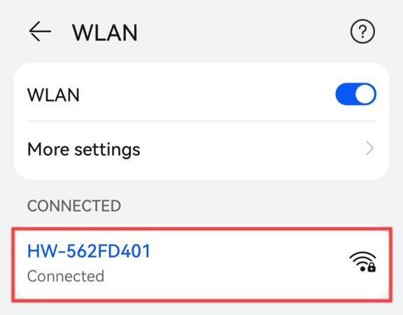

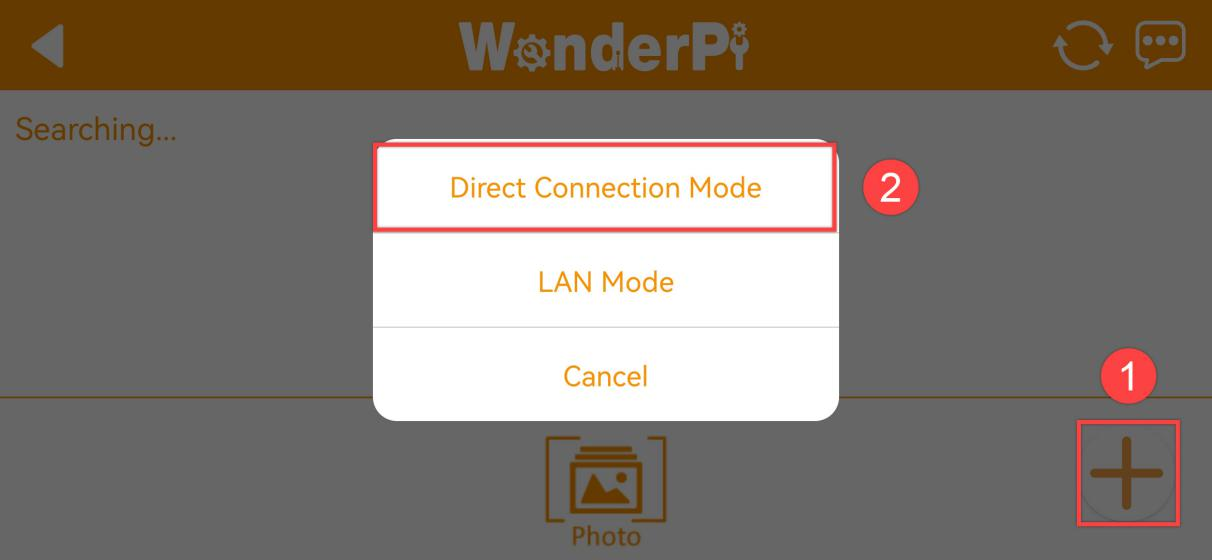

After TurboPi boots up successfully, it enters AP direct connection mode, and generates a WiFi starting with “HW”.

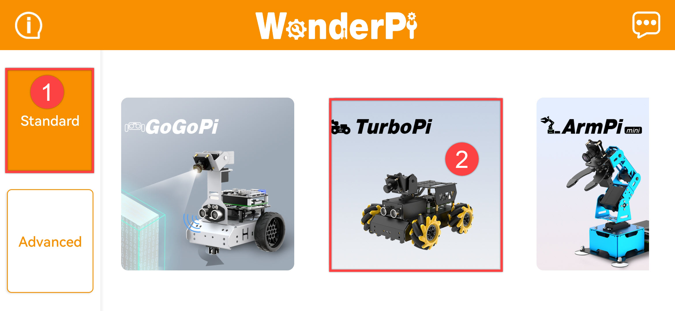

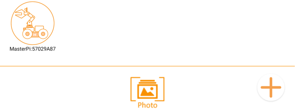

(1) Open”WonderPi”. Select “Standard ->TurboPi” in sequence.
(2) Tap “+” in bottom right corner, and then select Direct Connection Mode.

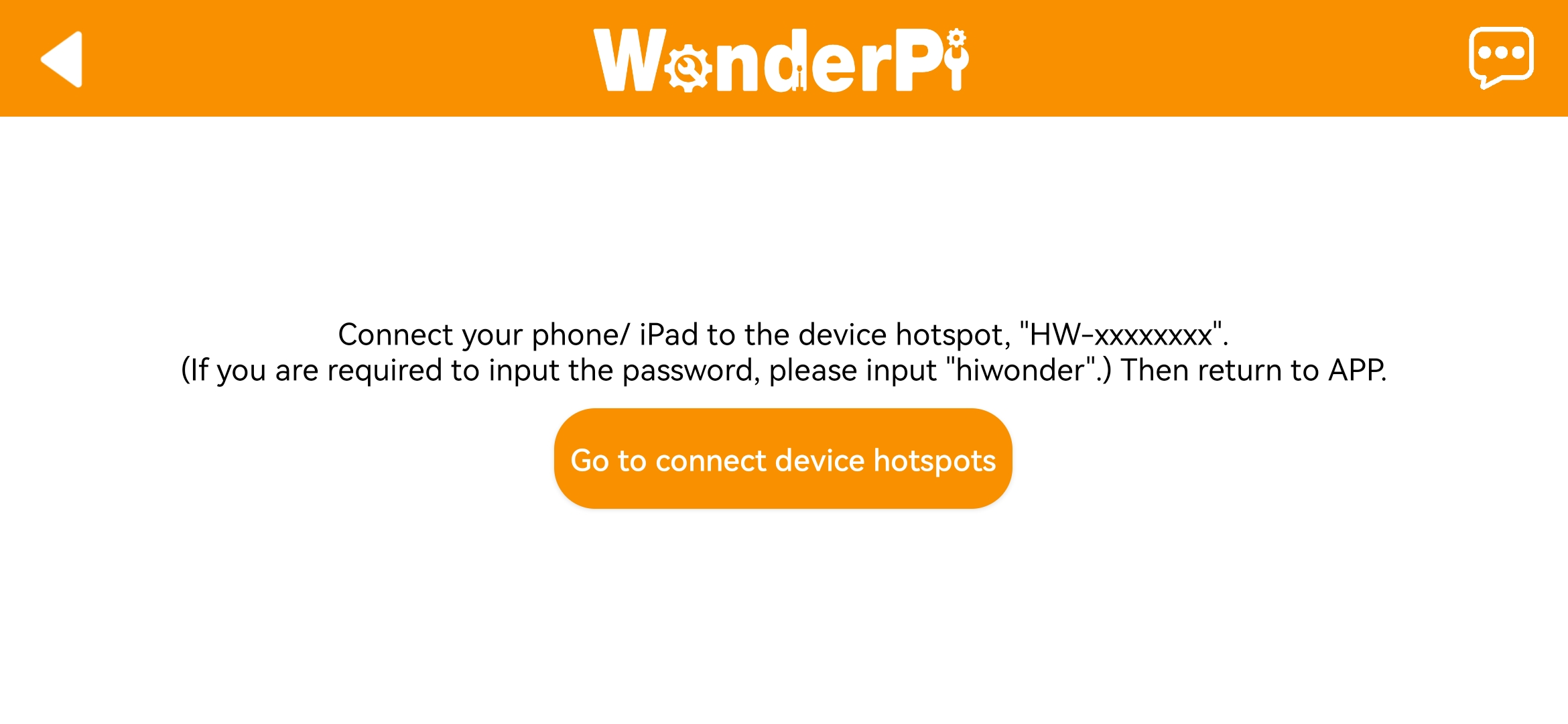

(3) Tap “Go to connect device hotspot”. Join WiFi starting with “HW”. The password is “hiwonder”.
(4) Return back to APP after connection.
For iOS user, please don’t return to APP until WiFi icon appears on status bar, otherwise robot cannot be searched. If robot cannot be searched by APP, tap
to refresh.

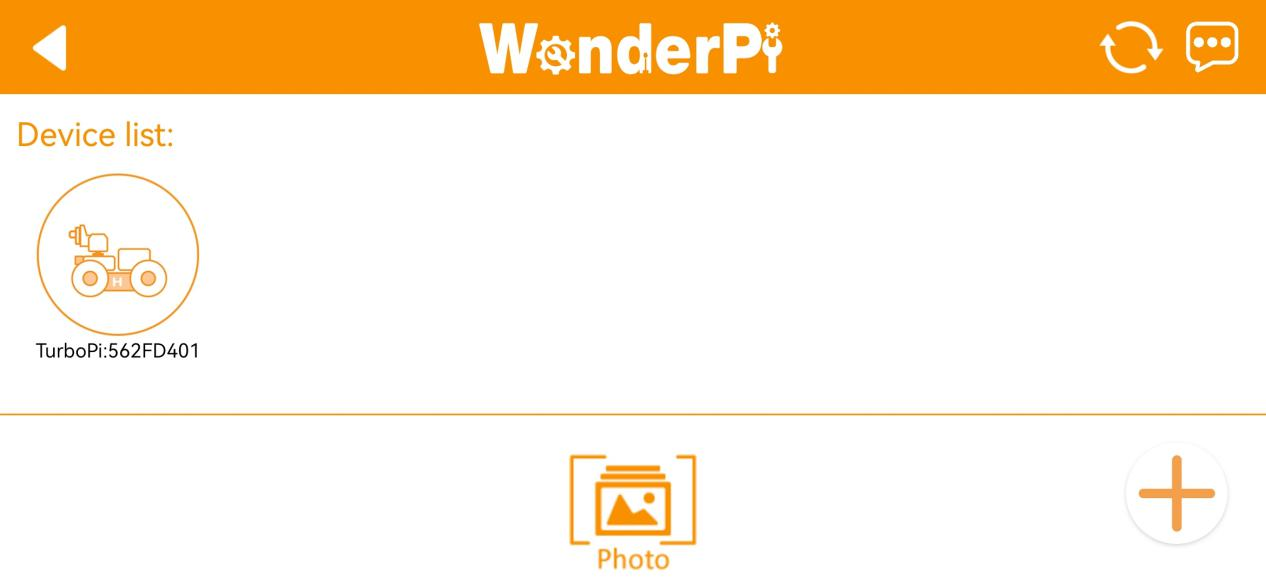

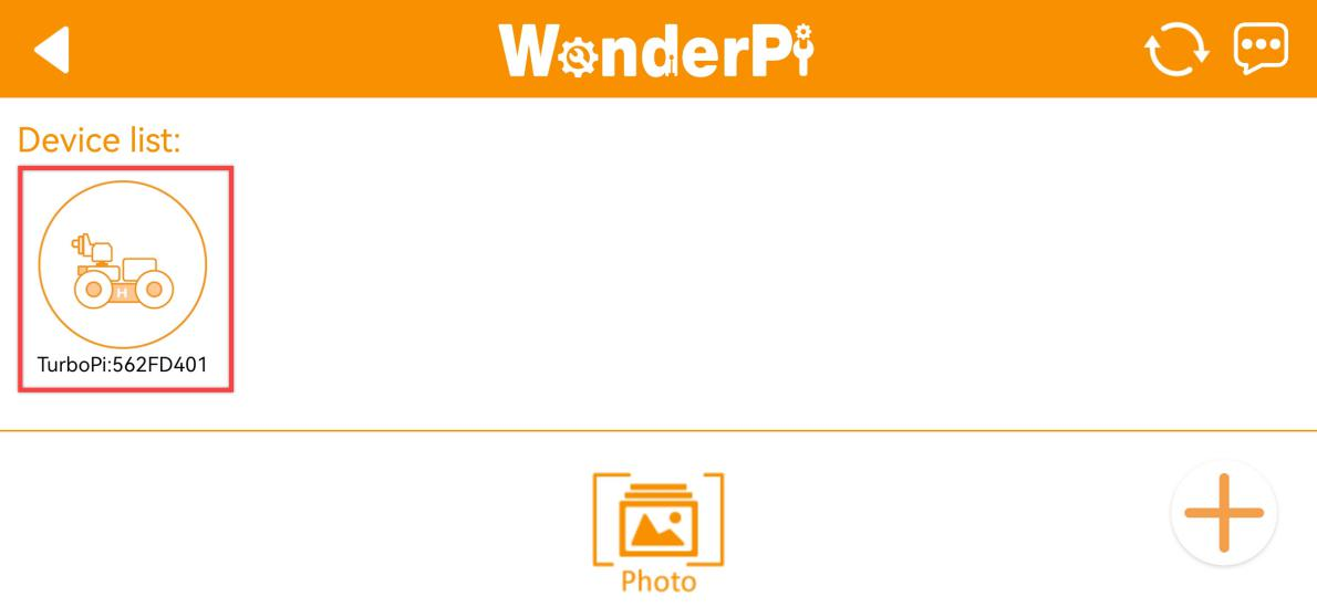

(5) APP automatically connects to robot. When robot icon below occurs, connection completes.
If you are informed of “No Internet. Whether to keep connection”, just select “keep connected”.
(6) Tap robot icon to enter mode selection interface.

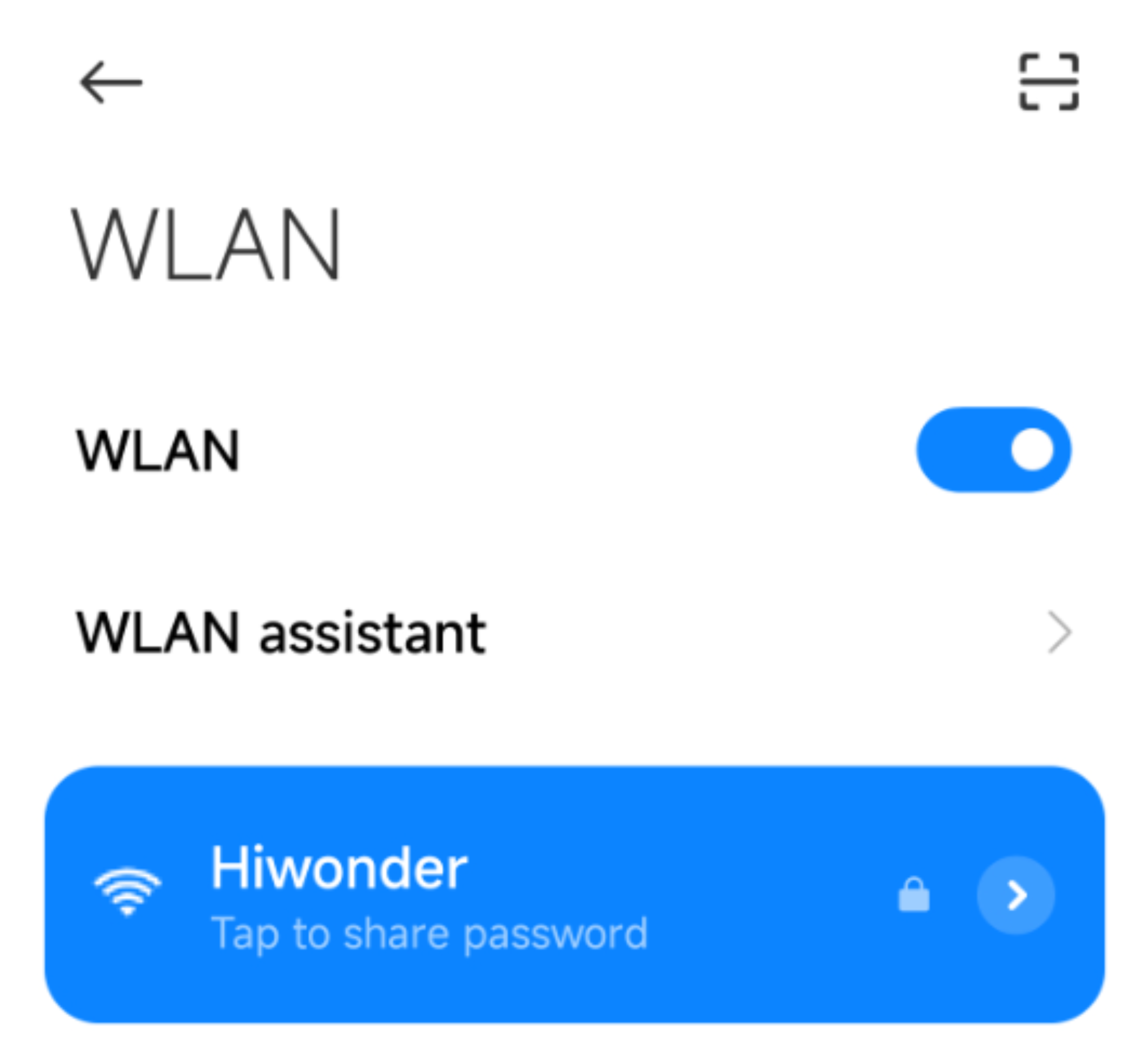

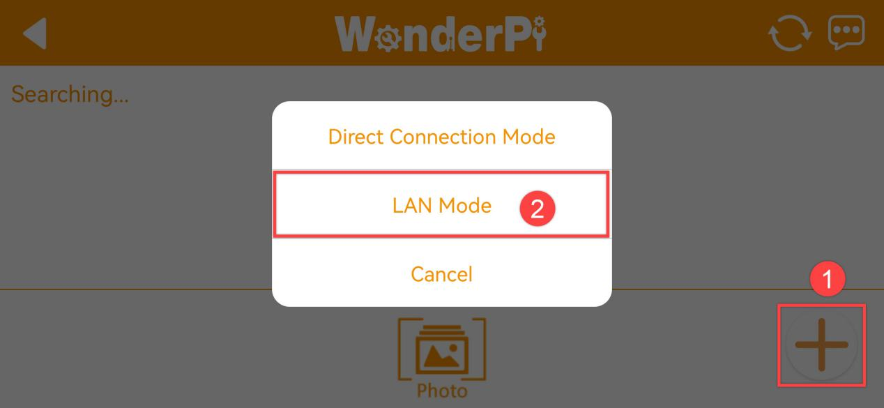

1.2.3 LAN Connection Mode

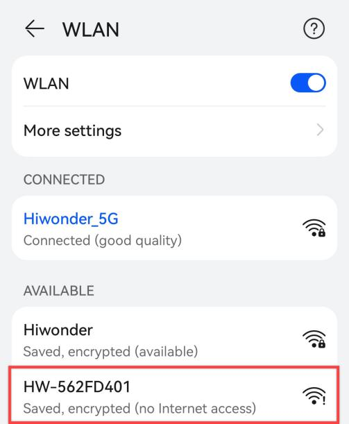

(1) Disconnect the WiFi generated by TurboPi. Connect your phone to a WiFi. Take “Hiwonder” as example.
(2) After connection, open “WonderPi”. Select “Standard ->TurboPi” in sequence.
(3) Tap “+” in bottom right corner, and then select LAN Mode.

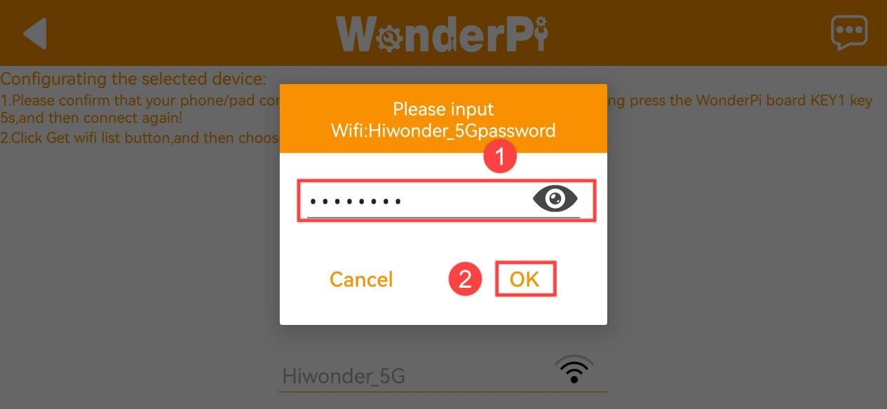

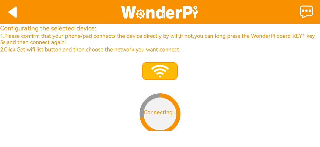

(4) Input the password of the WiFi your phone joins. Ensure the password you input is correct, otherwise APP fails to connect to robot. Tap “OK”.
(5) Tap “Go to connect device hotspot”.
(6) Join the WiFi starting with “HW”. The password is “hiwonder”. After connection, return back to APP.
(7) APP automatically configures network.

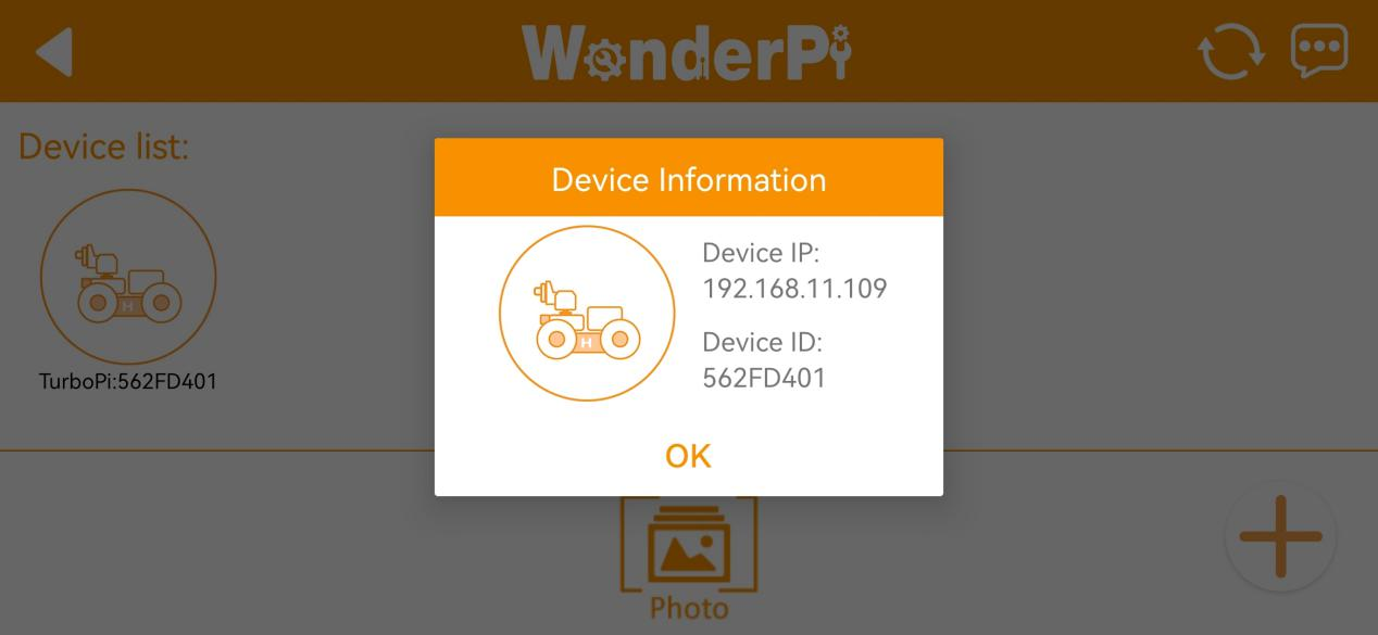

(8) After a while, robot icon below occurs, and LED on expansion board keeps on.
(9) Long press robot icon to check TurboPi’s IP and ID.
(10) Tap robot icon to enter mode selection interface.

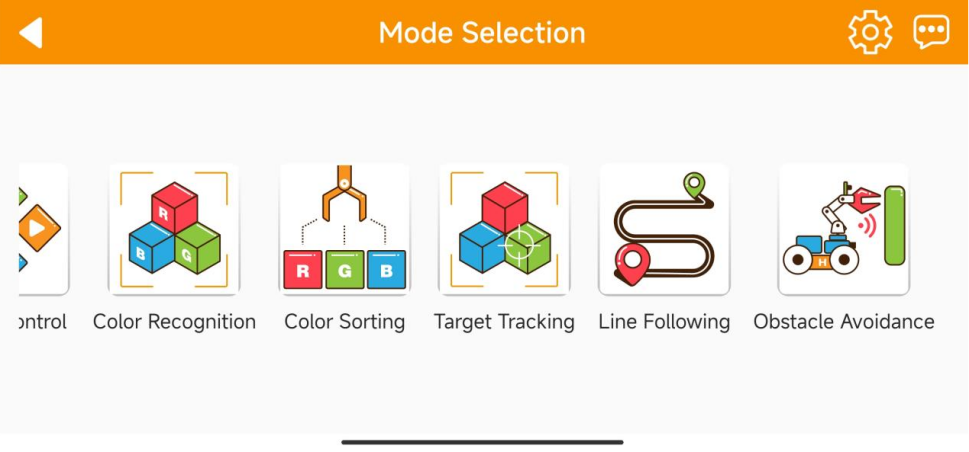

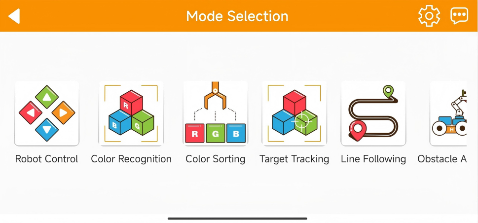

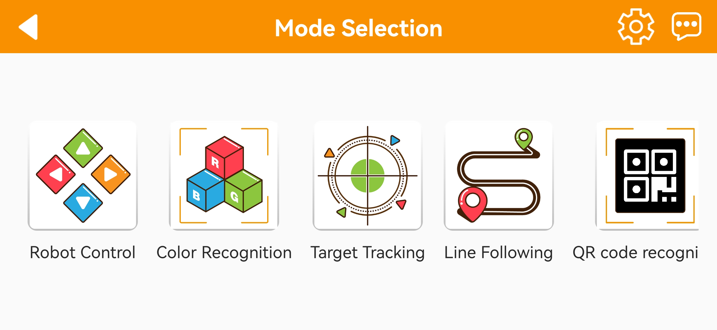

2.2.2 Start Games
After connecting, click MasterPi icon to enter the mode selection interface.
In the mode selection interface, click the icon corresponding to the game to enter the game interface.

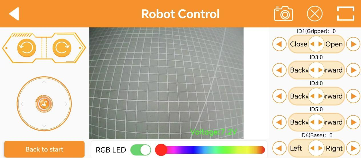

Robot Control
(1) This game allows you to control the movement of the car and the RGB light on the ultrasonic sensor in real time. The interface consists of four parts, and the descriptions and function icons of each part are shown below:
The interface of “Robot Control” can be divided into three parts. The left side of the interface can control the movement of the robotic arm by dragging the slider. Other function icons can refer to the following table:
| Icon | Corresponding Function |
Drag to control MasterPi’s movement. |
Control the rotation direction of MasterPi. |
Control MasterPi back to the initial posture. |
The battery voltage of the MasterPi will be displayed in the lower right corner of the image. Note: when the battery voltage is less than 7V, please charge it as soon as possible. |
The real-time image transmitted by camera indicates voltage value of MasterPi’s battery. Note: when the battery voltage is less than 7V, please charge it as soon as possible.
The right side of the interface can be used to control the angle of 5 servos so as to control the movement of the robotic arm.
If you want to back to the games option interface, you can click the blank area, then the title bar will appear. Next, click
at the left side.

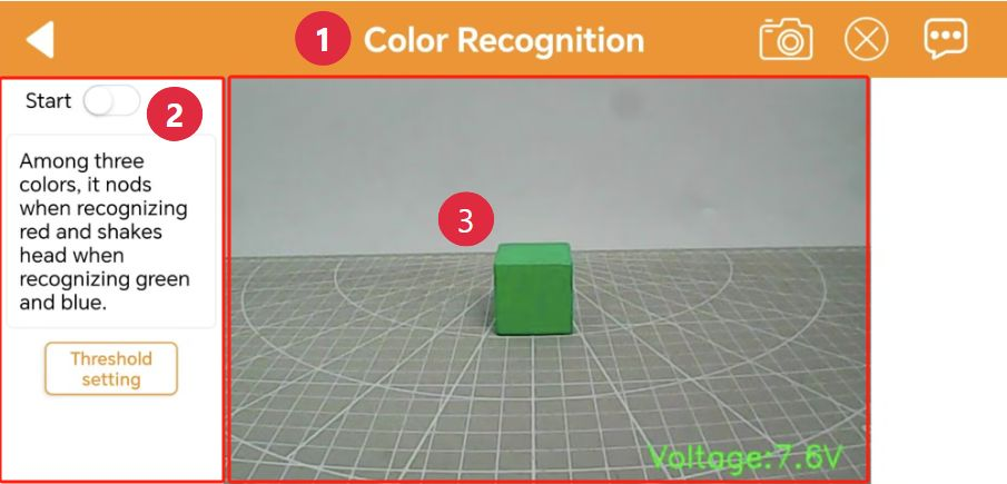

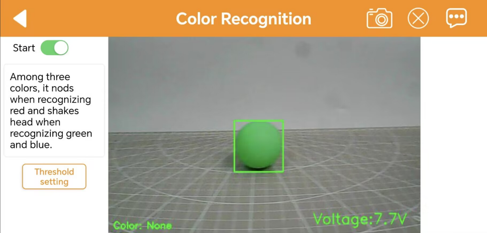

(1) Click “Color Recognition” to enter this game. Its interface consists three parts:
① The status bar is located at the top of the interface.
② The left side of the interface is the area for enabling, disabling the game and adjusting the color threshold.
③ The right side of the interface is the area for displaying the live camera feed.
(2) Clicking the “Start Recognition” allows you to place red, blue, and green objects one by one in front of the camera. Take green as an example. When green is detected, the MasterPi will highlight the recognized green area in the feedback image. The buzzer will emit a “beep” sound, then the camera will perform a “head-shaking” action.
The green will be recognized and highlighted in the live camera feed.
The buzzer will emit a “beep” sound, and the recognized color will be displayed in the lower left corner.

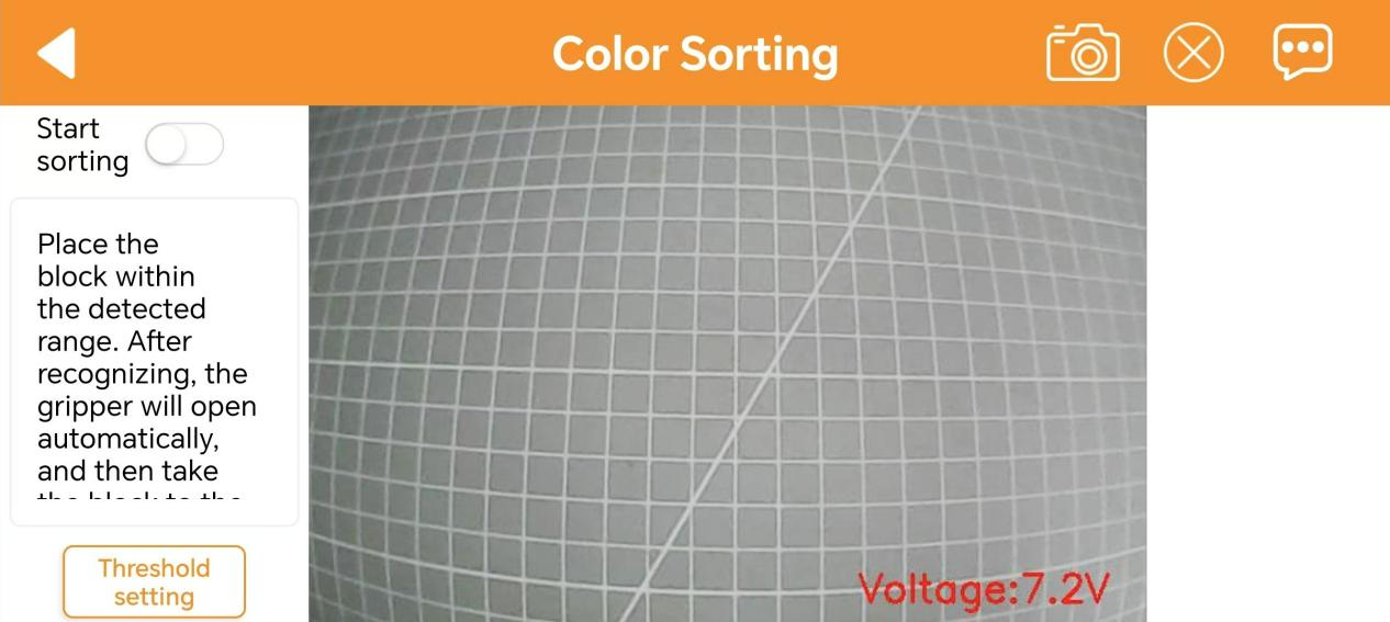

Color Sorting
Click “Color Sorting” to enter the game interface. After starting the game, the car’s camera can recognize different color blocks to perform corresponding actions.
When recognizing QR codes, it is important to maintain an optimal distance between the QR code image and the camera. It is 35cm.
Please start this game under a well-lit environment, but try to keep it from direct light.
① The left side of the interface is the game switch area.
② The right side of the interface is the live camera feed.
(1) Click the “Start Recognition” to select different color blocks, and the MasterPi will perform corresponding actions upon recognizing different color blocks.
| Recognized Color | Outcome |
| Red | The buzzer emits a "beep" sound and places the red block at coordinates (-15, 14, 2). |
| Green | The buzzer emits a "beep" sound and places the green block at coordinates (-18, 9, 3). |
| Blue | The buzzer emits a "beep" sound and places the blue block at coordinates (-18, 0, 2). |
(2) If want to back to mode selection interface, you can arbitrarily click the blank area in interface, then click

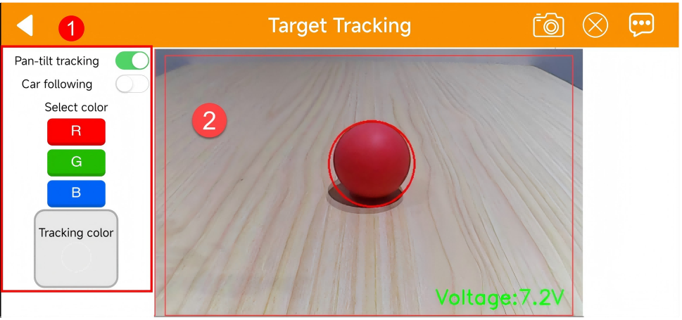

Target Tracking
Click “Target Tracking” to enter the game interface. Once activated, this game enables the car to move along with the target color as it moves.
When recognizing, please do not have the same or similar colored object within the detected range to avoid interference.
If the recognition effect is not good enough, please refer to 2.3 Adjust Color Threshold.
(1) Please select both “Pan-tilt Tracking” and “Car Following” simultaneously for car tracking.
② The tracking switch area is located on the left side of the interface
③ The camera live feed area is located on the right side of the interface.

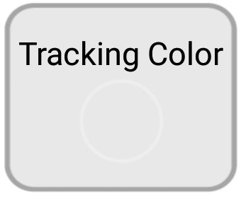

(2) Click the “Pan-tilt Tracking”, and select the target color to activate the tracking game. MasterPi’s camera will move with the selected color target, while the car body remains stationary. Then, click the “Car Body Following” to activate the car body following game. MasterPi’s car body and pan-tilt will follow the movement of the selected color target.
| Button Icon | Function Instruction |
Start or close pan-tilt tracking. |
Select the targeted color. |
Display the information of targeted color. |
(3) If want to back to mode selection interface, you can arbitrarily click the blank area in interface, then click

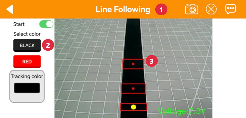

② The line tracking switch area is located on the left side of the interface
(1) Click “Start following” to enter this game and select color. Then MasterPi will follow the targeted line.
| Icon Button | Function Instruction |
Start or stop this game |
Select the targeted color |
Display the selected tracking color. |

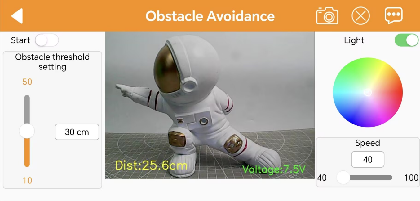

Obstacle Avoidance
Click “Obstacle Avoidance” to enter the game interface. After this game is activated, the car can use ultrasonic to detect obstacles ahead to avoid them.
Do not detect object at close range for a long time
① The left side of the interface includes the obstacle avoidance game switch and the obstacle threshold setting area.
② The middle of the interface is the camera transmission image area.
③ The right side of the interface includes the setting area for the RGB light and motor speed.
(1) Click “Start avoidance”. MasterPi will move forwards and it will turn left when detecting obstacle ahead. Then continue moving forward until there is no obstacle.
Start this game. |
Set obstacle threshold. |
Turn on or off RGB light. |
Adjust RGB light color. |
Adjust motor speed. |

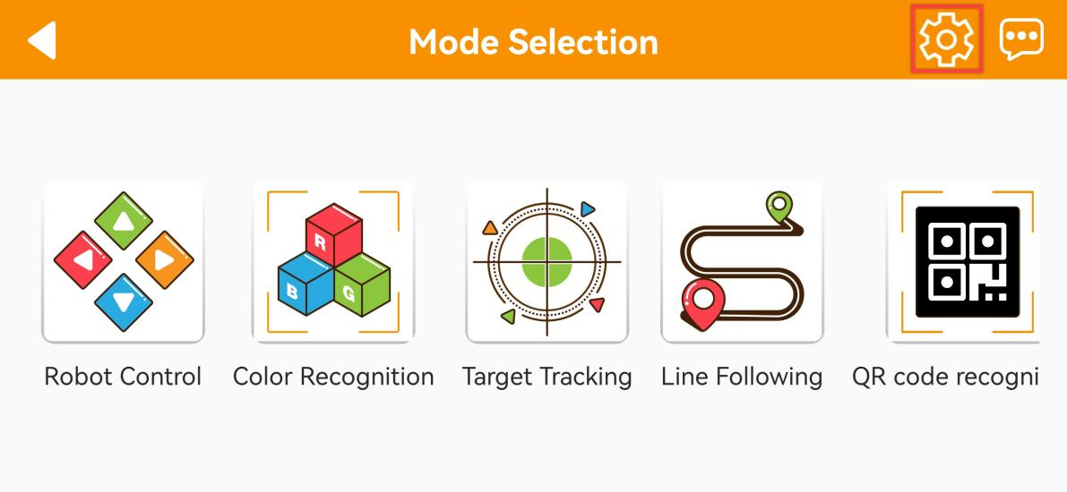

Different light source will have different influence on the colors, which will result in recognition discrepancy. To tackle this problem, you can adjust color threshold via “WonderPi” APP.
2.3.1 Preparation
Start TurboPi. Open “WonderPi” APP, and connect it to TurboPi. For how to connect robot to APP, operate referring to”2.1 APP Installation and Connection “.
2.3.2 Interface Layout
Tap in upper right corner to enter color threshold adjustment interface.

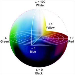

Adjust L component of camera returned image. "L_min" is lower limit and "L_max" is upper limit. |
Adjust A component of camera returned image. "a_min" is lower limit and "a_max" is upper limit. |
Adjust B component of camera returned image. "b_min" is lower limit and "b_max" is upper limit. |

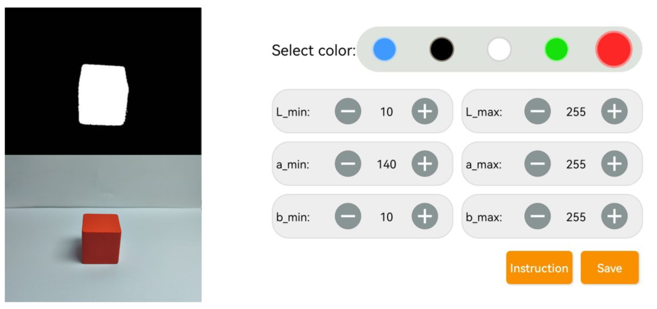

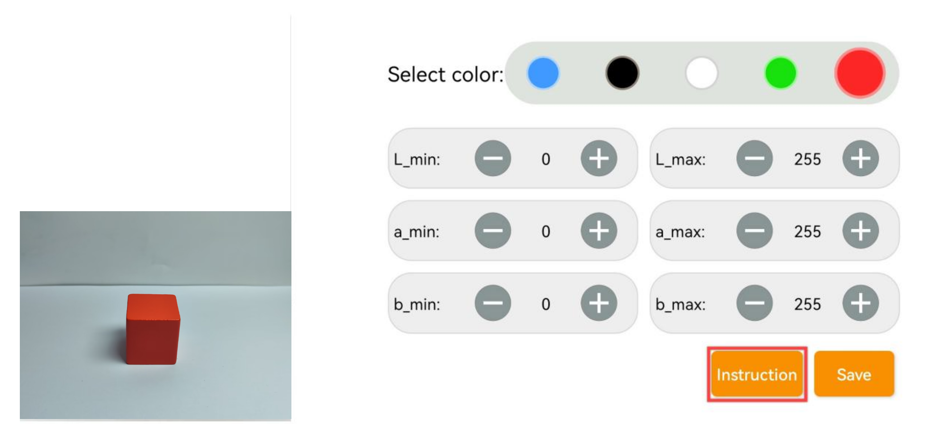

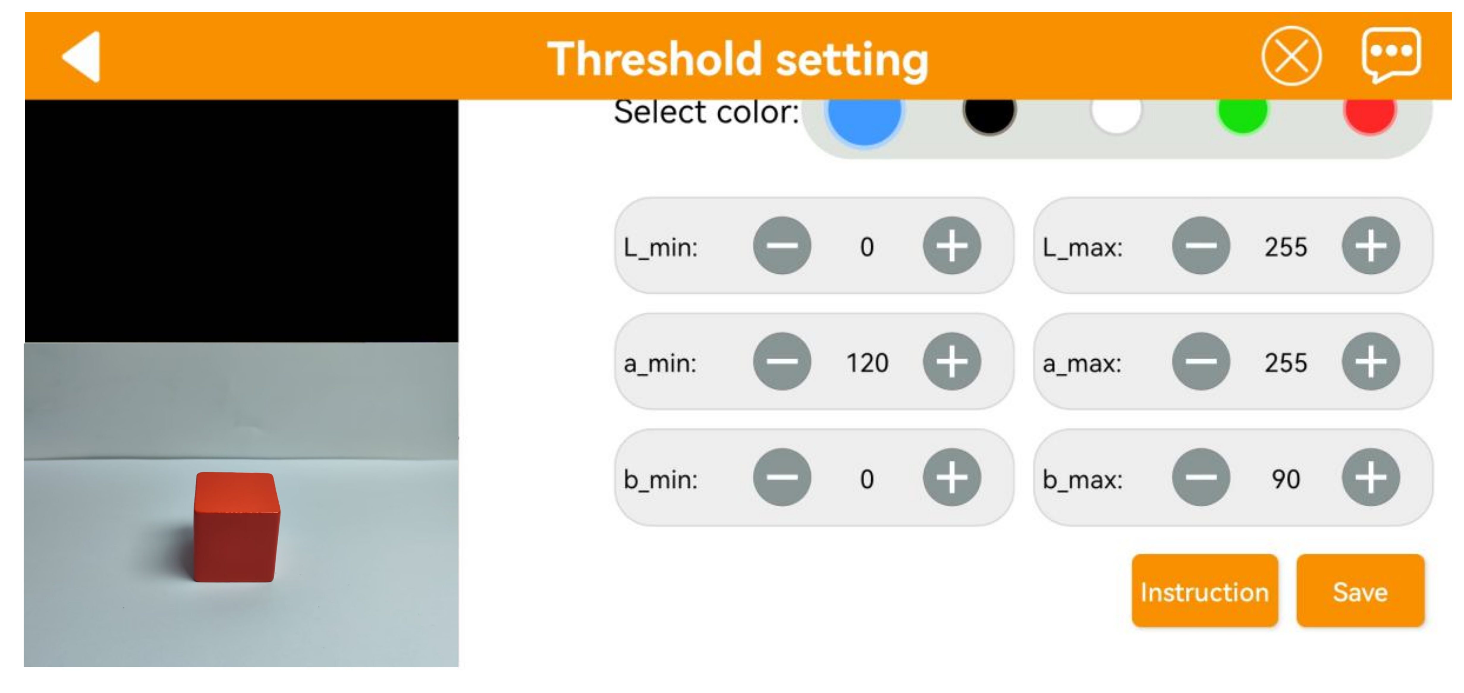

2.3.3 Adjust Color Threshold

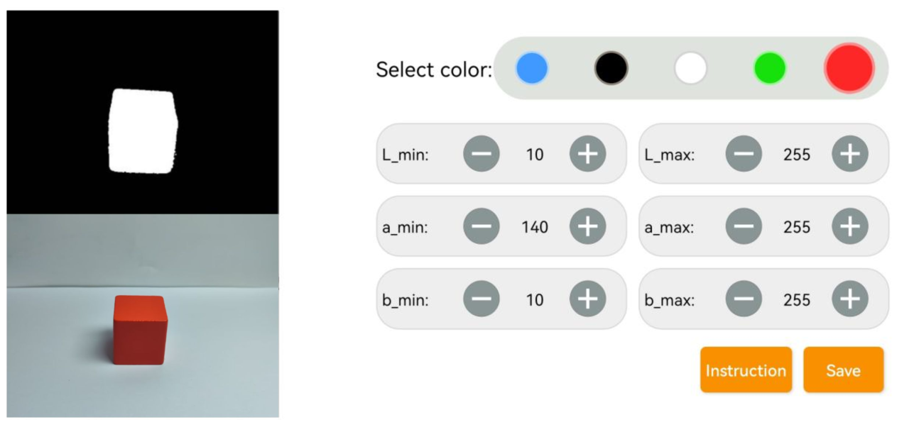

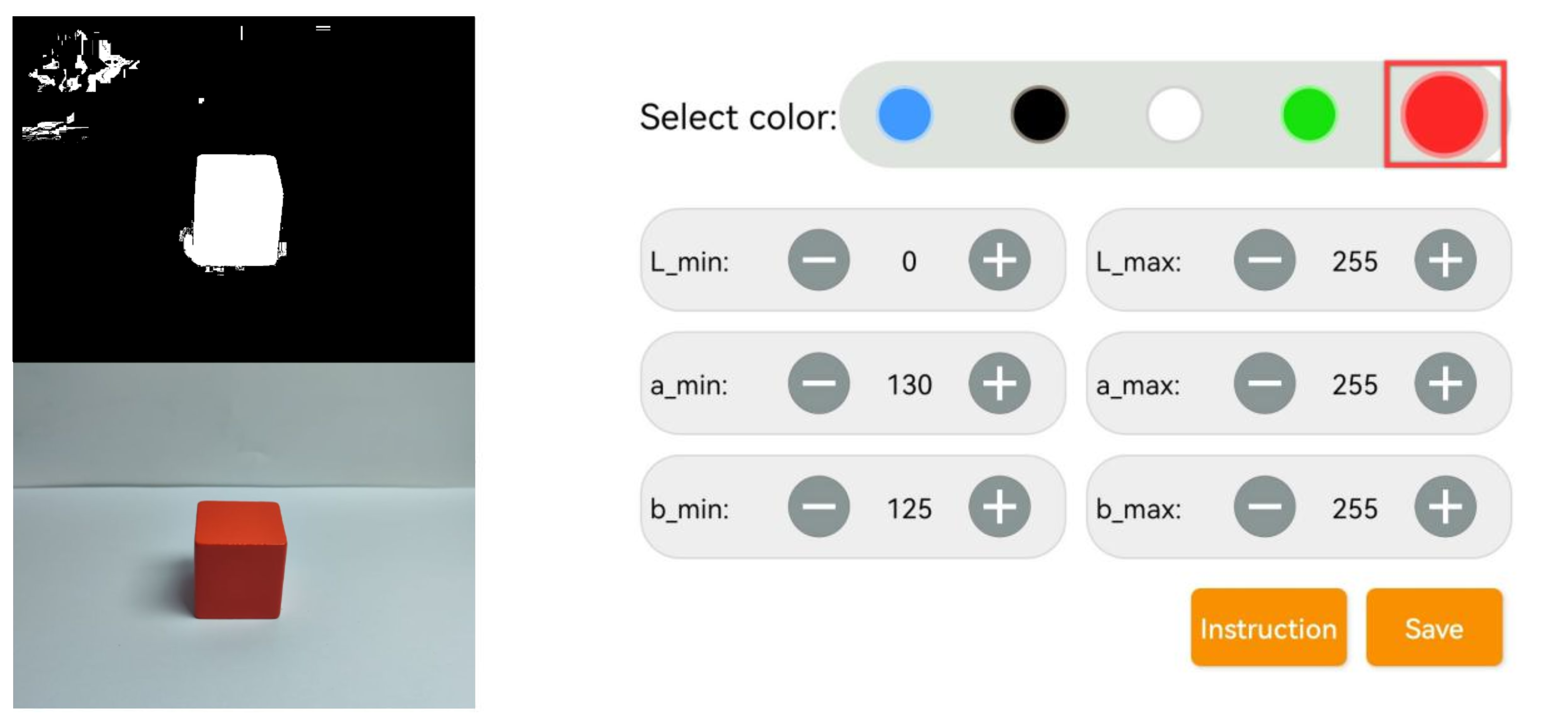

(1) Select color to be adjusted. Take red as example.

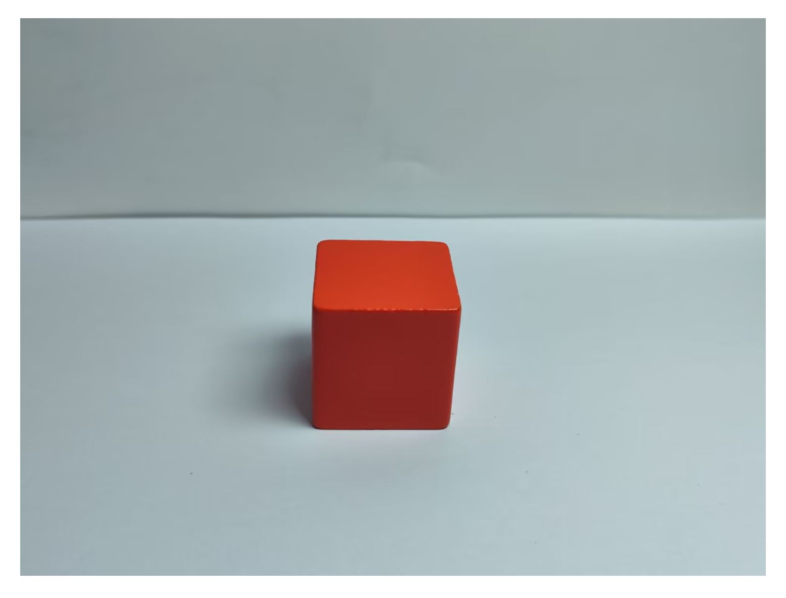

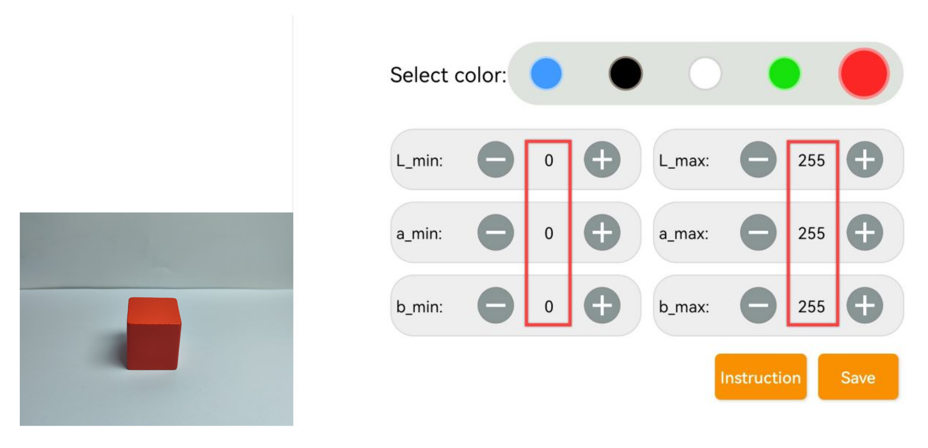

(2) Put red object within camera recognition zone. Set L_min, a_min and b_min to 0, and L_max, a_max and b_max to 255.

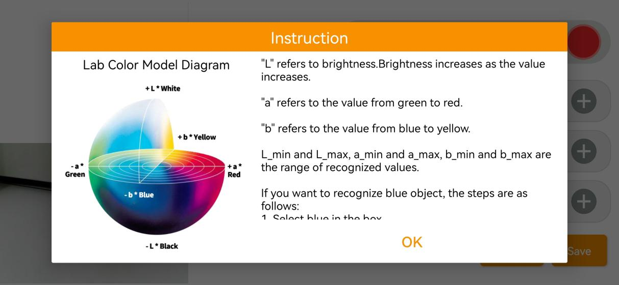

(3) Tap “Instruction” icon to check how to adjust color threshold.
if you need to close Instruction window, select “OK”.

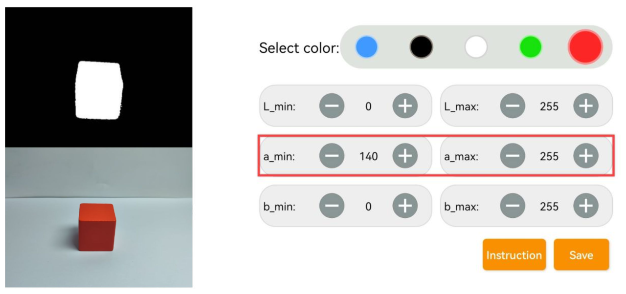

(4) Red approaches “+a” zone, so you need to adjust A component.
(5) Keep “a_max” value the same, and then increase “a_min” value till red object turns white and other area is black.
(6) Adjust “L” and “B” values. If it belongs to light red, increase L_min. Otherwise, decrease L_max. If it belongs to warm tone, increase B_min. Otherwise, decrease B_max.
(7) Remember to save the value after adjustment.
