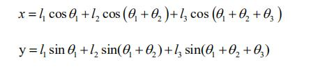

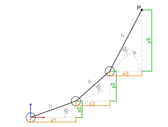

We simplify the model of the robotic arm, remove the pan-tilt at the base, and the actuator part to get the main body of the robotic arm. From the figure above, you can see the coordinates (x, y) of the end point P of the robotic arm, which ultimately consists of three parts (x1+x2+x3, y1+y2+y3). Among them θ1, θ2, and θ3 in the above figure are the angles of the servo that we need to solve, and α is the angle between the paw and the horizontal plane. From the figure, it is obvious that the top angle of the claw α=θ1+θ2+θ3, based on which we can formulate the following formula:
Among them, x and y are given by the user, and l1, l2, and l3 are the inherent properties of the mechanical structure of the robotic arm. In order to facilitate the calculation, we will deal with the known part and consider the whole:
Substituting m and n into the existing equation, and then simplifying can get:
Through calculation:
We see that the above formula is the root-finding formula of a quadratic equation in one variable:
Based on this, we can find the angle of θ1, and similarly we can also find θ2. From this we can obtain the angles of the three steering gears, and then control the steering gears according to the angles to realize the control of the coordinate position.

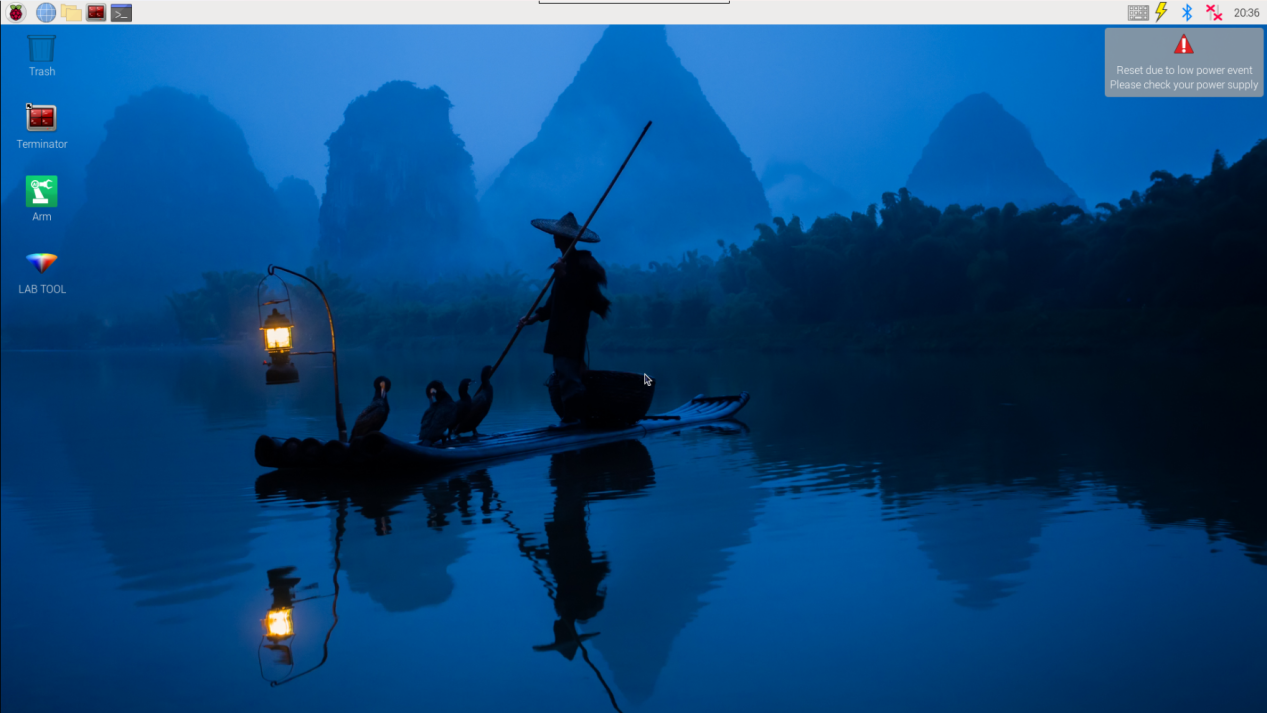

(2) Click in the top left corner of the desktop, or press the shortcut key “Ctrl+Alt+T” to open the LX terminal.
(3) Enter the command . Press “Enter” to switch to the directory where the program is.
cd /MasterPi/board_demo
(4) Enter the command, and press “Enter” to activate the game.
python3 control_by_servo.py
(5) If want to exit the program, press “Ctrl+C”.

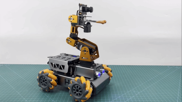

4.4.3 Program Outcome
After the program starts, the robotic arm will move left and right, forward and backward, then up and down.
