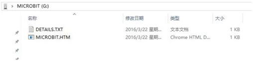

Indicator light status after download (left) and successful program download confirmation (right)
No hex file visible in the drive after download is complete

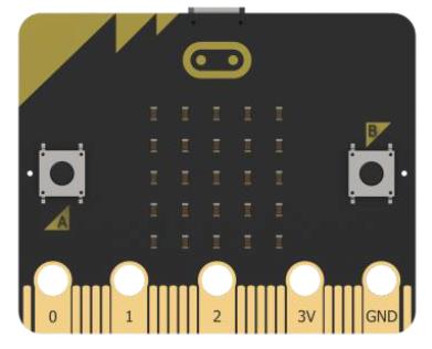

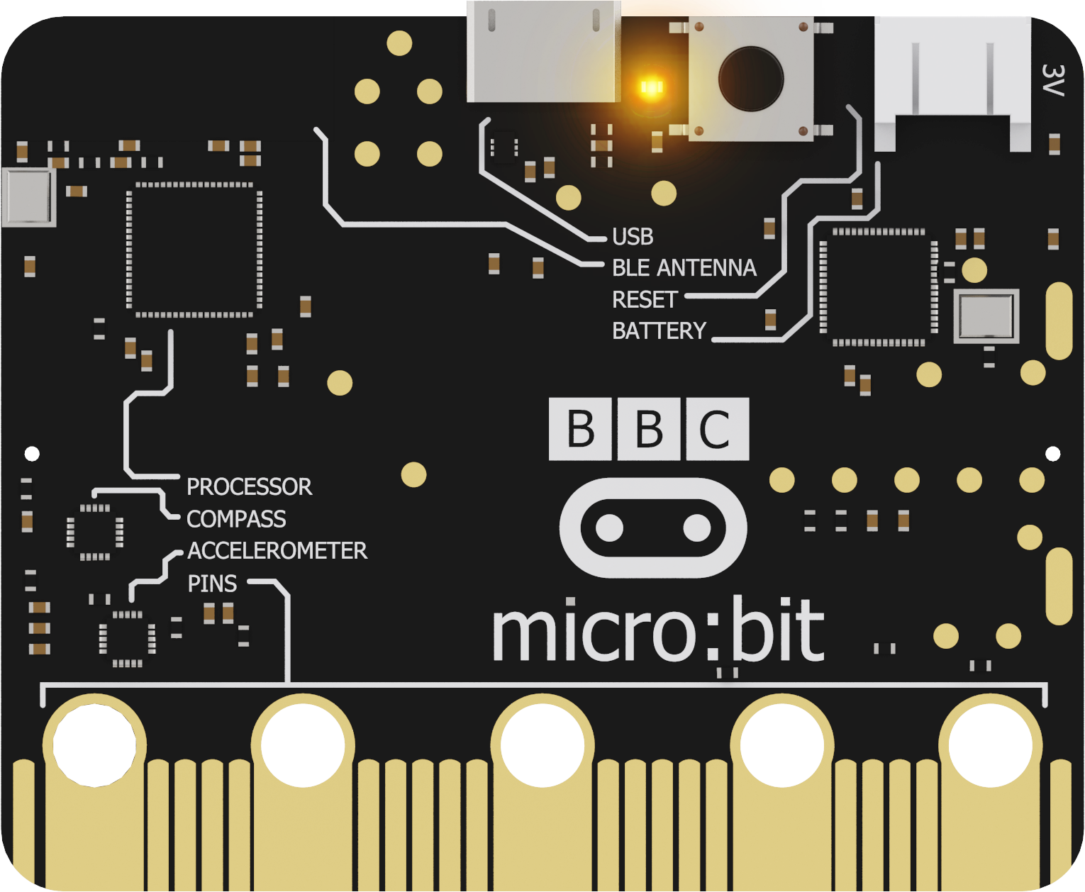

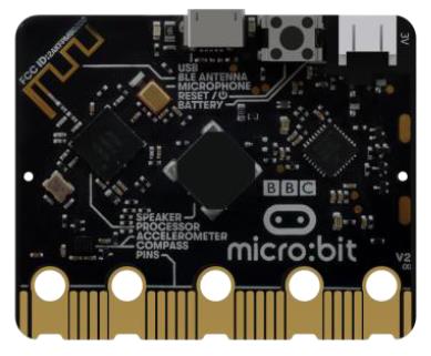

Based on the original function of micro:bit V1.5, the new generation of micro:bit V2.0 has been optimized and improved in computing power and performance, as well as add several onboard modules for expansion.
All functions of micro:bit V1.5 can be implemented in micro:bit V2. Therefore, the tutorial for micro:bit V1.5 is applicable to micro:bit V2.0.
Regarding the new features of micro:bit V2.0, please see the related lessons.
The following table shows the comparison between two boards and the red parts highlights the new function of micro:bit V2.0.

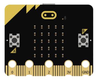

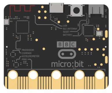

| No. | Feature | micro:bit V1.5 | micro:bit V2 |
| 1 | Appearance |
Front
Back
Front
Back
| 2 | Processor | Nordic nRF51822 | Nordic nRF52833 |
| 3 | ARM | Cortex-M0 32bit 16MHz | Cortex-M4 32bit+FPU 64MHz |
| 4 | Memory/Flash | 16KB RAM/256KB Flash | 128KB RAM/512KB Flash |
| 5 | Touch Logo | None | Onboard touch sensor |
| 6 | Microphone | None | Onboard microphone with LED indicator |
| 7 | Speaker | None | Onboard electromagnetic speaker |
| 8 | Edge Connector | Flat type | Gear type |
| 9 | Reset Button | Reset function | Reset function, long press for power saving mode |
| 10 | Power Indicator | None | Red LED when powered |
| 11 | Bluetooth | Bluetooth 4.0 | Bluetooth 5.0 |
| 12 | Operating Current | 90mA | 300mA |

(3) After downloading, hex file is not visible in disk drive and the disk drive will automatically flash out. Also, you can see that the indicator next to USB port emits yellow light. The indicator will blink rapidly and continuously while your program is transferred and will stop flashing and keep on after transfer is complete.
After transfer is complete, hex file will disappear in micro:bit disk. After power on micro:bit, your program starts running on your micro:bit automatically.

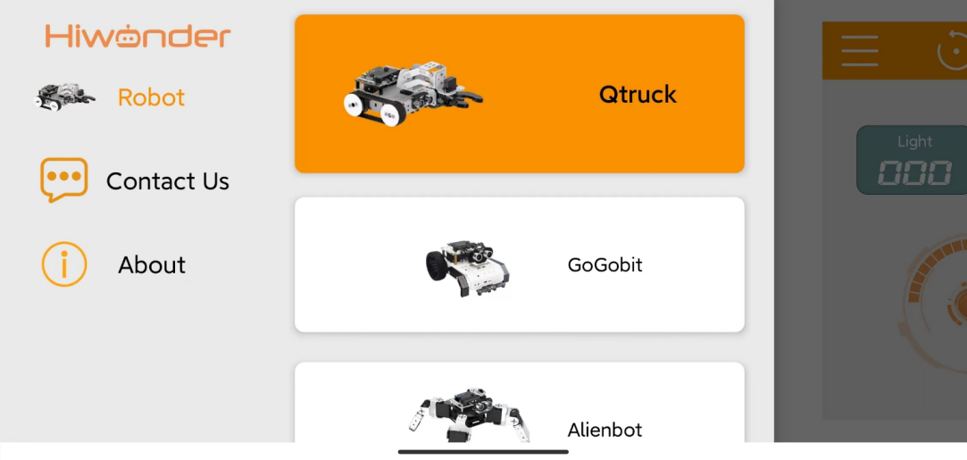

Connect to APP
Before using app, please enable Bluetooth and GPS service in phone settings.

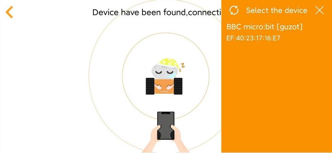

Click Bluetooth button on app to pair with robot. Do not connect robot by Bluetooth in your phone settings.
(1) Enable Bluetooth and GPS service.
(2) Open Wonderbit. Click on
to select “Qtruck”.
(3) Click on
and select “BBC micro:bit” in pop-up device search list to connect.
(4) At the same time, keep your phone close to Qtruck. After connection is complete, Bluetooth icon on app will stop flashing and light up.

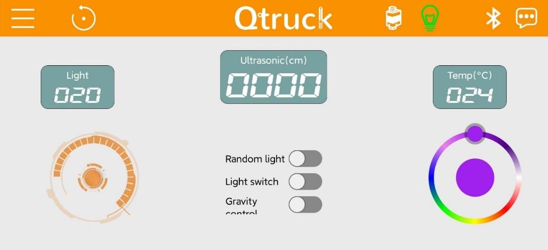

App Control

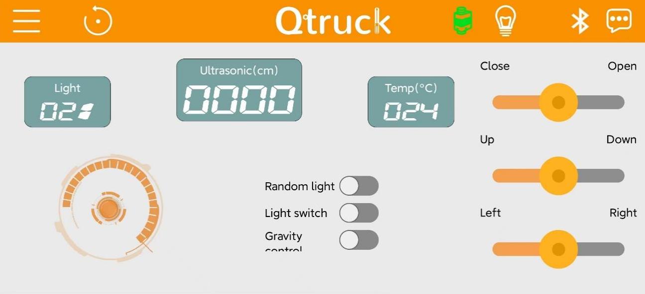

There are two functions on home interface of app including color light and servo control functions.
First of all, please learn about the color light function.
| Icon | Function |
Control Qtruck to go forward or backward and turn left or right. |
Display light intensity of environment where Qtruck is located. |
Display the distance between Qtruck and object ahead. |
Display temperature of environment where Qtruck is located. |
Turn on this button, two color light on Qtruck emit random light (the light color is contained in surroundings). |
Turn on or off the color light. |
Turn on Gravity control, you can tilt your phone to control Qtruck to move. |
Control Qtruck's light color. |
Click this button to open servo control interface. |
