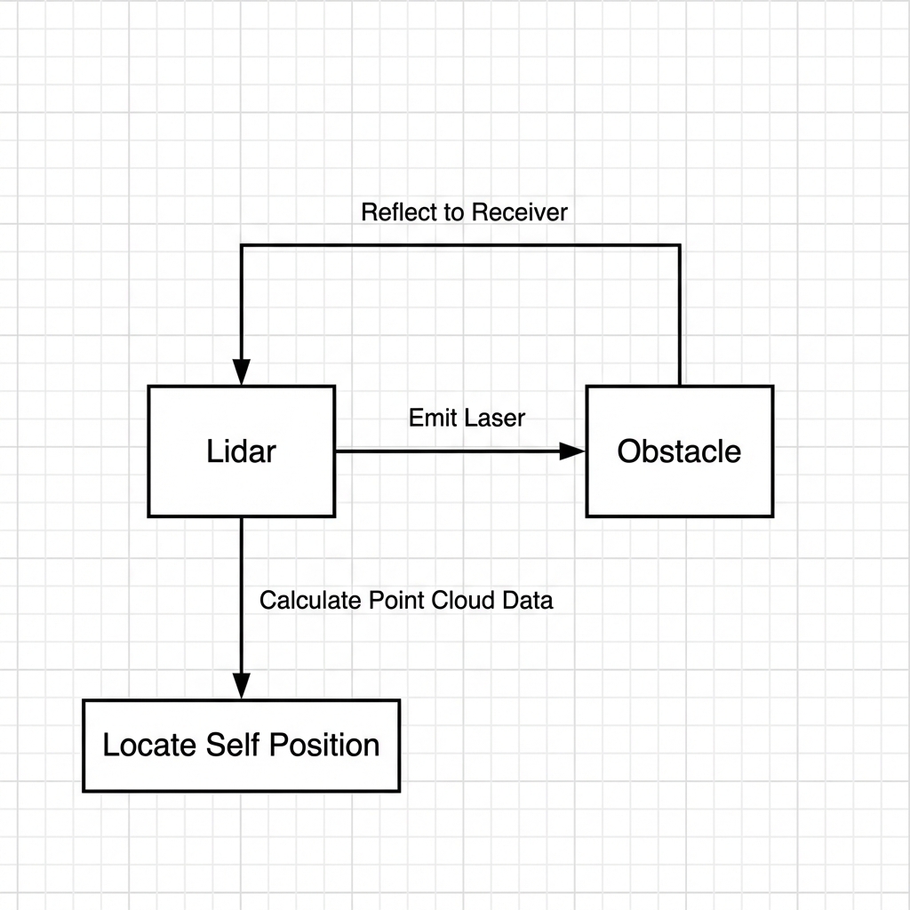

Preprocessing: Optimizing the raw point cloud data from the LiDAR, removing problematic data, or applying filtering.
Using a laser as the signal source, pulsed lasers emitted by the laser device hit surrounding obstacles, causing scattering.
A portion of the light waves will reflect back to the LiDAR receiver, and based on the principles of laser distance measurement, the distance from the LiDAR to the target point can be calculated.
Regarding point clouds: Generally speaking, the environmental information acquired by LiDAR is called a point cloud. It reflects a portion of what the robot’s “eyes” can see in its environment. The collected object information is presented as a series of scattered data points with accurate angles and distances.

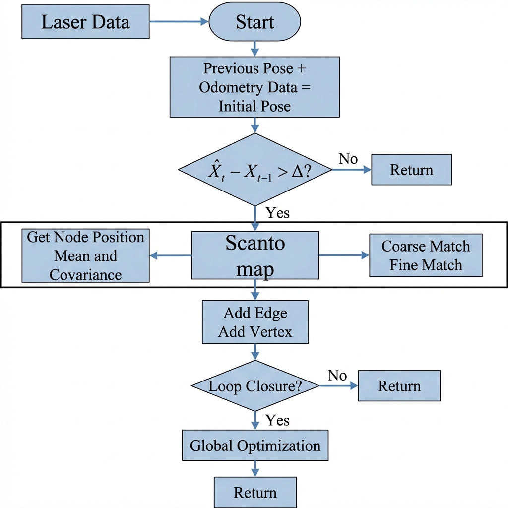

KARTO
Karto_SLAM is based on the concept of graph optimization, using highly optimized and non-iterative Cholesky decomposition for sparse system decoupling as the solution. Graph optimization methods use the mean of the graph to represent the map. Each node represents a position point of the robot’s trajectory and the sensor measurement data set. With the addition of each new node, calculations and updates are performed.
In the ROS version of Karto_SLAM, the Sparse Pose Adjustment (SPA) adopted is related to scan matching and loop closure detection. The more landmarks there are, the greater the memory requirement. However, compared to other methods, the graph optimization approach has a greater advantage in mapping large environments because it only contains a graph of points, which represent the robot’s pose, solving for the pose before solving for the map.
The algorithmic program framework of Karto SLAM is shown in the figure below:
As can be seen from the above figure, the process is quite straightforward. In the traditional soft real-time operating mechanism of SLAM, processing is performed every time a frame of data enters, and then it returns.

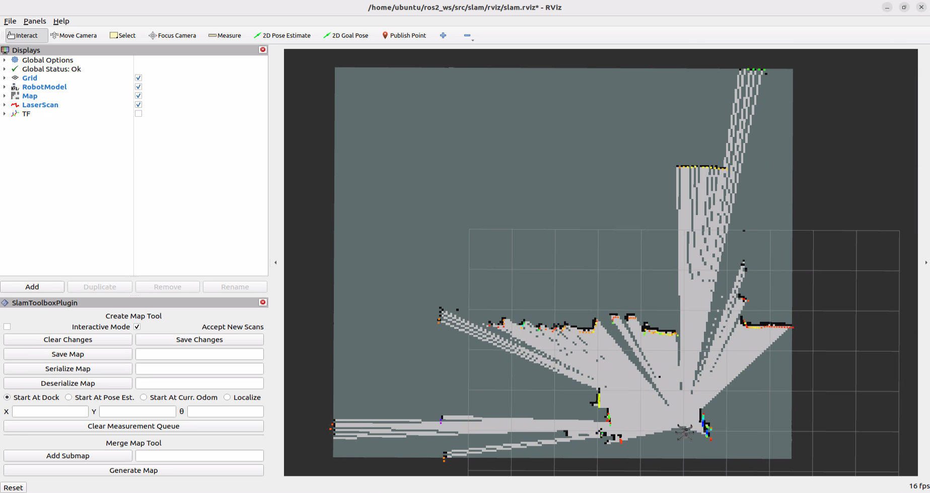

Enter the command to start mapping.
Open a new command line terminal and enter the command to launch the rviz tool to display the mapping effect:

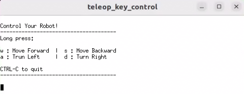

A wireless controller or keyboard can be used to control the movement of the robot. If keyboard control is selected, a new command line terminal must be opened, the command to start the keyboard control node entered, and the Enter key pressed:
If the prompt shown in the figure below appears, the keyboard control service has started successfully.
Control the robot to move around the current space to construct a more complete map. The table below lists the keyboard keys available for manipulating the robot’s movement and their corresponding functions:
| Keyboard Key | Robot Action |
| W | Short press, switch to forward state |
| S | Short press, switch to backward state |
| A | Short press, turn left |
| D | Short press, turn right |

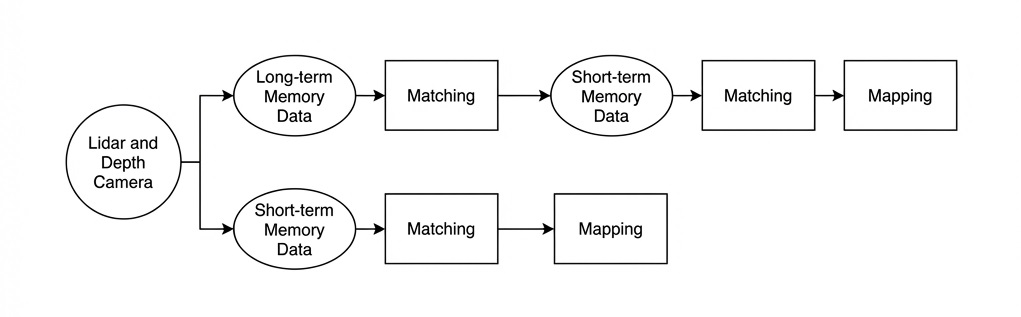

RTAB-VSLAM 3D mapping utilizes feature-based mapping. The advantage is that general scenes can provide abundant feature points, offering good scene adaptability and allowing the use of feature points for relocalization. There are several disadvantages to this approach. First, feature point calculation algorithms are time-consuming. Second, the information utilized by feature points is too sparse, losing most of the information in the image. Third, the feature point method becomes ineffective for textureless areas. Finally, feature point matching is prone to mismatches, which significantly impacts the results.
Once the features in the images are obtained, features from different times need to be matched to form a loop closure detection. After matching is completed, the data is divided into two categories: Long-Term Memory (LTM) data and Short-Term Memory (STM) data. The LTM data is used for matching future data, while the STM data is used for matching continuously timed data.
When the RTAB-VSLAM algorithm runs, it first uses STM data to update the localization points and map. When data at a future moment successfully matches the LTM data, the corresponding LTM data is added to the STM data to update the localization points and map.

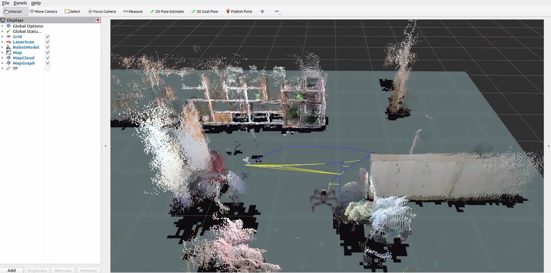

Enter the command to start mapping:

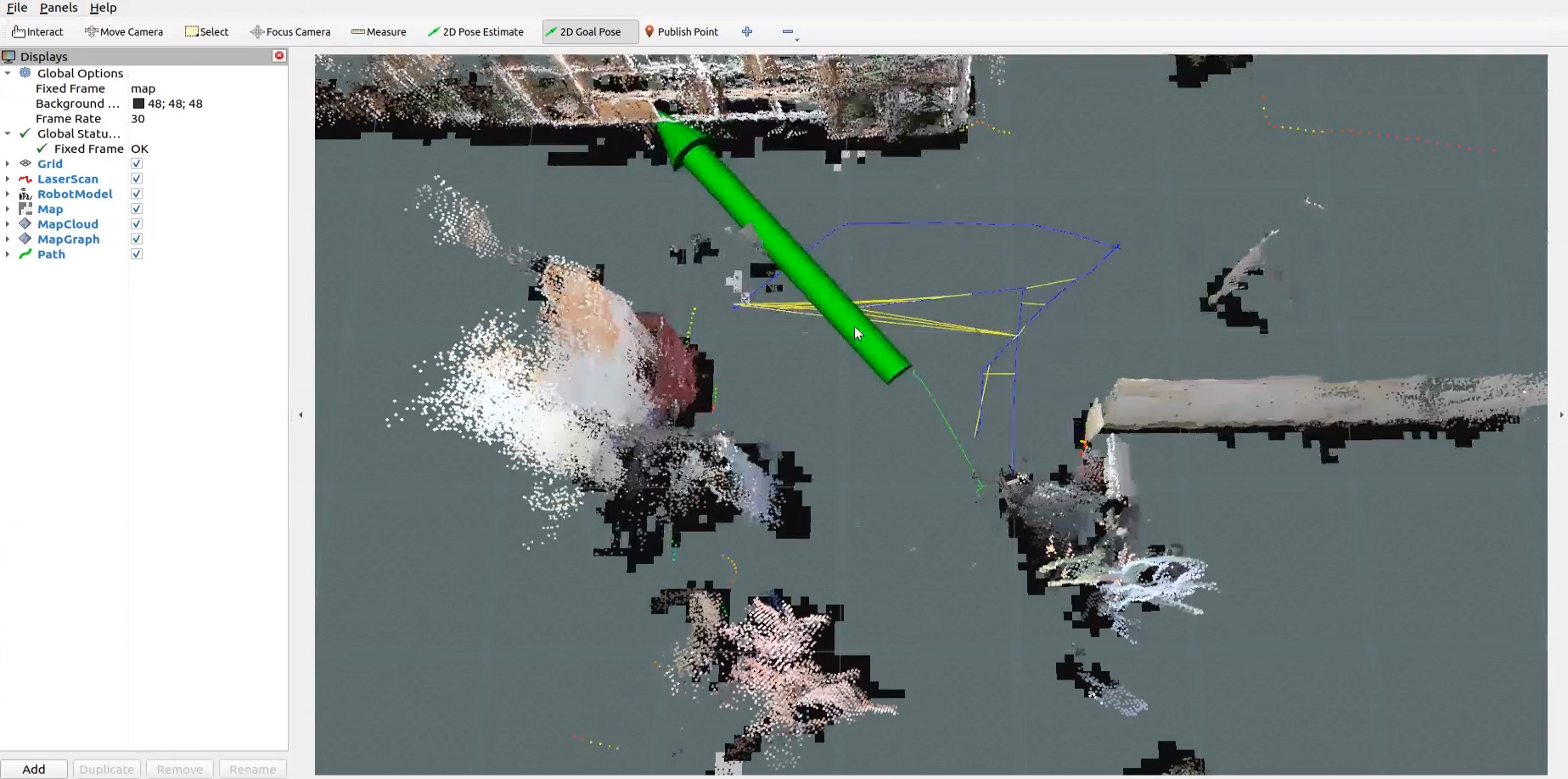

A wireless controller or keyboard can be used to control the movement of the robot. If keyboard control is selected, a new command-line terminal must be opened. Then enter the command to start the keyboard control node and press Enter:

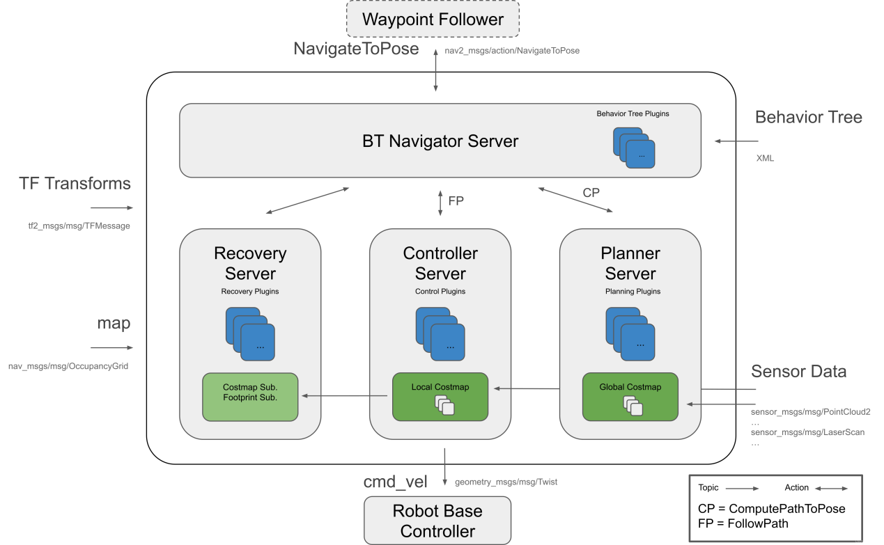

The Nav2 project inherits and expands on the spirit of the ROS navigation stack. The project strives to safely move a mobile robot from point A to point B. Nav2 can also be applied to other applications involving robot navigation, such as dynamic point tracking. During this process, dynamic path planning, calculating motor speeds, avoiding obstacles, and executing recovery behaviors are required.
Nav2 uses behavior trees to call modular servers to complete an action. An action can be calculating a path, controlling force, recovering, or any other operation related to navigation. These are all independent nodes that communicate with the behavior tree (BT) via ROS Action servers. The Nav2 architecture can be preliminarily understood by viewing the following diagram:
To further explain the architecture diagram above, it can be simply divided into one large component and three smaller components.
The Large Component:
BT Navigator Server: The navigation behavior tree server. This major server organizes and invokes the three smaller services below.
The Three Smaller Components:
Planner Server: The planning server, whose task is to compute paths that fulfill certain objective functions. Depending on the chosen nomenclature and algorithm, this path can also be called a route. In simple terms, it involves finding a path on the map.
Controller Server: The control server, also known in ROS1 as the local planner. It represents the method by which the globally calculated path is followed or a local task is completed. In simple terms, it involves controlling the robot’s movement based on the found path.
Recovery Server: The recovery server acts as the backbone of a fault-tolerant system. The goal of the recovery tool is to handle unknown or faulty states of the system and manage them autonomously. In simple terms, it formulates strategies to restore normalcy when the robot encounters an unexpected situation, such as how to climb out of a pit it accidentally fell into while moving.
Through continuously switching between path planning, controlling the robot along the path, and autonomous recovery when encountering problems, the robot’s autonomous navigation is achieved. During robot navigation, relying solely on a raw map built by SLAM is insufficient. During movement, the robot might encounter new obstacles, or it may find that obstacles in certain areas of the raw map have disappeared. Therefore, the map maintained during the robot navigation process is dynamic. Depending on the update frequency and usage, it can be categorized into the following two types:

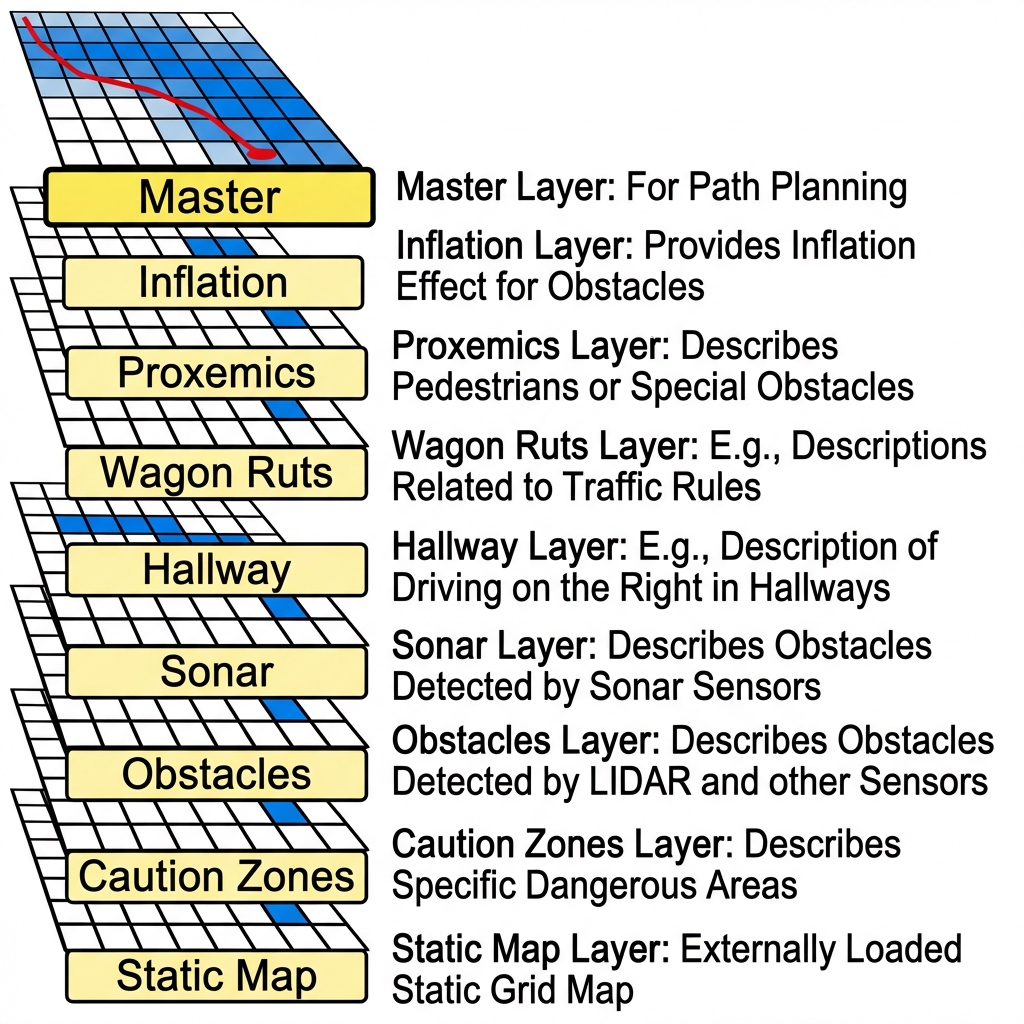

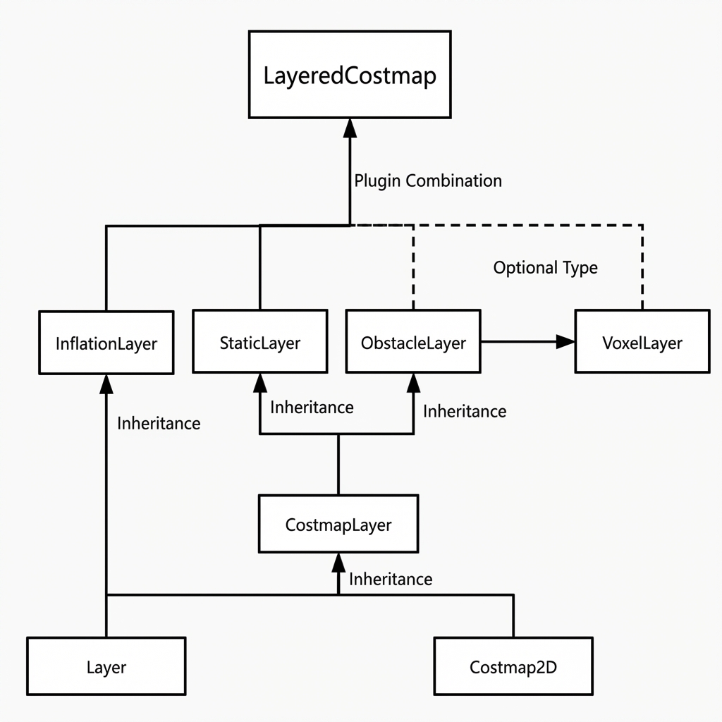

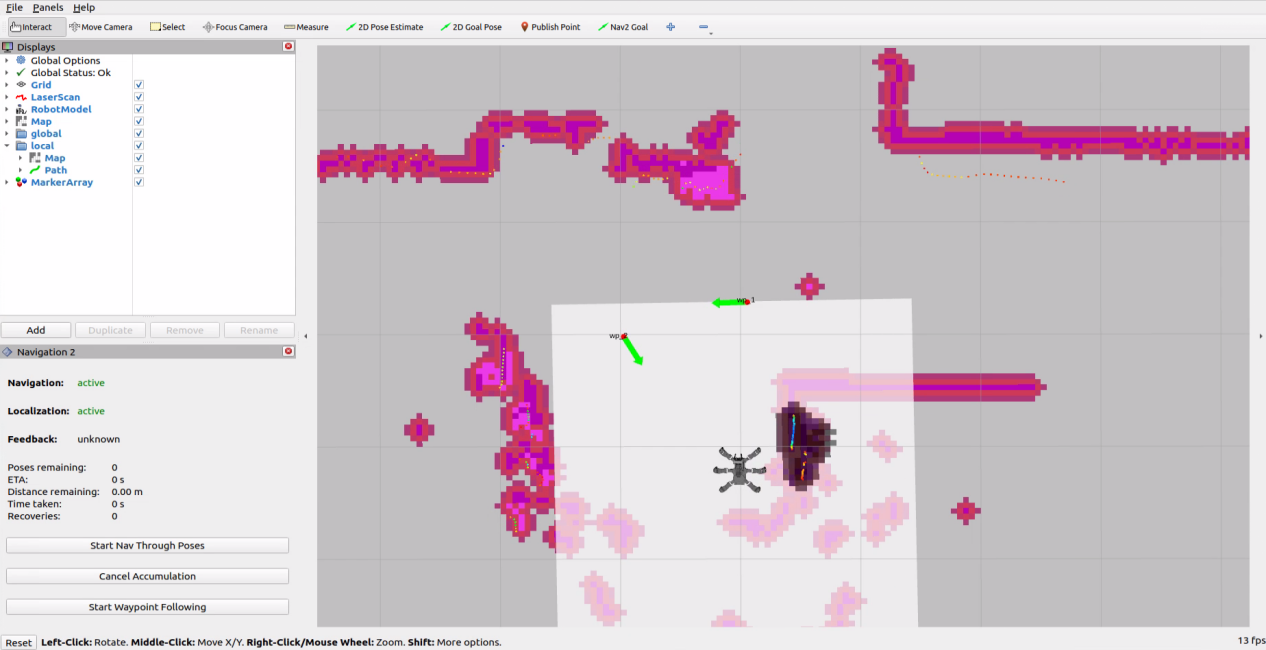

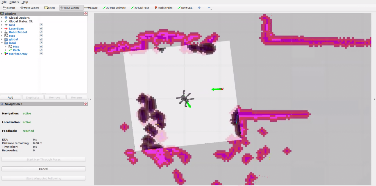

Global Costmap:
The global costmap is primarily used by the global path planner. As seen in the architecture diagram above, it resides within the Planner Server.
Static Map Layer: The static map layer, which usually consists of the completed static map built by SLAM.
Obstacle Map Layer: The obstacle map layer, used to dynamically record obstacle information perceived by sensors.
Inflation Layer: The inflation layer, which expands outward over the preceding two map layers to prevent the robot’s exterior from colliding with obstacles.
Local Costmap:
The local costmap is primarily used by the local path planner. As seen in the architecture diagram above, it resides within the Controller Server.
Inflation Layer: The inflation layer, which expands outward over the obstacle map layer to prevent the robot’s exterior from colliding with obstacles.

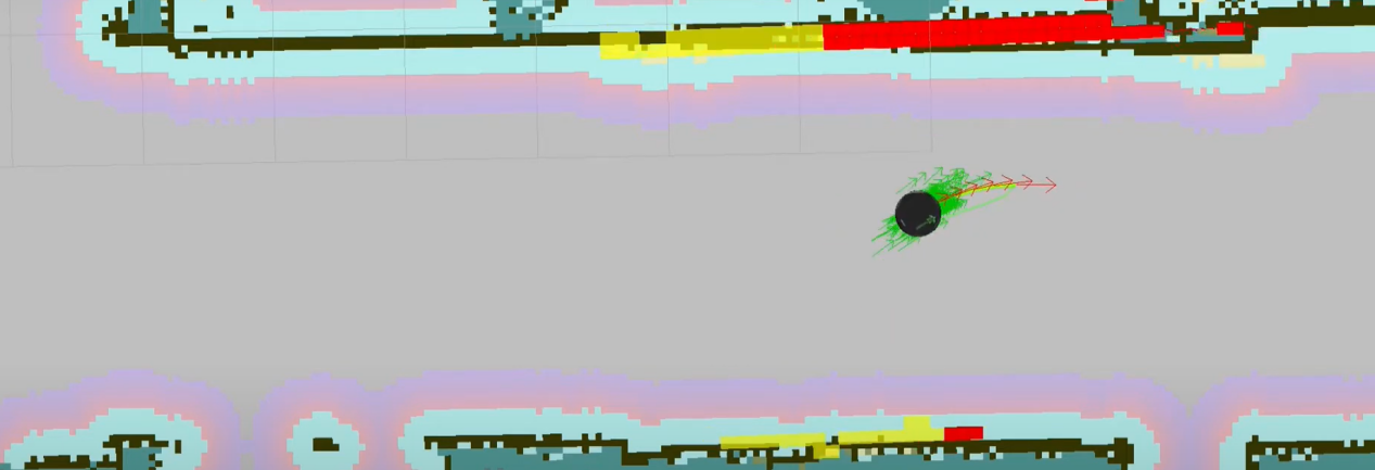

Costmap
Whether using a LiDAR or a depth camera as a sensor to generate a 2D or 3D SLAM map, it cannot be directly utilized for actual navigation, and the map must be converted into a costmap. ROS costmaps typically adopt a grid format. A single grid cell in a grid map occupies 1 byte, which is eight bits, capable of storing values from 0 to 255. In other words, each cell’s cost, or the grid value, ranges from 0 to 255. Only three scenarios are required: Occupied for when an obstacle is present, Free for when there is no obstacle, and Unknown Space.

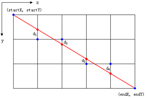

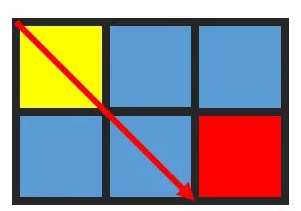

Before introducing costmap_2d, an algorithm must be presented: Bresenham’s line algorithm. Bresenham’s line algorithm is used to depict a line determined by two points. It calculates the points closest to a line segment on an n-dimensional raster. This algorithm only utilizes relatively fast integer addition, subtraction, and bit shifting, and is commonly used for drawing straight lines on computer screens. It is one of the earliest developed algorithms in computer graphics.
A set of virtual grid lines is constructed passing through the centers of pixels in each row and column, as shown in the figure above. The intersections between the line and each vertical grid line are calculated in order from the starting point to the ending point. Then, based on the sign of the error term, the pixel in that column closest to this intersection is determined.
Core idea of the algorithm: Assume: k = dy/dx. Since the starting point of the straight line is at the center of the pixel, the initial value of the error term d is d0 = 0. For every increment of 1 in the X subscript, the value of d correspondingly increments by the line’s slope value k, i.e., d = d + k. Once d ≥ 1, subtract 1 from it to ensure d remains between 0 and 1. When d ≥ 0.5, it is closest to the upper-right pixel (x+1, y+1) relative to the current pixel. When d < 0.5, it is closer to the right-side pixel (x+1, y). For computational convenience, let e = d - 0.5; the initial value of e is -0.5, and the increment is k. When e ≥ 0, take the upper-right pixel (x+1, y+1) of the current pixel (xi, yi). When e < 0, it is closer to the right-side pixel (x+1, y). Integers can be used instead to avoid division. Because only the sign of the error term is utilized in the algorithm, the following substitution can be made: e1 = 2 * e * dx.
The Costmap2D class maintains the cost value of each grid. The Layer class is a virtual base class that unifies the interfaces of the various costmap layers of plugins. The most important interface functions among them are:
The initialize function, which calls the onInitialize function to initialize each costmap layer respectively;
The matchSize function: In the StaticLayer class and ObstacleLayer class, this function calls the matchSize function of the CostmapLayer class to initialize the size, resolution, origin, and default cost values of each costmap layer, keeping them consistent with the layered_costmap. For the inflationLayer class, a distance-dependent cost table is calculated based on the inflation radius. Cost values of inflated grids can later be queried using distance. A seen_ array is also defined, which is used to mark whether a grid cell has been traversed. For the VoxelLayer class, the size of voxel blocks is initialized.
The updateBounds function, which adjusts the size range that needs updating for the current costmap layer. For the StaticLayer class, the map update boundary is defined by the size of the static map. Note: The static layer is generally only used within the global costmap. For the ObstacleLayer class, boundaries for obstacles are determined by iterating through the sensor data in clearing_observations.
The initialize function and matchSize function each execute only once. The updateBounds function and updateCosts function execute periodically, with execution frequency determined by map_update_frequency.
The CostmapLayer class simultaneously inherits from the Layer class and Costmap2D class, and provides several operational methods for updating cost values. The StaticLayer class and ObstacleLayer class both inherit from the CostmapLayer class because they need to save the cost values for instantiating the costmap layers. The StaticLayer class uses static grid map data to update its own costmap. The ObstacleLayer class utilizes sensor data to update its costmap. Compared to the ObstacleLayer class, the VoxelLayer class additionally considers z-axis data. Differences in effect are mainly reflected in obstacle clearance: one executes clearance on a 2D plane, while the other clears in 3D.
Costmap obstacle metric scaling is very flexible. Specific layers can be created according to requirements, and obstacle information of concern is then maintained on that layer. If only a LiDAR is installed on the robot, an Obstacles layer needs to be created to maintain the obstacle information scanned by the LiDAR. If an ultrasonic sensor is added to the robot, a Sonar layer needs to be created to maintain the obstacle information scanned by the acoustic sensor. Each layer can possess its own obstacle update rules, such as adding obstacles, deleting obstacles, updating confidence levels of obstacle points, etc., significantly increasing the extensibility of the navigation system.

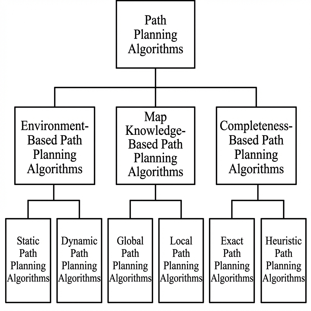

Based on the degree of understanding of the environment by the mobile robot, environmental properties, and utilized algorithms, path planning can be divided into environment-based path planning algorithms, map-knowledge-based path planning algorithms, and completeness-based path planning algorithms.
Commonly used path planning algorithms in autonomous robot navigation include Dijkstra, A*, D*, PRM, RRT, genetic algorithms, ant colony algorithms, fuzzy algorithms, etc.
Dijkstra and A* used in robotics belong to graph-structure-based path search algorithms. The navigation package suite incorporates navfn, global planner, and carrot planner global path planning plugins. One of these can be selected and loaded into move_base for use, or a third-party global path planning plugin can be loaded into move_base, such as SBPL_Lattice_Planner or srl_global_planner. Alternatively, custom global path planning plugins can be developed according to the nav_core interface specifications.
Mobile robot navigation relies on path planning to reach a target point. The navigation planning layer can be divided into a global path planning layer, a local path planning layer, and an action execution layer.
Global path planning layer: Based on a given target, it accepts weight map information to generate a global weight map, planning a global path from the starting point to the target position, which serves as a reference for local path planning.
Local path planning layer: As the local planning component of the navigation system, it accepts the local weight map information generated from the weight map and plans the local path based on nearby obstacle information.
Action execution layer: Combining instructions from the upper layer and path planning, it issues current actions for the mobile robot.

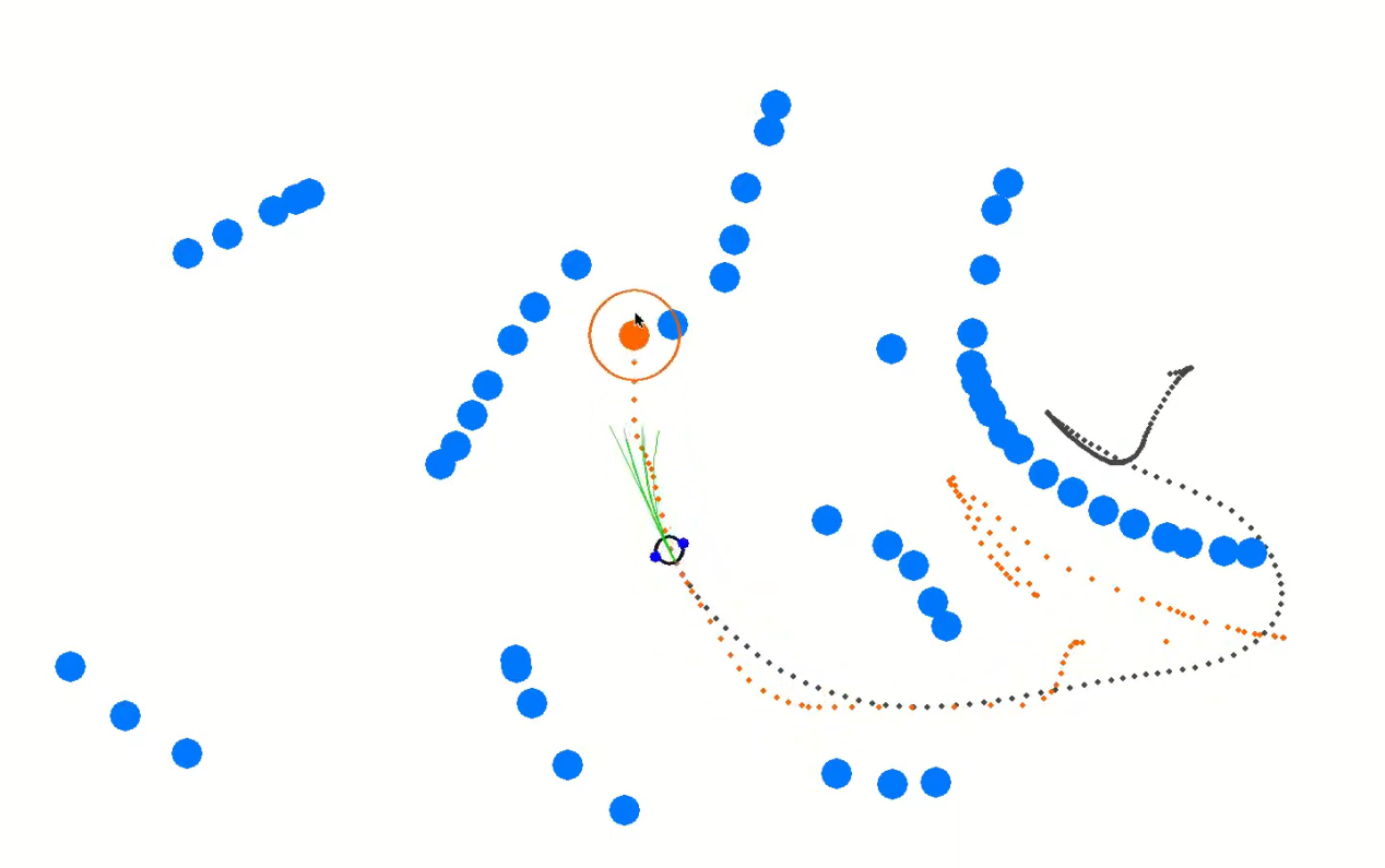

DWA Algorithm
Introduction
The DWA algorithm, also known as the Dynamic Window Approach, is a classic algorithm used for mobile robot path planning and motion control. The DWA algorithm realizes safe navigation for a robot on a known map by searching for the optimal combination of velocity and angular velocity within the state space of linear and angular velocities. The basic description and some formulas of the DWA algorithm are as follows.
The main idea behind the DWA algorithm is that at every time step, the robot considers its current state and sensor information, then generates a set of possible motion trajectories, also called a dynamic window, in the state space of velocity and angular velocity. It subsequently evaluates these trajectories to select the optimal one. Evaluation criteria typically include obstacle avoidance, maximizing forward directional velocity, and minimizing angular velocity. By continuously repeating this process, the robot can plan its motion trajectory in real time to cope with dynamic environments and obstacles.

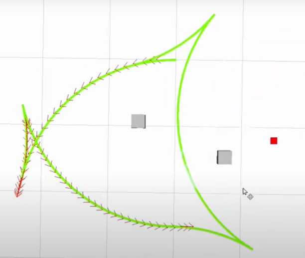

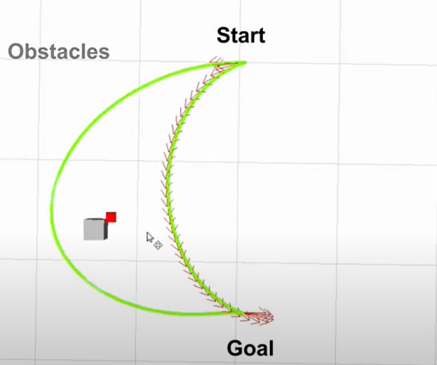

TEB Algorithm
Introduction
The TEB (Timed Elastic Band) algorithm is employed for path planning and motion planning, mainly used in applications involving robots and autonomous vehicles. The central idea of the TEB algorithm is to model the path planning problem as an optimization problem. The goal is to generate the optimal trajectory within a given time, satisfying the kinematic constraints of the robot or vehicle, as well as obstacle avoidance requirements. Key characteristics of the TEB algorithm include:
(1) Hierarchical time representation: The TEB algorithm introduces the concept of time stratification, dividing the trajectory into multiple time steps. Each time step corresponds to a position of the robot or vehicle on the trajectory. This aids in establishing time constraints and avoiding collisions.
(2) Trajectory parameterization: The TEB algorithm parameterizes the trajectory into a series of displacements and velocities to facilitate optimization. Each time step has a displacement and a velocity parameter.
(3) Constraint optimization: The TEB algorithm considers the kinematic constraints of the robot, obstacle avoidance constraints, and trajectory smoothness constraints. These constraints are modeled as part of the objective function in the optimization problem.
(4) Optimization solving: The TEB algorithm uses optimization techniques like Quadratic Programming (QP) or Nonlinear Programming (NLP) to solve for the optimal parameters of the trajectory to satisfy the constraints.

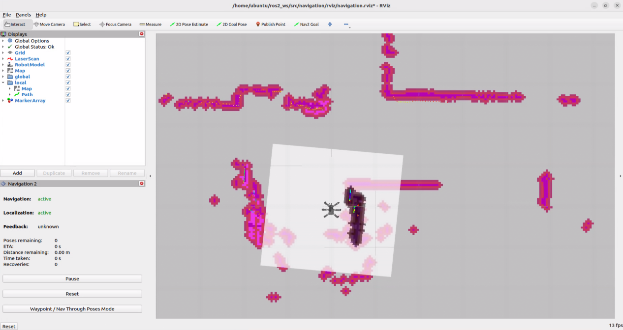

5.2.4 LiDAR Single-Point, Multi-Point Navigation, and Obstacle Avoidance
Click the icon
on the system desktop to open the command line terminal. Enter the command to disable the app auto-start service:
Enter the command to start the navigation service, and press Enter:
The map_01 at the end of the command is the map name, which can be modified based on specific requirements. The storage path for maps is /home/ubuntu/ros2_ws/src/slam/maps.

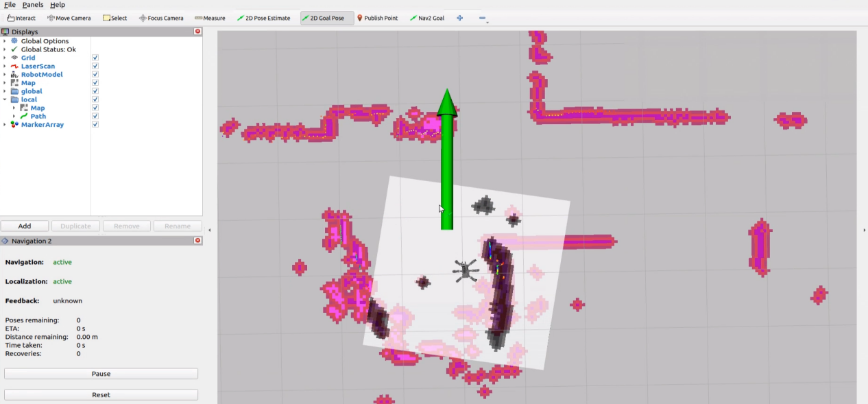

Open a new command line terminal and enter the command to start the rviz tool to display navigation:

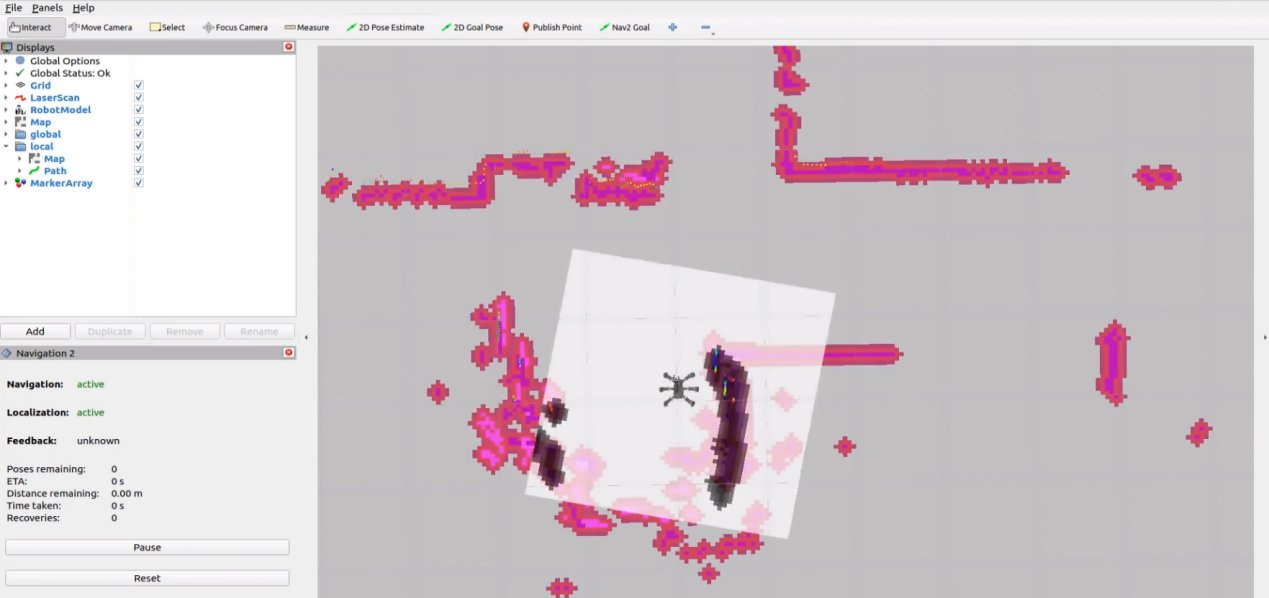

Single-Point Navigation

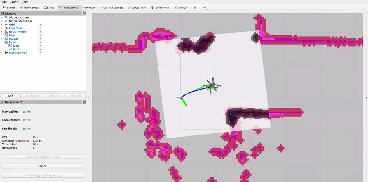

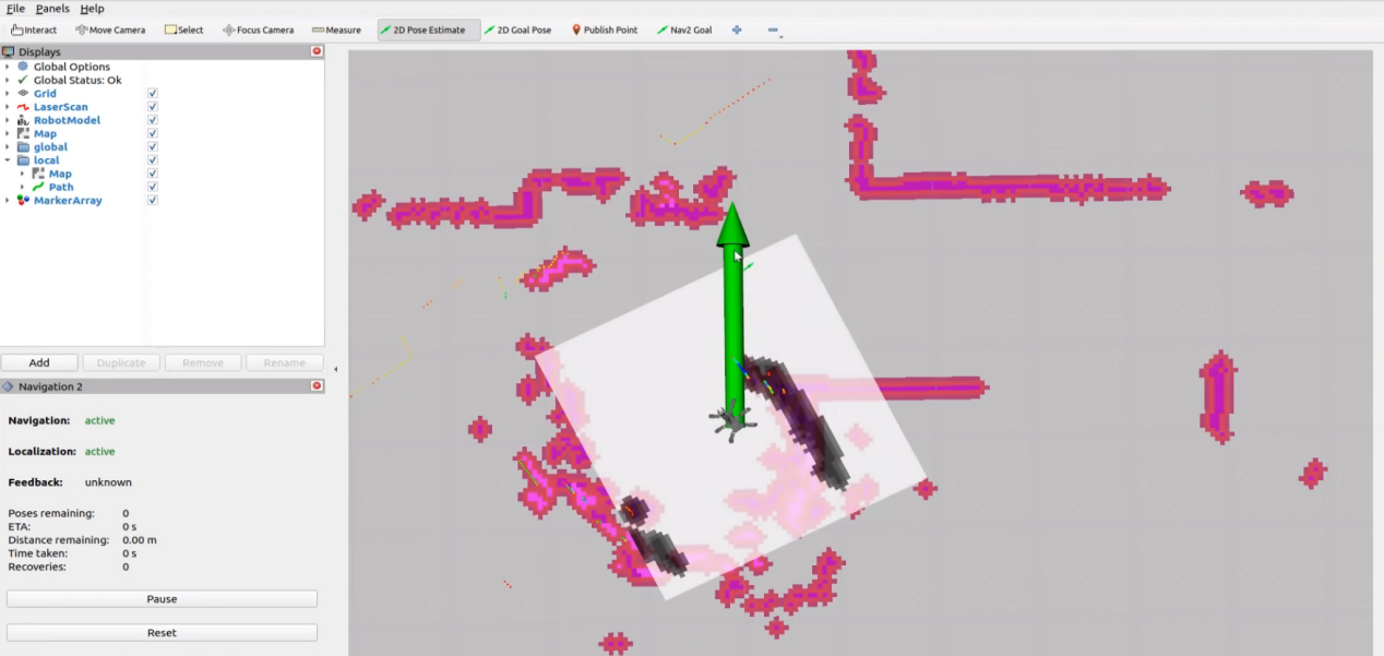

In the software menu bar, 2D Pose Estimate is used to set the robot’s initial position, 2D Goal Pose is used to set a single target point for the robot, and Publish Point is used to set multiple target points for the robot.
Click
to set the robot’s initial position. Choose a position on the map interface, and click and drag the mouse to set the robot’s pose.
The effect after setting the robot’s initial position is shown in the figure below:

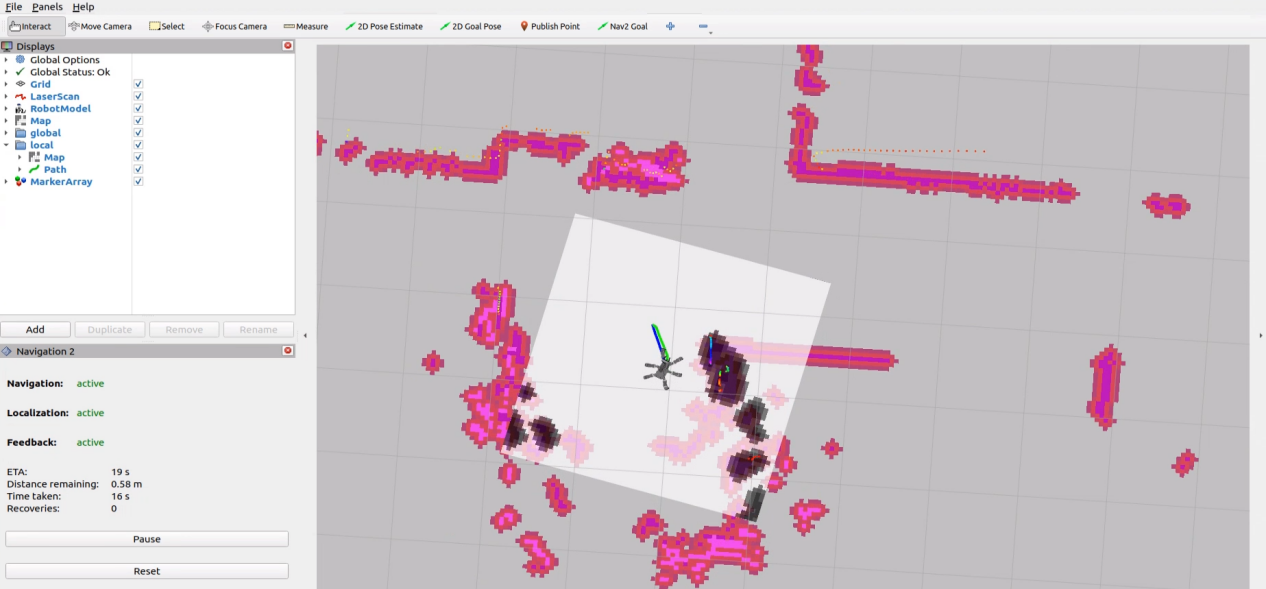

Click the icon
, select a location on the map interface as the target point, and click once with the mouse at that point. Once selected, the robot will automatically generate a route and move to the target point.
After the target point is determined, the map will display two paths. The line composed of green segments is the straight-line path between the robot and the target point, while the dark blue line is the robot’s planned path.
When encountering obstacles, the robot will bypass them while continuously adjusting its posture and movement trajectory.

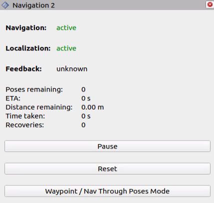

Click the
Waypointbutton to enable multi-point navigation:
Set the respective navigation points via
, as shown below:
Finally, click
Start Nav Through PosesorStart Waypoint Followingto navigate.Start Nav Through Poseswill not be concerned with the robot’s posture when reaching each navigation point, whileStart Waypoint Followingcontrols the robot to achieve a specific posture at each point.The execution effect of multi-point navigation is shown below, with the robot reaching the target points in sequence:
The completed state of multi-point navigation is shown in the figure below:

5.2.5 RTAB-VSLAM 3D Navigation
Algorithm Introduction and Principles
For an introduction and principles of the RTAB-VSLAM algorithm, refer to 5.1.3 RTAB-VSLAM 3D Mapping for more details.
Operating Steps
Power on the robot and connect it to the remote control software NoMachine. For details on how to connect to the remote desktop, refer to section 1. ROSpider User Manual -> 1.4 Development Environment Setup.
Click the icon
Enter the command to start navigation, and press Enter:
Open a new command-line terminal and enter the command to start the rviz tool to display navigation:
In the software menu bar, 2D Goal Pose is used to set a single target point for the robot, and Publish Point is used to set multiple target points.
Click the icon
After the target point is determined, the map will display the path between the robot and the target point.
