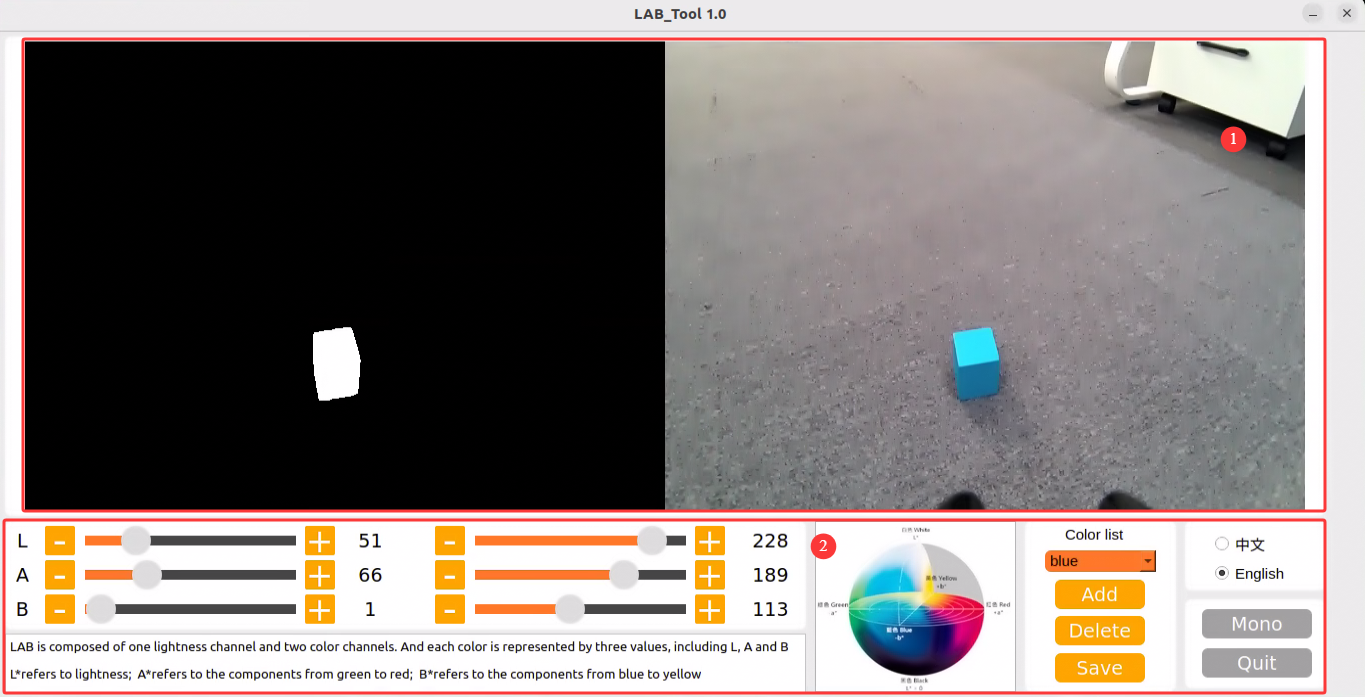

6.1.2 LAB_TOOL Interface Description
The LAB_TOOL software interface is divided into a video feed display area and a recognition adjustment area.
  1. Video Feed Display Area: The left side shows the processed camera feed, and the right side shows the original feed.
If the video feed does not display, the camera connection has failed. Check the cable connection at the corresponding port, or try replugging it to resolve the issue.
  1. Recognition Adjustment Area: Used to adjust color thresholds. The functions of each button are described in the table below:

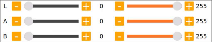

The L, A, and B sliders are used to adjust the numerical values of the L, A, and B components of the video feed.
The left slider represents the "min" value of each component, and the right slider represents the "max" value of each component.

6.1.3 Adjusting Color Thresholds

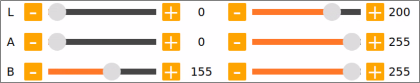

  1. Open the LAB_TOOL, and select the color to be adjusted in the color list within the recognition adjustment area. Here, red is used as an example.

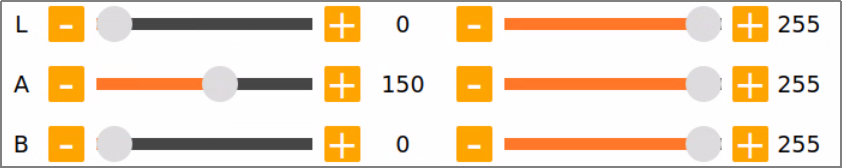

  2. Set both the min and max values of the L, A, and B components to 0 and 255 respectively.

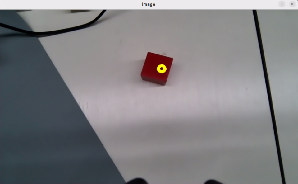

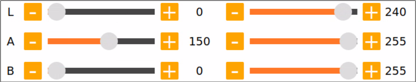

  1. Place a colored object within the camera’s field of view. Refer to the LAB color space distribution chart, and adjust the L, A, and B components toward the target recognition color range.
Red is closer to “+a”, so the A component needs to be increased. Keep the max value of the A component unchanged and increase its min value until the colored object area in the left display screen turns white, while other areas turn black.
  1. Adjust the remaining L and B components based on the environment. If the red color appears too light, increase the min value of the L component. If it appears too dark, decrease the max value of the L component. If the red color is too warm, increase the min value of the B component. If it is too cool, decrease the max value of the B component.

  1. Click the Save button in the recognition adjustment area to save the color threshold parameters.

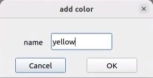

  1. Open the LAB_TOOL and click the Add button.
  1. Enter the color name in the Name field and click OK.

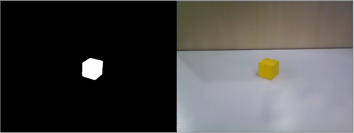

  1. Place the colored object within the camera’s field of view. Drag the sliders for the L, A, and B components to adjust the threshold until the colored object area in the left display screen turns white, while other areas turn black.
After adjusting the color thresholds, press Ctrl + C to close the camera service, and click Close to exit the interface.

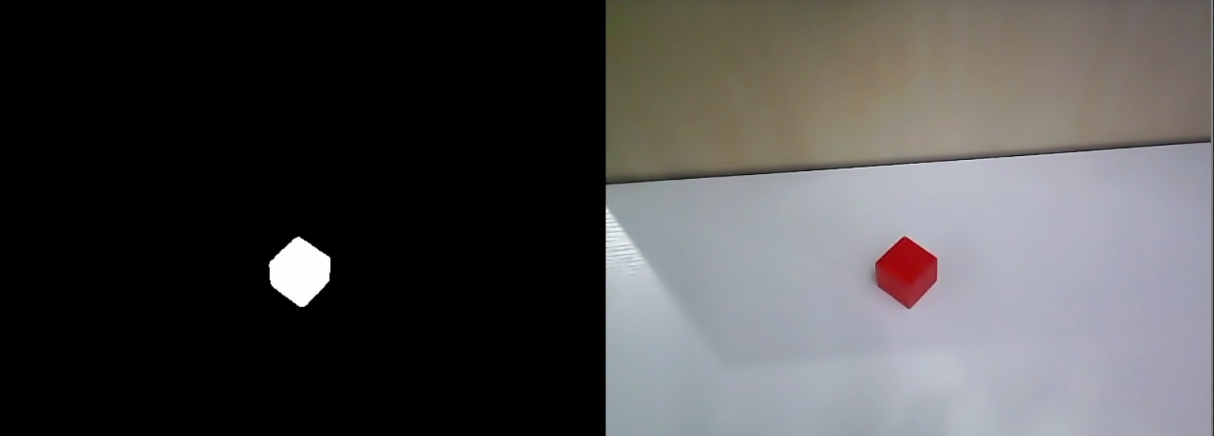

First, the camera’s RGB image is acquired, and the image undergoes scaling and Gaussian blur processing. The color space of the image is then converted from RGB to LAB. For more details on the LAB color space, refer to 1. Tutorials\2. Basics Course\3. OpenCV Computer Vision Course.
Next, object colors within the circle are recognized using color thresholds, and a mask is applied to portions of the image. Masking uses a selected image, graphic, or object to globally or locally obscure the processed image. Following morphological opening and closing operations on the object image, the object with the largest contour is ultimately circled.
Opening operation: Erosion followed by dilation. Purpose: Used to eliminate small objects, smooth shape boundaries without changing area. It can remove small granular noise and disconnect adhered objects.
Erosion: Eliminates object boundary points, shrinking the boundary inward, which removes objects smaller than the structural element.
Dilation: Expands object boundary points, merging all background points contacting the object into the object, thereby expanding the boundary outward.
Finally, the recognition results are fed back onto the video feed.

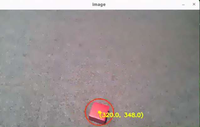

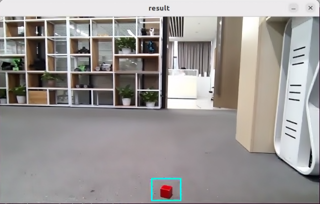

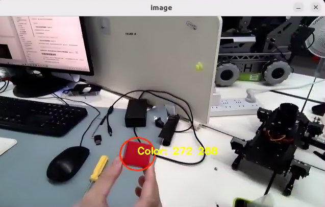

6.2.3 Program Outcome
After starting the feature, ensure that no other objects containing the target colors exist within the camera’s field of view to avoid affecting the performance.
After starting the feature, place the target object within the camera’s field of view. When the target object is recognized, the buzzer will emit a short beep, the video feed will mark the target object with a circle of the corresponding color, and the color name will be printed in the terminal. Upon recognizing red, servo No. 22 will rotate once, upon recognizing blue, servo No. 23 will rotate once, and upon recognizing green, servo No. 19 will rotate once. The program can recognize objects that are red, blue, and green.

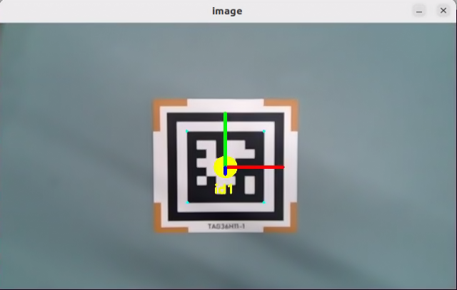

6.3 AprilTag Tag Recognition
6.3.1 Experiment Overview
First, the RGB image is obtained by subscribing to the topic message published by the camera node, and it undergoes grayscale conversion and scaling processing.
Next, tag information is acquired, such as the tag ID, tag center point, and corner coordinates.
Finally, camera calibration is performed to feed back the tag recognition results via the video feed.

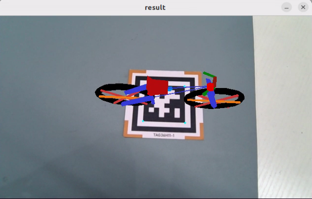

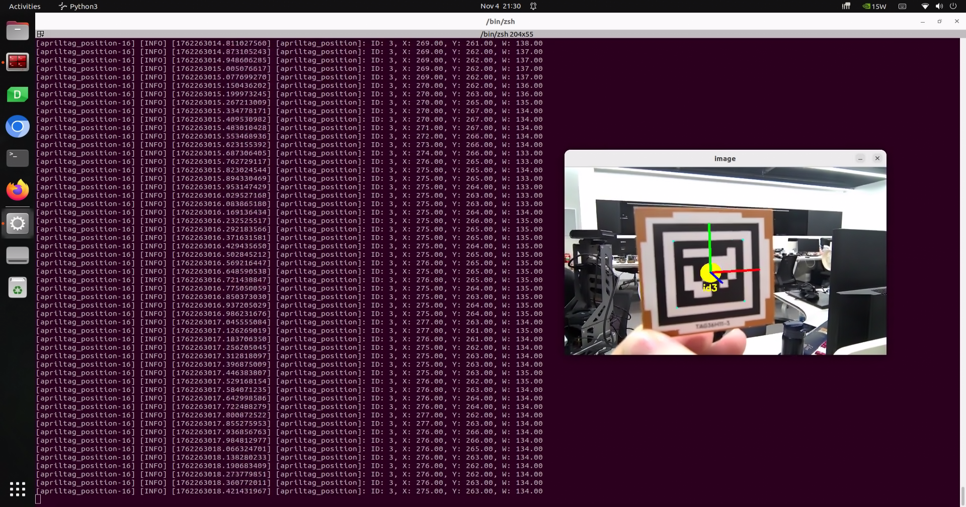

6.3.3 Program Outcome
After starting the feature, place the tag card within the camera’s field of view. When the tag is recognized, a coordinate axis will be drawn at the tag on the video feed, the four corners of the tag will be marked with small blue dots, and the tag’s ID will be displayed.

6.3.4.2 Python Source Code Analysis
/home/ubuntu/ros2_ws/src/example/example/opencv_example/include/apriltag_recognition.py
  • The parameter OBJP refers to the world coordinates of the feature points. The parameter AXIS refers to the 3D coordinates of three-dimensional points in the world coordinate system. The parameter CIRCLE is an array representing a circular set of points.
OBJP = np.array([[-1, -1,  0],
                 [ 1, -1,  0],
                 [-1,  1,  0],
                 [ 1,  1,  0],
                 [ 0,  0,  0]], dtype=np.float32)
AXIS = np.float32([[0, 0, 0],
                   [1.5, 0, 0],
                   [0, 1.5, 0],
                   [0, 0, 1.5]])
CIRCLE = np.float32([[0.3 * math.cos(math.radians(i)), 0.3 * math.sin(math.radians(i)), 0] for i in range(360)])
AXIS = np.append(AXIS, CIRCLE, axis=0)
  • The draw function is used to draw the four points and three coordinate axes.
def draw(img, corners, imgpts):
    imgpts = np.int32(imgpts).reshape(-1,2)
    cv2.drawContours(img, [imgpts[4:]], -1, (255, 255, 0), -1)
    cv2.line(img, tuple(imgpts[0]), tuple(imgpts[1]), (255, 0, 0), 3)
    cv2.line(img, tuple(imgpts[0]), tuple(imgpts[2]), (0, 255, 0), 3)
    cv2.line(img, tuple(imgpts[0]), tuple(imgpts[3]), (0, 0, 255), 3)
    return img
  • Sets the camera intrinsic matrix and distortion coefficients, subscribes to images and camera information, and publishes tag information and image processing results.
        self.camera_intrinsic = np.array([[619.063979, 0, 302.560920],
                                          [0, 613.745352, 237.714934],
                                          [0, 0, 1]], dtype=np.float32)
        self.dist_coeffs = np.array([0.103085, -0.175586, -0.001190, -0.007046, 0.000000])
        self.tag_detector = apriltag("tag36h11")
        self.image_sub = self.create_subscription(Image, '/depth_cam/rgb/image_raw' , self.image_callback, 1)  # Camera image subscription
        self.camera_info_sub = self.create_subscription(CameraInfo, '/depth_cam/rgb/camera_info' , self.camera_info_callback, 1)  # Camera info subscription
        self.apriltag_info_pub = self.create_publisher(ApriltagsInfo, '~/apriltag_info', 1) # Tag info publishing
        self.result_publisher = self.create_publisher(Image, '~/image_result', 1)  # Image processing result publishing
        # self.declare_parameter('enable_display', False)
        self.display = self.get_parameter('enable_display').value
  • camera_info_callback: A callback function used to handle subscriptions to camera info messages, updating the camera intrinsic matrix and distortion coefficients.
    def camera_info_callback(self, msg):
        with self.lock:
            self.camera_intrinsic = np.array(msg.k).reshape(3, 3)
            self.dist_coeffs = np.array(msg.d)
  • image_callback: A callback function used to handle image messages from the image subscriber, including image conversion, processing, visual display, and publishing the processed image to a designated topic.
    def image_callback(self, msg):
        rgb_image = self.bridge.imgmsg_to_cv2(msg, 'rgb8')
            with self.lock:
                result_image = self.image_proc(rgb_image, result_image)
        except Exception as e:
        if self.display:
            cv2.imshow('image', cv2.cvtColor(result_image, cv2.COLOR_RGB2BGR))
            cv2.waitKey(1)
        self.result_publisher.publish(self.bridge.cv2_to_imgmsg(result_image, "rgb8"))
  • Draws tag corners and center points, and performs pose estimation. The parameter corners refers to the pixel coordinates of feature points in the image. The parameter rvecs refers to the rotation vector transforming the world coordinate system to the camera coordinate system. The parameter tvecs refers to the translation vector transforming the world coordinate system to the camera coordinate system.
    tag_center = common.point_remapped(tag_center, (int(w/2), int(h/2)), (w, h))
    corners = np.array([lb, rb, lt, rt, tag_center], dtype=np.float32).reshape(5, -1)
    ret, rvecs, tvecs = cv2.solvePnP(OBJP, corners, self.camera_intrinsic, self.dist_coeffs)
    imgpts, _ = cv2.projectPoints(AXIS, rvecs, tvecs, self.camera_intrinsic, self.dist_coeffs)
6.4 AR Vision
6.4.1 Experiment Overview
Next, tags are detected to acquire tag information, such as the tag ID, tag center point, and corner coordinates.
Finally, through operations like model projection and polygon filling, a 3D image is rendered at a specified location on the video feed.
6.4.2 Operation Steps
  1. Power on the robot and connect it to the remote control software, NoMachine. For instructions on connecting to the remote desktop, refer to 1. ROSpider User Manual \ 1.4 Development Environment Setup.
  2. Click the desktop icon to open the terminal.
  3. Enter the command to stop the auto-start service.
  1. Enter the command to start the AR vision feature.
ros2 launch example ar.launch.py
  1. To close the feature, press Ctrl + C in the terminal interface. If the feature does not close immediately, try pressing Ctrl + C a few more times.
6.4.3 Program Outcome

6.4.4.2 Python Source Code Analysis
/home/ubuntu/ros2_ws/src/example/example/opencv_example/include/ar.py
  • Obtains the default storage path for the model.
MODEL_PATH = os.path.join(os.path.abspath(os.path.join(os.path.split(os.path.realpath(__file__))[0])), '3d_model')
  • The draw_rectangle function is used to draw a cube. The parameter img is the image on which to draw the cube. The parameter imgpts refers to the corner points of the cube. Finally, it returns the image with the drawn cube.
def draw_rectangle(img, imgpts):
    imgpts = np.int32(imgpts).reshape(-1, 2)
    cv2.drawContours(img, [imgpts[:4]], -1, (0, 255, 0), -3)  # Draw contour points, filled
    for i, j in zip(range(4), range(4, 8)):
        cv2.line(img, tuple(imgpts[i]), tuple(imgpts[j]), (255), 3)  # Draw points connected by lines
    cv2.drawContours(img, [imgpts[4:]], -1, (0, 0, 255), 3)  # Draw contour points, unfilled
    return img
  • Obtains related information about the 3D image, such as vertex position information and color information.
	if self.target_model != 'rectangle':  # If the cube is not being drawn
		# Load the model
		obj = obj_load(os.path.join(MODEL_PATH, self.target_model + '.obj'), swapyz=True)
		obj.faces = obj.faces[::-1]
		new_faces = []
		# Analyze the model and get the point coordinates
		for face in obj.faces:
			face_vertices = face[0]
			points = []
			colors = []
			for vertex in face_vertices:
				data = obj.vertices[vertex - 1]
				points.append(data[:3])
				if self.target_model != 'cow' and self.target_model != 'wolf':
					colors.append(data[3:])
			scale_matrix = np.array([[1, 0, 0], [0, 1, 0], [0, 0, 1]]) * MODELS_SCALE[self.target_model]  # Scale
			points = np.dot(np.array(points), scale_matrix)
  • Conversion from Euler angles to rotation matrix: Converts Euler angles to a rotation matrix to subsequently adjust the viewing angle of the 3D image. The parameter 'xyz' is the axis of rotation. The parameter (0, 0, 180) represents the rotation angle, namely the Euler angles. The parameter degrees=True dictates the unit of the rotation angle. If set to True, the unit is degrees.
if self.target_model == 'bicycle':
	points = np.array([[p[0] - 670, p[1] - 350, p[2]] for p in points])
	points = R.from_euler('xyz', (0, 0, 180), degrees=True).apply(points)
elif self.target_model == 'fox':
	points = np.array([[p[0], p[1], p[2]] for p in points])
	points = R.from_euler('xyz', (0, 0, -90), degrees=True).apply(points)
elif self.target_model == 'chair':
        # Image callback
        # Convert ROS image into numpy format
        with self.lock:
                # Process image
                self.get_logger().info(str(e))
            cv2.imshow("result", cv2.cvtColor(result_image, cv2.COLOR_RGB2BGR))
            cv2.waitKey(1)
        # Convert opencv format into ros format

6.5.2 Operation Steps
  • Commands are strictly case-sensitive, and the Tab key can be used to auto-complete keywords.
  • The recognizable colors for this feature are red, green, and blue.
  1. Enter the command to start the color block coordinate positioning feature. To locate other colored blocks, change red to the desired color.
ros2 launch example color_position.launch.py color:=red
6.5.3 Program Outcome
After starting the feature, ensure that no other objects containing the recognized color exist within the camera’s field of view to avoid affecting the performance.
After starting the feature, place the target object within the camera’s field of view. When the target object is recognized, the buzzer will emit a short beep, the video feed will mark the target object with a circle of the corresponding color, and the color name will be printed in the terminal. Upon recognizing red, servo No. 22 will rotate once, upon recognizing blue, servo No. 23 will rotate once, and upon recognizing green, servo No. 19 will rotate once. The program can recognize red, blue, and green objects.

/home/ubuntu/ros2_ws/src/example/example/opencv_example/include/color_position.py
  • Creates subscriptions to the '/color_detect/color_info' and '/color_detect/image_result' topics, creates the '~/start' service, and creates a client to request the /controller_manager/init_finish service. Creates publishers buzzer_pub and joints_pub, sets up the color detection and ROI clients, and finally creates a timer.
    self.create_subscription(ColorsInfo, '/color_detect/color_info', self.get_color_callback, 1)
    self.create_subscription(Image, '/color_detect/image_result', self.image_callback, 1)
    self.create_service(Trigger, '~/start', self.start_srv_callback, callback_group=timer_cb_group) # Enter the feature
    self.controller = step_controller.StepController()
    self.buzzer_pub = self.create_publisher(BuzzerState, 'ros_robot_controller/set_buzzer', 1)
    self.set_color_client = self.create_client(SetColorDetectParam, '/color_detect/set_param', callback_group=timer_cb_group)
    self.set_roi_client = self.create_client(SetCircleROI, '/color_detect/set_circle_roi', callback_group=timer_cb_group)
    self.set_color_client.wait_for_service()
    self.set_roi_client.wait_for_service()
  • This initialization function initializes robot posture and robotic arm servo positions, calls the start_srv_callback service callback function, and starts a thread to execute the target function.
    def init_process(self):
        self.timer.cancel()
        self.controller.set_build_in_pose('DEFAULT_POSE', 1)
        joint_angle = [500, 670, 40, 210, 500, 600]
        set_servo_position(self.joints_pub, 1, ((19, joint_angle[0]), (20, joint_angle[1]), (21, joint_angle[2]), (22, joint_angle[3]), (23, joint_angle[4]), (24, joint_angle[5])))
  • Service callback function used to start the color recognition function and return a response.
        self.get_logger().info('\033[1;32m%s\033[0m' % "start color position")
        color_msg = ColorDetect()
        color_msg.color_name = self.target_color
        color_msg.detect_type = 'circle'
        msg.data = [color_msg]
        if res.success:
            self.get_logger().info('\033[1;32m%s\033[0m' % 'set color success')
            self.get_logger().info('\033[1;32m%s\033[0m' % 'set color fail')
        response.success = True
        response.message = "start"
        return response
  • Acquires the image, recognizes the colored object, marks the center point, and finally displays the image.
    def main(self):
        while self.running:
            except queue.Empty:
                if not self.running:
                    continue
            if self.color in ['red', 'green', 'blue'] :
                self.count += 1
                if self.count > 30:
                    self.count = 0
                    self.target_color = self.color
                self.count = 0
            if image is not None:
                if self.center is not None:
                    cv2.circle(image, (int(self.center[0]), int(self.center[1])), 5, (0, 255, 255), -1)
                    string = "({:0.1f}, {:0.1f})".format(self.center[0], self.center[1])
                    cv2.putText(image, string, (int(self.center[0]), int(self.center[1] + 16)), cv2.FONT_HERSHEY_SIMPLEX, 0.6, (0, 255, 255), 2)
                cv2.imshow('image', image)
                key = cv2.waitKey(1)
                if key == ord('q') or key == 27:  # Press Q or Esc to exit
                    self.running = False
        rclpy.shutdown()

  1. Left-click the mouse in the video feed to select the object to be tracked.
  1. Next, enter the command in the current terminal and press Enter to initiate tracking:
ros2 service call /object_tracking/set_running std_srvs/srv/SetBool "{data: True}"
  1. To close the feature, press Ctrl + C in the first terminal interface. If the feature does not close immediately, try pressing Ctrl + C a few more times.
6.6.3 Program Outcome
After starting the feature, place the target object within the camera’s field of view. When the target object is recognized, ROSpider will track the object.

6.7.2 Operation Steps
  1. Enter the command to start the tag positioning feature.
ros2 launch example apriltag_position.launch.py
6.7.3 Program Outcome
Once the program runs, it will recognize the tag in the frame, draw the 3D coordinate axis and corners at the tag’s center, and print the recognized tag ID and coordinate position information to the terminal.
6.7.4 Program Analysis
6.7.4.1 Launch File Analysis
/home/ubuntu/ros2_ws/src/example/example/opencv_example/apriltag_position.launch.py

6.7.4.2 Python Source Code Analysis
/home/ubuntu/ros2_ws/src/example/example/opencv_example/include/apriltag_position.py
  • Creates subscriptions to the '/apriltag_detect/image_result' and '/apriltag_detect/apriltag_info' topics, creates the joints_pub publisher, and finally creates a timer.
	self.image_sub = self.create_subscription(Image, '/apriltag_detect/image_result' , self.image_callback, 1)  # Image subscription
	self.apriltag_info_sub = self.create_subscription(ApriltagsInfo, '/apriltag_detect/apriltag_info',  self.apriltag_info_callback, 1) # Tag info subscription
  • Initialization function, initializing robot posture and robotic arm servo positions.
        self.timer.cancel()
        joint_angle = [500, 750, 200, 150, 500, 600]
  • The apriltag_info_callback callback function is used to extract the center position, width, and ID of the tag.
    def apriltag_info_callback(self, msg):
        data = msg.data
        if data != []:
            self.center = (data[0].x, data[0].y)
            self.width = data[0].w
            self.id = data[0].id
            self.id = ''
  • Image reception and processing callback function, including image data format conversion and image display.
        if self.id :
            self.get_logger().info(f"ID: {str(self.id)}, X: {self.center[0]:.2f}, Y: {self.center[1]:.2f}, W: {self.width:.2f}")
        cv2.waitKey(1)

6.10.3 Operation Steps
  1. Enter the command to start the KCF object recognition feature.
ros2 launch example kcf.launch.py
6.10.4 Program Outcome
After starting the feature, press the S key, and left-click the mouse to draw a box around the tracking target in the current frozen frame. To redraw the box, press the C key, and press the S key again.
After selection is complete, press the Space key or Enter key to start tracking. A blue box will mark the tracking target in the video feed, and the robot will rotate left and right based on the target’s position to track it.
