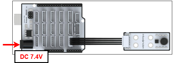

This section illustrates connecting a 4-pin cable to the A2 and A3 ports on the Arduino expansion board. Refer to the diagram below.

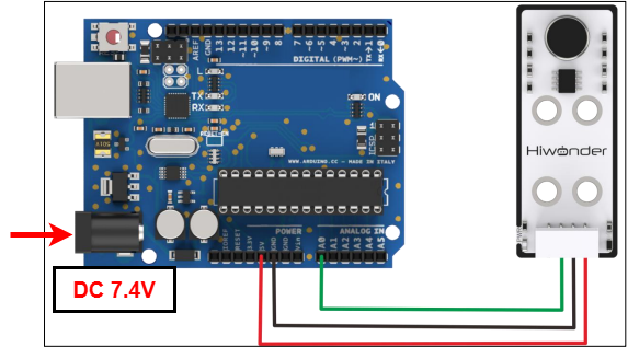

If you do not have an Arduino expansion board, use a Dupont wire to directly connect to the Arduino development board, just as below:
  • If the battery is not connected to the cables, do not connect the cable ends directly together. Doing so may cause a short circuit and damage the system.
  • Before powering on, ensure that no metal objects are touching the controller. Otherwise, the exposed pins at the bottom of the board may cause a short circuit and damage the controller.

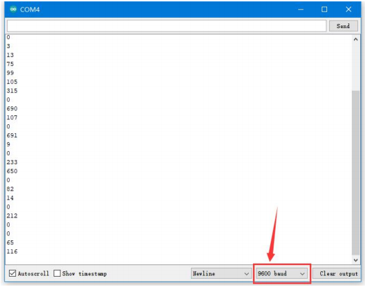

  1. After the code is uploaded, click to open the serial monitor, set the baud rate to 9600 to observe the output.
2.2.2 Project Outcome

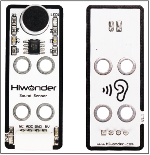

When you speak into the microphone of the sound sensor and the sensor detects the sound signal, LED1 on the sensor lights up. The louder the voice, the larger the value displayed on the serial monitor.
