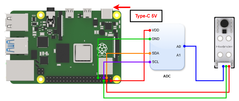

3.1.1 Wiring Instruction
This section uses DuPont wire to connect the sound sensor and the ADC digital-to-analog conversion module as an example.For wiring instructions, refer to the figure below:
  • If the battery is not connected to the cables, do not connect the cable ends directly together. Doing so may cause a short circuit and damage the system.
  • Before powering on, ensure that no metal objects are touching the controller. Otherwise, the exposed pins at the bottom of the board may cause a short circuit and damage the controller.

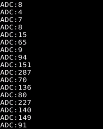

3.2.2 Project Outcome
When you speak into the microphone of the sound sensor and the sensor detects the sound signal, LED1 on the sensor lights up. The louder the voice is, the larger the value displayed in the Raspberry Pi terminal window will be.

    value = adc.read_adc(1,gain=GAIN)
    print('ADC:' + str(value))
    time.sleep(0.2)
Store the data output from port A1 of the ADC module into value, and then print the content of value in the Raspberry Pi terminal window.
