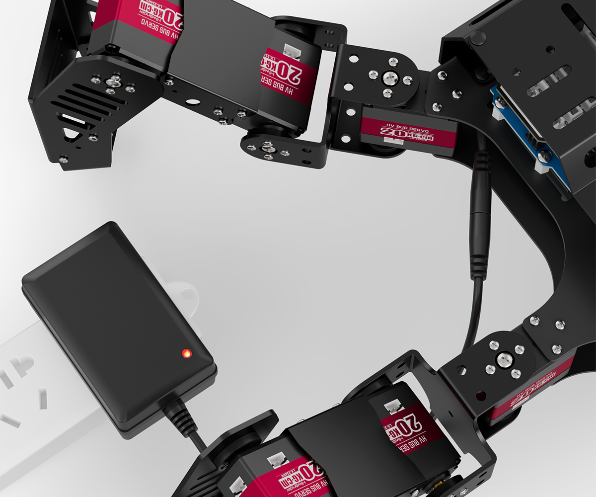

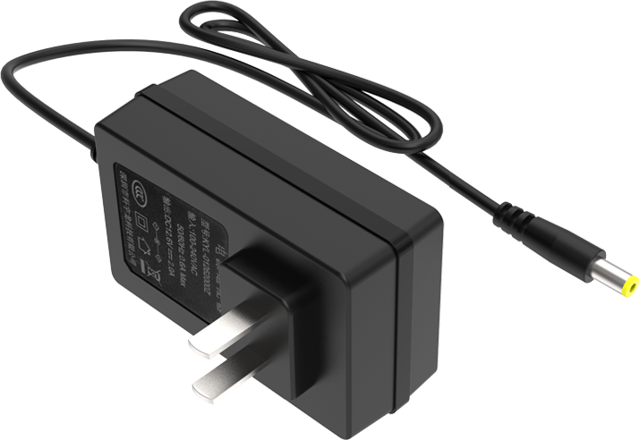

1.3 Battery Charging and Usage Precautions
1.3.1 Charging Instructions

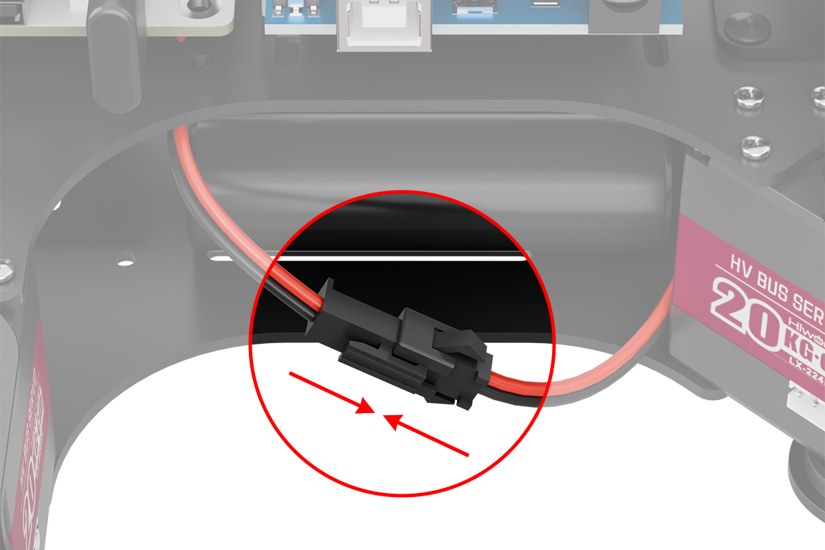

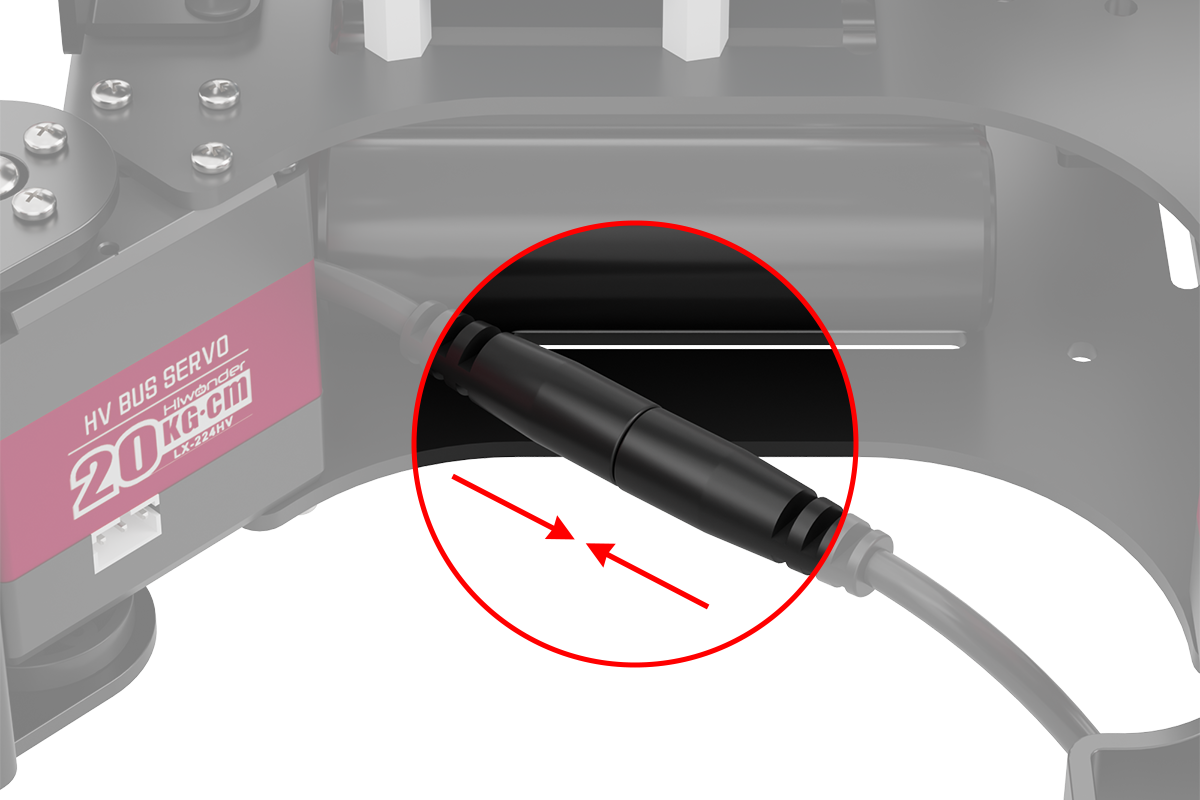

Step 1: Before charging, connect the battery using the provided connector. Connect the red wire to the red terminal and the black wire to the black terminal.
The battery adopts a reverse-polarity protection design.
Step 2: Insert the charger plug into the battery’s round DC port.
Step 3: A red indicator light means charging is in progress. A green light indicates charging is complete. A full charge typically requires approximately 3 hours.
