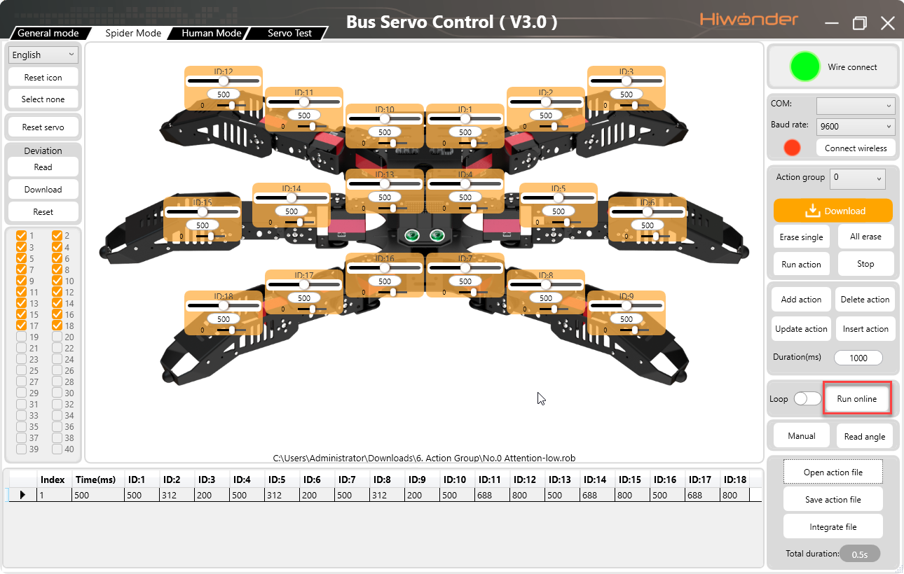

(3) Double-click to launch the PC software, then click “Spider Mode” at the top of the interface.
(4) Once the robot is powered on, the software will automatically attempt to connect. If successful, the upper right corner of the main interface will display “Wire Connect”, and the indicator of the glowy ultrasonic sensor will light up green.
Upon connection, the system will automatically recognize the device and install the necessary driver.

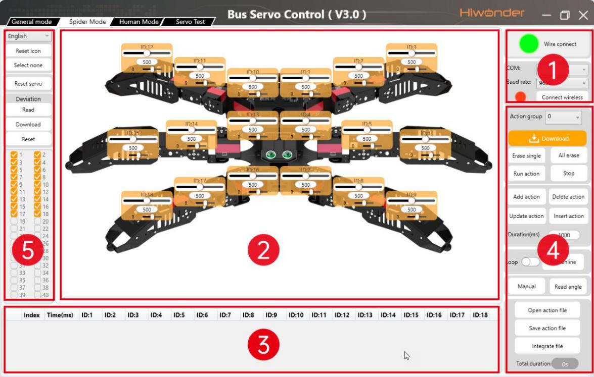

3.1.3 Function Introduction

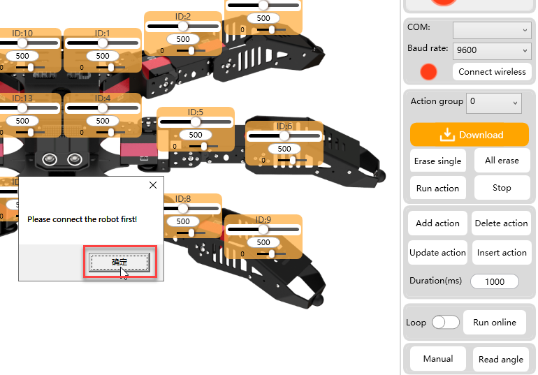

① Device Connection Area
| Icon | Function |
Displays the current connection status of the device. The icon turns green indicating that the device is successfully connected, while red indicating that the device is disconnected or not detected and the message "Disconnect" will appear. |
② Servo Control Area
The servo control area displays the icons of the selected servos. By adjusting the corresponding slider values, you can directly control the position of each servo.
| Icon | Function |
Indicates the servo ID number, for example, 9 is the servo's ID here. |
Adjust the servo position, with a range from 0 to 1000. |
Adjust the servo deviation, with a range from -100 to 100. |
③ Action Details List Area
This section displays the details of the current action group, including the execution time for each action and the values of all involved servos.
| Icon | Function |
Indicates the action group number. There are 230 available action groups, each capable of containing up to 510 actions. If this limit is exceeded, the system will notify that the group can only be run online and cannot be downloaded. |
Indicates the execution time for the corresponding action. |
Displays the servo's value in the current action. You can double-click a value to directly modify it. |
④: Action Group Settings Area
| Icon | Function |
Dropdown menu to select Action group number. Allows selection of an action group from 0 to 230. Action Group 0 is set by default for action of Stand at attention. |
Download the current list of actions to the controller, which will overwrite the original actions in the selected action group. |
Erase all actions in the currently selected action group. Use with caution! Click to erase all actions in groups 0 to 230. |
Execute the selected action group once. |
Stop the currently running action group. |
Add the current servo values from the Servo Control Area as a new action to the last row of the Action Details List. |
Delete the selected action from the Action Details List. |
Replace the selected angle values in the Action Details List. The angle values will be replaced with those in the center Servo Control Area, and the duration will be replaced by the value in "Duration(ms)". |
Insert a new action above the selected action. The inserted action will use the servo values from the center Servo Control Area and the duration set in "Duration(ms)". |
Click and select an action group file to load its data into the Action Details List. The path to the action group files we provide is located in "Appendix → Action Group Files". |
Save the actions currently in the Action Details List to a specified location. |
After opening one action group file, click the "Integrate File" button to load another file and combine the two into a new group. |
Click to run the actions in Action Details List once. If "Loop" is checked, the robot will repeat the sequence. |
Click the button will relax the joints of the robotic arm, allowing it to be manually positioned into the desired pose. |
Read the current servo angle values from the robot's physical pose. Must be used in conjunction with the "Manual" button. |
⑤: Servo Settings (For Reference)
| Icon | Function |
Set the interface language. Click to choose from Simplified Chinese / Traditional Chinese / English. |
If the servo icons are misplaced, click this button to restore the default layout. Applicable in General Mode. |
Click to deselect all selected servos. Applicable in General Mode. |
Click to return all servos to central position. |
Click to automatically read the saved deviation values from the controller. |
Click to upload the adjusted deviation values from the software to the robot. |
Click to clear the software's deviation data, which will not affect the deviation data stored in the controller. |
This number indicates the Servo ID. If the checkbox in front of the number is selected, the corresponding servo's control icon will appear in the Servo Control Area. Spiderbot uses servos with ID numbers 1 to 18. Other IDs cannot be selected in Spider Mode. |

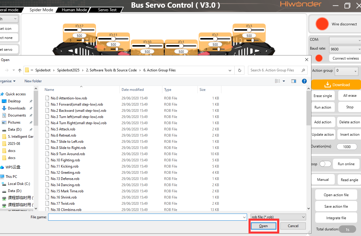

3.2.1 Open Action File
(1) Power on the robot, double-click to launch the PC software, then click “Spider Mode” at the top of the interface.
(2) Once the robot is powered on, the software will automatically attempt to connect. If successful, the upper right corner of the main interface will display “Wire Connect”, and the indicator in the glowy ultrasonic sensor will light up green.

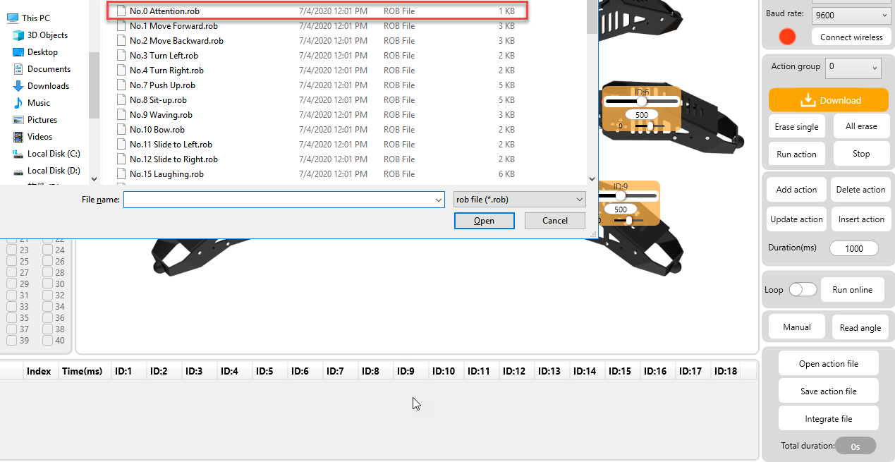

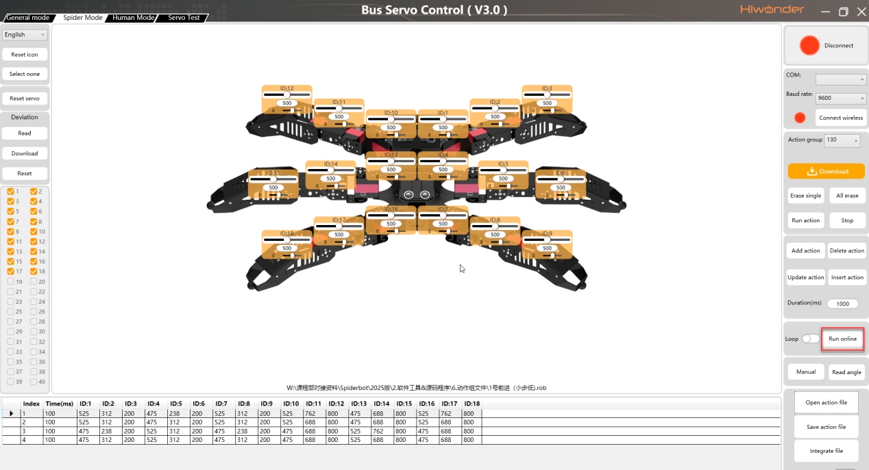

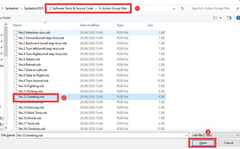

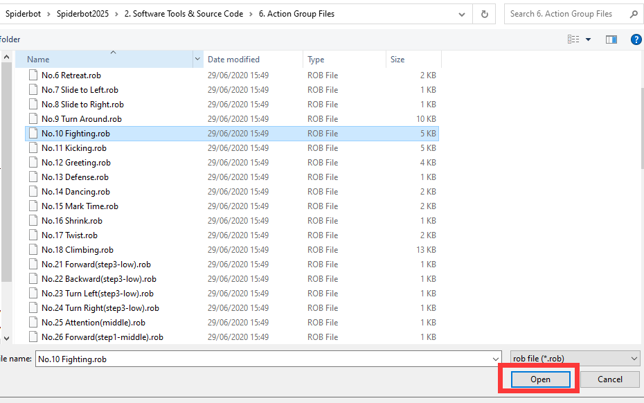

(3) Click “Open action file”.
(4) Navigate to the path: Appendix → Action Group Files, and select the file named “No.12 Greeting”, then click “Open”.
(5) You will now see the loaded file listed in the Action Details List.

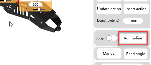

3.2.2 Run the Action Group Online
Click “Run online” to execute the selected action group.

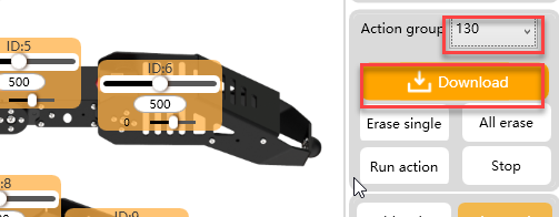

If you want the robot to run this action offline or call it from a program later, you must download the action group to the robot’s controller.

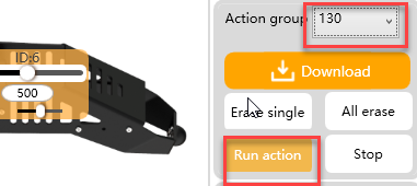

(1) Click the dropdown menu next to the Action Group button to select the Action group number. Note: Some action groups between 0 and 110 are preloaded. To avoid overwriting existing data, select a number greater than 110.
In this example, choose 130 and click Download.
(2) Once the download is complete, a confirmation window will pop up. Click “OK” to close it.
(3) To execute the downloaded action group, select its number and click “Run action”.

(1) Power on the robot and connect it to your computer as instructed in the previous sections. Double-click to launch the PC software, then click “Spider Mode” at the top of the interface.
(2) Click “Open action file” in the Action Group Settings area. Open Action Group 0 located under the path: Appendix → Action Group Files.
(3) With the first action loaded, clicking “Run online” will apply the servo values to the robot.

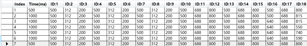

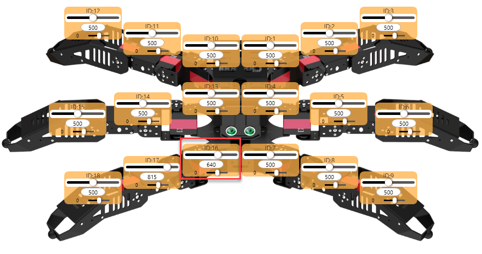

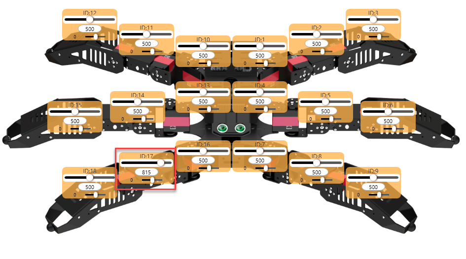

(4) Next, let’s design the second action by raising the robot’s front right leg. According to the servo ID layout, adjust Servo ID 17 by sliding its slider to a value of 815, then click “Add action”.
To adjust the value, hold down the left mouse button and drag the slider. For fine-tuning, quickly click on the left or right side of the slider.
(5) To make the robot rotate its front leg, slightly adjust Servo ID 16 to 640, then click “Add action” to insert it as the third action.

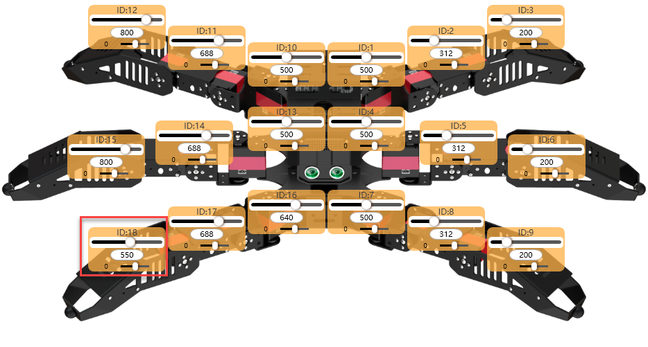

(6) Then, raise the front leg further by setting Servo ID 18 to 550, and add this as the fourth action.

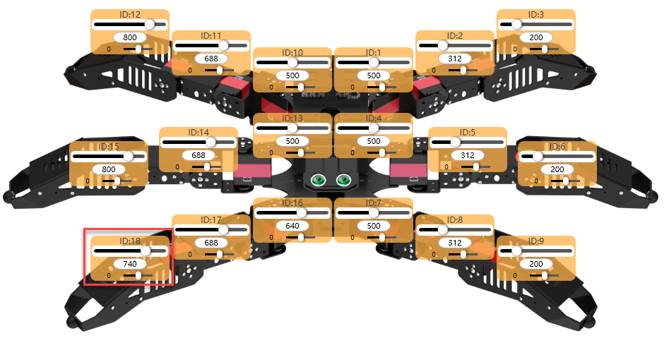

(7) To lower the leg, slide Servo ID 18 to 740, and add this as the fifth action.

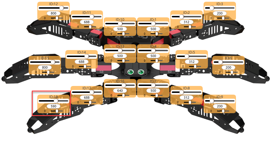

(8) Next, raise the leg again by adjusting Servo ID 18 to 590, and add this as the sixth action.
(9) Finally, set the robot to return to the initial action of Stand at Attention after waving the leg. To copy Action 1, you need to right-click on Action 1, choose Copy, and select Action 6, then right-click to choose Paste Down.
(10) The action group is now complete. The Action Details List records all the servo parameters required for this motion sequence.

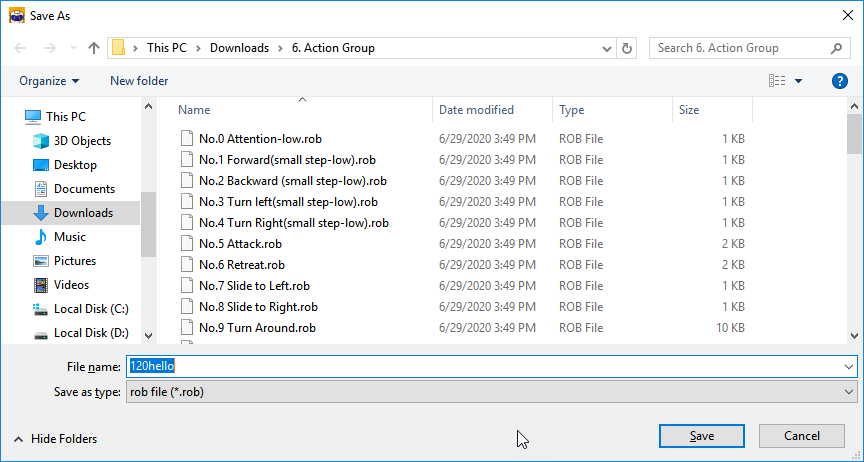

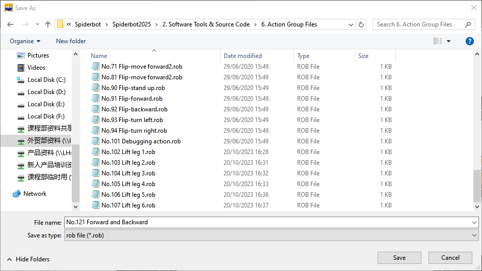

(1) After completing the actions, save them locally for future testing or modification. Click “Save action file”, enter the desired file name and number in the popup window, 120hello in this case, and click “Save”.

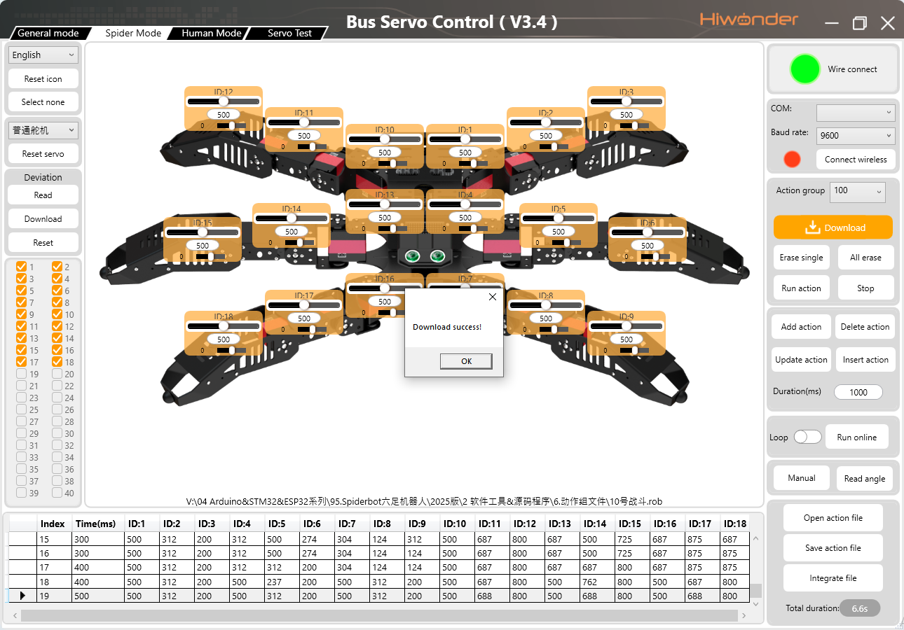

(2) Next, download the saved actions to the corresponding action groups. On the right side of the interface, select action group number 120, then click “Download”.
Once the download is complete, the robot will emit a beep sound, and a dialog box will appear confirming “Download Complete”. Click “OK” to close the dialog.

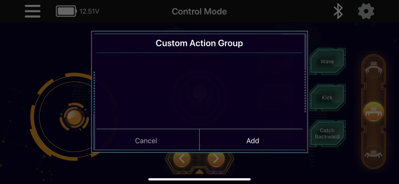

(1) Turn on the robot and launch the app Wonderbot on your phone.
(2) Connect the device following the steps described in 2. Remote Control->2.2 APP Control.

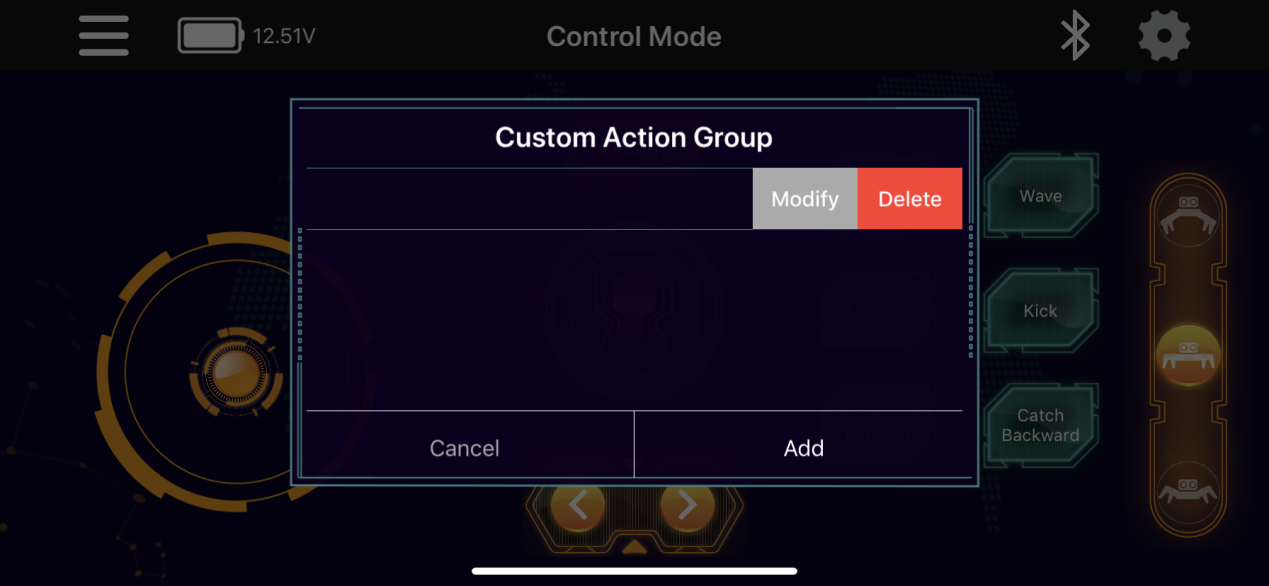

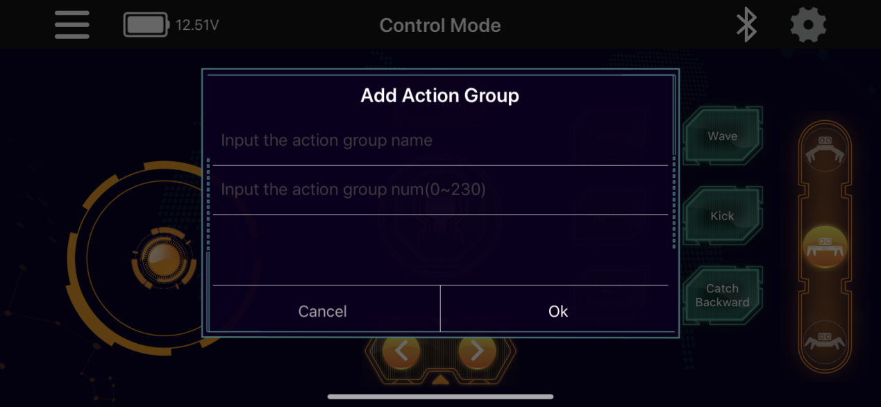

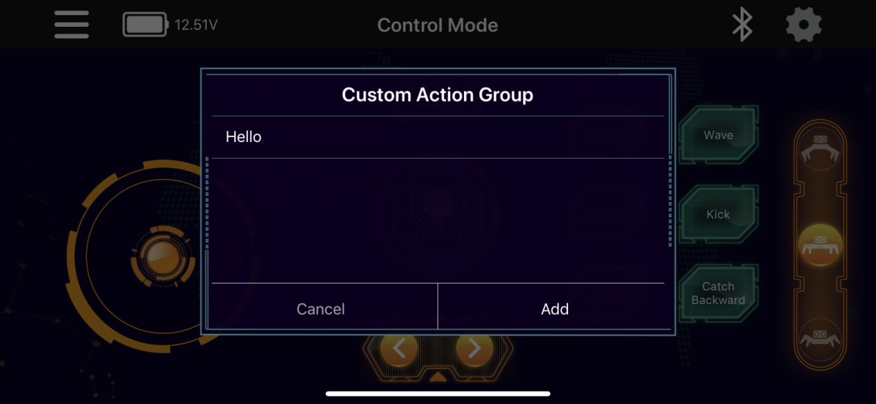

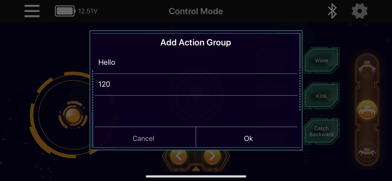

(3) Tap “Custom” in the interface and then tap “Add” in the popup window.
(4) In the form that appears, enter an action group name and action group number.
The name can be anything you like, but the action group number must be entered correctly or the action will not work.
(5) Once added, tap the custom action button to execute the action once.
(6) To delete a custom action, swipe or long-press the action button, then tap “Delete”.

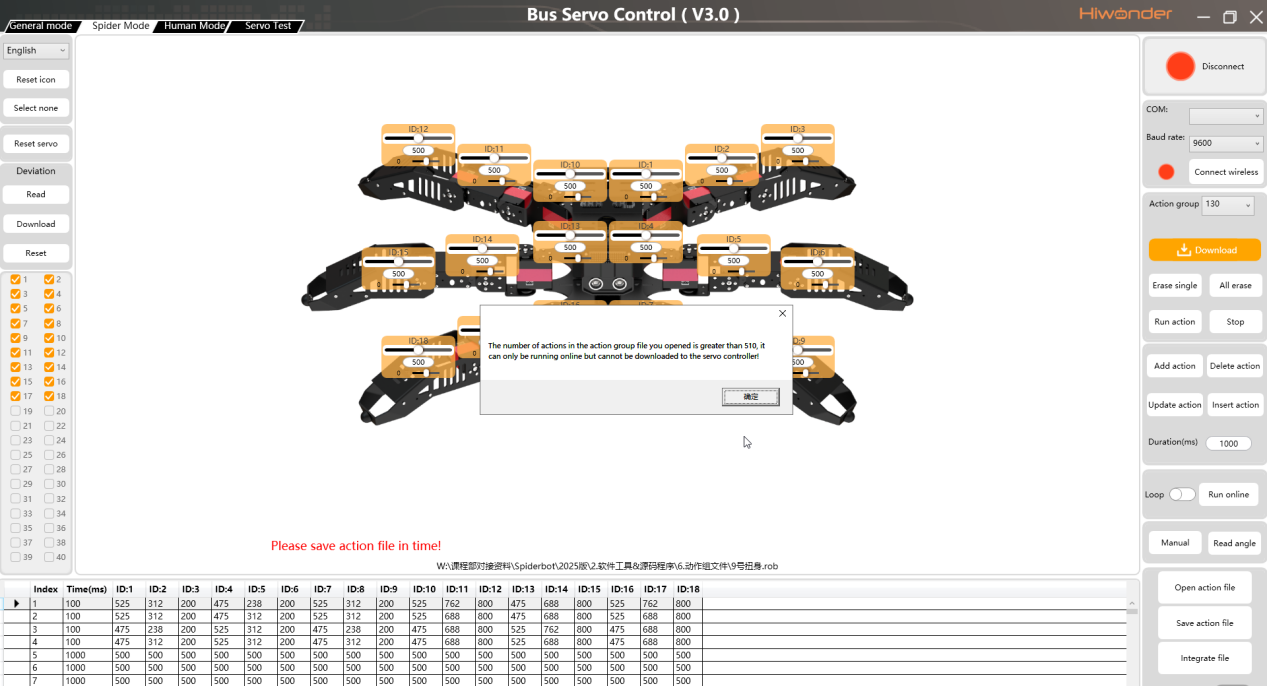

(6) If the total number of actions in the Action Details List exceeds 510, the software will display a warning message. In this case, the action group cannot be downloaded to the controller and can only be run online for testing.

(2) On the right side of the interface, select action group number 100, then click “Download”.
Action Group 100 is designated as the default offline start group. Other group numbers cannot be used to trigger offline execution. For example, downloading to group number 98 will not work.
(3) After the download completes, a confirmation dialog will appear in the control software. Click “OK” to close the dialog.

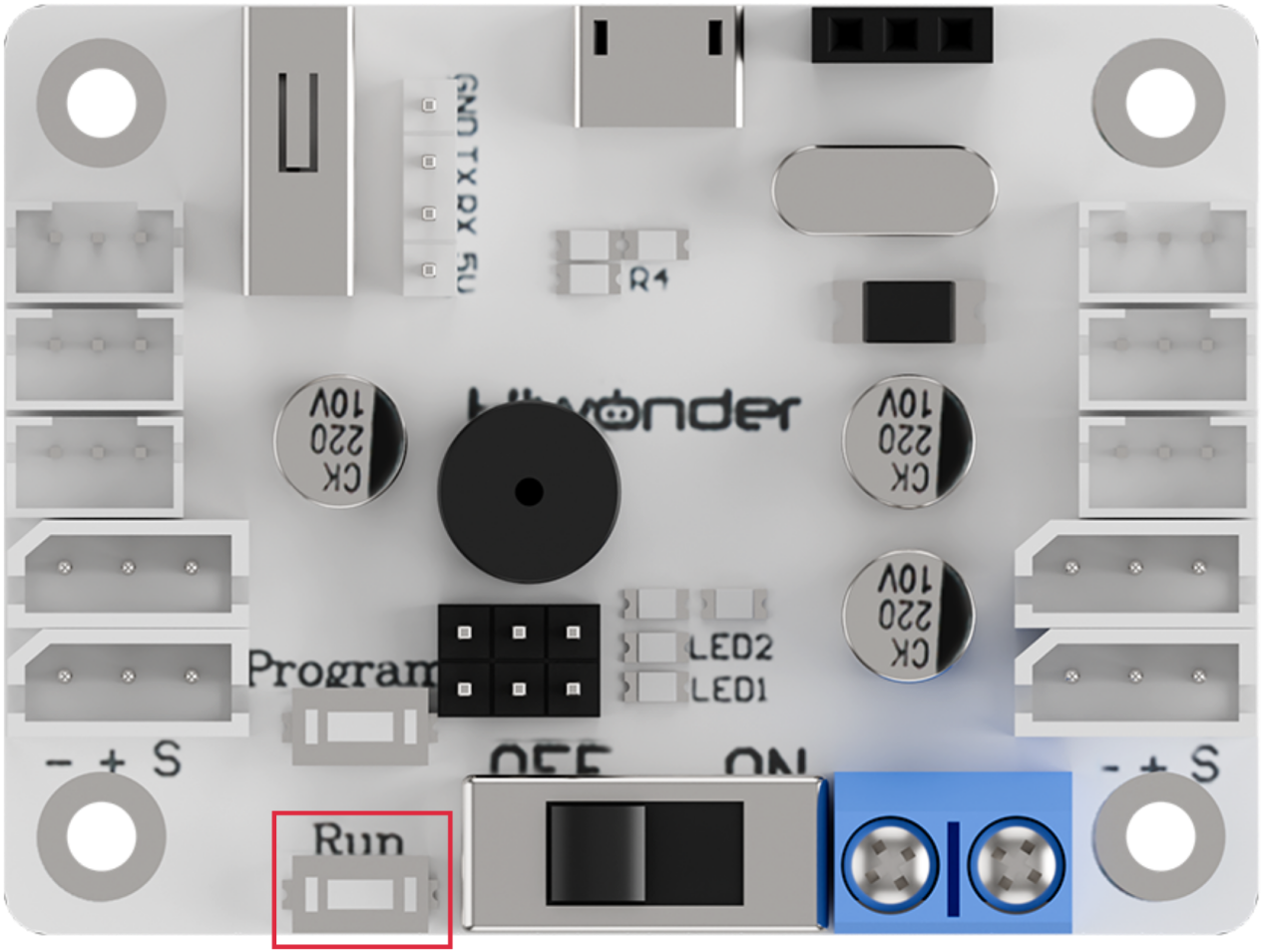

(4) Place the robot on a flat surface and turn on the power switch. Press the “Run” button on the controller briefly to execute Action Group 100 in offline mode.
Press and hold the “Run” button for 3 seconds to enable continuous loop playback of the action group.
