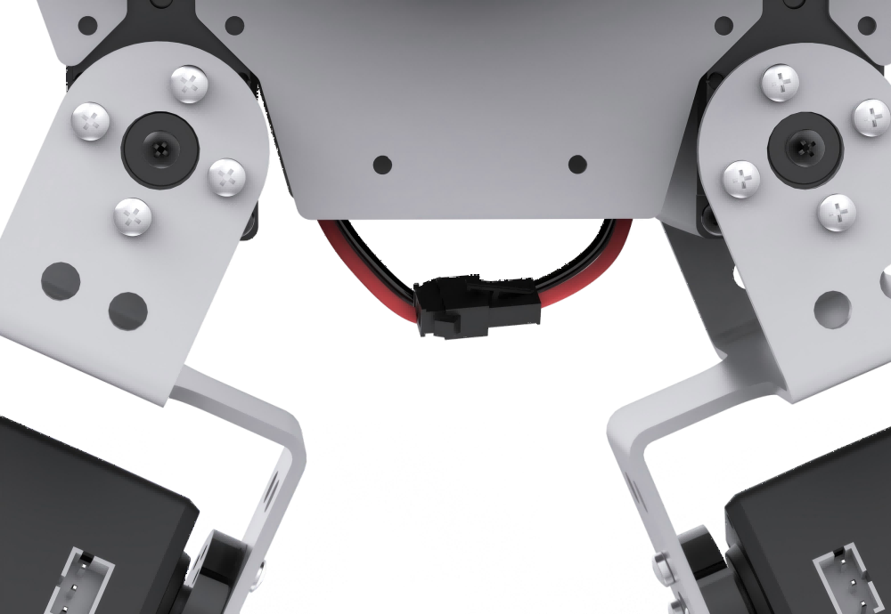

Lithium batteries must be disconnected during transportation. Therefore, users should first connect the battery connector cable upon receiving the robot, then charge it. Only after the charging process is complete can the robot be powered on for the first time.
1.3.1 Charging
Please check whether the connector cable is properly connected before charging. Connect the red wire to red one and the black wire to black before charging.

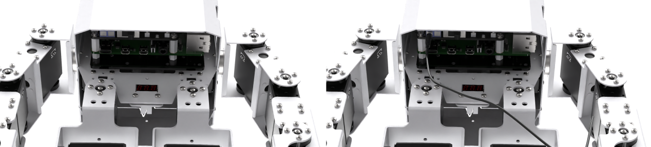

(1) Plug the end of the charger to the hole of the Raspberry Pi expansion board on the back as pictured:

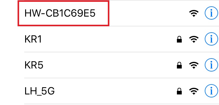

(2) After turning on, Raspberry Pi will emit a “Di” sound and will be in a AP hotspot mode and launch a Wi-Fi hotspot with a network named with the first letters “HW”.

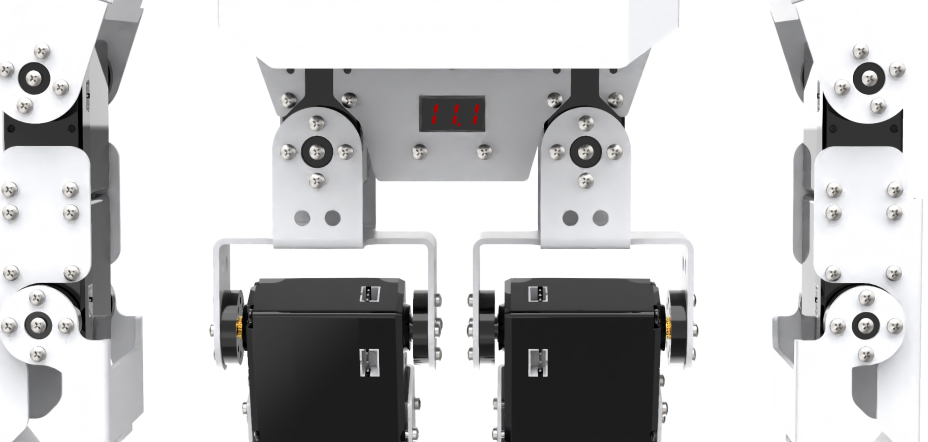

TonyPi is equipped with a voltage display module on its back, allowing users to observe the current battery level of the robot in real time as pictured:
The operating voltage range of TonyPi is 9V to 12.6V. When the battery is fully charged, the voltage display module will show “12.6”. When the current voltage is less than 10V, please recharge the robot promptly.
