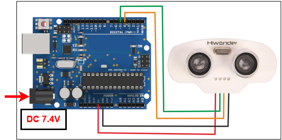

Follow the diagram below to complete the wiring for this section.
  • If the battery is not connected to the cables, do not connect the cable ends directly together. Doing so may cause a short circuit and damage the system.
  • Before powering on, ensure that no metal objects are touching the controller. Otherwise, the exposed pins at the bottom of the board may cause a short circuit and damage the controller.

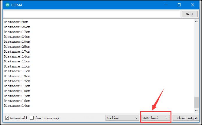

  1. For the Arduino and UNO development board equipped with the expansion board, use a USB cable to connect them to the computer. You can open Arduino IDE, click “File → New,” and import the program located in the same directory as this tutorial.
  2. Remember to select the correct development board and port. The ports shown below are for reference only. Then compile and upload the program.
  1. After the code is uploaded, click to open the serial monitor, set the baud rate to 9600 to observe the output.

The serial monitor displays the distance between the ultrasonic sensor and the obstacle in front, in centimeters.
