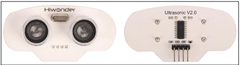

When wiring, connect the ultrasonic module’s positive and negative pins to the Raspberry Pi’s corresponding power pins. Connect the TRIG pin to GPIO22 and the ECHO pin to GPIO24.

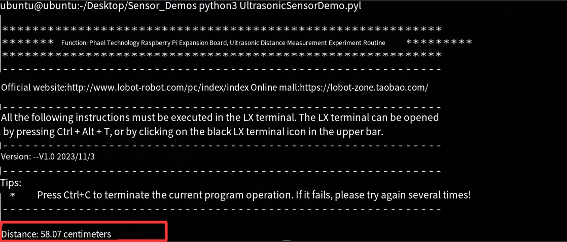

  1. Run the program by entering:
python3 UltrasonicSersorDemo.py
3.2.2 Project Outcome
Place obstacles at varying distances in front of the ultrasonic sensor. The terminal interface will display the distances detected by the sensor in real time.
