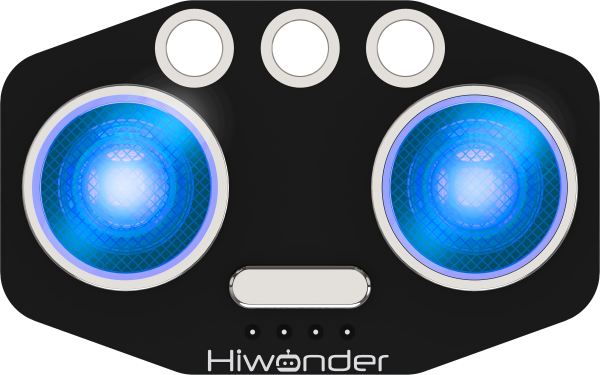

| 5 | Glowy ultrasonic sensor | 1 | ![]() |

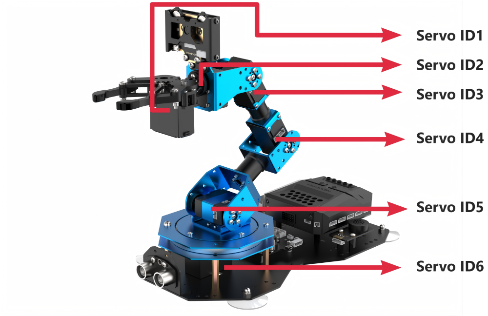

1.3.2 Servo ID Distribution
The distribution of servos on the xArm AI body is as follow:
The key specifications for the servo models used on robot arm are outlined below.

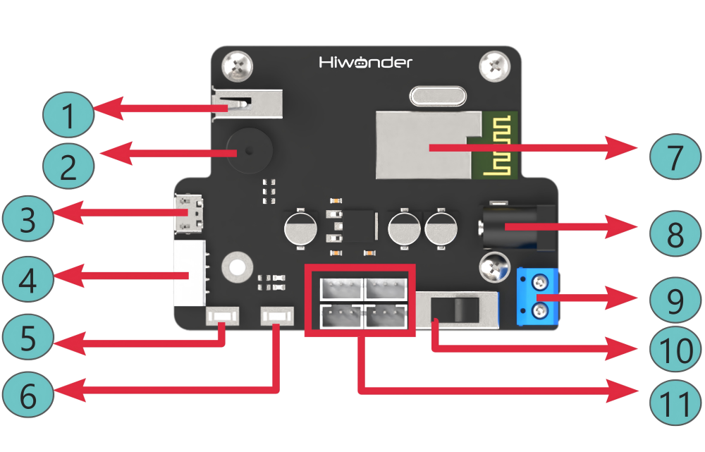

(1) Servo Controller
The xArm AI servo controller adopts the MM32F103CBT6 as its main controller, responsible for driving the servos. It can store action group files and supports offline execution of action groups (Action group No.100 is specially designated for downloading action groups for offline execution). Collaborating with the ESP32 multifunctional expansion board (CoreX controller), it forms a dual-brain architecture, enabling easy and efficient secondary development and function expansion.
| No. | Component Name | No. | Component Name |
| 1 | USB port(for connecting PS2 wireless controller receiver) | 7 | Bluetooth control (for app control) |
| 2 | Buzzer | 8 | 7.5V 6A power adapter port |
| 3 | Micro USB port (connecting to PC) | 9 | Battery port (support 7.4V lithium battery) |
| 4 | Serial port (for communication with ESP32 multifunctional expansion board) | 10 | Power switch |
| 5 | Program button Used for offline action group program) |
11 | Bus servo port |
| 6 | Run button (for executing action group offline) |

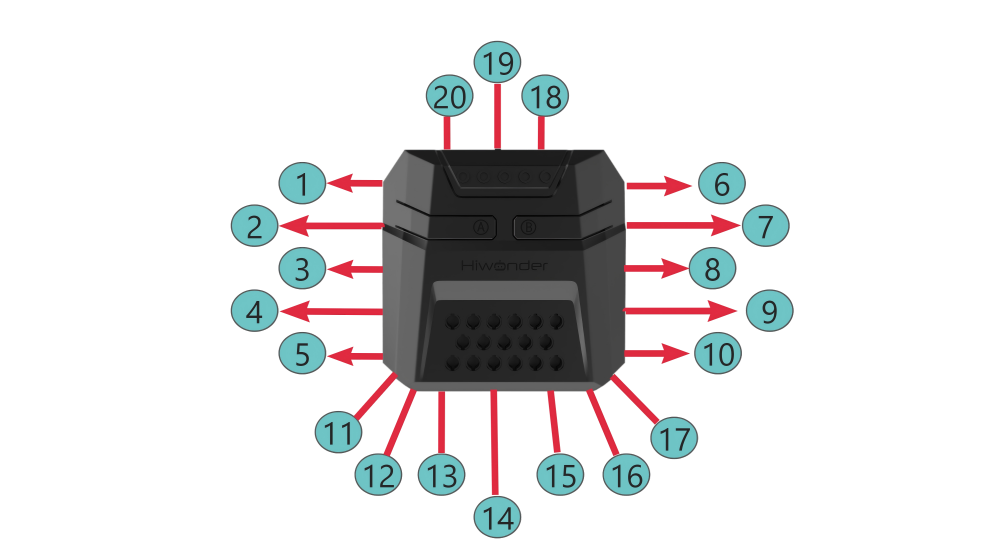

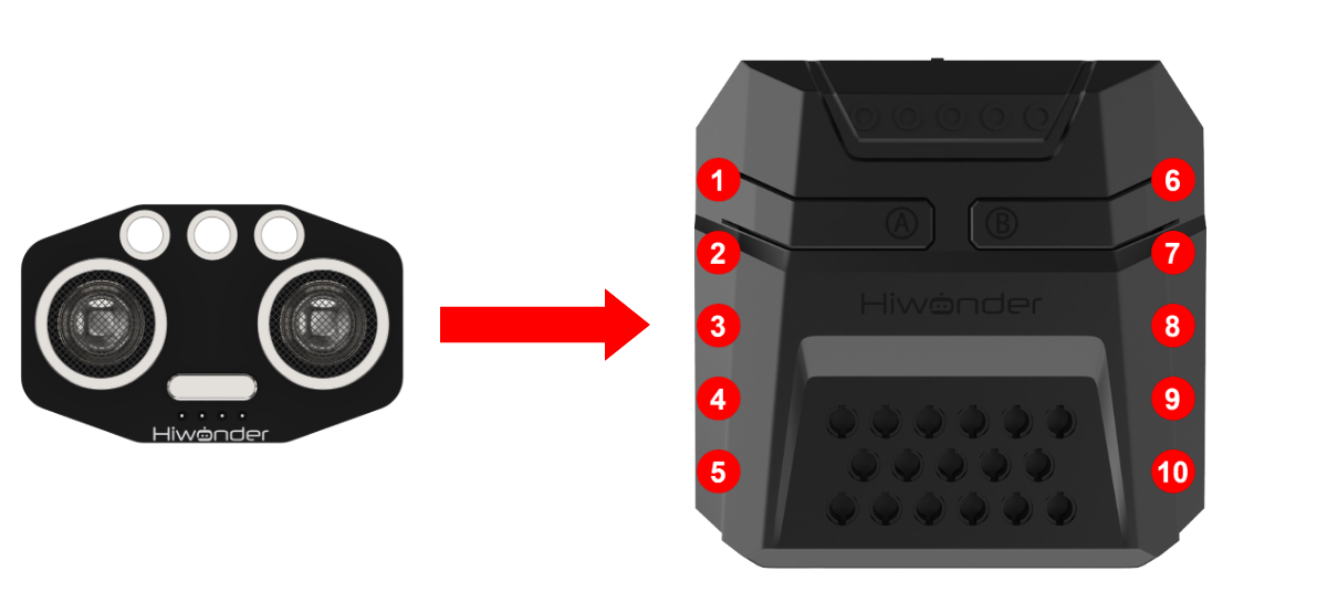

(2) CoreX Controller
The combination of CoreX controller and servo controller is primarily used for secondary development projects. It features onboard PWM servo interfaces, motor interfaces, and programmable buttons. Additionally, it includes built-in RGB lights, a sound sensor, infrared transmitter/receiver, a buzzer, and other electronic modules. Multiple sensor interfaces are reserved, utilizing a unified 4-PIN anti-reverse connector, ensuring strong expandability.
| No. | Function |
| 1、2、6 | Analog signal sensor port |
| 3、4、5、9 | IIC communication port |
| 8 | Digital signal sensor port |
| 7 | Serial communication port |
| 10 | Serial servo port |
| 11、17 | DC motor port |
| 12 | Infrared receiving component |
| 13、15 | Motor port with speed encoder |
| 16 | Infrared emitting component |
| 14 | PWM servo port (from top to bottom, corresponding to "-", " +" and " S") ("S" represents the signal cable, and "-" represents the power negative terminal.) ("+" on servo ports 1 and 2 provides 5V output.) ("+" on servo ports 3, 4, and 5 provides power supply output.) |
| 18 | Power port |
| 19 | Switch |
| 20 | Micro USB port (for uploading code) |

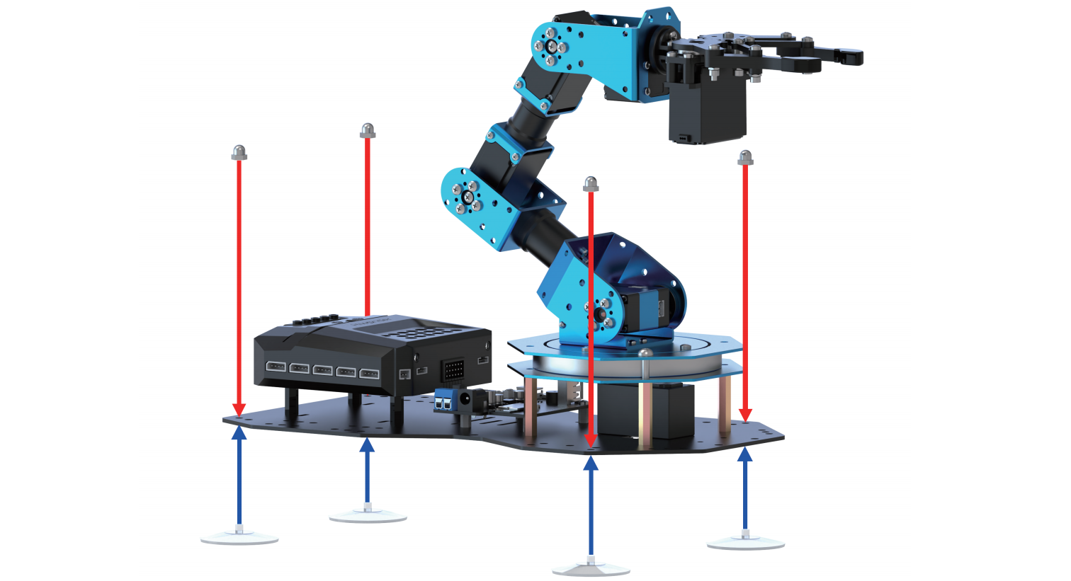

(1) Align the suction cups with the holes on bottom plate, and tighten them clockwise using nuts.
(2) Attach the sensor bracket to the bottom plate using M4-8 screws and M4 nuts, then mount the ultrasonic sensor onto the bracket using M4*6 screws.
(3) Last, use a 300mm 4PIN cable to connect the ultrasonic sensor to the port 4 on CoreX controller.
