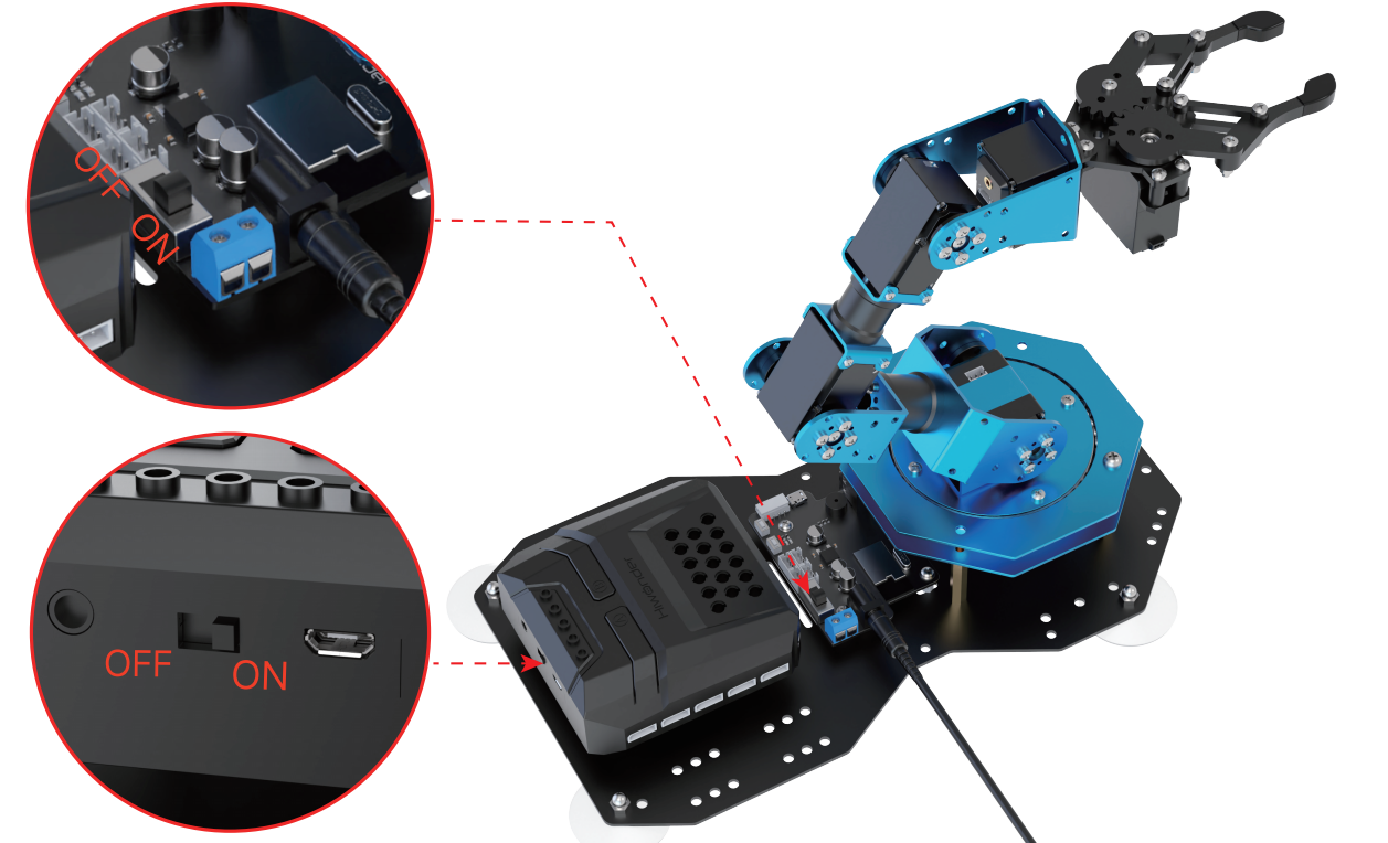

Step 1: Switch on xArm AI robotic arm.

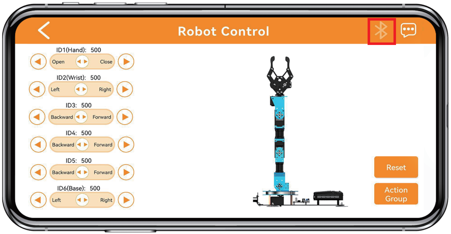

  • Device Connection
  • Please enable the Bluetooth and GPS service before opening the APP.
  • Please pair and connect the device using the Bluetooth button within the app interface. Do not pair it through your phone’s settings using a passkey.
(1) Turn on xArm AI.
(2) Open “Wonderbot” on your mobile. Tap on to select “xArm AI.”
(3) After selecting the robot model, users enter the “Mode Selection” interface and tap “Robot control” function. Click the flashing Bluetooth icon , locate “xArm” in the Bluetooth list for connection.
If “xArm AI” isn’t found in the Bluetooth list at first, please click “research” to search for the device.
(4) Once connected, the Bluetooth icon in the top right corner will stay on.

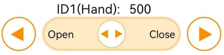

Servo Control Area: users can control the position value of a single servo. Following methods are for your reference:
Drag the central slider to either side to change the servo position value.
Click or press and hold to increase or decrease the servo position value.

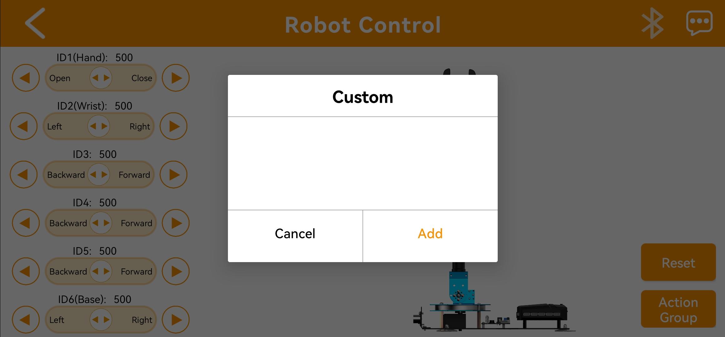

(3) Preset Action Group Invocation Interface
① This interface displays custom action groups. Users can click the “Add” button to create a new custom action group.
The “custom action groups” mentioned here are action groups downloaded into the servo control board. These are not interchangeable with the action groups created by the user through the app in the “My Actions” mode.
② For example, in the image above, assign a new name to the pre-downloaded No.0 action group on the servo control board. Then, click “OK.”
③ Afterward, invoke the No.0 action group in the “Preset Action Group Invocation Interface” using the assigned action group action name.

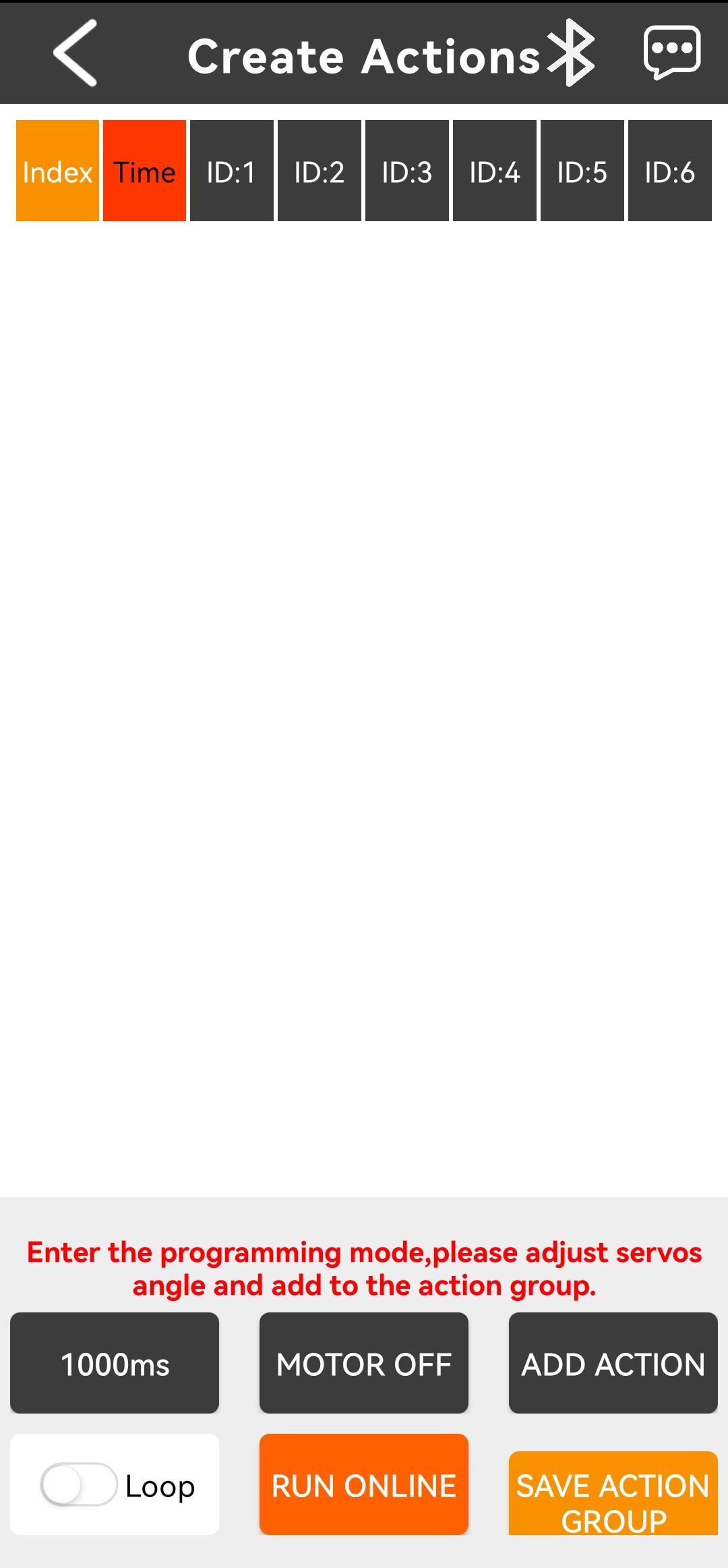

In “Create Acton” Mode, users can create actions by manually rotating the robotic arm, moving each joint to any angle and saving it. Multiple actions can be created and then combined into a sequence, which can be saved as an action group within the app.

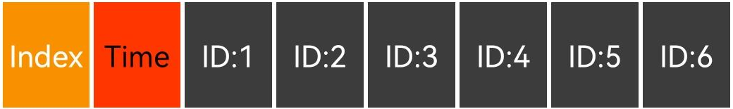

The action group data table is shown on the left. The table header includes:
"Sequence": The action number within the action group.
"Time": The running time of the action.
"ID:X": The corresponding servo position value.
The running time of the next action.
After clicking, the servos lose power and become idle. Only at this point can users manually move the joints of the servos to program the action group.
After clicking, the current posture of the robotic arm (the position values of each servo) will be recorded as a new action.

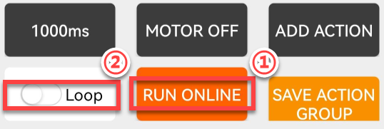

After clicking, if you click "Run Online", the robotic arm will repeatedly execute the action group (all the actions in the list).
Click it to run the action group once.If the "Loop" switch is turned on, the action group will repeatedly execute the actions in the list.
Combine the actions in the current list into a single action group file and save it locally within the app.

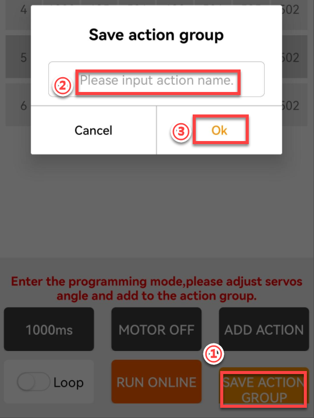

Action Group Creation Steps:

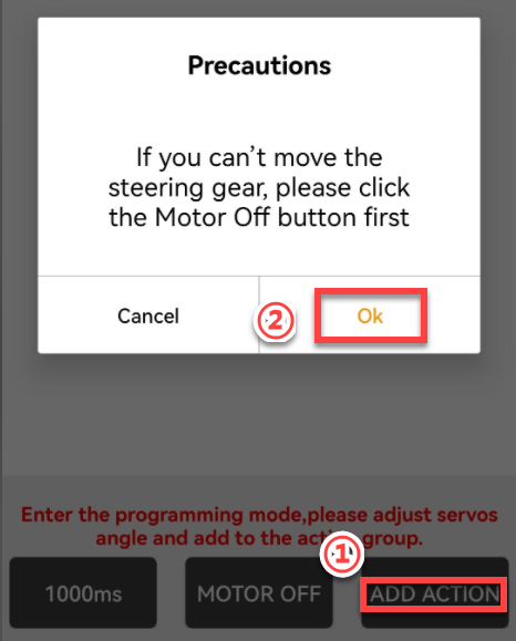

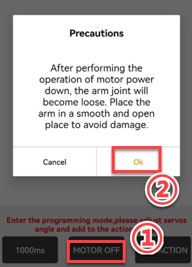

(1) Click “Motor Off,” then click “OK” to power off the servos.
The robotic arm cannot be manually moved for action group programming until this step is completed.

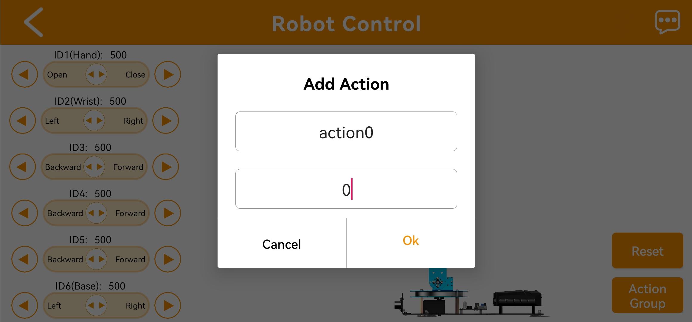

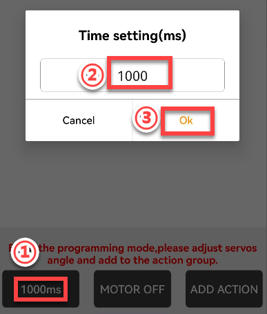

(2) Click the icon next to “1000ms” to confirm the execution time (in ms) for the new action. Enter the time in the pop-up window, then click “OK”.
(3) Users can move the robotic arm to any desired posture. After positioning, click “Add Action.” The software will read the current position values of each servo and save them as a new action. The new action will automatically be added to the last row of the current list.

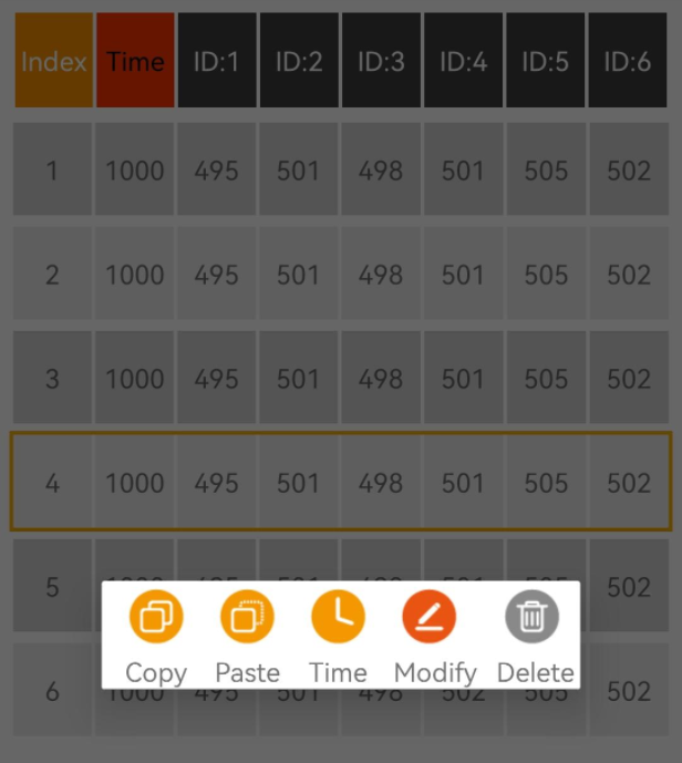

(4) (Optional) If the user wants to modify a previously created action in the action group list, simply long-press on the action in the list. A modification options pop-up will appear automatically, as shown in the image below:
Icon Function
Copy the position values of each servo and the execution time of the selected action to the clipboard.
Overwrite the position values of each servo and the execution time in the selected action with the values copied from other actions in the clipboard.
Redefine the running time of the selected action.
After clicking, follow the instructions in the pop-up window. Move the robotic arm to the desired posture manually, then click "OK." The software will read the current position values of each servo and overwrite the selected action with these values.
Remove the current action from the action group list.

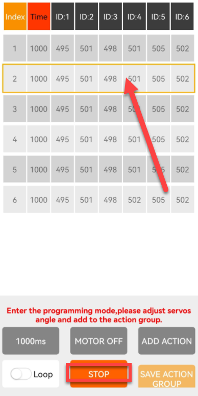

(5) (Optional) After all the actions in the action group are created, users can have the robotic arm execute the actions again to evaluate the results.
Step1 : Execute a specific action in the action group: Click on the action in the list, and the servos on the robotic arm will move to the specified positions within the time defined for that action.
Step2 : Execute the entire action group: Click “Run Online” (see the image below at position ①), and the robotic arm will run the entire action group once. To loop the action group, first turn on the “Loop” switch (see position ② in the image below), then click “Loop” again, and the robotic arm will repeatedly execute the action group.
During the execution of the action group, as shown in the image below, the action highlighted in the yellow box within the arrow indicates the current action being executed by the robotic arm. You can click “Stop” to interrupt the execution of the action group.
(6) Click the “Save Action Group” icon. In the pop-up window, name the action group and click “OK” to complete the entire process of creating the action group.
The saved action group can be viewed in the “My Actions” mode, as explained below.

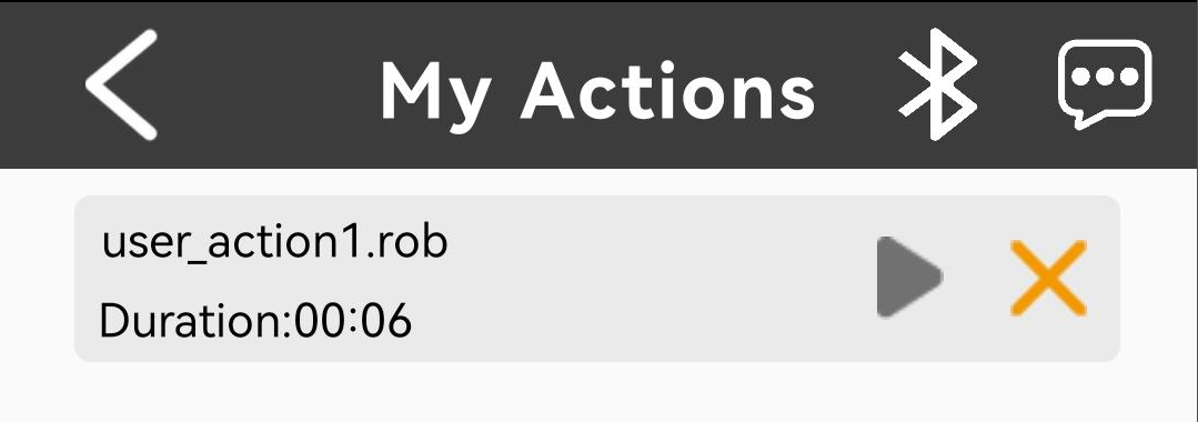

  • My Action
In “My Actions” mode, users can find the action groups previously created in “Create Action” mode and edit them accordingly.

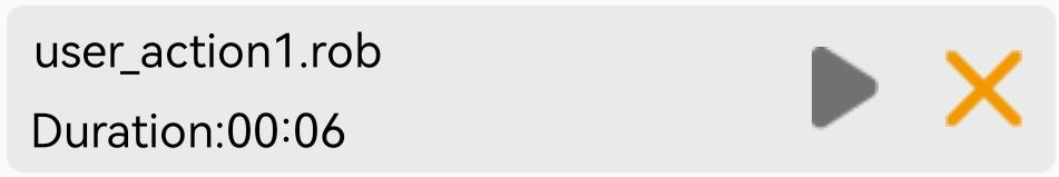

For example, using the “Create Action Group 1” icon:

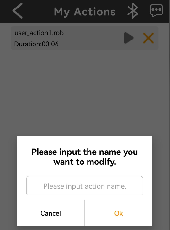

(1) “Duration” refers to the total time required for the action group to execute all actions. Click to execute the action group once; click to delete the current action group.
(2) Long press the action group icon to bring up the following pop-up window:
(3) In the pop-up window, you can modify the name of the action group.
