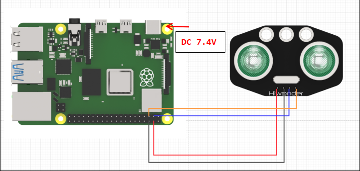

3.1.1 Wiring Instructions
When connecting the wires, make sure the 5V, GND, SDA, and SCL pins of the illuminated ultrasonic module are connected to the corresponding pins on the Raspberry Pi.
  • If using our lithium battery, connect the battery adapter wires to the DC port with red to+and black to-.
  • If the adapter wires are not connected to a lithium battery, do not connect them directly to the battery wires, to avoid short circuits caused by reversing the positive and negative poles.
  • Before powering on, ensure that no metal objects touch the main board, as contact with the pins on the underside may cause a short circuit and permanently damage the board.
