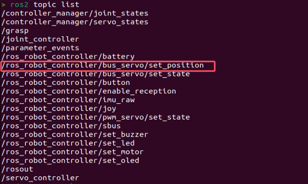

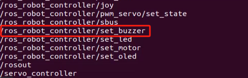

(3) Open a new terminal and run the command to display the topics published after the initiation of the robot arm node.
ros2 topic list
  • Program outcome

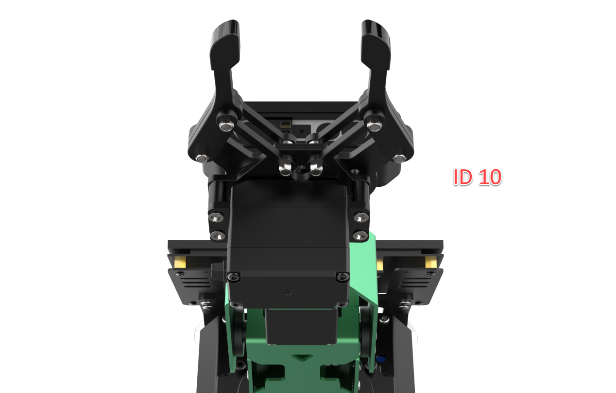

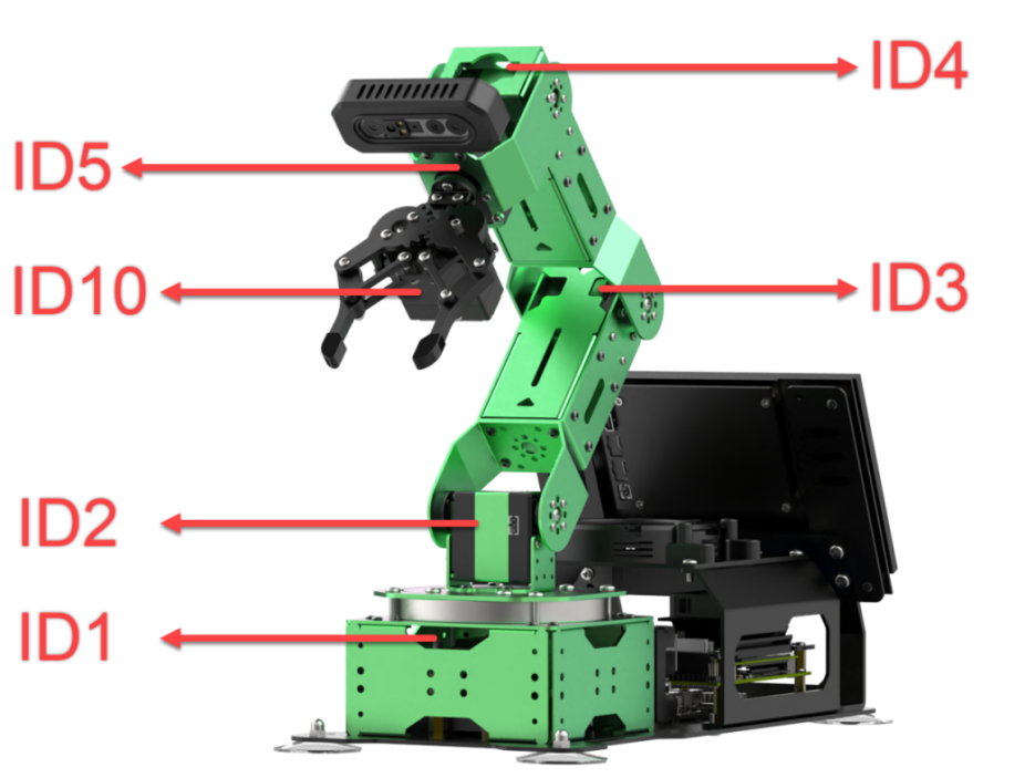

servo_id: The ID of the servo motor, which can be 1–5 or 10.
position: The angle of the servo motor, with a valid range of 0–1000 pulses.
For example, this configuration sets Servo 1 to rotate to a position of 700 pulses.

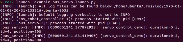

(3) After starting the example, you will see the robotic arm’s Servo 4 rotating back and forth between angles 200 and 500, and the terminal will display the servo topic information.

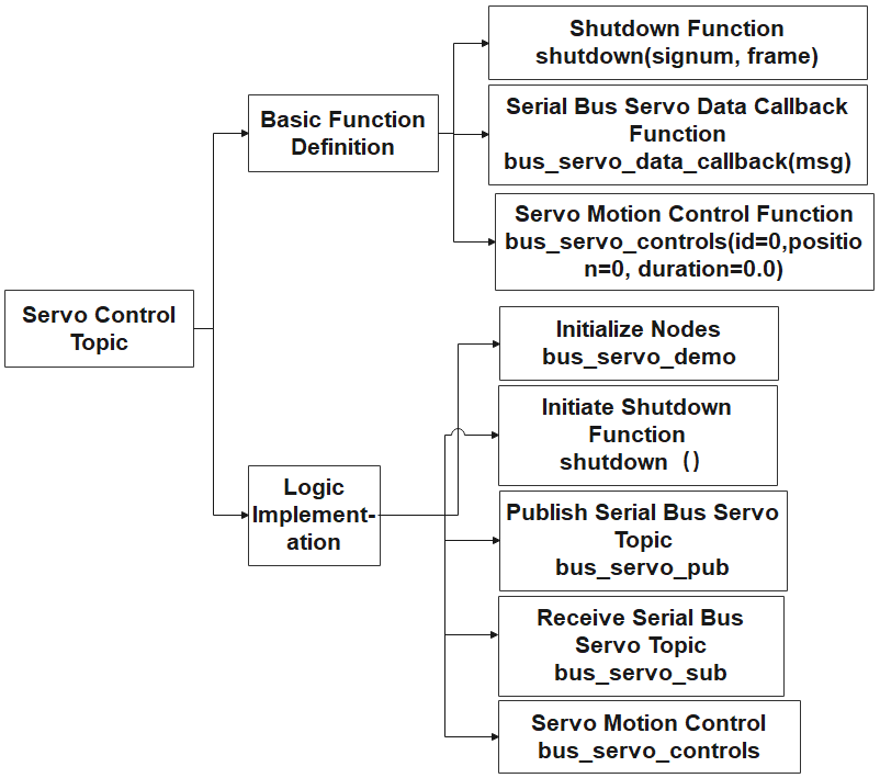

The program logic flowchart is as below:
The diagram above illustrates the main structure of the program’s logic flow, highlighting the division into basic function definitions and implementation logic. Initially, the necessary functions for servo control are established. In the main function, nodes are initialized, interrupt functions are activated to detect signals, and relevant bus servo topics are both published and received. This information is then relayed to the servo control function, enabling effective servo control. The upcoming document will follow the structure outlined in the program’s logic flowchart above.

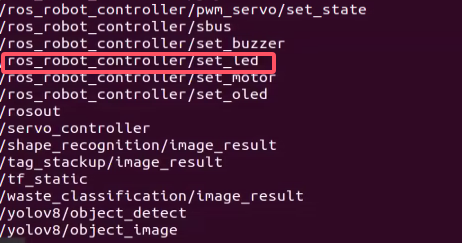

rostopic list
Topic Function
/jetarm_sdk/set_led Control LED to turn on or off

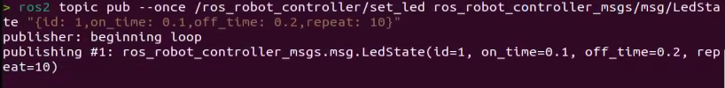

(1) Open a new terminal, and execute the following command.
ros2 topic pub --once /ros_robot_controller/set_led ros_robot_controller_msgs/msg/LedState "{id: 1,on_time: 0.1,off_time: 0.2,repeat: 10}"
The following four parameters can be obtained:
brightness: LED ID. The ID of the LED on the STM32 controller is 1.
on_ticks: The duration of LED illumination, measured in milliseconds.
0ff_ticks: the duration of LED off time, measured in milliseconds.
repeat: the cycle number of LED on and off.
(2) After the parameters are set, hit Enter key to run the program.
(3) When the program completes running, press ‘Ctrl+C’ to exit. If the program cannot be stopped, you may need to retry.

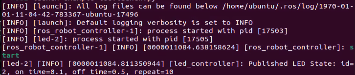

(2) Run the command to initiate the game. The LED on STM32 controller will flicker ten times then go off. The following parameter settings will be printed on the terminal.
python3 ~/ros2_ws/src/example/example/simple/include/led_node.py

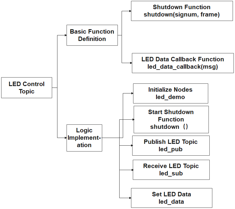

The program’s logic flow, as illustrated above, is mainly categorized into basic function definitions and implementation logic. Initially, the functions required for LED control are defined. Subsequently, within the main function, nodes are initialized, interrupt functions are activated to detect interrupt signals, and relevant topics for the LED are both published and received. The control of the LED is accomplished by configuring parameters related to LED information. The forthcoming document will adhere to the program’s logic flowchart outlined above.

③ Publish the LED state information.
    def publish_led_state(self):
        msg = LedState()
        msg.id = 2
        msg.on_time = 0.1
        msg.off_time = 0.5
        msg.repeat = 10
        self.publisher.publish(msg)
        self.get_logger().info(f'Published LED State: id={msg.id}, on_time={msg.on_time}, off_time={msg.off_time}, repeat={msg.repeat}')
This function creates and sets the LedState message, which includes the following fields:
id: The LED’s ID, set to 2.
on_time: The duration the LED stays on, set to 0.1 seconds.
off_time: The duration the LED stays off, set to 0.5 seconds.
repeat: The number of times the LED blinks, set to 10.
The message is then published using self.publisher.publish(msg), and the message content is logged. The LED parameters are set to make the LED blink.
ros2 topic list
Topic Function
/ros_robot_controller/set_buzzer Control buzzer to turn on or off

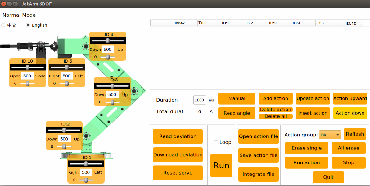

This section will introduce the interface and functions of the JetArm upper computer PC software.

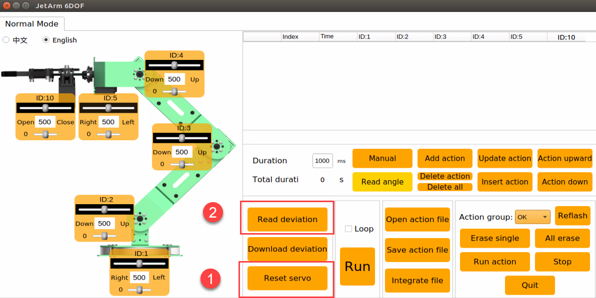

  • Open PC Software through Icon
Double-click on the robot system desktop to open the PC software.
  • Open PC Software through Command
(1) Open a new terminal, and execute the command to navigate to the directory.
cd factory_utils/arm_pc/
(2) Run the command to open the PC software.
python3 main.py

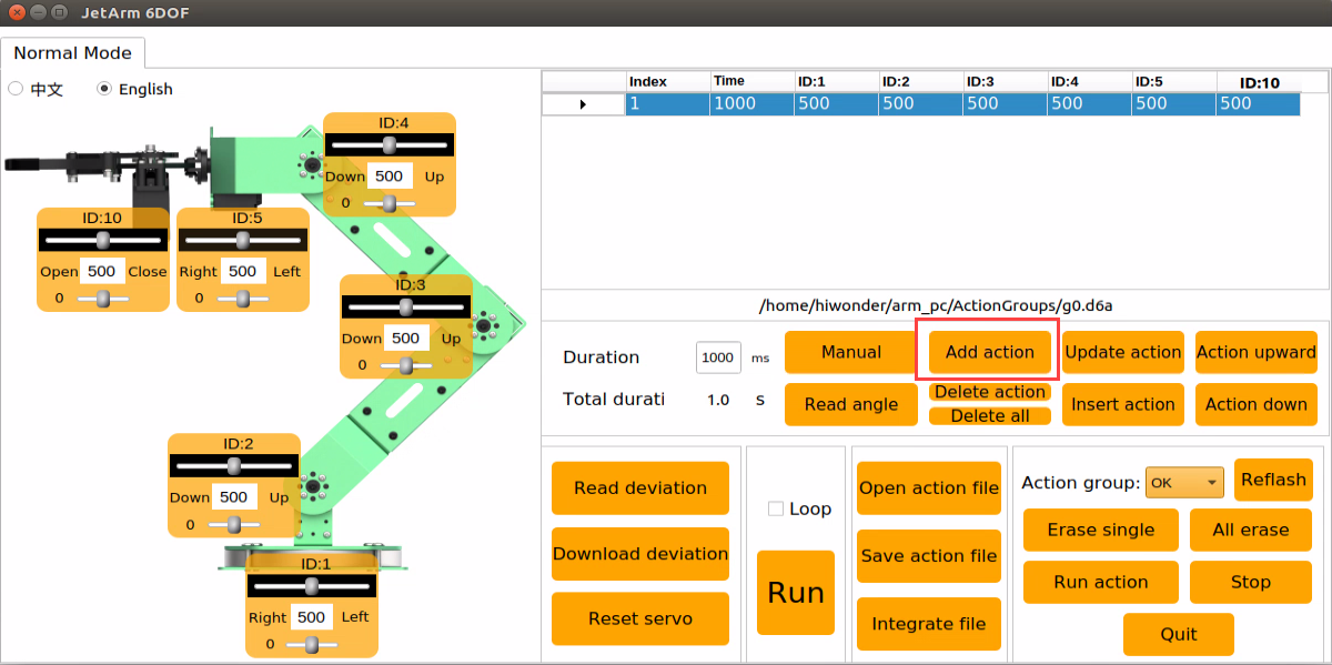

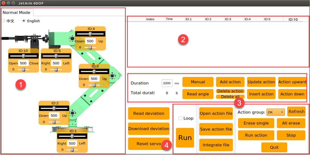

  • Introduction to PC Software Interface

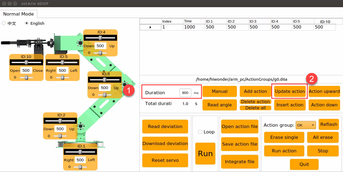

The interface of the PC software is divided into 4 areas:
①: Servo control zone
②: Action list
③: Action group setting zone
④: Deviation setting zone
The introduction to each section’s function within the PC software is outlined as follows:

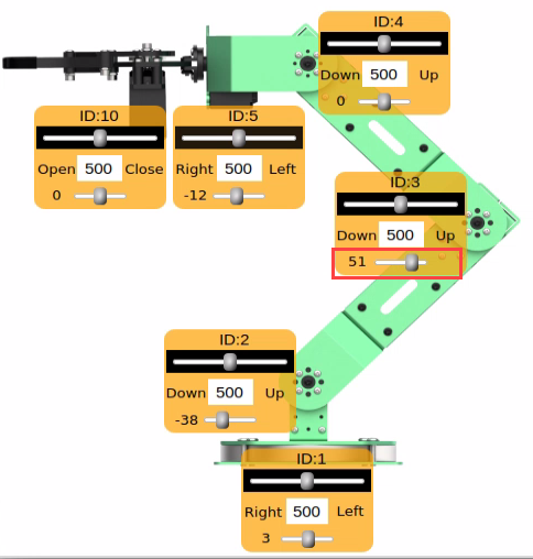

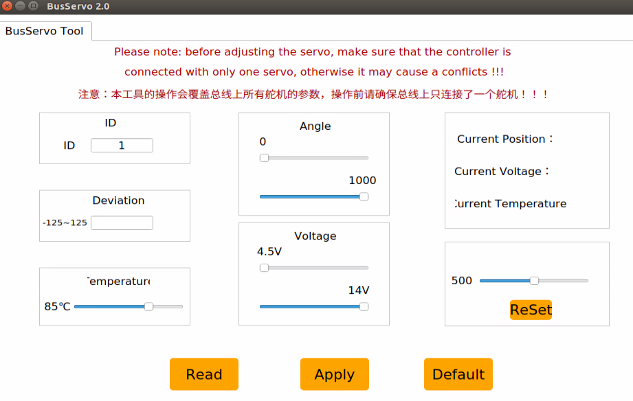

①: Servo Control Zone
In this zone, you can change the servo’s position through dragging the sliders.
Icon Function
Servo ID
Adjust servo's position. The minimum value is 0, and the maximum value is 1000.
Adjust the servo deviation. The minimum value is -125, and the maximum value is 125.

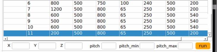

②: Action List
The action list include the information, such as action group NO., duration and location of each servo.
Icon Function
Action group NO.
The duration of the execution of the action group, measured in millisecond
Corresponding servo position value. You can directly double click the value to modify
③: Action Group Setting Zone
In action group setting zone, you can add, delete, update, insert, run, open and integrate the action group.
Icon Function
The time required for executing each action group. You can directly click for modifications
The time required for executing all action groups
Upon clicking this icon, the robot servo will deactivate, causing the joints to loosen. Subsequently, you can manually design the robot's actions by dragging the servo
Retrieve the manually set servo position. This function should be utilized in conjunction with the 'Manual' icon
Append the current servo value, configured in the servo control area, to the bottom of the action list to create a new action
Delete action: Delete the selected action in the action list
Delete all: Delete all actions in the action list
Replace the selected servo parameter in the action list with the current value set in the servo control zone. Additionally, substitute the Time with the corresponding value set in the
Insert one action above the selected action in the action list. The value of inserted action is the same as that set in servo control area. And the Time is the same as
Move the selected action to the previous line
Move the selected action to the next line
Execute the actions in the action list once. If "Loop" is selected, the actions will run in a continuous loop
Open the necessary action group file and load its data into the action list. Save action group files in the following directory: /home/hiwonder/arm_pc/ActionGroups
Save the actions in the action list to the designated path: /home/hiwonder/arm_pc/ActionGrourps
First, click to open an action group, and then use to open another action group. Subsequently, integrate the two action groups
Display the action groups saved in PC software
Refresh the selected action group
Delete the selected action group file
() Delete all the action group files
Execute the selected action group once
Stop running action group
Exit the PC software

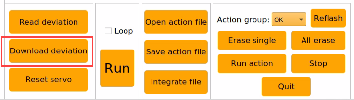

④: Deviation Setting Zone (Optional: This area is for informational purposes. As the robot’s deviation has been corrected before delivery, manual deviation adjustment is unnecessary if the robot is functioning properly. For more information on deviation adjustment, please refer to ‘4.4 Deviation Adjustment’).
Icon Function

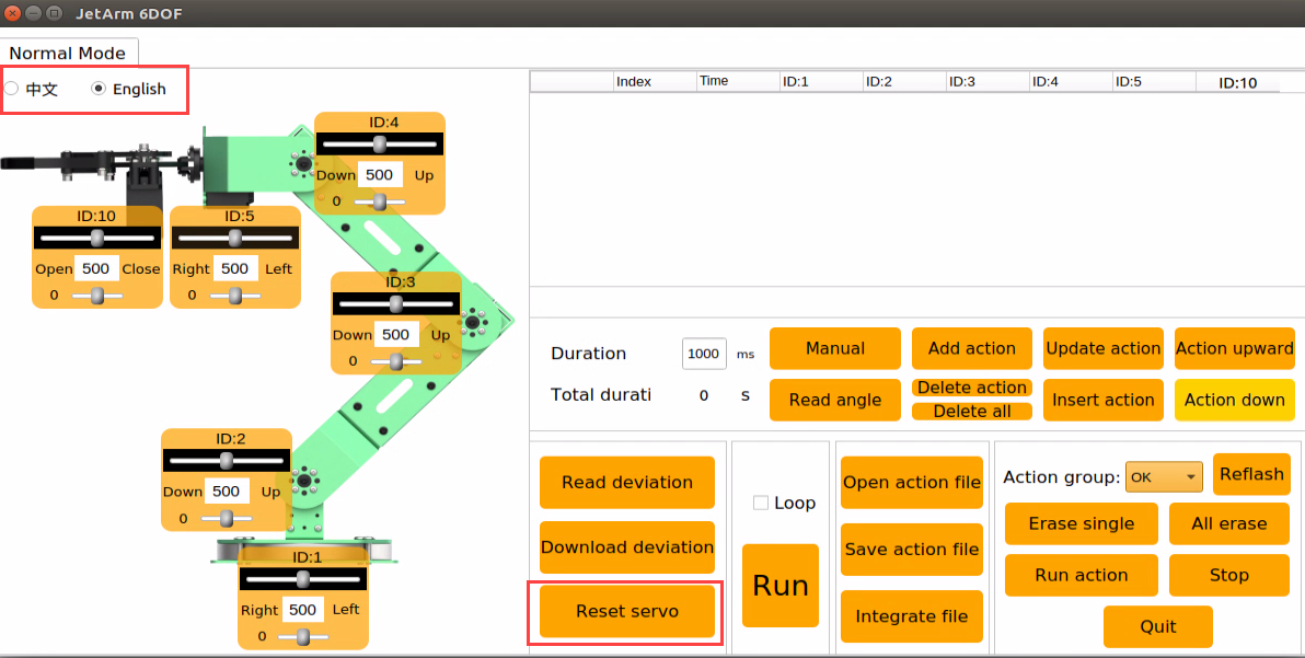

Read the saved deviation vale
Download the adjusted deviation to the robot
Reset all servos' position to 500

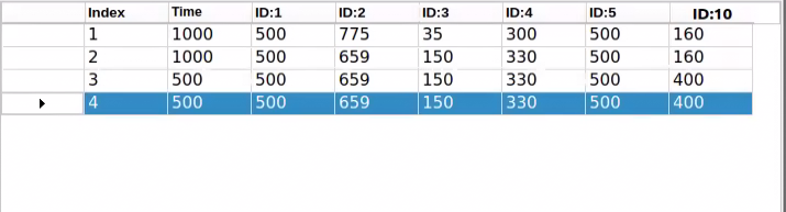

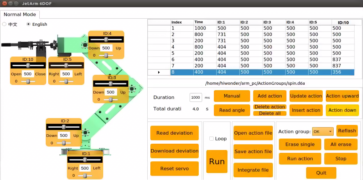

10.4.2 Editing & Calling Action
  • Action Editing
Click-on on the robot system desktop to open the PC software.

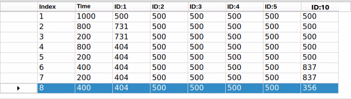

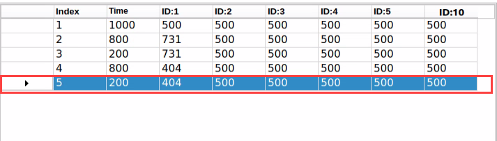

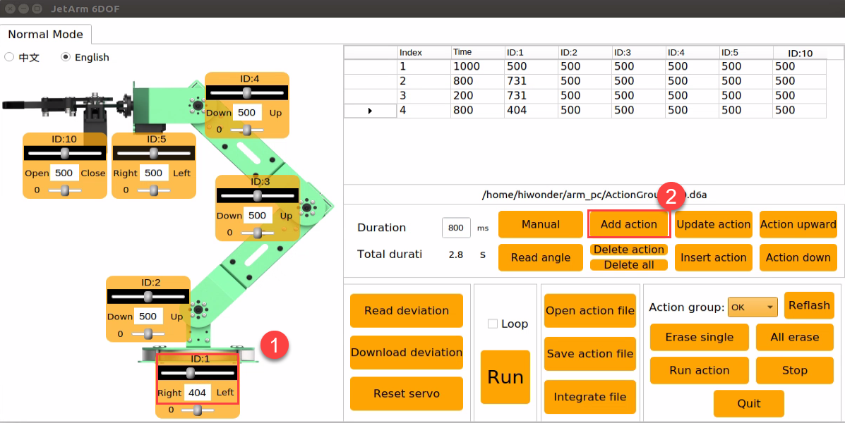

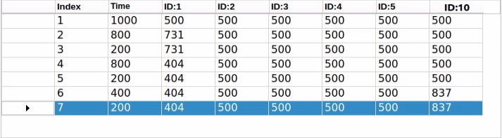

Step 1: Click-on the ‘Reset Servo’ button to reset the robot arm’s pose. Next, adjust the sliders to set the servo values as shown in the picture below. Once done, click on ‘Add Action’ to include this action in the action list.
Step 2: Set the duration to 800ms, then click on the ‘Update Action’ button to synchronize the time.
Step 3: configure the ID1 servo to enable the robot arm to rotate left. Then click-on ‘Add Action’ button to add this action to the action list. The duration remains the same, 800ms.
Step 4: Add a transitional action. Select NO.2 action and set the duration to 200ms, then click-on ‘Add Action’.
Step 5: Enable the robot arm to move to the right by adjusting the slider for the ID1 servo as shown below. Set the time to 800ms and then click on the ‘Add Action’ icon.
Step 6: Add a transitional action. Select NO.4 action, set the duration to 200ms, then click-on ‘Add Action’ button.

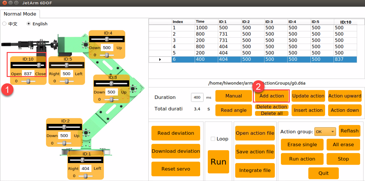

Step 7: Control the gripper to close and open. Adjust the value of NO.10 servo, set the duration to 400ms, and click-on ‘Add Action’ button.
Step 8: Add a transitional action. Set the duration to 200ms, and click-on ‘Add Action’ icon.
Step 9: Adjust the servo values as the picture below shown to adjust the gripper.

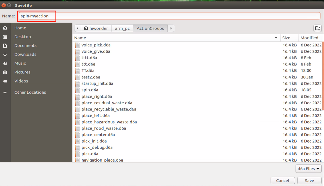

  • Saving Action
For ease of later debugging and management, you can save the action file. Click-on the ‘Save Action File’ button and select this folder ‘/home/ubuntu/arm_pc/ActionGrourps,’. After naming the action file, click-on ‘Save’ button.

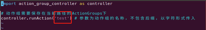

(1) Open a new command-line terminal, and execute the following command to navigate to the directory containing source code.
cd arm_p
(2) Execute the command to open the source code file.
vim control_demo.py
(3) Enter the action group name within the single quotation marks. Note: The program can only access the action group files saved in the ‘ActionGroups’ folder. The name entered within the single quotation marks should not include the suffix.
(4) Execute the command to run the program, and invoke the set action groups.
python3 control_demo.py

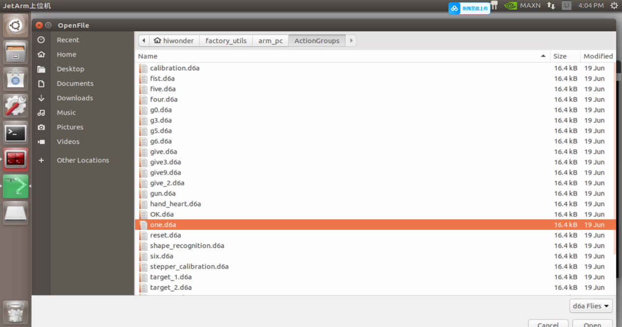

10.4.3 Integrate Action Groups
Step 1: Access the robot system desktop, and open JetArm PC software.

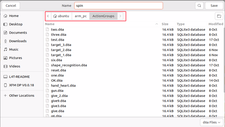

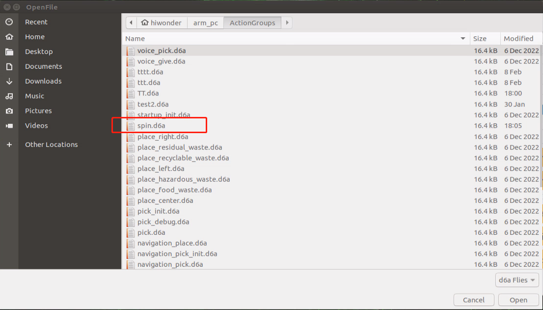

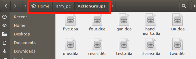

Step 2: click-on ‘Integrate File’ button to navigate to the folder ‘/home/ubuntu/arm_pc/ActionGrourps’, and double-click ‘spin.d6a’ to open it.
Step 3: the selected action will be added to the action list.
Step 4: click-on ‘Integrate File’ icon, and double-click ‘myaction.d6a’ to open. Then, these two action files are integrated into one.
Step 5: click-on NO.1 action, then click-on ‘Run’ button to enable the robot arm perform the integrated action.
Step 6: Click the ‘Save Action File’ button to save the combined action group for easier debugging in the future.

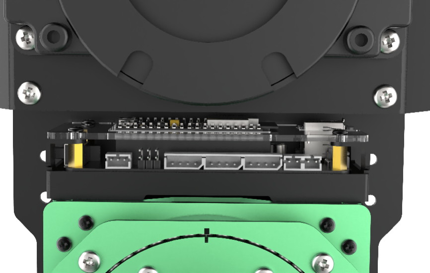

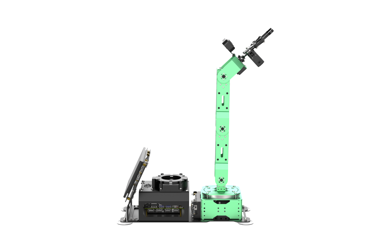

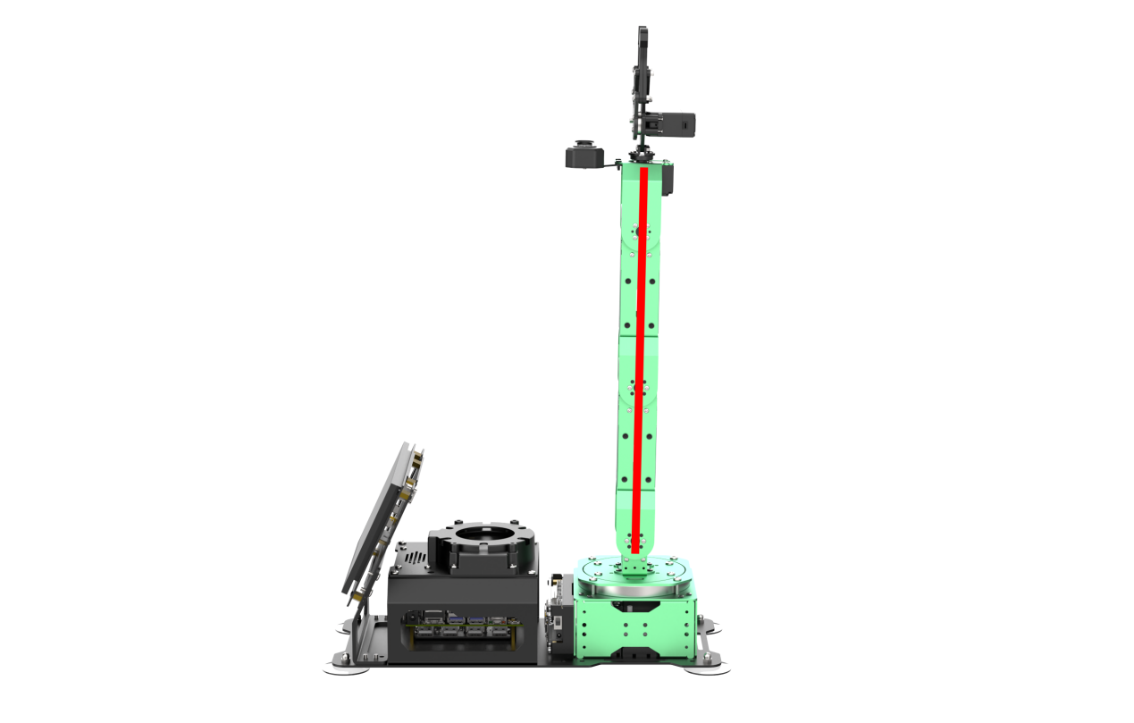

  • Judging Deviation
(1) Click-on on the robot system desktop to open the PC software.
(2) Click-on ‘Reset Servo’ to reset the robot arm’s pose.
(3) After the robot arm resets servo, the main shaft screws of robotic arm servos 2 to 4 align in a straight line, as illustrated in the diagram below:
(4) The marking on the pan-tilt should align with the marking on the metal shell.

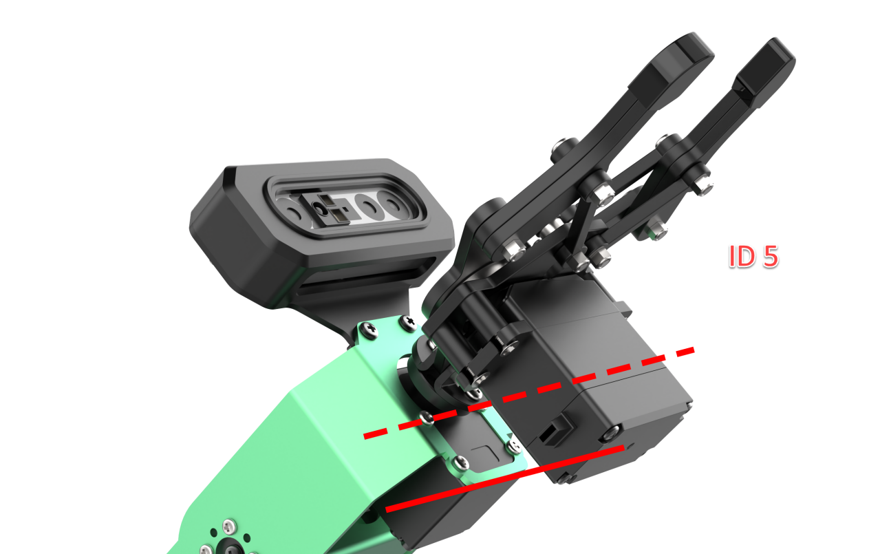

(5) If the metal casing above servo 5 and the camera casing display parallel lines, and the gripper is slightly open, as illustrated in the diagram on the right below, it means that the robotic arm does not need deviation adjustment. Feel free to proceed to the next section.
(6) If the angle between the servo and the centerline is less than 30° (taking NO.3 servo as an example), it falls into the category of minor deviation. In such cases, you can rectify the deviation using PC software by following the instructions in Minor Deviation Adjustment.
The angle between the servo and the centerline is determined by the following calculations:
  • When adjusting the servo using the PC software, the slider range is from 0 to 1000, and the servo’s rotatable range when powered is from 0 to 240 degrees. This means that 240/1000 equals 0.24 degrees, indicating that each unit of the slider corresponds to a servo rotation of 0.24 degrees.
  • Regarding the adjustment of the small slider, its range is ±125. When converted to the adjustment range for minor deviation, it amounts to 125 * 0.24 = 30°.
(7) If the angle between the servo and the centerline exceeds 30° and the deviation cannot be corrected by adjusting the servo value within the limit range (±125, using NO.3 servo as an example), it is considered a large deviation. For detailed instructions, please consult Large Deviation Adjustment.
  • Minor Deviation Adjustment
(1) Launch the PC software, then click on the ‘Reset Servo’ icon to reset the robotic arm’s pose. Subsequently, click the ‘Read Deviation’ button to transfer the deviation value to the PC software.
(2) Using ID3 servo adjustment as an example, after reading the deviation, adjust the deviation by dragging the slider of the ID3 servo.
Minor deviation adjustment can be directly done by dragging the servo’s deviation slider on the PC software. (please note that it is the small slider that adjusts the deviation).
(3) Adjust the ID3 servo slider to align the robot arm into a straight line. The value indicated in the picture below is for reference purposes only. You should adjust the servo value according to the actual situation.
(4) Click-on ‘Download Deviation’ icon, and save the adjusted deviation data to the robot arm.

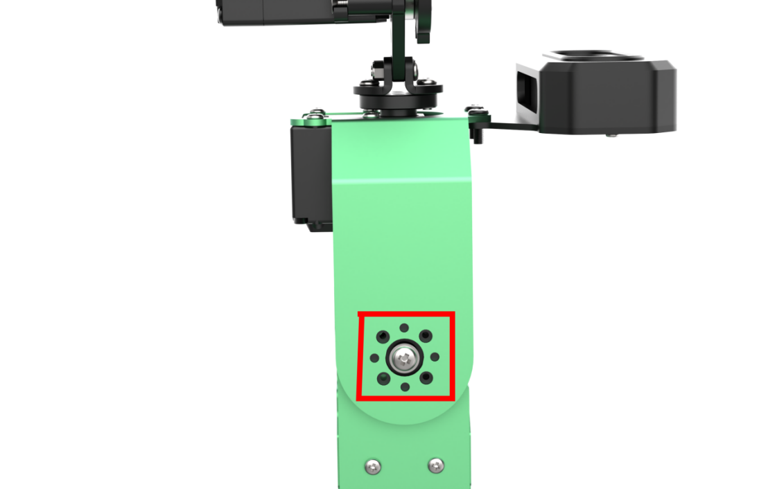

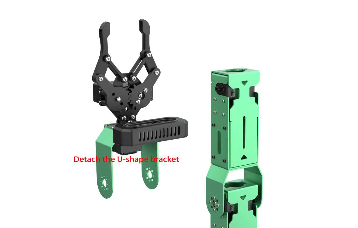

  • Large Deviation Adjustment
To make significant deviation adjustments, the servo must be detached from the U-shaped bracket, centered, reinstalled, and, once the installation is complete, the steps for minor deviation adjustment should be repeated.
(1) Click-on ‘Reset Servo’ icon to reset the robot arm’s pose.
(2) At this point, you may notice a significant deviation in servo 2, with the deviation angle exceeding 30°.

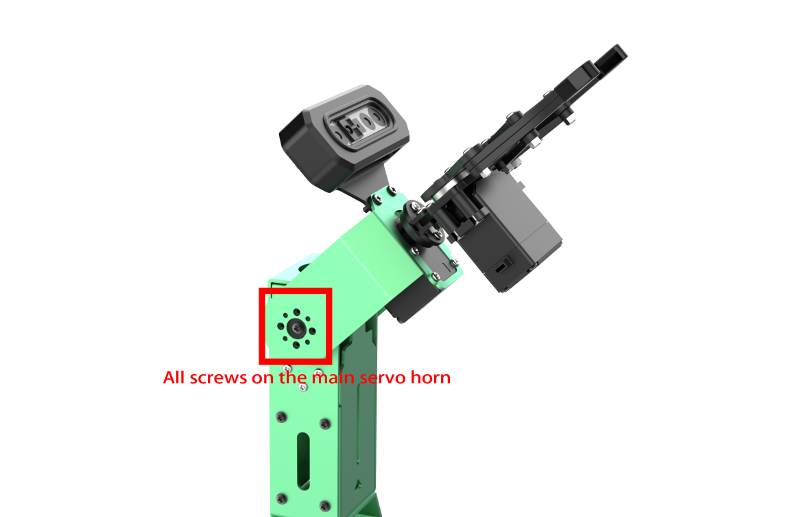

(3) Switch off the robot arm. Please refrain from powering it on while detaching the parts.
(4) Remove all screws from the main servo horn of servo 2 and the main shaft screws on the sub-horn (start by removing the four outer screws of the horn, then proceed to the shaft screws).
(5) Detach the U-shape bracket.
(6) After detaching the bracket, initiate the robot and open the PC software, then click on the ‘Reset Servo’ icon. At this point, the position of the NO.3 servo is adjusted. Please securely hold the detached component to prevent the robotic arm from unintentionally returning to its initial position upon startup.
(7) After centering the servo, turn off the robot arm, and install the main servo horn and assistant servo horn in a ‘cross’ formation.
The servo is now centered, so please refrain from forcibly manipulating the servo shaft. If the servo horn ‘cross’ is not correctly installed, repeat steps 5-7 in Large Deviation Adjustment of this document.
(8) Secure the bracket using screws, ensuring the holes are aligned.
(9) Power on the robot arm, and repeat the instructions provided in Minor Deviation Adjustment to fine tune the deviation.

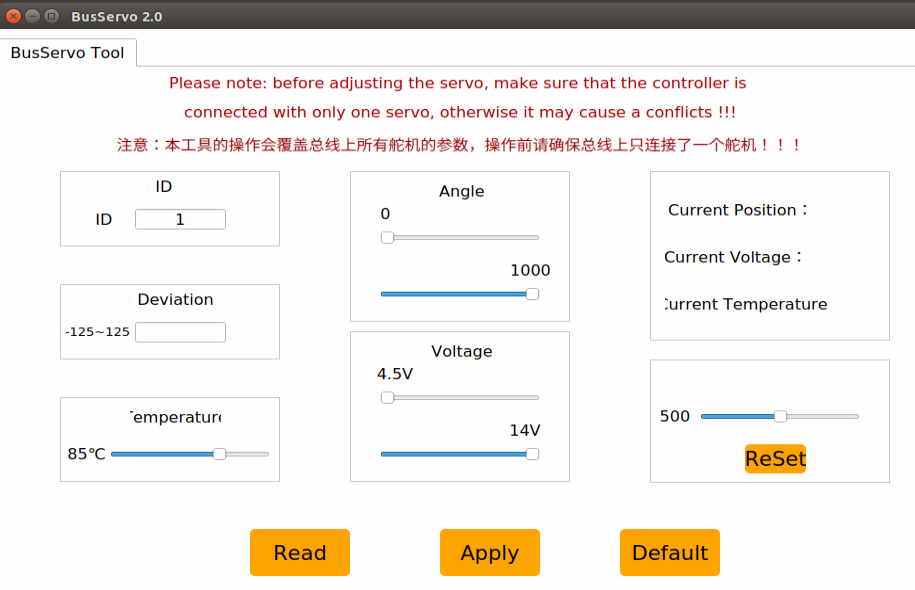

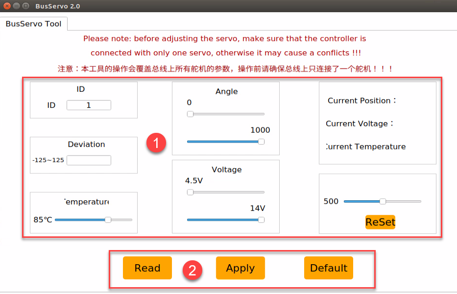

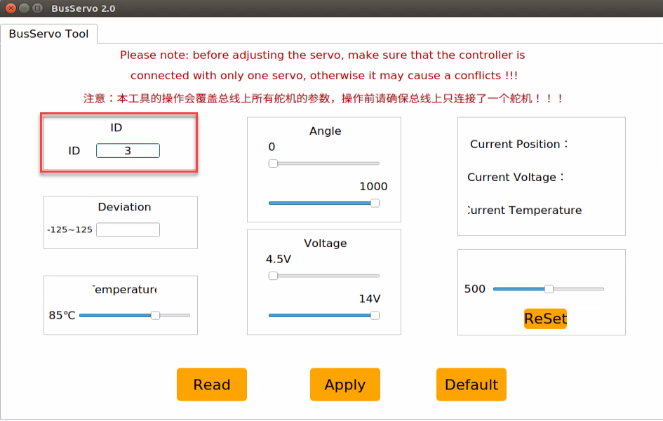

10.5 Use of Servo Debugging Tool
When replacing a servo, it is essential to utilize the servo debugging tool for configuring parameters such as ID and midpoint. Refer to the earlier section, ‘1.1 Introduction to Servo Control Node,’ for information on servo ID numbers.
Prior to initiating servo debugging, please be aware that the servo interface can only be connected to a single servo. Connecting multiple servos in series will result in identical parameters for all servos, preventing individual control of each servo.
10.5.1 Introduction to Servo Debugging Tool Interface
(1) Access the robot system desktop according to the tutorials provided in 1. Getting Ready(JetArm User Manual) ->1.6 Development Environment Setup and Configuration.
(2) Execute the following commands to check the files.
cd factory_utils/Bus_Servo_Tool
ls
(3) Next, enter the command to open the PC software. After opening, confirm that the bus servo interface is separately connected to a servo.
python3 main.py
(4) The function of each icon is detailed in the table below:
Icon Function
Read current servo parameter
Apply the change
Restore default settings
Set servo ID. The servo ID can be set within this range: 0~253
Adjust the servo's working temperature. 85℃ by default.
Adjust the servo rotation range according to their specific needs. JetArm's servo rotation range is from 0 to 1000.
Adjust servo's working voltage range. Users can limit servo's working voltage to protect the servo. The servo working voltage range of the servo is from 9 to 12.6V.
Display the servo's current position, voltage and temperature.
Adjust the servo's rotation position by dragging the slider and pressing the Apply button. To return to the position of 500, press the ReSet button and then Apply.

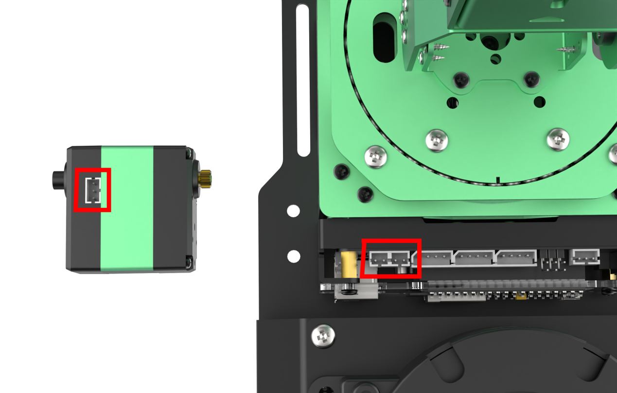

10.5.2 Servo Debugging Instructions
(1) Connect one servo to the servo port.
(2) Enter the following command to launch the servo debugging tool. Ensure that only one servo is connected to the serial bus servo port during this process.
python3 factory_utils/Bus_Servo_Tool/main.py
(3) Click-on ‘Read’ button.
(4) Using the adjustment of ID3 servo as an example, set the servo ID. Other parameters can be left at their default values, or users can customize them based on their needs.
(5) Click-on Apply button to apply the change.
(6) After setting the servo ID, detach and assemble the servos according to the Large Deviation Adjustment.
