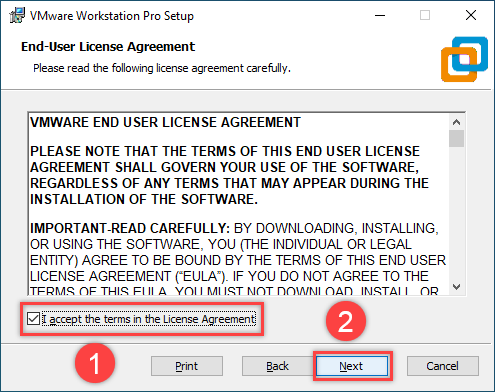

15.1.1 Virtual Machine Software Installation

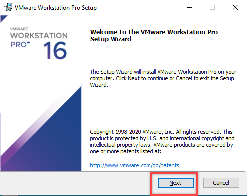

  • VMware Installation
A virtual machine allows us to run other operating systems within our current operating system. In this section, we will demonstrate the installation process using VMware Workstation as an example:
(1) Unzip the virtual machine software package located under the “Configuration File -> VMware” path.

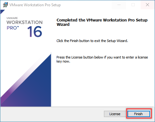

(2) After unzipping, locate the virtual machine folder and double-click the executable file (with the “.exe” extension).

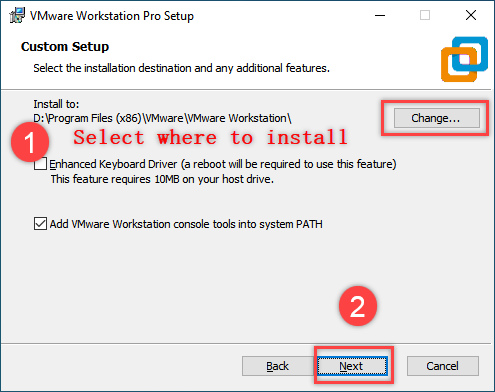

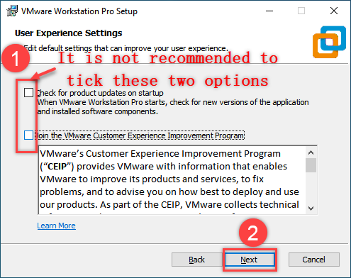

(3) Follow the on-screen instructions to complete the installation of the virtual machine.

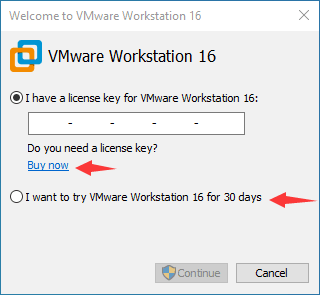

(4) VMware Workstation offers 30-day free trial. After 30-day trial, you can purchase a license key to activate this software. If you need free resource, please contact us via email.

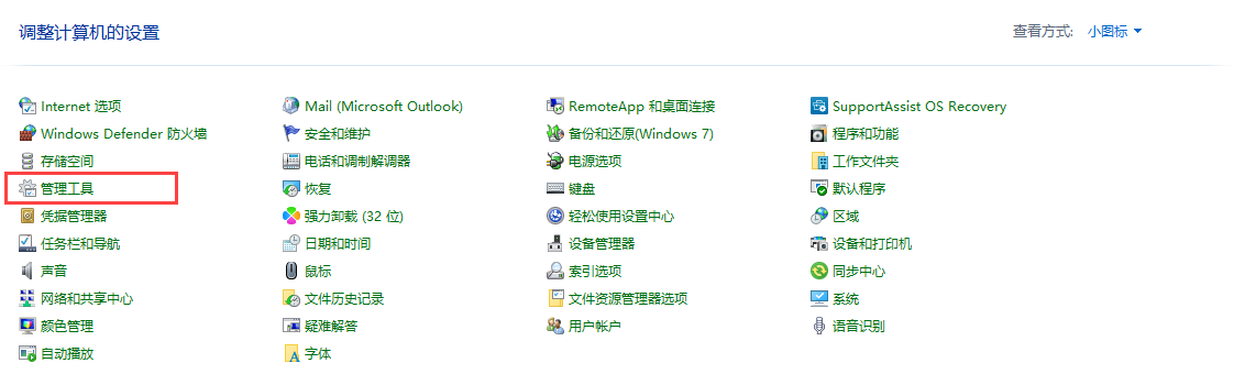

(1) On your computer, press the WIN+R keys to open the Run window. Then, type control and press Enter to open the Control Panel.
(2) Click on Administrative Tools and then double-click on Services.

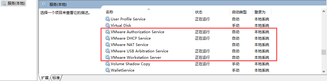

(3) Locate the VMware-related services as shown in the image below.

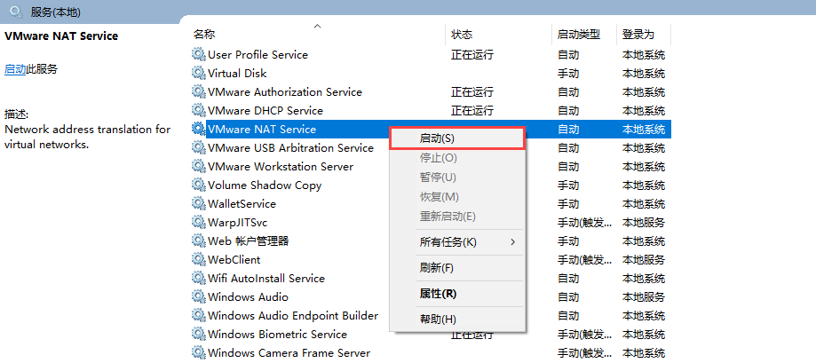

(4) Right-click on the Start button and select it to start all VMware-related services.

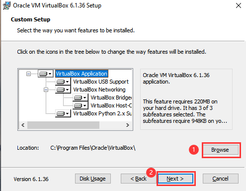

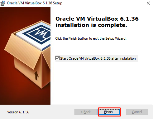

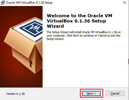

  • VirtualBox Installation
(1) Open the software installation package in the same directory and click Next.
(2) Modify the installation path if needed, then click Next.
(3) No changes needed, just click Next.
(4) Confirm the installation and click Start Installation.
(5) Once the installation is complete, click Finish.

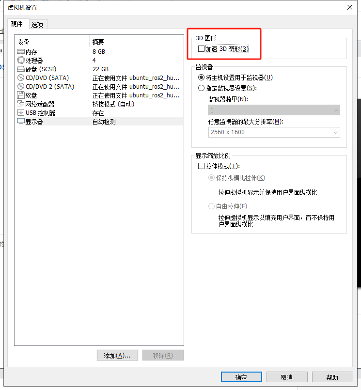

15.1.3 Virtual Machine Settings

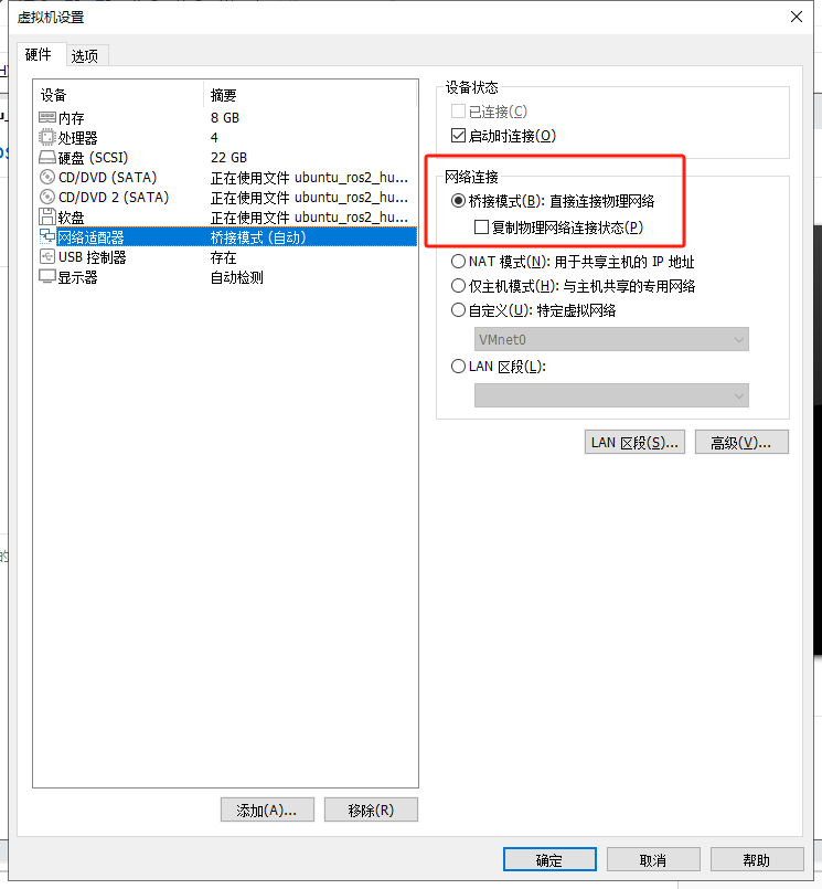

(1) Locate the virtual machine you just imported and click Edit Virtual Machine Settings.
(2) Click on Network Adapter and select Bridged Mode.
(3) Click on Display and uncheck the Accelerate 3D Graphics option.
Enabling the “Accelerate 3D Graphics” option can negatively affect virtual machine performance and may cause lag during simulation.

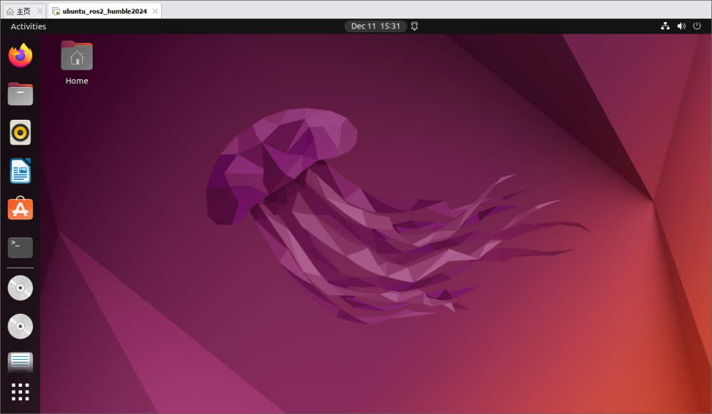

The virtual machine interface is as below:

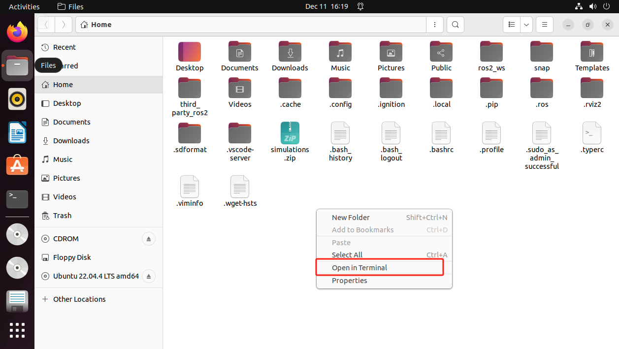

(2) Click the Home icon on the desktop to enter the Home directory.
(3) Locate the Simulations compressed file in the same directory. Drag the compressed file into the Home directory of the virtual machine.
Only drag one file at a time.
(4) Right-click in the Home directory and select Open in terminal to open the terminal.

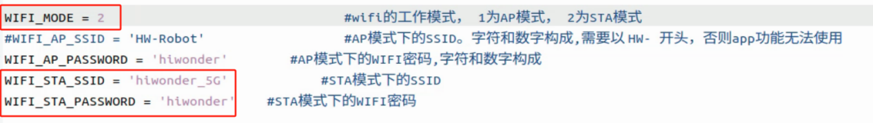

15.2.2 Network Configuration (Performed in Robot System Desktop)
To ensure proper communication between the virtual machine and the robot during future operations, we need to configure the device’s network settings.
(1) Start the robot and open a terminal on the desktop.
(2) Enter the following command to configure the WiFi file:
cd ~/wifi_manager && gedit wifi_conf.py
(3) Modify the configuration to LAN mode and enter the WiFi name and password
(4) Press Ctrl+S to save and close the file.

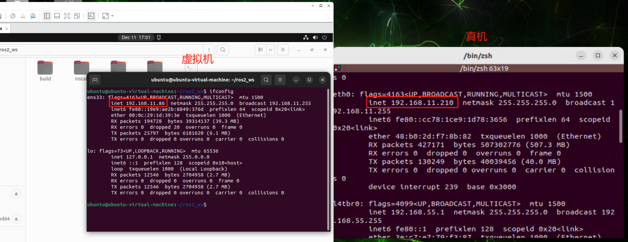

(5) For subsequent connections, ensure that the device and virtual machine are on the same network segment. You can check this by running the following command in the terminal:
ifconfig
In this example, both the virtual machine and the robot are on the 192.168.11 network segment, allowing for normal communication.

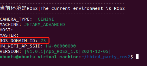

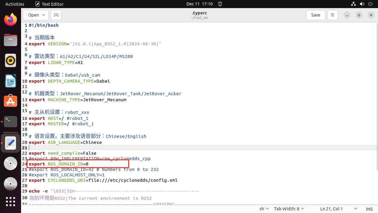

15.2.3 Device ID Configuration (To Be Performed on the Virtual Machine)
In the previous section, we configured the network environment. However, for the virtual machine and the robot to communicate on the same network, they must have matching ID numbers. Below are the steps to configure the ID:

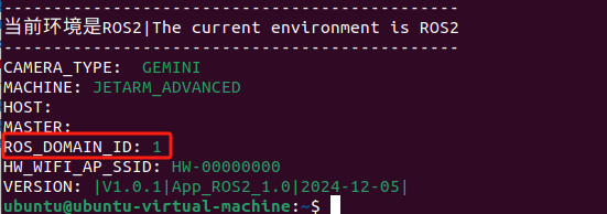

(1) Start the robot and open a terminal from the desktop.
(2) The terminal will display the device’s DOMAIN_ID, as shown below:
For example, if the DOMAIN_ID is 23, we will configure the virtual machine accordingly.

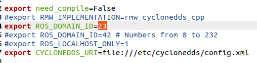

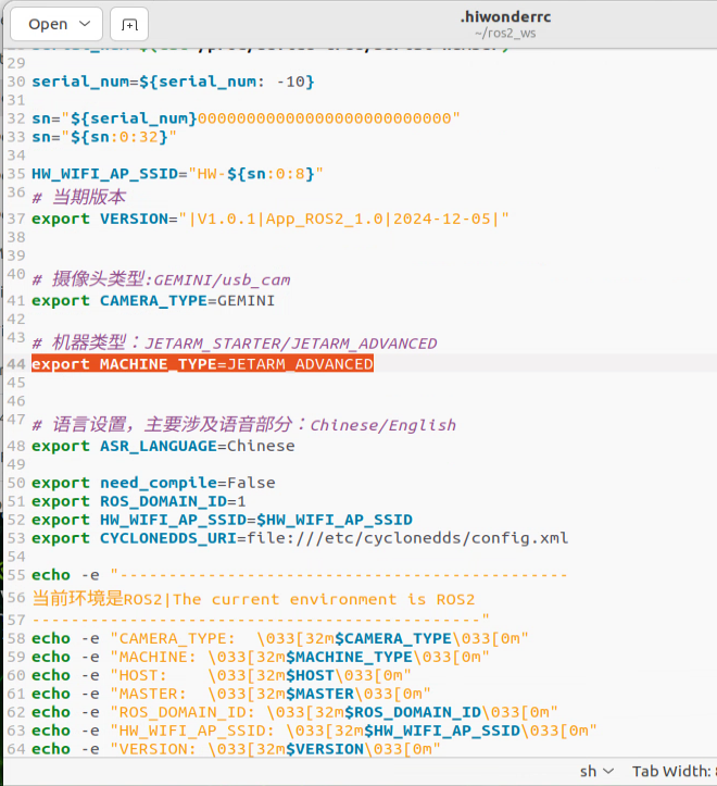

(3) Start the virtual machine and open a terminal from the desktop.
(4) Enter the following command to open the configuration file:
gedit ~/ros2_ws/.typerc
(5) Change the ID to 23 as shown in the image below. Then, select the appropriate configuration based on your camera version and comment out the other option.
(GEMINI: Depth Camera; USB_CAM: Monocular Camera)
(6) Press Ctrl+S to save the changes and close the file.
(7) Close the current terminal, then open a new terminal. You will observe that the ID has been successfully updated to 23.

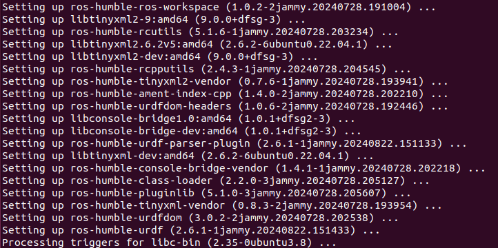

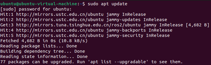

(1) Run the following command and press Enter to update the package information:
sudo apt update
(2) Run the following command and press Enter to install the URDF dependencies:
sudo apt-get install ros-humble-urdf
When the output matches the image below, the installation is successful:

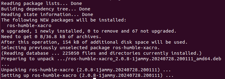

(3) Run the following command and press Enter to install the Xacro model extension for URDF:
sudo apt-get install ros-humble-xacro

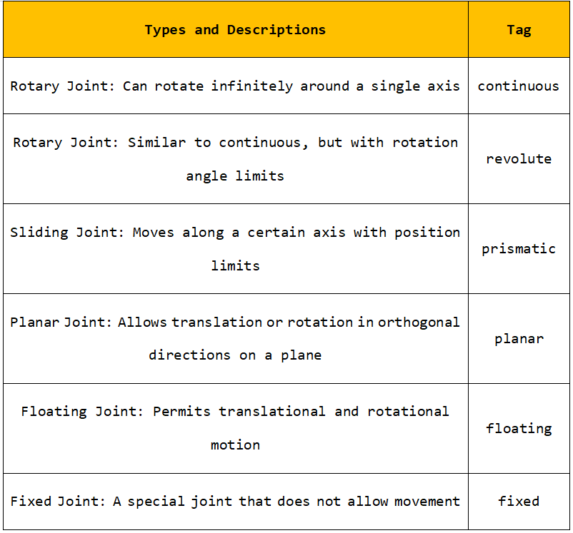

The Joint tag describes the kinematic and dynamic properties of the robot’s joints, including the joint’s range of motion, target positions, and speed limitations. In terms of motion style, joints can be categorized into six types.

To learn about the type of the joint, please refer to joint
<joint name="pan_joint" type="revolute">

First, the following code defines a joint named “joint2” with the type “revolute”, indicating that this is a rotational joint. This joint connects a parent link named “link1” and a child link named “link2”.
<joint name="joint2" type="revolute">
  <origin xyz="..." rpy="..." />
  <parent link="link1" />
  <child link="link2" />
  <axis xyz="0 -1 0" />
  <limit lower="-2.09" upper="2.09" effort="1000" velocity="10" />
</joint>
The joint’s position (origin) is specified using the xyz attribute.

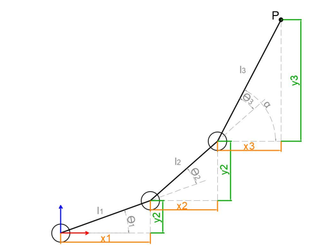

  • Inverse Kinematics Analysis
(1) Geometric Method
For a robotic arm, the geometric method involves determining the rotation angles of each joint after specifying the position and orientation of the end effector. Since the 3D motion of a robotic arm is quite complex, we simplify the model by removing the rotational joint of the lower platform. This allows us to analyze the kinematics in a 2D plane.
Inverse kinematics analysis generally involves extensive matrix computations, making the process complex and computationally intensive, which can make implementation challenging. To better suit our needs, we use the geometric method for analyzing the robotic arm.

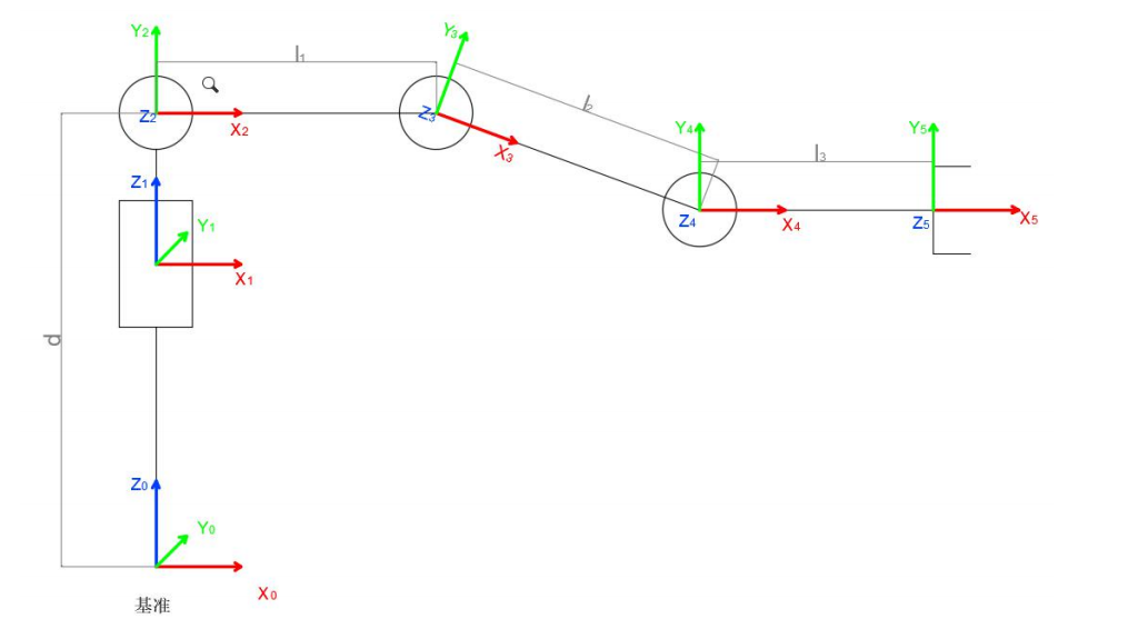

We simplify the model of the robotic arm by removing the base platform and actuator section, resulting in the main body of the arm. From the diagram above, we can see that the coordinates (x, y) of the end effector P are composed of three parts: (x1 + x2 + x3, y1 + y2 + y3).
In the diagram, θ1, θ2, and θ3 are the joint angles of the servos that we need to calculate, and α is the angle between the gripper and the horizontal plane. From the diagram, it is clear that the angle of the gripper from the top view, α, is equal to θ1 + θ2 + θ3. Using this, we can derive the following equation:
Where x and y are provided by the user, and l1, l2, and l3 are the inherent properties of the robotic arm’s structure.
To simplify the calculations, we process the known parts and consider them as a whole:
Substituting m and n into the existing equation and simplifying, we get:
By solving this equation, we obtain:
This result corresponds to the quadratic formula for solving a single-variable equation, where:
From this, we can calculate the angle of θ1, and similarly, we can calculate θ2. With all three servo angles determined, we can then control the servos based on these angles to achieve the desired position.

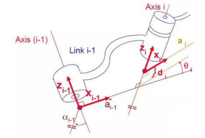

  • DH Modelling
(1) Introduction
The DH Parameter Table (Denavit-Hartenberg Parameter Table) is a standardized method used to describe the relative position and orientation of robotic arm joints and links. It uses four parameters to represent the relationship between each pair of adjacent joints. These four DH parameters have very clear physical meanings, as described below:
① Link Length: The length of the common normal between the axes of two adjacent joints (the rotation axis for rotational joints, the translation axis for prismatic joints).
② Link Twist: The angle by which the axis of one joint is rotated around the common normal relative to the axis of the adjacent joint.
③ Link Offset: The distance along the axis of a joint between the common normal of the current joint and the common normal of the next joint.
④ Joint Angle: The angle of rotation around the joint axis between the common normal of the current joint and the common normal of the next joint.
⑤ While these definitions might seem complex, they become much clearer when viewed in the context of coordinate systems.
First, you should focus on the two most important “lines”:
- The axis of a joint (axis).
- The common normal between the axis of one joint and the axis of the adjacent joint (common normal).
In the DH parameter system, we define the axis as the z-axis, and the common normal as the x-axis, where the direction of the x-axis is from the current joint to the next joint.
However, these two rules alone are not enough to fully determine the coordinate system of each joint. Let’s now go over the detailed steps for determining the coordinate system.
In applications such as robotic arm simulations, we may use other methods to establish coordinate systems. However, understanding the method described here is crucial for grasping the mathematical expressions of robotic arms and for understanding the subsequent analyses.
The diagram below shows two typical robot joints. Although these joints and links may not resemble any specific joints or links from real robots, they are quite common and can easily represent any joint in a real robot.
This revision simplifies and clarifies the explanation, making it easier for users to understand the concepts and how they relate to the coordinate system in robotic arms.
(2) Determine Coordinate System
There are generally several steps involved in determining the coordinate system:
To model a robot using the DH (Denavit-Hartenberg) notation, the first step is to assign a reference coordinate system to each joint. For each joint, both the Z-axis and the X-axis must be specified.
① Defining the Z-axis:
For a rotational joint, the Z-axis is aligned with the direction of rotation according to the right-hand rule. The joint variable is the rotation angle around the Z-axis.
For a prismatic joint (sliding joint), the Z-axis aligns with the direction of linear motion. The joint variable is the length of travel along the Z-axis.
② Defining the X-axis:
When the X-axis is specified and two joints are neither parallel nor intersecting, the Z-axes usually form skew lines. However, there is always a common perpendicular — the shortest line between the two skew lines — which is orthogonal to both. The local reference coordinate system’s X-axis is defined along the direction of this common perpendicular.
If aₙ represents the common perpendicular between Zₙ and Zₙ₋₁, then the direction of Xₙ will be along aₙ.
③ Special Cases:
- When the Z-axes of two joints are parallel, there are infinitely many common normal lines. In this case, one can choose the common normal that is collinear with the common normal of the previous joint, simplifying the model.
- When the Z-axes of two joints intersect, there is no common normal. In this case, the X-axis can be defined along the line perpendicular to the plane formed by the two axes, simplifying the model.
Once the coordinate system is assigned to each joint, the model can be represented as shown in the diagram below:
After determining the coordinate system, we can represent the four parameters more simply:
Link Length li: Defined as the distance along the positive Xi-1 axis from Z i-1 axis to Zi.
Link Twist ai: Defined as the angle of rotation along the positive direction Xi-1 (using the left-hand or right-hand rule?) between Zi-1 and Zi.
Joint Offset di: Defined as the distance along the positive Zi - 1 axis from Xi - 1 axis to the Xi.
Joint θi: Defined as the rotational angle between two axes, measured in the positive direction (using the left-hand or right-hand rule).
Joint θi: Defined as the rotational angle between Xi-1 and Xi along the positive direction Zi-1, using the right-hand rule (or left-hand rule, depending on the convention).

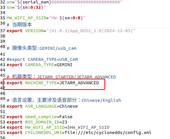

(1) Start the virtual machine. Click on on the system desktop to open the command line terminal.
(2) Enter the following command to open the configuration file:
gedit ros2_ws/.typerc
(3) Modify the section highlighted in red in the image below to the JETARM_ADVANCED version. After making the changes, press Ctrl+S to save and close the file.
(4) Return to the terminal and enter the following command to update the environment configuration:
source ~/.bashrc

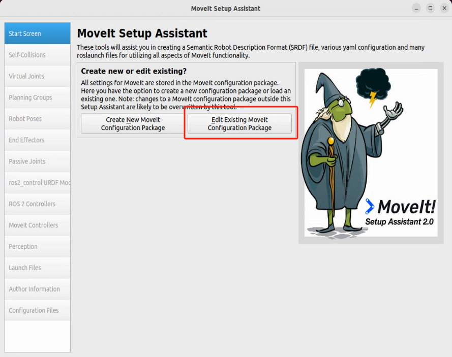

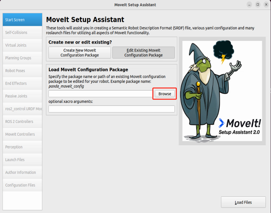

(3) Click Edit Existing MoveIt2 Configuration Package to begin editing an existing configuration package.

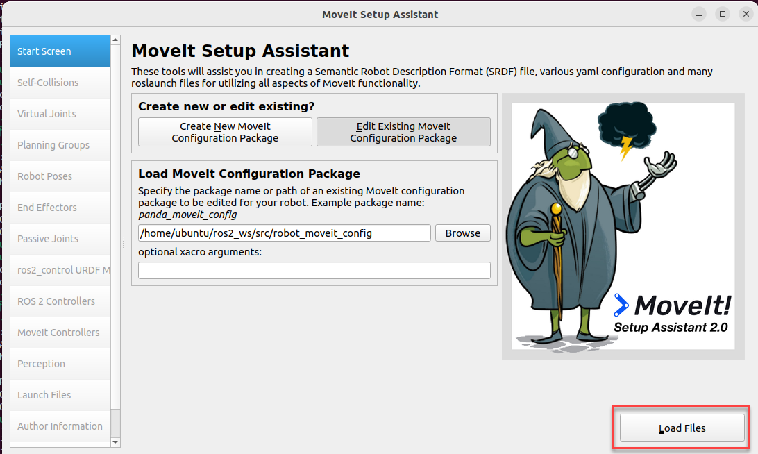

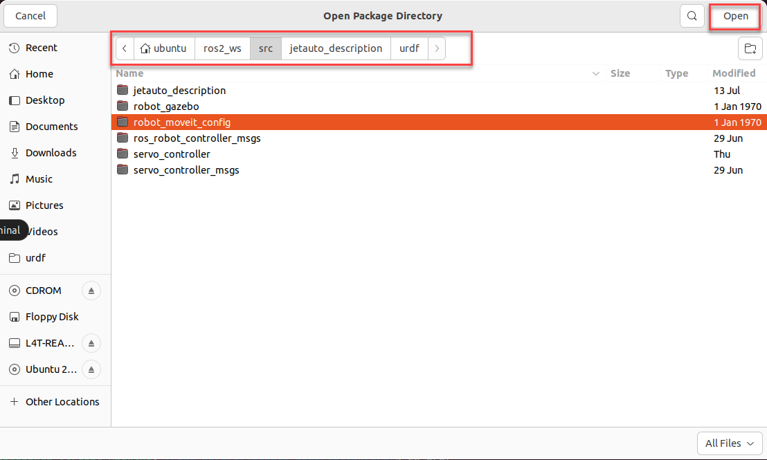

(4) Click Browse and navigate to the following directory: home/ubuntu/ros2_ws/src/robot_moveIt_config; Select the folder and click Open.
(5) Click Load Files and wait for the files to load.
Once the progress reaches 100%, the robot model will appear on the right side, indicating a successful load.

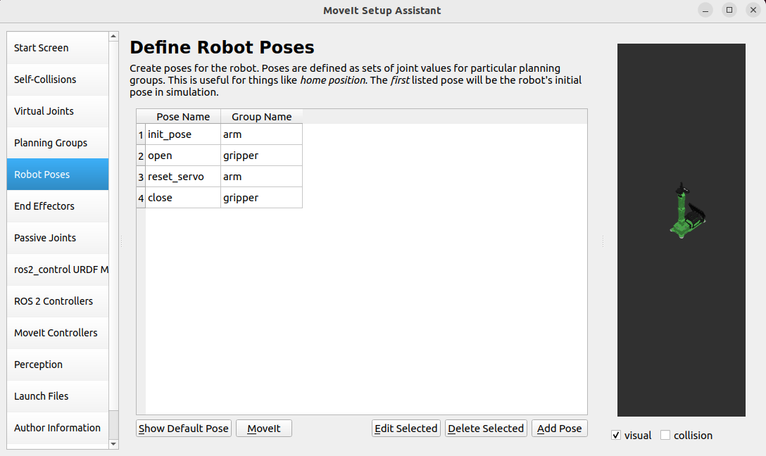

(6) Adjust settings for options such as Virtual Joints and Robot Pose in the left-hand menu.

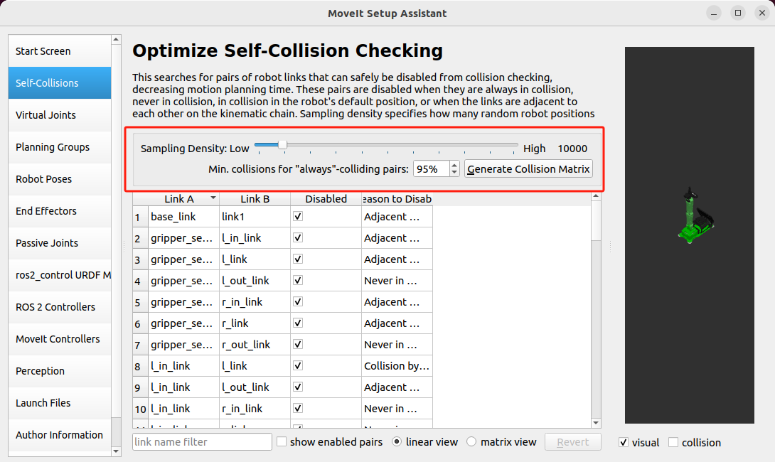

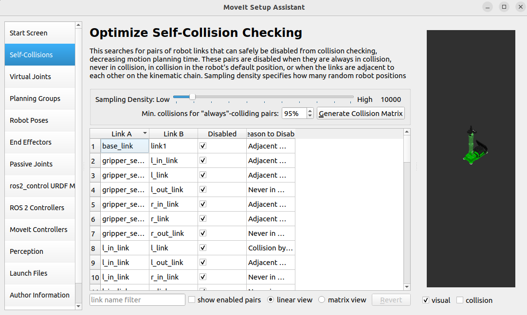

(1) Self-Collisions
The default collision matrix generator scans all joints of the robot. This custom collision matrix can safely disable specific collision checks, thereby reducing the processing time for motion planning.
Sampling Density:
Sampling density refers to the number of random joint configurations sampled to check for collisions. Higher density increases computation time. The default value is 10,000 collision checks.

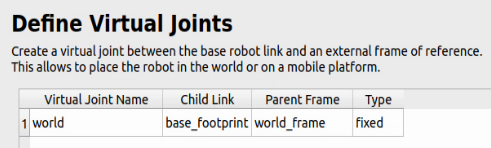

(2) Virtual joints
Virtual joints are primarily used to connect the robot to a simulation environment. In this step, a virtual joint is defined to link the base_footprint frame to the world_frame.

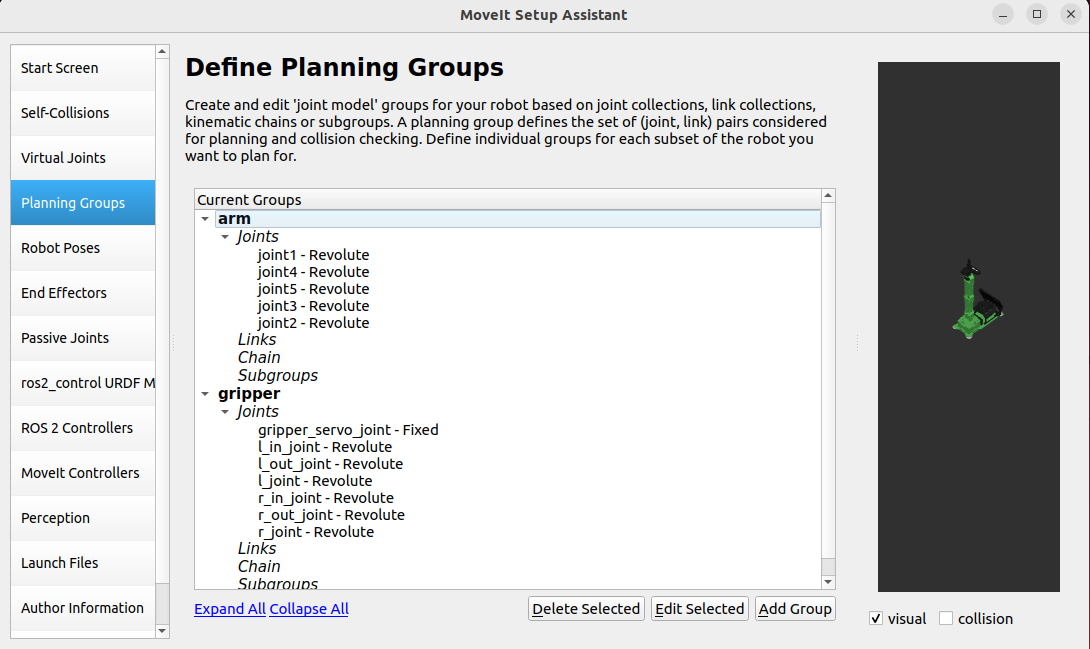

(3) Planning Groups
Joint groups are used to define the various joint components required to assemble the robot.

Define custom pose names for the robot and specify the joint groups involved in achieving each pose.

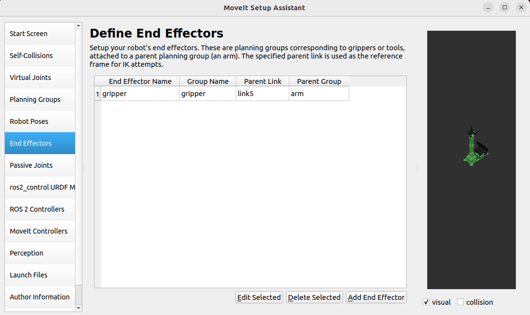

(5) End Effectors
End effector (robot arm’s gripper)

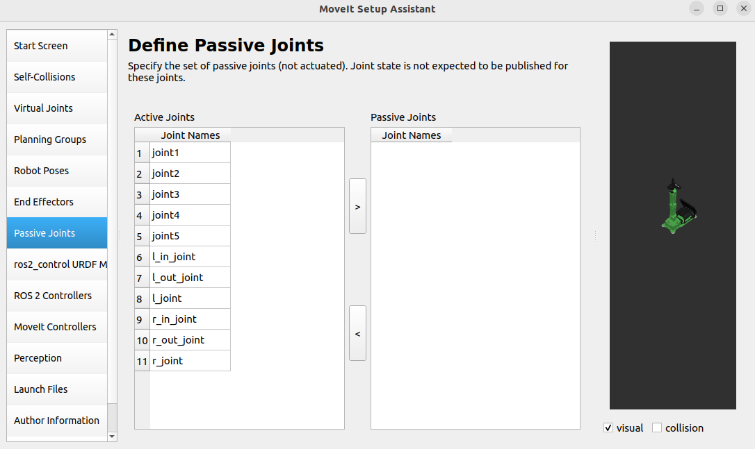

(6) Passive Joints
Defining unused joints. Specify which joints are available and which are disabled, based on the robot’s configuration.

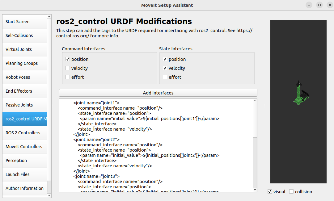

(7) ros2_control URDF Modifications
Configure the URDF file required for the simulation.

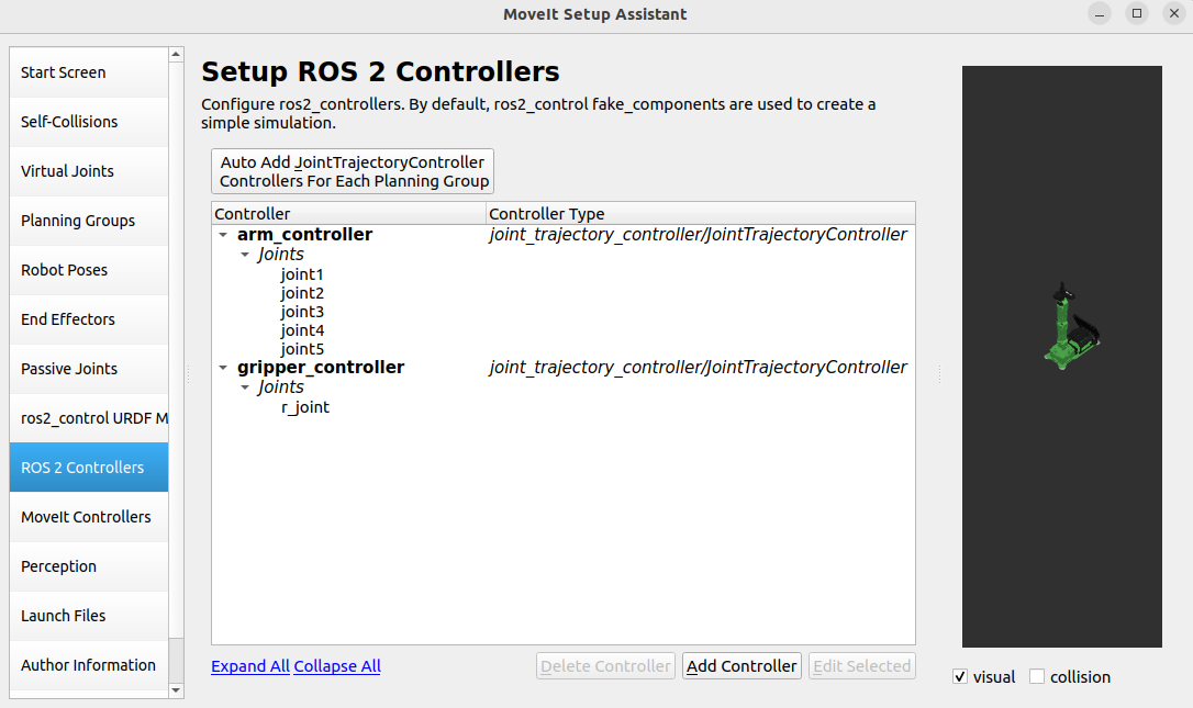

(8) ROS2 Controllers
Using the ROS2 Controllers panel, you can add simulated controllers for the joints. This enables MoveIt2 to simulate the motion of the robotic arm.

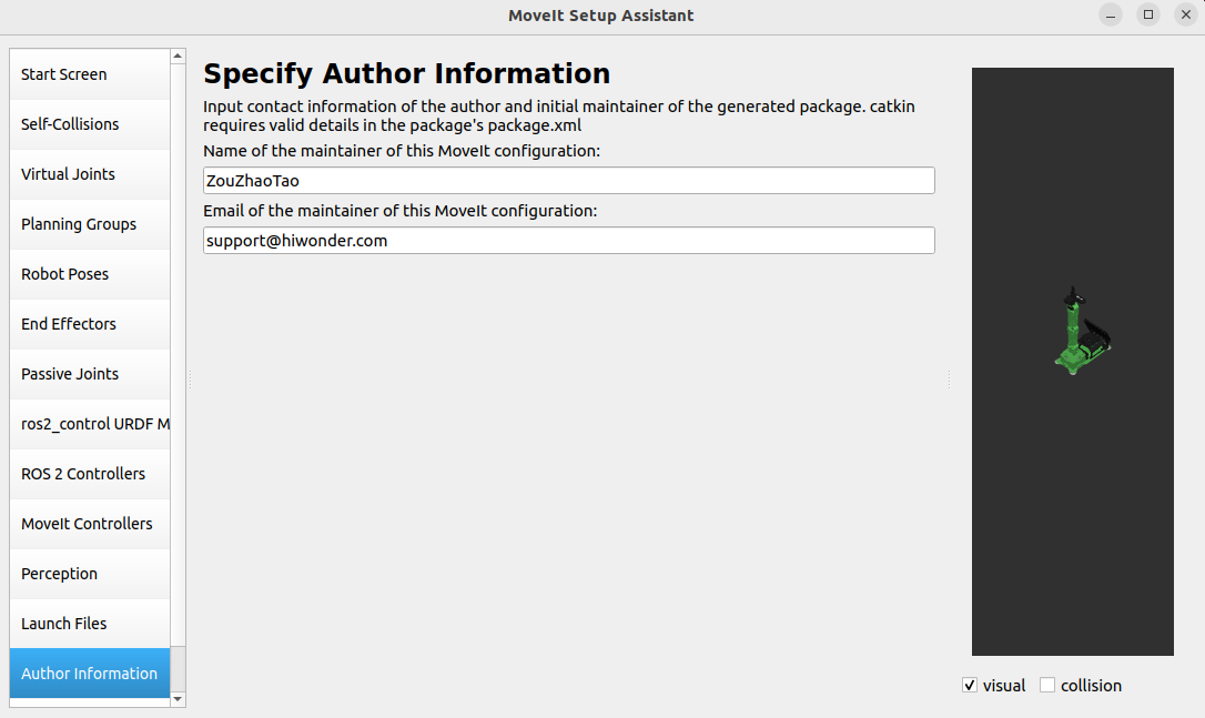

(9) Author Information
Provide the author’s details for documentation purposes.

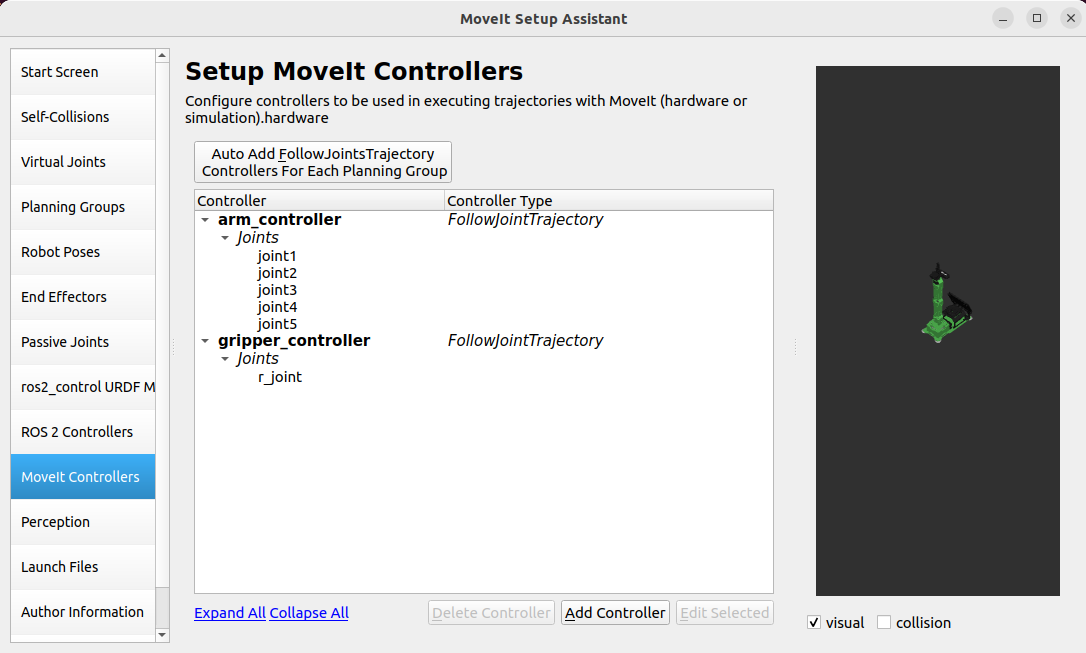

(10) Movelt controllers
Configure the controller for executing trajectories in Movelt

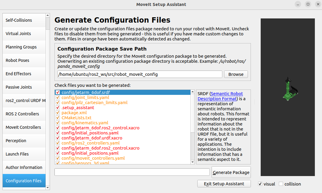

② Generating Configuration Files
After confirming the file path, click Generate Package to generate the configuration package.

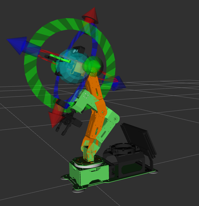

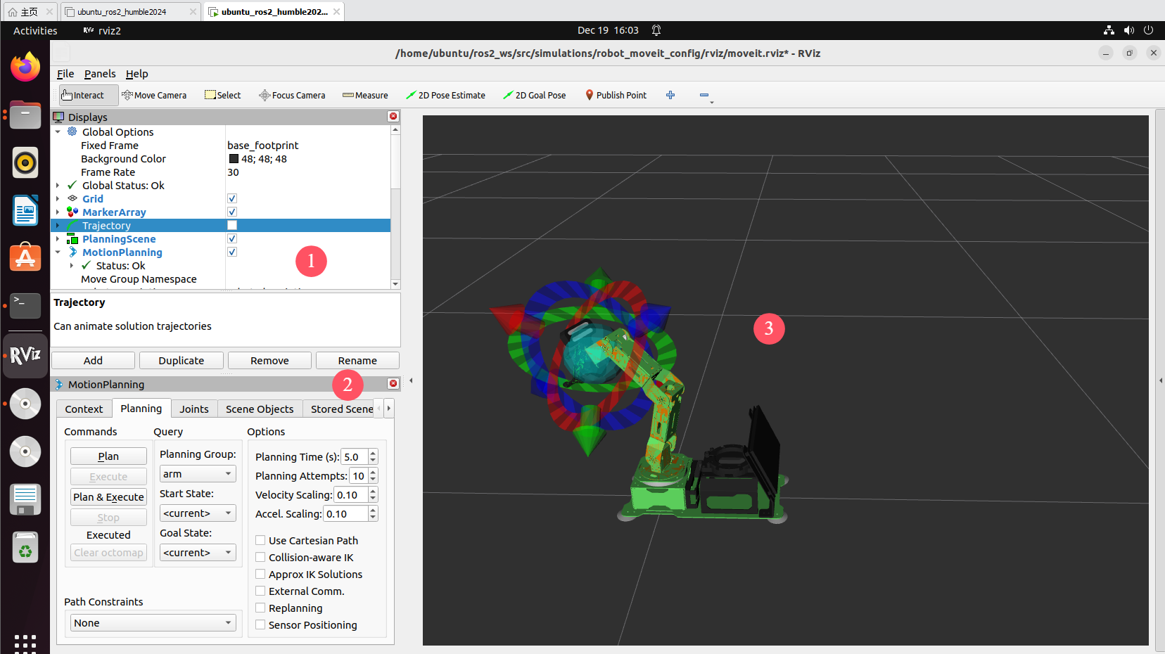

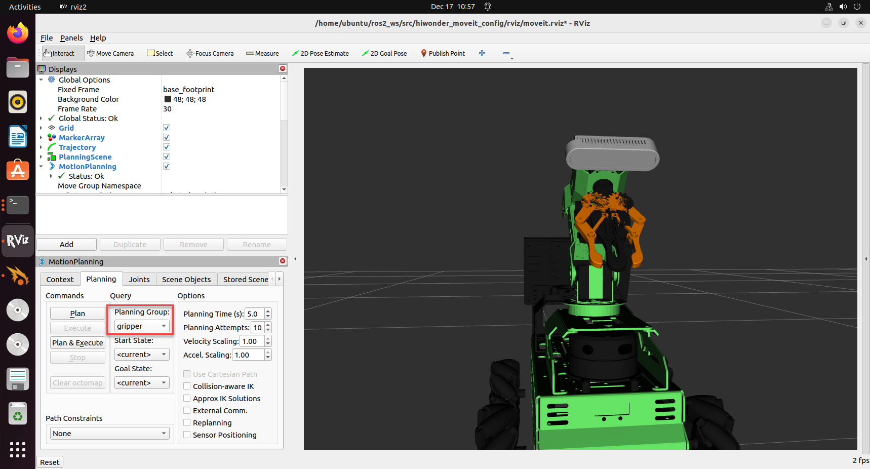

  • Start MoveIt2 Tool
(1) Start a new command-line terminal, and run the following command to launch the MoveIt2 tool.
ros2 launch robot_moveit_config demo.launch.py
(2) Program Interface Overview

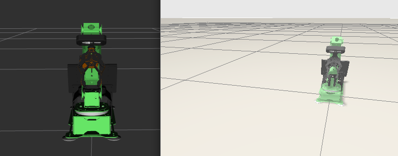

The program interface is shown in the image below:
Position 1: RViz Toolbar
Position 2: MoveIt Debugging Area
Position 3: Simulation Model Adjustment Area

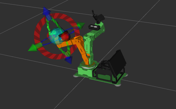

  • Control Instructions

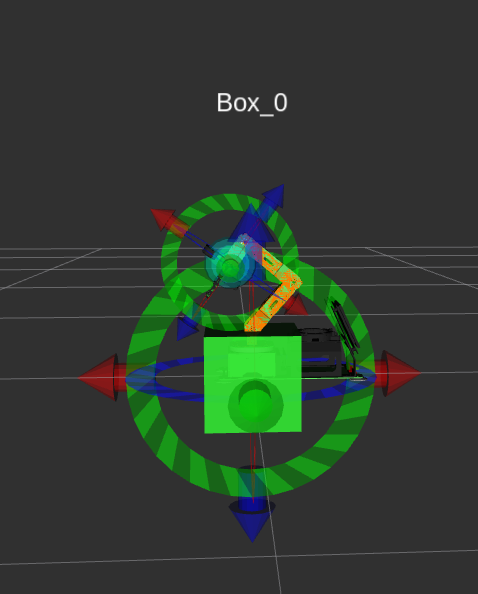

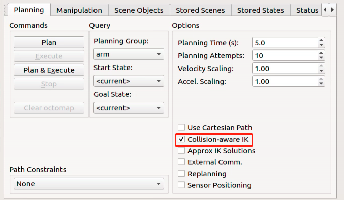

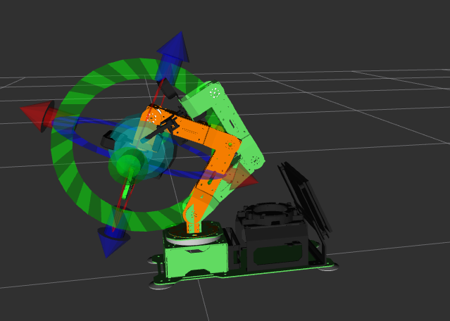

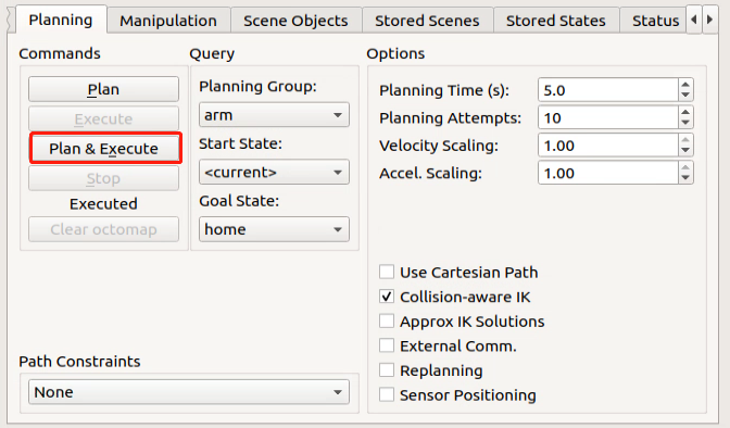

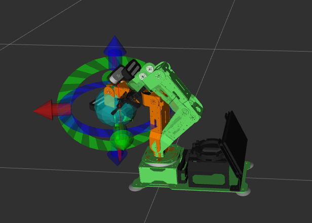

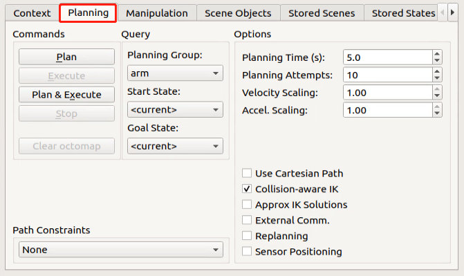

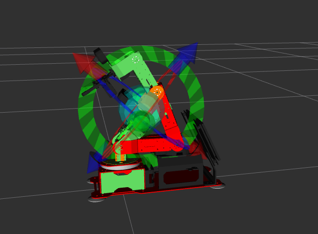

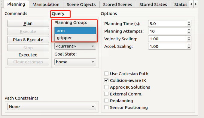

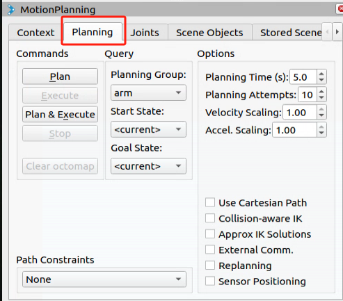

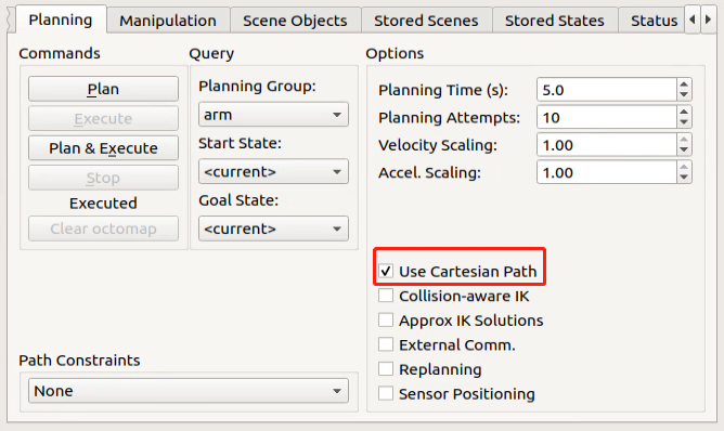

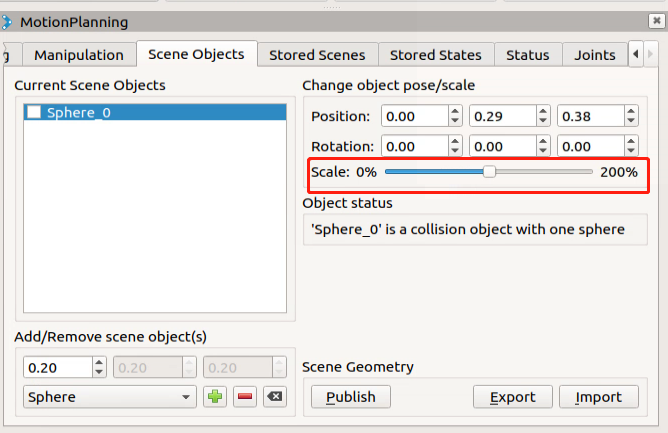

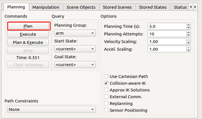

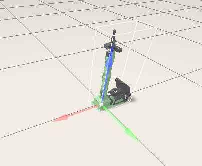

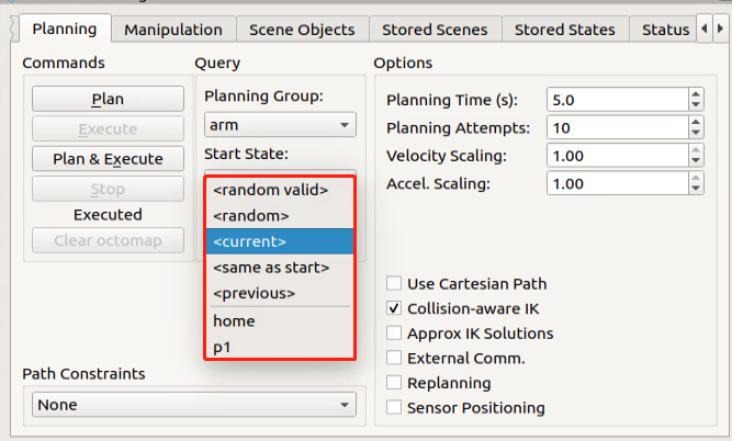

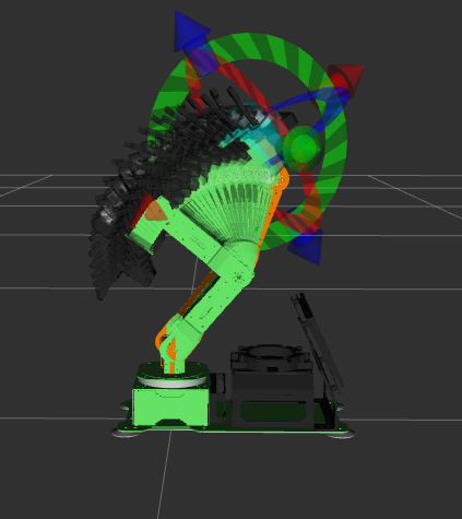

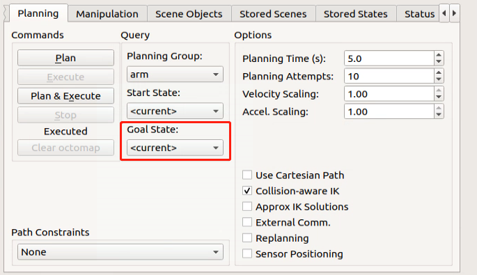

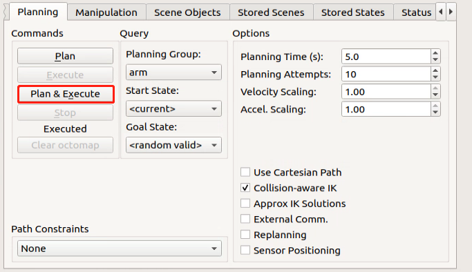

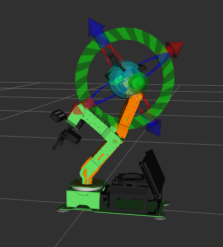

(1) In the MoveIt2 Debugging Area, find and click the Planning section.

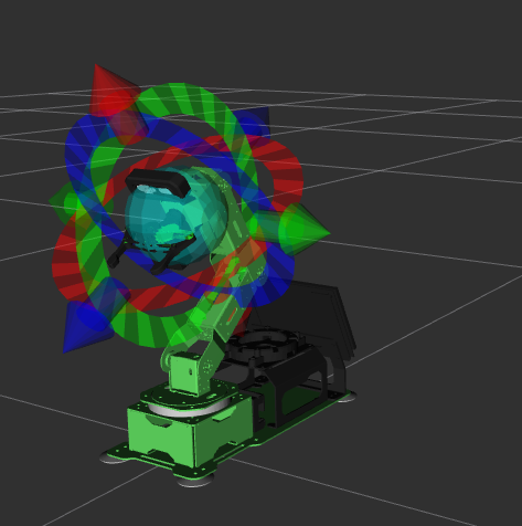

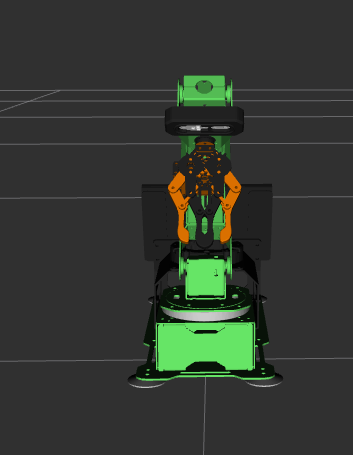

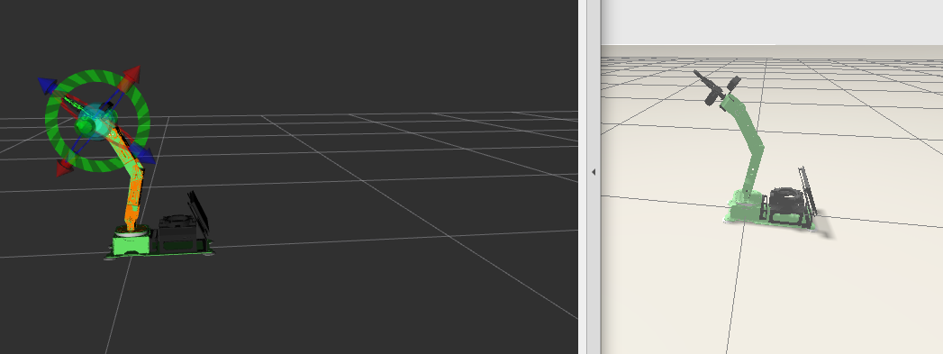

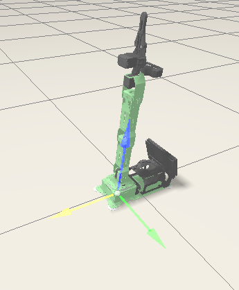

(2) In the Simulation Model Adjustment Area, you will see arrows in red, green, and blue colors. Click and drag the arrows to adjust the robotic arm’s pose. In the robot’s first-person view:
Green represents the X-axis, with the positive direction pointing to the robot’s left.
Red represents the Y-axis, with the positive direction pointing to the robot’s front.
Blue represents the Z-axis, with the positive direction pointing upwards from the robot.

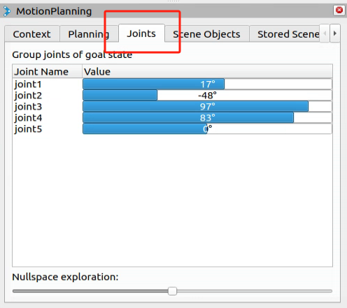

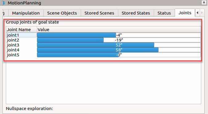

(3) Besides adjusting the pose using the arrows, you can also adjust individual joints directly. Click the triangle icon on the right and find the Joints panel.
(4) Drag the sliders for the corresponding joints to adjust their angles individually.
(5) After successfully planning the robotic arm’s motion path, the new position will be highlighted in orange. If the new position causes a collision with other parts of the robot, it will be marked in red. You must adjust the configuration to avoid collisions; otherwise, the motion cannot be executed.
Orange (Executable State) is shown in the following image.
For example, if the robotic arm is planned to be in the position shown in the image, it will collide with the depth camera, turning the state red (Non-executable).
(6) After planning the path, return to the Planning section and click the Plan option. The simulation model will display the motion path from the original position to the newly planned position.
(7) Then, click the Execute option to make both the simulation model and robotic arm follow the planned motion path.
(8) Alternatively, you can click Plan & Execute, where the robotic arm will first display the new planned motion path and then execute the movement.
(9) To close this mode, press Ctrl+C in the terminal. If the process fails to stop, try again.

(1) In the MoveIt2 Debugging Area, locate and click the Planning section.
(2) In the Simulation Model Adjustment Area, there are arrows in green, red, and blue colors. From the robot’s first-person perspective:
(3) In the Query category, click the dropdown menu under Planning Group and select the joint group (servo group) you wish to control. For example, the default selection is the arm group.
(4) Click the dropdown menu under Goal State and choose the desired target position.
(5) The parameter list in the dropdown menu is as follows:
random valid: A valid random position where no collisions will occur.
random: A random position that may potentially result in a collision.
current: The current position.
same as start: The same as the starting position.
previous: The previous target position.
home and p1 are the default positions set by the program.
(6) To avoid the possibility of collisions, select random valid to randomly generate a valid target position. Each time you click this option, a new target position will be randomly generated and displayed in the simulation model.
(7) Click Plan & Execute, and both the simulation model and robotic arm will perform the motion simultaneously. The simulation model will show the newly planned movement path, and the robotic arm will execute the motion.
(8) To exit this mode, press Ctrl+C in the terminal. If the process fails to stop, try again.

Cartesian path planning is a method of trajectory planning where the robot’s end effector moves within Cartesian space.
In MoveIt2, Cartesian path planning allows you to specify the starting and target positions of the robot’s end effector, and generates a smooth path for the end effector to move from the starting position to the target position.
(1) Cartesian Coordinate System
The Cartesian coordinate system is a general term for both orthogonal and skewed coordinate systems. It consists of two axes intersecting at the origin, forming a planar affine coordinate system. If the measurement units along both axes are equal, it is called a Cartesian coordinate system.
If the two axes are perpendicular to each other, it is known as a Cartesian orthogonal coordinate system; otherwise, it is called a Cartesian skew coordinate system.
In most cases when describing spatial position, velocity, and acceleration, we use the Cartesian coordinate system. When referring to rotations around an axis, the positive direction is determined by the right-hand rule, as shown in the diagram below:
(2) Cartesian Path Analysis
Cartesian path planning can be divided into point-to-point Cartesian path planning and continuous Cartesian path planning based on the nature of the path. This involves predefining the robot’s target points or target paths and using kinematic calculations to determine the joint-level trajectory, allowing the robot to follow the desired path.
In joint space (the space composed of all joint vectors), the movement of the robot’s axes is controlled individually. Each axis moves independently through interpolation, without affecting the other axes. The trajectory between two points taken by the robot’s end effector is an arbitrary curve.
However, in some cases, the shape of the end effector’s trajectory needs to be a straight line or arc, for example. In these cases, Cartesian path planning is used to add constraints on the shape of the trajectory.
Important: Before starting, ensure that there is enough space around the robot for movement. Keep a safe distance from the robot during operation to avoid injury from collisions with the robotic arm. Also, make sure to bend the antenna backward to prevent damage to the antenna during the robot’s movement.
This section will add Cartesian path constraints to the path planning, restricting both the simulation model and the real robotic arm to perform linear motion.

(3) Locate the Planning section, and tick Use Cartesian Path to enable Cartesian path planning.
(4) Next, use the mouse to drag the arrows in the “Simulation Model Adjustment Area” to plan the robot arm’s path. From the robot’s perspective, the green arrow represents the X-axis, with the positive direction to the robot’s left; the red arrow represents the Y-axis, with the positive direction to the robot’s front; and the blue arrow represents the Z-axis, with the positive direction upwards from the robot.
(5) Once the planning is complete, click Plan & Execute. The simulation model will execute the action and attempt to linearly move the end effector in Cartesian space. If the action cannot be performed within the Cartesian path constraints, it will display a failure message.
(6) To exit this mode, press Ctrl+C in the terminal. If it fails to close, please try again.

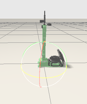

(3) In the Simulation Model Adjustment Area, there are arrows in three colors: green, red, and blue. Click and drag the arrows to adjust the robot arm’s posture. From the robot’s perspective, the green arrow represents the X-axis (positive direction is to the left of the robot), the red arrow represents the Y-axis (positive direction is in front of the robot), and the blue arrow represents the Z-axis (positive direction is above the robot).

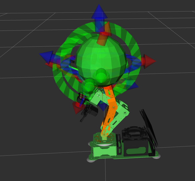

After planning the path, the new position will be highlighted in orange, as shown in the image below:

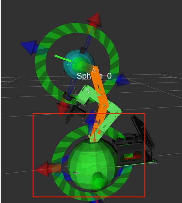

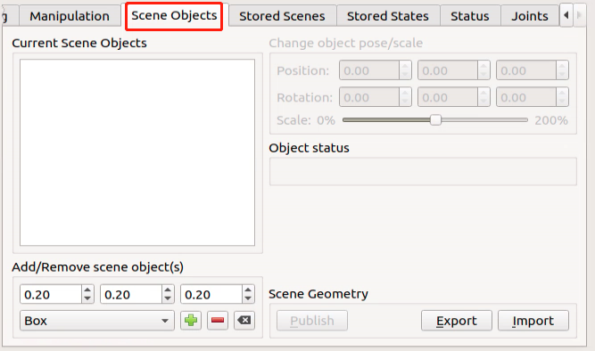

(4) Once the robot arm’s path is planned, click the Scene Objects section to add a collision model.
(5) The section is divided into 4 areas, as described below:

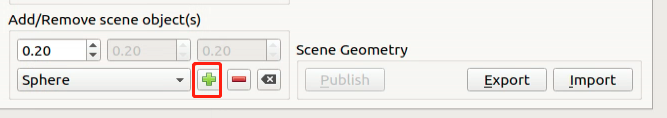

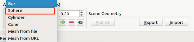

(6) Click the Box dropdown menu and select a collision model. Here, we will use the Sphere model as an example.
(7) Click the plus icon to add the currently selected collision model.
The model will be placed at the robot’s base by default, as shown in the image below:
(8) Use the slider to adjust the size of the collision model. It is recommended to shrink it to about 50% of the original size.
(9) Drag the 3D arrows on the sphere to move the collision model between the start and target positions to test the collision detection effect.

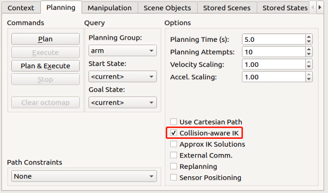

(10) Click the Planning section and check the Collision-aware IK option to enable the collision detection for the model.
(11) Next, click Plan & Execute to begin moving along the planned path. When the following prompt appears, select Yes.
(12) After confirming, the robot arm will plan the movement path, avoiding any obstacles along the way to prevent collisions.
(13) If you wish to exit this mode, press Ctrl+C in the terminal. If it doesn’t close successfully, please try again.

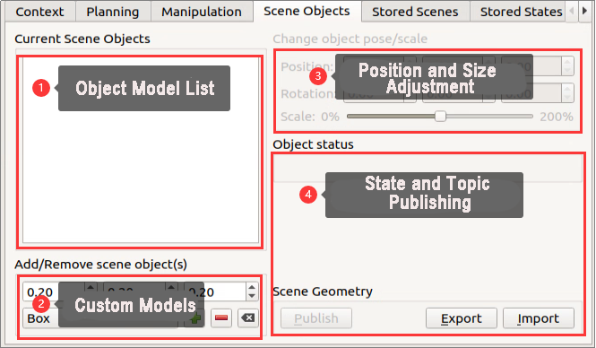

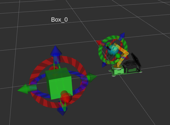

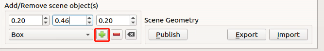

(3) In the debugging area, locate the Scene Objects section to add scene object models.
(4) This section is divided into 4 areas, as shown below.

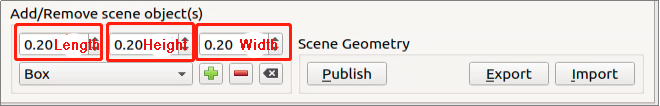

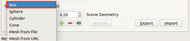

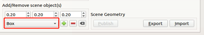

(5) In the “Custom Models” section, select the required basic model. Here, we use the cube model as an example.
(6) Above the model selection, adjust the initial size of the object model in meters, as shown below.
(7) After adjusting, click the “+” button to add the currently configured object model to the scene.
(8) Once added, the model list will be updated with the newly added model, which will appear at the center of the scene (i.e., the robot’s center).
(9) In the simulation model adjustment area, there are arrows in red, green, and blue colors. Click and drag these arrows to adjust the robot’s pose. In the robot’s first-person view:
Green Arrow: X-axis direction, positive direction is to the left of the robot.
Red Arrow: Y-axis direction, positive direction is in front of the robot.
Blue Arrow: Z-axis direction, positive direction is above the robot.

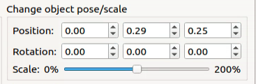

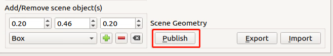

(10) In addition to using arrow dragging, you can also make adjustments in the “Position and Size” adjustment area.
Position: Adjust the object’s position on the X, Y, and Z axes.
Rotation: Adjust the object’s angle along the X, Y, and Z axes.
Scale: Adjust the object’s size by dragging the slider.

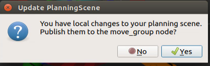

(11) After making adjustments, click Publish to send the model’s topic message. MoveIt2 will automatically subscribe to this message.
(12) To prevent object models from colliding, go to the Planning section and check the Collision-aware IK box to enable collision detection for the model.
(13) If you wish to close this feature, press Ctrl+C in the terminal. If the closing fails, please try again.
(1) Open a new command-line terminal. Launch MoveIt2 Tool: Enter the following command to launch the MoveIt2 tool:
(2) The program interface is displayed as shown below:
Position 1: RVIZ Toolbar
Position 2: MoveIt2 Debugging Area
(3) Adjust Robot Pose: In the simulation model adjustment area, there are red, green, and blue arrows. Click and drag the arrows to adjust the robotic arm’s pose. The robot is viewed from its first-person perspective, with:

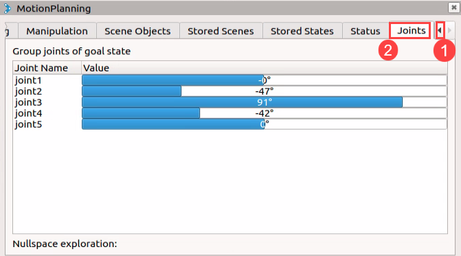

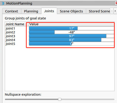

(4) Adjust Individual Joints: In addition to adjusting the pose with the arrows, you can directly adjust the individual joints. Click the triangle icon on the right side, then find and click the Joints panel.
(5) Fine-tune Joint Angles: Drag the corresponding sliders to adjust the angles of the individual joints.

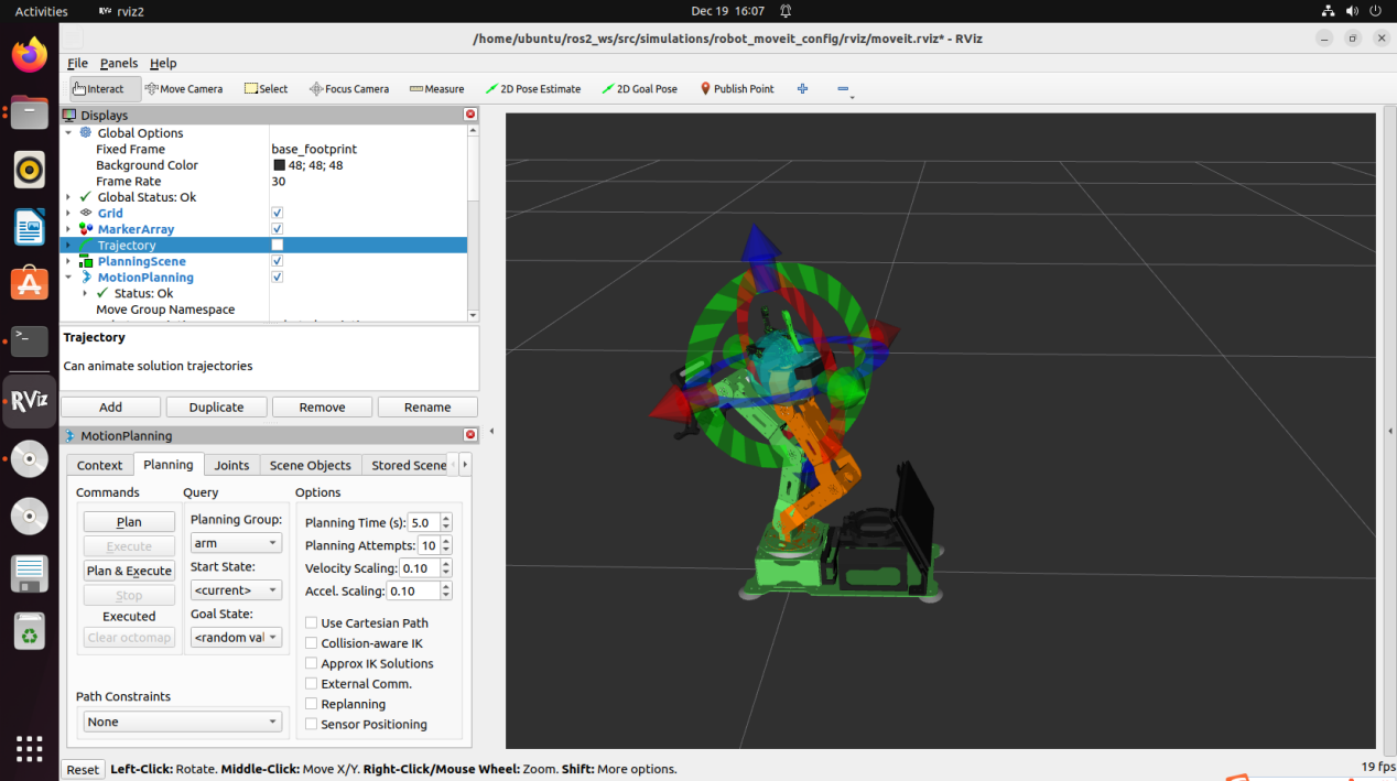

(6) Path Planning and Collision Detection: After successfully planning the robotic arm’s movement path, the new position will be indicated in orange. If there is a collision with other parts of the robot, the position will be marked in red. In this case, you need to adjust the pose to avoid collisions, or the action cannot be executed.
Orange indicates an executable position, as shown below:

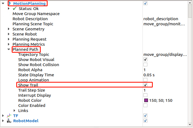

(7) Visualize the Motion Path: In the RVIZ toolbar, click Motion Planning and Planned Path, then check the Show Trail option. This will display the visual trail of each frame of the robotic arm’s movement.

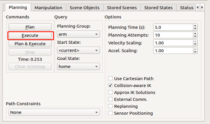

(8) Demonstrate the Movement Path: Return to the Planning section, and click the Plan button. The simulation model will demonstrate the path from the original position to the newly planned position.
(9) Execute the Planned Path: After observing the demonstration, uncheck the Show Trail option. Then, click the Execute button. The simulation model and the robot will simultaneously execute the planned motion.

(1) Important Notes
① Network Requirements: The virtual machine and the robot must be on the same network segment and able to communicate with each other in order to control the robot. Otherwise, only simulation is possible, and the robot will not execute the planned movements.
② Safety Precautions: Before starting, ensure there is enough space around the robot for movement. Maintain a safe distance from the robot during execution to prevent any collisions between the robotic arm and your body that could cause injury.

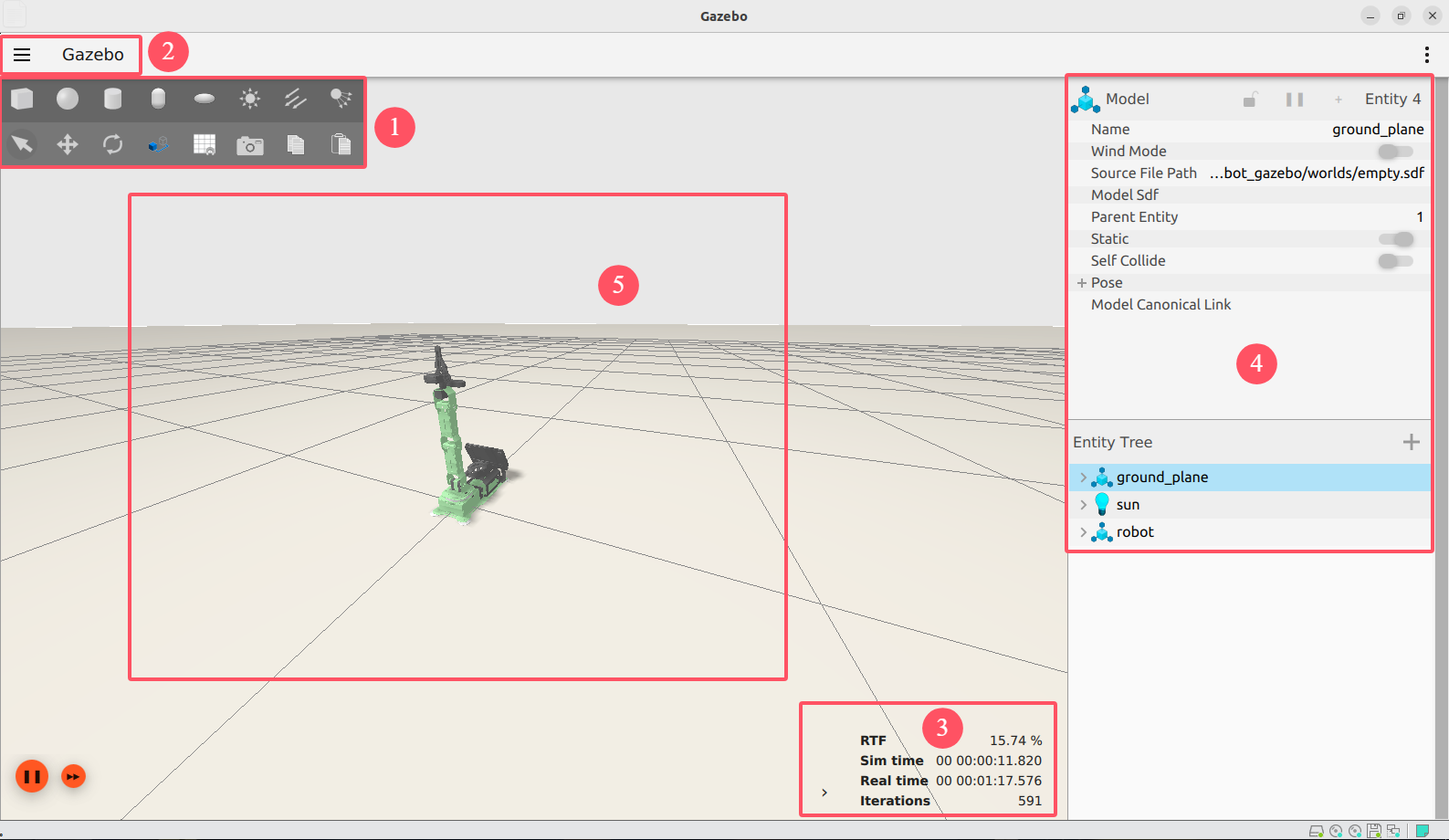

15.6.2 Gazebo GUI Introduction
The simulation software interface is as below:
The specific functions of each position are detailed in the table below:
Name Function
Tool bar (1) Provides commonly used options for interacting with the simulator.
Menu bar (2) Configures or modifies simulation parameters and offers interaction features.
Action Bar(3) Allows manipulation of models and adjustment of parameters.
Timestamp (4) Controls the time in the virtual environment.
Scene (5) The main part of the simulator where the simulation models are displayed.
For more information about Gazebo, please visit the official website: http://gazebosim.org/.

(1) Start the virtual machine. Click-on the system desktop icon to execute the command-line terminal.
(2) Execute the command below to access the configuration file.
(3) Fill in the corresponding parameters based on your machine type. After completing the entry, press Ctrl+S to save and close the file.
Different machine types correspond to different simulation models!
source ~/.bashrc

Toolbar Tools
We’ll explain a few tools from the toolbar using the following example:
(4) Selection tool : This is Gazebo’s default tool, used to select models.
(5) Move Tool : Use this tool to select a model and drag the three axes to control its movement.
(6) Rotate Tool : Use this tool to select a model and drag the three axes to control its rotation.

The MoveIt2 interface is shown below:
Position 1: RVIZ toolbar
① In the MoveIt2 Debugging Area, find and click on the Planning section.
② In the Simulation Model Adjustment Area, there are three colored arrows: red, green, and blue. Click and drag the arrows to adjust the robotic arm’s orientation. From the robot’s perspective:
Green represents the X-axis (positive direction is to the left of the robot).
Red represents the Y-axis (positive direction is in front of the robot).
Blue represents the Z-axis (positive direction is above the robot).
③ After successfully planning the arm’s motion path, the new position will be highlighted in orange. If the new position causes a collision with other parts of the robot, it will be marked in red. In this case, you need to adjust the position to avoid the collision; otherwise, the action cannot be executed.
Orange indicates an executable state, as shown below:
For example, if the robotic arm is positioned as shown in the image, it will collide with the depth camera, turning red (non-executable state) as shown below:
④ Once the path is planned, return to the Planning section and click Plan. The simulation model will demonstrate the movement path from the original position to the newly planned position.
⑤ Next, click Execute to make both the simulation model and the robotic arm follow the planned path.
⑥ Alternatively, click Plan & Execute, and the robotic arm will first display the newly planned movement path, then execute the motion.
⑦ You can also observe that the path planned in MoveIt2 is synchronized with the Gazebo interface.
(2) Gripper Control

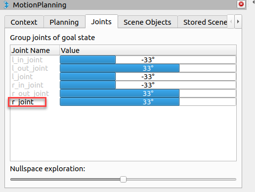

① To control the gripper movement, select gripper in the Planning Group.
② Drag the r joint to control the gripper’s rotation.
③ Once the motion trajectory is planned, return to Planning and click Plan & Execute to execute the movement.
