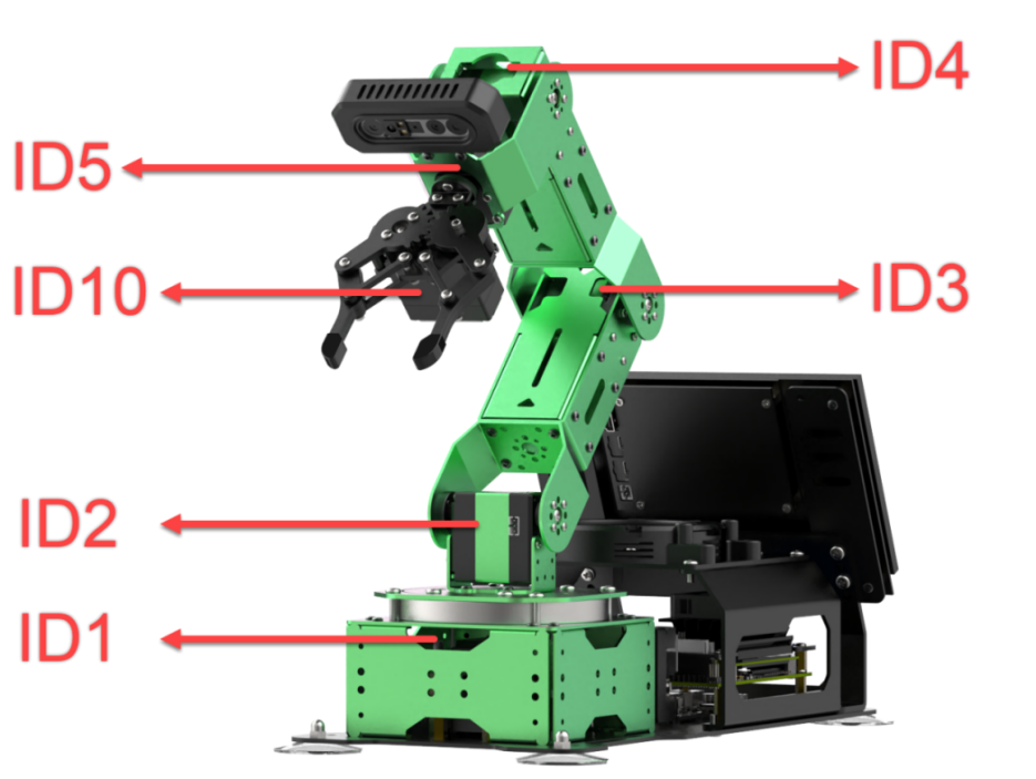

2.1 Servo Control Node
The robot arm is equipped with 6 servos, utilizes Jetson Orin NX as the controller, employs an STM32 microcontroller for communication, and implements servo control through the serial port. To facilitate and standardize servo control, it is essential to establish a ROS node as the interface for each servo.
2.1.1 Introduction to Servo Control Node

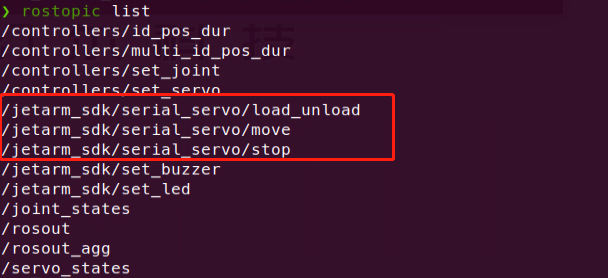

(3) Open a new terminal and run the command to display the topics published after the initiation of the robot arm node.
rostopic list
Topic Function
/jetarm_sdk/serial_servo/load_unload Power on/off servos
/jetarm_sdk/serial_servo/move Control servo movements
/jetarm_sdk/serial_servo/stop Terminate servo movement

servo_id: Adjustable from 1 to 5.
Position: Servo angle, ranging from 0 to 1000.
Duration: Time required for the servo to move to the specified position, measured in milliseconds.

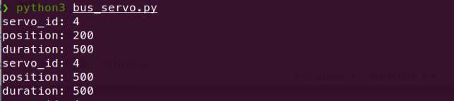

  • Python Control
(1) Run the command below in the terminal to initiate the robotic arm SDK file.
roslaunch jetarm_sdk sdk_node_6dof.launch
(2) Open a new command-line terminal and run the following command to navigate to the corresponding directory.
cd jetarm/src/jetarm_example/src/bus_servo/
(3) Next, enter the command to start the function, and you will see the servo motor 4 of the robotic arm rotating back and forth between angles of 200 and 500, with the servo topic information printed in the terminal.
python3 bus_servo.py

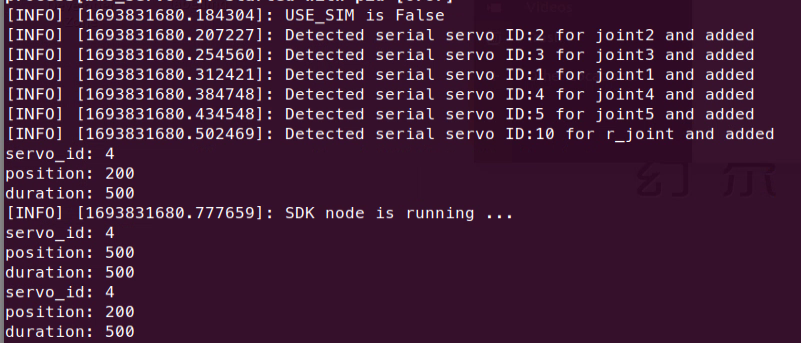

  • Launch File Control
(1) Double-click to initiate the command terminal and run the following command to disable the auto-start service.
(2) Execute the command to initiate the servo control. The buservo.py file will be invoked.
roslaunch jetarm_example bus_servo.launch
(3) After initiating the game, the No. 4 servo will rotate back and forth within the range of 200-500, and the servo topic information will be printed on the terminal.

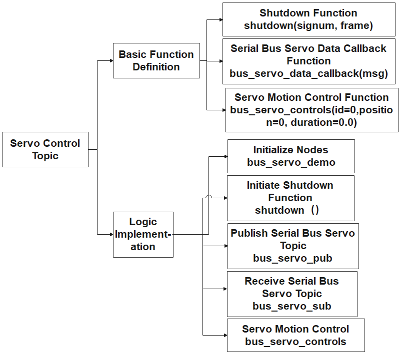

  • Python Program Analysis
The source code of the program is saved in /home/ubuntu/jetarm/src/jetarm_example/src/bus_servo/bus_servo.py.
The program logic flowchart is as below:
The diagram above illustrates the main structure of the program’s logic flow, highlighting the division into basic function definitions and implementation logic. Initially, the necessary functions for servo control are established. In the main function, nodes are initialized, interrupt functions are activated to detect signals, and relevant bus servo topics are both published and received. This information is then relayed to the servo control function, enabling effective servo control. The upcoming document will follow the structure outlined in the program’s logic flowchart above.
(1) Import Feature Package
By utilizing the import statement to bring in necessary modules, the rospy library serves as the Python client library for ROS. This library is essential for tasks such as crafting ROS nodes, managing message publication and subscription, and executing service calls. The ‘signal’ library, a standard Python module, is employed for signal handling. Furthermore, the hiwonder_interfaces.msg package encapsulates various message types, including the SerialServoMove message type specifically designed for serial communication with the robotic arm.
import rospy
import signal
from hiwonder_interfaces.msg import SerialServoMove
(2) Main Function

(5) Servo Motion Control Function
def bus_servo_controls(id=0, position=0, duration=0.0) is used to control serial bus servo’s movement. It contains the following parameters:
ID: Servo ID; Adjustable from 1 to 5.

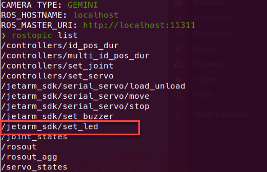

rostopic list
Topic Function
/jetarm_sdk/set_led Control LED to turn on or off

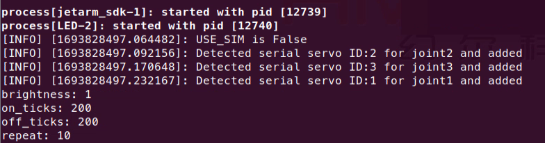

(2) Run the command to initiate the game. The LED on STM32 controller will flicker ten times then go off. The following parameter settings will be printed on the terminal.
python3 led.py

(3) After the game starts, the LED on the STM32 controller will flicker 10 times then go off. The terminal will print the following parameter settings.

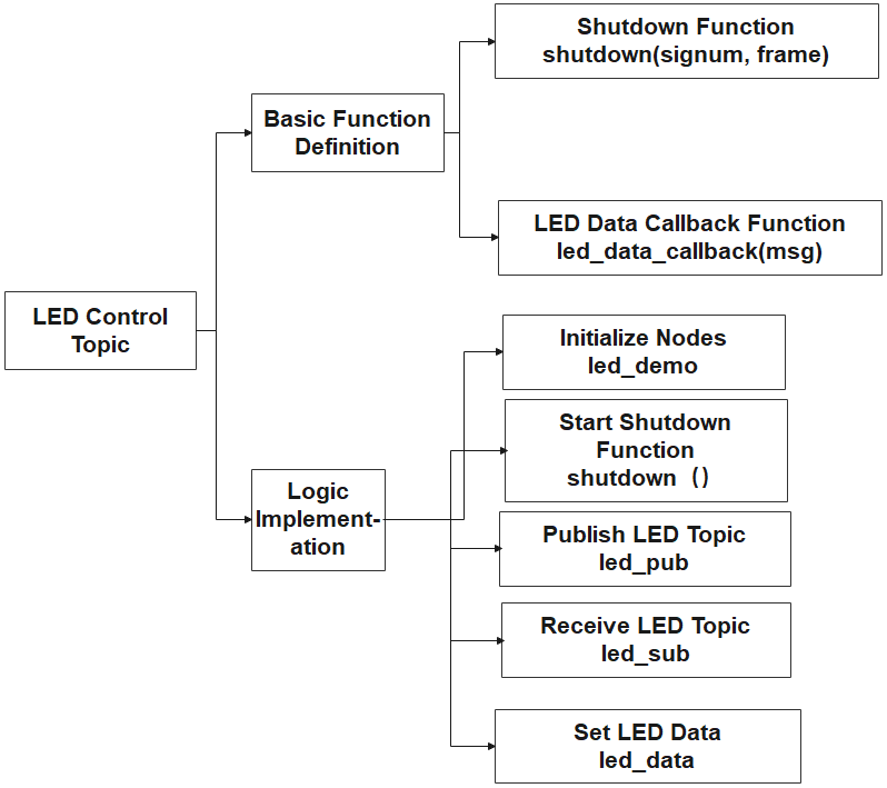

The source code is stored in jetarm/src/jetarm_example/src/LED/LED.py
The program’s logic flow, as illustrated above, is mainly categorized into basic function definitions and implementation logic. Initially, the functions required for LED control are defined. Subsequently, within the main function, nodes are initialized, interrupt functions are activated to detect interrupt signals, and relevant topics for the LED are both published and received. The control of the LED is accomplished by configuring parameters related to LED information. The forthcoming document will adhere to the program’s logic flowchart outlined above.
Import the necessary modules using the import statement. The rospy library is the Python client library for ROS, used to write ROS nodes, publish and subscribe to messages, and execute service calls.
The ‘signal’ import is a standard Python library for handling signals.
ubuntu_interfaces.msg is a package containing message types, including the SerialServoMove message type used for the robotic arm’s serial communication.
import rospy
import signal
from hiwonder_interfaces.msg import Led
(2) Main Function

    led_data.off_ticks= 200 #亮的间隔(bright interval)
    led_data.repeat = 10#重复的次数(repetition times)
    while running:
        led_pub.publish(led_data) #发布LED数据(publish LED data)
        rospy.sleep(1) # 延时,防止一直发布数据(delay, to prevent continuously publish data)
        if led_data_detection:
① Initialize the node.
if __name__ == '__main__':
    rospy.init_node('led_demo', anonymous=True) #初始化节点(initialization node)
② Establish the signal handling function, triggering the shutdown function upon the reception of an interrupt signal (Ctrl+C).
    signal.signal(signal.SIGINT, shutdown)
③ Publish and receive LED topic.
    # 发布LED话题(publish LED topic)
    led_pub = rospy.Publisher('/jetarm_sdk/set_led', Led, queue_size=1)
    # 接收LED话题(receive LED topic)
    led_sub = rospy.Subscriber('/jetarm_sdk/set_led', Led, led_data_callback)
④ Configure the following parameters to enable the LED to flicker.
    led_data = Led()
    led_data.brightness = 1  #LED ID
    led_data.on_ticks = 200  #亮的时间(bright time)
The variable led_data represents the message type Led()for the LED light.
The parameter brightness corresponds to the LED’s ID, with the onboard LED on the 32 main control board assigned the ID 1.
The on_ticks parameter indicates the duration of LED illumination in milliseconds, set to 200ms in this case.
The off_ticks parameter represents the duration of LED extinction in milliseconds, set to 200ms here.
The repeat parameter signifies the number of repetitions for the LED on/off sequence, set to 10 repetitions in this instance.
⑤ When the running variable is set to True, the loop will be continuously executed.
    while running:
In the loop, publish the LED’s data information led_data (with the parameters set earlier). Subsequently, introduce a 1-second delay to prevent data retransmission. Then, check if led_data_detection is True (when the ‘on_ticks’ in the message, representing the LED’s illumination time, is 0, ‘led_data_detection’ is set to True), and exit the loop.
(3) self.shutdown Function
Interrupt function within the program, designed to stop the execution. When the program receives an interrupt signal, it sets running to False ,and prints shutdown upon completion.
def shutdown(signum, frame):
    global running
    running = False
    rospy.loginfo('shutdown')
    rospy.signal_shutdown('shutdown')
(4) LED Data Callback Function
Define a callback function to handle received messages. It takes one parameter, msg r,epresenting the received message. Declare led_data_detection as a global variable. In the function, when a message is received, it checks if on_ticks (the LED light-up time) in the message is not empty. If it is not empty, led_data_detection is then set to True. This is used to check whether the received message contains valid data.
# LED数据回调函数(LED data callback function)
def led_data_callback(msg):
    global led_data_detection
    if msg.on_ticks != 0: #判断该话题的启动时间是否为0(check if the start time of the topic is zero)
        print(msg)
        led_data_detection = True

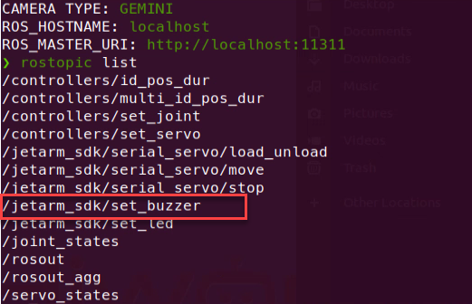

Topic Function
/jetarm_sdk/set_buzzer Control buzzer to turn on or off

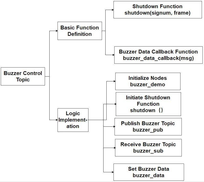

The program logic flowchart is depicted as below:
From the diagram above, the program’s logic flow is primarily divided into basic function definitions and implementation logic. First, the functions needed to control the buzzer are defined. Then, in the main function, nodes are initialized, interrupt functions are activated to detect interrupt signals, relevant topics for the buzzer are published and received. Buzzer control is then achieved by configuring parameters related to the buzzer information. The content of the following document will be written following the aforementioned program logic flowchart.
