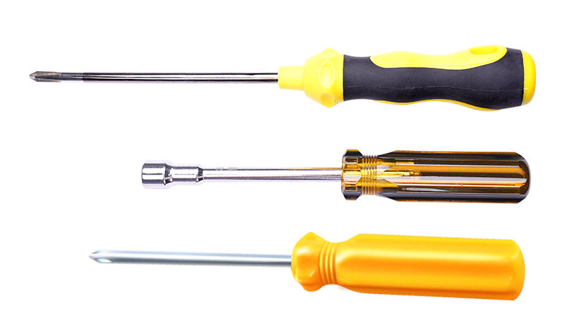

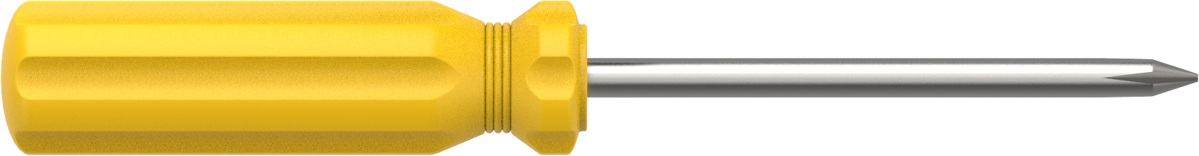

5 Screwdriver 1

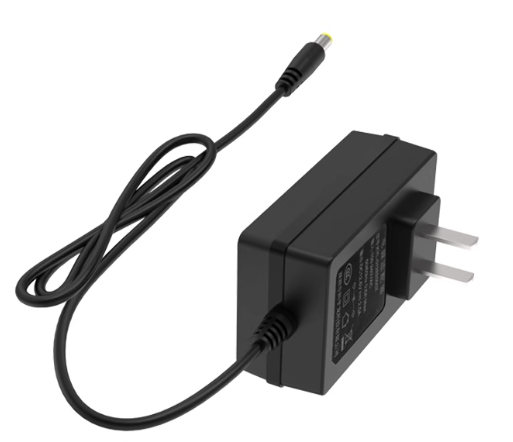

2 12.6V 2A charger 1

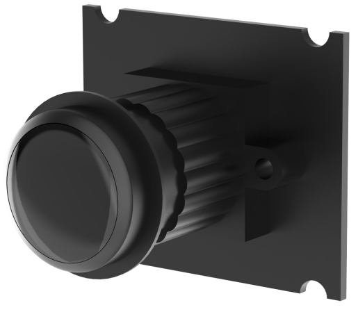

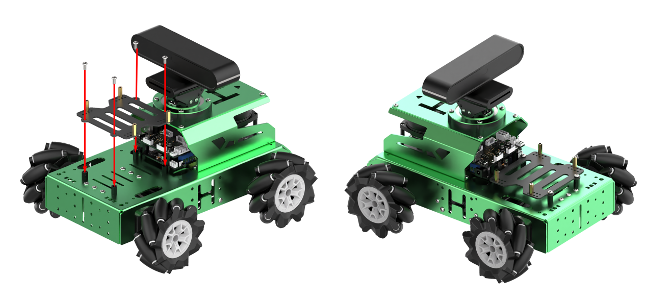

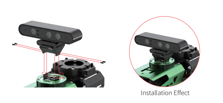

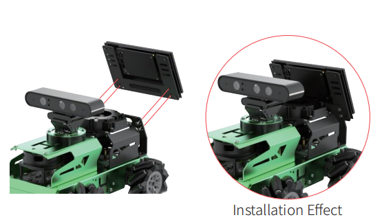

1.2.1 Install Depth Camera
  • JetAuto Version

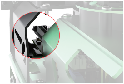

(1) Snap the front of 3D depth camera into the slot on bracket.
(2) Align camera bracket’s holes with those on 3D depth camera. Then secure these two components together with M3*6 flat-head machine screw.
The lens is facing the front of robot.
(3) Thread the depth camera cable through the controller casing.

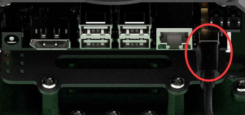

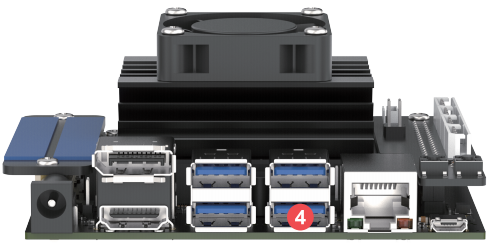

(4) Connect the depth camera to the port 4 on Jetson Nano board.
This section uses Jetson Nano version as an example. For detailed wiring instructions, please refer to “2.5 Wiring Instructions”.

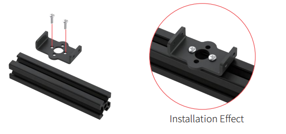

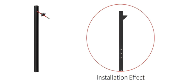

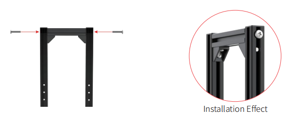

  • JetAuto Pro Version
(1) Use M6*6 round head machine screws to attach two columns onto the corner braces at the back of robot.
(2) Fasten two columns onto the chassis with M5*20 round machine screws.
(3) Attach corner brace to the top of each column using M5*20 round head machine screws.
(4) Fix the beam to corner braces with M5*20 round head machine screws.
(5) Secure columns and beam together with M6*25 round head machine screws.
(6) Install the camera bracket on the beam with M3*15 round head machine screws.
(6) Mount 3D depth camera onto camera bracket with M3*6 round head screws.

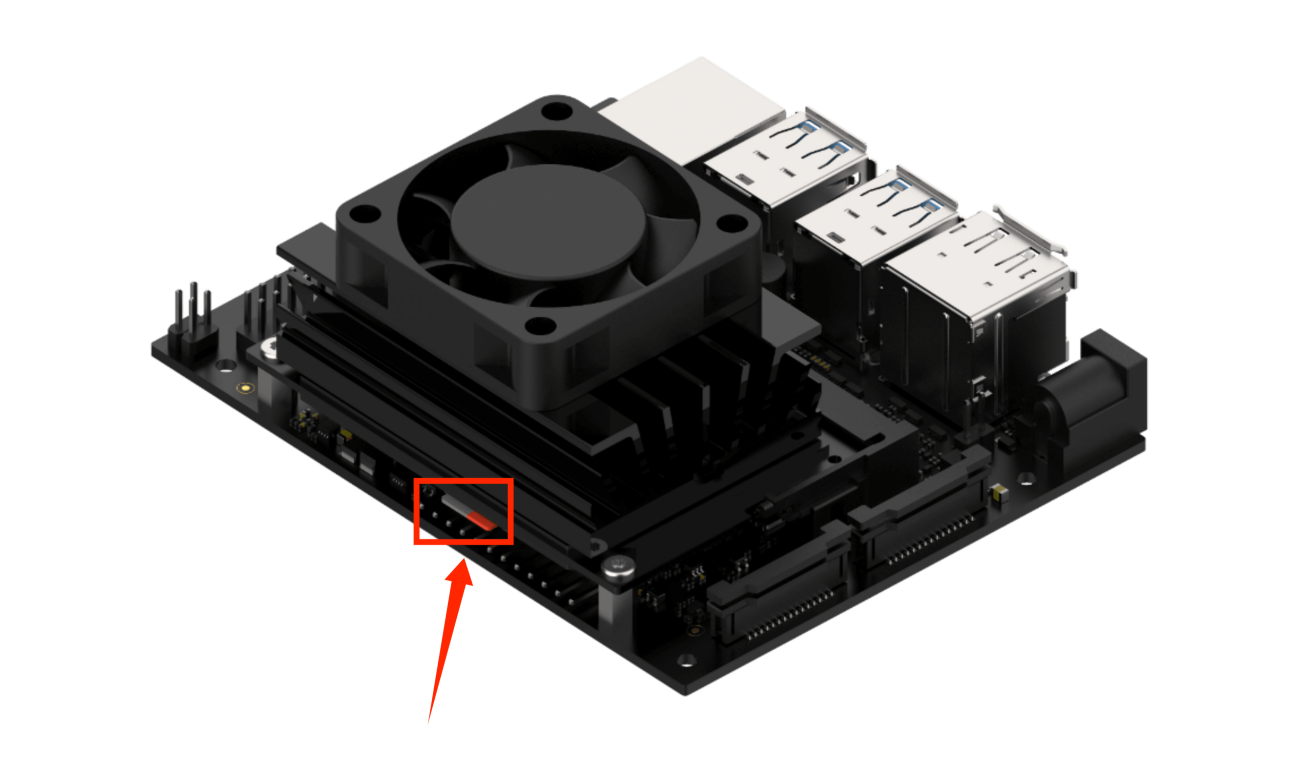

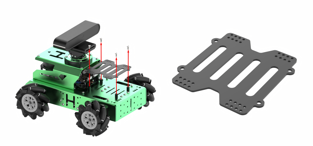

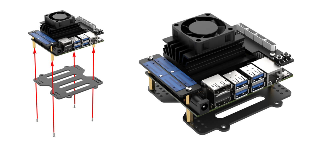

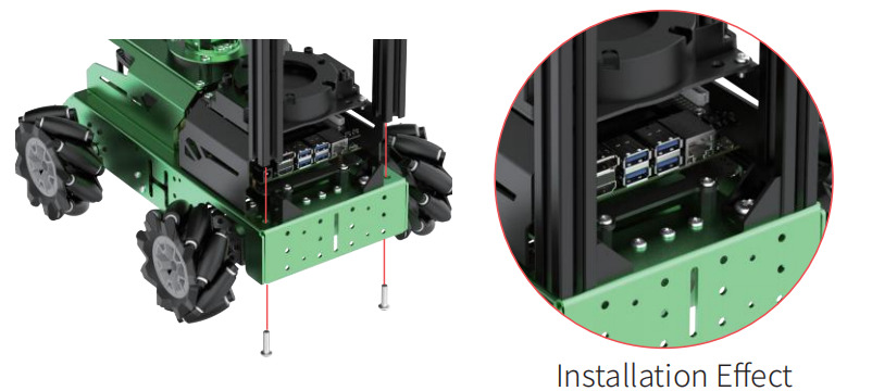

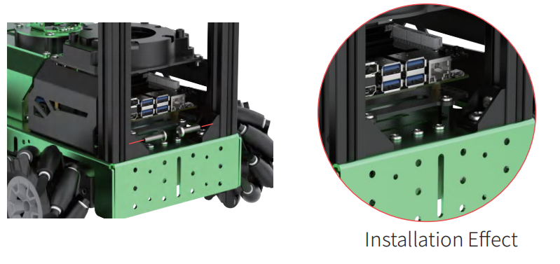

1.2.2 Install Control Board (Applicable to the robot version without Jetson Controller)
  • Jetson Nano Control Board

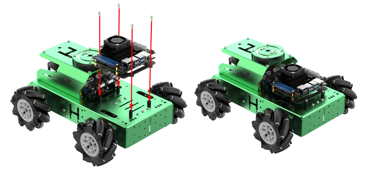

(1) Fix the main control board with M2.5*8+6 single-pass copper columns and M2.5*12 double-pass copper columns, then attach the antennas and expansion board to the main control board with M2.5*6 round head machine screws.
(2) Use a screwdriver to remove four M4*6 round head screws on the main control board adapter plate, as shown on the right figure below.
(3) Attach the main control board to the adapter plate with M2.5*6 round head screws.
(4) Use the M4*6 round head screws removed in step 2) to secure the adapter plate to the single-pass nylon columns.

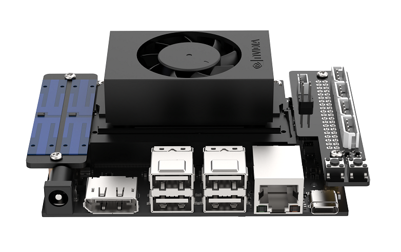

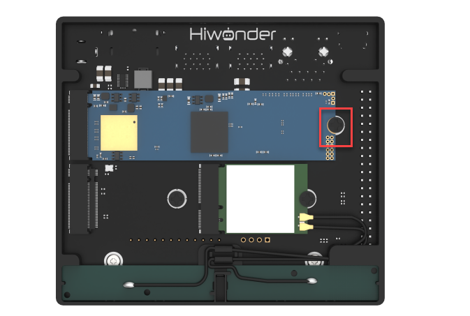

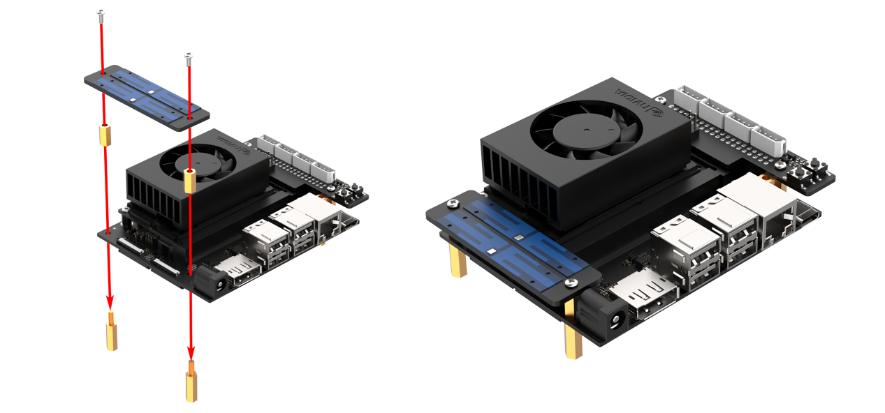

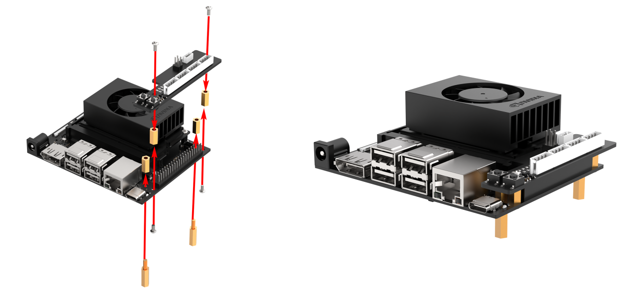

  • Jetson Orin Nano/Jetson Orin NX Control Board
(1) Attach the expansion board onto the main control board using M2.5*8+6 single-pass copper columns, M2.5*12 double-pass copper column and M2.5*6 round head screws.
(2) Secure the antennas with M2.5*8+6 single-pass copper columns, M2.5*12 double-pass copper columns and M2.5*6 round head screws.
(3) Use a screwdriver to remove the four M4*6 round head screws on the adapter plate.
(4) Attach the main control board to the adapter plate with M2.5*6 round head screws.
(5) Use the M4*6 round head screws removed in step 3) to secure the adapter plate to the single-pass nylon columns.

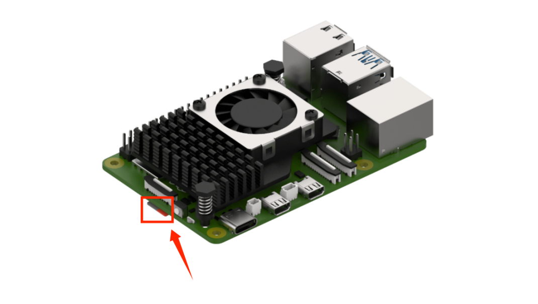

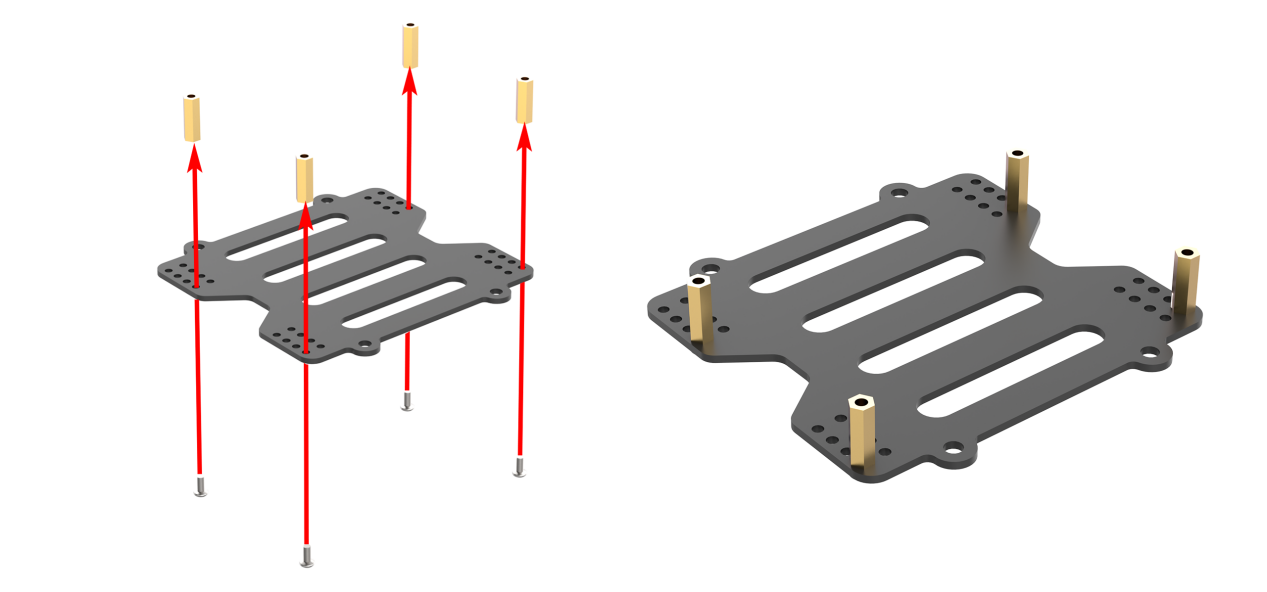

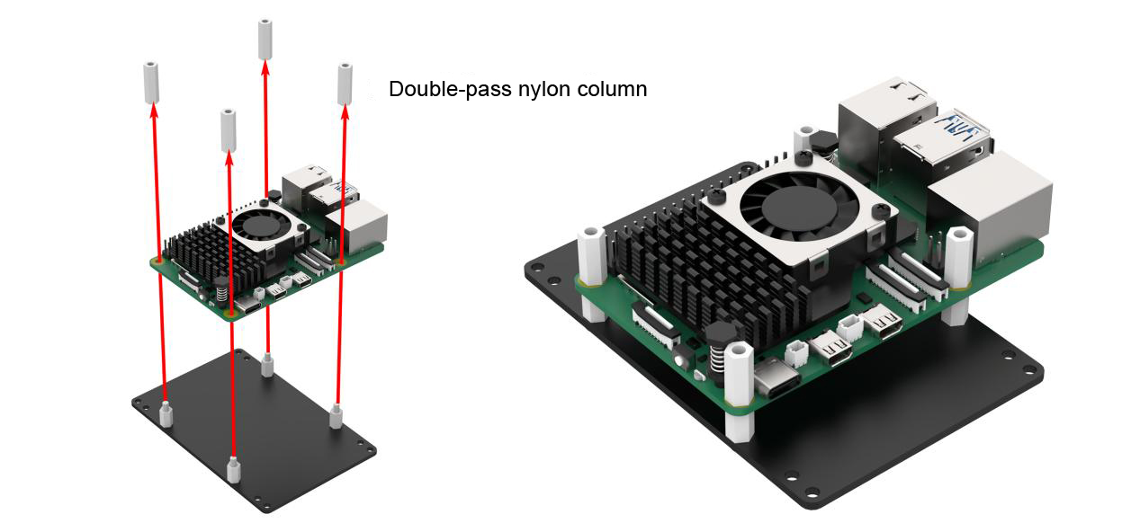

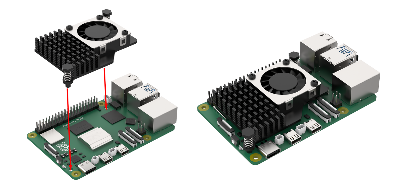

  • Raspberry Pi5 Control Board
(1) Use a screwdriver to remove the four M4*6 round head screws on the adapter plate.
(2) Mount the M2.5*12 double-pass copper columns on the adapter plate with M2.5*6 round head screws.
(3) Use the M4*6 round head screws removed in step 1) to secure the adapter plate to the single-pass nylon columns.
(4) Secure the four M2.5*5+6 singe-pass nylon columns to the adapter plate using M2.5*6 round head screws.
(5) Press down firmly on the push-type screw of the heat sink to mount it on the main board.
(6) Attach the main board to the adapter plate using double-pass nylon columns.
(7) Insert the expansion board into the pins of Raspberry Pi 5.
(8) Attach the adapter plate to the robot with M2.5*6 round head screws.

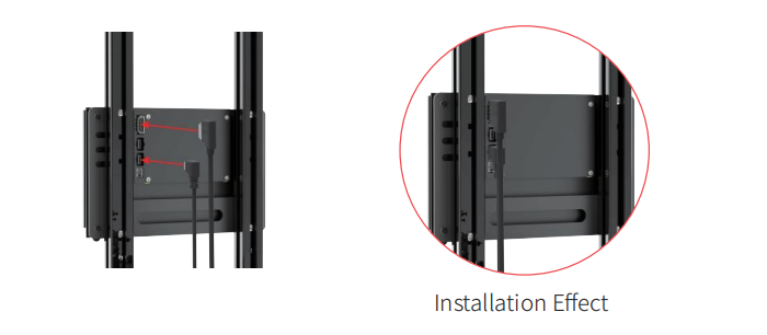

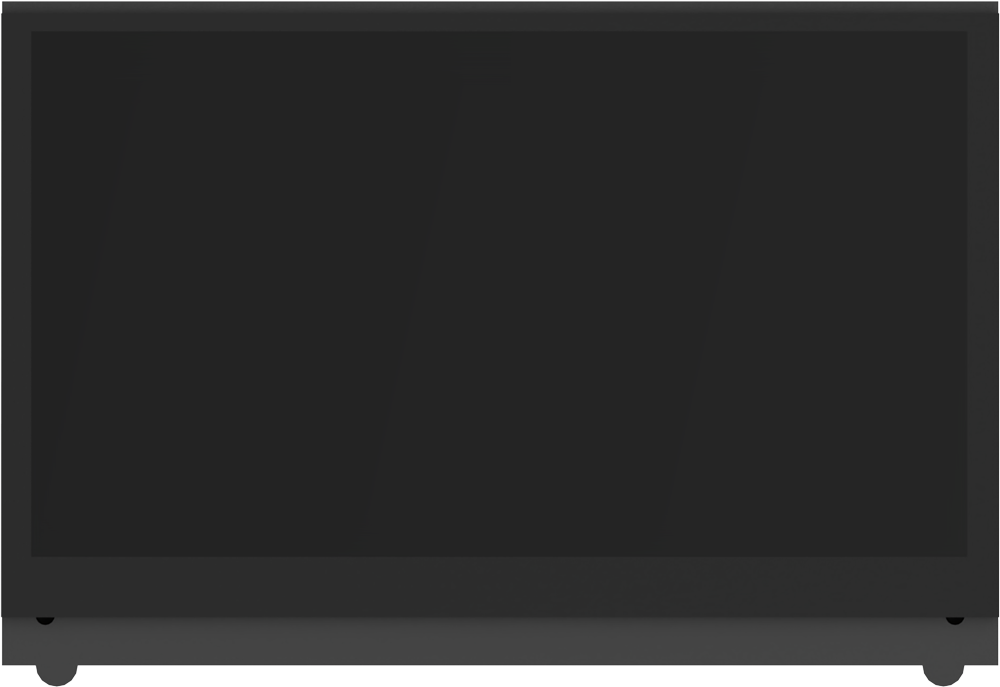

1.2.3 Install 7-inch LCD Screen
  • JetAuto
(1) Install 7-inch LCD screen to columns with M4*20 round-head machine screws.

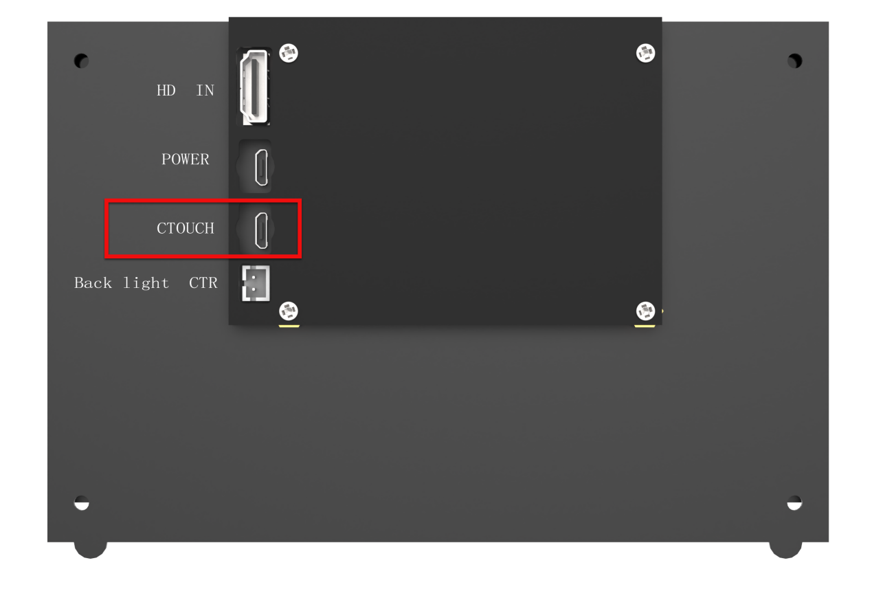

(2) Connect HDMI cable to HDMI interface on the 7-inch LCD screen, and connect power cable to CTOUCH port.
7-inch LCD screen doesn’t support touch control if the cable is not connected to CTOUCH port.
  • JetAuto Pro
(1) Install 7-inch LCD screen to columns with M4*20 round machine screws.

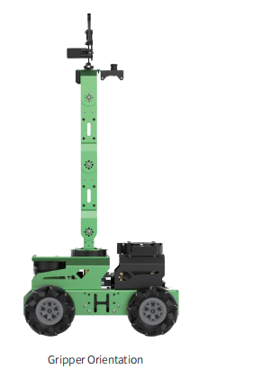

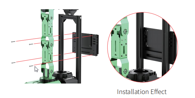

1.2.4 Install Robotic Arm(JetAuto Pro)
(1) Attach the robotic arm to pan tilt with M3*6 round head machine screws.
Gripper should face towards the front of the car.
(2) Connect the servo wires of the robot arm to the corresponding ports as pictured.

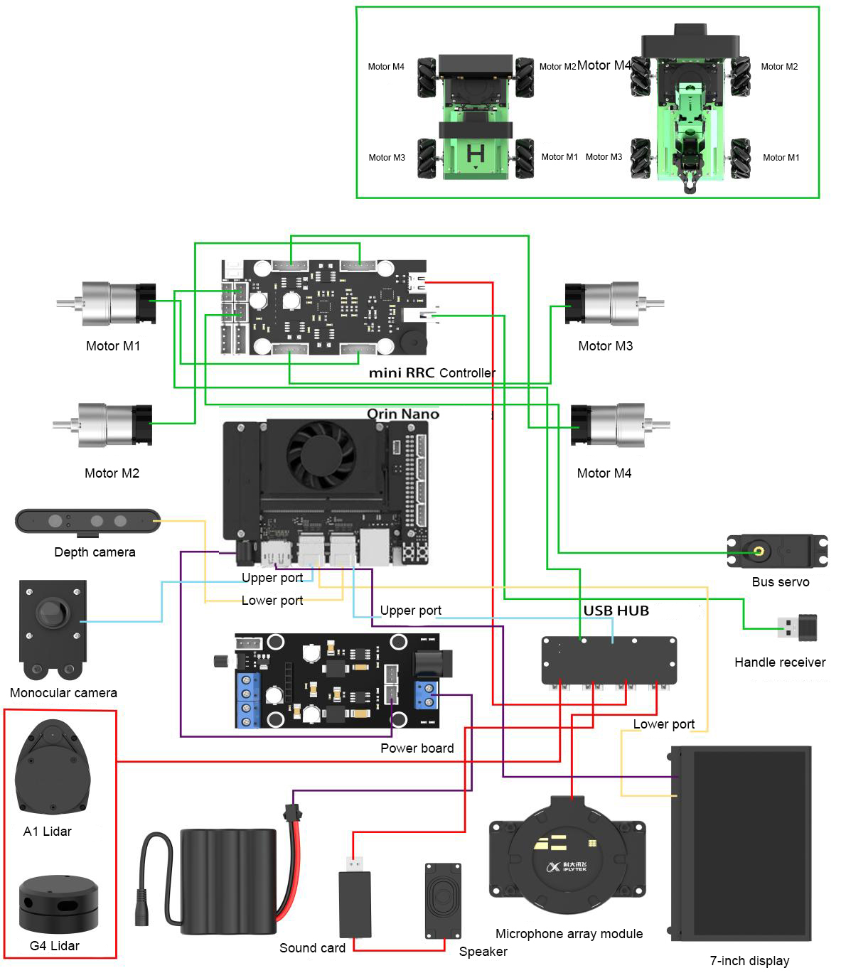

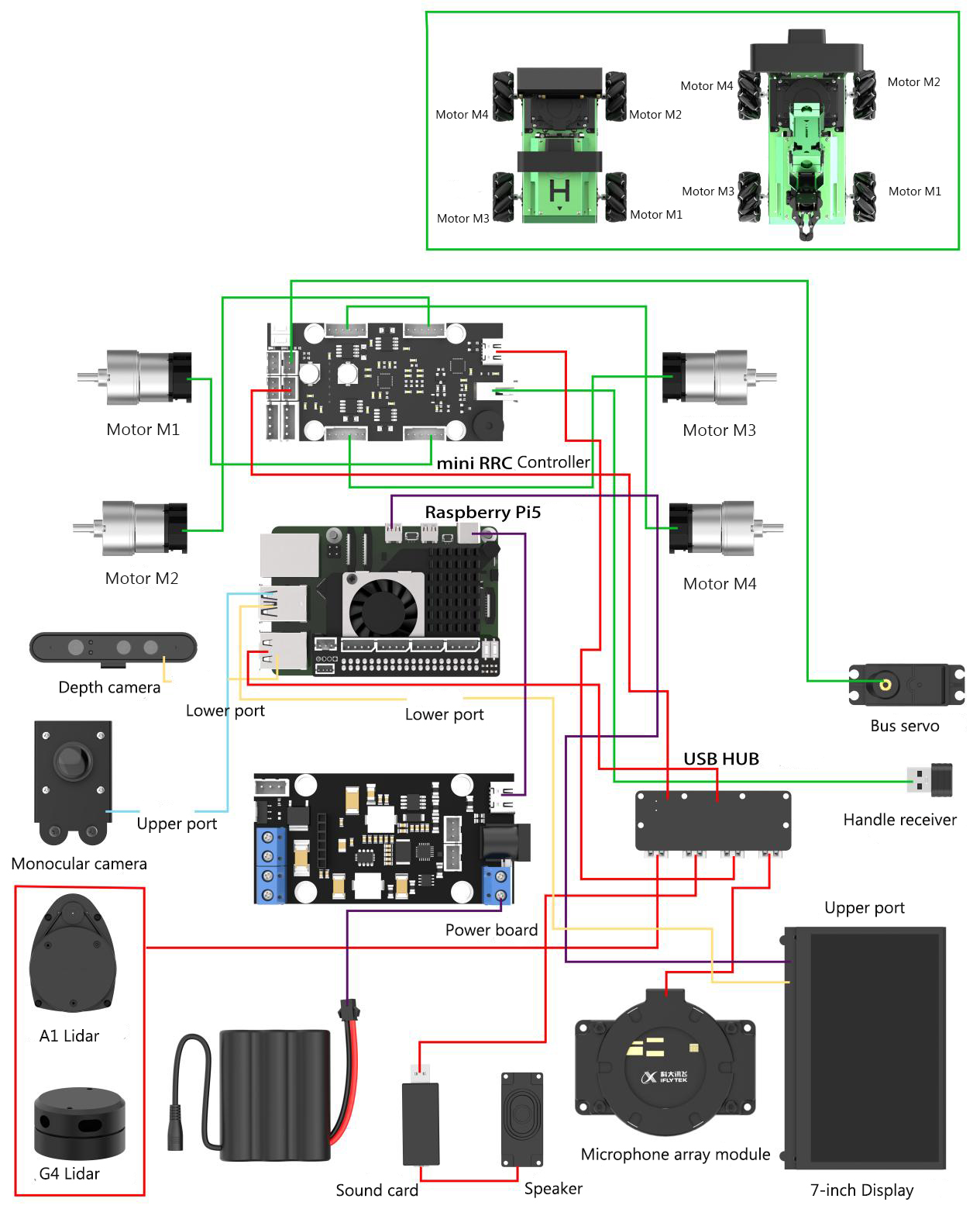

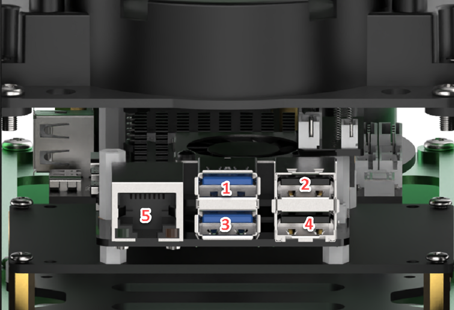

1.2.5 Wiring Instructions (Key Points)
Upon receiving the robot, it is necessary to follow the wiring tutorials below to connect the control board. Each accessory must be properly connected its corresponding port; otherwise, the robot’s functions will not work properly.

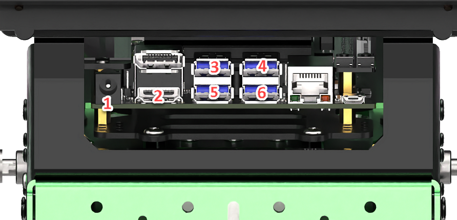

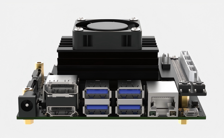

  • **Wiring Instructions(Jetson Nano Controller) **
Please refer to the table below and connect each accessory to its corresponding port on Jetson Nano board. If any of the listed accessories are not included in your kit, please ignore the corresponding port number.
NO. Name

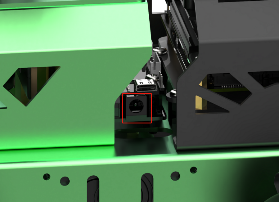

1 Jetson Nano Main Controller Power Supply Interface (DC round head cable)
2 Display HDMI Interface
Reserved Custom Expansion Interface
(Monocular camera connection for JetAuto Pro version)
4 USB Hub Communication Interface
5 Display Power Supply Interface
6 Depth Camera Interface

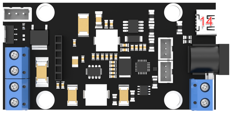

  • USB HUB
NO. Name
7 Lidar port
8 Speaker port
9 Communication port of Mini STM32 controller
10 Microphone array port
Jetson Nano communication port
(connected to port 4)
USB HUB power supply port
(supplied by mini STM32 controller)

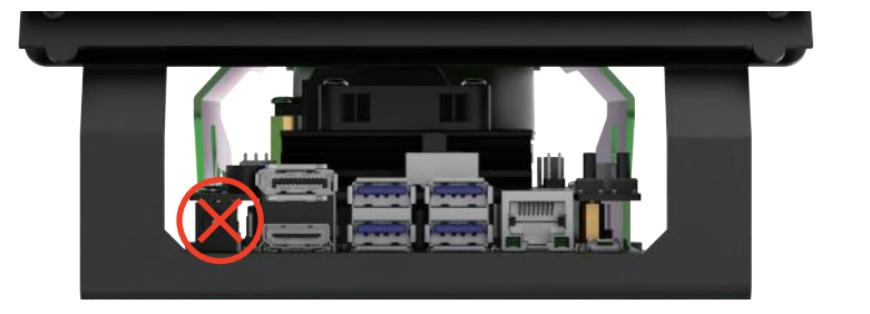

  • Wiring Instructions(Jetson Orin Nano/Jetson Orin NX Control Board)
Please refer to the table below and connect each accessory to its corresponding port on Jetson Orin Nano board and USB hub. If any of the listed accessories are not included in your kit, please ignore the corresponding port number.
NO. Name
Jetson Orin NX Main Controller Power Supply Interface
2 Display HDMI (convert to DP) Interface
(For JetAuto Pro version, connect the monocular camera here)
  • USB HUB
NO. Name
7 Lidar port
8 Speaker port
11 Jetson Orin Nano communication port (connected to port 4)
(power supplied by mini STM32 controller)

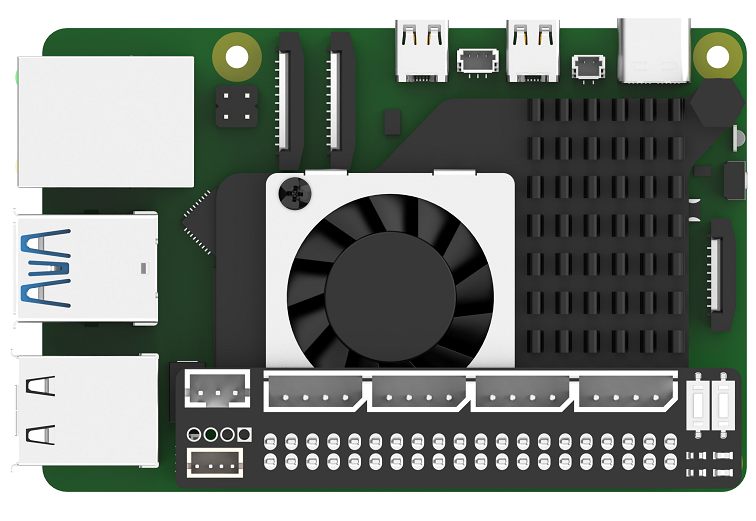

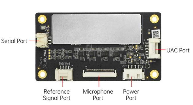

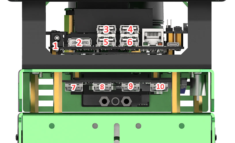

  • **Wiring Instructions(Raspberry Pi 5 Control Board) **
Please refer to the table below and connect each accessory to its corresponding port on Raspberry Pi 5 board and USB hub. If any of the listed accessories are not included in your kit, please ignore the corresponding port number.
NO. Name
2 USB Hub Communication Interface
3 Display Power Supply Interface
4 Depth Camera Interface
5 Ethernet Interface
NO. Name
6 Lidar port
7 Speaker port
8 Communication port of mini STM32 controller
9 Microphone array port
10 Raspberry Pi 5 communication port (connected to port 2)
11 USB HUB power supply port (supplied by mini STM32 controller)
NO. Name
12 Power supply for ROS main controller (Raspberry Pi)
13 Micro HDMI interface (connect to the HDMI interface of the 7-inch LCD display)
No. Name
(Connected to port 12)

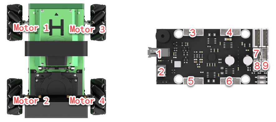

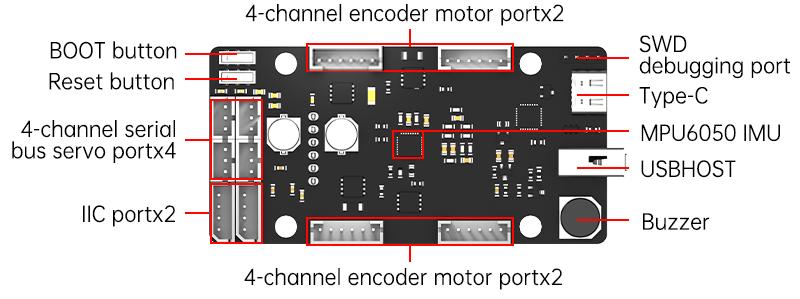

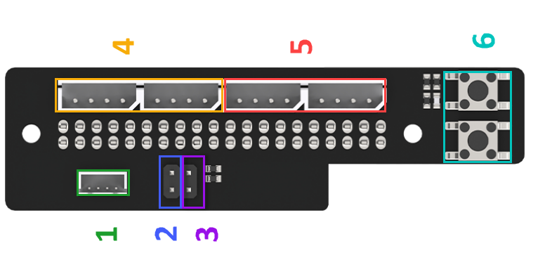

  • Mini STM32 Controller
NO. Name
1 Remote Controller Signal Receiver
3 Motor 1
4 Motor 3
5 Motor 2
6 Motor 4
7 Pan-Tilt Servo
8 Power Supply for USB Hub
9 Robotic Arm Bus Servo (JetAuto Pro)

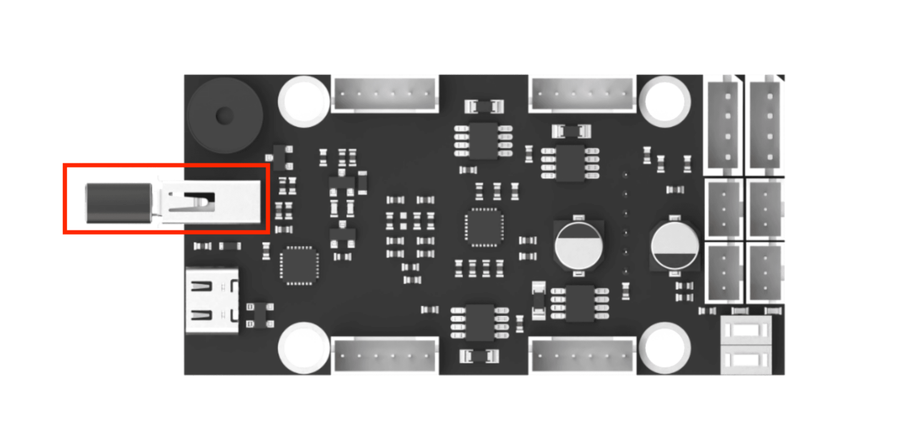

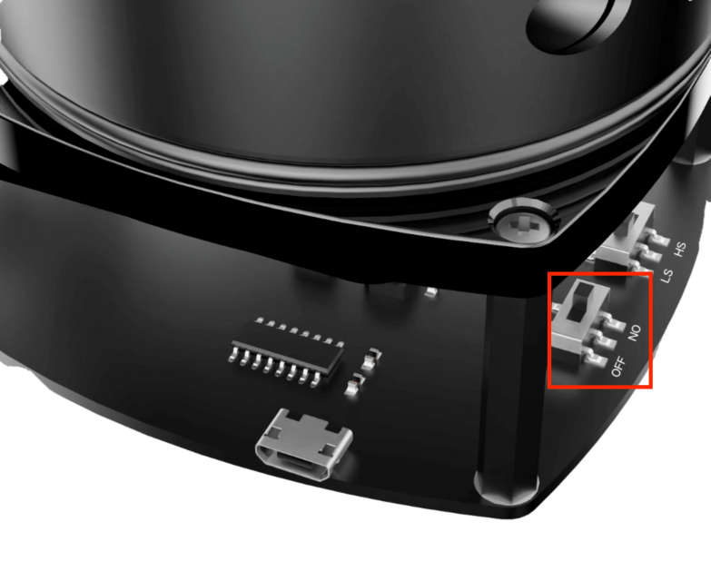

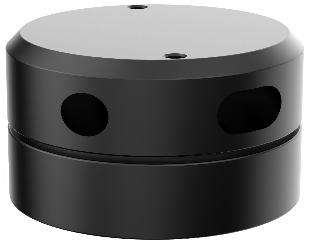

(8) In terms of Lidar, different Lidar models also have different performances when starting up. The left image below is A1 Lidar and the right is the G4 Lidar:
If you choose the ultimate kit with Lidar G4, the Lidar will spin for a few round, then stop until the robot boots up successfully.

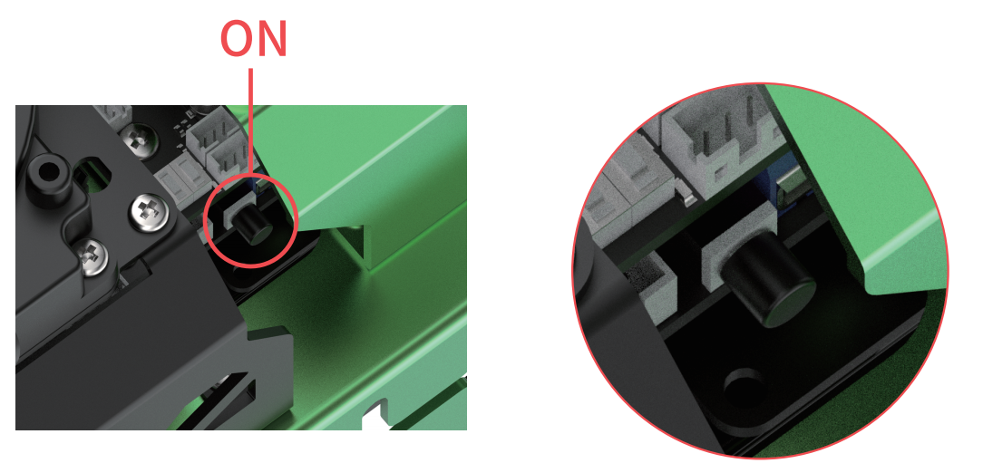

For other robot kits with Lidar A1, you need to push the switch to the “ON” side. The Lidar will continue to rotating after a short period of time after being turned on.

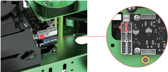

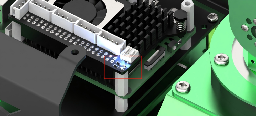

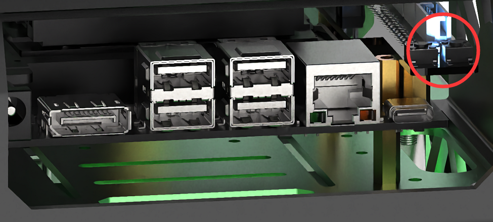

1.3.2 Robot Startup State & Testing Instruction
(1) Press the switch.
(2) After 20-30s, LED1 on expansion board flashes blue. When buzzer emits a beep, this means both ROS configuration and device are ready for use.
  • The LED indicator for Jetson Nano, Jetson Orin Nano and Jetson Orin NX versions is as pictured:
  • The LED indicator for Raspberry Pi5 version is as pictured:

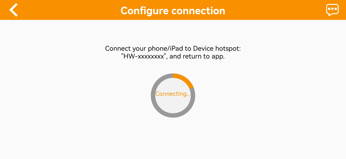

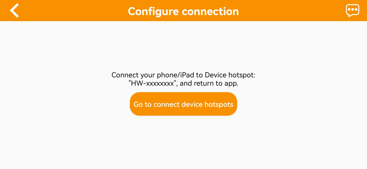

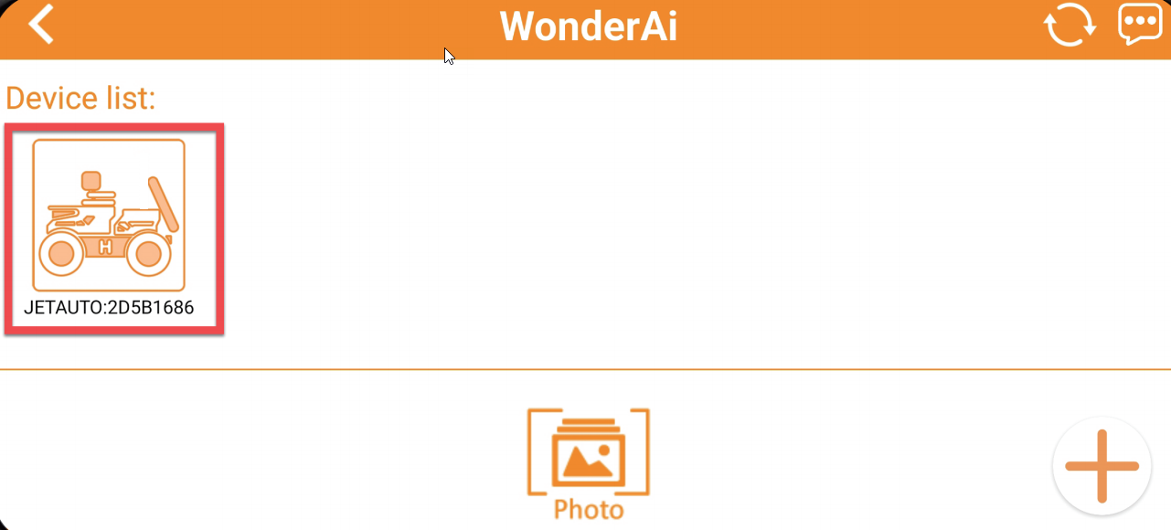

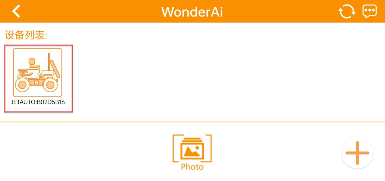

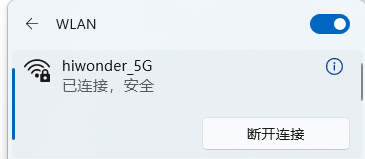

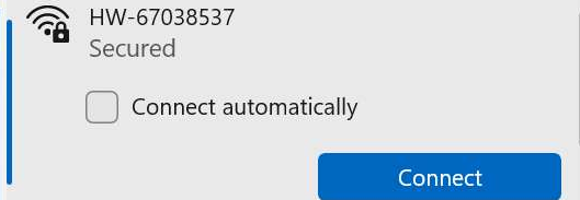

(3) After robot boots up successfully, robot is default to AP direct connection mode and generates a WiFi starting with “HW”. The initial WiFi password is “hiwonder”.
If you can not find the generated WIFI, please troubleshoot from the following:
  • Follow above three steps in “Robot Startup State & Testing Instruction” for troubleshooting.

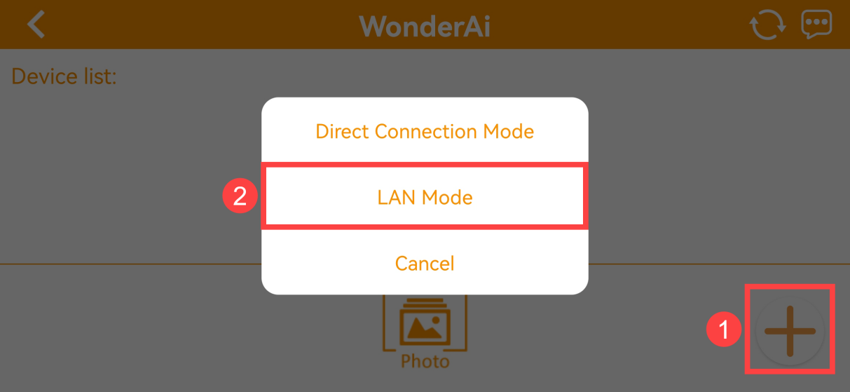

  • If the LED1 on expansion board is flashing blue and keeps on, it may be set to LAN mode. In this case, please press and hold the Key1 button for 5-10 seconds. If LED1 starts flashing, indicating that a WI-Fi starting with “HW” is generated.
  • If the KEY1 button doesn’t start flashing after the above operation, SD card or SSD may not be detected, try re-inserting the SD card or SSD.
  • If the LED1 on expansion board always remains on after re-inserting the SD card or SSD, it may indicate an issue with the SD card or SSD.

Please refer to the below table to test the hardware modules:
Module Operation Outcome
LED on expansion board Observe the LED status The robot is set to AP direct connection mode by default. The flashing blue LED indicated that the network service configuration has been completed.
Buzzer Examine the short beep A short beep from the buzzer indicates that the onboard hardware of the expansion board are functional.

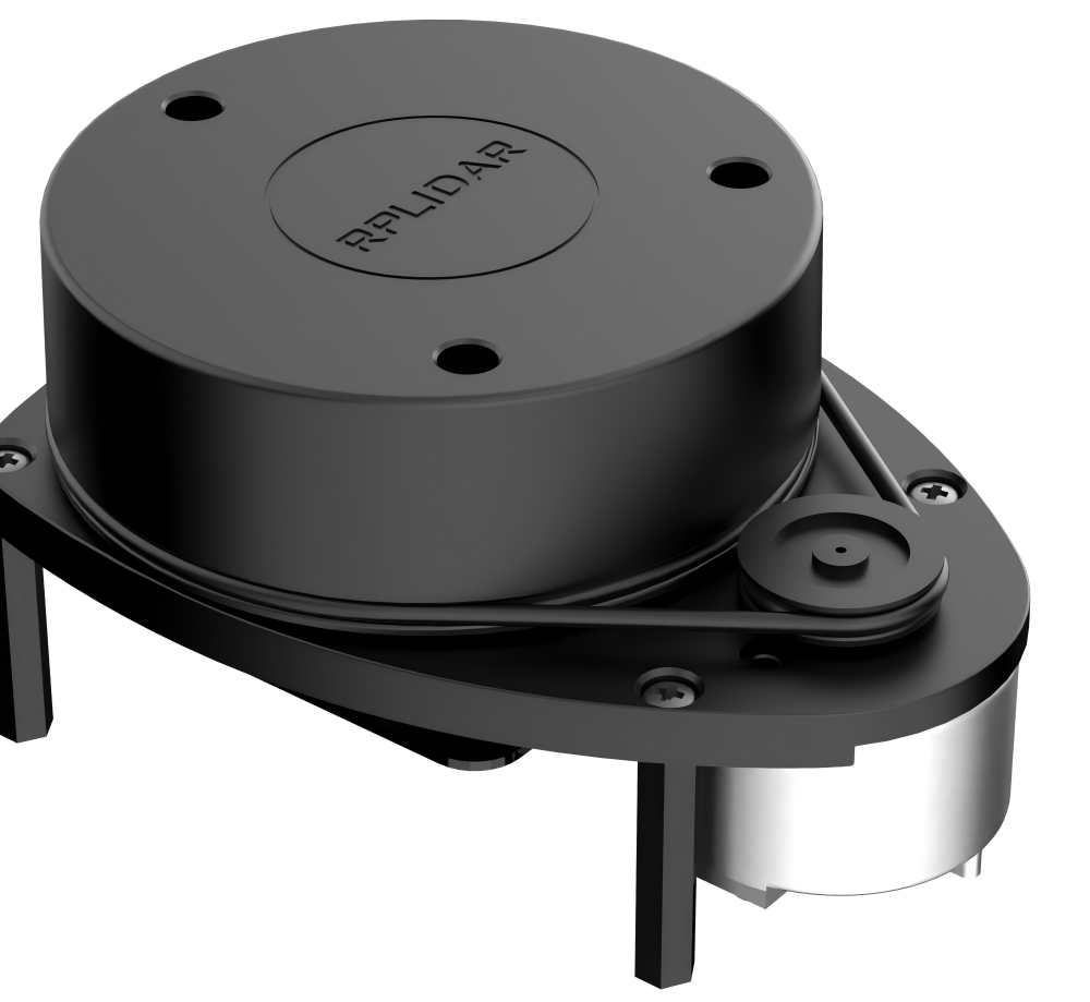

Lidar Observe the rotation status (1) Lidar G4: Upon initial startup, it will rotate for a few round, then stop. After the robot startup is complete, it resumes rotating.
(2) Lidar A1: it will keep rotating after a brief wait following startup.
7-inch HD touch screen Tap the icons on system desktop to confirm the following:
(1) Whether the HDMI cable is connected normally.
(2) Whether the power cable is connected to the C-TOUCH interface of the screen.
The screen can display the system desktop and can be touched normally.
KEY1 button on expansion board Switch the network status After connecting to STA LAN mode via app, long press KEY1 and then check if LED1 indicator flashes.

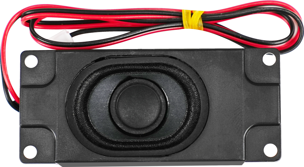

Microphone, sound card, speaker After turning on the robot, say "Hello, Hiwonder". The robot responds "I' m here". (the voice function is only targeted for the user who purchased advanced kit and ultimate kit.)
Depth camera + robotic arm (1) Connect to the robot via app.
(2) Open "Robot Control" to view the live camera feed from the depth camera.
(3) Swipe the screen to simultaneously control the servo on the pan-tilt.
(4) Slide the robot arm control buttons for controlling each joint's servo.
Display the live camera feed and rotate.

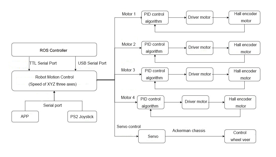

STM32 controller + DC encoder geared motor After robot powers on, perform the "Robot control" function on app using the wireless handle or mobile phone to check the hardware functions. Robot is able to operate normally.

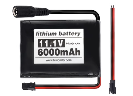

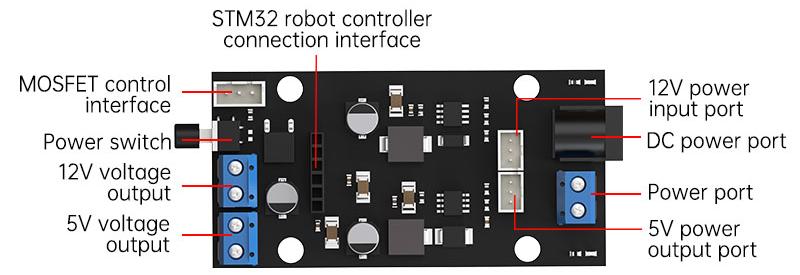

1.4 Charging Instructions and Battery Usage Guide
It is mandatory for the robot to disconnect power cables during transportation, and the battery is not fully charged. Before the first use, users need to connect the battery wires and then proceed with charging. The charging duration is approximately 3 hours. Charging the robot from 10V to 12.3V takes approximately 3 hours.
1.4.1 Charging Instructions

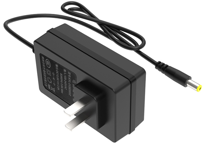

(1) Charge battery with the provided charger. Turn off the switch on the power supply board and never use it while charging
(2) Indicator on charger changes green when it connects to battery but not plugged into a power outlet. Indicator turns green after the battery is fully charged.
(3) Do not directly connect the charger to DC power port of Jetson Nano board, otherwise the board will be burned.
(4) Unplug charger in time to avoid overcharging.
(5) If battery voltage drops below 10V, the buzzer will sound an alarm. Please charge the battery promptly.
(6) In case robot won’t be used in a long period of time, please fully charge battery first, then disconnect battery wires.
(7) Always keep battery in cool and dry environment, otherwise battery lifespan gets shortened. Never intentionally hit, throw or step on your Lipo battery.
(8) Avoid using the battery in environments with strong static electricity or a strong magnetic field, as this may damage the safety protection device of the battery.
(9) Do not plug the battery into a power outlet, and do not use metal objects to connect the positive and negative poles of the battery.
(10) If robot won’t be used in a long period of time, please fully charge battery.
(11) It is strictly prohibited to modify, weld, or convert battery charger or Lipo battery.
(12) Keep battery away from high temperature and liquid to prevent overheating, fire and damp, which result in function decline.
Warning
please strictly follow the guide. Our company is not responsible for any product damage, economic losses and accident caused by improper use.
1.4.2 Charging Operation
(1) Make sure the switch is in the closed position.
(2) Connect the battery wires ensuring that each wire matches its corresponding color.
(3) Connect the special charger to DC port of the power supply board.
(4) Red indicator means robot is being charged. It will turn green after robot is fully charged. It takes about 4 hours to fully charge the battery.
Please unplug the charger in time once battery is fully charged to avoid overcharging.

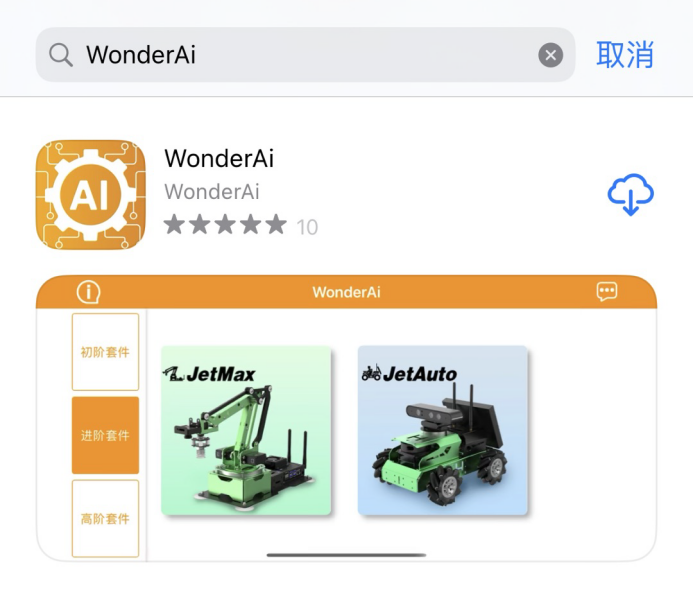

(1) Android user: WonderAi
(2) iOS user: you can download “WonderAi” in App Store.

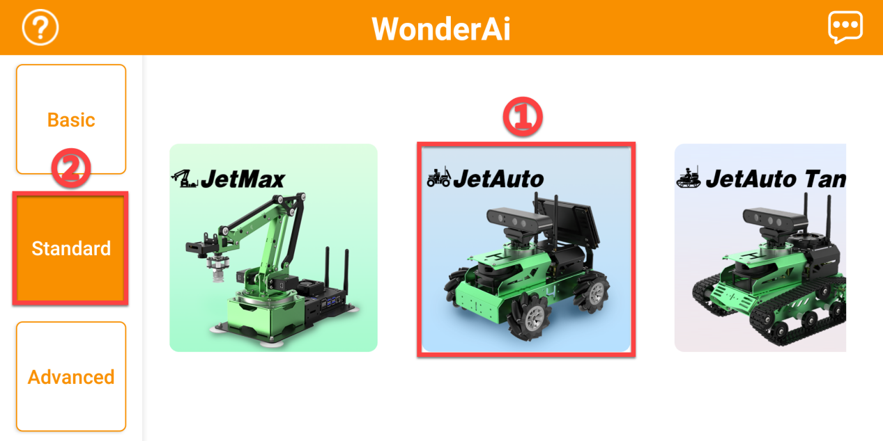

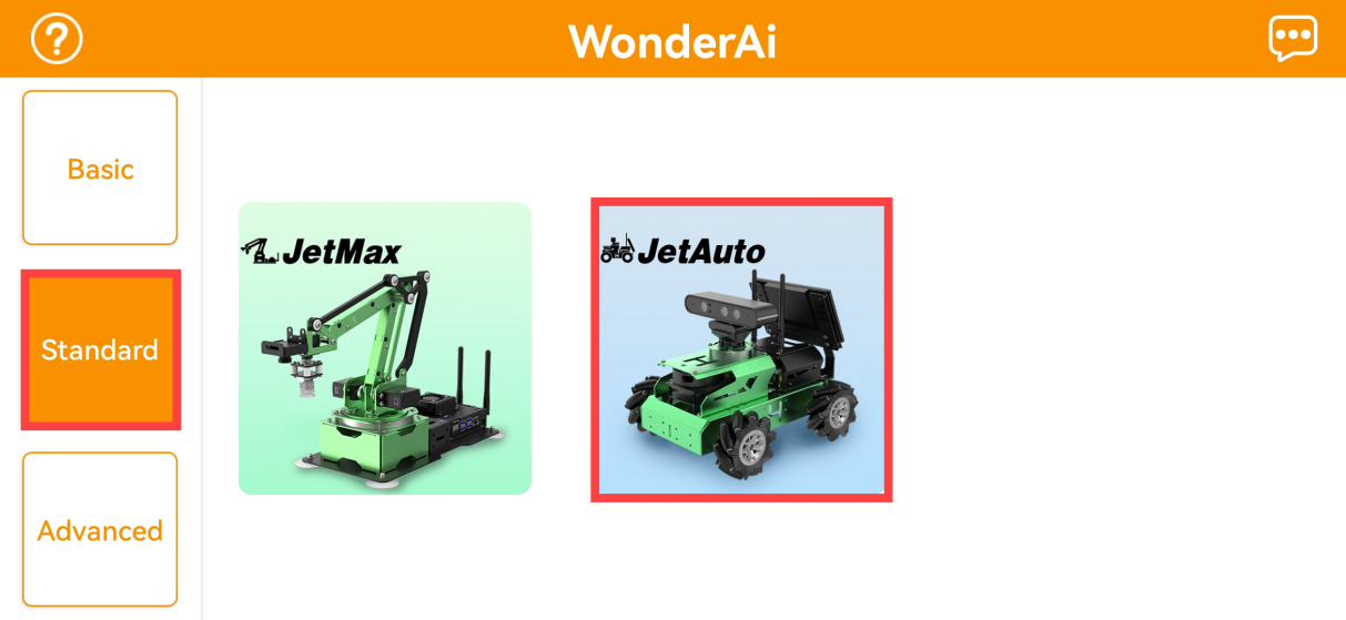

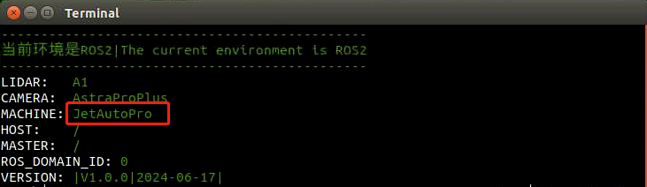

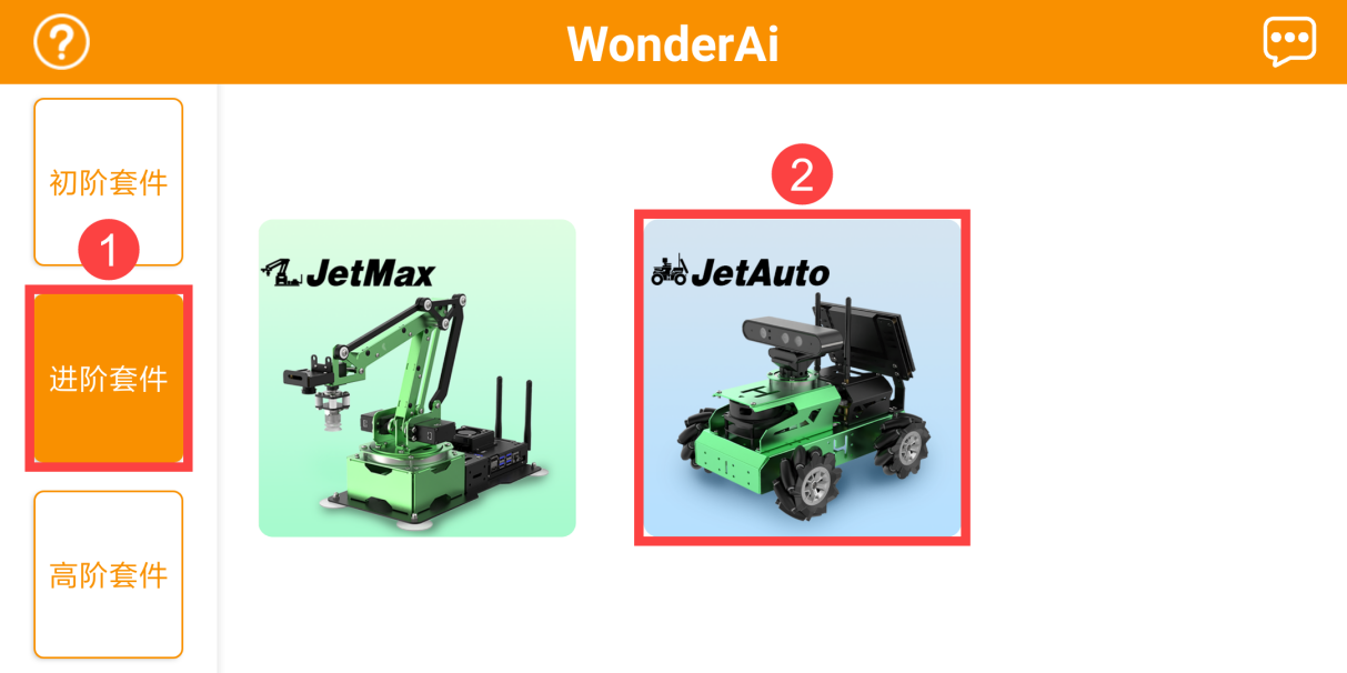

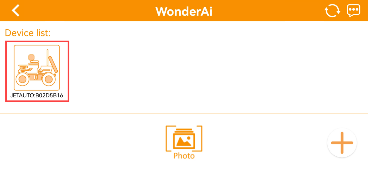

① Open “WonderAi” APP, then tap “Advanced->JetAuto” in sequence.(If you’re using JetAuto Pro, please choose “Advanced ->JetAuto Pro”)
② Click “+” button, and select “Direct Connection Mode”.
If you want to connect robot under LAN modem, please refer to “1.5.1 Preparation -> LAN Mode Connection (Optional)”.

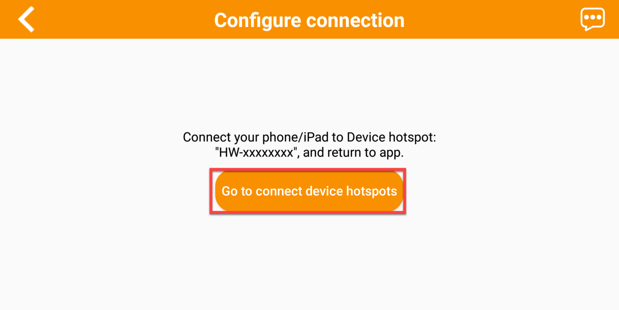

③ Next, click “Go to connect device hotspots” to join the WiFi generated by JetRover.
④ The device WiFi starts with “HW” and the password is “hiwonder”.
For iOS user, please do not return back to the APP until the WiFi icon appears above, otherwise JetAuto cannot be searched. If JetAuto cannot be searched, please click to refresh.
⑤ Return to the APP, and click the robotic icon to enter home interface.
If you are informed of “No Internet Connection. Whether to keep connection”, just select “Keep Connection”.

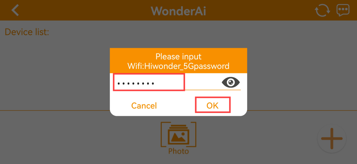

(2) LAN Mode Connection (Optional)

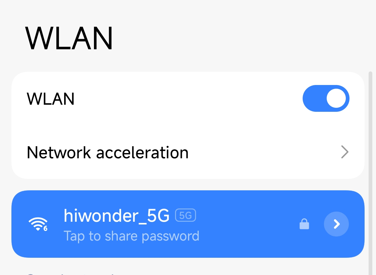

① Firstly, join 5G network, for example “Hiwonder_5G”. (The router supporting dual-frequency will distinguish the Wi-Fi name by default under the situation that 2.4 G and 5G are separated. For example, Wi-Fi “Hiwonder” is 2.4 frequency band while “Hiwonder_5G” is 5G frequency band)
② After connection, open WonderAi. Then click “Advanced->JetAuto” in sequence. (If you’re using JetAuto Pro, please choose “Advanced->JetAuto Pro”)
③ Click “+” button at the lower right corner, then select LAN Mode.
④ Continue, enter the Wi-Fi password. Having entered the password, click “OK”. Please ensure the password you enter is correct.
⑤ Click “Go to connect device hotspots”.
⑥ Join the WiFi starting with HW, and input the password “hiwonder”. After connection, return back to the APP interface.
⑦ In this point, WonderAi APP is connecting to the robot.

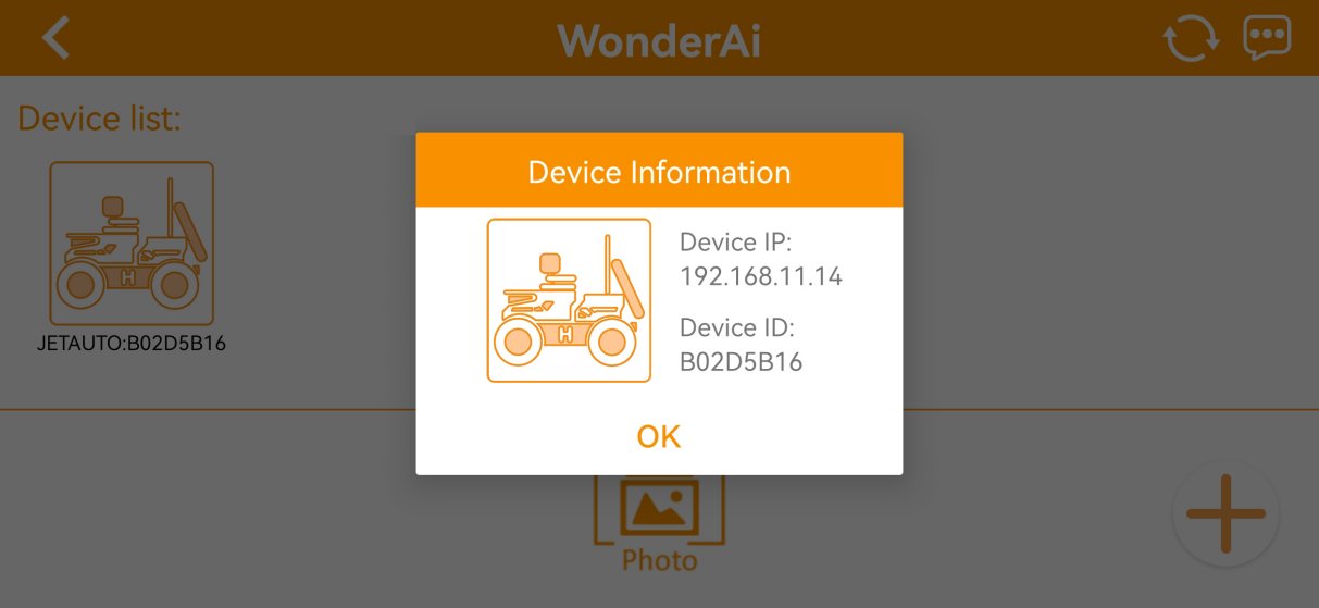

⑧ After a while, the robotic icon will show up. And at the same time, LED1 on the expansion board will light up.
⑨ By long pressing the robotic icon, you can check the IP address and ID.

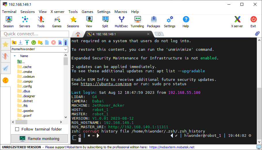

⑩ You can search for its IP address through the remote connection tool and establish a connection. For detailed instructions, please refer to “1.6 Development Environment Setup and Configuration”.
⑪ To switch from LAN mode back to direct connection mode, press and hold the KEY1 button on the expansion board until the blue light flashes, indicating the switch is complete.

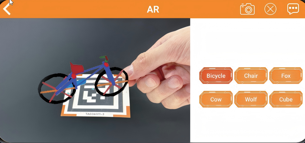

AR The tag can display the set 3D image within the live camera feed.

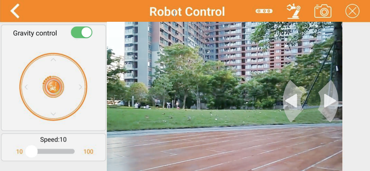

1.5.2 Robot Control

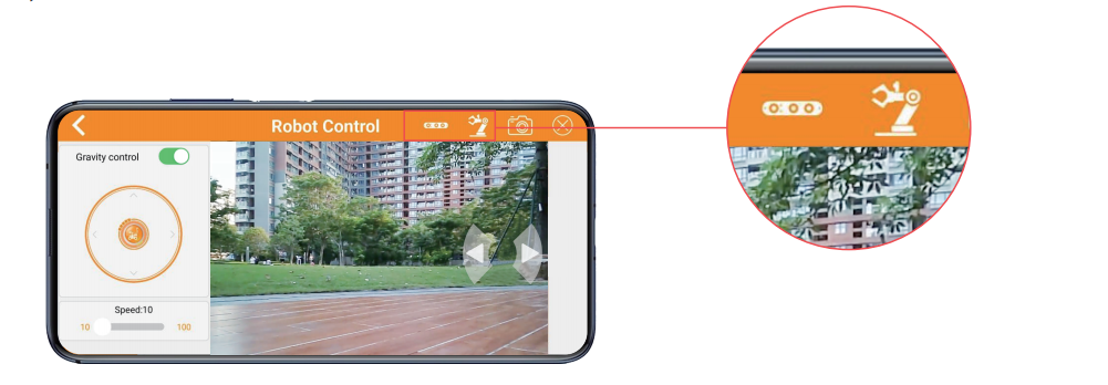

(1) Tap “Remote Control” in the game selection interface to enter the operation interface.
(2) If connected with a JetAuto Pro, the interface will differ slightly from the current one shown above. It will include an additional function, a switch function between the monocular camera, depth camera, and robotic arm control, as pictured:
(3) The functions corresponding to the remote control icons are outlined in the table below. By clicking the corresponding icons, you can control the robot’s motion in real-time.
Icon Function
Turn on/ off gravity control mode.
Drag the center button to control the robot to move in all direction.
Reminder: when controlling the robot, users determine the direction from the robot's first-person perspective to determine, not based on the live video camera on the right side of the app.
Adjust the robot speed ranging from 10 to 100
Make the robot turn left and right.

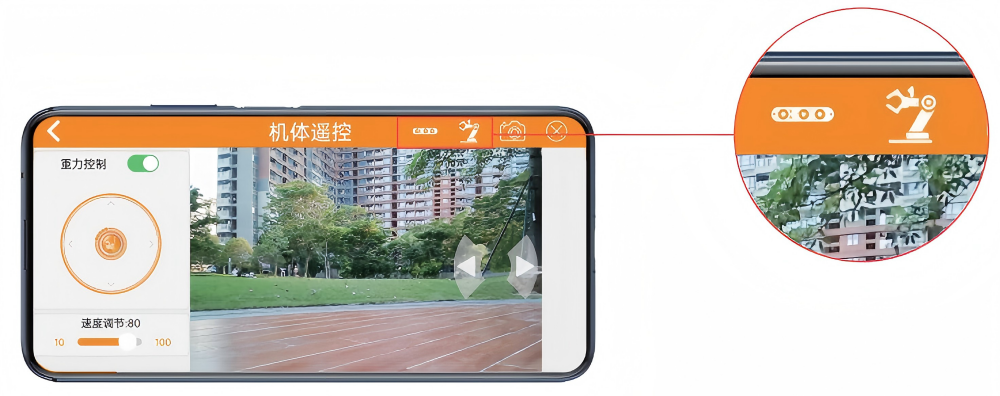

Display the current camera view. You can control the pan-tilt servo to turn left and right by dragging the screen.
(JetAuto Pro only) The camera can be switched bwteen the monocular camera and 3D depth camera.

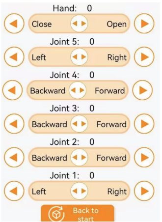

(JetAuto Pro only) display the robotic arm operation interface
After turning on “Gravity Control” mode, hold your phone horizontally with the screen up. Then tilt your phone forward, backward, right and left, and the robot will move in the same direction.

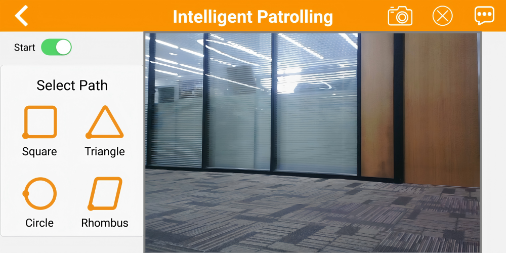

1.5.4 Intelligent Patrolling
  • This game is not supported on JetAuto Pro version.
  • Before starting the activity, please place the robot on a spacious platform to ensure it has enough room to move around.
Click “Line Following” to enter the operation interface of this game.
(1) Click the start button to begin the activity.
(2) For example, in square mode, click the square mode button on the right side of the app interface.
(3) The robot will use its current position as the origin and start moving in a square trajectory.

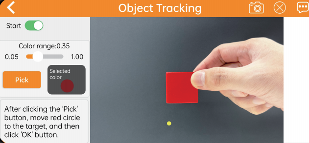

(1) Click “Target Tracking” on the mode selection screen to enter the operation interface for this activity.
(2) Firstly, click “pick”, then drag the red circle on the camera returned image to the target to pick the color.
(3) Then click “ok” button. The color you pick will display at the right box.
(4) Click “Start” button. Then you can move the object, and JetAuto will move with it.
(5) Click “Start” button. Then you can move the object, and JetAuto will move with it.

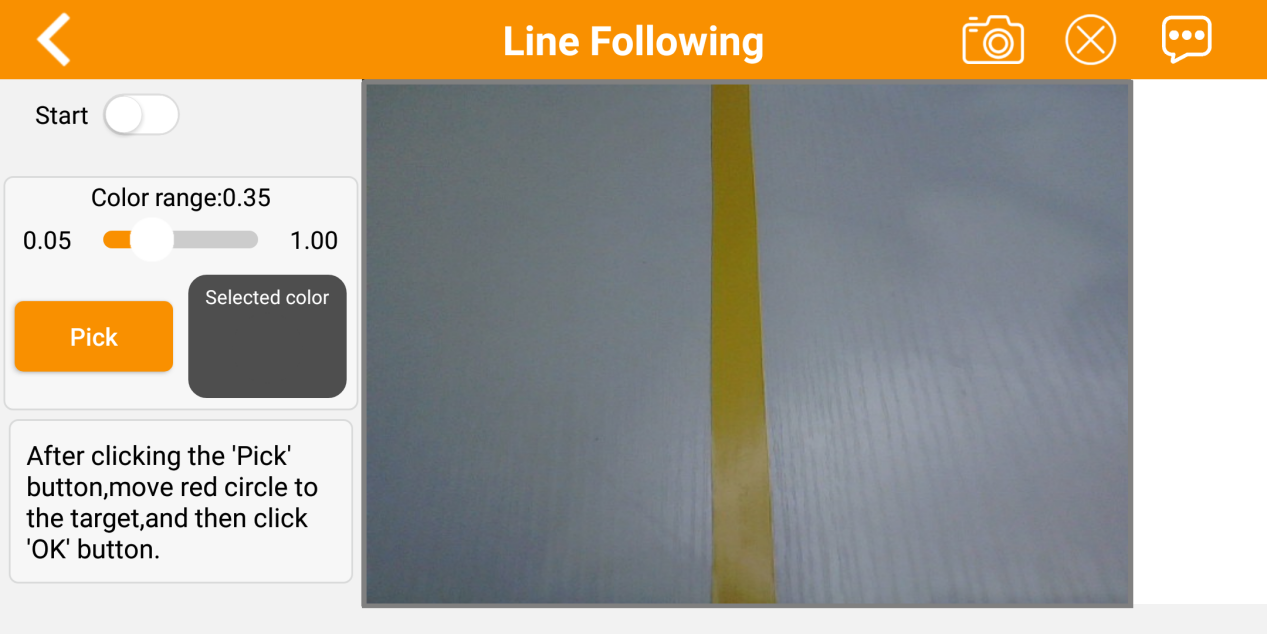

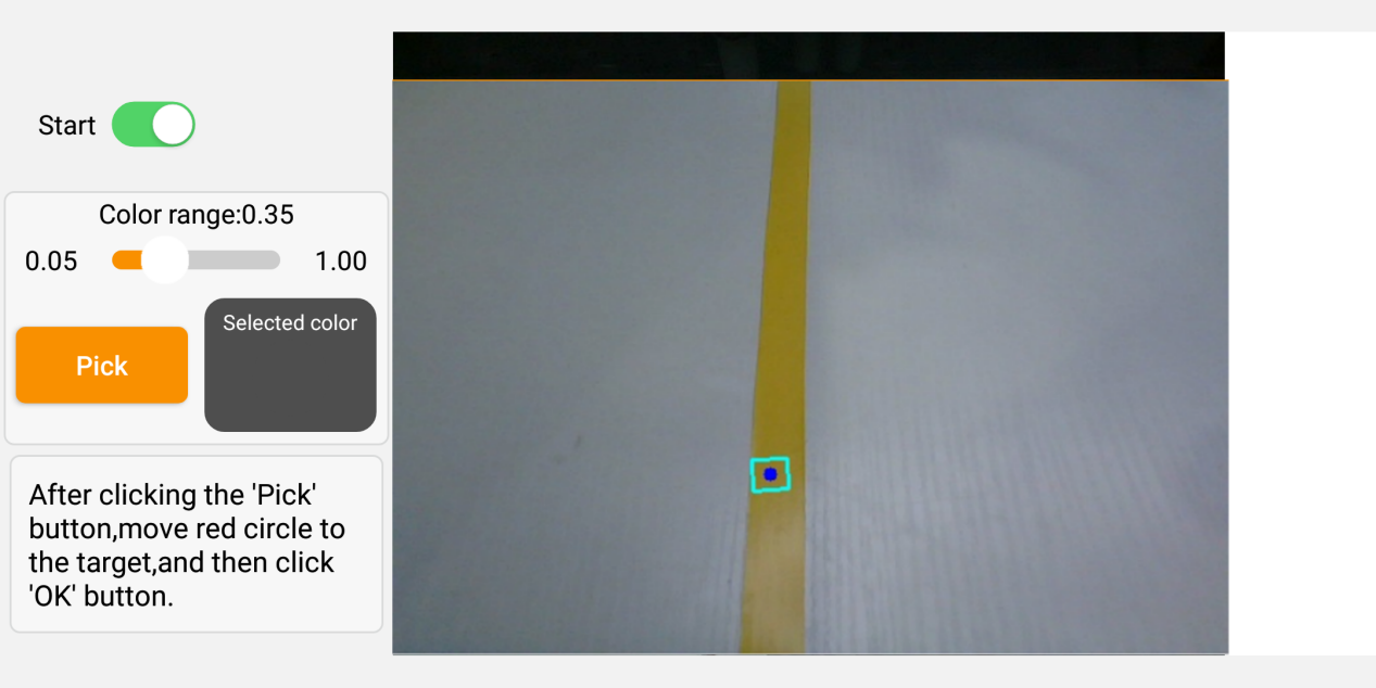

1.5.6 Line Following
  • It is recommended to slightly tilt the camera downwards.
  • Before the game starts, paste the tape on the ground to set the path, and place the robot on it.
  • After the game starts, please remove other objects in target color from the field of view of the camera, otherwise the game will be influenced.
(1) Click “Line Following” on the mode selection screen to enter the operation interface for this activity.
(2) In this case, red tape will be used an example for demonstration. Click “pick color”, then drag the red circle on the camera returned image to the path to pick the color.
(3) Next click “confirm” button. The color you pick will display at the right box.
(4) Lastly, click “Start” button, then the robot will move along the path.

Click “AR” on the mode selection screen to enter the operation interface for this activity. Place the tag within the field of view, and click the 3D pattern you want, for example “bicycle”. Then the 3D bicycle will be overlaid on the April Tag.

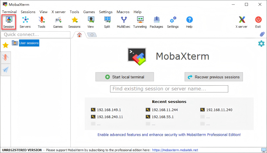

1.6.1 Remote Connection Tool Introduction & Installation

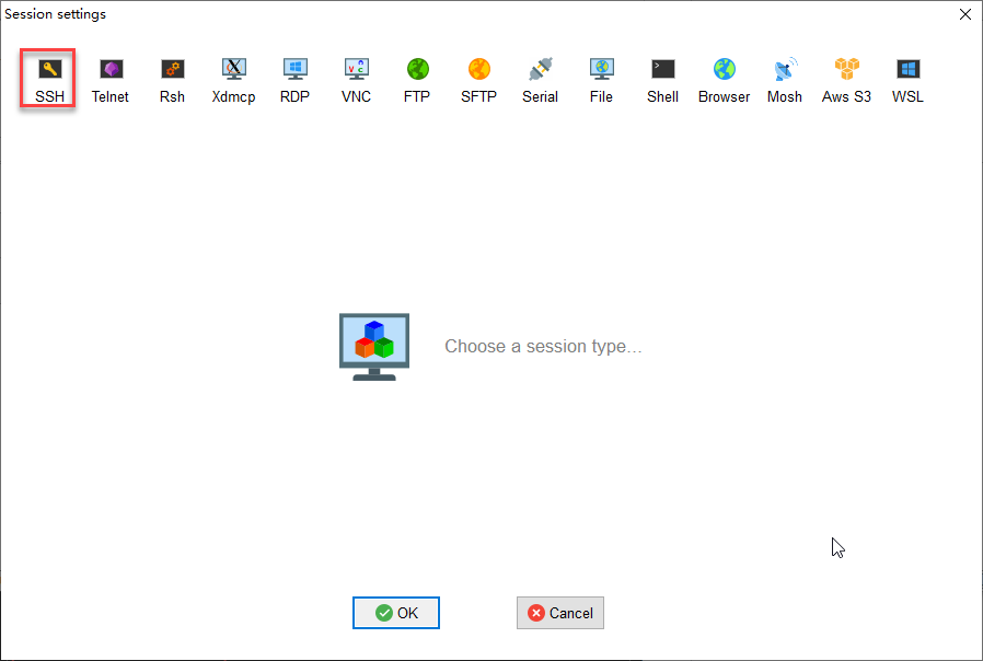

Regarding the two methods of remote control for the robot: graphical and command-line control.
NoMachine and VNC are graphical remote control software. After installation, you can directly control the robot on the computer by connecting to the robot’s hotspot. For the Jetson Nano, Jetson Orin Nano, and Jetson Orin NX main controllers, NoMachine is used for connection, while the Raspberry Pi 5 main controller uses VNC. With these two software options, users can clearly see the robot’s system desktop, making it easier to operate intuitively.
In contrast to NoMachine and VNC, MobaXterm is an SSH connection that focuses more on command-line control. It does not display the full desktop of the robot system, only a command-line window. For users who are familiar with command-line operations, MobaXterm allows quicker control of the robot via commands while reducing computational load and memory usage.
MobaXterm also has a built-in lightweight X11 server that can directly display graphical application interfaces. Regardless of which control board you use, MobaXterm’s SSH connection method is applicable.
In short, NoMachine and VNC are suitable for scenarios that require intuitive operation, while MobaXterm is better for quickly executing commands. Choose the software that best fits your remote control needs.

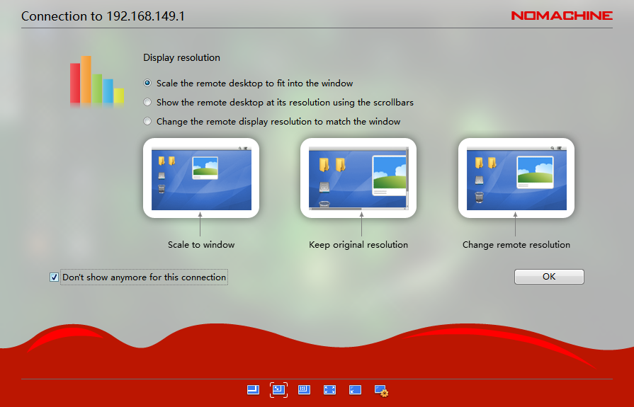

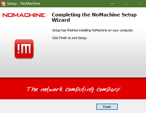

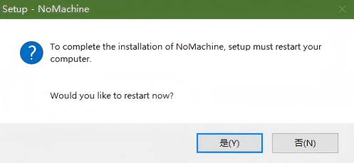

  • NoMachine Installation
This tool is applicable to Jetson controller versions.
(1) Enter the same directory as this document to open the installation package “nomachine_8.4.2_10_x64” in “Appendix ->nomachine_8.4.2_10_x64”.
(2) Click “Next”.
(3) Then click “I accept the agreement” in the prompt box, and set the “Language” as “English”, then click “Next”.
(4) Remain the default installation path. Click “Next”.
(5) Click “Yes” to restart the computer (Please do not skip this step).

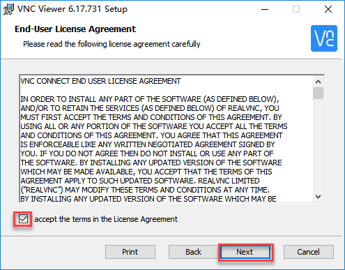

  • VNC Installation
This tool is applicable to Raspberry Pi 5 version.
(1) Enter the same directory as this document to open the installation package “VNC-Viewer-6.17.731-Windows” in the folder “Appendix -> VNC-Viewer-6.17.731-Windows”. In the pop-up dialog box, select ‘English’ as the installation language and click the ‘OK’ button.
(2) Click “Next”.
(3) Then click “I accept the agreement” in the prompt box, and continue.
(4) Click “Install”.
(5) Click “Finish” to complete the installation.

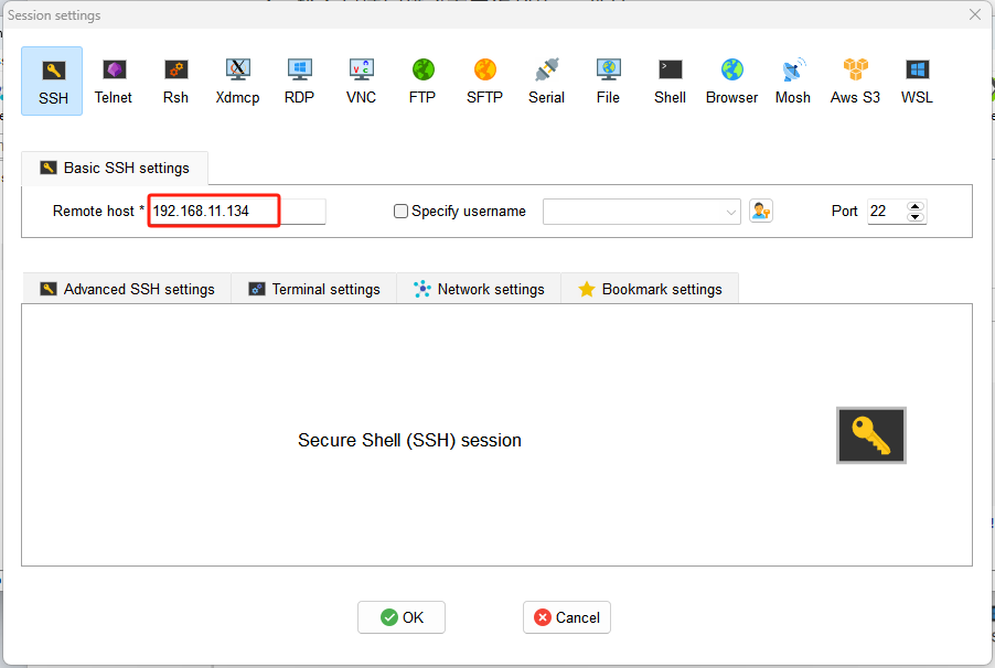

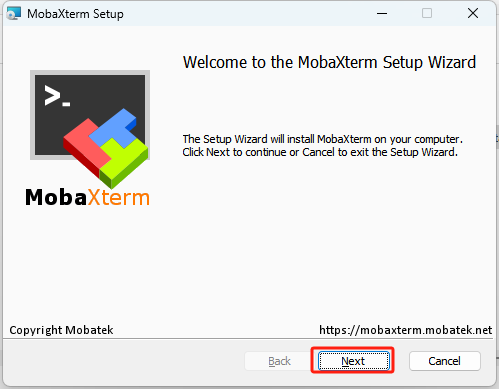

  • MobaXterm Installation
This tool is applicable to any robot version.
(1) Locate the “MobaXterm” installation package in this folder Appendix->MobaXterm.
(2) Click “Next”.
(3) Then click “I accept the agreement” in the prompt box, and click “Next”.
(4) Keep the default installation position,and click “Next”.
(5) Click “Install”.

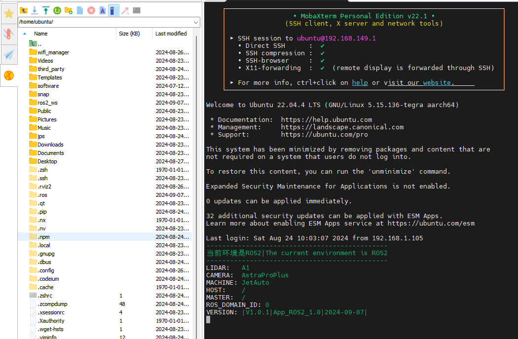

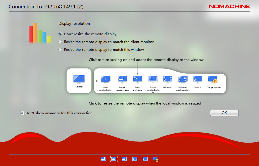

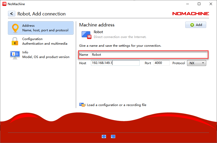

  • Establish Connection via NoMachine
(1) The robot is set to AP direct connection mode by default. After booting up successfully, it will create a hotspot starting with “HW”. As the picture shown below, the connection password is “hiwonder”.
(2) Open NoMachine, input the IP address “192.168.149.1” in the search bar in AP mode, and click “Configure connection to new host 192.168.149.1”.
(3) After opening, follow these steps: click on Address > Name, enter “robot” > Host, enter “192.168.149.1” > click Add.
(4) Fill in the provided username and password based on the control board version:
① Initial configuration for Jetson Nano board:
username: jetauto, password:hiwonder
② Initial configuration for Jetson Orin Nano board:
username: ubuntu, password:ubuntu
③ Initial configuration for Jetson Orin NX board:
username: ubuntu, password: ubuntu

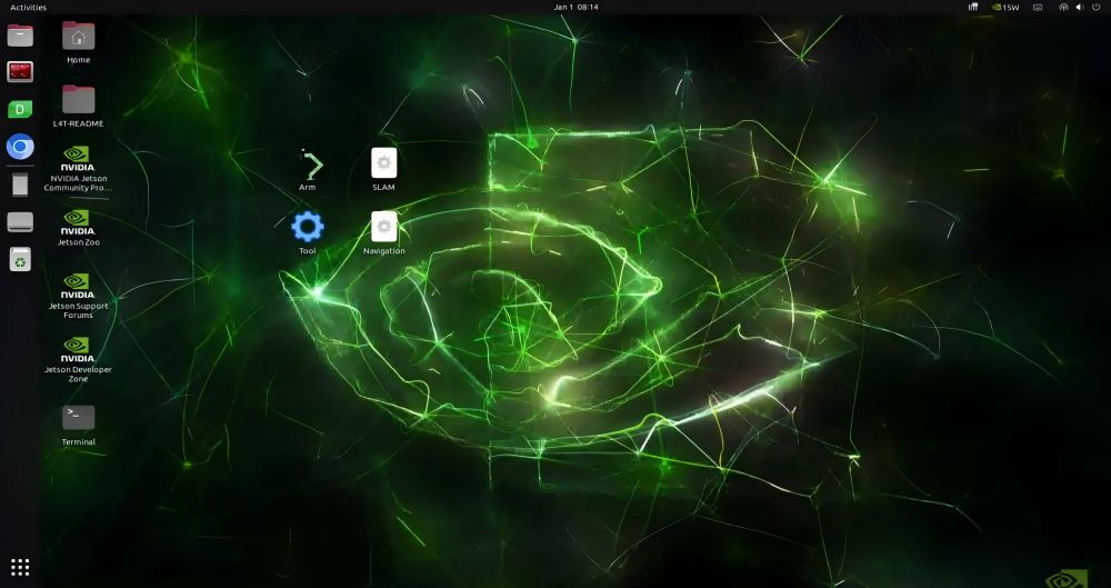

(5) Check the “Save this password” box, then click the Login button. Below will take “Jetson Nano” version as an example:
(6) Afterwards, you will see the remote desktop of the Jetson Nano open up.

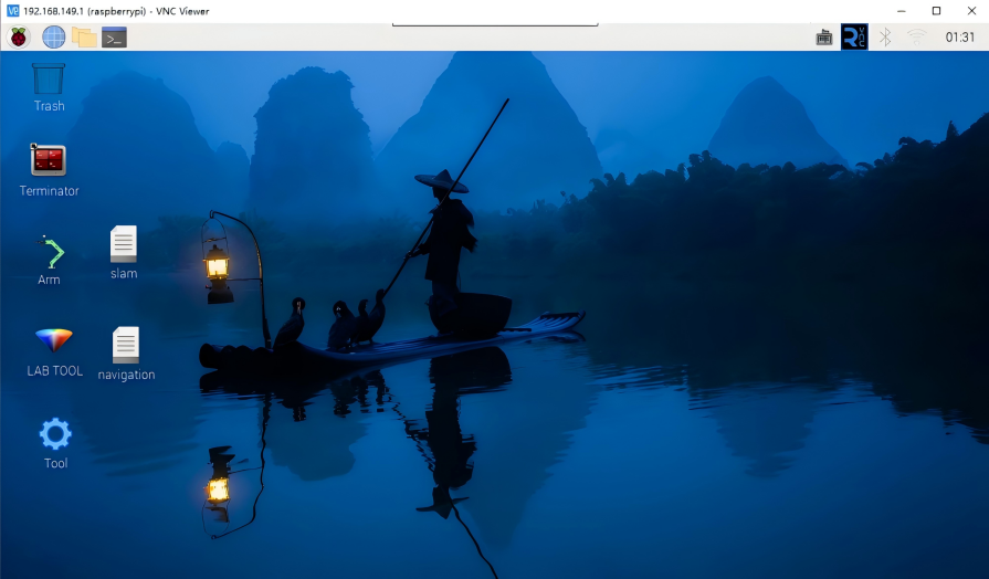

  • Establish Connection via VNC
(1) Search for and connect to the hotspot starting with “HW”, as shown in the following figure. The password for the connection is hiwonder.
(2) Next, open VNC software. In the VNC Viewer, enter the IP address “192.168.149.1” in the search bar in AP mode, and press Enter. If you receive a security warning, click ‘Continue

  • Establish Connection via MobaXterm
This section takes “AP Direct Connection” as an example to illustrate. The same operation method is applicable to LAN mode. You just need to change the IP address.
(1) In the main interface, click “Session” on the top right corner to create a session. In the session interface, enter the recorded Raspberry Pi 5 IP address “192.168.149.1”, and then click “OK”.
(2) Choose SSH.
(3) Enter the fixed IP address in AP direction connection mode:
192.168.149.1
(4) As pictured, you need to select the third option.
(5) The interface will prompt users to enter the login as and password. It is necessary to fill in the username and password based on the control board version (Below will take Jetson Nano version as an example):
④ Initial configuration for Raspberry Pi 5 board:
username: pi, password: raspberrypi
  • The username must be entered in lowercase mode. Even if the username includes uppercase letters during setup, it must be entered in lowercase when logging in.
  • The username will be visually displayed. After entering it, press Enter to proceed to the password input.
  • The password will not be visually displayed. After entering the password, press Enter to log in.
(6) When the input password is correct, you will get access to the system. The system interface is as pictured:
1.6.3 LAN Mode Connection
STA LAN Mode: the development board is able to actively connect to the designated hotpot/ WIFI. (It can connect external network)
  • If you are uncertain how the robot connect the robot to the STA local network and obtains an IP address, it is recommended to connect via the app.
  • The system image has made special configurations for WI-FI, so the WI-FI option cannot be directly selected from the menu bar, as shown in the image below. This does not affect the normal operation of the robot. Users can refer to the “Method to Restore Wi-Fi Option in the Menu Bar” for the necessary settings.
  • This section will use connecting to the “Hiwonder_5G” Wi-Fi as an example. Users should refer to the Wi-Fi that you have set up themselves when configuring the local network connection.
  • Establish Connection via Nomachine
(1) In LAN mode, search for and connect to the Wi-Fi you have set up on the computer, as shown in the image below.
(2) Open NoMachine, input the IP address “192.168.11.134” in the search bar in AP mode, and click “Configure connection to new host 192.168.11.134”.
If you are unsure the IP address, please refer to “1.5.1 Preparation -> LAN Mode Connection (Optional)”.
(3) After opening NoMachine, change Name to “Robot” and click “add”.
(4) Then double the name “Robot”.
(5) Fill in the provided username and password based on the control board version:
(6) Check the “Save this password” box, then click the Login button. Below will take “Jetson Nano” version as an example:
(7) Afterwards, you will see the remote desktop of the Jetson Nano open up.

(3) Wait for the connection window to pop up, then enter the following in order: Username > Password > Click ‘Remember password’ > Click ‘OK’:
Username: pi
Password: raspberrypi
(4) Once connected, the Raspberry Pi’s remote desktop will appear as shown in the image below.
(1) In the main interface, click “Session” on the top right corner to create a session. In the session interface, enter the recorded robot IP address “192.168.11.134”, and then click “OK”.
(2) Choose SSH.
(3) Enter the IP address obtained in LAN mode: 192.168.11.134
1.6.4 Method to Restore WI-FI Option in Menu Bar
(1) Double click on to open the command-line terminal.
(2) Enter the command and press Enter to access the configuration file directory.
cd hiwonder-toolbox/
(3) Enter the command and press Enter to open the configuration file.
vim hiwonder_wifi_conf.py
(4) Firstly, you need to change the value of “HW_WIFI_MODE” to 2. The value “1” represents AP direction connection mode, while “2” represents LAN mode.
(5) Then, modify “HW_WIFI_STA_SSID” and “HW_WIFI_STA_PASSWORD” to match the name and password of your router’s WIFI.
Choosing a 5G Wi-Fi signal will provide higher transmission speeds. If you experience lag when connected to a regular Wi-Fi network, you can switch to a 5G Wi-Fi network for better performance.
(6) Press “Esc” and enter “:wq” to save and exit the file.
(7) Enter the command “sudo systemctl restart hw_wifi.service” to restart the robot’s Wi-Fi service. After a short wait, the LED1 on the expansion board will remain solid.
After restarting the robot’s Wi-Fi service, NoMachine will automatically disconnect. This is because the device has been set to LAN mode, and the connection to a different Wi-Fi network causes the IP address to change from the original one.
(8) First, connect your phone to the 5G network. In this case, we will use the “Hiwonder_5G” Wi-Fi as an example.
(9) Open “WonderAi”. Choose “Advanced -> JetAuto” in sequence.
(10) Wait for a moment. The main interface will display the corresponding robot icon and name.
(11) Long and hold the robot icon in app to view the IP address and device ID assigned to the robot.
(12) Enter the obtained IP address into NoMachine to establish a remote connection. For detailed instructions, please refer to the tutorial “1.6.2 AP Direct Connection Mode.”

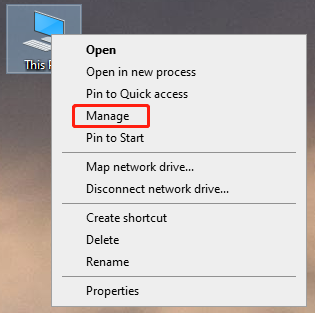

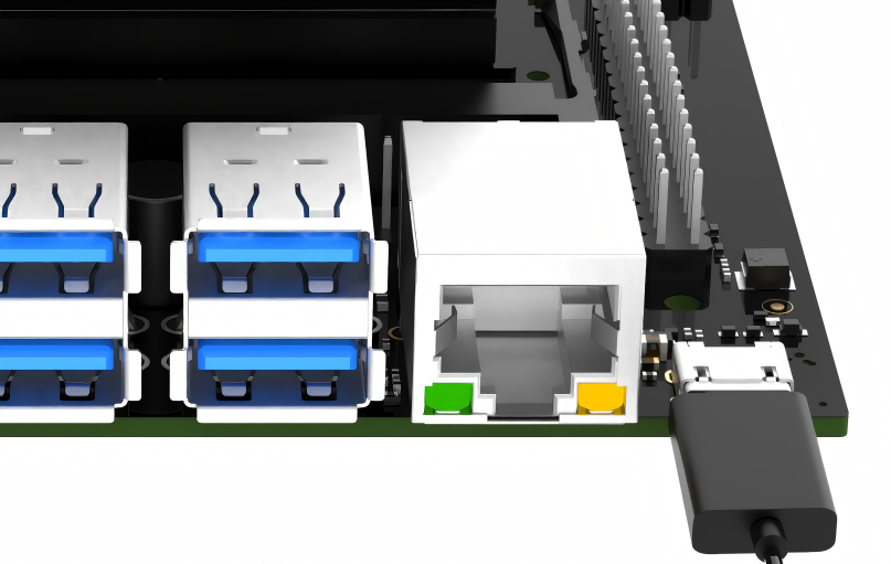

1.6.5 USB Cable Fixed IP Connection
This section is only supported for Jetson series main control versions! It is not supported for Raspberry Pi 5 main control versions!
The robot can improve the remote operation smoothness through enabling remote NDIS compatible device, using the fixed IP “192.168.55.1”. This method does not require connecting to the robot’s hotspot or WiFi in the local network. The specific operation steps are as follows:
(1) Connect the Jetson Nano board to your computer using Micro-USB cable.
(2) For Jetson Orin Nano board, connect it to the computer using a Type-C cable.
(3) Right click “This computer” to select “Manage”.
(4) Click on “Device Manager”. In the “Network Adapters” section, locate the NDIS driver. Right-click to select “Update Driver”.
(5) After the driver is installed, you need to refer to either “AP Direction Connection Mode” or “LAN Mode Connection” to log in the system. You only need to modify the address bar to “192.168.55.1”.

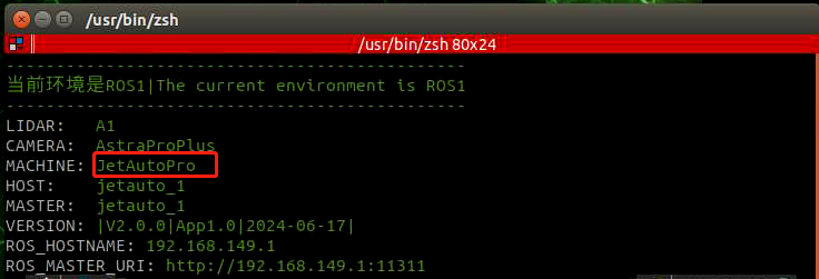

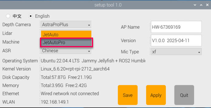

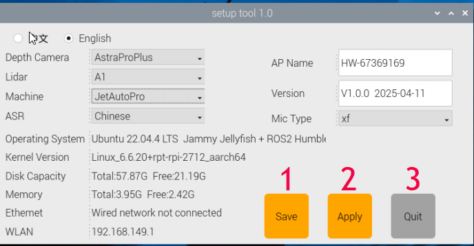

1.6.7 Robot Version Configuration Tool Instruction
This section will introduce the robot system’s built-in version configuration tool, which allows switching between different chassis configurations, Lidar types, camera models, and Chinese/English voice settings.
It is applicable to the following users:
① Users who have purchased a robot kit without control board.
② Users who have re-flashed the system image.
③ Users who have replaced other accessories supported by the system, such as switching from a Mecanum wheel chassis to a tracked chassis.
For users who have purchased a complete robot kit with control board, they only need to be aware of the content and do not need to take action. Before learning how to use the tool, you can first confirm the system version configuration based on the control board model you purchased.
  • Tool Introduction and Usage
(1) Use the Nomachine remote desktop connection tool to connect to the robot. For specific connection methods, refer to section Remote Device Connection.

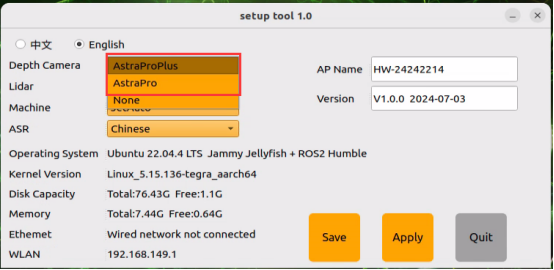

(2) Once connected to the remote desktop, double-click on or for robot system configuration.
(3) In the interface, select the desired robot type options, as shown in the red-boxed area in the following image.
(4) Users can check your order information to obtain the hardware version. It typically needs to configure the following ares in the tool: Depth Camera, Lidar, Machine, ASR. Please refer to the table below. Keep the other options at their default settings and avoid incorrect operation to prevent issues!
Option Configuration
Depth camera AstraPro/AstraProPlus/None
Lidr A1/A2/G4/S2L/LD14P
Machine JetAuto/JetAutoPro
ASR Chinese/English
(5) For instance, if you need to switch the machine type from JetAuto version to JetAuto Po version.
(6) After selecting, click Save > Apply > Quit in sequence. It is crucial to follow this order to successfully switch the chassis type.
(7) Wait for the robot body to emit a “beep” sound, indicating that the chassis type switch was successful.
  • Configuration Modification Verification
The following demonstrations are provided for four types of cotrol boards: Jetson Nano, Jetson Orin Nano, Jetson Orin NX, and Raspberry Pi 5. For an introduction to the differences in terminals, please refer to the “System Command-line Terminal Introduction”.
(1) Jetson Nano Control Board:
If using ROS1, you can verify by clicking on . For ROS2, use the ROS2 command-line terminal.
(2) Jetson Orin Nano/Jetson Orin NX Board
Verify by clicking on .
(3) Raspberry Pi 5 Board
Click on to verify the ROS2 system environment.

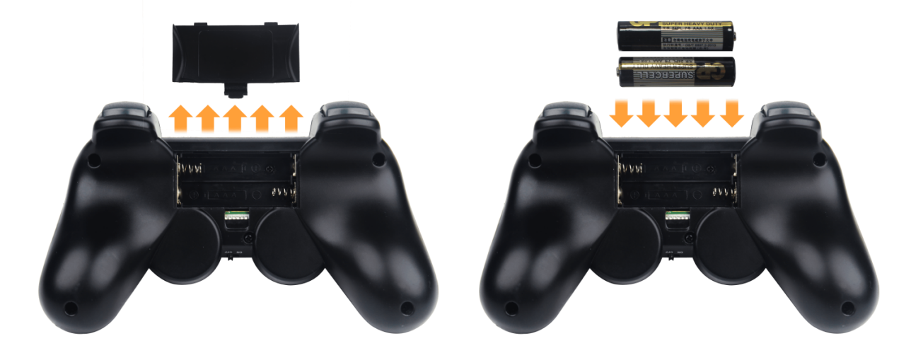

(2) When installing the batteries, please distinguish the positive and negative poles of the battery.

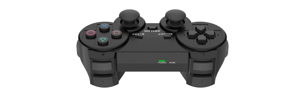

1.7.2 Device Connection
(1) After the robot is powered on, turn on the switch of the handle. At this point, two LED lights (red and green lights) on the handle will blink simultaneously.
(2) Wait for a few seconds, and the robot and handle will be paired automatically. When pairing is successful, the green LED light will remain on, and the red LED light will turn off.

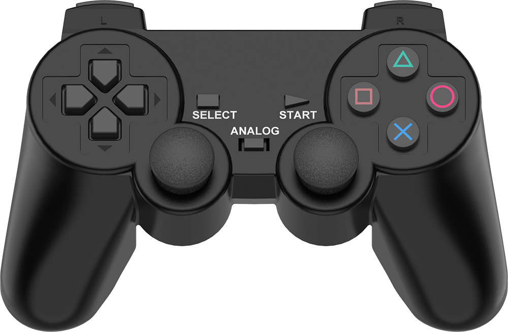

1.7.3 Button Instructions
The below table will introduce the functions of the buttons and joysticks (take robot as the first person view):
Gently pushing the joystick in any direction enables low-speed movement.
Button Function Instruction
START Stop and reset the robot Short press
Left joystick Move forward Push upward
Left joystick Move backward Push downward
Left joystick Move to left (Mecanum chassis only) Push to left
Left joystick Move to right (Mecanum chassis only) Push to right

Before powering on the robot, it is necessary to ensure that the touch screen is already installed and connected.
The power cable of the touch screen needs to connect to the C-Touch interface, otherwise, the touch functionality is ineffective.
Next, you need to confirm whether the handle receiver is securely plugged into the USB port of the robot.
The handle received is already plugged in the USB hub upon receiving the robot.

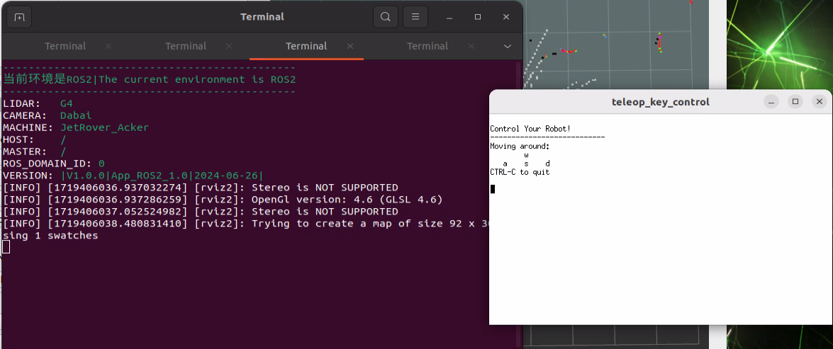

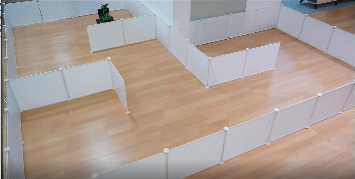

  • ROS1 Mapping
  • This section is applicable to Jetson Nano controller
  • In this mode, it’s necessary to set up a closed space beforehand on a flat surface. If obstacles are placed, their height should be at least above the radar’s horizontal position.

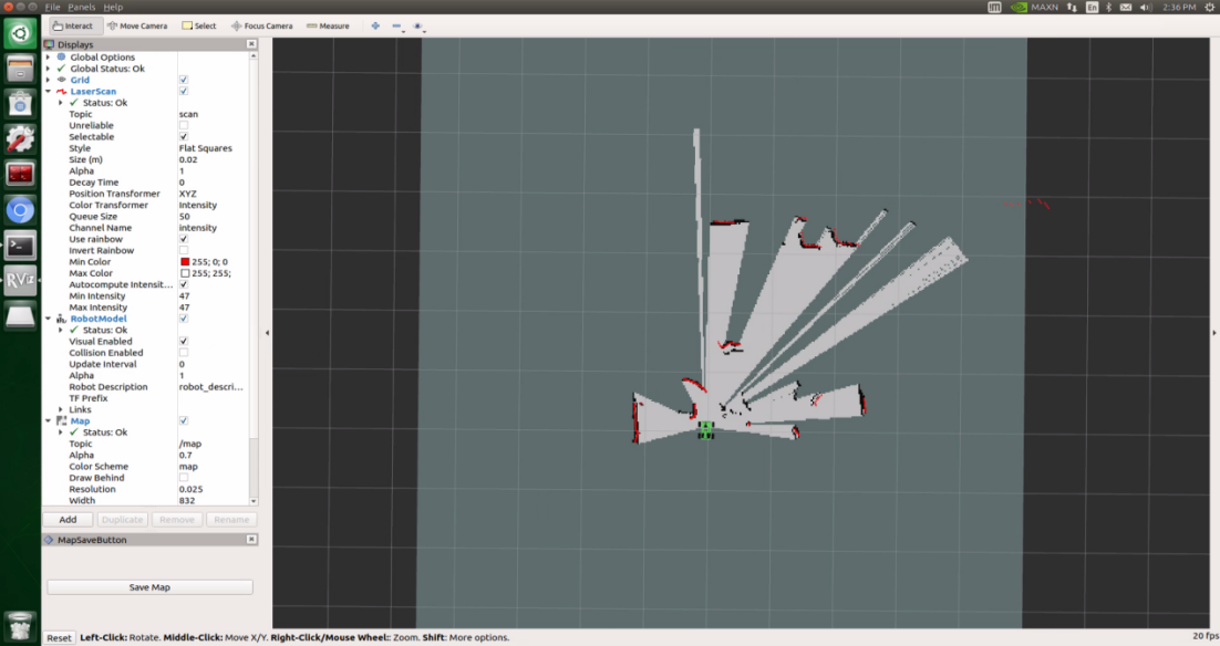

(1) Place the robot inside the constructed space.
(2) Click on the screen desktop. Open

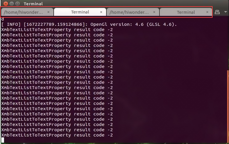

(3) At this time, Several terminals will be opened to run the program simultaneously. Wait for a while at this point.
(4) When you see the below interface, it indicated that the function is enabled successfully.

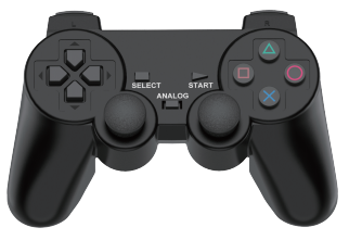

(5) Now, let’s use control the robot to map using the wireless handle. The function instruction for each button is as follow:
When using the handling, keep the distance from the robot not too far to avoid disconnection.
Button/Joystick Operation Function
START Short press Exit sleep mode
Left joystick Push forward/backward Control robot to move forward and backward
Push to left/right
Control the movement of left and right translation
(Only supported for Mecanum chassis)
Right joystick Push to left Control robot to turn left

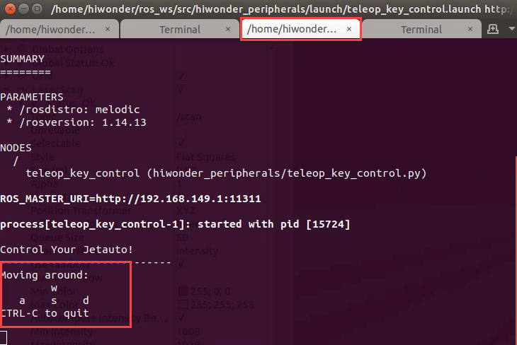

You can also choose to control the robot using the keyboard, but it’s not recommended here. Keyboard control will be introduced in later courses. If you prefer keyboard control, you’ll need to connect to the remote desktop and modify the terminal to enable keyboard control.
For the remote system desktop connection, please refer to “1.6.1 Remote Connection Tool Introduction & Installation”.
The button instruction for keyboard control is as follow:
Buttons Function Instruction
W Move forward Short press to this button to forward status. Robot will keep moving forward.
S Move backward Short press to this button to backward status. Robot will keep moving backward.
A Turn left Long press to interrupt moving forward or backward and make a counter-clockwise turn to the left in place
D Turn right Long press to interrupt moving forward or backward and make a right turn.
When the “W” or “S” key is pressed, the robot will continue moving forward or backward respectively. When the “A” or “D” key is pressed, the robot will interrupt the forward or backward motion and rotate counterclockwise or clockwise in place respectively. When the “A” or “D” key is released, the rotation will stop, and the robot will remain stationary.

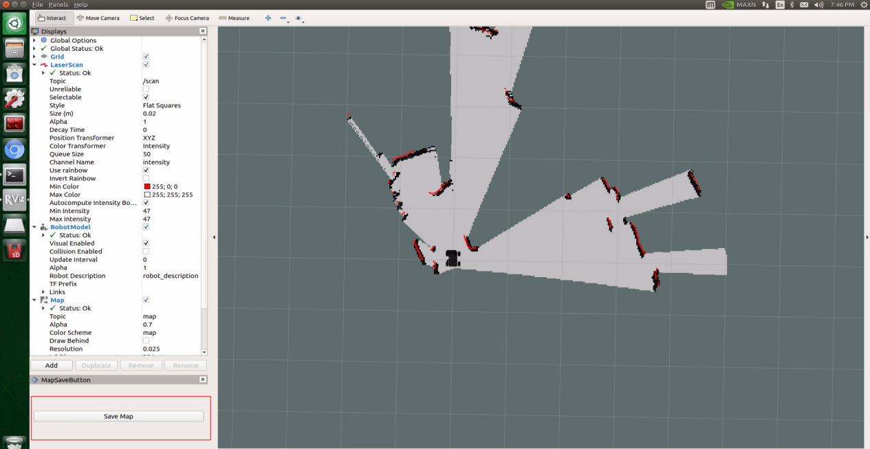

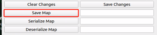

(6) After the movement is complete, press the save button in the bottom left corner, and the robot will save the completed map.
The standard for a completed map is as follow:
(7) After the mapping is complete, if you want to close this function, click interface and tap .

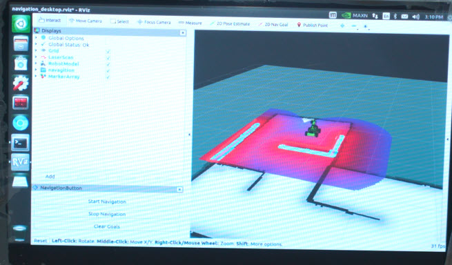

  • ROS2 Mapping
  • This section is applicable to Jetson Orin Nano/Jetson Orin NX and Raspberry Pi 5.
(2) Click on the screen desktop. Open the SLAM icon.
Regardless of whether it’s a tracked robot or a wheeled robot, using keyboard control cannot make the robot perform lateral movement.

1.11 Hardware Introduction
This chapter focuses on the hardware components of ROS robots, including electronic control system, ROS controller, Lidar and depth camera, etc.
1.11.1 Hardware System Wiring Diagram
The hardware connection system diagram of the robot based in the mini STM32 controller is shown below. The specific model and ROS controller may var, and the detailed instructions will be provided in the following content.
Jetson Nano Controller Version:
Jetson Orin Nano/Jetson Orin NX Controller Version:
Raspberry Pi 5 Controller Version:

  • STM32 Controller
The robot’s electronic control system uses a mini STM32 controller (hereafter referred to as the STM32 controller) as the low-level motion controller. It connects multiple DC encoder reduction motors and has a built-in IMU accelerometer and gyroscope sensor. This setup enables the control of the robot’s chassis movement and sensor data collection. In the professional development version, JetAuto Pro, a 6-DOF robotic arm made up of bus servos is included.
The controller uses the STM32F407VET6 as the main controller, which features ARM’s Cortex-M4 core, a 168 MHz main frequency, 512K of on-chip FLASH, 192K of on-chip SRAM, and integrates FPU and DSP instructions. The system block diagram of the STM32F40x/41x series is shown below:
The resource layout on the front side of the control board is shown in the diagram below:
  • MiniROS Robot Controller:
Main Control Chip STM32F407VET6 (100-pin)
Motor driver chip YX4055 (overcurrent protection)
IMU sensor 3-axis accelerator; 3-axis gyroscope
Motor port 4-channel encoder motor port
Servo port 4-channel serial bus servo port
USB HOST 1-channel USB HOST port; Supports wireless controller and mouse
USB serial port 1-channel USB serial port (Type-C)
Responsive component 1 buzzer
I2C Port 2-channel 4PIN port
Circuit protection overheating, short circuit, and overcurrent protection
Program download SWD debugging port
Size 78*39mm
Board layers Industrial-grade four-layer board
Mounting hole spacing 48*32mm
  • Robot Power Module
Switch push-button switch
Power input 6-14V wide voltage interface
Power output ports 2 x 5V power output ports, 2 x 12V power output ports
Size 78*39mm
In the robot, the power module’s power interface is connected to the battery, the 5V power output interface supplies power to the Jetson Nano/ Raspberry Pi 5 controller, and the 12V power output interface to Jetson Orin Nano/Jetson Orin NX controller.

  • Jetson Orin Nano Version
The robot is equipped with the Jetson Orin Nano main controller, which comprises a Jetson Orin Nano motherboard and a Jetson expansion board. The motherboard is a compact yet powerful computer that can run mainstream deep learning frameworks, providing the computational power necessary for most artificial intelligence projects.
The expansion board features connections for LEDs and buttons, enabling users to monitor network status through LED flashes and switch network modes using the button. It also includes reserved GPIO and I2C interfaces. The controller is installed with Ubuntu 22.04 and features the ROS2 Humble environment for robotic operating systems.
The Jetson Nano and Jetson Orin Nano controller board with a mini expansion board offers stable performance, low power consumption, and strong expandability. It can run mainstream deep learning frameworks and meets the computational requirements of most artificial intelligence projects.
Jetson Nano and Jteson Orin Nano controller
Reserved interfaces include 2 USB ports, 2 GPIO ports (4-Pin), 2 IIC ports (4-Pin), and 1 UART port. The board is equipped with 5V/3.3V power interfaces, LED indicators, and 2 programmable buttons.

  • Raspberry Pi5 Version
The robot uses a Raspberry Pi 5 as its ROS main controller, which includes the Raspberry Pi 5 controller and a mini expansion board. The controller is a compact yet powerful computer capable of running major deep learning frameworks, providing the computational power needed for most AI projects.
The mini expansion board adds functionality with LEDs and buttons, allowing users to monitor network status via LED indicators and switch network modes using a mobile phone. It also features reserved GPIO and I2C interfaces for additional expansion.
The controller operates with the Raspberry Pi Debian12 official system and has a ROS2 environment set up in Docker.
Overall, the mini expansion board for the Raspberry Pi 5 is stable, energy-efficient, and highly expandable, capable of supporting mainstream deep learning frameworks and meeting the computational needs of most AI applications.

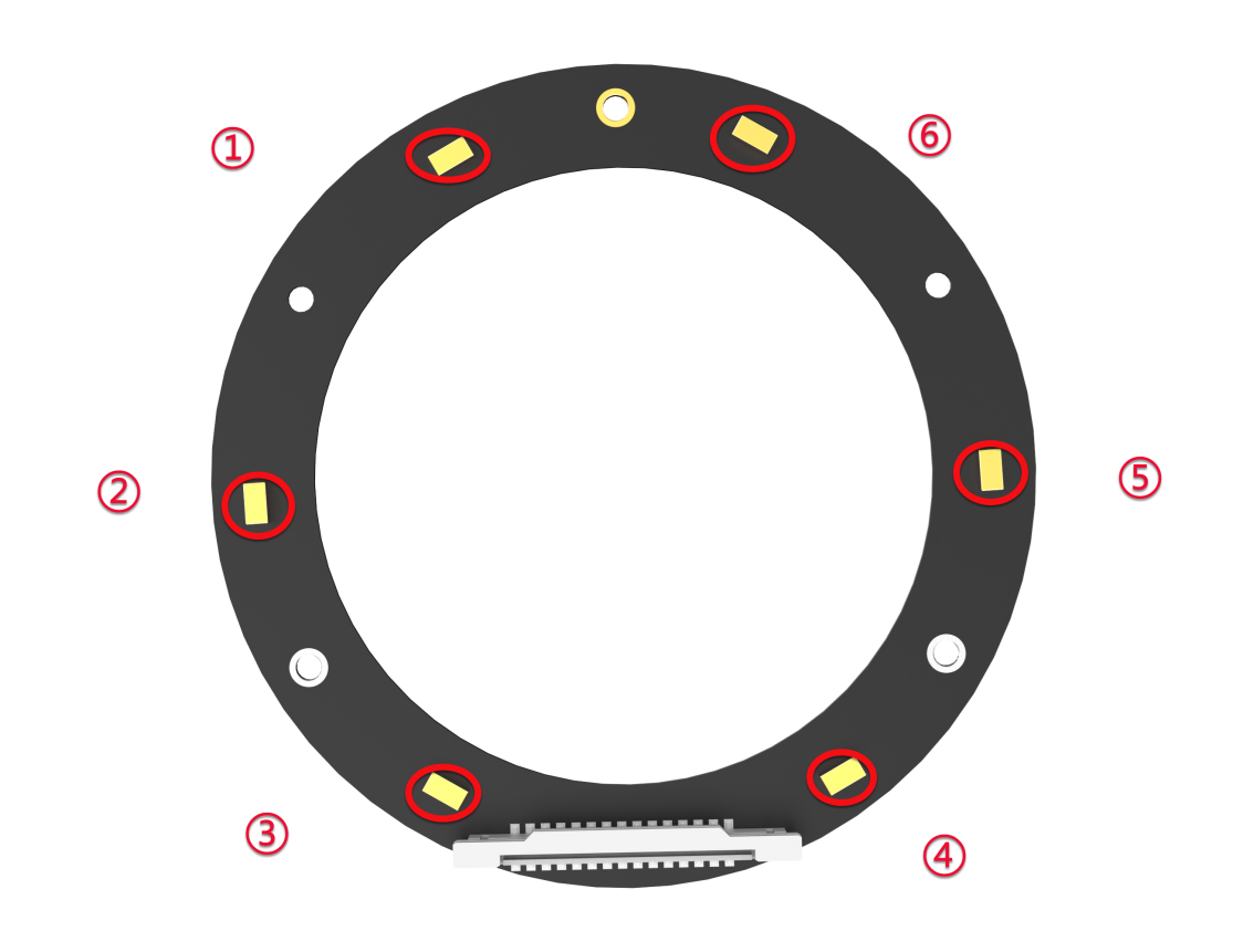

  • Microphone Array Module
This module is optional in robot kit. It can allow robot to realize voice wake-up and voice control capabilities.
This robot uses the R818 noise reduction board and a ring-shaped six-way microphone array, which features a planar distribution structure composed of six microphones. It is a system that samples and processes the spatial characteristics of the sound field. It can perform sound source localization, suppress background noise, interference, reverberation, and echo, and achieve 360° equivalent sound reception.
The noise reduction board can suppress background noise, interference, reverberation, and echoes, as shown in the image below:

  • 7-inch LCD Screen
(The system desktop shown in image is for demonstration purpose only, please rely on the actual product for accuracy.)
The 7-inch LCD screen is optional hardware with both display and touch functionalities. In addition to directly display the robot’s system desktop, it allows for a quick experience of mapping and navigation function by touching icons on the desktop.

The standard connection method requires a power cable and a USB serial cable to communicate with the ROS main controller via the onboard USB serial port. The STM32 requires a power supply of 9-24V, and the ROS main controllers (Jetson Nano and Raspberry Pi 5) can be directly connected to the STM32’s power output port (5V) for power supply through the STM32 power input. The Jetson Orin Nano/Jetson Orin NX requires a 12V power supply.

Before starting this section, you need to use Nomachine remote desktop connection software. For detailed instructions, please refer to “1.6.1 Remote Connection Tool Introdiction & Installation”.
1.13.1 ROS1 Directory and Functional File Introduction
This section is only applicable to the Jetson Nano controller.
(1) Click to open the command terminal. Enter the below command, and then press Enter to view each file under the home directory.
