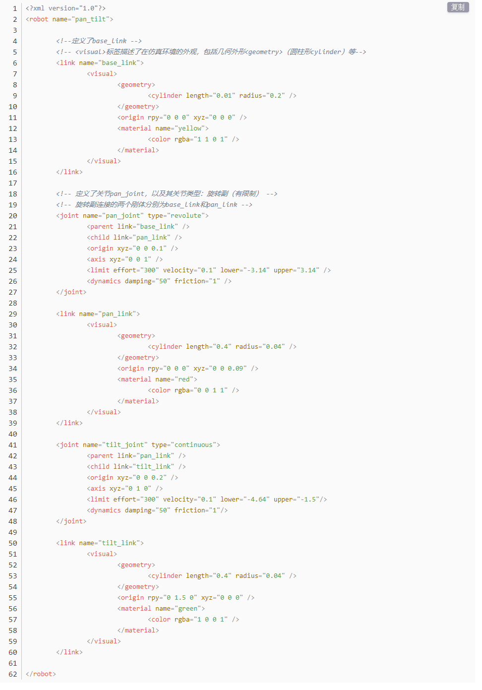

(6) Write Simple URDF Model
Name the model of the robot
To start writing the URDF model, we need to set the name of the robot following this format: “<robot name=’robot model name’>”. Lastly, input “</robot>” at the end to represent that the model is written successfully.
(7) Set links
① To write the first link and use indentation to indicate that it is part of the currently set model. Set the name of the link using the following format: <link name=”link name”>. Finally, conclude with “</link>” to indicate the successful completion of the link definition.
② Write the link description and use indentation to indicate that it is part of the currently set link, and conclude with “</visual>”.
③ The “<geometry>” tag is employed to define the shape of a link. Once the description is complete, include “</geometry>”. Within the “<geometry>” tag, indentation is used to specify the detailed description of the link’s shape. The following example demonstrates a link with a cylindrical shape: “<cylinder length=’0.01’ radius=’0.2’/>”. In this instance, “length=’0.01’” signifies a length of 0.01 meters for the link, while “radius=’0.2’” denotes a radius of 0.2 meters, resulting in a cylindrical shape.
④ The “<origin>” tag is utilized to specify the position of a link, with indentation used to indicate the detailed description of the link’s position. The following example demonstrates the position of a link: “<origin rpy=’0 0 0’ xyz=’0 0 0’ />”. In this example, “rpy” represents the roll, pitch, and yaw angles of the link, while “xyz” represents the coordinates of the link’s position. This particular example indicates that the link is positioned at the origin of the coordinate system.
⑤ The “<material>” tag is used to define the visual appearance of a link, with indentation used to specify the detailed description of the link’s color. To start describing the color, include “<material>”, and end with “</material>” when the description is complete. The following example demonstrates setting a link color to yellow: “<color rgba=’1 1 0 1’ />”. In this example, “rgba=’1 1 0 1’” represents the color threshold for achieving a yellow color.
(8) Set joint
① To write the first joint, use indentation to indicate that the joint belongs to the current model being set. Then, specify the name and type of the joint as follows: “<joint name=”joint name” type=”joint type”>”. Finally, include “</joint>” to indicate the completion of the joint definition.
To learn about the type of the joint, please refer to “joint”.
② Write the description section for the connection between the link and the joint. Use indentation to indicate that it is part of the currently defined joint. The parent parameter and child parameter should be set using the following format: “<parent link=’parent link’/>”, and “<child link=’child link’ />”. With the parent link serving as the pivot, the joint rotates the child link.
③ “<origin>” describes the position of the joint using indention. This example describes the position of the joint: “<origin xyz=’0 0 0.1’/>”. xyz is the coordinate of the joint.
④ “<axis>” describes the position of the joint adopting indention. “<axis xyz=’0 0 1’ />” describes one posture of a joint. xyz specifies the pose of the joint.
⑤ “<limit>” imposes restrictions on the joint using indention. The below picture The “<limit>” tag is used to restrict the motion of a joint, with indentation indicating the specific description of the joint angle limitations. The following example describes a joint with a maximum force limit of 300 Newtons, an upper limit of 3.14 radians, and a lower limit of -3.14 radians. The settings are defined as follows: “effort=’joint force (N)’, velocity=’joint motion speed’, lower=’lower limit in radians’, upper=’upper limit in radians’”.
⑥ “<dynamics>” describes the dynamics of the joint using indention. “<dynamics damping=’50’ friction=’1’ />” describes dynamics parameters of a joint.

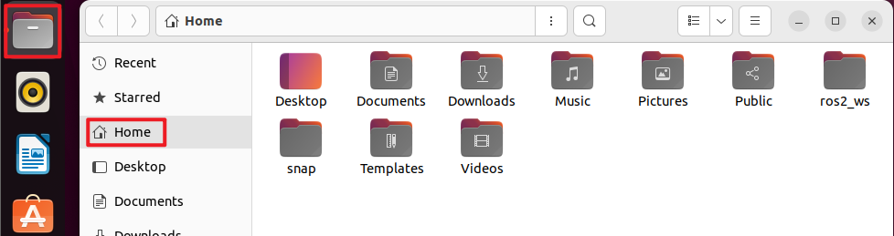

(2) Click-on
to open the command-line terminal.
(3) Run the following command to enable the app auto-start service, and hit Enter key.
(4) Enter the command and press Enter to access the startup program directory.

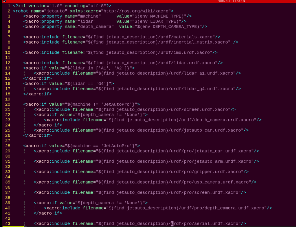

cd ~/ros2_ws/src/simulations/jetauto_description/urdf
(5) Enter the command to navigate to the robot simulation model folder.
vim jetauto.xacro
(6) Locate the code below:
Several URDF models are combined to create a full robot:
| File Name | Device |
| materials | Color |
| inertial_matrix | Inertia Matrix |
| lidar_a1 | A1 Lidar |
| lidar_g4 | G4 Lidar |
| jetauto_arm | Exclusive to JetAutoPro Robot |
| jetauto_car | JetAuto Robot |
| Imu | Inertial Measurement Unit |
| depth_camera | Depth Camera |
| usb_camera | USB Camera |
| common | Common Components or Attributes |
| connect | Connectors, detailing the physical connections between robot components |
| gripper | Gripper Assembly |
| arm.transmission | Robotic Arm Transmission Structure |
| gripper.transmission | Gripper Transmission Structure |

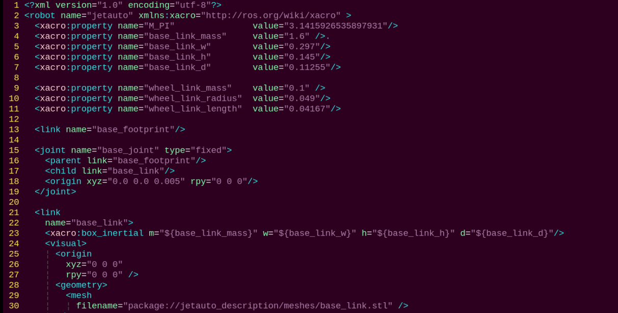

Brief Analysis of Robot’s Main Body Model
Open a new command prompt and enter the following command to open the robot model file, which contains descriptions of each part of the robot:
vim jetauto_car.urdf.xacro
This is the start of the URDF file. It specifies the XML version and encoding while defining a robot model named jetauto. The xmlns:xacro namespace is also included to facilitate the generation of URDF using Xacro macros. This line of code defines a Xacro attribute called M_PI and assigns it the value of the mathematical constant π.

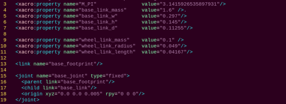

In this section, a link named base_footprint is defined as the robot’s chassis.
Various characteristics of the robot such as mass, width, height, and depth are specified.
Next, a joint called base_joint is defined with a type of “fixed”, indicating it’s a stationary joint. It connects the parent link base_footprint with the child link “base_link”.
The joint’s position (origin) is determined using an xyz attribute.
<link name="base_footprint"/>
<joint name="base_joint" type="fixed">
<parent link="base_footprint"/>
<child link="base_link"/>
<origin xyz="0.0 0.0 0.005" rpy="0 0 0"/>
</joint>

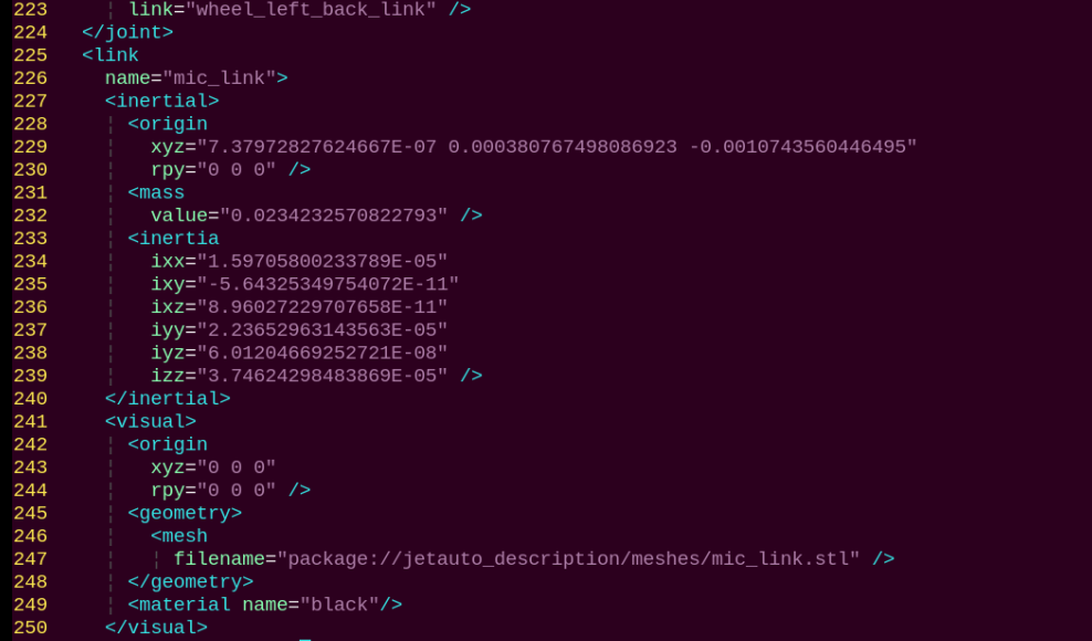

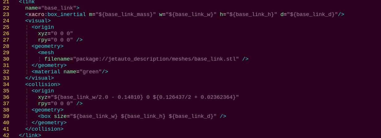

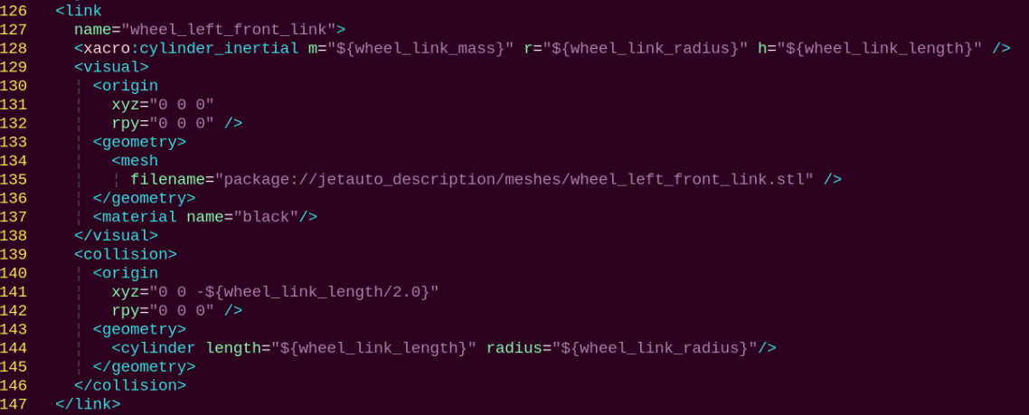

The following code is an XML snippet that defines a link in a robot model. Let’s break down and analyze its structure and purpose.
The code begins with the <link> tag, which defines a link within the robot model. This link is named base_green_link. Inside the <link> tag, there are three sections: <inertial>, <visual>, and <collision>.
The <inertial> section defines the link’s inertial properties, such as mass and inertia. It contains an <origin> tag that specifies the position and orientation of the inertial frame relative to the link frame. The <mass> tag specifies the link’s mass, while the <inertia> tag defines the inertia matrix around the link’s principal axes.
The <visual> section defines the visual representation of the link. It also contains an <origin> tag that specifies the position and orientation of the visual frame relative to the link frame. The <geometry> tag defines the shape of the visual representation, which, in this case, is a mesh. The <mesh> tag specifies the filename of the mesh file that represents the visual appearance of the link. Lastly, the <material> tag defines the color or texture of the visual representation, here represented by a material called ‘green.’
The <collision> section defines the collision properties of the link. It is similar to the <visual> section but is used for collision detection rather than visualization. It includes an <origin> tag and a <geometry> tag that define the position, orientation, and shape of the collision representation.
Overall, this code snippet defines a link in the robot model, including its inertial properties, visual representation, and collision attributes. In simulation or visualization environments, the mesh files specified in the <visual> and <collision> sections are used for visual representation and collision detection with the link.

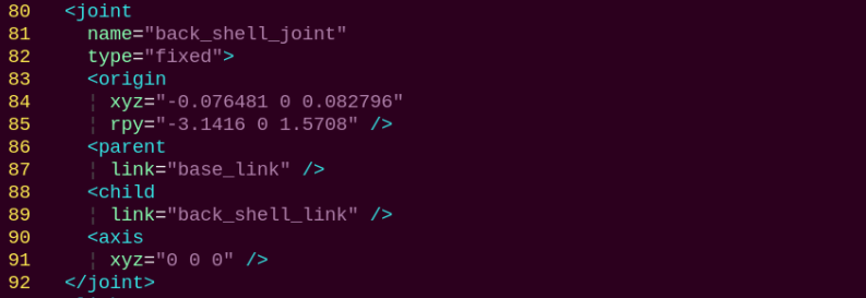

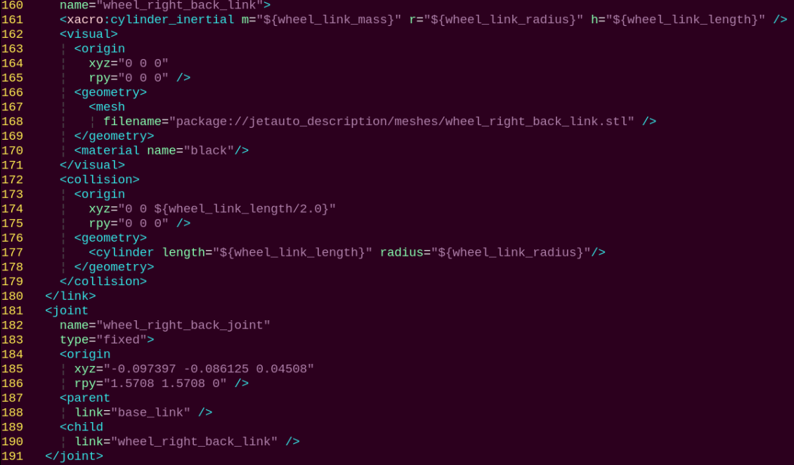

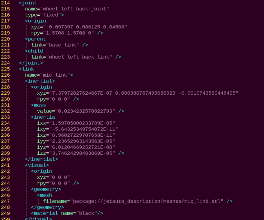

The following code describes a joint named base_green_joint of type fixed, which means it is a fixed joint. The joint’s parent link is named base_link, and its child link is named base_green_joint. The joint’s coordinate origin is at (0, 0, 0), the Euler angles (rpy) are (0, 0, 0), and the joint has no defined axis.

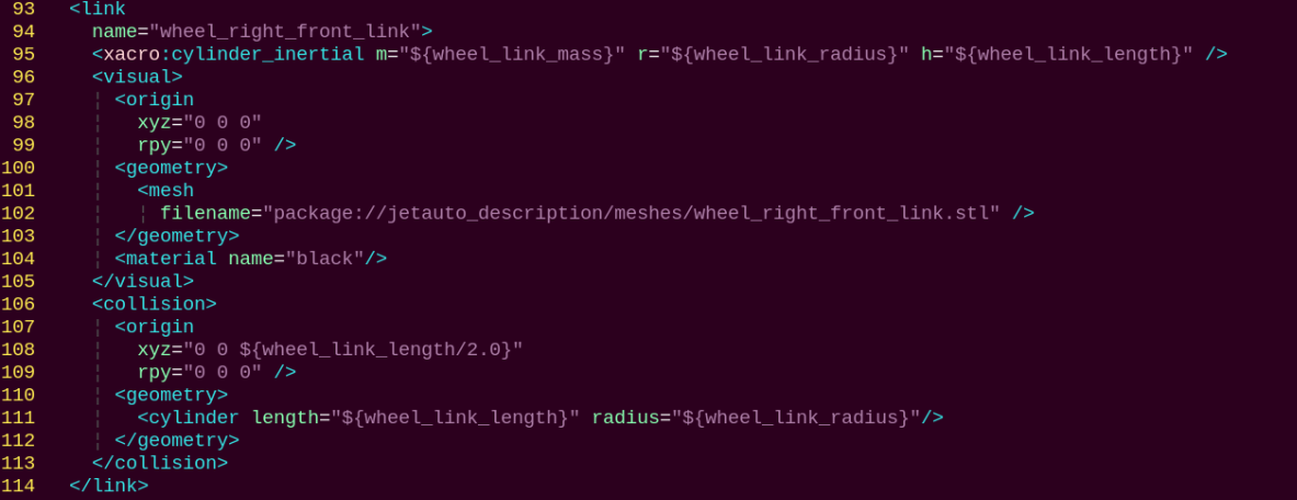

Next, let’s take a look at the description of the link:
The above code describes a link named wheel_right_front_link, which contains information about its inertia (inertial), visual representation (visual), and collision shape (collision).
The inertial part describes the link’s mass and inertia matrix. The mass is 0.124188560741815, and specific values are provided for the inertia matrix components.
The visual part details the link’s appearance, defined by a three-dimensional model (mesh) with the filename package://jetauto_description/meshes/wheel_left_front_link.stl. The link uses a material named black.
The collision part specifies the link’s collision shape, also defined by a three-dimensional model (mesh) with the same filename as the visual part.

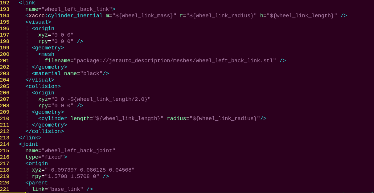

The following code snippet is an XML fragment used to define a joint and a link in a robot model. The joint definition includes:
Type: fixed (indicating a fixed joint that does not allow movement)
Origin: Specifies the position and orientation of the joint relative to the parent link (”base_link”).
Parent Link: Specifies the link to which the joint is attached.
Child Link: Specifies the link that the joint connects to.
Axis: Specifies the rotation axis of the joint. In this case, the axis is set to (0, 0, 0), indicating that it is a fixed joint with no rotation capability.
The link definition includes:
Inertia: Specifies the inertial properties of the link, including mass, center of mass, and moment of inertia.
Visual: Specifies the visual representation of the link, including its position, orientation, geometry (mesh), and material.
Collision: Specifies the collision properties of the link, including its position, orientation, and geometry (mesh).
Another link definition is provided with the name
Inertia: Specifies the inertial properties of the link, including mass and inertia.
Visualization: Specifies the visual representation of the link, including its position, orientation, geometry (mesh), and material.
Detailed Explanation:
Inertial Properties (inertial): Defines the mass and inertia matrix of the link. In this example, the mass of the link is 0.124186629923608, and the individual components of the inertia matrix (ixx, ixy, ixz, iyy, iyz, izz) are also specified with precise values.
Visual Properties (visual): Defines the visual representation of the link. Here, the link’s visualization uses a mesh with the file name package://jetauto_description/meshes/wheel_right_front_link.stl. Additionally, a material named black is applied for visualization.
Collision Properties (collision): Defines the collision properties of the link. In this case, the collision properties are identical to the visual properties, using the same mesh.

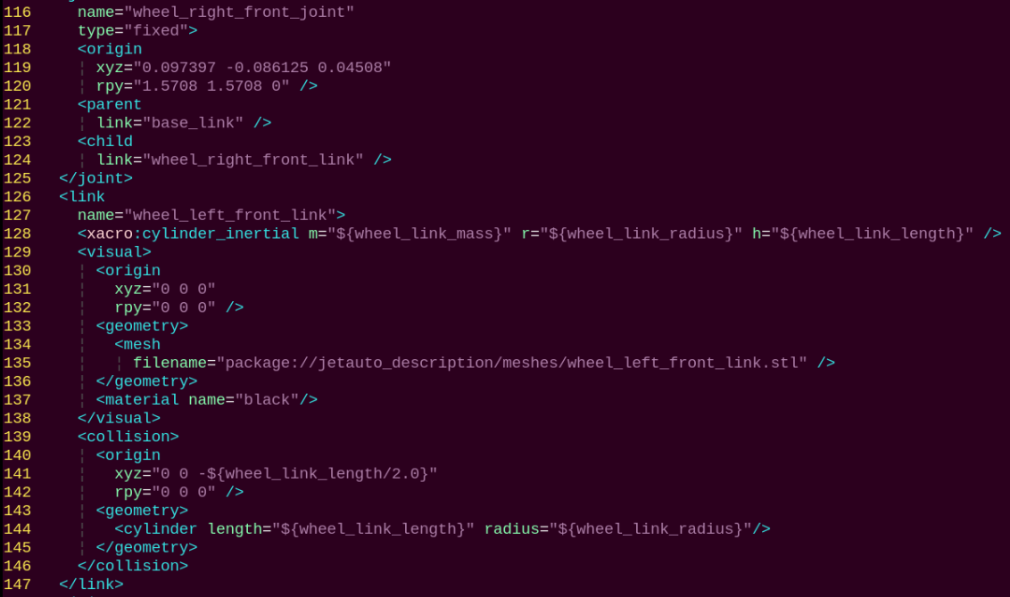

The following code defines a fixed joint that connects two links: base_link and wheel_right_front_link. The joint’s initial position and rotation are specified using the <origin> tag.
name=wheel_right_front_joint: This attribute sets the joint’s name to “wheel_right_front_joint”.
type=fixed: This attribute indicates that the joint is of type fixed, meaning it is stationary and does not allow movement.
<origin> tag: This tag specifies the joint’s initial position and rotation. The joint’s xyz coordinates are set to “-0.10658 0.091851 -0.065487”, and the rpy (roll, pitch, yaw) rotation angles are set to “0 0 3.1416”.
<parent> tag: This tag designates base_link as the parent link of the joint, meaning the joint is connected to base_link.
<child> tag: This tag designates wheel_right_front_link as the child link of the joint, meaning the joint is connected to wheel_right_front_link.
<axis> tag: This tag defines the joint’s axis. In this case, the axis is set to (0, 0, 0), indicating that the joint has no specific axis of rotation.
The following describes a link named "wheel_right_back_link", including its inertial, visual, and collision properties. The link’s geometry is defined using a mesh file, and its visual properties also specify a black material.
name="wheel_right_back_link": This attribute sets the name of the link to "wheel_right_back_link".
<inertia> tag: Defines the inertial properties of the link, including its mass and inertia matrix.
<origin> tag: Specifies the position and rotation of the link’s inertia origin. Specifically, the xyz coordinates are `”0.21333 0.20224 0.00032742”`, and the rpy (roll, pitch, yaw) rotation angles are `”0 0 0”`.
<mass> tag: Defines the mass of the link, which is `”0.13231”`.
<inertia> tag: Specifies the inertia matrix of the link, including the values for ixx, ixy, ixz, iyy, iyz, and izz.
<visual> tag: Defines the visual properties of the link, including its appearance and material.
<origin> tag: Specifies the position and rotation of the link’s visual origin. The xyz coordinates are `”0 0 0”`, and the rpy rotation angles are `”0 0 0”`.
<geometry> tag: Defines the geometry of the link, including a mesh file.
<mesh> tag: Specifies the mesh file used for the link’s geometry, located at `”package://jetauto_description/meshes/wheel_right_back_link.stl”`.
<material> tag: Defines the material of the link, specified as `”black”`.
<collision> tag: Specifies the collision properties of the link, including its geometry.
<origin> tag: Specifies the position and rotation of the link’s collision origin. The xyz coordinates are `”0 0 0”`, and the rpy rotation angles are `”0 0 0”`.
The following code snippet describes a joint named “wheel_right_back_joint”:
\<joint\>: This is the opening tag for the joint element, defining a joint with name=’wheel_right_back_joint’.
type="fixed": Specifies that the joint is of type “fixed”, meaning it is a stationary joint that does not permit movement.
\<origin\>: This tag defines the joint’s origin, including its position and orientation.
xyz="0.10675 0.091848 -0.065821": Indicates the position of the joint’s origin in 3D space as (0.10675, 0.091848, -0.065821).
rpy="0 0 3.1416": Represents the orientation of the joint’s origin using Euler angles, with roll, pitch, and yaw set to 0, 0, and 3.1416 respectively.
<parent>: This tag specifies the joint’s parent link.
link="base_link": Identifies the parent link of this joint as “base_link”.
\<child\>: This tag specifies the joint’s child link.
link="wheel_right_back_link": Identifies the child link of this joint as “wheel_right_back_link”.
<axis>: This tag defines the axis of the joint.
xyz="0 0 0": Sets the joint’s axis to (0, 0, 0), indicating that the joint does not have a defined axis of rotation.
\</joint\>: This is the closing tag for the joint element.

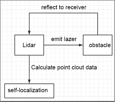

(1) Preprocessing: Optimizing the raw data from the radar point cloud, filtering out problematic data or performing filtering. Using laser as a signal source, pulses of laser emitted by the laser are directed at surrounding obstacles, causing scattering.
Some of the light waves will reflect back to the receiver of the lidar, and then, according to the principle of laser ranging, the distance from the lidar to the target point can be obtained.
Regarding point clouds: In simple terms, the surrounding environment information obtained by lidar is called a point cloud. It reflects a portion of what the ‘eyes’ of the robot can see in the environment where it is located. The object information collected presents a series of scattered, accurate angle, and distance information.

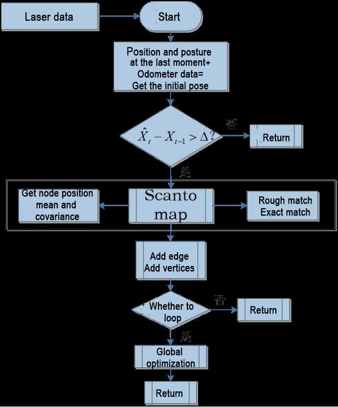

KARTO:
Karto_SLAM is based on graph optimization techniques, utilizing highly efficient and non-iterative Cholesky decomposition to solve sparse systems. In this method, the map is represented as a graph where each node represents a specific position in the robot’s trajectory along with its associated sensor measurements. As new nodes are added, the computations are updated accordingly.
The ROS version of Karto_SLAM incorporates Sparse Pose Adjustment (SPA), which is linked to scan matching and loop closure detection. Although including more landmarks increases memory requirements, graph optimization methods like Karto_SLAM are particularly advantageous in large environments. This is because they only represent the robot’s poses in the graph and determine the map after computing these poses.
The algorithmic framework of Karto_SLAM is shown in the diagram below:
From the diagram above, it can be seen that the process is quite straightforward. The SLAM system operates with a traditional soft real-time mechanism: each new frame of data is processed as it arrives and then returned.

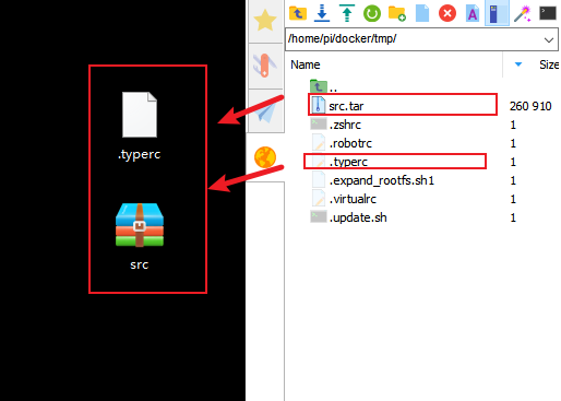

⑤ Next, enter the command to copy the .typerc file to the shared directory tmp.
cp ~/ros2_ws/.typerc ~/share/tmp
⑥ Use the SSH remote connection tool MobaXterm to drag the src.tar and .typerc files from the /home/pi/docker/tmp folder on the Raspberry Pi system image to your local PC.
If you can’t find the .typerc file, you may need to click the “Show Hidden Files” button to display hidden files.
For detailed instructions on how to connect using the SSH remote connection tool MobaXterm, please refer to “1.Quick Start Guide(JetAuto User Manual)-> 1.6 Development Environment Setup and Configuration”.
(2) Import Files into Virtual Machine
① Click-on
to navigate to the home directory.
② Drag and drop the .typerc and src.tar files exported from the robot into the virtual machine.

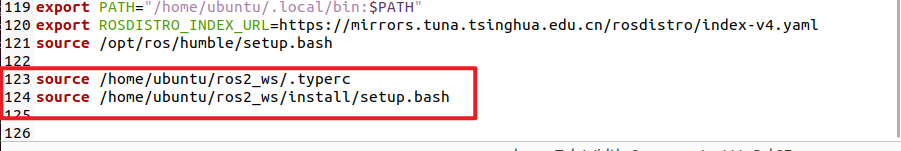

(8) Modify the .bashrc file by entering the following command:
gedit ~/.bashrc
Copy and add the following content to the .bashrc file:
source /home/ubuntu/ros2_ws/.typerc
source /home/ubuntu/ros2_ws/install/setup.bash
(9) After editing, save and exit by pressing Ctrl + S or clicking the “Save” button in the upper-right corner.
(10) Run the following command to refresh the environment configuration.
source ~/.bashrc

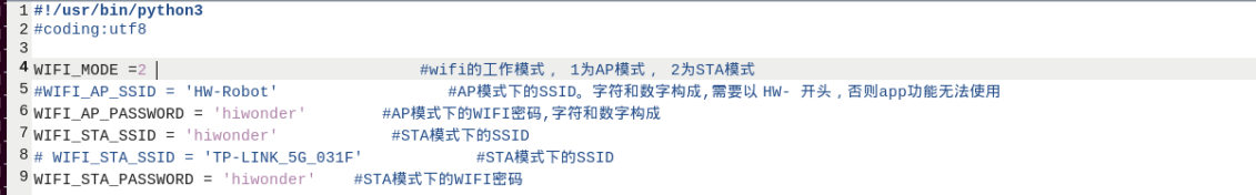

Configuring the Robot for Local Network Mode
(1) Click on
to open the command line terminal. Then, enter the command to navigate to the wifi_manager directory.
cd ~/wifi_manager
(2) Use the command to edit the WiFi configuration file. Switch it to local network mode and enter your own WiFi name and password.
gedit wifi_manager/wifi_conf.py
(3) After making your changes, save the file by pressing `Ctrl + S` or by clicking the `Save` button in the top-right corner of the editor, then close the editor.

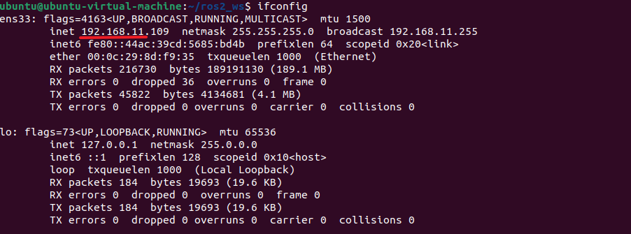

(4) Restart the network service with the following command, or shut down and restart the robot. It is recommended to shut down and restart the robot. Check the IP address on the robot’s OLED screen and connect to it:

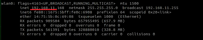

(5) Make sure the virtual machine and the robot are connected to the same local network. The IP addresses should be in the same subnet.
Virtual Machine:
Robot:

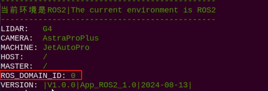

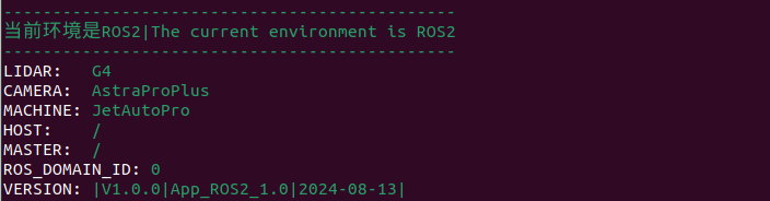

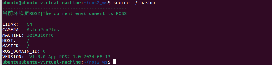

(6) After restarting, click on
to open the ROS 2 command line terminal on the robot. Ensure that the ROS_DOMAIN_ID is set to 0, matching the virtual machine:
Robot:
Virtual machine: Click-on
to access the virtual machine command-line terminal.

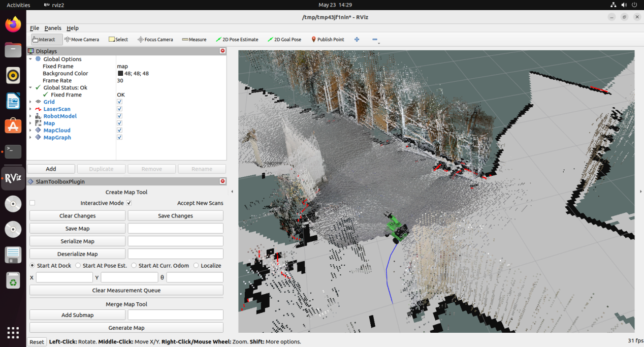

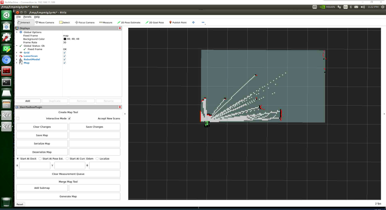

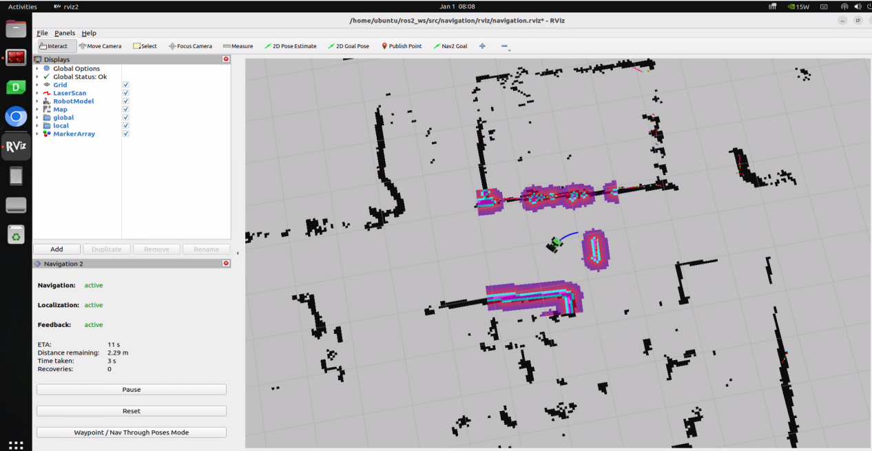

② Execute the following command to launch the RViz tool and display the map-building results.
(3) Enable Keyboard Control for the Robot
① Click

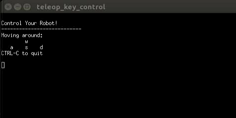

② Enter the following command to start the keyboard control node and press Enter key:
If the terminal displays the confirmation message shown below, the keyboard control service has started successfully.
③ Use your keyboard to move the robot around the area to create a more complete map. The table below shows the keyboard keys and their functions for controlling the robot’s movement.
| Key | Robot Action |
| W | Short press to switch to forward state and continuously move forward |
| S | Short press to switch to backward state and continuously move backward |
| A | Long press to interrupt the forward or backward state and turn left |
| D | Long press to interrupt the forward or backward state and turn right |
④ When controlling the robot’s movement with the keyboard to map, it’s advisable to reduce the robot’s movement speed appropriately. The slower the robot’s speed, the smaller the odometry relative error, leading to better mapping results. As the robot moves, the map displayed in RVIZ will continuously expand until the entire environment scene’s map construction is completed.

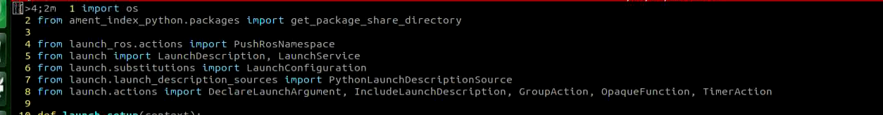

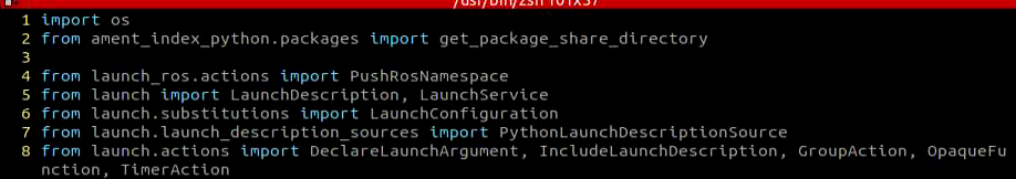

The launch file is located at: /home/ubuntu/ros2_ws/src/slam/launch/slam.launch.py
Import Library
The launch library can be explored in detail in the official ROS documentation: https://docs.ros.org/en/humble/How-To-Guides/Launching-composable-nodes
Set the Storage Path
Use the get_package_share_directory function to obtain the path of the slam package.
30 31 32 33 | if compiled == 'True': slam_package_path = get_package_share_directory('slam') else: slam_package_path = '/home/ubuntu/ros2_ws/src/slam' |
Initiate Other Launch File

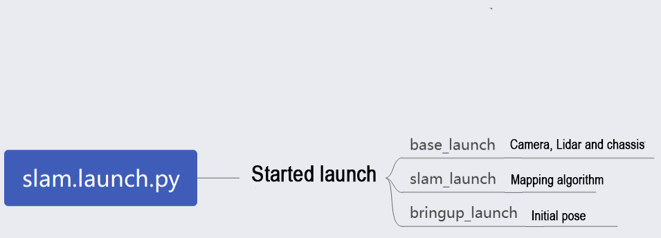

35 36 37 38 39 40 41 42 43 44 45 46 47 48 49 50 51 52 53 54 55 56 57 58 59 60 61 62 63 64 65 66 67 68 | base_launch = IncludeLaunchDescription( PythonLaunchDescriptionSource( os.path.join(slam_package_path, 'launch/include/robot.launch.py')), launch_arguments={ 'sim': sim, 'master_name': master_name, 'robot_name': robot_name }.items(), ) slam_launch = IncludeLaunchDescription( PythonLaunchDescriptionSource( os.path.join(slam_package_path, 'launch/include/slam_base.launch.py')), launch_arguments={ 'use_sim_time': use_sim_time, 'map_frame': map_frame, 'odom_frame': odom_frame, 'base_frame': base_frame, 'scan_topic': '{}/scan'.format(frame_prefix), 'enable_save': enable_save }.items(), ) if slam_method == 'slam_toolbox': bringup_launch = GroupAction( actions=[ PushRosNamespace(robot_name), base_launch, TimerAction( period=5.0, # 延时等待其它节点启动好 actions=[slam_launch], ), ] ) |
base_launch: Launch for hardware initialization
slam_launch: Launch for basic mapping
bringup_launch: Launch for initial pose setup

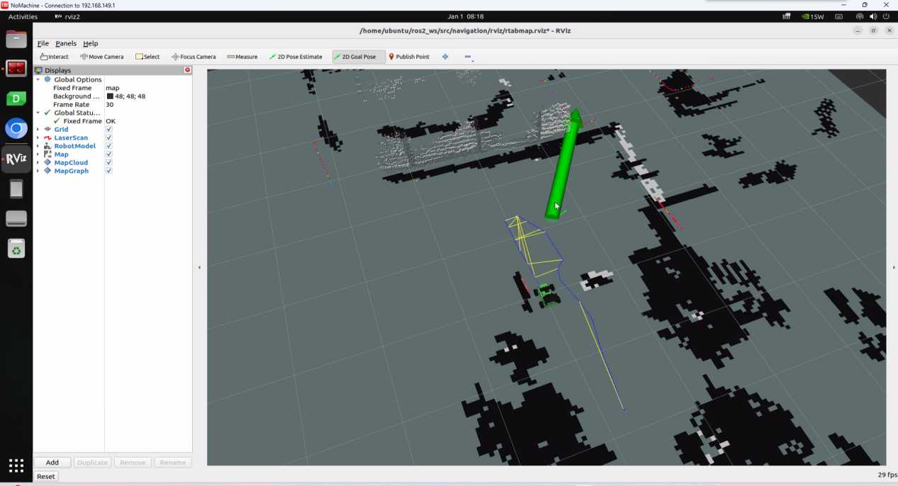

② Run the following command to initiate the rviz tool tp display the mapping result.
① Click-on
to launch a new command-line terminal.
② Enter the command to activate the keyboard control node and press Enter.
If the prompt shown in the image below appears, it means the keyboard control service has started successfully.
③ Move the robot around the current space to build a more complete map. The table below shows the keyboard keys and their functions for controlling the robot’s movement:

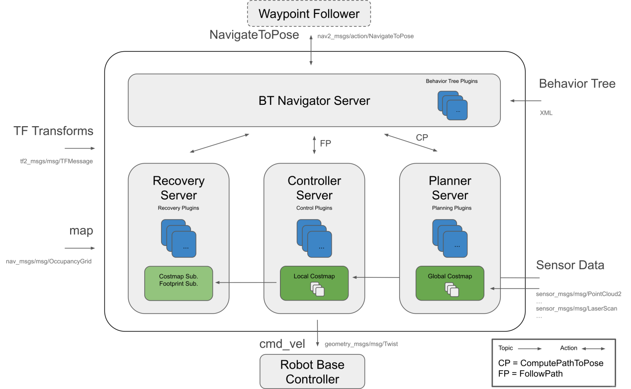

(1) Principle Structure Framework Explanation
The Nav2 project inherits and promotes the spirit of the ROS Navigation Stack. The project strives to safely navigate mobile robots from point A to point B. Nav2 can also be applied to other applications, including robot navigation tasks such as dynamic point tracking, which involves dynamic path planning, velocity calculation, obstacle avoidance, and recovery behaviors.
Nav2 utilizes behavior trees to invoke modular servers to accomplish an action. These actions can involve path computation, control forces, recovery, or any other navigation-related operation. These are achieved through independent nodes communicating with ROS Action servers and the behavior tree (BT). You can refer to the diagram below for a preliminary understanding of Nav2’s architecture:
The architecture diagram above can be further explained as one major component and three minor components, totaling four services.
Major:
BT Navigator Server: This service organizes and invokes the following three minor services.
Minor:

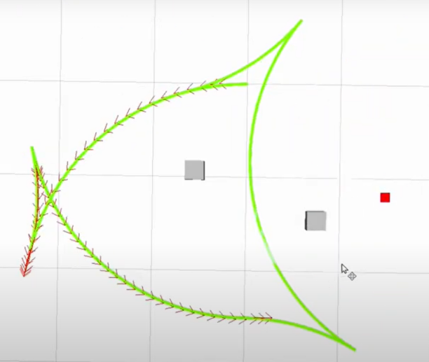

① Planner Server: Responsible for path planning, the planner server computes paths based on selected naming conventions and algorithms. These paths are essentially routes calculated on the map.
② Controller Server: Also known as the local planner in ROS 1, this server provides the method for the robot to follow the globally computed path or complete local tasks. In simple terms, it controls the robot’s movement based on the planned route.
③ Recovery Server: The backbone of the fault-tolerant system, the recovery server handles unknown or faulty conditions autonomously. Its goal is to manage unexpected situations the robot may encounter and recover autonomously. For example, if the robot falls into a hole while moving, the recovery server finds a way to get it out.
By continuously switching between planning paths, controlling the robot along the path, and autonomously recovering from issues, the robot achieves autonomous navigation.

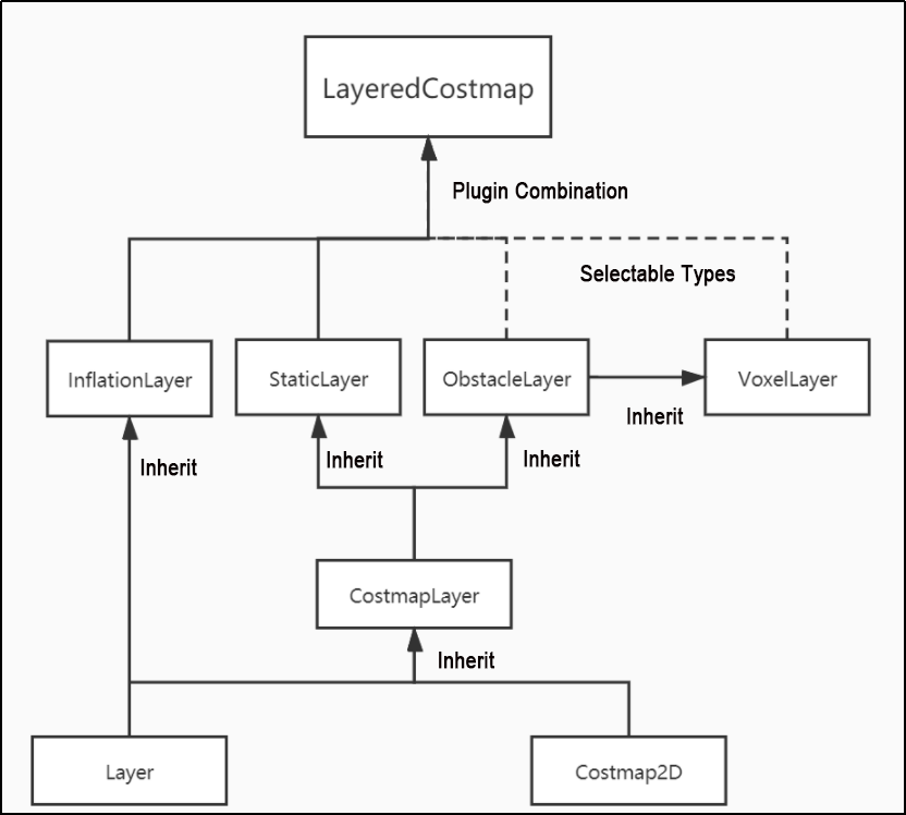

During robot navigation, relying solely on the original map generated by SLAM is insufficient. The robot may encounter new obstacles during movement, or it may find that obstacles in certain areas of the original map have disappeared. Therefore, the maintained map during robot navigation is dynamic. Depending on the update frequency and purpose, it can be categorized into the following two types:

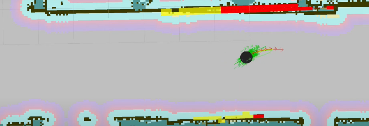

① Global Costmap:
The global costmap is mainly used for global path planners. As seen in the structure diagram above, it is located within the Planner Server.
Static Map Layer: This layer consists of the static map usually created by SLAM.
Obstacle Map Layer: This layer is used to dynamically record obstacle information perceived by sensors.
Inflation Layer: This layer inflates (expands outward) the maps from the previous two layers to prevent the robot’s shell from colliding with obstacles.
② Local Costmap:
The local costmap is primarily used for the local path planner, as seen in the Controller Server in the architecture diagram above. It typically consists of the following layers:
Obstacle Map Layer: This layer records dynamically sensed obstacle information from sensors.
Inflation Layer: This layer inflates (expands outward) on top of the obstacle map layer to prevent the robot’s shell from colliding with obstacles.

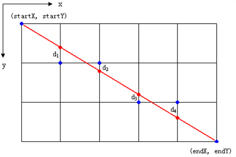

Before delving into costmap_2d, it’s important to introduce the Bresenham algorithm. This algorithm is utilized to draw a straight line between two points by calculating the closest point of a line segment on an n-dimensional raster. It relies solely on relatively fast integer operations such as addition, subtraction, and bit shifting, making it a fundamental algorithm in computer graphics.
To construct a set of virtual grid lines, we begin by passing them through the pixel centers of each row and column. The intersection points of these straight lines with each vertical grid line are calculated sequentially, starting from the line’s origin and moving towards its endpoint. Subsequently, the pixel closest to each intersection point within the pixel column is determined based on the sign of the error term.
The core concept of the algorithm relies on the assumption that k=dy/dx, where k represents the slope. Since the straight line originates from the center of a pixel, the initial error term d is set to d0=0. With each increment in the subscript X, d increases by the slope value k, i.e., d=d+k. When d≥1, 1 is subtracted from it to ensure that d remains between 0 and 1. If d≥0.5, the pixel closest to the upper-right of the current pixel is considered (i.e., (x+1,y+1)); otherwise, it’s closer to the pixel on the right (i.e.,(x+1,y)). For ease of calculation, let e=d−0.5; initially, e is set to -0.5, and it increments by k. When e≥0, the upper-right pixel of the current pixel (xi, yi) is selected, and when e<0, the pixel closer to the right (x+1,y) is chosen instead. Integers are preferred to avoid division. Since the algorithm only uses the sign of the error term, it can be replaced as follows: e1 = 2*e*dx.
The Costmap2D class is responsible for managing the cost value of each raster. Meanwhile, the Layer class serves as a virtual base class, standardizing the interfaces of costmap layers for each plugin. Key interface functions include:
The initialize function, which invokes the onInitialize function to initialize each costmap layer individually.
The matchSize function, found in the StaticLayer and ObstacleLayer classes, ensures consistency across costmap layers by calling the matchSize function of the CostmapLayer class. This initialization process sets the size, resolution, origin, and default cost value of each layer. In the inflationLayer class, a cost table is computed based on the expansion radius, enabling subsequent cost value queries based on distance. Additionally, the seen_ array is defined to mark traversed rasters. For the VoxelLayer class, initialization involves setting the size of the voxel grid.
The updateBounds function adjusts the size range of the current costmap layer requiring updates. For the StaticLayer class, the update range is determined by the size of the static map (typically used in global costmaps). Conversely, the ObstacleLayer class determines obstacle boundaries by traversing sensor data in clearing_observations.
The initialize and matchSize functions are executed only once each, while updateBounds and updateCosts are performed periodically, their frequency determined by map_update_frequency.
The CostmapLayer class inherits from both the Layer class and the Costmap2D class, providing various methods for updating cost values. The StaticLayer and ObstacleLayer classes, needing to retain cost values of instantiated layers, also inherit from CostmapLayer. The StaticLayer updates its costmap using static raster map data, whereas the ObstacleLayer employs sensor data for updates. In contrast, the VoxelLayer class considers z-axis data more extensively, particularly in obstacle clearance. This distinction primarily affects obstacle removal, with two-dimensional clearance in one case and three-dimensional clearance in the other.
Costmap measurement barriers offer remarkable flexibility. You can tailor a specific layer to your requirements, thereby managing pertinent barrier information effectively. For instance, if your robot is equipped solely with LiDAR, you’ll need to establish an Obstacles layer to handle obstacle data scanned by the LiDAR. In case ultrasonic sensors are integrated into the robot, creating a new Sonar layer becomes necessary to manage obstacle information from the sonic sensor. Each layer can define its own rules for obstacle updates, encompassing tasks such as obstacle addition, deletion, and confidence level updates. This approach significantly enhances the scalability of the navigation system.

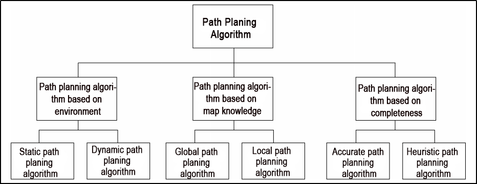

Commonly used path planning algorithms in robot autonomous navigation encompass Diikstra, A*, D*, PRM, RRT, genetic algorithms, ant colony algorithms, fuzzy algorithms, and others.
Dijkstra and A* are graph-based path search algorithms commonly utilized in robotic applications. The navigation function package integrates navfn, global planner, and carrot planner as global route planning plug-ins. Users have the option to select one of these plug-ins to load into move_base for utilization. Alternatively, they can opt for a third-party global path planning plug-in, such as SBPL_Lattice_Planner or srl_global_planner, or develop a custom global path planning plug-in adhering to the interface specification of nav_core.
Mobile robot navigation facilitates reaching a target point through path planning. The navigation planning layer comprises several components:
Global path planning layer: This layer generates a global weight map based on the provided goal and accepts weight map information. It then plans a global path from the starting point to the target location, serving as a reference for local path planning.
Local path planning layer: This component, constituting the local planning aspect of the navigation system, operates on the local weight map information derived from the weight map. It conducts local path planning considering nearby obstacle information.
Behavior execution layer: This layer integrates instructions and path planning data from the higher layers to determine the current behavior of the mobile robot.
Path planning algorithms for mobile robots are a crucial area of research, significantly impacting the efficiency of robotic operations.

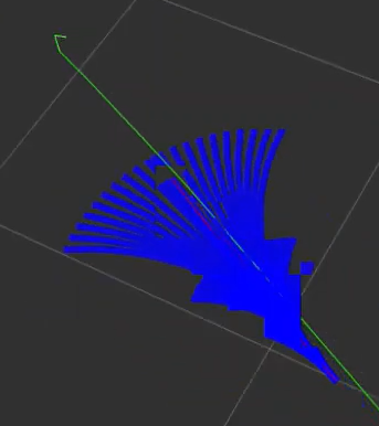

The Dynamic Window Approach (DWA), a classic algorithm for path planning and motion control of mobile robots, ensures safe navigation on a known map. By exploring the speed and angular velocity state space, DWA identifies the optimal combination for safe navigation. Below, you’ll find a basic description along with some key formulas of the DWA algorithm.
The core concept of the DWA algorithm involves the robot assessing its current state and sensor data to generate a series of potential motion trajectories (referred to as dynamic windows) in the speed and angular velocity state space. These trajectories are then evaluated based on criteria such as obstacle avoidance, maximizing forward speed, and minimizing angular velocity to select the optimal trajectory. Through iterative iterations of this process, the robot dynamically plans its trajectory in real-time to adapt to changing environments and obstacles.
(2) Formula
① Robot status: current position (x, y) and orientation (θ)
② Motion control parameters: linear velocity (V) and angular velocity (ω).
③ Range of velocity and angular velocity sampling: minimum (Vmin, ωmin) and maximum (Vmax, ωmax).
Time step: Δt
The formula is as below:
Velocity Sampling: In the DWA algorithm, the initial step involves sampling the state space of velocity and angular velocity to create a set of potential velocity-angular velocity pairs, known as dynamic windows.
Vsamples = [vmin, vmax]
ωsamples = [-ωmax, ωmax]
(Vsamples) denotes the speed sampling range, while (ωsamples) indicates the angular speed sampling range.
Motion Simulation: The DWA algorithm conducts a motion simulation for each speed-angular velocity pair, determining the trajectory of the robot based on these combinations in its current state.
x(t+1) = x(t) + v * cos(θ(t)) *Δt
y(t+1) = y(t) + v * sin(θ(t)) *Δt
θ(t+1) = θ(t) + ω * Δt
Here, x(t) and y(t) denote the robot’s position, θ(t) represents its orientation, v stands for linear velocity, ω for angular velocity, and Δt represents the time step.
(3) Trajectory Evaluation: The DWA algorithm assesses each generated trajectory using evaluation functions, including obstacle avoidance, maximum speed, and minimum angular velocity.
Obstacle Avoidance Evaluation: Detects if the trajectory intersects with obstacles.
Maximum Speed Evaluation: Verifies if the maximum linear speed on the trajectory falls within the permissible range.
Minimum Angular Velocity Evaluation: Ensures that the minimum angular velocity on the trajectory remains within the allowed range.
These evaluation functions can be defined and adjusted as per task requirements.
(4) Select optimal trajectory: The DWA algorithm chooses the trajectory with the highest evaluation score as the next move for the robot.

TEB Algorithm
(1) Description

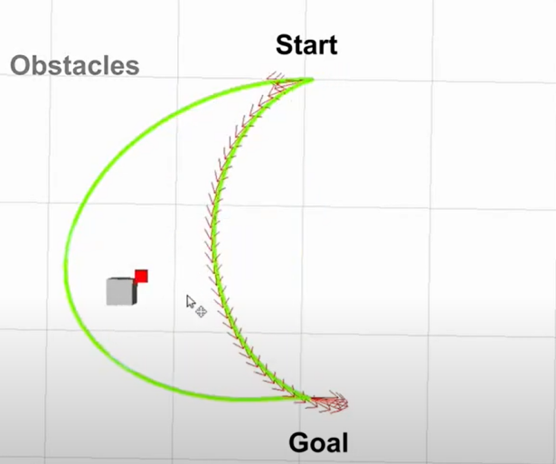

The TEB (Timed Elastic Band) algorithm is utilized for both path planning and motion planning, particularly in domains like robotics and autonomous vehicles. At its core, the TEB algorithm treats path planning as an optimization challenge, aiming to generate the best trajectory within a specified timeframe while accommodating dynamic constraints and obstacle avoidance needs for the robot or vehicle. Key characteristics of the TEB algorithm encompass:
① Time Layered Representation: The TEB algorithm employs time layering, dividing the trajectory into discrete time steps, each corresponding to a position of the robot or vehicle. This aids in setting timing constraints and preventing collisions.
② Trajectory Parameterization: TEB parameterizes the trajectory into displacements and velocities, facilitating optimization. Each time step is associated with displacement and velocity parameters.
③ Constrained Optimization: TEB considers dynamic constraints, obstacle avoidance, and trajectory smoothness, integrating them into the objective function of the optimization problem.
④ Optimization Solution: TEB utilizes techniques like linear quadratic programming (QP) or nonlinear programming (NLP) to determine optimal trajectory parameters that fulfill the constraints.
(2) Formula
The figure below illustrates the optimization objective function in the TEB algorithm:
In the following expression:
J(x) denotes the objective function, where x represents the trajectory parameter.
Wsmooth and Wobstacle represent weights assigned to smoothness and obstacle avoidance, respectively.
H signifies the smoothness penalty matrix.
f(xi, oj) represents the obstacle cost function between trajectory point xi and obstacle oj.
① Status Definition:
Firstly, we define the state of the robot (or vehicle) in the path planning problem as follows:
Position: P = [X, Y], indicating the coordinates of the robot on the two-dimensional plane.
Velocity: V = [Vx, Vy], representing the robot’s velocity along the X and Y axes.
Time: t, denoting the current time.
Control Input: u = [ux, uy], representing the control input of the robot, which can be speed or acceleration.
Robot Trajectory: x(t) = [p(t), v(t)], indicating the state of the robot at time t.
② Target Function:
The essence of the TEB algorithm lies in solving an optimization problem. The objective is to minimize a composite function comprising various components:
Jsmooth(x): Smoothness objective function, ensuring trajectory smoothness.
Jobstacle(x): Obstacle avoidance objective function, preventing collisions with obstacles.
Jdynamic(x): Dynamic objective function, ensuring compliance with the robot’s dynamic constraints.
③ Smoothness objective function Jsmooth(x):
Smoothness objective functions typically involve the curvature of trajectories to ensure the generated trajectories are smooth. It can be represented as:
Where k(t) is the curvature.
④ Obstacle avoidance objective function Jobstacle(x):
The obstacle avoidance objective function calculates the distance between trajectory points and obstacles. It penalizes trajectory points that are in close proximity to obstacles. The specific obstacle cost function, denoted as f(x,o), can be adjusted according to specific requirements or needs.
⑤ Dynamic objective function Jdynamic(x):
The dynamics objective function ensures that the generated trajectory adheres to the robot’s dynamic constraints, which are determined by its kinematics and dynamics model. This typically includes limitations on velocity and acceleration.
⑥ Optimization:
In the end, the Trajectory Optimization with Ellipsoidal Bounds (TEB) algorithm addresses the stated objective function by framing it as a constrained optimization problem. This problem incorporates optimization variables for trajectory parameters, time allocation, and control inputs. Typically, this optimization problem falls under the category of nonlinear programming (NLP) problems.

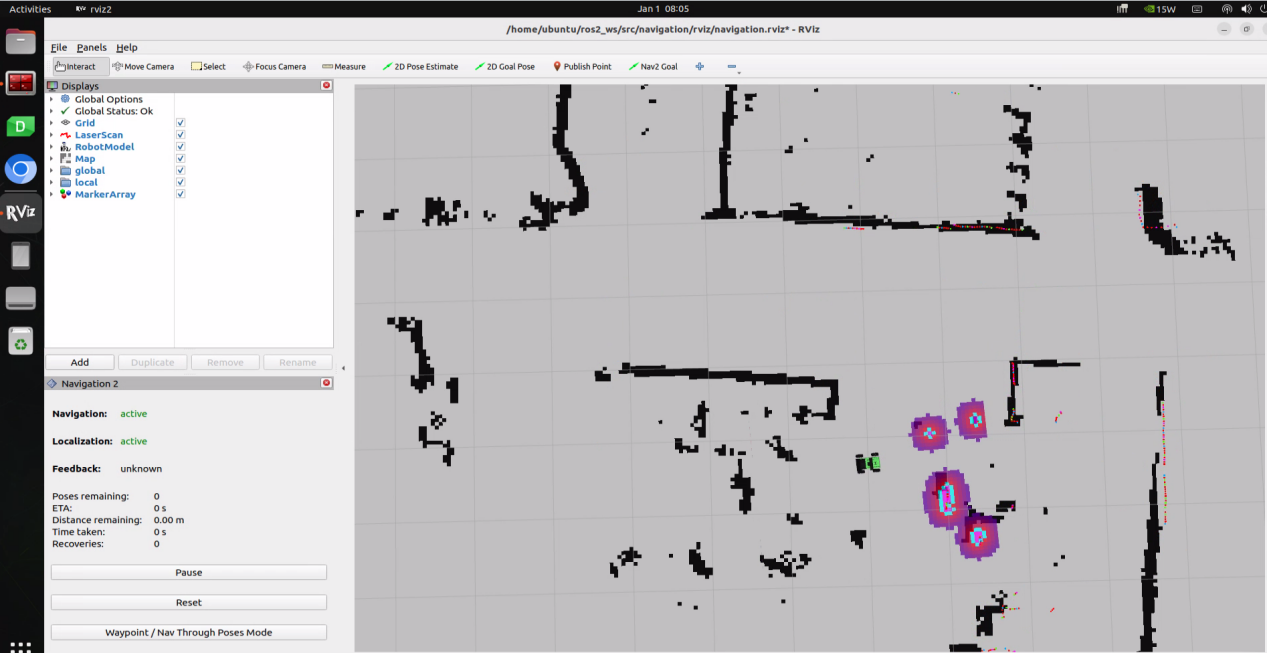

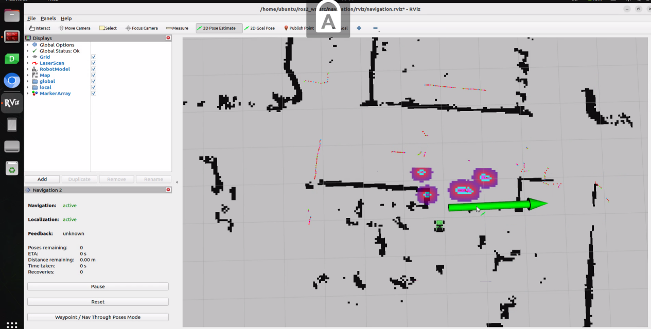

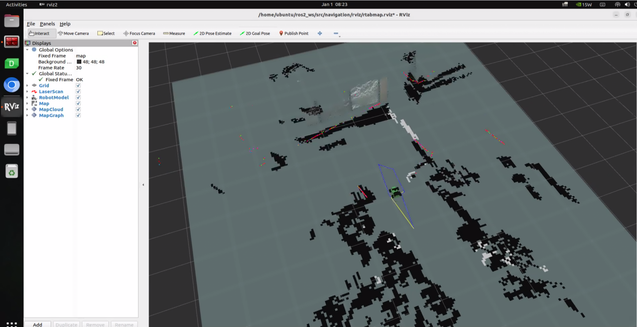

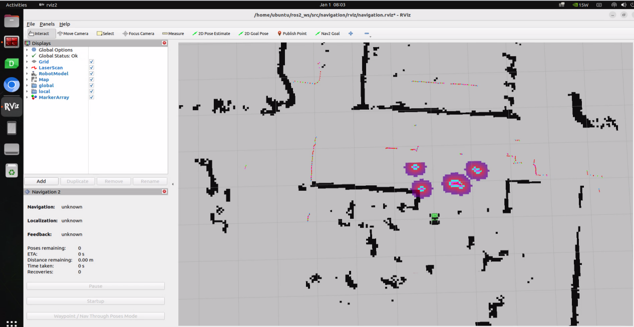

Point-to-Point Navigation
In the software menu bar, “2D Pose Estimate” is used to set the initial position of the JetAutor robot; “2D Nav Goal” is used to set a single target point for the robot; “Publish Point” is used to set multiple target points for the robot.
(1) Click
to set the initial position of the robot. On the map interface, choose a position, click, and drag the mouse to select the robot’s pose.
(2) After setting the initial position of the robot, the effect is as shown in the figure below:
(3) Click

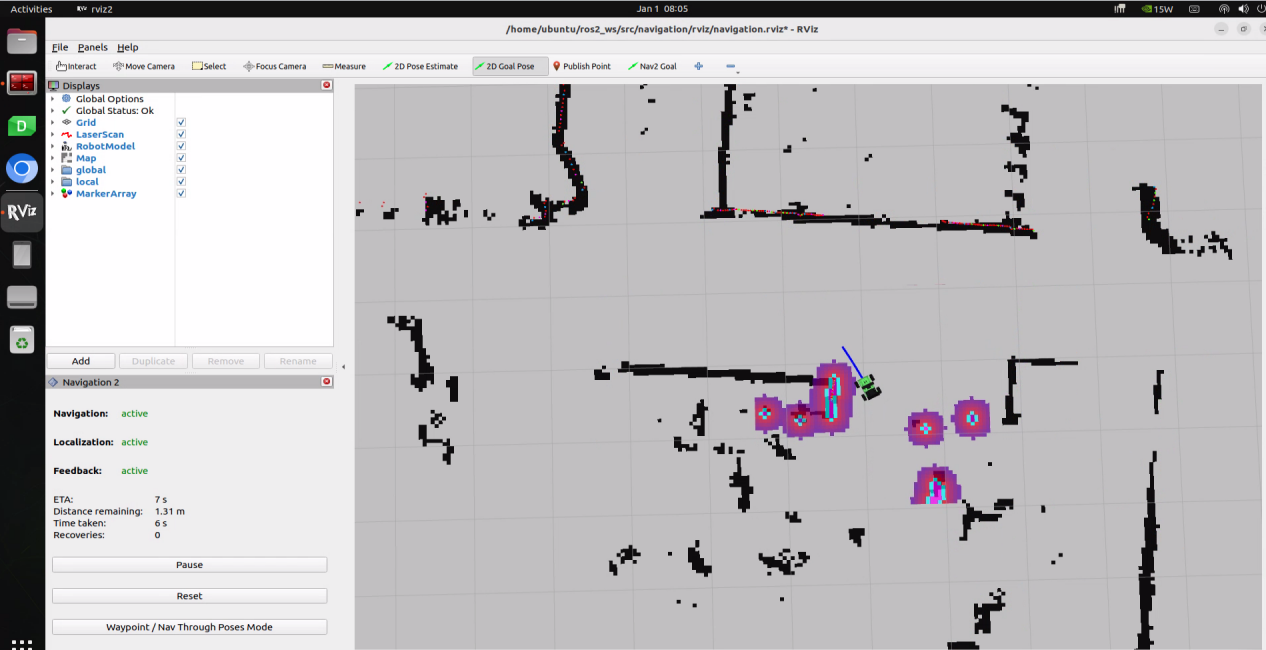

and select a location on the map interface as the target point. Click the mouse once at that point. After selection, the robot will automatically generate a route and move to the target point.
(4) After confirming the target point, the map will display two paths: the green line represents the direct path between the robot and the target point, and the dark blue line represents the planned path of the robot.
(5) When encountering obstacles, the robot will bypass them and continuously adjust its posture and travel route.

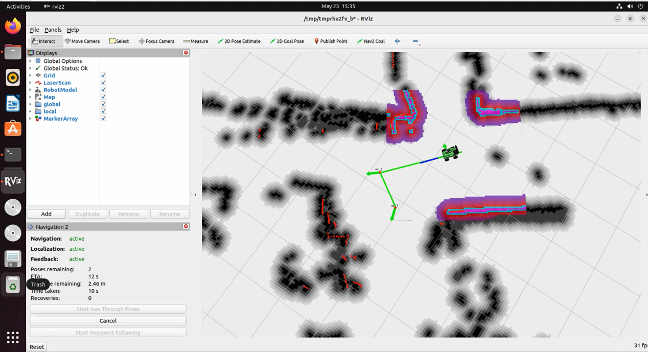

Multi-Point Navigation
(1) Click the “waypoint” button to start multi-point navigation:
(2) Set each navigation point using
(3) Finally, click “Start Nav Through Poses” to make the robot move through the set target points one by one.
Clicking “Start Nav Through Poses” will not track the robot’s pose at each navigation point. “Start Waypoint Following” will control the robot to ensure it reaches the pose at each navigation point.
(4) The effect during multi-point navigation is shown in the figure below, with the robot reaching the target points in sequence:
(5) The effect after completing multi-point navigation is shown in the figure below:

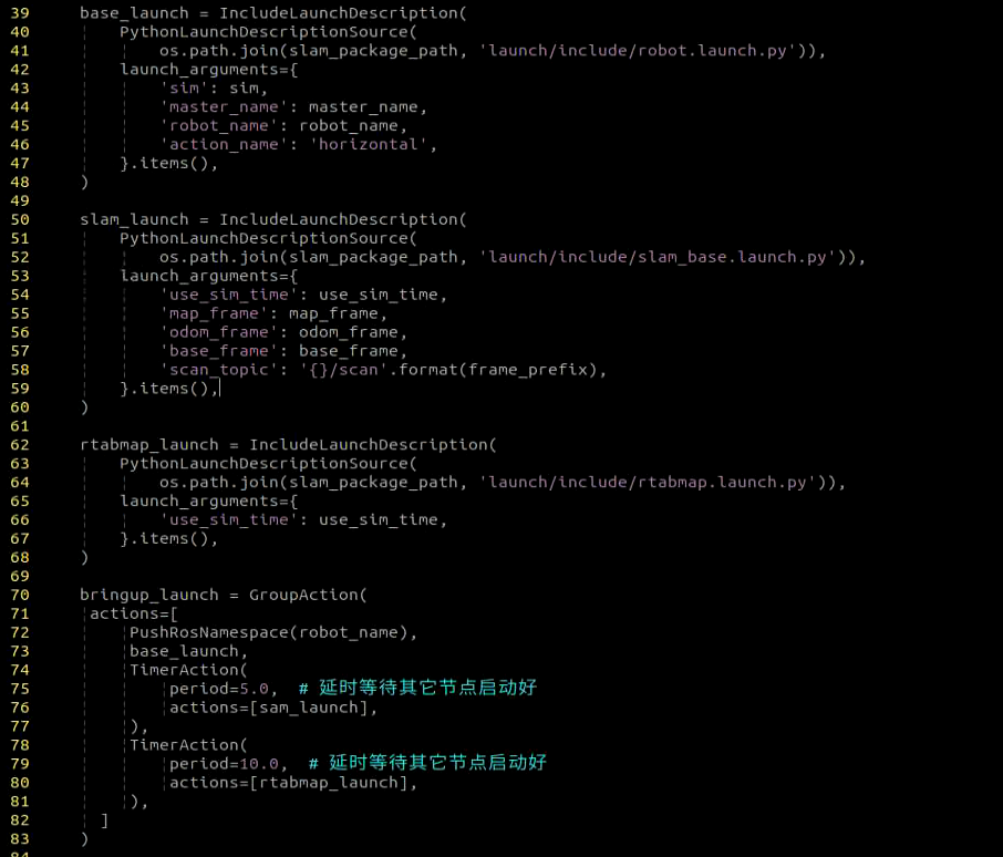

Launch Description
The path to the launch file is located at: /home/ubuntu/ros2_ws/src/navigation/launch/navigation.launch.py
(1) Set Paths
Locate the paths for the peripherals, controller, and servo_controller packages.
12 13 14 15 16 17 | if compiled == 'True': slam_package_path = get_package_share_directory('slam') navigation_package_path = get_package_share_directory('navigation') else: slam_package_path = '/home/ubuntu/ros2_ws/src/slam' navigation_package_path = '/home/ubuntu/ros2_ws/src/navigation' |
(2) Launch Other Files

(3) Execute the command to disable the app auto-start service:
(4) Enter the following command to start the navigation service and press Enter:
Virtual Machine Operations
(1) Click-on
to start the virtual-machine command-line terminal.
(2) Run the following command to launch the RVIZ display tool.

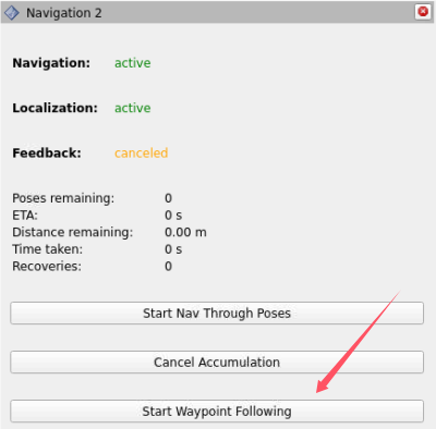

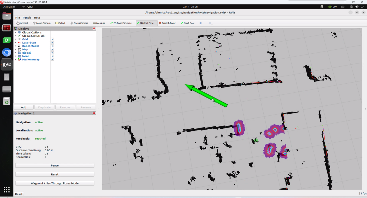

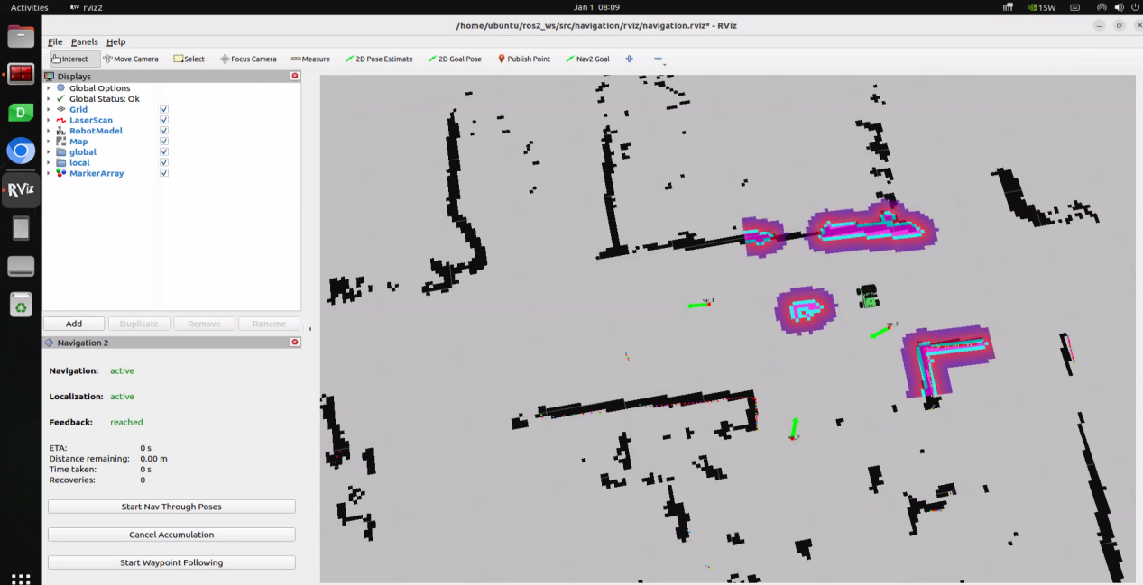

In the software menu bar, “2D Nav Goal” is used to set a single target point for the robot, and “Publish Point” is used to set multiple target points for the robot.
(3) Click
, and on the map interface, select a location as the target point by clicking the mouse once at that point. After the selection is made, the robot will automatically generate a route and move to the target point.
(4) After confirming the target point, the map will display two paths: a line composed of blue squares representing the straight-line path between the robot and the target point, while the dark blue line represents the planned path of the robot.
(5) After encountering obstacles, the car will navigate around them and continuously adjust its posture and trajectory.
Launch Description
The launch file is saved in:/home/ubuntu/ros2_ws/src/navigation/launch/navigation.launch.py
(1) Set Paths
base_launch for various hardware
navigation_launch to start the navigation algorithm
bringup_launch to initialize actions
43 44 45 46 47 48 49 50 51 52 53 54 55 56 57 58 59 60 61 62 63 64 65 66 67 | navigation_launch = IncludeLaunchDescription( PythonLaunchDescriptionSource(os.path.join(navigation_package_path, 'launch/include/bringup.launch.py')), launch_arguments={ 'use_sim_time': use_sim_time, 'map': os.path.join(slam_package_path, 'maps', map_name + '.yaml'), 'params_file': os.path.join(navigation_package_path, 'config', 'nav2_params.yaml'), 'namespace': robot_name, 'use_namespace': use_namespace, 'autostart': 'true', 'use_teb': use_teb, }.items(), ) bringup_launch = GroupAction( actions=[ PushRosNamespace(robot_name), base_launch, TimerAction( period=10.0, # 延时等待其它节点启动好 actions=[navigation_launch], ), ] ) return [sim_arg, map_name_arg, master_name_arg, robot_name_arg, use_teb_arg, bringup_launch] |
