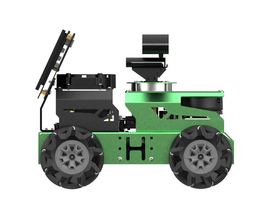

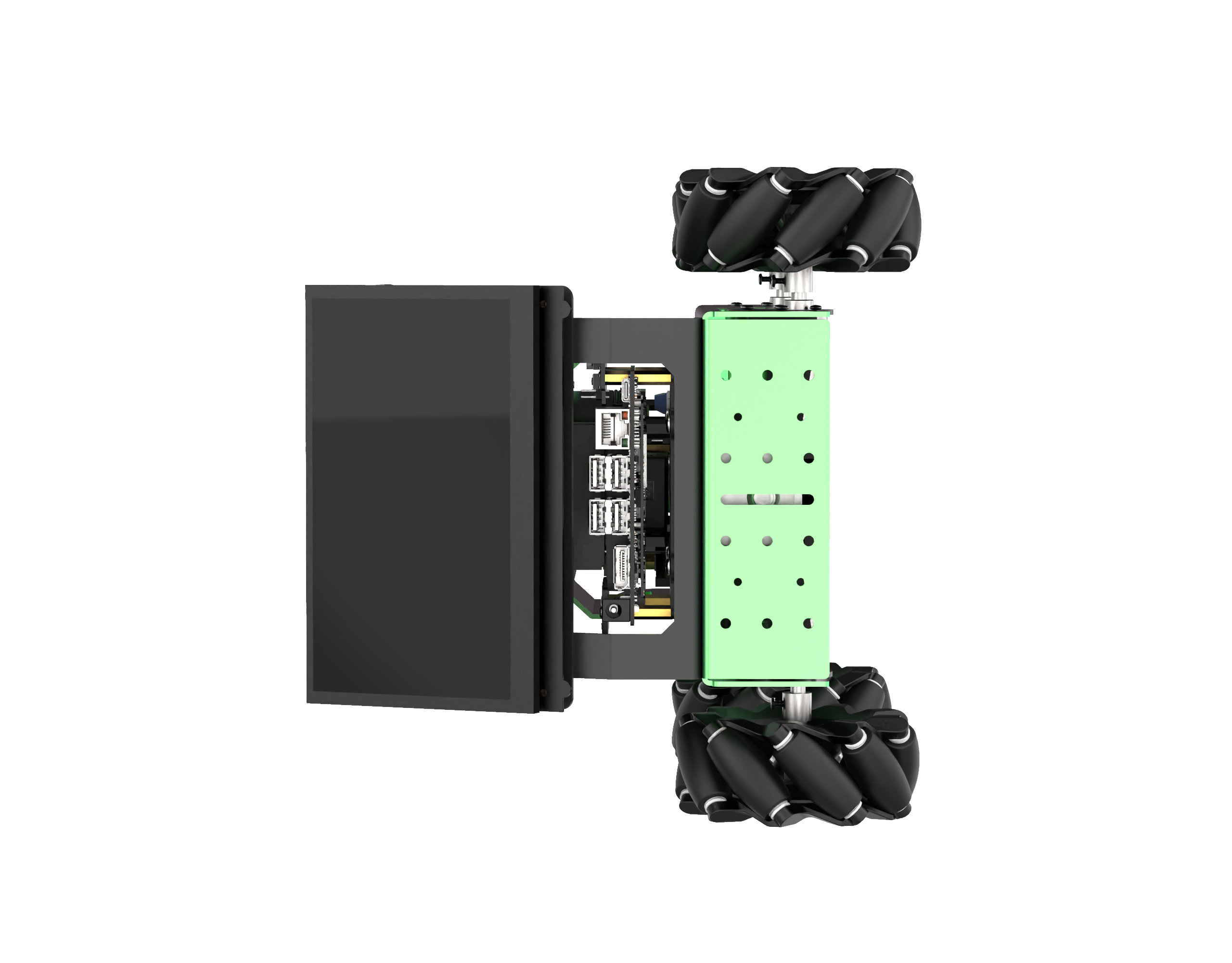

JetAuto features a Mecanum wheel chassis. Mecanum wheels use multiple small, freely rotating rollers to support the vehicle’s weight. These wheels are typically located at the bottom of the chassis and can rotate independently, allowing the vehicle to turn and maneuver more easily. Mecanum wheel vehicles are commonly used in urban environments and on roads due to their high maneuverability and ease of turning.
2.1.2 Mecanum Wheel:
  • Hardware Structure

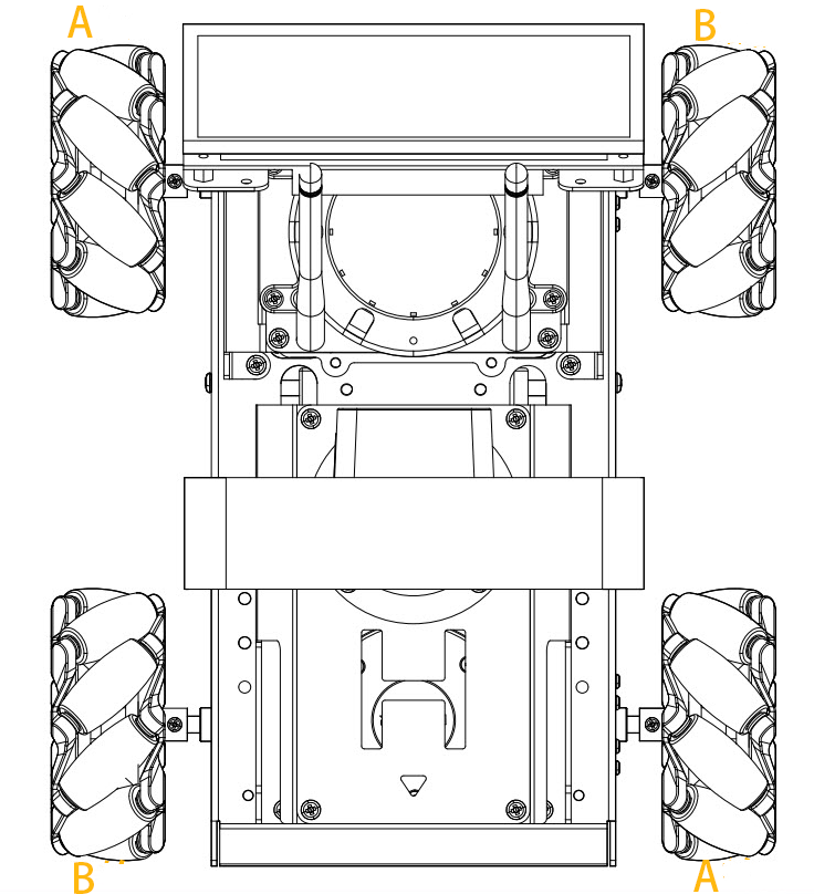

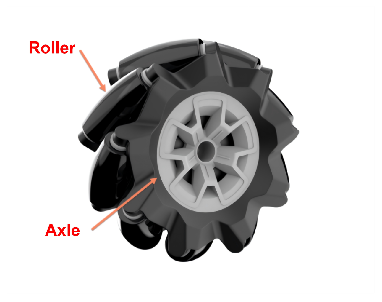

The Mecanum wheel comprises rollers and an axle. The axle functions as the main support structure for the entire wheel, with rollers attached to it. The axle axis is positioned at a 45-degree angle to the roller axis. Typically, Mecanum wheels operate in groups of four, with two left wheels and two right wheels. Wheels A and B are symmetrical.
There are various combinations of four Mecanum wheels, such as AAAA, BBBB, AABB, ABAB, BABA. However, not all combinations allow the robot car to move in all directions, including forward, backward, and sideways. The Mecanum-wheel chassis combination is ABAB, enabling omnidirectional movement.
  • Physical Characteristics
The vehicle achieves omnidirectional motion by summing up the propelling forces of the ground-engaging rollers. This summation can occur in any direction through adjustments in wheel rotation direction and torque magnitude for the four wheels.
Because of the rollers’ specific orientation at a certain angle to the wheel circumference, Mecanum wheels have the ability to slip sideways. The generatrix of these small rollers is unique. As the Mecanum wheel rotates around its fixed axle, each small roller’s envelope forms a cylindrical surface, allowing the wheel to continuously roll forward.

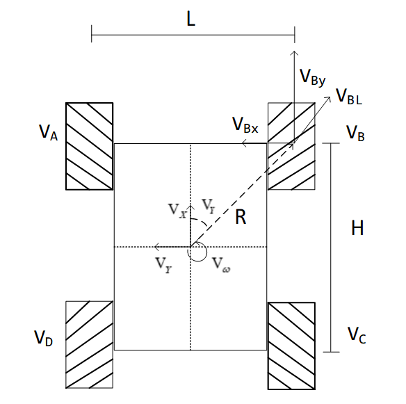

When conducting kinematic analysis, we can consider the kinematic model of Mecanum wheels, which includes the following parameters:
(1) Vx: Velocity of the Mecanum wheel in the X-axis (typically front and rear direction).
(2) Vy: Velocity of the Mecanum wheel in the Y-axis (typically left and right direction).
(3) Vω: Angular velocity of the Mecanum wheel chassis (rotation speed of the chassis around its own center).
(4) Real-time velocities of the four wheels of the Mecanum wheel.
(5) The motion of the right front wheel in the plane can be decomposed into:
(6) VBx: Velocity of the Mecanum wheel in the X-axis (typically front and rear direction).
(7) VBy: Velocity of the Mecanum wheel in the Y-axis (typically left and right direction).
(8) L: Distance between the centers of the left and right wheels.
(9) H: Distance between the centers of the front and rear wheels.
(10) θω: Angle formed by the chassis body center and the center of the right front wheel, typically 45°.
(11) With these parameters, we can perform kinematic analysis of the Mecanum wheel chassis. The following are key mathematical formulas:
  • Kinematics Formula:
To simplify the mathematical model for kinematics, we make the following two idealized assumptions:
(1) Omni-directional wheels do not slip on the ground, and there is sufficient friction with the ground.
(2) The 4 wheels are distributed at the corners of a rectangle or square, with the wheels parallel to each other.
Here, we decompose the rigid body motion of the car into three components linearly. By calculating the velocities of the four wheels when the output Mecanum wheel chassis translates along the X+ and Y+ directions and rotates along the Z+ direction, we can combine these three simple motions using formulas to determine the required speeds of the four wheels.
In the equations, A, B, C, and D represent the rotational speeds of the four wheels, i.e., the motor speeds. VX is the translation speed of the car along the X-axis, VY is the translation speed along the Y-axis, and ω is the rotational speed along the Z-axis. L/2 is half of the car’s wheelbase, and H/2 is half of the car’s axle distance.
(1) The velocity components of each wheel during the robot’s translation along the X-axis can be calculated using the following formulas:
Where,
VA,VB,VC,VD:Real-time velocities of the four Mecanum wheels.
VX:Velocity of the Mecanum wheel in the X-axis direction.
(2) When the robot translates along the Y-axis, the speed component of each wheel can be calculated using the following formula:
Where, VY is the velocity of the robot in the Y-axis direction.
(3) When the robot rotates along the Z-axis, the speed component of each wheel can be calculated using the following formulas:
Where,:The angular velocity of the Mecanum wheel chassis (i.e., the speed at which the chassis rotates around its own center)
(4) Combining the velocities in the X, Y, and Z directions allows for the computation of the rotation speeds of the four wheels based on the motion state of the car.

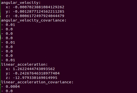

IMU (Inertial Measurement Unit) is a device that measures the three-axis attitude angles (angular velocity) and acceleration of an object. The gyroscope and accelerometer are the main components of the IMU, providing a total of 6 degrees of freedom to measure the angular velocity and acceleration of the object in three-dimensional space. Upon receiving the first IMU message, the node will prompt you to maintain the IMU in a specific orientation and press Enter to record the measurement values. After completing measurements in all 6 directions, the node will calculate calibration parameters and write them to the specified YAML file. The specific steps are as follows:
After the node receives the first IMU message, it will prompt you to hold the IMU in a specific direction and then press Enter to record the measurement. After completing all 6 directions, the node will calculate the calibration parameters and write them to the specified YAML file. The specific steps are as follows:

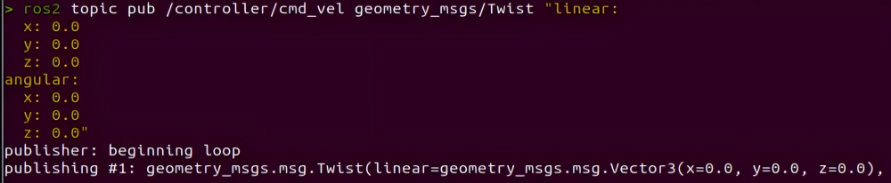

(8) Next, enter the following command and press Enter to start the chassis control node:
(9) Open a new command-line terminal, enter the following command, and press Enter to start the angular velocity calibration:
ros2 launch calibration angular_calib.launch.py

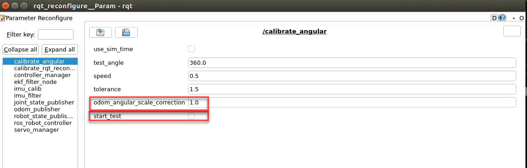

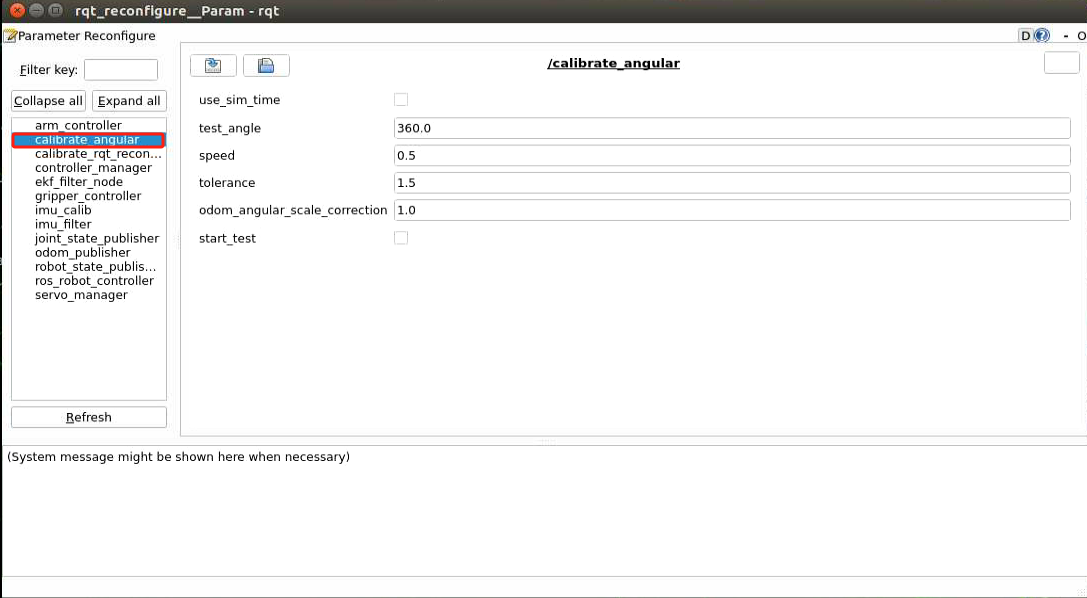

Click on “calibrate_angular” on the left side. The calibration interface will appear as shown.
The meanings of the parameters on the left side of the interface are as follows:
The first parameter, test_angle is for testing the rotation angle, with a default value of 360°.
The second parameter, speed is the linear speed, with a default value of 0.15 meters per second.
The third parameter, tolerance is the error value. The smaller the error value, the greater the robot’s jitter after reaching the target position.
The fourth parameter, odom_angle_scale_correction is the odometer angle scale correction.
The fifth parameter, start_test is the button to start testing the odometer angle scale correction.
Place the robot in a horizontal position and check “start_test (start test).” The robot will then rotate in place for one full circle.
If the rotation does not complete a full circle and there is a deviation, you need to adjust the “odom_angle_scale_correction (motor rotation scale correction)” value. This value adjusts the scaling ratio of the motor during rotation. It is recommended to adjust by increments of 0.01 each time and test until the robot can complete a full circle. Record this value.

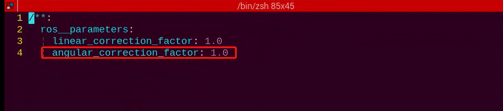

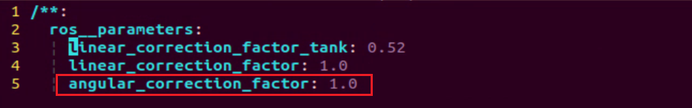

(10) After calibration is complete, enter the following command to navigate to the calibration configuration file directory and update it with the calibrated parameter values.
cd ~/ros2_ws/src/driver/controller/config && vim calibrate_params.yaml
Press ‘I’ key to navigate to the editing mode, and modify the value of “angular_correctqion_factor” to the adjusted value of “odom_angule_scale_correction”.
(11) After modification, press the “ESC” key, enter “:wq” to exit and save the changes.

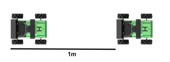

Position the robot on a flat and open surface. Mark the starting point with tape or any other indicator in front of the robot, and position the endpoint tape or another marker 1 meter ahead of the robot.

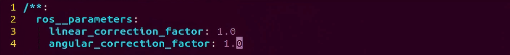

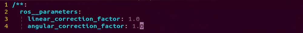

(4) Before starting the calibration, navigate to the calibration configuration file directory and open the configuration file.
(5) Change the linear velocity parameter linear_correction_factor to 1.0, then proceed with the calibration.
(6) After making the change, press “ESC”, type “:wq”, and press Enter to save and exit.

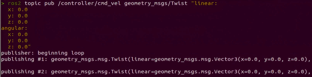

(7) Next, enter the following command and press Enter to start the chassis control node:
(8) Open a new command-line terminal, enter the following command, and press Enter to start the linear velocity calibration:
ros2 launch calibration linear_calib.launch.py

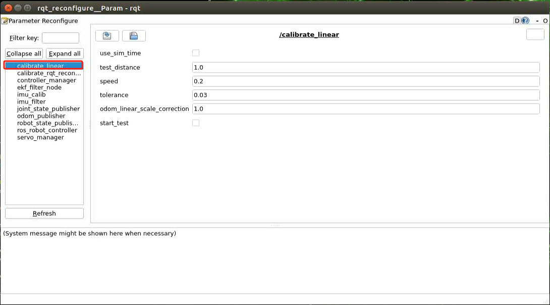

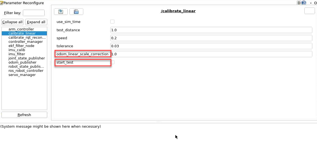

(9) Once the calibration program starts, click on “calibrate_linear” on the left side. The calibration interface will appear as shown.
The first parameter test_distance, is for testing the distance, with a default value of 1 meter.
The second parameterspeed is the linear speed, with a default value of 0.2 meters per second.
The fourth parametertoleranceis the error value. The smaller the error value, the greater the robot’s jitter after reaching the target position.
The fifth parameter odom_linear_scale_correction is the odometer linear scale correction.
The sixth parameterstart_test is the button to start testing the odometer linear scale correction.
(10) If there is a deviation, you need to adjust the value of odom_linear_scale_correction. This value controls the scaling factor for the motor’s forward movement. It is recommended to adjust the value in increments of 0.01.

(12) Press the ‘i’ key to enter edit mode, and update the value of linear_correction_factor (forward correction factor) to match the adjusted odom_linear_scale_correction value.
(13) After making the changes, press the “ESC” key, type “:wq”, and press Enter to save and exit.
(14) To stop this functionality, press ‘Ctrl+C’ in the terminal. If it does not stop immediately, try pressing the keys repeatedly.

(2) Data Viewing

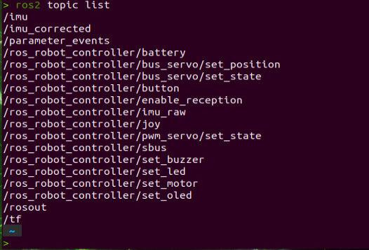

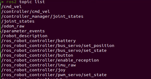

① Open a new command-line terminal, and run the following command to check the current topic:
ros2 topic list
② Enter the command to view the type, publisher, and subscribers of the “/imu” topic. You can replace “/imu” with the topic you want to view. The type of this topic is “sensor_msgs/msg/Imu”.
ros2 topic info /imu
③ Use the following command to display the content of the topic message. Feel free to replace ‘imu’ with the name of the topic you wish to view.
ros2 topic echo /imu
The terminal will display the data from the three axes of the IMU.

(1) Open a new command-line terminal, and run the command below to check the current topic.
ros2 topic list

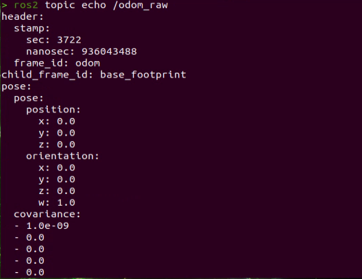

(2) Enter the command to view the type, publisher, and subscribers of the “/odom_raw” topic. You can replace “/odom_raw” with the topic you want to view. The type of this topic is “nav_msgs/msg/Odometry”.
ros2 topic info /odom_raw
(3) Enter the command to print the topic message contents. You can replace the topic you want to view as needed.
ros2 topic echo /odom_raw
The message content includes acquired pose and velocity data.

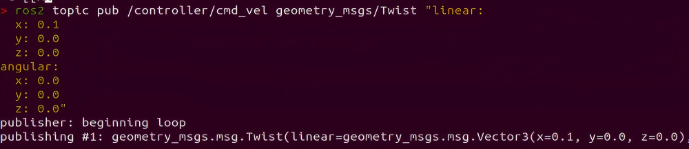

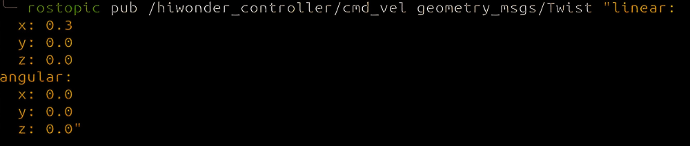

(5) Open a new ROS2 command-line terminal, then enter the following command to enable the speed control.
ros2 topic pub /controller/cmd_vel geometry_msgs/Twist "linear:
x: 0.0
y: 0.0
z: 0.0
angular:
x: 0.0
y: 0.0
z: 0.0"

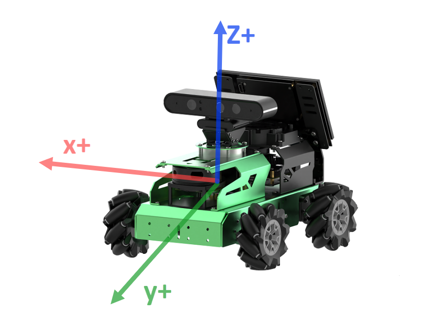

In this context, linear represents the set linear velocity, considering the robot’s viewpoint where the X-axis points forward without any influence from the Y or Z directions.
On the other hand, angular pertains to the set angular velocity. A positive Z-value induces a left turn in the robot, while a negative Z-value causes the robot to turn right. This configuration has no impact on the X and Y directions.
  • MIn this scenario, the linear velocity (x) is measured in meters per second, and it is advisable to maintain it within the range of “-0.6 to 0.6”.
  • The angular velocity (z) denotes the turning speed and is determined by the formulas V=ωR (linear velocity equals angular velocity times radius) and tanΦA=D/R (where z=ω, D=0.213, and ΦA represents the turning angle). The angle ΦA should be within the range of 0 to 36 degrees.
(6) Use the arrow keys to navigate and modify the relevant parameters. For example, to make the robot move forward, adjust the linear velocity (X) to 0.1, and then press Enter to execute the action.
(7) If you need to stop the car, open a new terminal and change the previously modified linear velocity back to “0.0”, then press Enter.
(8) To close this feature, press “Ctrl+C” in each terminal interface.
To bring the robot car to a stop, please create a new terminal and adjust the linear velocity. Using the ‘Ctrl+C’ shortcut alone may not effectively halt the robot car.
  • Change Forward Speed
By modifying the linear velocity value (X), the robot can achieve forward movement at variable speeds. For instance, to make the robot shift diagonally to the left front, during step (5) in Disable App Service and Initiate Speed Control, set X to ‘X: 0.3’.
Upon pressing Enter, the robot will move forward at a speed of 0.3 meters per second in a straight direction.
  • Program Outcome
After the game starts, the robot will go forward at the speed of 0.3m/s.

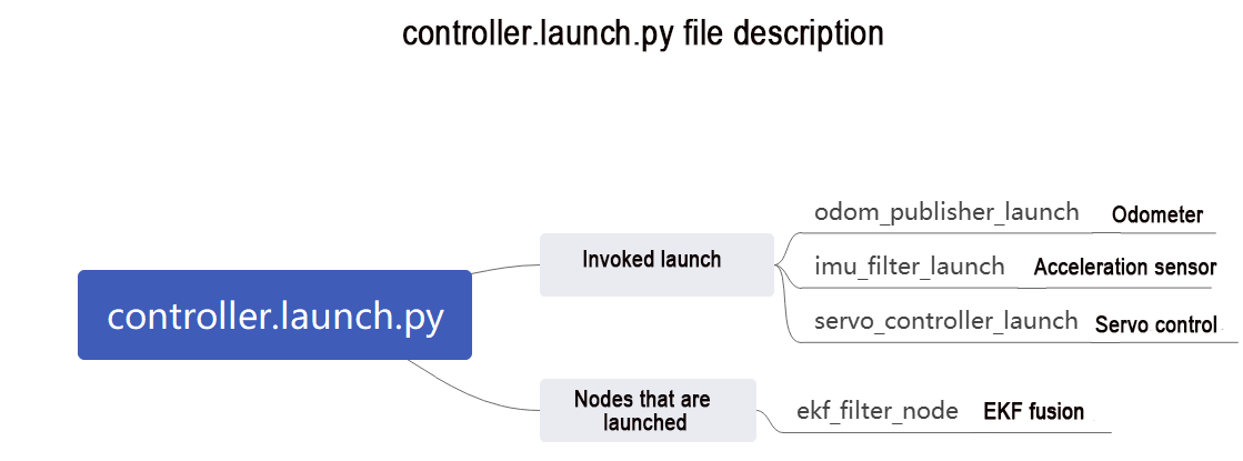

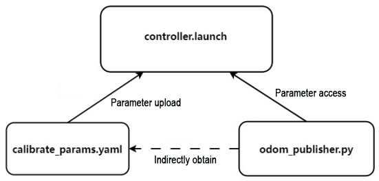

controller.launch is the launch file, calibrate_params.yaml is the configuration file, and odom_publisher.py is the program script.
When starting up, the launch file is executed first. It loads the YAML configuration file and passes the parameters to the ROS node. The node then reads these parameters from the ROS parameter server, initializes accordingly, and communicates with other nodes to collaboratively achieve the desired functionality.
(1) Launch File
The launch file is located in: /home/ubuntu/ros2_ws/src/driver/controller/launch/controller.launch.py
① Set the storage path
Retrieve the paths for the three packages: peripherals, controller, and servo_controller.
    if compiled == 'True':
        servo_controller_package_path = get_package_share_directory('servo_controller')
        servo_controller_package_path = '/home/ubuntu/ros2_ws/src/driver/servo_controller'
    odom_publisher_launch = IncludeLaunchDescription(
        PythonLaunchDescriptionSource([os.path.join(controller_package_path, 'launch/odom_publisher.launch.py')
        launch_arguments={
            'namespace': namespace,
            'imu_frame': imu_frame,
            'frame_prefix': frame_prefix,
            'base_frame': base_frame,
            'odom_frame': odom_frame
        }.items()
② Initiate other Launch files
        launch_arguments={
        }.items()
odom_publisher_launch Odometer launch
imu_filter_launch IMU launch
③ Initiate Node
Launch the EKF fusion node.
70
71
72
73
74
75
76
77
78
79
80
81
82
83
84
85
86
87
    ekf_filter_node = Node(
        package='robot_localization',
        executable='ekf_node',
        name='ekf_filter_node',
        output='screen',
        parameters=[ekf_param, {'use_sim_time': use_sim_time}],
        remappings=[
            ('/tf', 'tf'),
            ('/tf_static', 'tf_static'),
            ('odometry/filtered', 'odom'),
            ('cmd_vel', 'controller/cmd_vel')
        condition=IfCondition(enable_odom),
    servo_controller_launch = IncludeLaunchDescription(
        PythonLaunchDescriptionSource([os.path.join(servo_controller_package_path, 'launch/servo_controller.launch.py')
        launch_arguments={
        }.items()

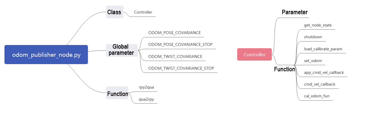

The Python program is saved in: /home/ubuntu/ros2_ws/src/driver/controller/controller/odom_publisher_node.py
① Import Library
 2
#!/usr/bin/env python3
# -*- coding: utf-8 -*-
import math
import time
import rclpy
import signal
import threading
from rclpy.node import Node
from controller import mecanum
from nav_msgs.msg import Odometry
from ros_robot_controller_msgs.msg import MotorsState, BusServoState, SetBusServoState
from geometry_msgs.msg import Pose2D, Pose, Twist, PoseWithCovarianceStamped, TransformStamped
② Main Function
239
240
241
def main():
    node = Controller('odom_publisher')
    rclpy.spin(node)  # 循环等待ROS2退出
The controller class is invoked here, and wait for the node to exit.
③ Global Parameter

④ Function
61
def rpy2qua(roll, pitch, yaw):
    cy = math.cos(yaw*0.5)
    sy = math.sin(yaw*0.5)
    cp = math.cos(pitch*0.5)
    sp = math.sin(pitch*0.5)
    cr = math.cos(roll * 0.5)
    sr = math.sin(roll * 0.5)
    q = Pose()
    q.orientation.w = cy * cp * cr + sy * sp * sr
    q.orientation.x = cy * cp * sr - sy * sp * cr
    q.orientation.y = sy * cp * sr + cy * sp * cr
    q.orientation.z = sy * cp * cr - cy * sp * sr
    return q.orientation
def qua2rpy(x, y, z, w):
    roll = math.atan2(2 * (w * x + y * z), 1 - 2 * (x * x + y * y))
    pitch = math.asin(2 * (w * y - x * z))
    yaw = math.atan2(2 * (w * z + x * y), 1 - 2 * (z * z + y * y))
    return roll, pitch, yaw
The function rpy2qua is used to convert Euler angles to quaternions.
The function qua2rpy is used to convert quaternions to Euler angles.
