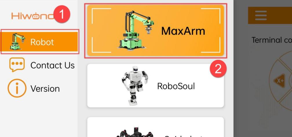

(1) If the main interface does not show up, please click on icon and click “Robot” to select MaxArm.

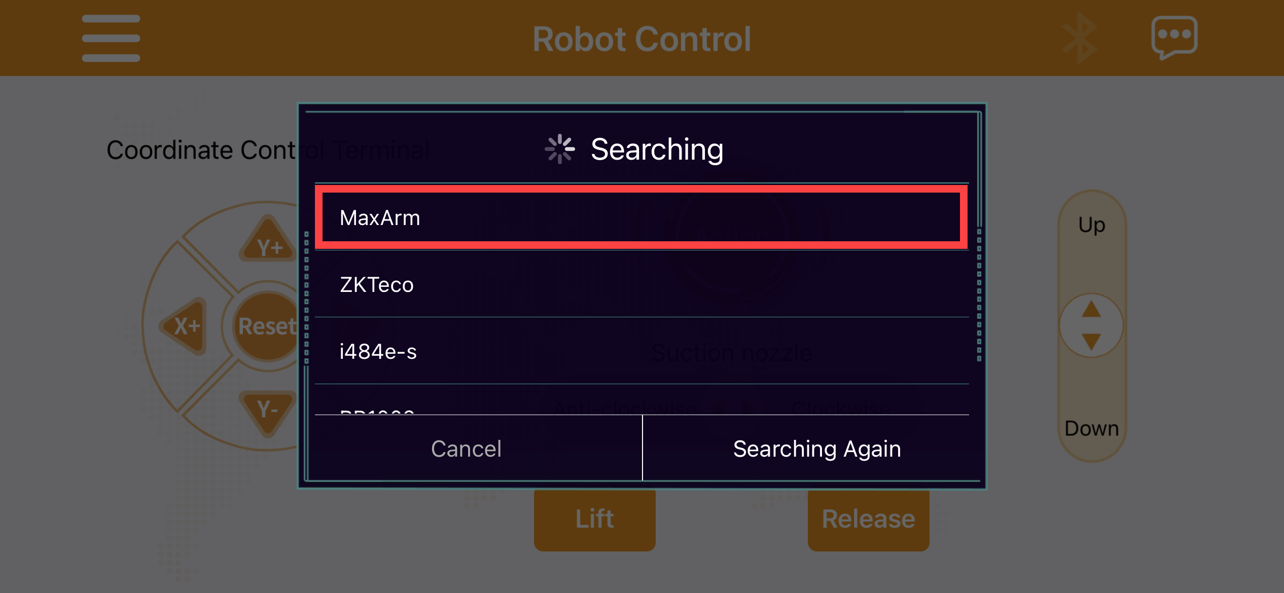

(2) Click on the flashing Bluetooth icon in the main interface to enter device searching status.
(3) Wait for a moment, then select “MaxArm”.

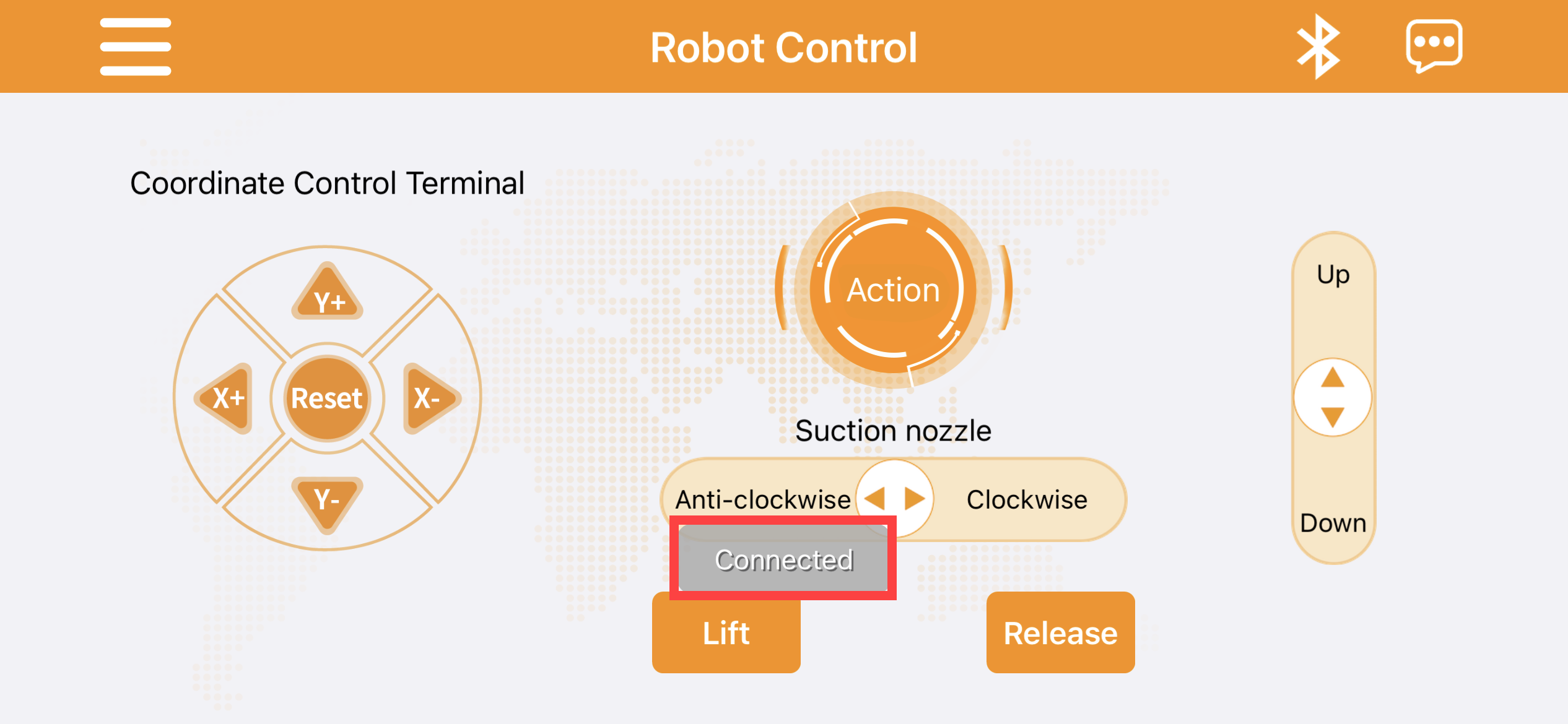

(4) When the Bluetooth icon stops flashing and keeps on, and the prompt “Bluetooth is connected” appears, which means robot has been connected successfully.

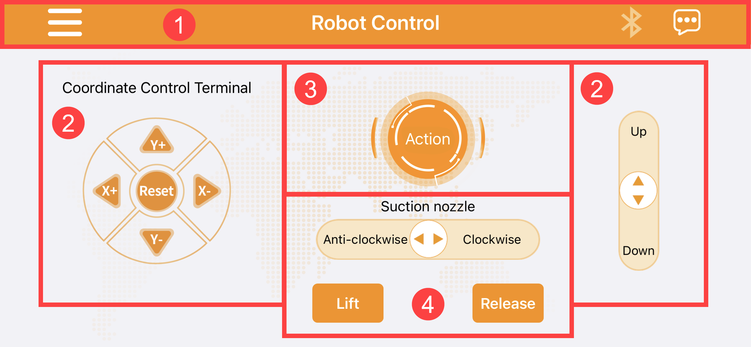

The app interface consists of four parts, which are menu bar, end effector coordinate control area, action calling area, suction nozzle control area.
  • Menu Bar
Icon Function
Product selection button
Click to select corresponding robot
Bluetooth connection button
If icon keeps flashing, Bluetooth is not connected.
If icon keeps on, Bluetooth is connected.
Help button
Click on it to check Hiwonder e-mail address and official website.
(1) End Effector Coordinate Control Area
The left and right sides of the main interface are the “End Effector coordinate control” area. Click the corresponding button to control robotic arm to move up and down, left and right, forward and backward. (Long press button for quick movement while short press for slight adjustment. When the robotic arm moves to the limited position, buzzer will alarm. After clicking “reset” button, buzzer will make sound and robotic arm will return to the initial position.)
Icon Function
Control robotic arm to return to the initial posture
Increase the value of x-axis
MaxArm rotates horizontally to the left
Decrease the value of x-axis
MaxArm rotates horizontally to the right
Increase the value of y-axis
MaxArm rotates backward
Decrease the value of y-axis
MaxArm rotates forward
Up: control the robotic arm to move up
Down: control the robotic arm to move down
(2) Action Calling Area
The upper middle part of interface is “action group” area. Click on it to call the action group files downloaded to the robotic arm.
Icon Function
Run the custom action group file
(3) Suction Nozzle Control Area
The lower part of interface is “suction nozzle control” area. Click on it to control the rotation and status of suction nozzle.
Icon Function
Clockwise: suction nozzle rotates clockwise
Anti-clockwise:suction nozzle rotates counterclockwise
The air pump starts pumping
The air pump stops pumping

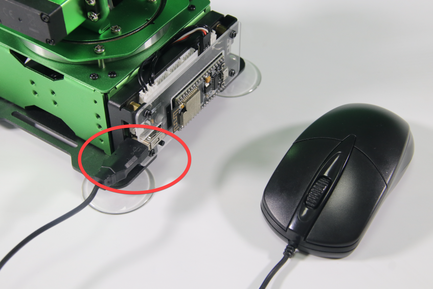

(1) Please prepare a mouse (wired or wireless). Connect mouse cable to USB port on expansion board, as shown in the figure below:
