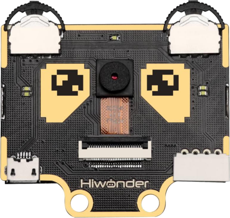

7.1.1 Introducing WonderCam
  • Instructions

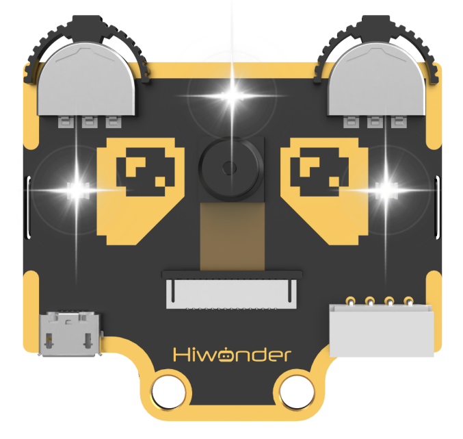

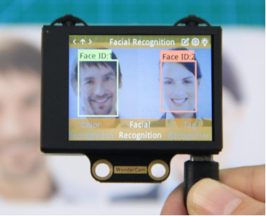

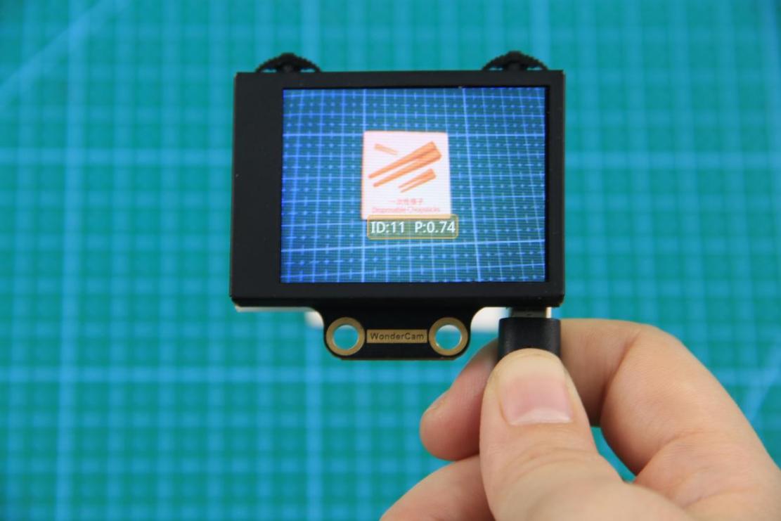

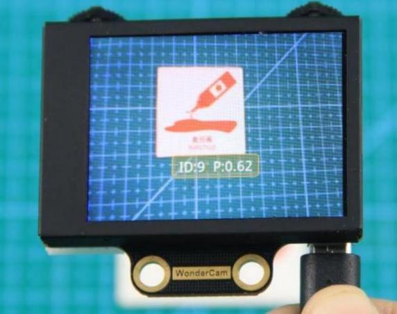

WonderCam is an user-friendly AI visual module with eight built-in functions: Color Recognition, Facial Recognition, AprilTag Recognition, Visual Line Following, Numeric Recognition, Landmark Recognition, Image Classification and Feature Learning.
WonderCam make learning AI fun and easy to comprehend. With 1-Click Training feature, it can readily program many creative AI visual projects.

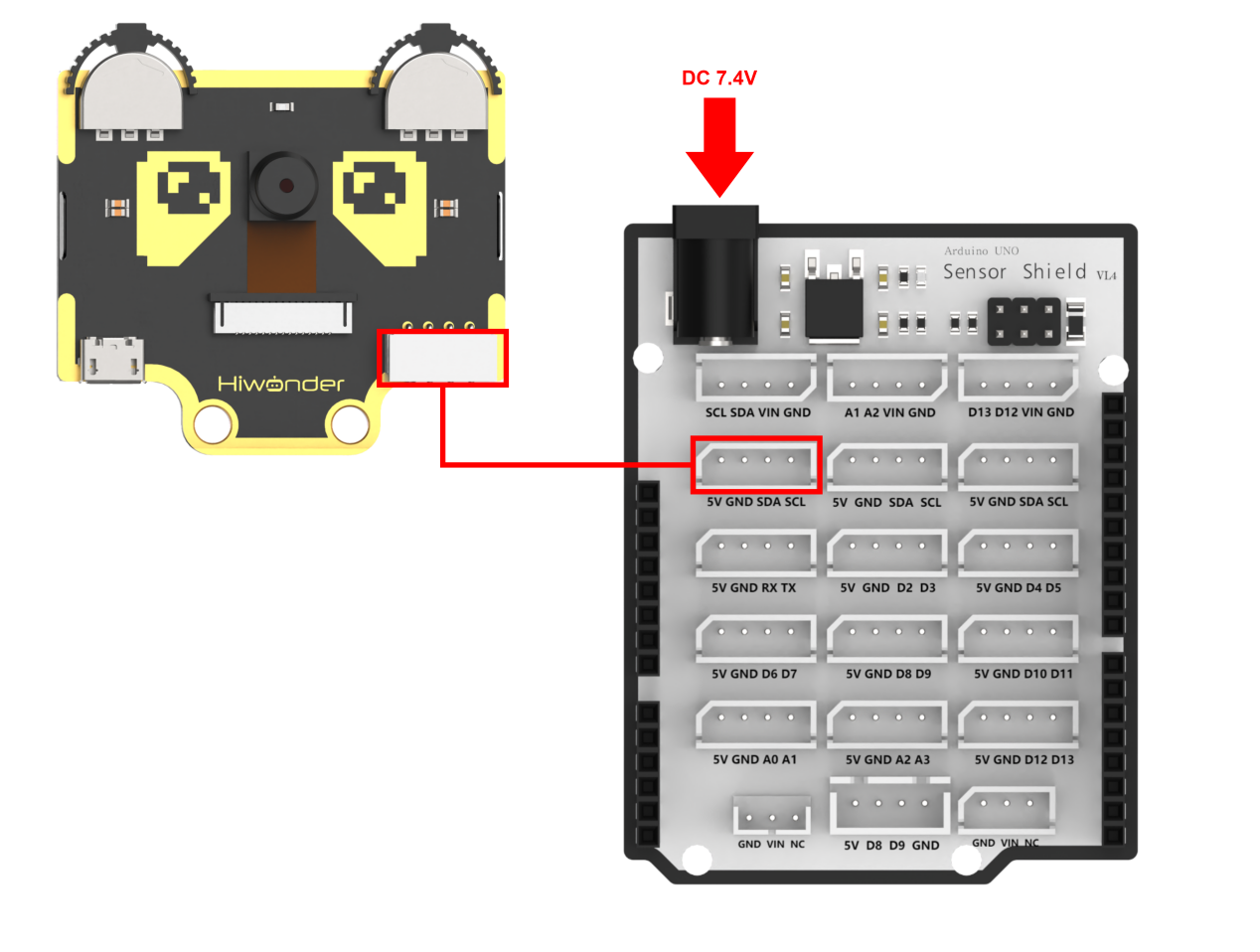

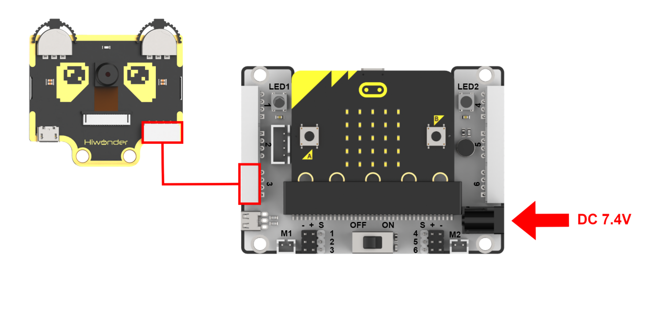

WonderCam IIC connector works seamlessly with many global leading controllers like micro:bit, Arduino, Raspberry Pi etc. By sending the recognized result output to the controller, you can focus on project creativity without the programming complexity.
  • Operation Overview

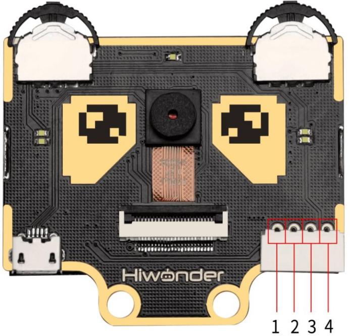

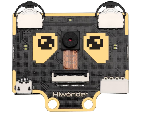

  • IIC Connectors Specification
S/N Name Function
1 SCL IIC Serial Clock Pin
2 SDA IIC Serial Data Pin
3 GND IIC Negative Pin
4 5V 5V Positive Pin

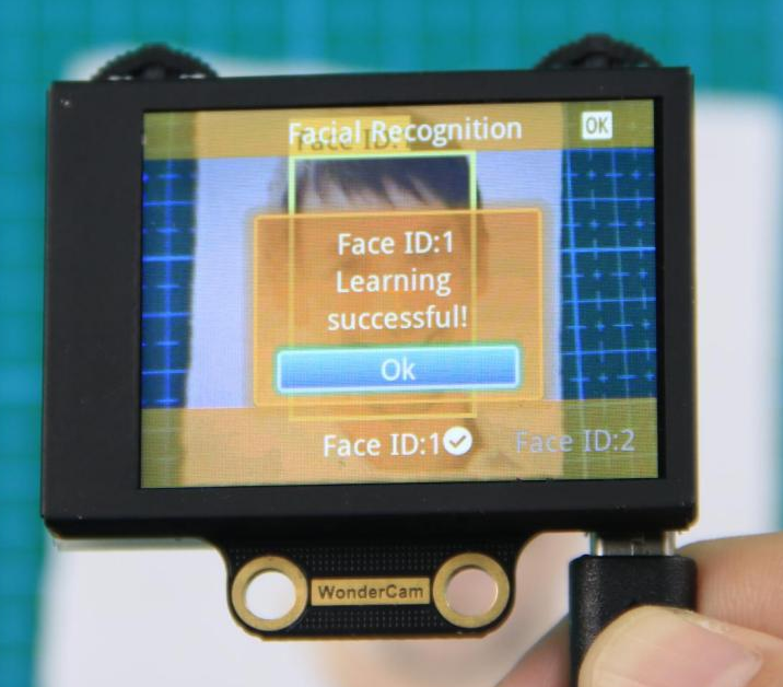

The 8 lessons are: Color Recognition, Facial Recognition, AprilTag Recognition, Visual Line Following, Numeric Recognition, Road Sign Recognition, Image Classification and Feature Learning.

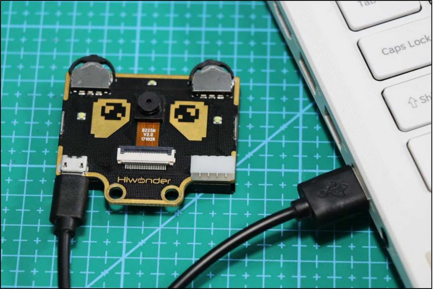

  • Device Power Supply Methods
(1) Connect to a computer port or a charging adapter via a USB cable.
(2) Powered by a lithium battery through the 4-pin interface on the right side of the back, which can be connected to an expansion board. For example, Hiwonder’s micro:bit expansion board, Arduino expansion board, etc.
  • The WonderCam vision module’s supply voltage must not exceed 5V. Please use a charging adapter or lithium battery that does not exceed 5V.
  • Make sure the supply voltage and power are sufficient. Otherwise, the WonderCam vision module may experience screen flickering, incorrect results, and other malfunctions.

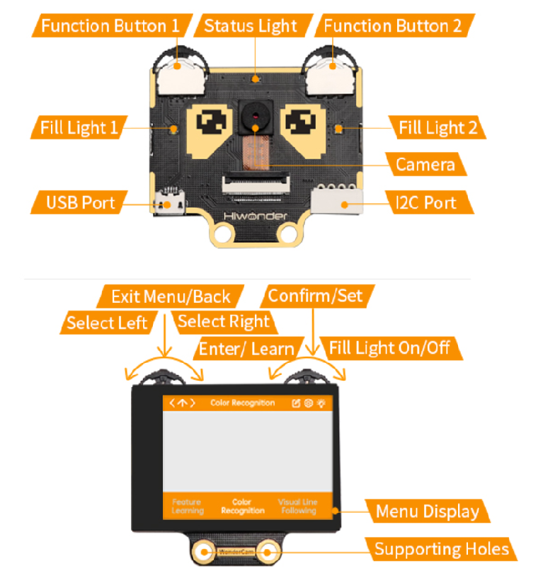

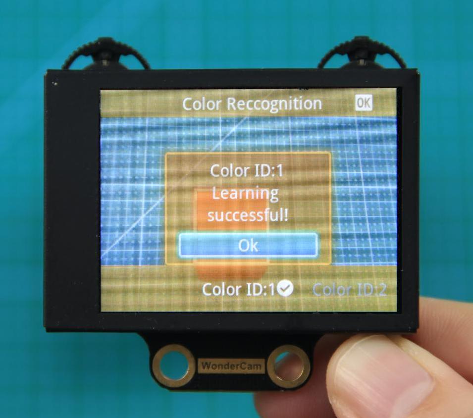

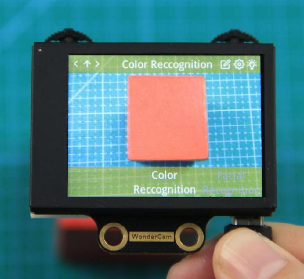

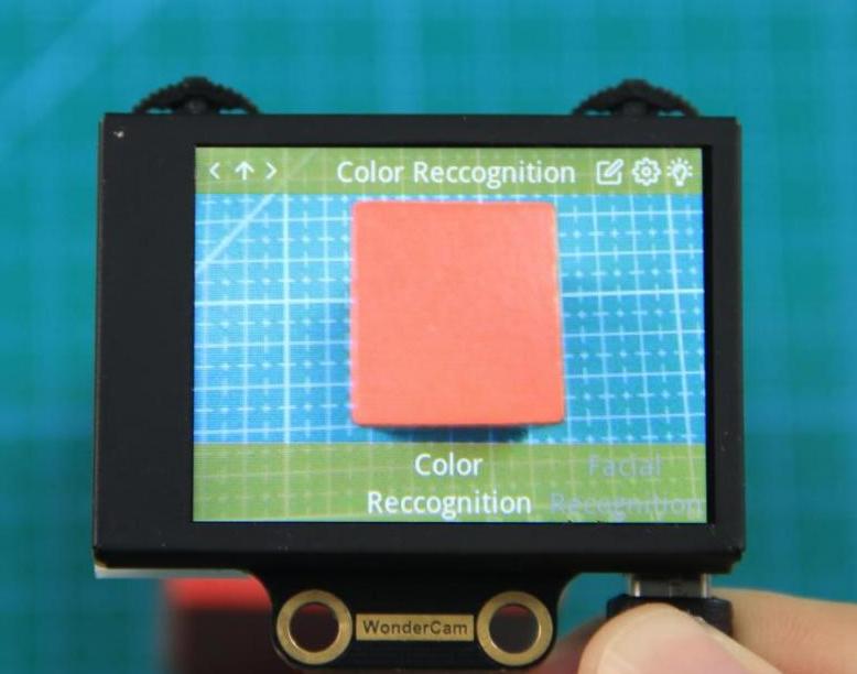

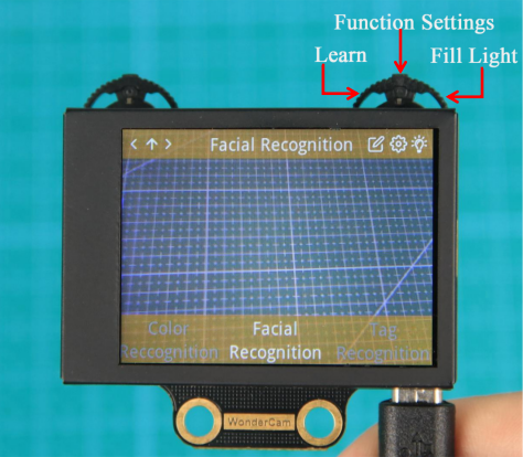

(1) Basic Operations

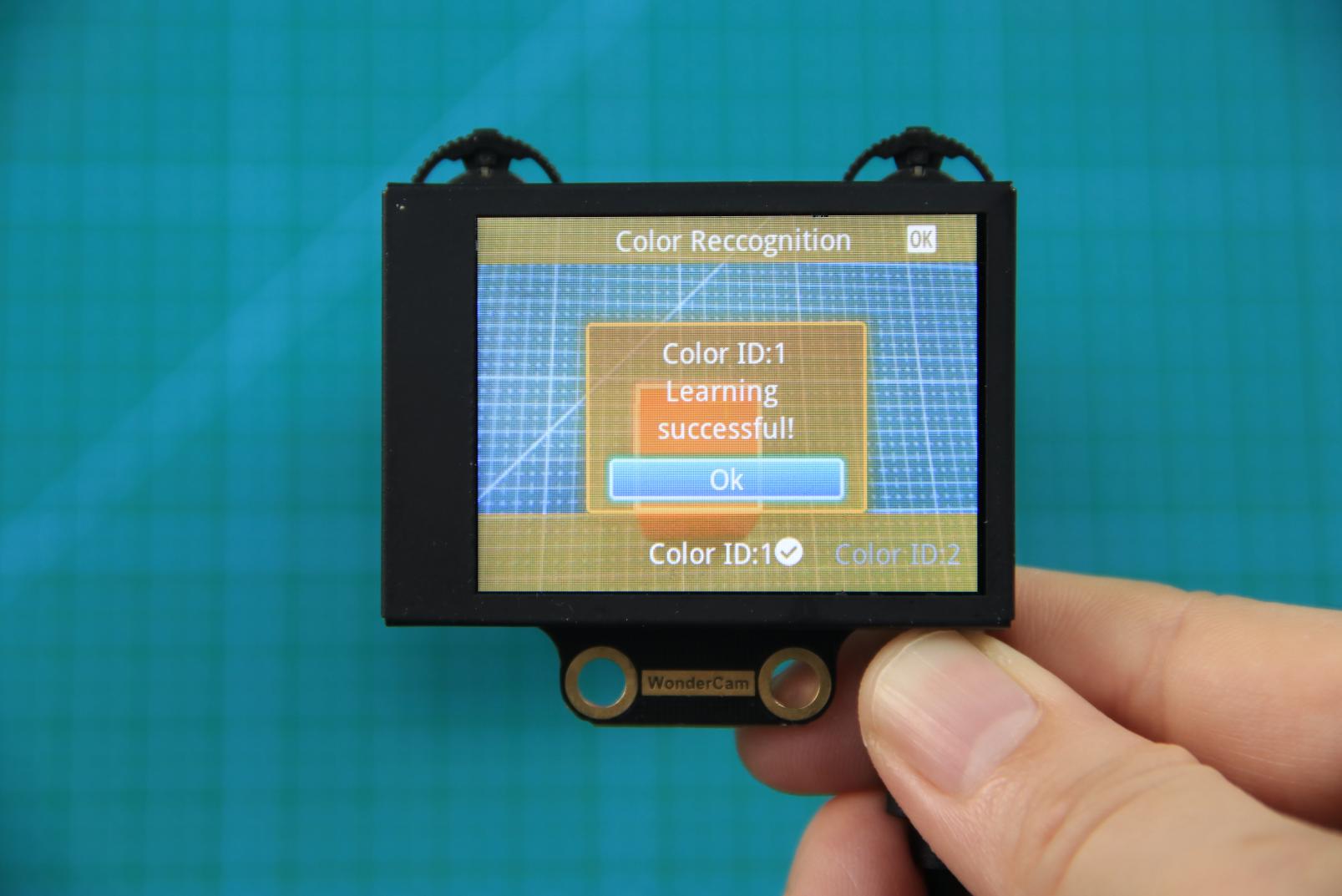

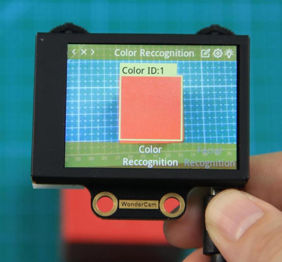

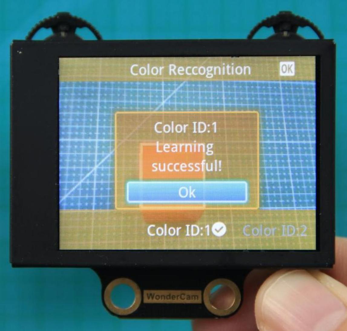

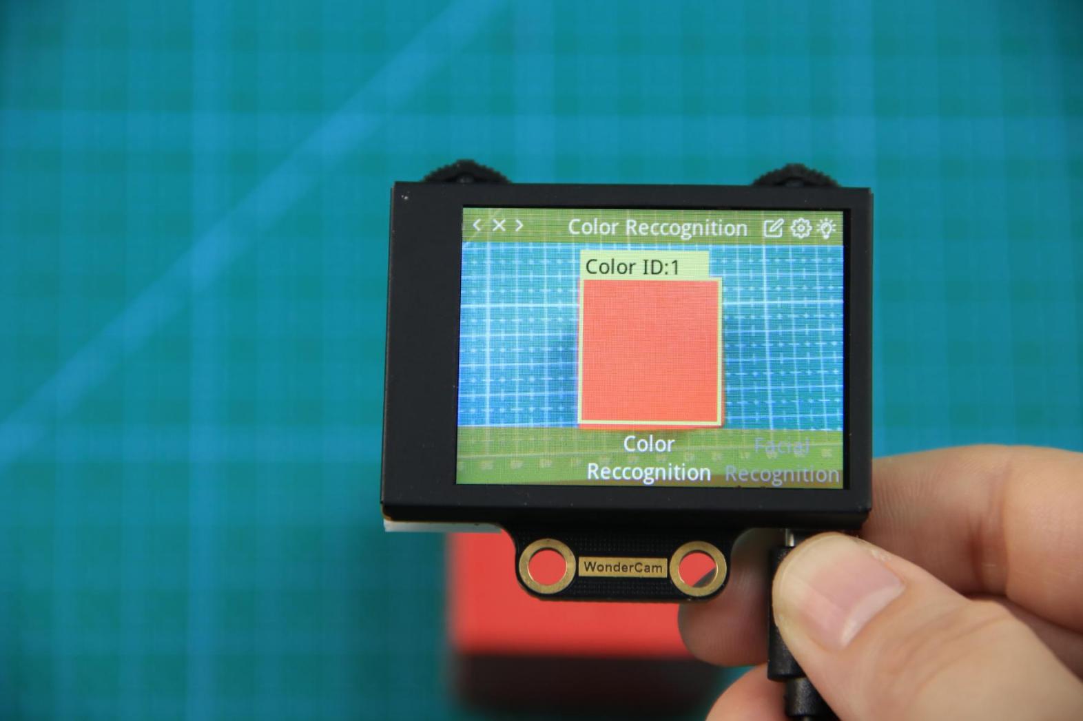

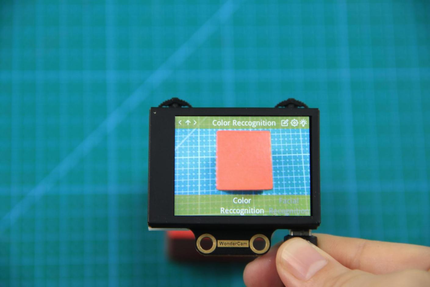

① When powered on for the first time, the screen will stay on the “Color Recognition” function menu.

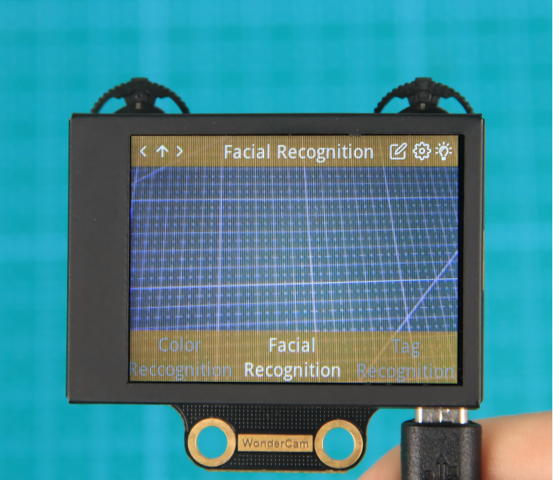

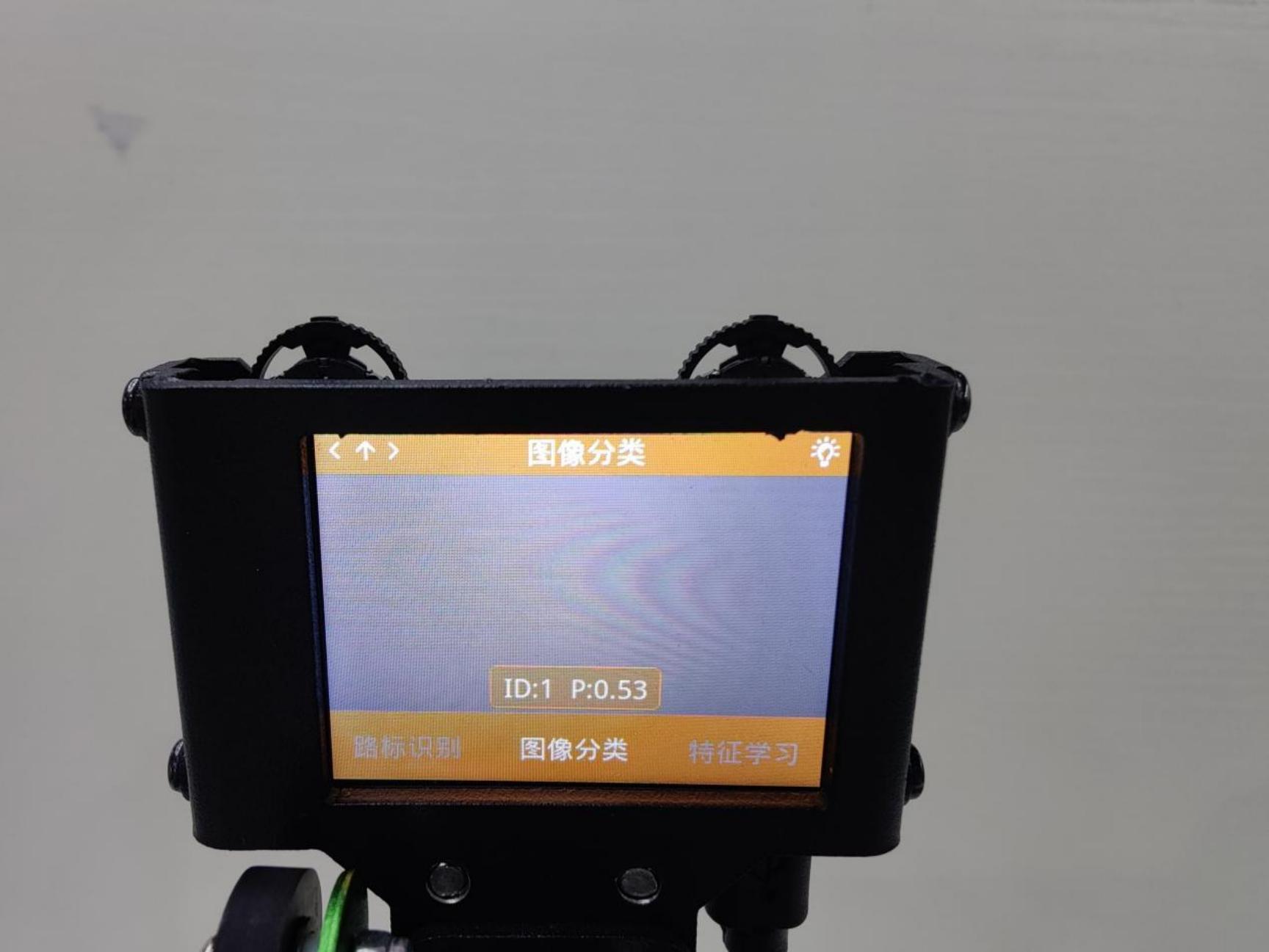

② The WonderCam vision module has two levers, and each lever can be flicked left, flicked right, or pressed downward, effectively providing three functions per lever. The two levers are functionally divided into a navigation lever and a function lever. The lever at the top left of the screen serves as the navigation lever, while the one at the top right is the function lever. By flicking the navigation lever to the right, you can switch to the “Face Recognition” function menu, as shown in the figure below.
③ In the the default screen after startup, the levers function as follows:

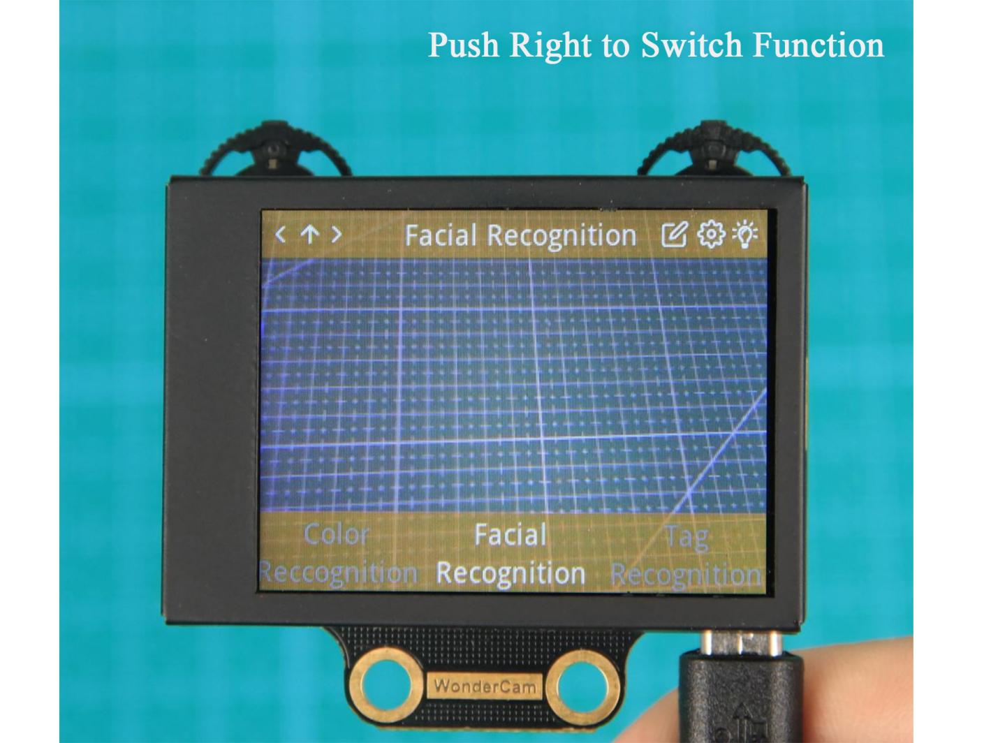

Navigation lever: Flick left or right to switch between different menu items.
④ In the main interface, flicking it left or right allows you to switch function menus. The switch will complete the change after the progress circle disappears. Holding the lever continuously enables faster switching.
Function lever: Used to open function options and confirm selections in dialog boxes. Note: Each function interface has its own specific functions, so the icons will change accordingly.
⑤ In the main interface, flicking the function lever to the right turns the fill light on or off.

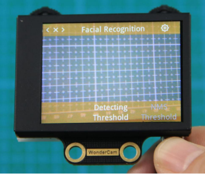

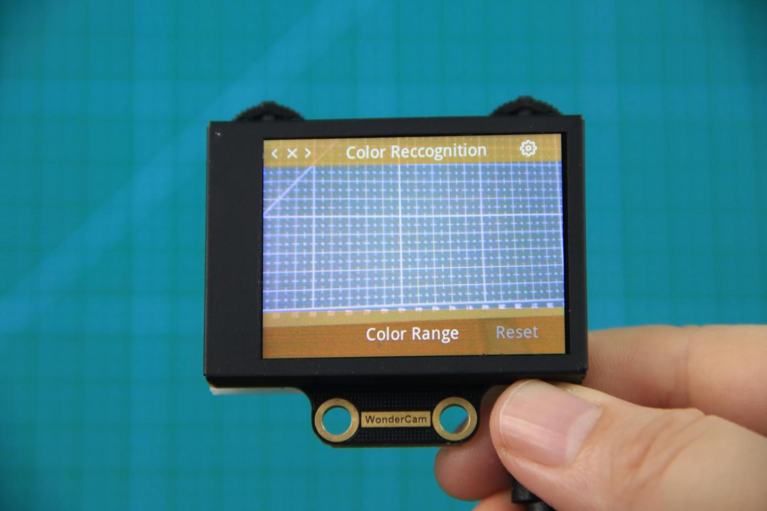

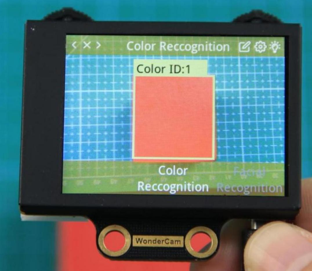

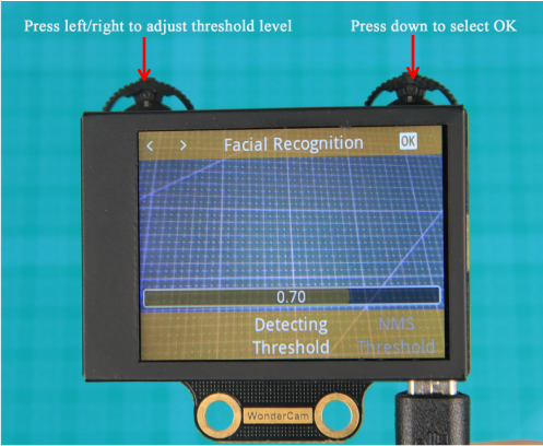

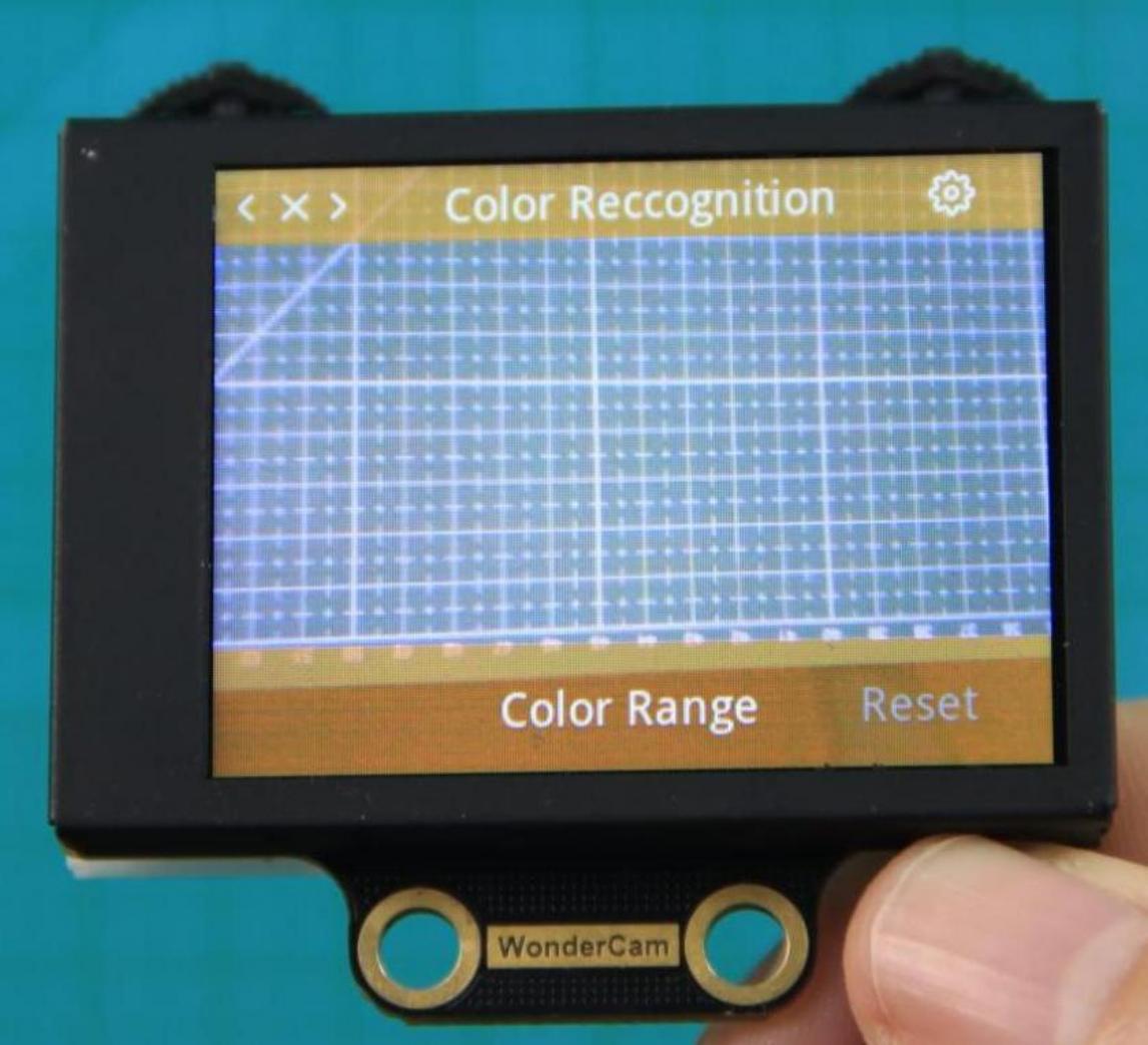

(2) Function Parameter Settings
You can adjust parameters for some functions, such as the detection threshold and NMS threshold in face recognition. If a gear icon appears at the top right corner of the main interface, it indicates that parameter settings are supported for the current function.
① How to enter the parameter settings menu:
Press the button corresponding to the gear icon to enter the parameter settings. For example, in face recognition, if you see a gear icon in the middle of the upper right corner, press down on the function lever to enter the parameter settings for face recognition.
② Setting specific parameters:
Move the navigation lever left or right to select the parameter you want to adjust, then press the button in the direction corresponding to the gear icon again to enter the detailed parameter setting. Inside the setting menu, you can use the navigation lever to move left or right to change parameter values. Long-pressing allows you to change values quickly. After completing the adjustments, press the button corresponding to the OK icon to save and return to the previous menu.

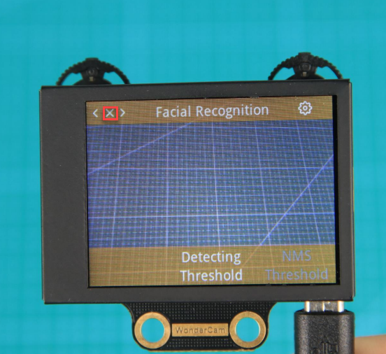

③ Exit settings and return to the main menu:
While in the settings menu, press the navigation lever toward the X icon to bring up the exit dialog. Follow the prompt to move the navigation lever to select “Yes” or “No.” Selecting “Yes” saves the parameter changes, while selecting “No” discards the changes and restores the original settings. After making your choice, press down on the function lever to confirm.

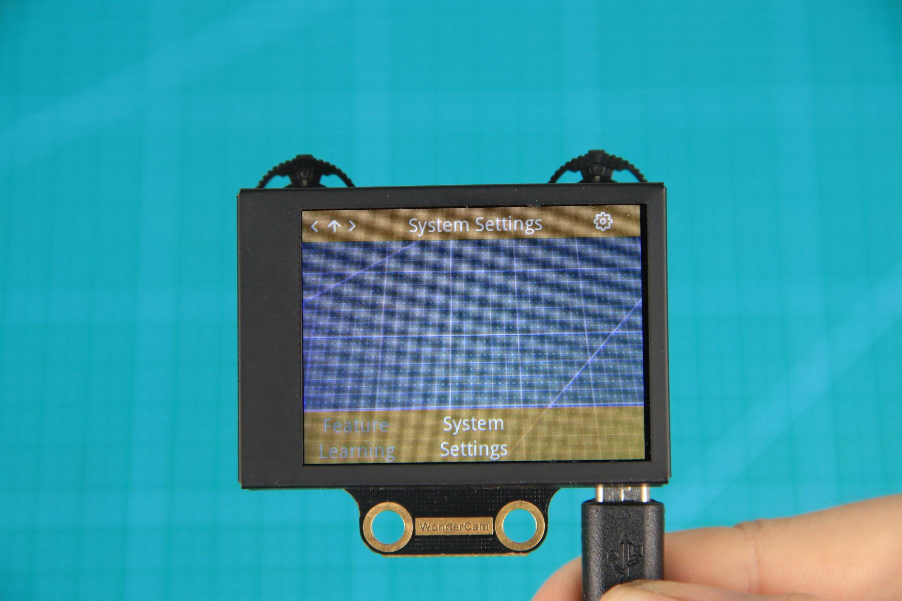

(3) System Settings
In addition to function-specific parameter settings, there are also general system settings, such as system language. This section mainly introduces how to adjust these parameters.
① Enter System Settings
In the main interface, move the navigation lever to the rightmost item, which is “System Settings.” Then press the gear icon to enter the system settings.
② Settings options:
(1) Screen brightness: Used to adjust the display brightness.
(2) Fill light brightness: Used to adjust the brightness of the fill light.
(3) Menu auto-hide time: Used to set the time before the menu automatically hides. For example, if set to 30, the menu will automatically hide after 30 seconds of inactivity.
(4) I2C address: Used to configure the I2C peripheral address of the WonderCam vision module. The default address is 0x32.
(5) Language: Used to set the system language of the WonderCam vision module. Currently supports English and Simplified Chinese. After setting, the module will automatically reboot to apply the changes.

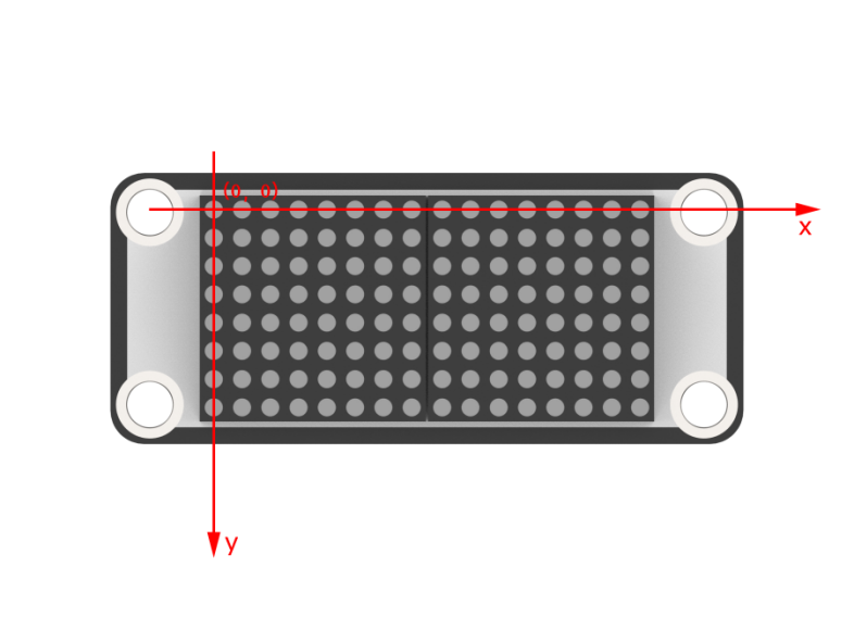

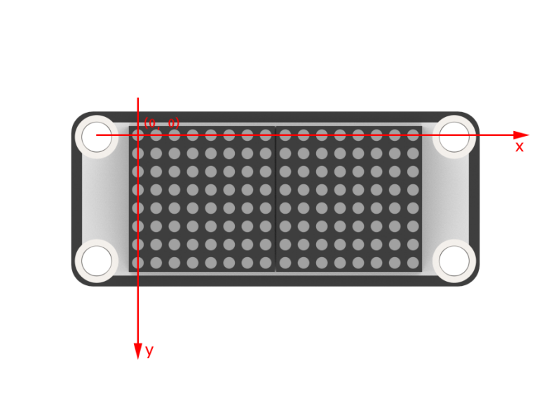

  • Understanding the Coordinate System
By understanding the coordinate system, you will be able to better interpret the output data from the WonderCam vision module in subsequent lessons. The WonderCam vision module defines the top-left corner of the image as point O. The horizontal direction to the right is the positive X-axis, and the vertical direction downward is the positive Y-axis. The maximum value of the X-axis within the image is 319, and the maximum value of the Y-axis is 239.

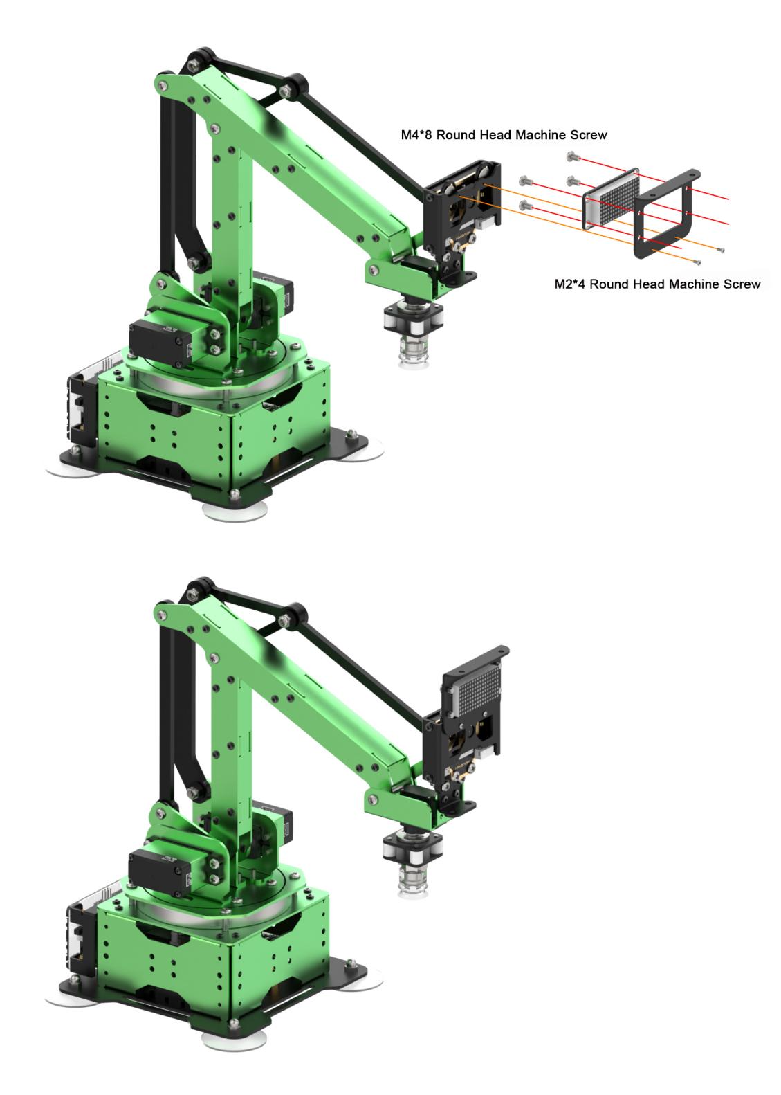

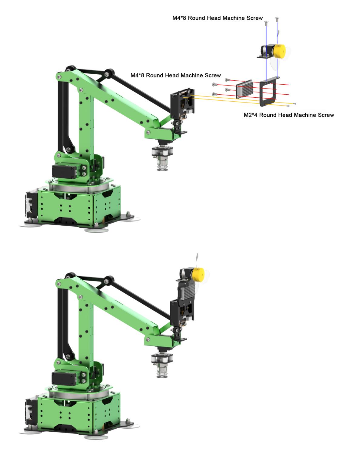

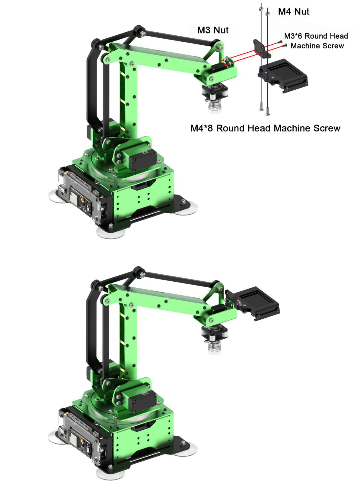

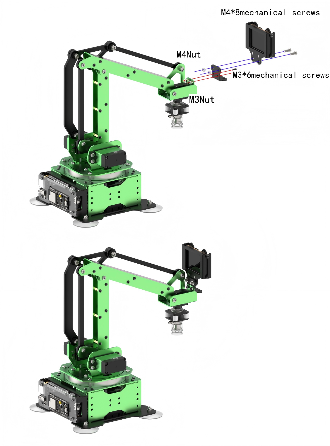

7.1.3 WonderCam Assembly

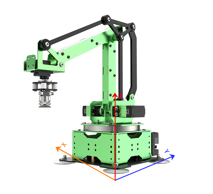

  • Establish Coordinate System
A coordinate system must be established to describe the motion of an object. MaxArm uses x-y-z axes coordinate system (unit:mm) and takes the the base centre of robotic arm as original point (0,0,0), as the figure shown below.
The correspondence relationship between the movement orientation of end effector and the values of x-y-z axes is shown below (user per se as reference):
Coordinate axis control orientation
x Control the end effector of robotic arm to move left or right (As the x value is positive, it moves to the right. As the x value is negative, it moves to the left. )
y Control the end effector of robotic arm to move forward and backward. (As the y value is negative,it moves backward. As the y value is positive, it moves forward.)
z Control the end effector of robotic arm to move up and down (As the z value is negative, it moves up. As the z value is positive, it moves down.)

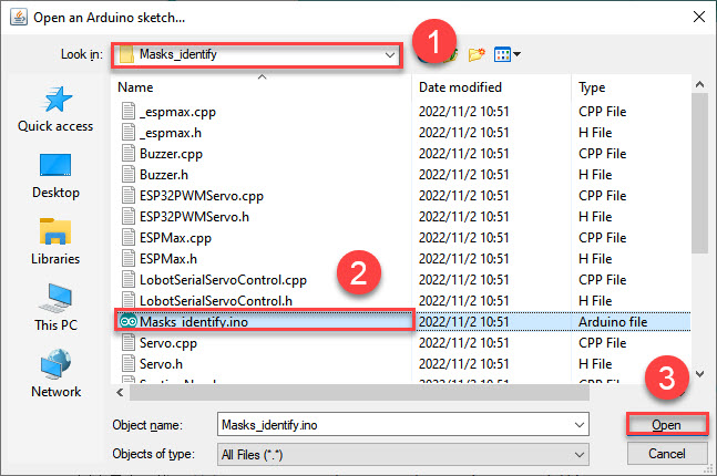

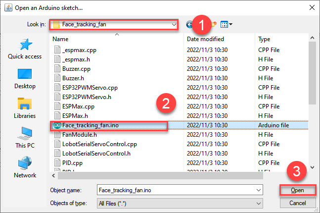

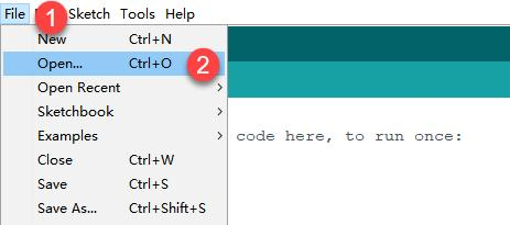

(1) Install and connect Arduino. (Please refer to the tutorial in folder 4. Underlying Files Learning/ Arduino Development/ Lesson 1 Set Development Environment)

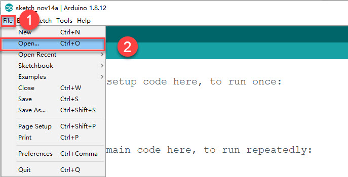

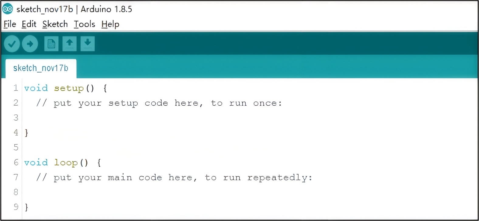

(2) Double click to open Arduino IDE .

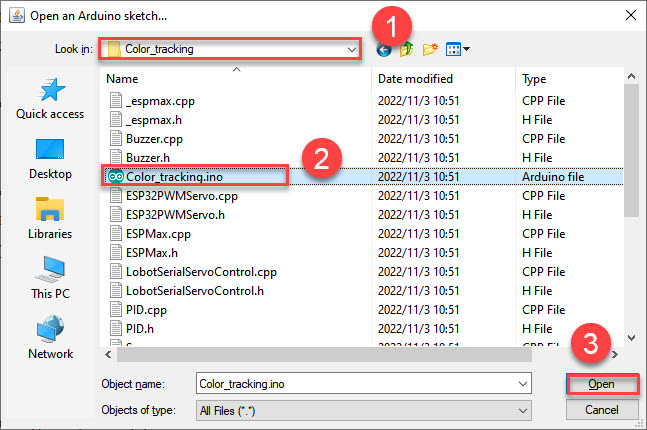

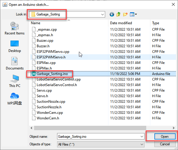

(3) Click “File–Open”.

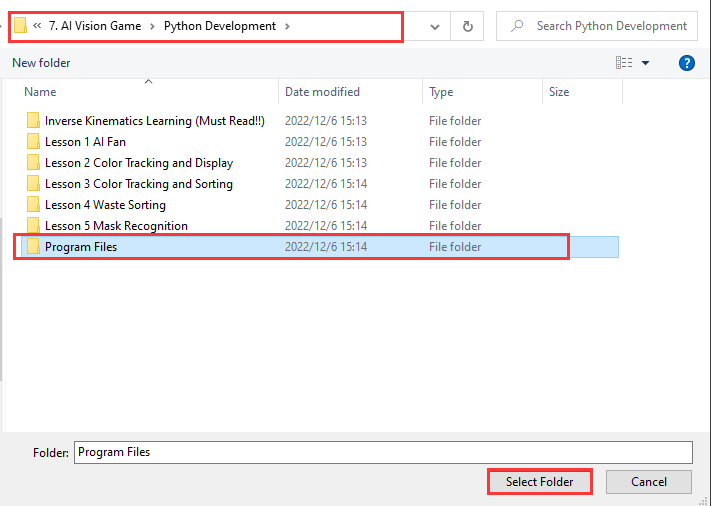

(4) Select the program “kinematics_demo.ino” in the folder 5.MaxArm Hardware Basics Learning/ Arduino Development/ Game Programs/ Program Files/ kinematics_demo, and click “Open”.

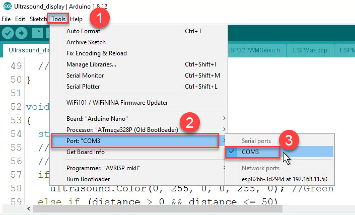

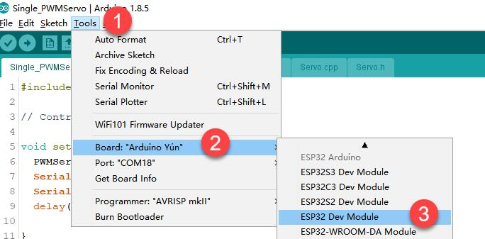

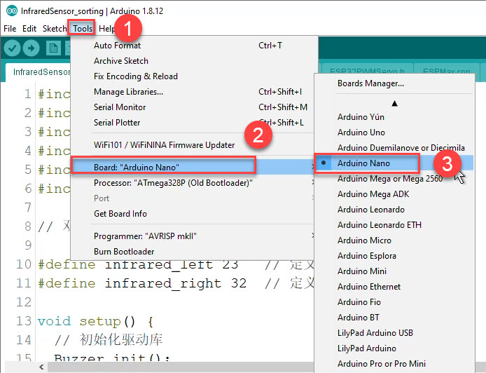

(5) Check the board model. Click “Tools–Board” and select “ESP 32 Dev Module”. (If the model of development board has been configured when setting the development environment, you can skip this step.)

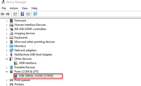

(6) Select the corresponding port of ESP32 controller in “Tools–Port”. (Here take the port “COM5” as example. Please select the port based on your computer. If COM1 appears, please do not select because it is the system communication port but not the actual port of the development port.)
(7) If you are not sure the port number, please open the “This PC” and click “Properties–Device Manger” in turns to check the corresponding port number (the device is with CH340).

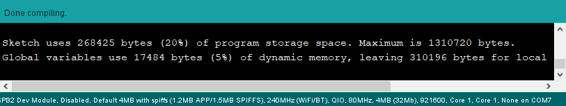

(8) After selecting, confirm the board “ESP32 Dev Module” in the lower right corner and the port number “COM5” (it is an example here, please refer to the actual situation).
(9) Then click on icon to verify the program. If no error, the status area will display “Compiling–Compile complete” in turn. After compiling, the information such as the current used bytes, and occupied program storage space will be displayed.

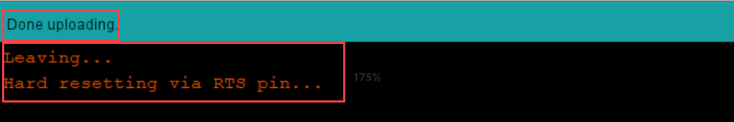

(10) After compiling, click on icon to upload the program to the development board. The status area will display “Compiling–Uploading–Complete” in turn. After uploading, the status area will stop printing the uploading information.

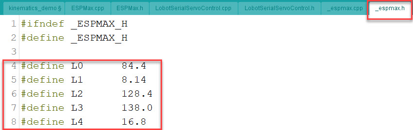

(2) Calculate the initial position of robotic arm
According to the linkage parameters of L0-L4 defined in kinematics underlying library.
2
#ifndef _ESPMAX_H
#define _ESPMAX_H
#define L0      84.4
#define L1      8.14
#define L2      128.4
#define L3      138.0
#define L4      16.8
Calculate the initial position of the end effector. (Use the L0-L4 values to get x=0, y=162.94, z=212.8)

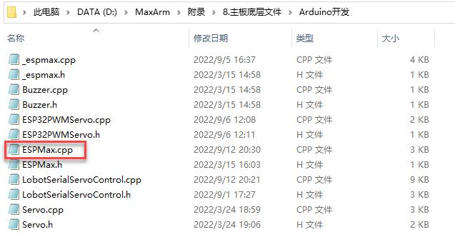

  • Inverse kinematics library analysis

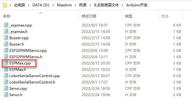

The path to the inverse kinematics library: Appendix–8. Controller Underlying Files–Arduino Development–espmax.py

  • Facial Recognition Introduction
Through face detection and facial recognition on the screen display, WonderCam provides data such as Face position and size etc.

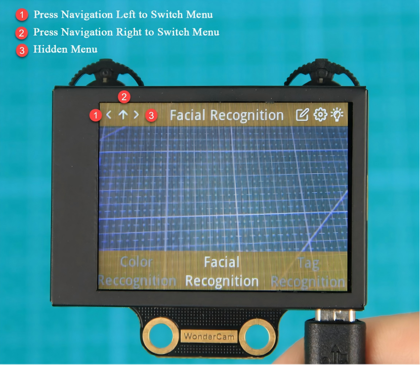

  • Facial Recognition Operations
(1) Enter Function
Push Navigation button to Facial Recognition menu.
(2) Face Detection
Once WonderCam is in Facial Recognition mode, face detection will automatically be activated. When face is detected, a white frame will appear on screen to enclose the detected face.
(3) Learn and Recognize Face
To recognize a specific face, WonderCam need to learn to recognize the face first.
① Learn a Single Face
Step 1: Left push Function button to enter Learning mode.
After entering Learning model, the mark “+” will appear in the middle of screen, and the menu bar will show “Face ID:1”, “Face ID:2” etc. The ID is to tag and save different Faces.
Step 2: Point the mark “+” on screen to the center of Face. Take note of the given instructions.
Step 3: When face is centered, left push Function button to the camera icon to learn the face. When learning is successful, push Function button down once to select OK and complete the learning process. If the learning is successful, when the face is detected, WonderCam will display the corresponding ID on screen.
② Learn Multiple Faces
To learn more faces, when in Learning mode, right push Navigation button to another ID number and repeat earlier process.
③ Recognizing Faces
After the learning is completed, when the same face is recognized again, the face will be framed in different color, and the corresponding ID will be displayed.
(4) Delete Face
To delete Face ID that is no longer required. In Face Recognition Learning mode, push Navigation button to the Face ID number targeted to delete. Push Function button to the right toward Bin icon, push Function button down to OK to delete.
  • Facial Recognition Function Settings
In Facial Recognition main menu, press Function button down toward Gear icon to enter Settings interface.
Available for configurations are: Detecting Threshold, NMS Threshold, Recognition Threshold and Reset.
  • Detecting Threshold: To set threshold for face detection. Higher value will have higher accuracy rate. However, too high a value will also resulted in lower face detection rate, or even failure face detection
  • NMS Threshold: Non- Maximum Suppression is a computer vision method. Leave it at default value.
  • Recognition Threshold: Settings for specific Face ID. Higher value will have higher accuracy rate. However, higher value may result in unable to recognize or only recognize at specific part or angle of the face.
  • Reset: This will erase all previous records and reset to factory defaults. Please take care to Save the settings so that the reset settings take effect.
7.2.3 Module Assembly
7.2.4 AI Fan
If the face models have been burnt to WonderCam in advance, you can start this game directly.
If fail to recognize face, please re-burn the firmware according to “4. Firmware (including method)” in Appendix/ WonderCam AI Vision Module /3.Appendix /4.Firmware (Installation method included).
  • Project Principle
In this game, when face is detected by WonderCam module, fan module will turn on and dot matrix module will display a smiley expression, and then robotic arm will track the face,

  • Preparation
(1) Hardware
Please refer to “Lesson 2 Module Assembly” to assemble fan module to the corresponding position on MaxArm (WonderCam AI vision module has been assembled by default).

(1) Double click to open Arduino IDE .
(2) Click “File – Open”.
(3) Open the program “Face_tracking_fan.ino” in the folder 7. AI Vision Games/ Arduino Development/ Program Files/ AI Fan/ Face_tracking_fan.
(4) Select the corresponding board model. Click “Tool – Board” and select “ESP 32 Dev Module” (If the board model has been configured when setting development environment, you can skip this step.)
(5) Select the corresponding port in “Tools–Port”. (Here take the port “COM5” as example. Please select the port based on your computer. If COM1 appears, please do not select because it is the system communication port but not the actual port of the development port.)
(6) If you’re not sure about the port number, please open the “This PC” and click “Properties–Device Manger” in turns to check the corresponding port number (the device is with CH340).
(7) After selecting, confirm the board “ESP32 Dev Module” in the lower right corner and the port number “COM5” (it is an example here, please refer to the actual situation).
(8) Then click on icon to verify the program. If no error, the status area will display “Compiling–Compile complete” in turn. After compiling, the information such as the current used bytes, and occupied program storage space will be displayed.
(9) After compiling, click on icon to upload the program to the development board. The status area will display “Compiling–Uploading–Complete” in turn. After uploading, the status area will stop printing the uploading information.

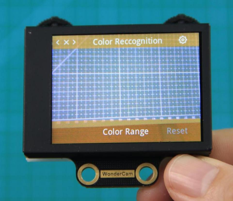

  • Introduction to Color Recognition function
WonderCam recognizes and identifies the various colors in the white frame shown within the display. It provides data such as object position and size etc to perform color recognition, color tracking etc.
  • Instructions
(1) Use bright and high saturated color. Example red, green or blue.
(2) Targeted object color and its background must be distinctive. Example if target object is Yellow, avoid yellow background.
(3) Do not learn White color or Composite color. Ensure environment is bright enough or use Fill Light on WonderCam when required.
(4) Adjusting light condition and the focus angle can help to stabilize and improve the color recognition process in the white frame within the display panel.
(5) Wiring
Use the provided cable to connect WonderCam vision module to the power supply.

The default start-up function on WonderCam is Color Recognition. If not, push Navigation button on WonderCam to left or right to select to Color Recognition menu.
(2) Learning new color and recognizing new color
To use Color Recognition function, program WonderCam to learn about the color first.
Steps are as follows

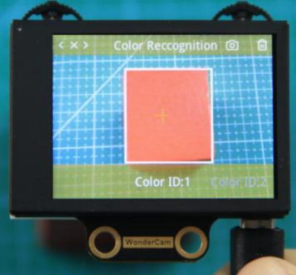

① Step 1: When in the Color Recognition Menu, push Function button to the left once to enter Learning mode.
② Step 2: In Learning mode, a red + sign will be shown in center of display with menu showing “Color ID:1”, “Color ID:2”.
③ Step 3: Focus red + on to the targeted colored object. When target is in focus, a white frame on screen will encapsulate the object.
Reminder:
(3) Do not Learn White color or Composite color. Ensure lighting condition is bright enough or use Fill Light on WonderCam when required.
④ Step 4: Push Function button to the left for WonderCam to Learn the color. Wait for Learning successful message display. Push Function button down to OK to complete. If Learning fail, try adjusting lighting condition or change to more distinctive color. Ensure the White frame is stabilized when in focus and push top right button to the left to Learn.
⑤ Step 5: When learning is successful and WonderCam detected corresponding color to the ID number it had learned previously, the ID number of the object will be shown on display.

(4) Color Recognition Function Settings
In the Color Recognition main menu, press Function button down to enter Settings interface.
Available for configurations are: Color Range and Reset.
  • Color Range: This controls the White Frame parameter size in detecting the target object color variation. Higher value will enlarge White Frame size and will cover wider range of color variation on the display. Lower value will reduce White Frame size and focus on smaller portion of color. Range value at 20 is optimum in most situation.
  • Reset. This will reset to factory default value. Do note to Save settings to effective the reset settings.

The following picture shows WonderCam AI vision module:

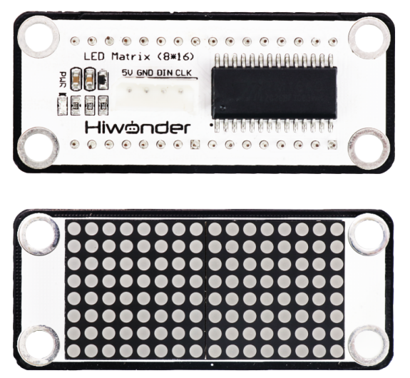

The following picture shows the dot matrix module:

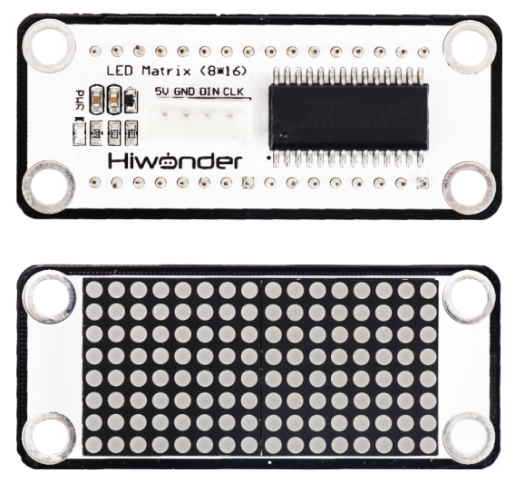

The module is composed of two red 8x8 LED dot-matrix screens, which can be controlled by driving the control chip.

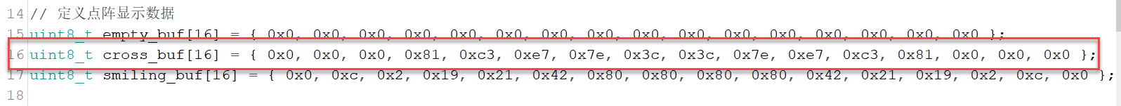

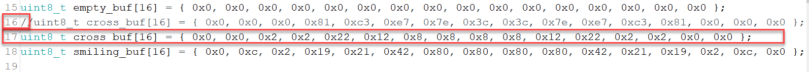

The display content of the dot matrix is realized by setting the high and low levels of the two pins of the diodes. When the corresponding line is set to 1 level and a column is set to 0 level, the corresponding diodes light up, that is, 0 represents on and 1 represents off.
The program controls the display pattern with a set of hexadecimal data, a total of 16 data. Each data controls a column of LED lights, and the pattern is displayed by setting individual point.
To explain more clearer, the rows and columns of dot matrix are marked with corresponding numbers, as the figure shown below:
x: The specific origin position of the bitmap x-axis coordinate and the value is from 0 to 15. The set in the program is 0.
y: The specific origin position of the bitmap y-axis coordinate and the value is from 0 to -7. The set in the program is 0.
If want the LED at position (0, 0) to light up first, we need to set the binary (from top to bottom) of the first column to 01111111, which translates to 0x7f in hexadecimal.
The path of the program file: 7.AI Vision Game/ Arduino Development/ Program Files/ Color Tracking and Display/ Color_tracking/Color_tracking.ino
(3) Open the program “Color_tracking.ino” in the folder 7. AI Vision Game/ Arduino Development/ Program Files/Color Tracking and Display/ Color_tracking.

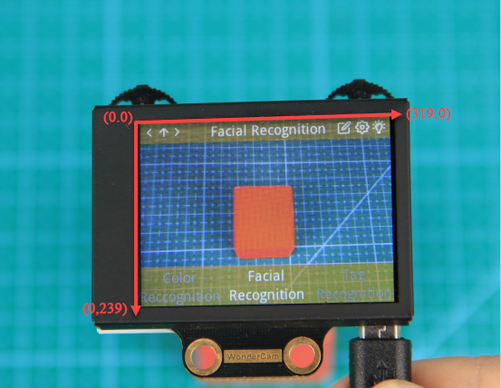

Firstly, obtain the coordinate data of the target color on screen (take red for example), as the figure shown below:
        color_x = p.x;
        color_y = p.y;

  • Wiring
  • Color Recognition Operations
(1) Enter Function
Reminder:
  • Use bright and high saturated color. Example red, green or blue.
  • Targeted object color and its background must be distinctive. Example if target object is Yellow, avoid yellow background.
  • Do not Learn White color or Composite color. Ensure lighting condition is bright enough or use Fill Light on WonderCam when required.
  • Adjusting light condition and the focus angle can help to stabilize and improve the color recognition process in the white frame within the display panel.
(3) Delete Color
To delete an ID color, enter Color Recognition mode and move to the selected ID by using Navigation button. Select Color ID to delete and push Function button to the right towards Bin icon. Push Function button down to select OK to delete.
  • WonderCam Module Assembly (Top view)
7.2.8 Color Tracking and Sorting
Before starting this game, please make sure the colors including red, green, blue to be recognized are learned as ID1, ID2 and ID3 in sequence with WonderCam module. The specific content refer to “Lesson 1 Color Recognition Learning” under the same directory.
WonderCam vision module must face down when assembling on MaxArm. The specific assembly tutorial refers to “Lesson 2 WonderCam Module Assembly (Top View)” in the same directory.
(3) Open the program “Tracking_Sorting.ino” in the folder 6. Secondary Development/ Arduino Development/ Sensor-extension Game/Program Files/ Color Tracking and Sorting/ Tracking_Sorting.

The coordinates of the center of block and screen according to PID algorithm.
93
94
          float d_x = pos[0] / 2.3;
          float d_y = 68 - abs(d_x / 3);

7.2.9 Image Classification (Mask Recognition)
  • Instructions
Distance from Card to WonderCam camera should be between 15cm to 20cm. Ensure sufficient lighting in the surrounding and use white background for better recognition results.
  • Introduction to Image Classification Function

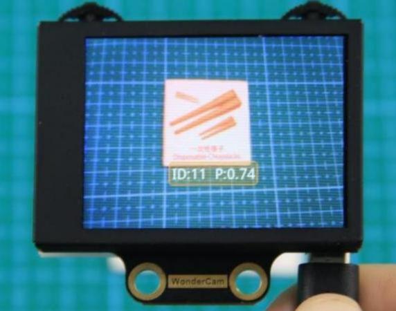

Using the programmed Image Classification model to recognize and classify pictures. This function can be used to classify garbage and etc.
WonderCam module has a built-in 12 card sorting model at factory default setting, which can be used with the waste template provided.
  • Number Recognition Operations
(1) Enter Function
Push Navigation button to Image Classification menu.
(2) Recognizing Landmark
When in Image Classification mode and using the templates provided, WonderCam is able to recognized the mark and present the corresponding ID number on its display. When in operation, a value will also be shown to signify the trust value. The highest value is 1.0 being closest matched.
Card ID Card ID
White background 1 2
3 4
5 6
7 8
9 10
11 12

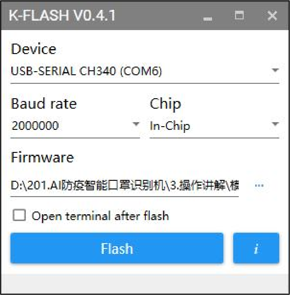

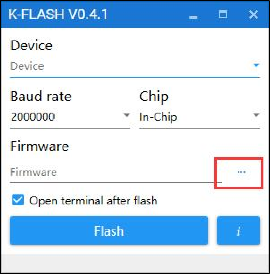

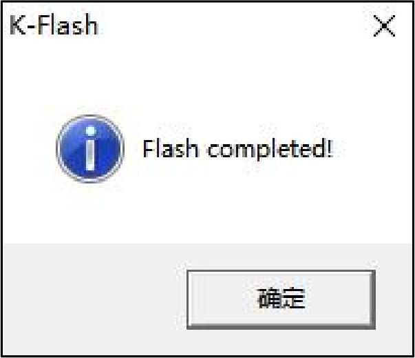

If the mask recognition models have been burnt, please re-download the firmware of WonderCam vision module before starting this game. The specific operation refers to “WonderCam Firmware (Installation method included)”.

(1) Hardware
Please refer to 7.AI Vision Game/ WonderCam AI Vision Module (must read!)/ Lesson 3 Aassembly to assemble WonderCam module to the corresponding position on MaxArm

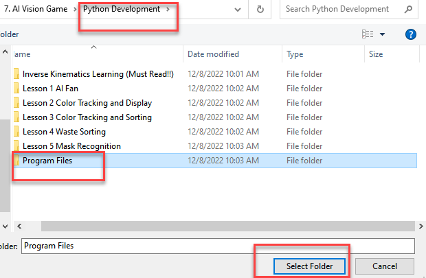

  • Program Download
Source Code
(3) Open the program “Masks_identify.ino” in the folder 7. AI Vision Game/ Arduino Development/ Sensor-extension Game/ Program Files/ Mask Recognition/ Masks_identify.

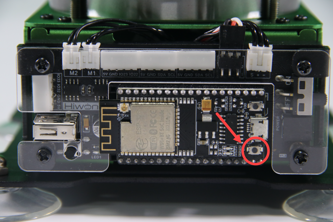

(10) After download is completed, click “reset” or the reset button on controller to run program.
  • Project Outcome
After the program is downloaded, press reset button according to the operation steps in “3. Program Download”. Then robot arm will be in preparation for recognition.
Then place a waste card to the recognition area. When the card is recognized, MaxArm will suck and transfer it to the corresponding position according to the card category.

The program defaults to place the cards in a row in front of the left side of the robot arm. In this section, you can learn how to modify the placement position of cards. Take placing the cards around robotic arm for example.
Firstly, take robotic arm as the first person view. The positive direction of x axis corresponds to the right side of robotic arm; the positive direction of y axis is the rear of robotic arm; the positive direction of z axis is the top of robotic arm. All position adjustment is based on this coordinate system.
The specific coordinate system refers to the following figure:

7.2.11 Firmware installation method

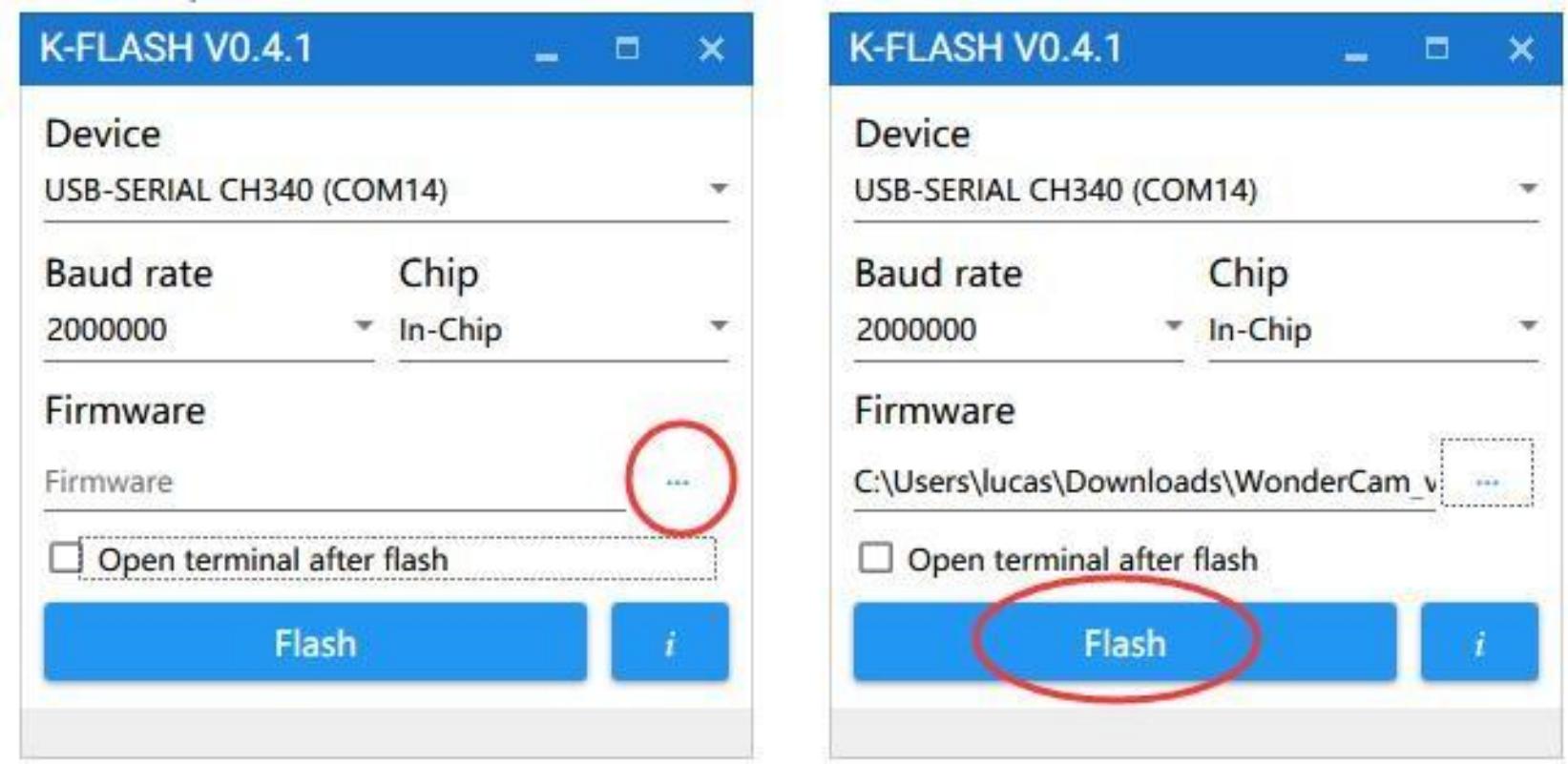

  • Firmware installation method

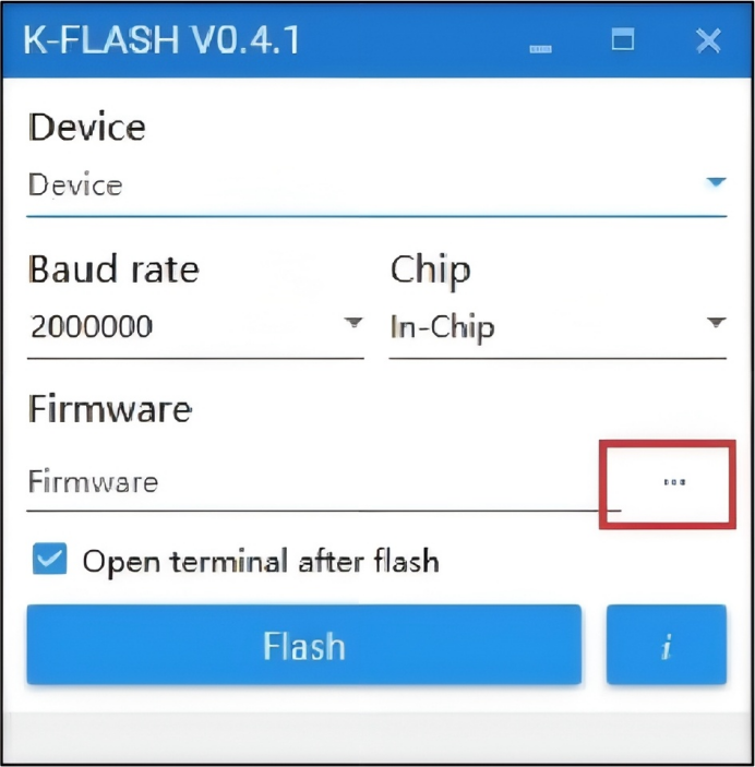

WonderCam firmware need to be reinstall for factory setting or to obtain the latest system
It is user-friendly to update firmware using Windows 10 system recommended. In this lesson, 0.6.5.kfpkg firmware will be used as example to demonstrate.
(1) Connect WonderCam vision module to one of the computer USB port with USB cable.
(2) Open K-Flash software in the folder of 4. Firmware. If fail to open K- Flash, please install first and then run K-Flash.

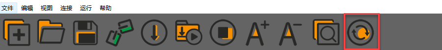

(3) Run K-FLASH software and then click button “” to load the firmware.
(4) Please set K-Flash software according to the following parameters:
  • Device: select the COM port that contains “USB-SERIAL CH340” on your computer
  • Baud rage2000000
  • Chip:In-Chip
  • Do not select “Open terminal after flash”
(5) Click the button “Flash” . The firmware installation takes about 5 min.
During downloading process, do not disconnect or change USB cable. WonderCam will restart after installation. Please set the system language to English.

(2) Run K-Flash software, and then click “ …” . Find and load the model file “facemask.kfpkg” .
(3) Set the parameters in K-Flash according to the following parameters:
  • Device: Select the corresponding COM port of your computer. The port name contains “USB-SERIAL CH340” .
  • Baud rage:2000000
  • Chip:In-Chip
  • It is not recommended to check this option “Open terminal after flash” .
(4) Click “Flash” to start burning. It takes about 5 minutes.
During this process, do not disconnect or move the USB cable.
(5) After the burning is completed, the prompt “ Flash completed” will appear.

(6) Notices for Image Classification
The distance between human face and camera should be 20-30cm and the ambient light should be light enough. It is recommended to use white background foe better realization effect.
(7) Introduction to Image Classification Function
Image Classification Function: Image classification can use the trained MobileNet model to classify images according to different features reflected in different images.
This function can be applied in mask recognition, image detection, waste sorting and etc.
(8) Operation
① Enter Function
② Image Classification
After starting the image classification function, the face with or
without a mask can be recognized. The ID with a mask corresponds to ID2 and the ID without a mask corresponds to ID3. The closer the confidence level is to 1.0, the more reliable the recognition result is.
  • Module Assembly

  • Preparation
(1) Hardware
Please refer to “Lesson 1 Module Assembly” under the same directory to assemble module to the corresponding position on MaxArm
(2) Software
Please refer to 4. Underlying Program Learning/ Arduino Development/ Lesson 1 Set Development Environment to connect MaxArm to Arduino.
(3) Open the program “Masks_identify.ino” in the folder 7. AI Vision Games/ Arduino Development/ Program Files/ Mask Recognition/Masks_identify.

// Define LED matrix display data (定义点阵显示数据)
uint8_t empty_buf[16] = { 0x0, 0x0, 0x0, 0x0, 0x0, 0x0, 0x0, 0x0, 0x0, 0x0, 0x0, 0x0, 0x0, 0x0, 0x0, 0x0 };
uint8_t cross_buf[16] = { 0x0, 0x0, 0x0, 0x81, 0xc3, 0xe7, 0x7e, 0x3c, 0x3c, 0x7e, 0xe7, 0xc3, 0x81, 0x0, 0x0, 0x0 };
uint8_t smiling_buf[16] = { 0x0, 0xc, 0x2, 0x19, 0x21, 0x42, 0x80, 0x80, 0x80, 0x80, 0x42, 0x21, 0x19, 0x2, 0xc, 0x0 };.

In the program, three display states of the LED dot matrix module are set, which are off, smiley, and cross. If want to change the display pattern, you can refer to the following operations:
The LED dot matrix module has 8 rows and 16 columns, each column represents an 8-bit binary number, when it is 0, the LED is off, when it is 1, the LED is on. To facilitate writing, we will convert it into hexadecimal numbers to record “cross_buf[16] = { 0x0, 0x0, 0x0, 0x81, 0xc3, 0xe7, 0x7e, 0x3c, 0x3c, 0x7e, 0xe7, 0xe7, 0xc3, 0x81, 0x0, 0x0, 0x0, 0x0 };”. Take displaying “❌ “ for example, as shown in the following table, coded from the bottom up.
1 2 3 4 5 6 7 8 9 10 11 12 13 14 15 16
0x0 0x0 0x0 0x81 0xc3 0xe7 0x7e 0x3c 0x3c 0x7e 0xe7 0xc3 0x81 0x0 0x0 0x0
0 0 0 1 1 1 0 0 0 0 1 1 1 0 0 0
0 0 0 0 1 1 1 0 0 1 1 1 0 0 0 0
0 0 0 0 0 1 1 1 1 1 1 0 0 0 0 0
0 0 0 0 0 0 1 1 1 1 0 0 0 0 0 0
Here is an example of changing the ❌ displayed by cross_buf to a sad expression. The specific steps are shown below.
(1) First calculate the hexadecimal numbers of the sad expressions, which are { 0x0, 0x0, 0x2, 0x2, 0x22, 0x12, 0x8, 0x8, 0x8, 0x8, 0x12, 0x22, 0x2, 0x2, 0x0, 0x0 } as shown in the table below, coded from the bottom up.
0x0 0x0 0x2 0x2 0x22 0x12 0x8 0x8 0x8 0x8 0x12 0x22 0x2 0x2 0x0 0x0
0 0 0 0 0 0 0 0 0 0 0 0 0 0 0 0
0 0 1 1 1 1 0 0 0 0 1 1 1 1 0 0
0 0 0 0 0 1 0 0 0 0 1 0 0 0 0 0
0 0 0 0 1 0 0 0 0 0 0 1 0 0 0 0
(2) Find the following code.
(3) Use // to comment it out and input uint8_t cross_buf[16] = { 0x0, 0x0, 0x2, 0x2, 0x22, 0x12, 0x8, 0x8, 0x8, 0x8, 0x12, 0x22, 0x2, 0x2, 0x0, 0x0 }; in the next line.
(4) After inputting, press Ctrl+S to save program and refer to “3. Program Download” to compile and upload. After the game starts, when a human face wearing no mask is detected, the module will display a sad expression.

(1) Install and connect Ard uino. (Please refer to the tutorial in folder 4. Underlying Files Learning/ Arduino Development/ Lesson 1 Set Development Environment)
(2) Double click to open Ard uino IDE .
(3) Click “File–Open” .
(4) Select the program “kinematics_demo.ino” in the folder 5.MaxArm Hardware Basics Learning/ Ard uino Development/ Game Programs/ Program Files/ kinematics_demo, and click “Open” .
(5) Check the board model. Click “Tools–Board” and select “ ESP 32 Dev Module” . (If the model of development board has been configured when setting the development environment, you can skip this step.)
(6) Select the corresponding port of ESP32 controller in “Tools–Port” . (Here take the port “COM5” as example. Please select the port based on your computer. If COM1 appears, please do not select because it is the system communication port but not the actual port of the development port.)
The path to the inverse kinematics library: Appendix/8. Controller Underlying Files/ Ard uino Development/ espmax.py
(1) Import head file and define pin
2
#include "ESPMax.h"

(1) Enter Function
(2) Face Detection
After entering Learning model, the mark “+” will appear in the middle of screen, and the menu bar will show “Face ID:1” , “Face ID:2” etc. The ID is to tag and save different Faces.
WonderCam will display the cor screen.
③ Recognizing Faces
